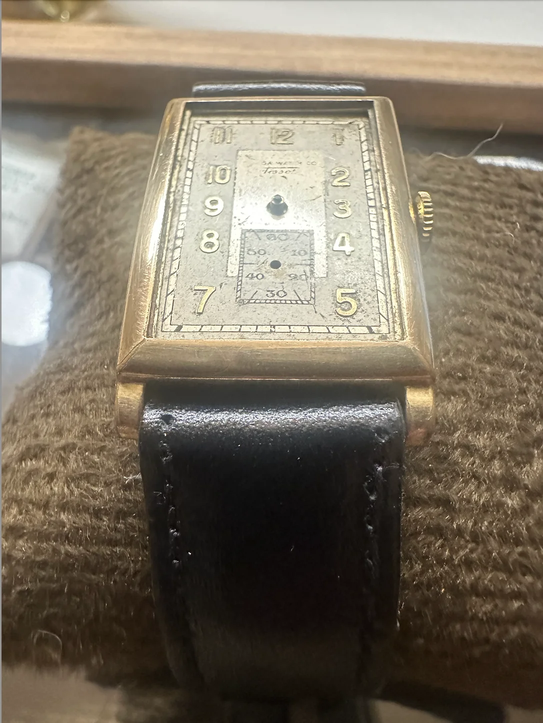

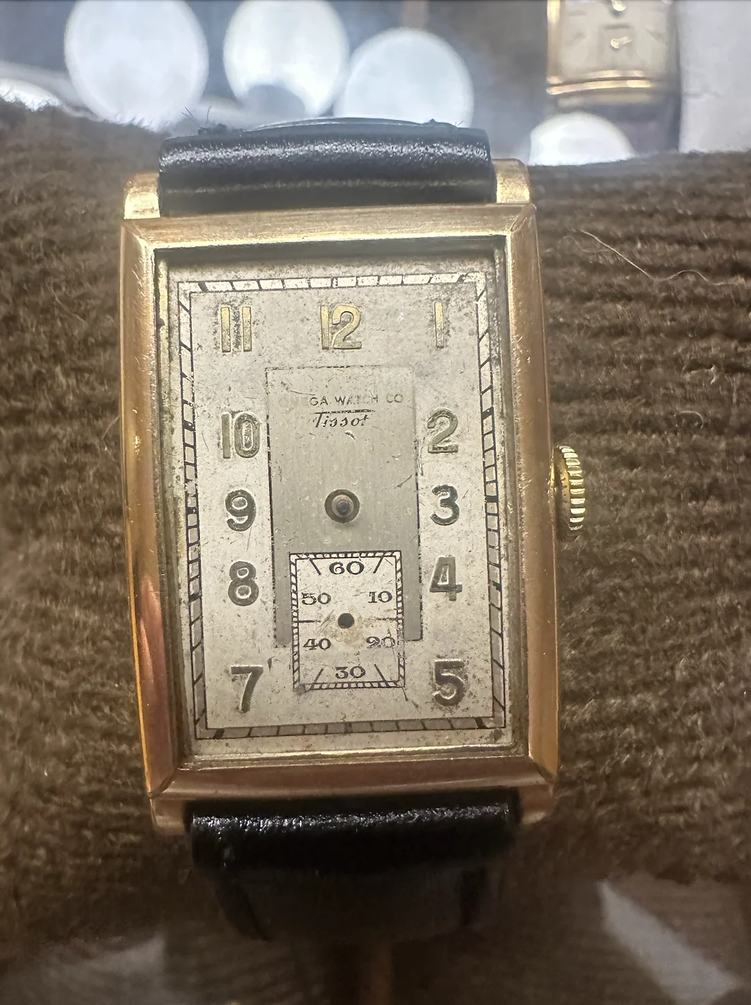

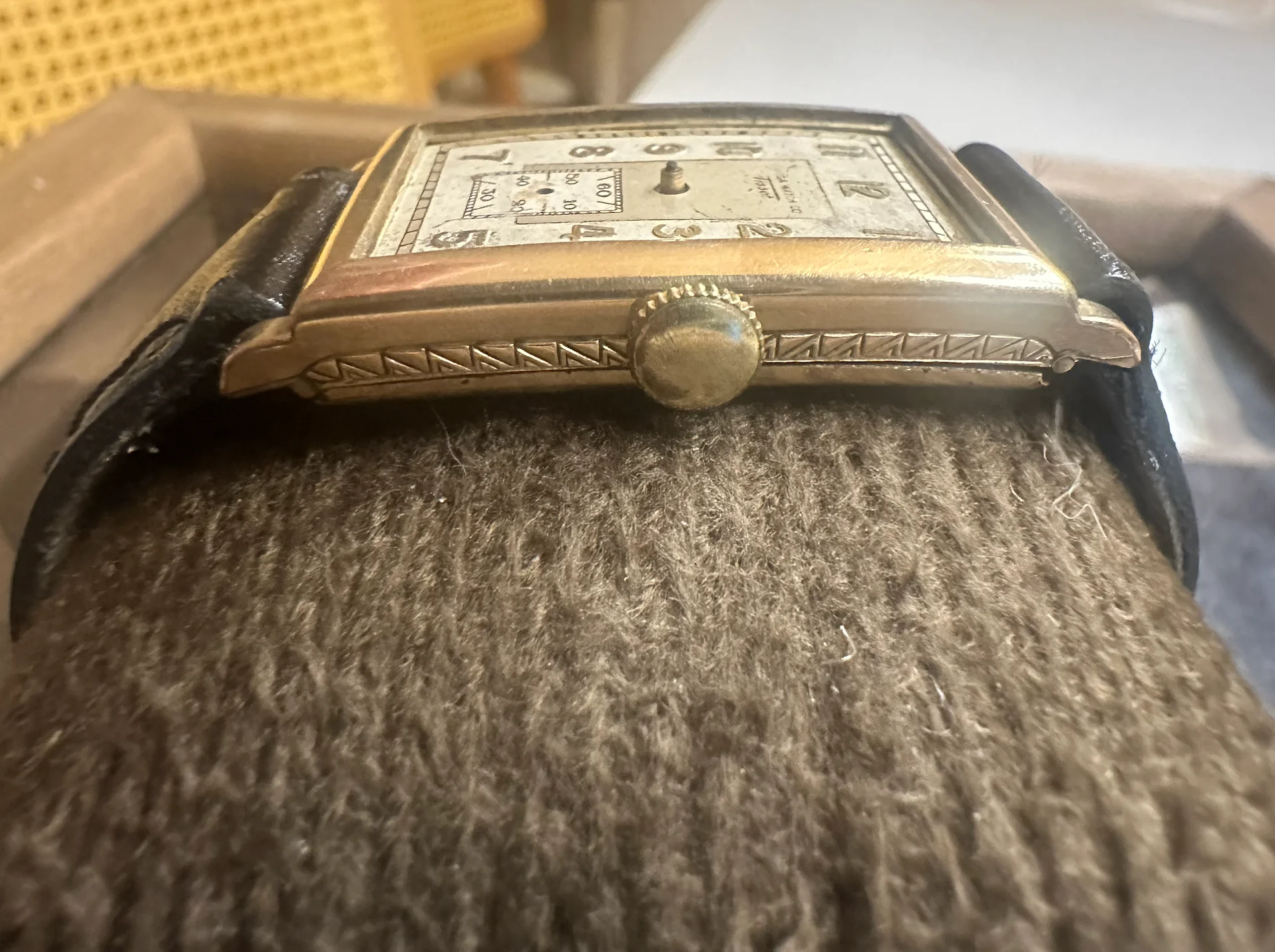

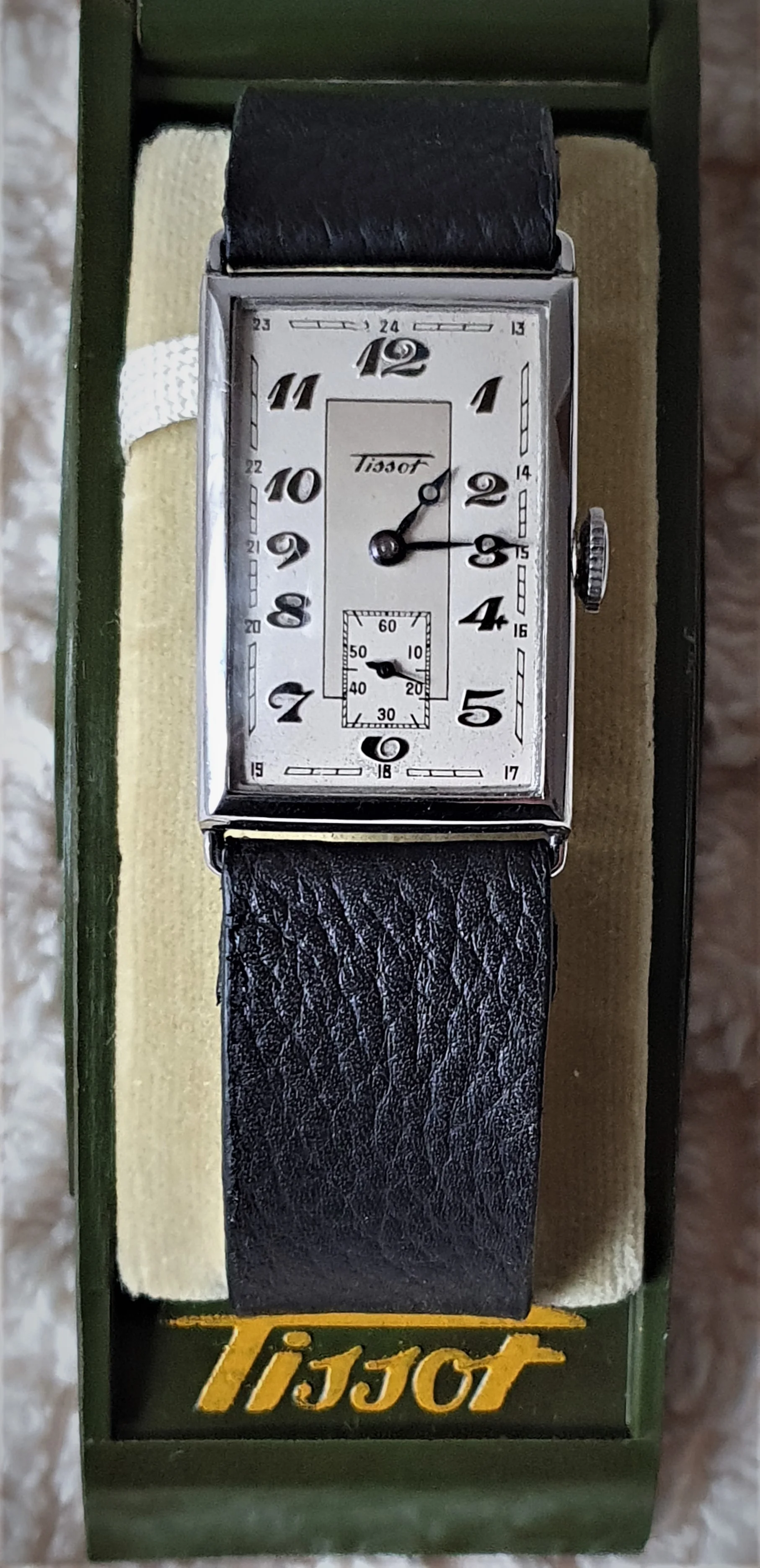

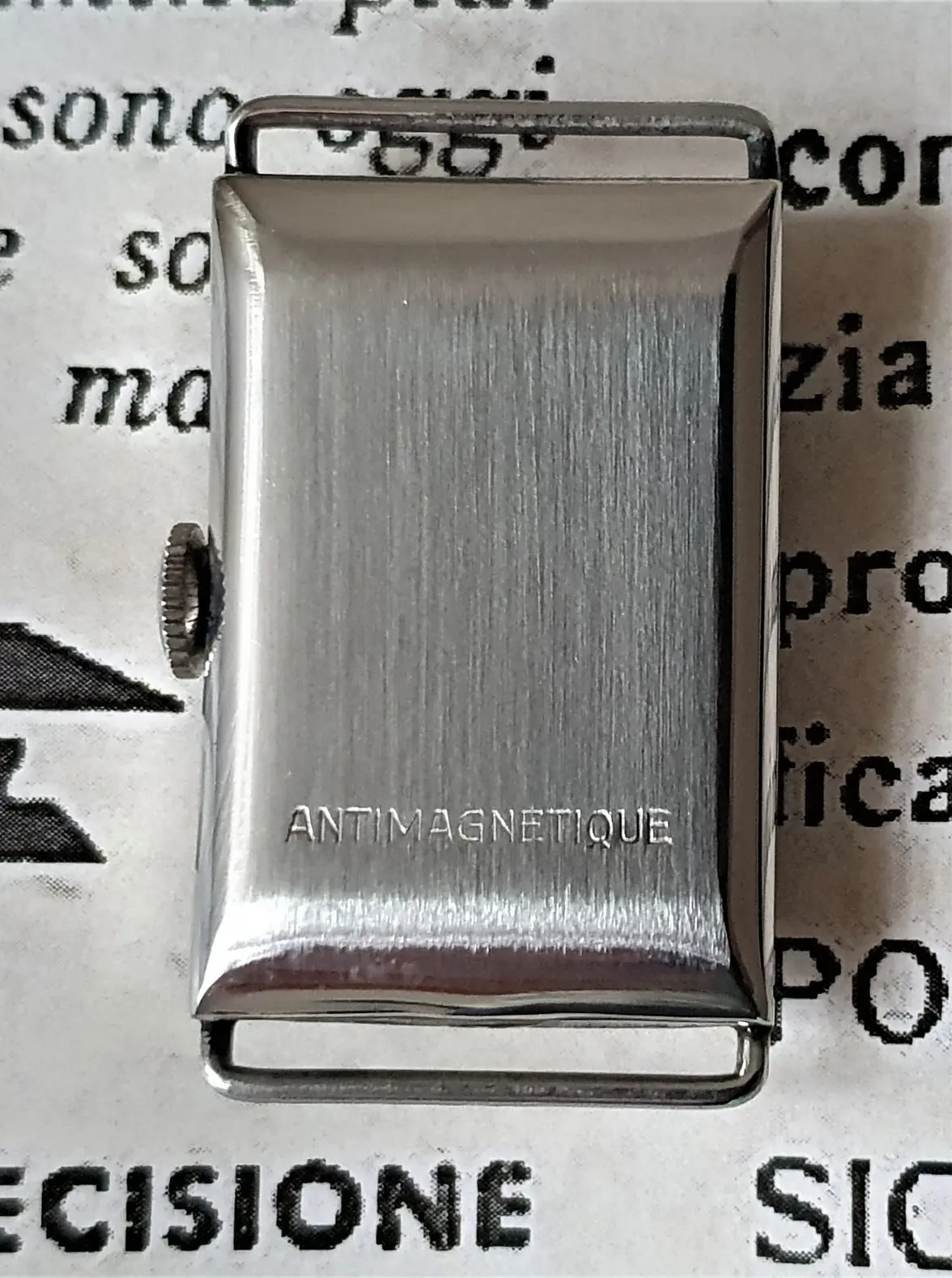

Hello everyone,
This watch recently came into my possession, and I would like to restore it as close as possible to its original condition. It is currently non-running and missing several components, including the crystal, hands, and buckle.
I have already sourced a donor movement (Cal. 20) with a very close serial number. However, I am having difficulty identifying the exact model to correctly source the remaining parts - especially the hands.
Could anyone help confirm whether the watch is original, assist with model identification, or share reference images/catalog entries of similar pieces?
Thank you very much in advance.
10
4

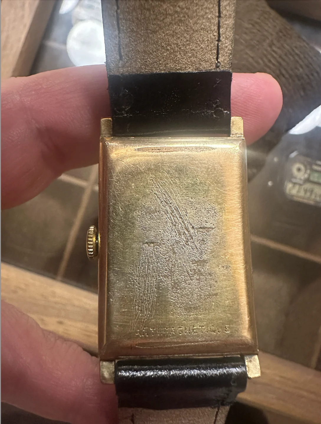

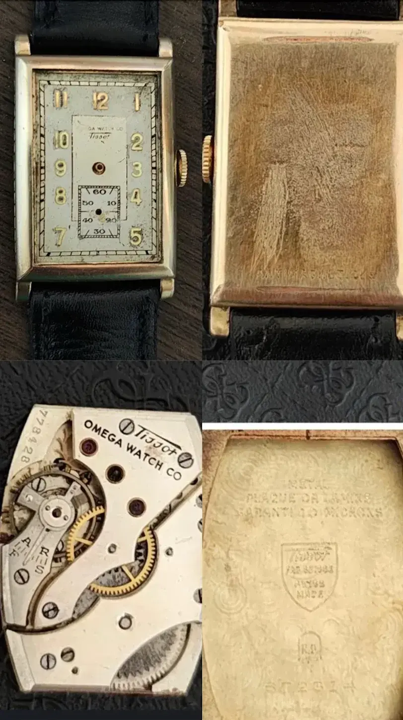

Some additional Info.
Movement:
CAL.20
Serial:
778.428
Box engraving (internal):
METAL
PLAQUÉ D'OR LAMINÉ
GARANTI 10 MICRONS
TISSOT
FAB SUISSE
SWISS MADE
RC
672314

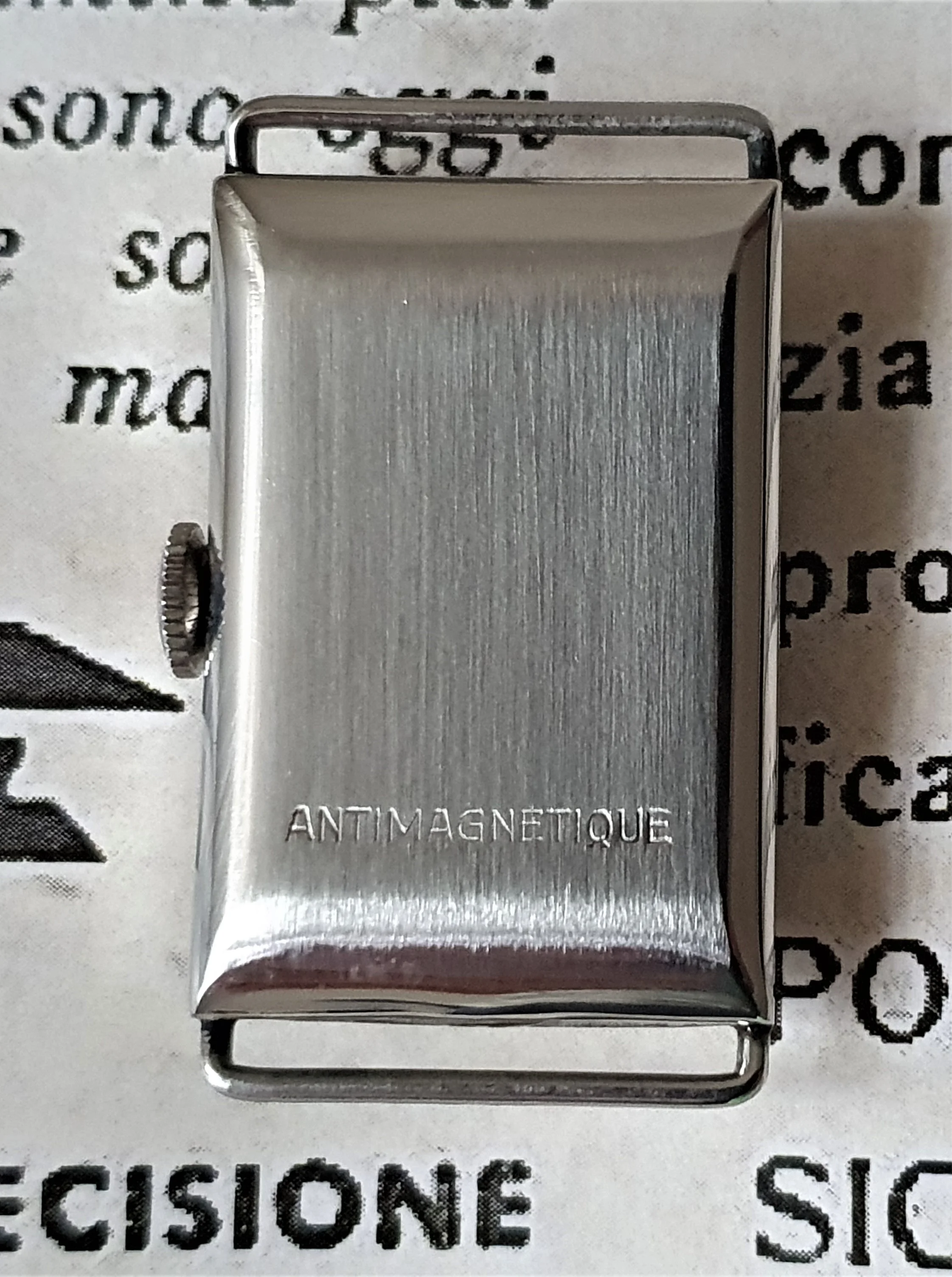

Box engraving (external):
ANTIMAGNETIQUE
3,273
14,218

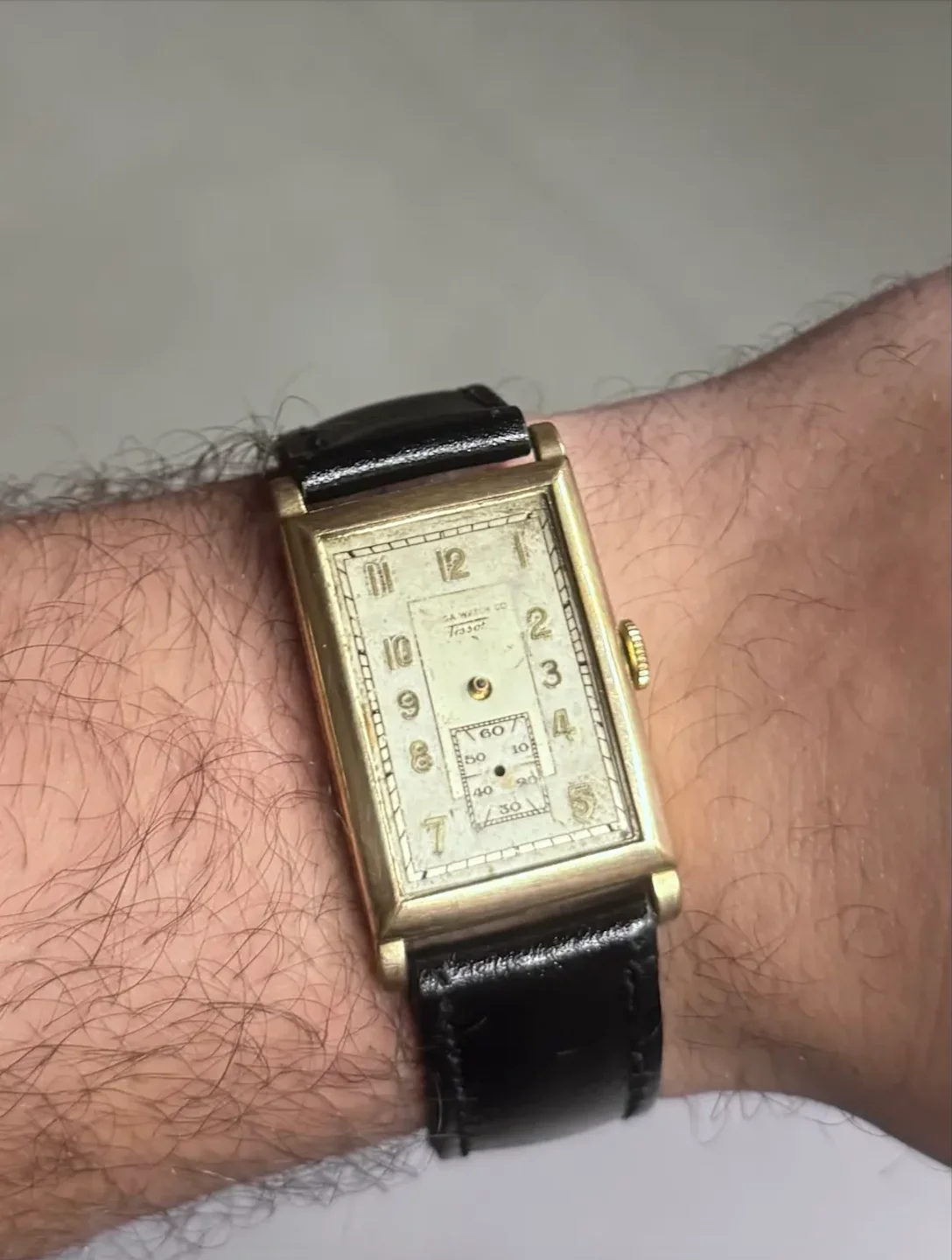

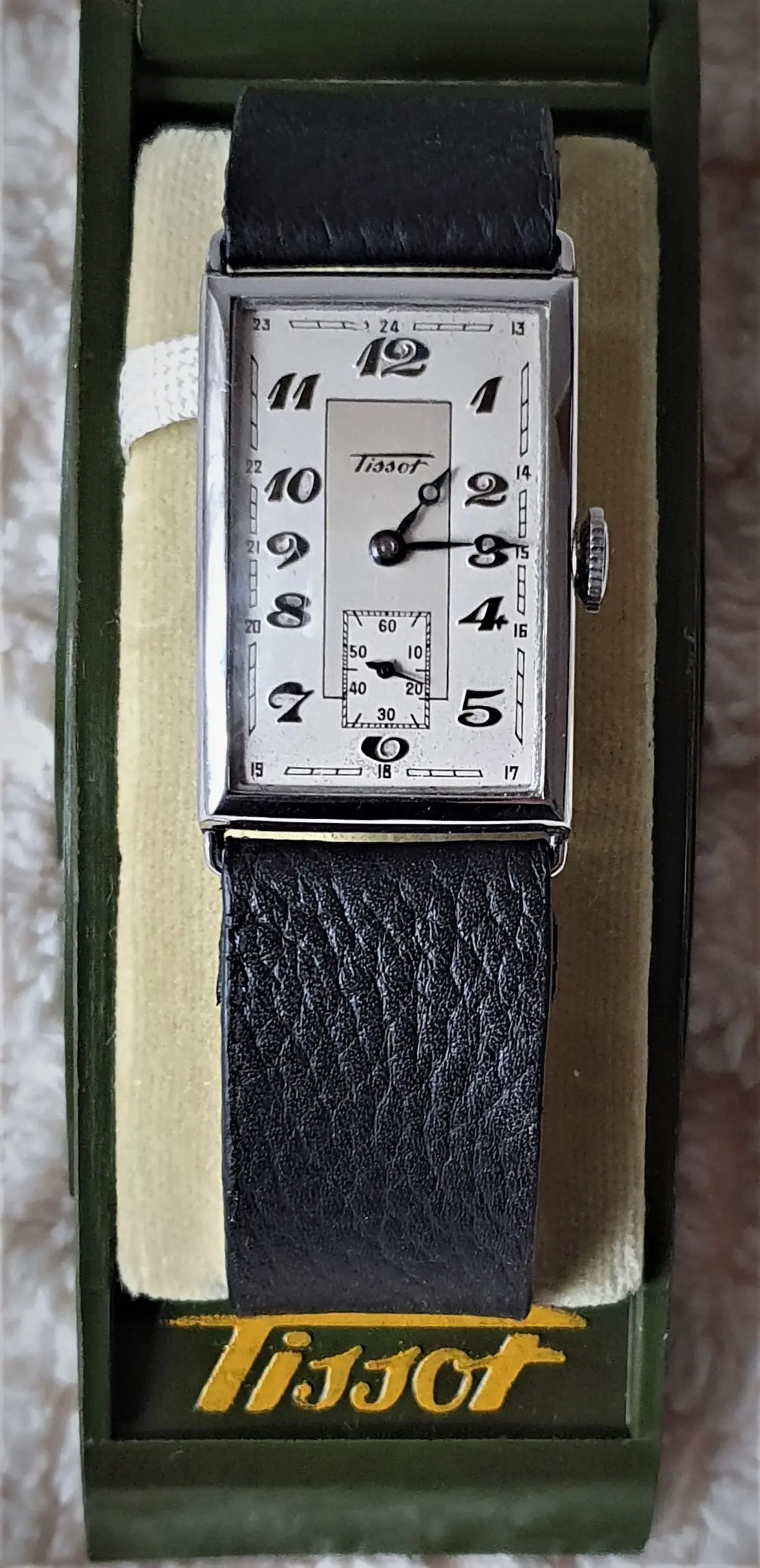

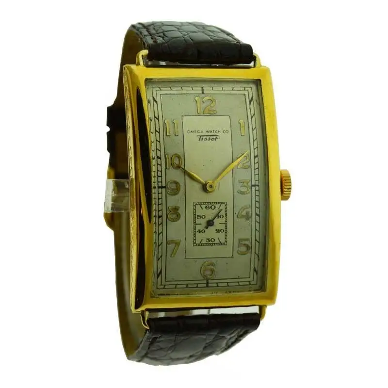

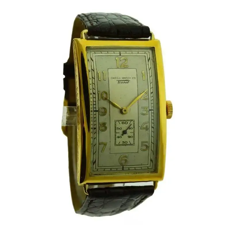

Hello @ruibelfort and welcome to the forum! Your watch looks entirely original to me, including the KB case and dial. It would originally have had gilt leaf hands (gilt hands to match the gilt numerals) like this jumbo version of your tank:

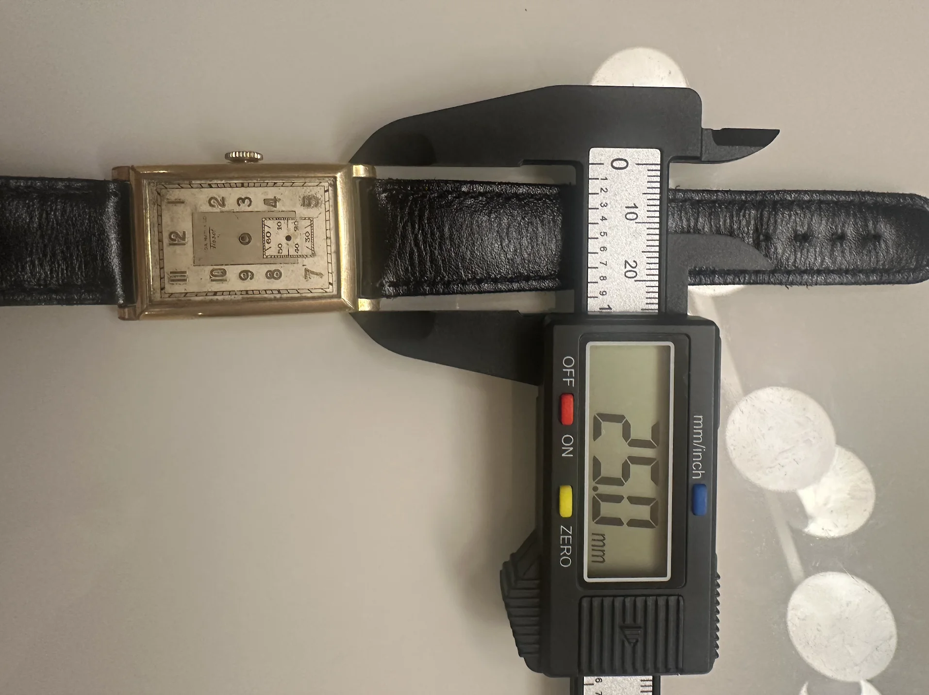

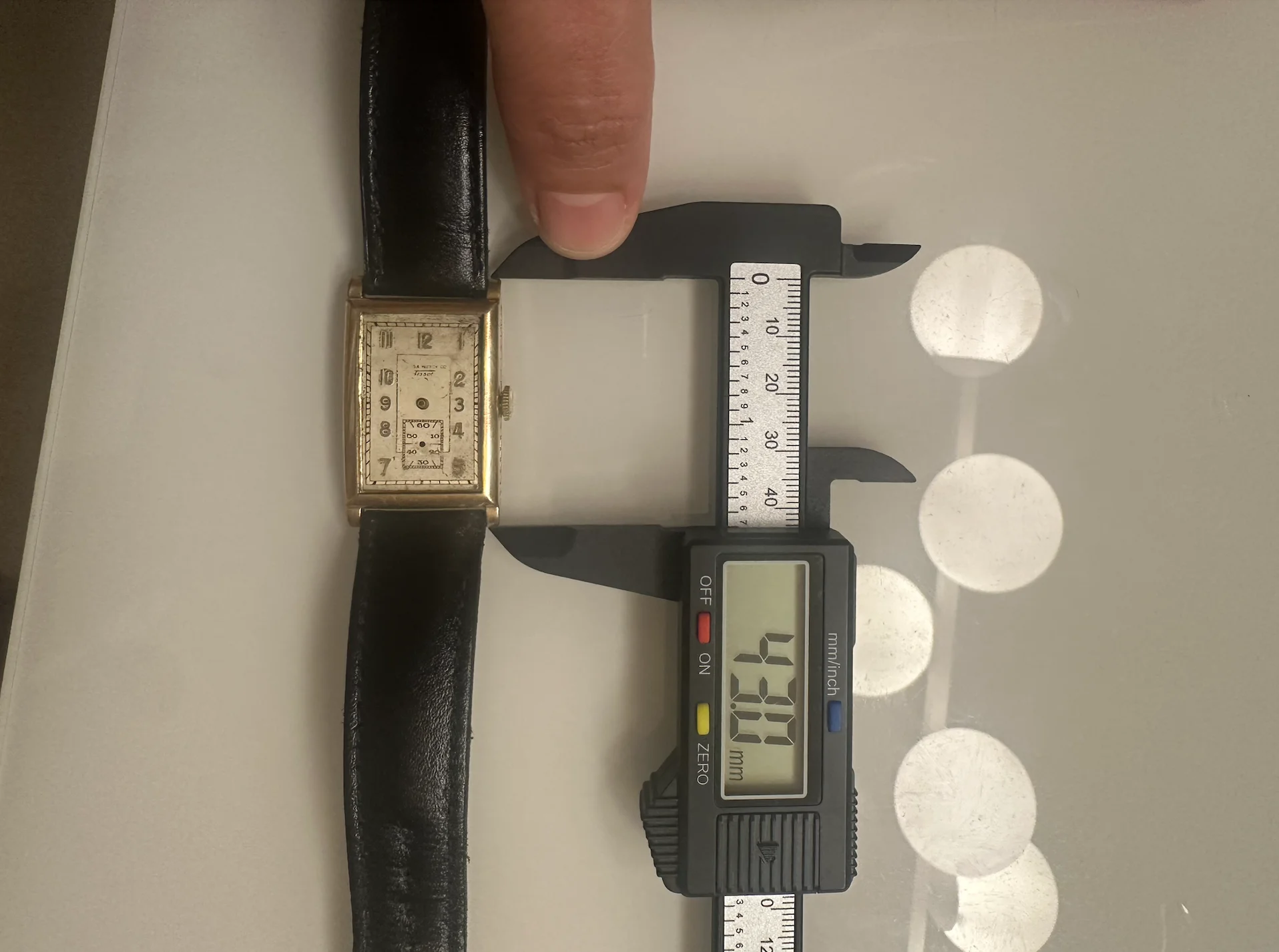

The visible dial area is 30 mm x 20 mm. Based on my research, I arrived at the following estimates:
Lengths (center to tip):
- Minute: ~10.0 mm
- Hour: ~7.4 mm
- Small seconds: ~3.3 mm
Hole sizes:
- Hour: ~1.20 mm
- Minute: ~0.70 mm
- Seconds: ~0.25 mm
Do these proportions sound correct to you for this reference?

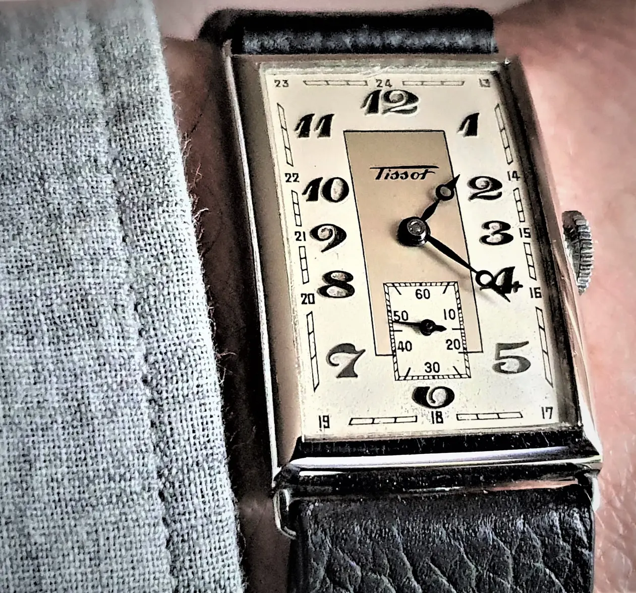

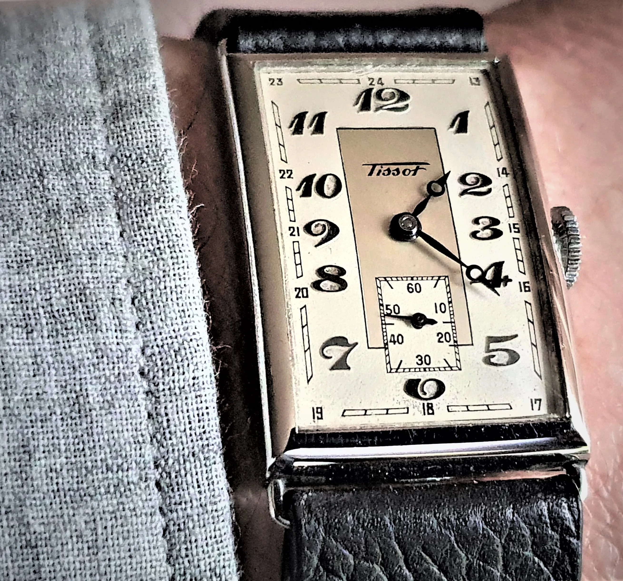

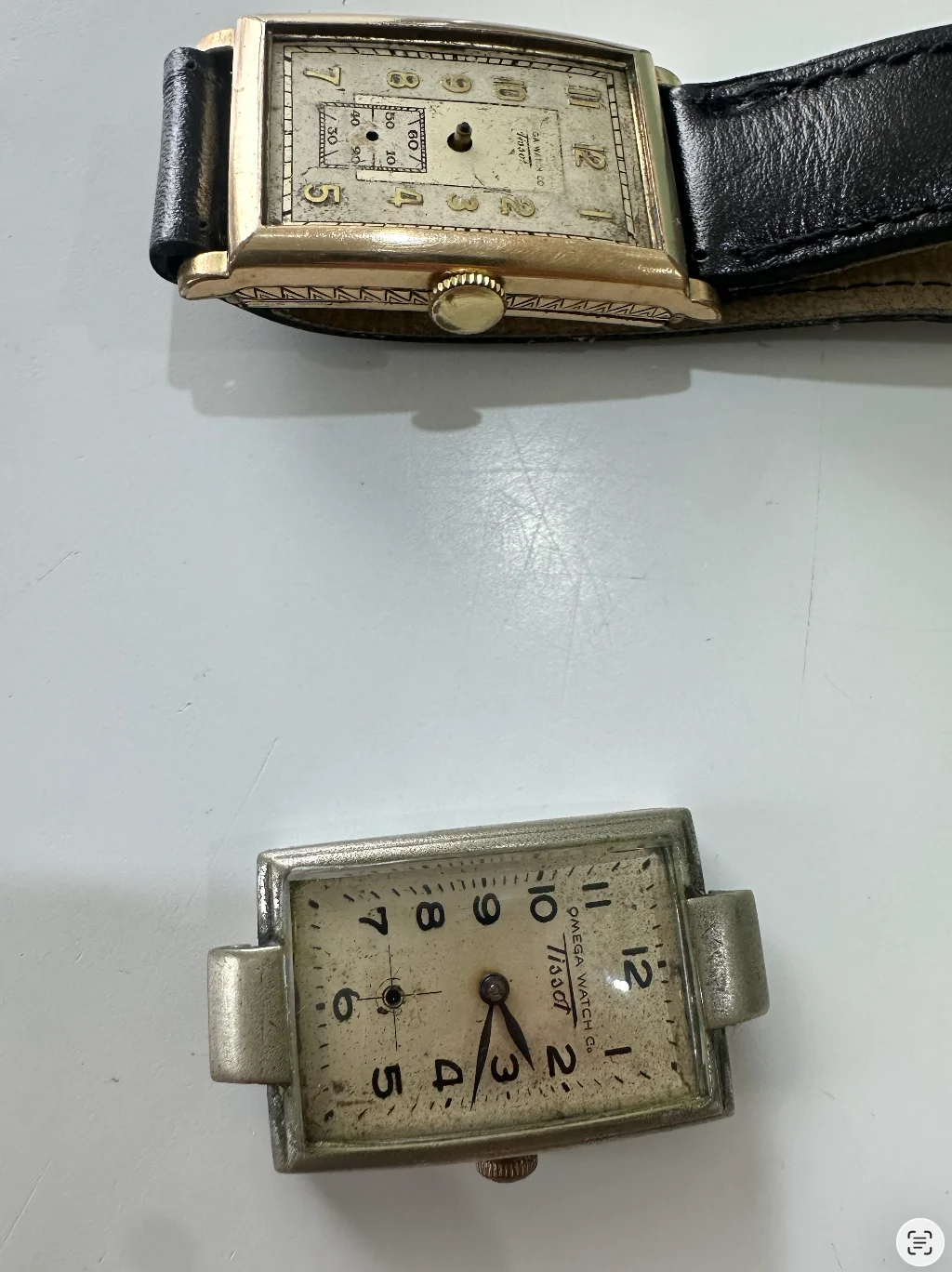

I have a Tissot from the same period with the same movement, but it features Breguet numerals and these hands.
10
4
Beautiful, @skand !
Any chance you have the serial number? I’d like to check the production year.
809
9,407
Beautiful, @skand !
I have the service card at hand and can provide the numbers: case number 848650, movement number 744714, and calibre 20.

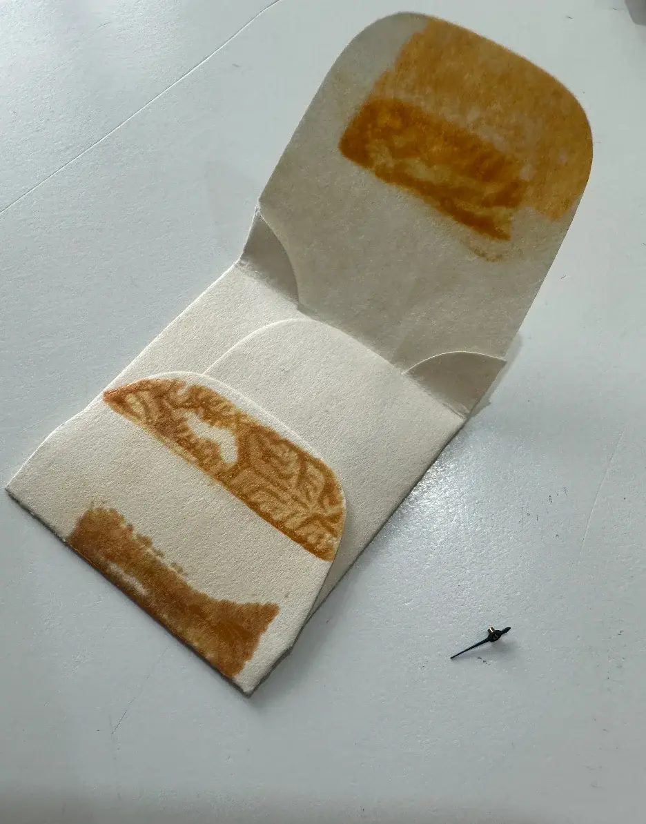

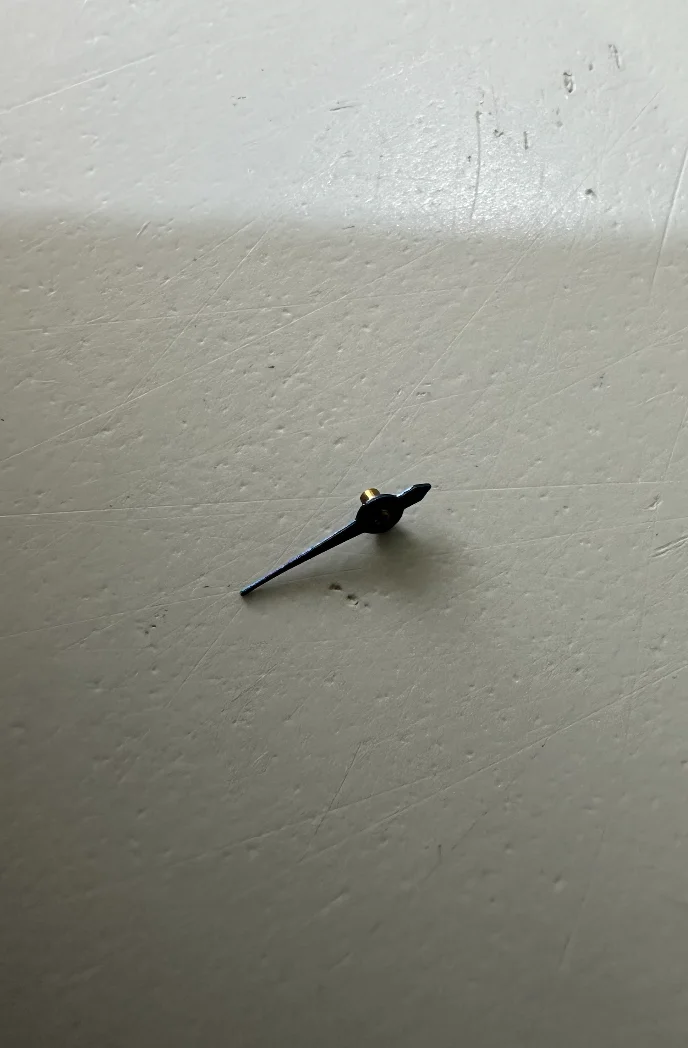

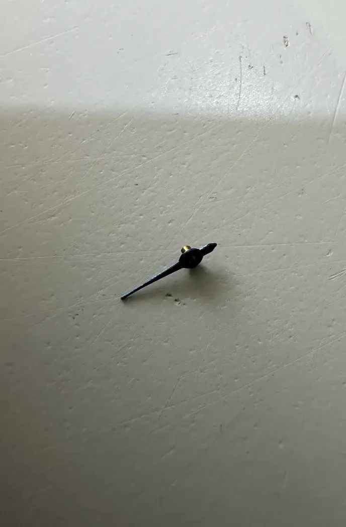

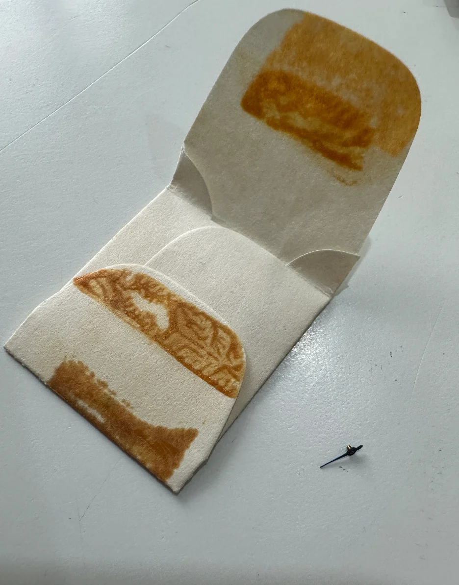

Just a quick update on this restoration: I was able to find all the pieces I needed to restore this watch as close as possible to its original state.
I found a donor movement at a reasonable price on a marketplace here in my country. It came with two of the missing hands, and the serial number is very close to my watch's. I was also able to find a NOS seconds hand for this exact model on eBay.
Last week, I left the watch with my trusted watchmaker, and in a month or two it should be ready. I'll come back here with the final result as soon as I have it in hand.
Thank you again for all the help!
