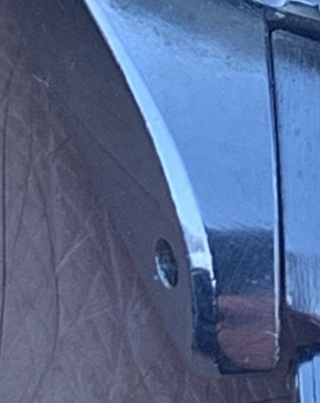

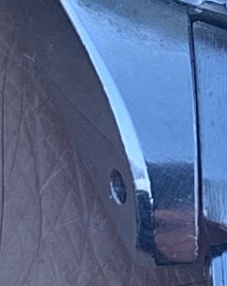

@Fedoclock Your stubborn position is perplexing. Please take some time to educate yourself before making comments that are not accurate. Here's an example of crown guards on an early '70's 1675 case. As you may notice, they have some wear from use and are also unpolished.
I hope you are kidding. I don t believe you are talking seriously posting this pic.
86
107
I honestly don't understand what you mean about the pic i shared and being "serious" or the earlier comment about "no crown guards surviving"?
3,997
9,030
@cvalue13 My opinion comes from experience in owning and holding honest examples in person. If this were polished by a wheel, the chamfers and satin finish would not be retained as indicated in these pics. The lug holes show wear but no evidence of polishing and appear factory original for a matte era case.

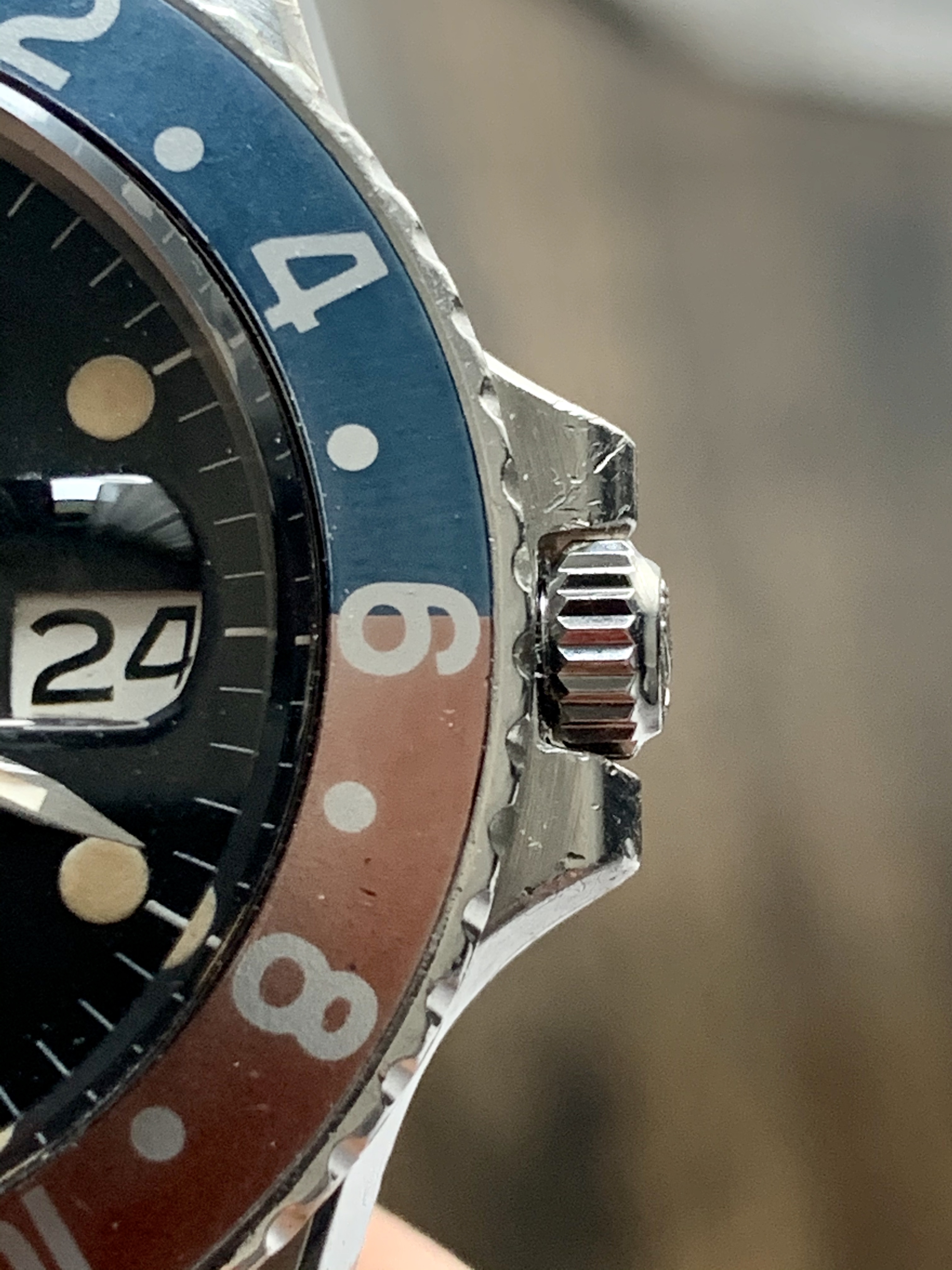

Again, I do understand this view; I think you also understand that enough of this type of “polish” and plenty of people in this hobby will still call the watch “polished” … I’ve been on this forum for going on 10 years, and admit I’ve not read every post, but not until today have I heard the needle-threading term “sleeve polish” - much less used as almost a widely accepted ontology of “polish”

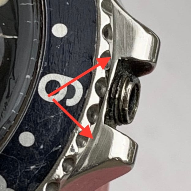

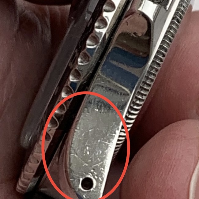

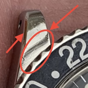

And I’m glad you’ve raised it, because this to me is the difference being trampled here.
On your watch, note at the blue arrow the interior edges of the crown guards - which are still essentially sharp, and at 90 degree angles (see yellow arrow)
As far as “sleeve polish” goes, the reason these specific edges and angles are retained is obvious: no sleeve (or even delicate “jewelers cloth”) has any purchase on these recesses. Scratches, dings, an intermittent rounded section due to this-or-that wear - sure! But in the main, these recessed edges and angles are roughly there, no matter and in contrast to the “sleeve polish” that may have occurred at the outer facing faces and edges of any well worn watch.

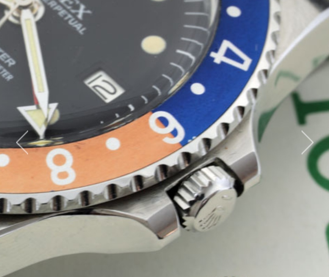

Contrast yours to the same features of OP’s watch:
Notice that even the recessed edges (blue arrows), in stark contrast to the watch @Larry S posted, are - not dinged, or scratches here and there, but instead - uniformly softened.
Moreover, notice (at yellow arrow) that the once 90 degree angles are now more boomerang shaped.
Whatever someone wants to call these differences, they amount to a justifiable difference worth noting - having something to do with some form of “polishing”
None of which is say anything about whether it’s not still worth a price!

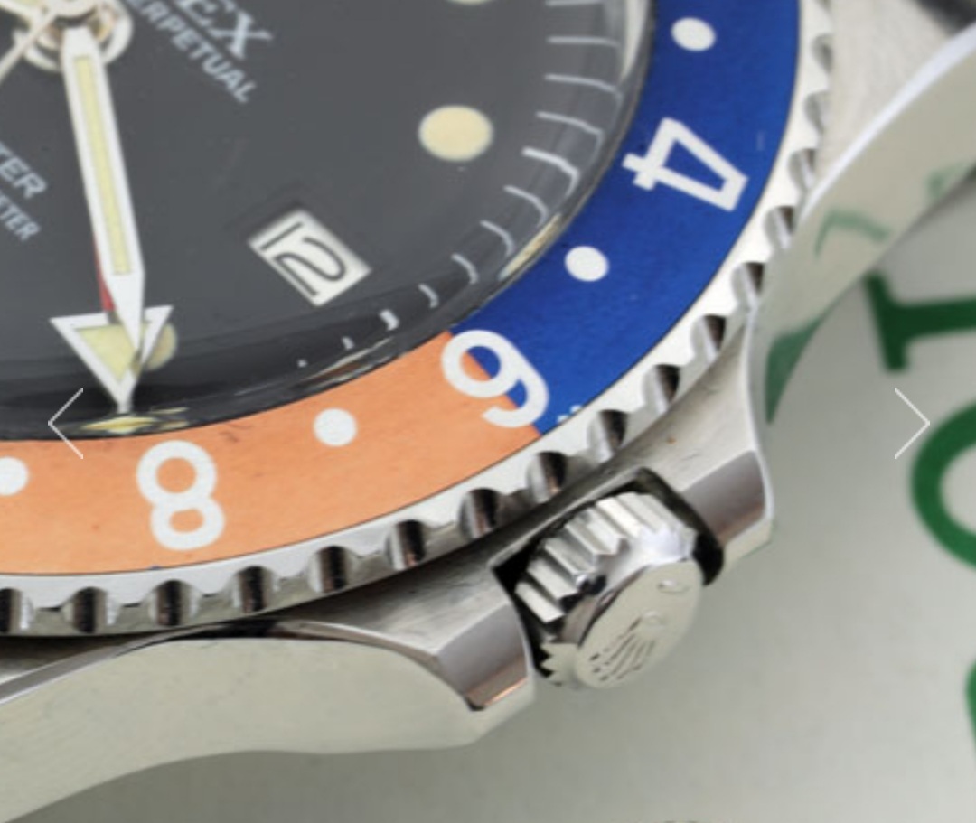

i'm not sure what the reference to dogma on polish is referring to honestly so I will respond without using that word. In my view, there is a distinct difference,(speaking solely for myself to be clear), between a watch that was worn for years with some softening of lines, finish, etc. as a result of just being worn and a watch that has been buffed by a polishing wheel (not maybe touched with a cloth) resulting in the original finish being altered from such intervention. The market also reflects a premium for pieces that appear to not have had the latter type of mechanical intervention compared to the former.
86
107
The example above, while interesting is not really an apples to apples comparison in my view. Watches from the matte era had much more hand finishing and different tolerances than a modern era watch made primarily by CNC machines. A case from the '70's may also exhibit some deformity from decades of wear. Case nuances aren't uniformly comparable from different eras due to changes incorporated over time as noted in an earlier response.

I have been following this thread, like many others before it, with interest. I firmly believe, that unless you know the provenance of a watch, it's extremely difficult to declare a it as unpolished.
I have handled a few 'unpolished' 1675's and own a couple 'unpolished' 16750's (one is an early matte dial which came right after the MK5 mentioned on this thread.) In my opinion, none of the ones I have observed/owned have rounded crown guards like the OP. I will also attest, quality of pictures makes a big difference. I have seen pictures of lug holes that look perfect w/o any cratering from one angle only to reveal the curvature around the holes from another view. Heck, I've taken a few of those pictures by accident!
IMHO, this watch has seen a polishing wheel in it's lifetime. I would never proclaim it as unpolished, that is a high hurdle for many serious collectors. I may be wrong, I won't be shy to admit it if I am, but my standard is very high when it comes to this question.
