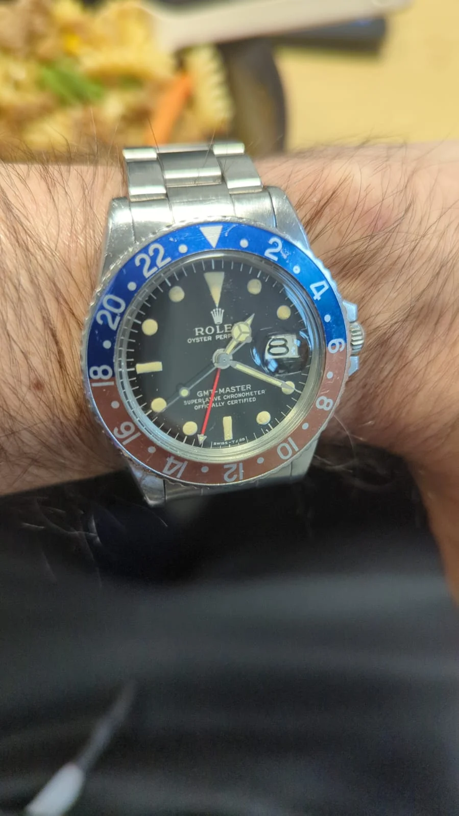

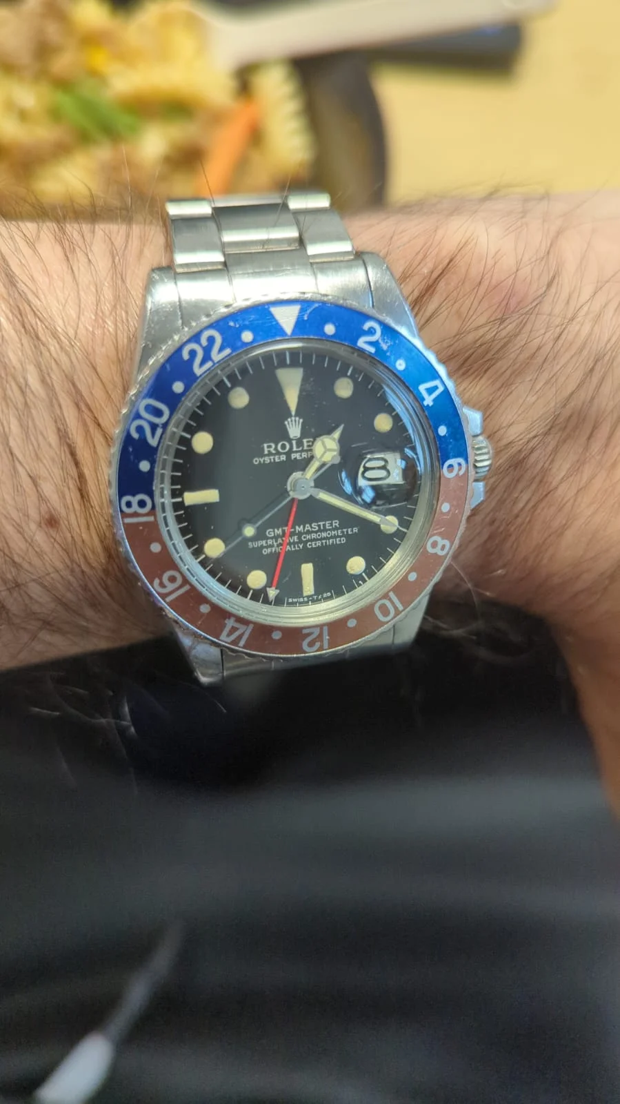

All I have right now is this image.
Best to All.
Well, it's hard to tell from that photo, but at first glance it doesn't appear to be a gilt-gloss dial, and also not the correct dial for an early matte 1675. So I would say that better photos and more information are definitely necessary to figure out what your friend actually has.

Nor does it have the original rivet bracelet so assume a later service replacement. Pictures of the clasp code would tell the year.
