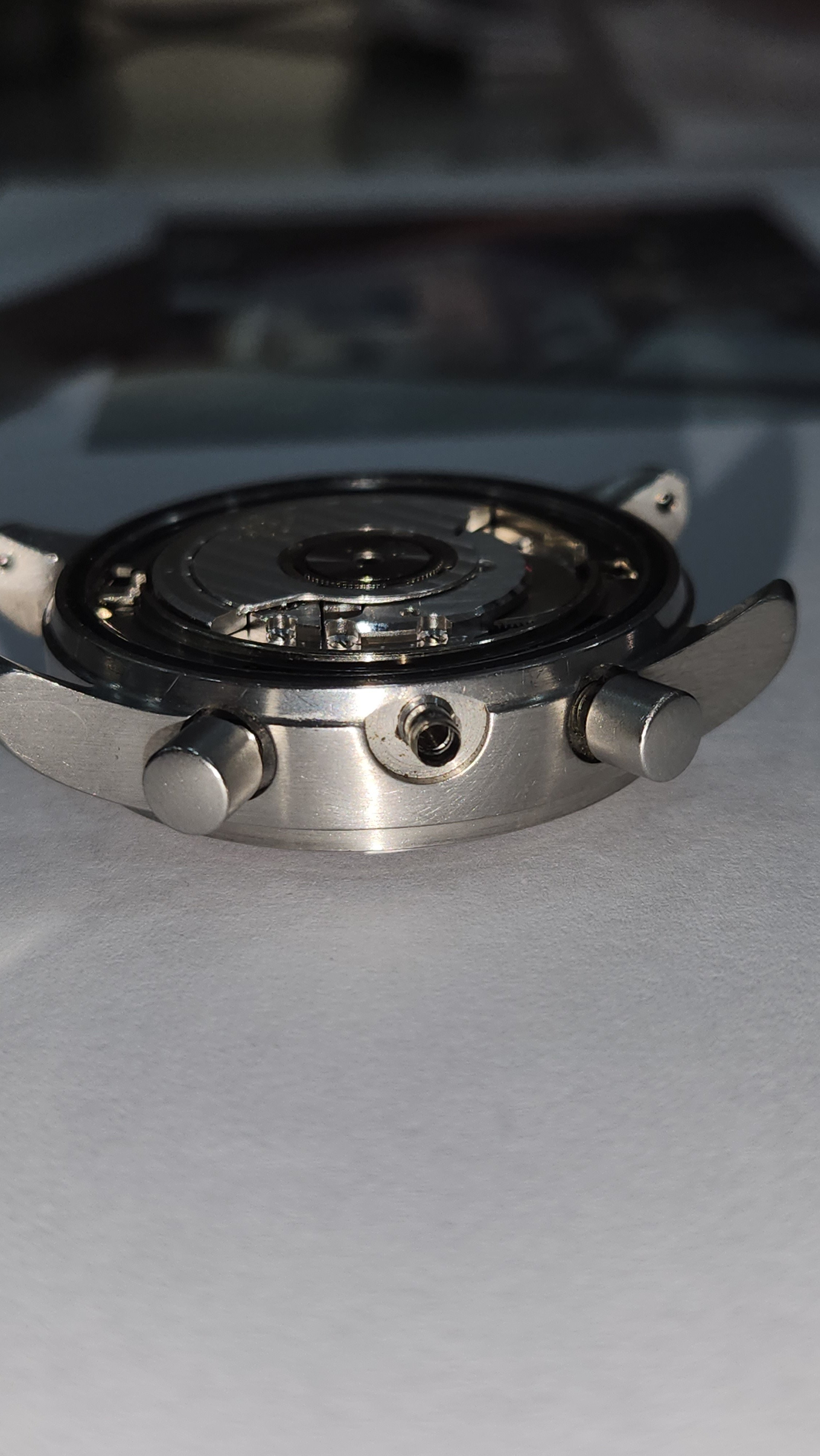

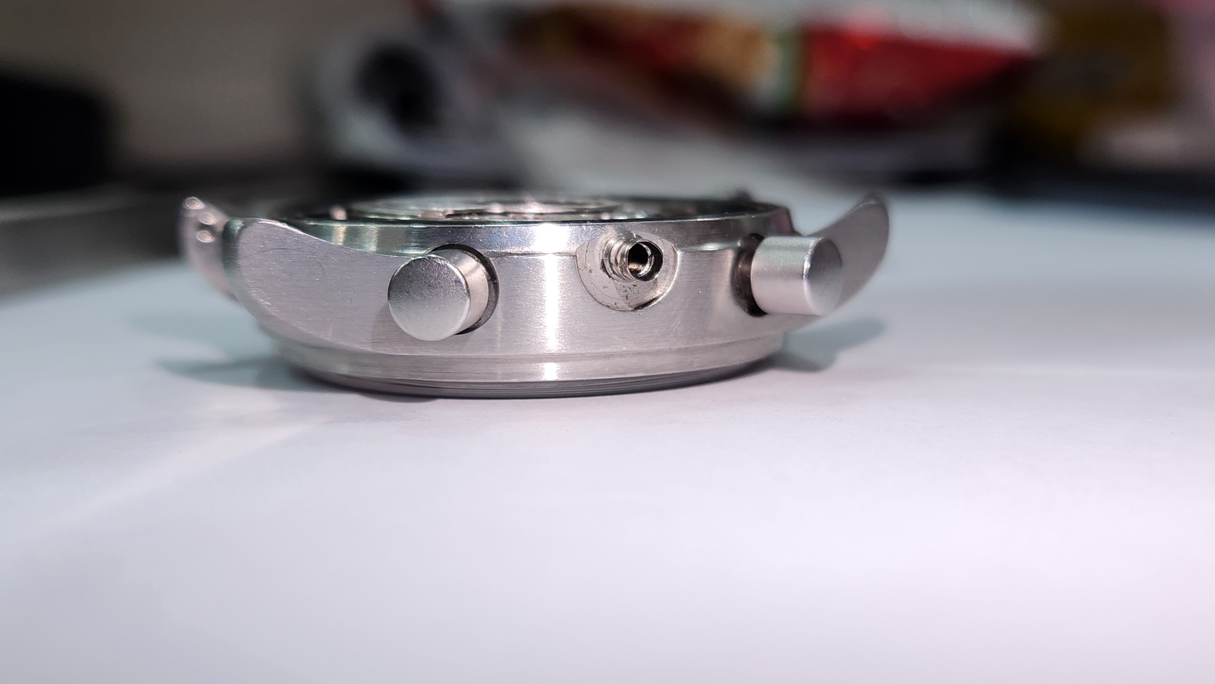

Hi! Recently i just got a good deal for a Vintage Omega Dynamic III Chronograph, after some times i just notice that the Crown aren't really tight , and sometimes just pops out from Close position.
i dont know if the Omega Dynamic III i have might have a busted Crown Tube or is it the Crown that gave up the screw threading in the crown
i wanted to replace it, but i think i needed the Part Number for this, or it can be replaced with generic Crown Tube?
Please do your magic guys 🙁
If you can check on the img below, does it suppose to have threaded crown or is it just fine?
29,952
77,435
069ST42146M | STEEL CROWN
090ST1230 | CASE TUBE
4
Thank you so much Archer!
cant really find the info i needed anywhere else!
Thank you so much!
