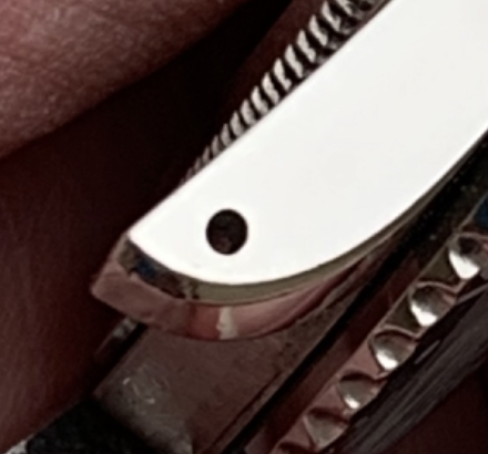

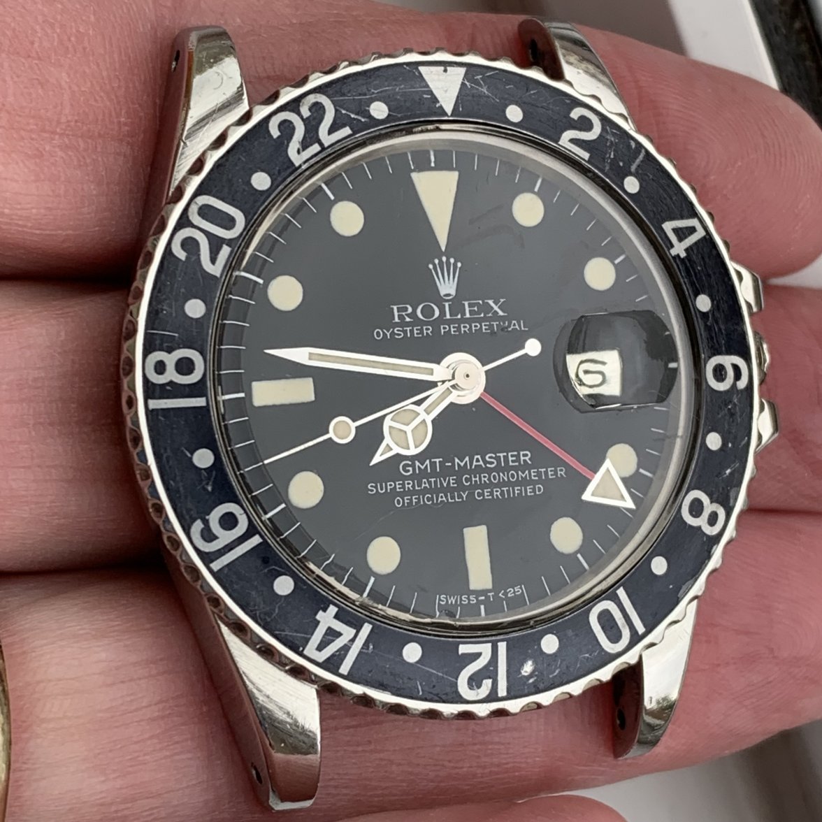

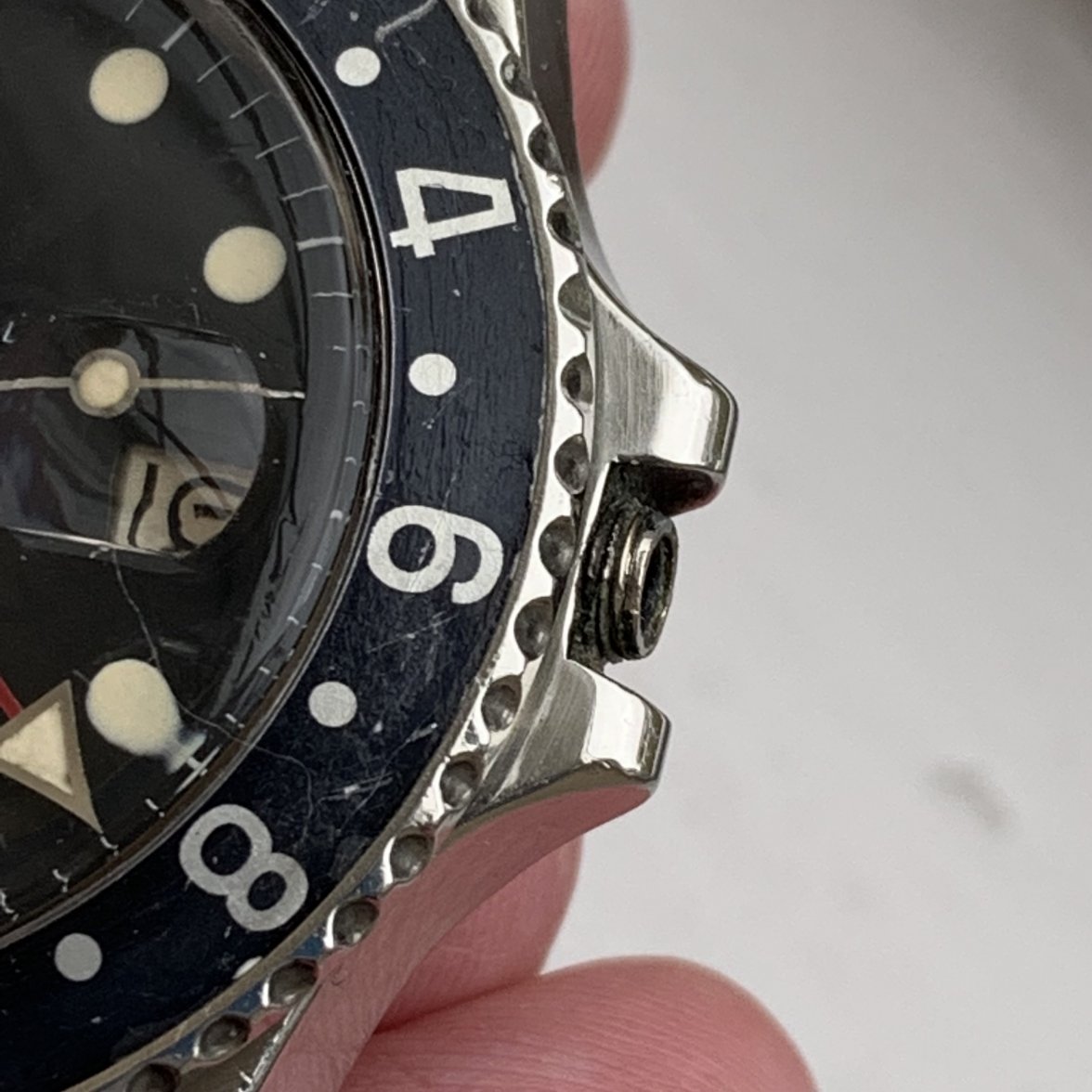

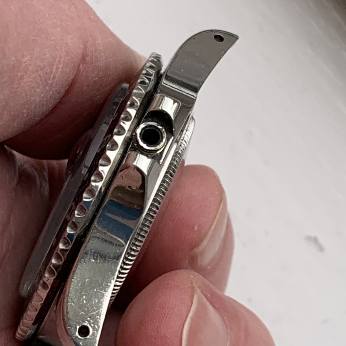

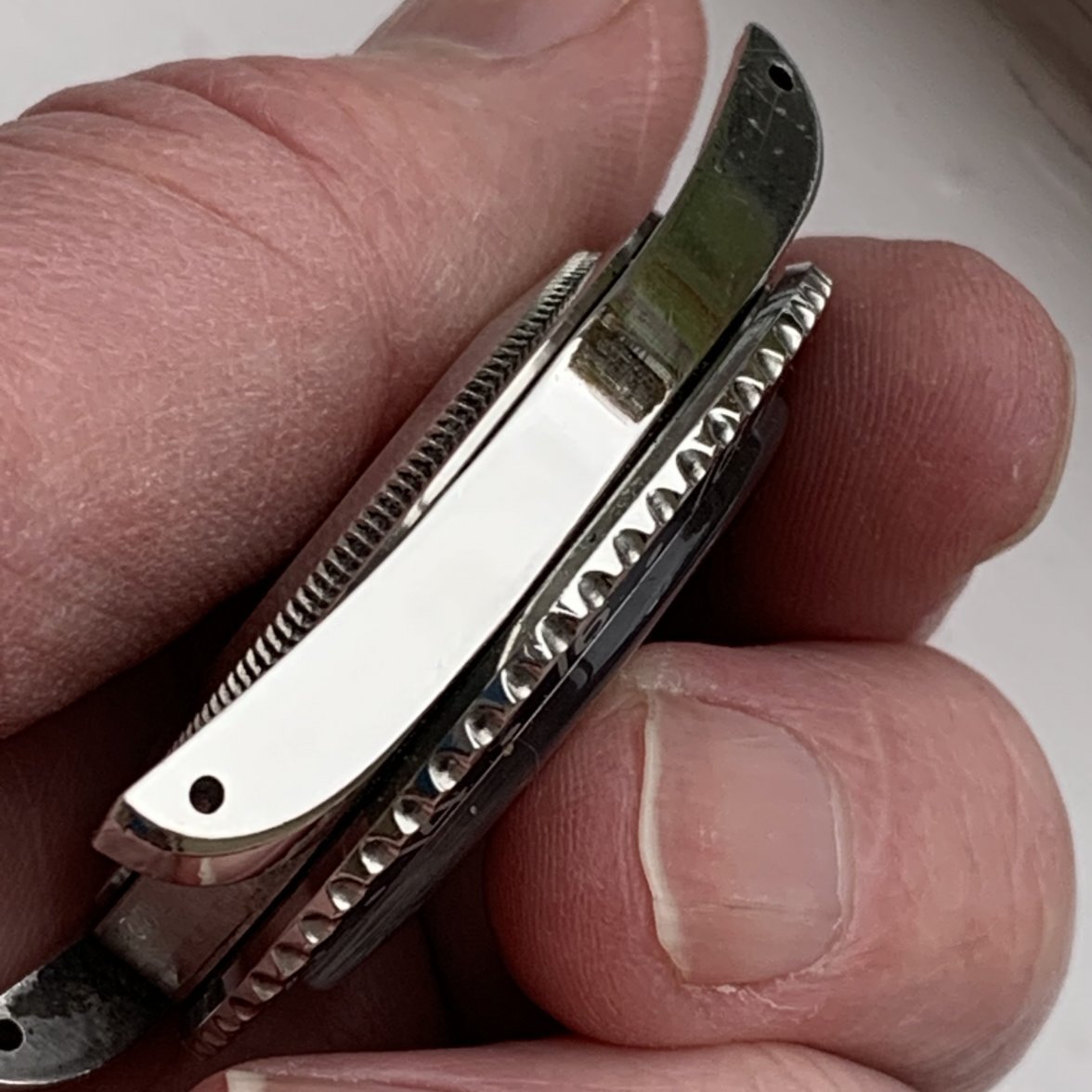

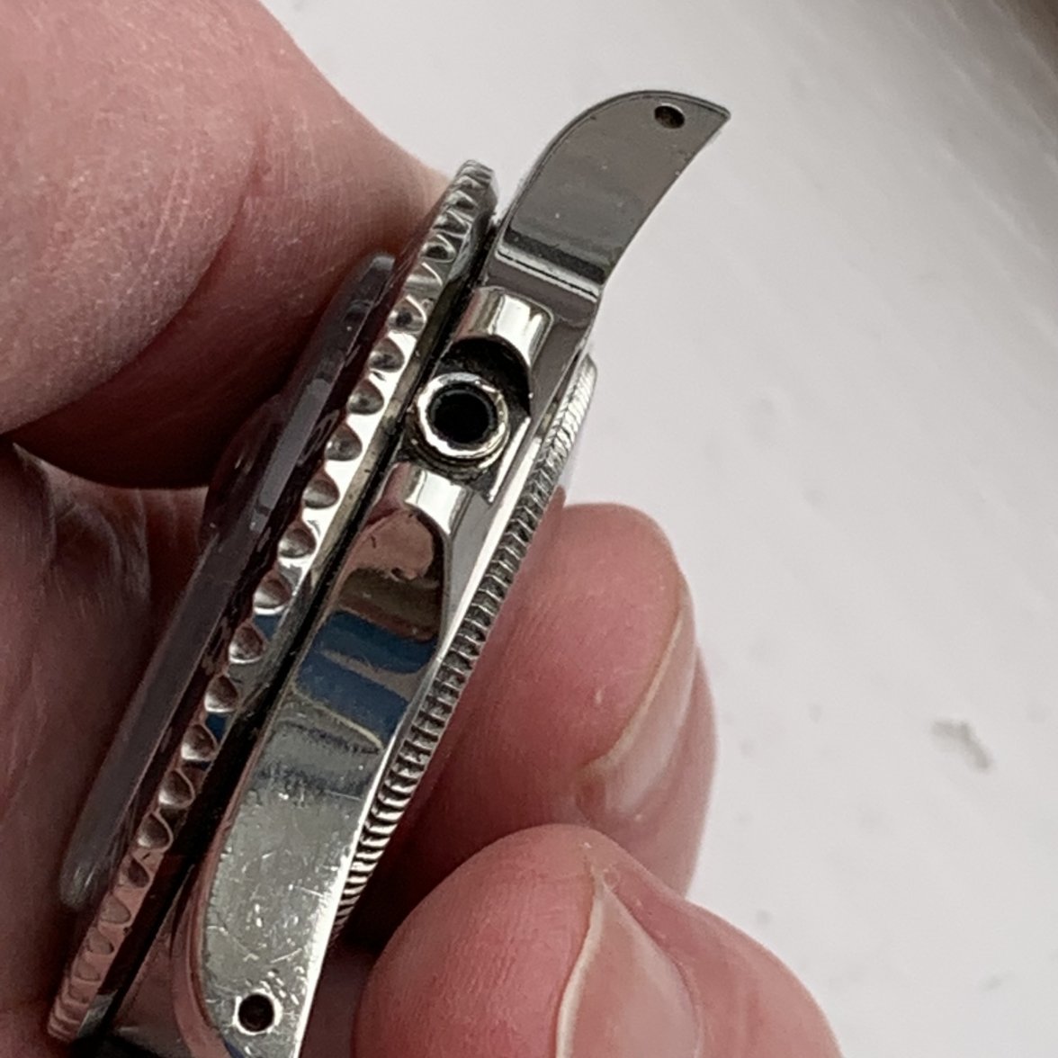

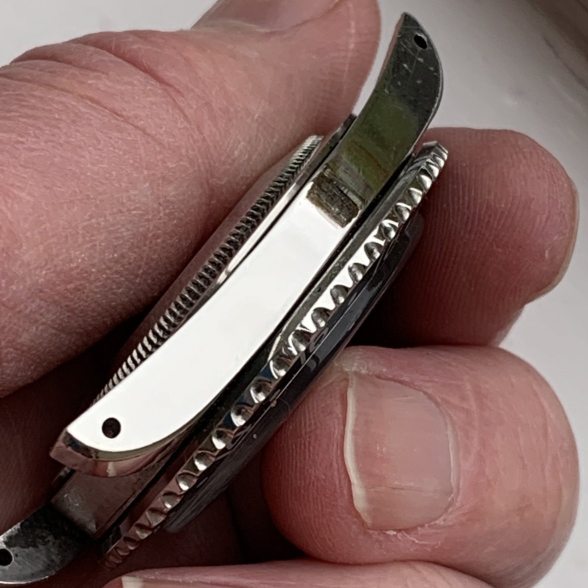

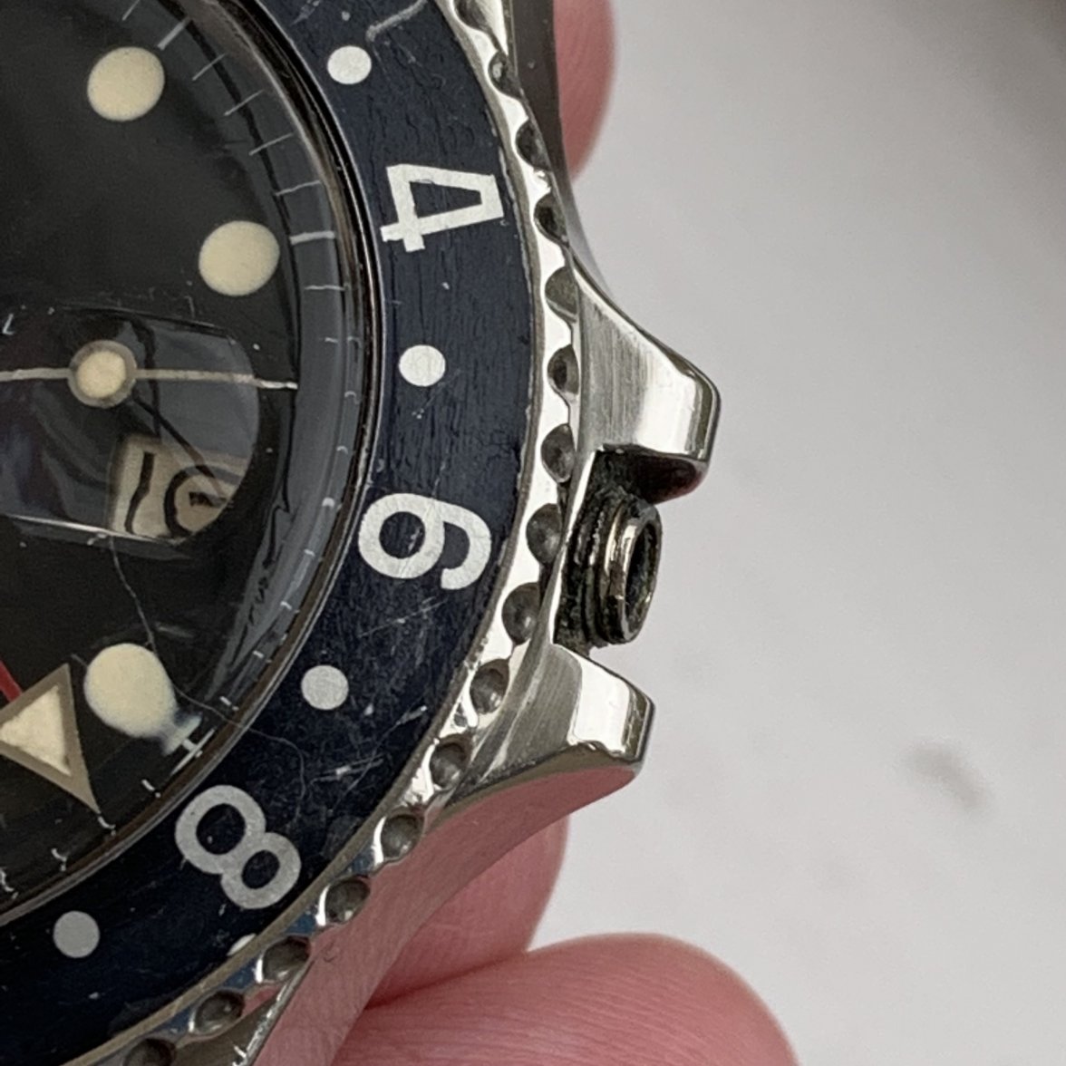

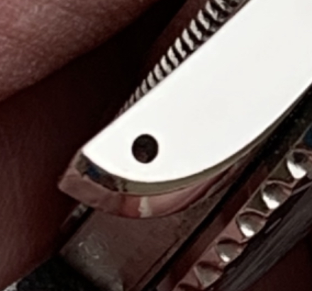

Case and bezel are over polished and can be seen by these pics. Insert is poor. Dial has to be checked that has not been relumed as well the hands set. Crown is missin. Last but not least I would check the bracelet carefully...
Also an higher price would be fine if you don't care about conditions. But if you care about conditions then the price is too high because even lower price would be too much.
Always depends on how important conditions are.
If you touch the case you will always note that the case has been fixed.

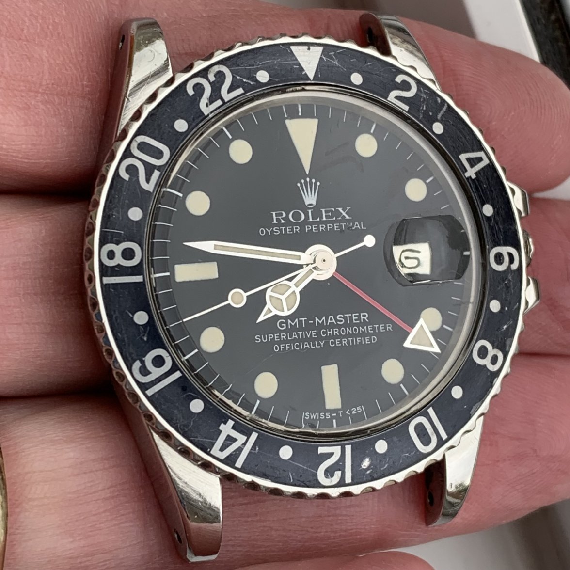

Also I want to say I have checked today with more time the dial and it does not look relumed so if I have to bet 1 cent I would say ia not which is an important point.
Insert is poor but is ok which is also a good point.

Disagree with some of the opinions on the case stated above. The case has typical "sleeve polish," were you see wearing off of the brushed finish in areas exposed to wear and tear, but retained chamfers and crisp lug holes (which are also far from the chamfers) as well as some evidence of brushing is areas closer to the case (like you can see on the top surface of the crown guards and at the top of the 10 o'clock lug as it meets the case). See a nice discussion of sleeve polish here. Might it have been polished a touch? Sure, maybe with a jeweler’s cloth, but the case is still better than 95% of 1675 cases out there. Many of the late 70's cases didn't have much of a chamfer by the crown guards so not sure why people think its been polished to hell. But definitely a nice case for me.
It also has the original bezel with the deep grooves and the lume on the dial seems unblemished. Easily worth what its being sold for and more.
Just needs a fresher insert.

this. The watch is a great buy at $8,200. I think bracelet is real, but not correct (doesn’t have “50” stamp). I’d bet that watch has not seen a polishing wheel. The crown is $50. Original crystal is $200. Service is $500. He has a $13,000 Watch for $8,950. Well done.
