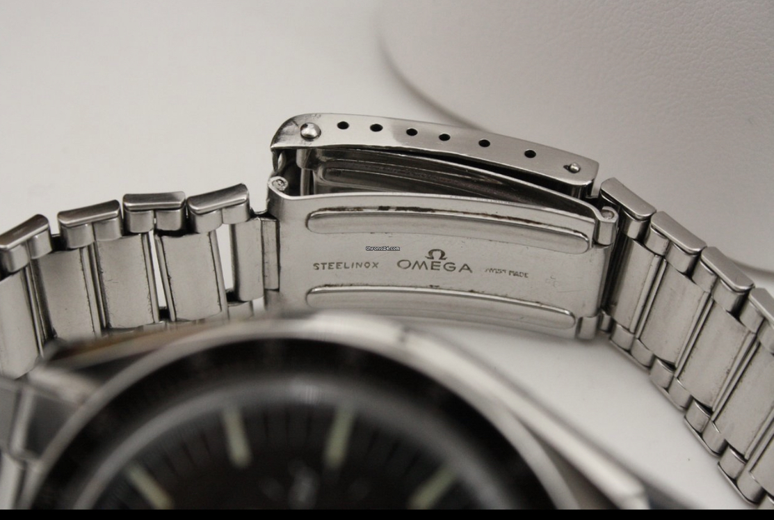

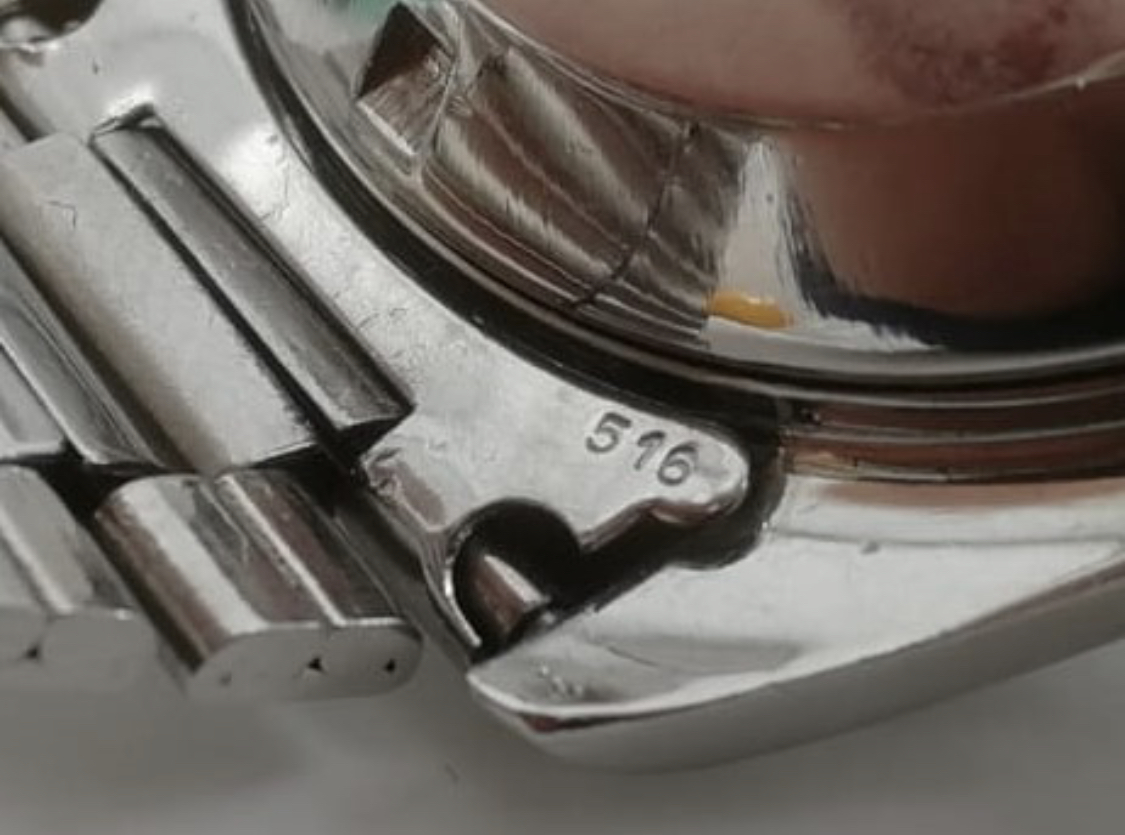

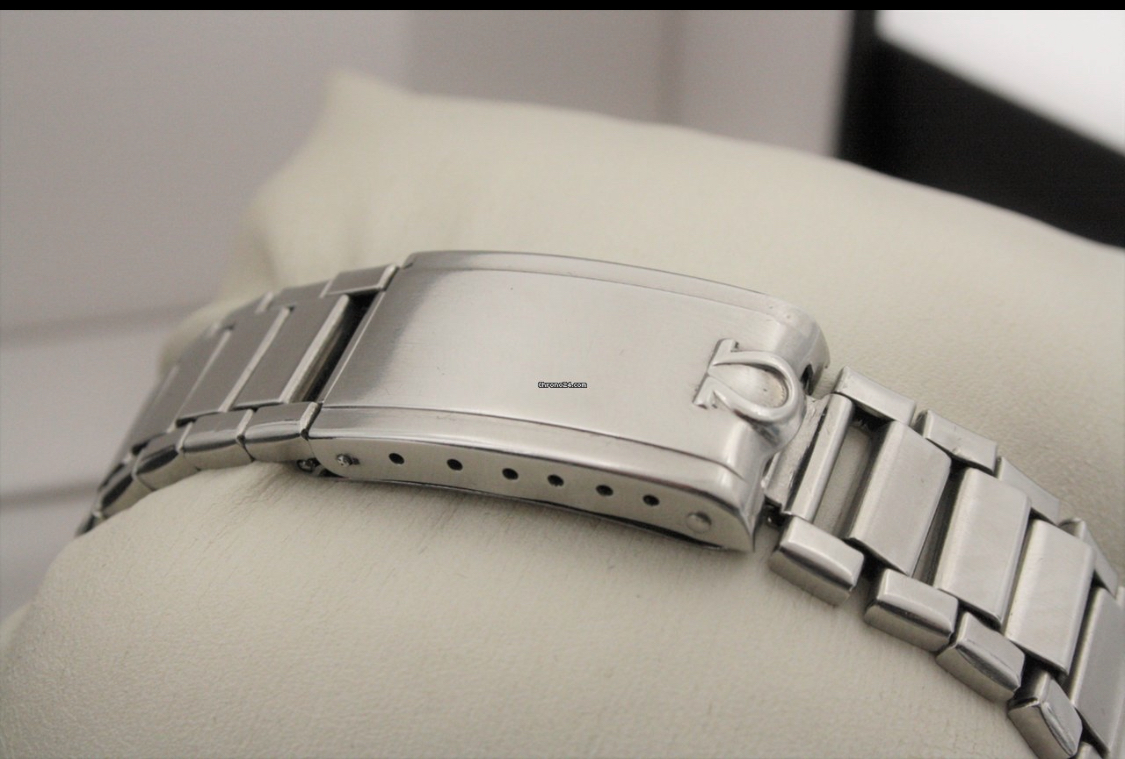

Hi everybody, I am new to the forum and hope you can help me out. I am planning to buy a very nice 145.012-67, with period correct bezel and lugs and all original parts, but I am not sure about the bracelet. It is not a 1039 or 1116, but it looks like a 7912 but with different end links. There is no reference on the inside of the clasp. The endlinks are 516, and I am not sure if the bracelet is time period correct. Can anybody help me? I have posted some pictures. Thanks in regard! Justin

From the pics it looks like a 7077. These have been seen with claps lacking the reference number. If so, this is too early to be correct for the watch.

I‘m missing the double stretch links from a 7070, looks more like an unmarked 7912 to me.

The clasp looks too short to me to be a 7912, but it could be the angle or how the photo has been resized.

Thanks for the reply, it indeed looks like a 7912, but how would the endlinks with reference 516 fit? Would this be a good buy or search further for a 1039?

I'd say a later 7912 with folded links. The earlier 7912's will have solid links. There's a date visible but I can't read it.

Looks like a homemade hybrid to me. 1506 or 7912 buckle and an early no date 7077 inner piece.

I am afraid it is indeed a hybrid. The seller does not know anything about the bracelet. Said it was repaired by laserwelding
