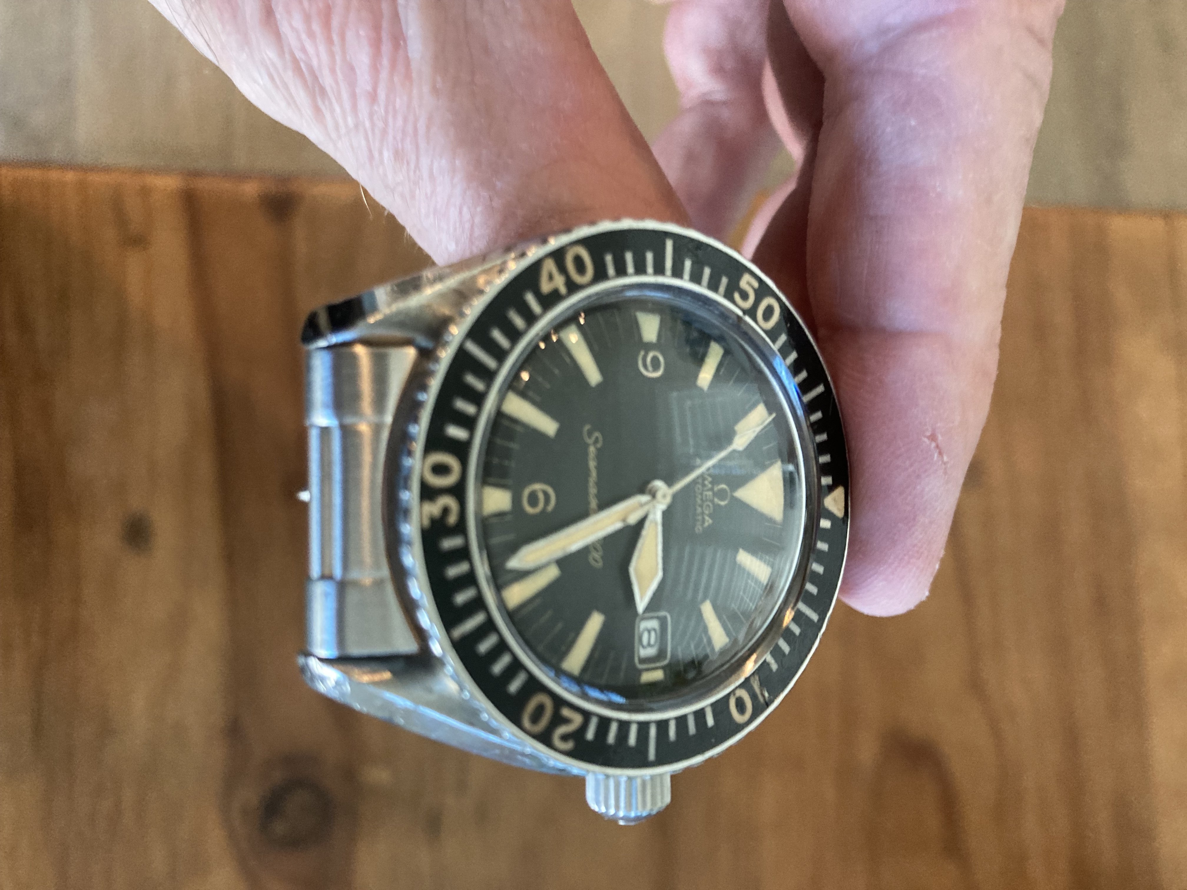

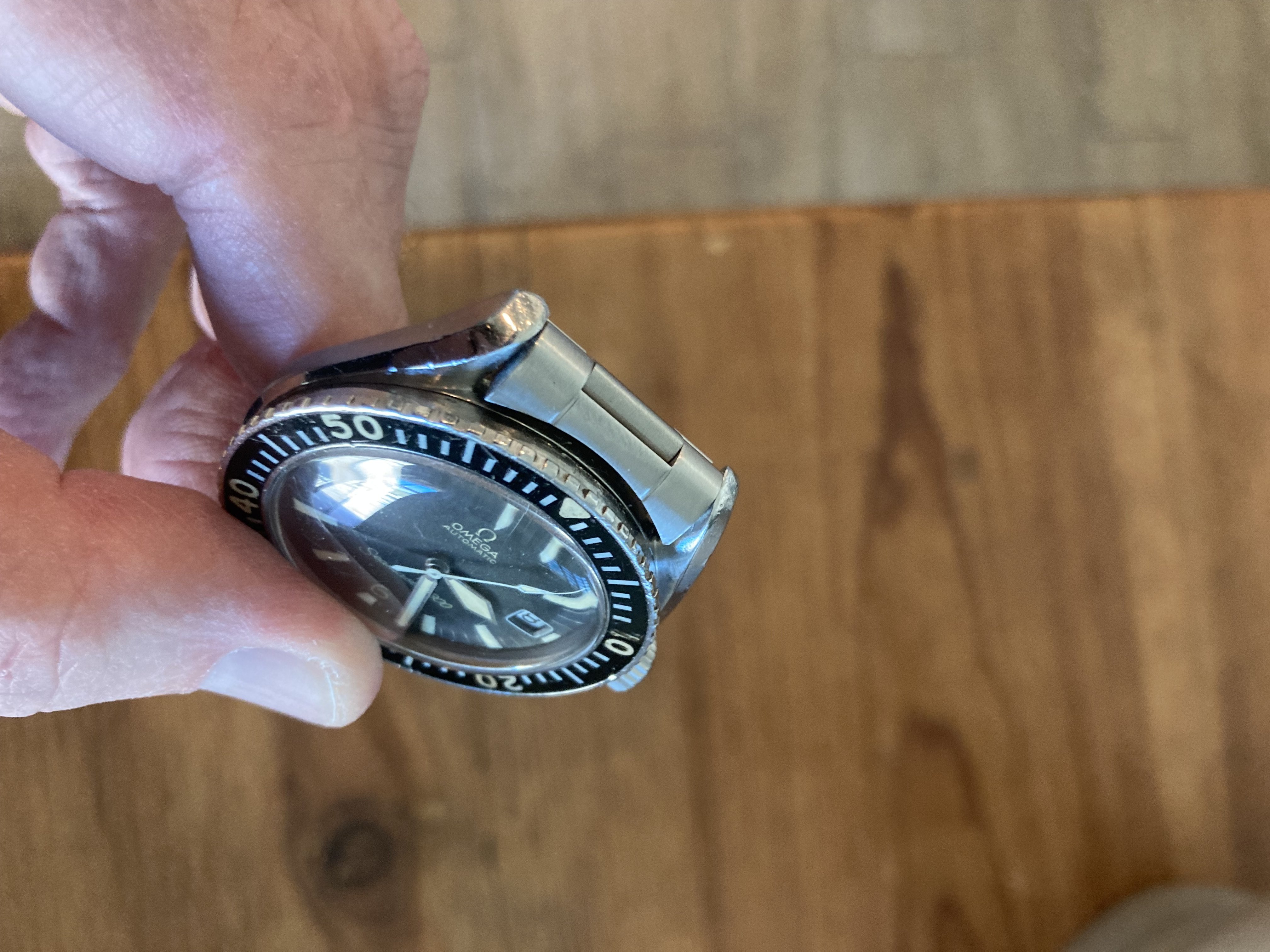

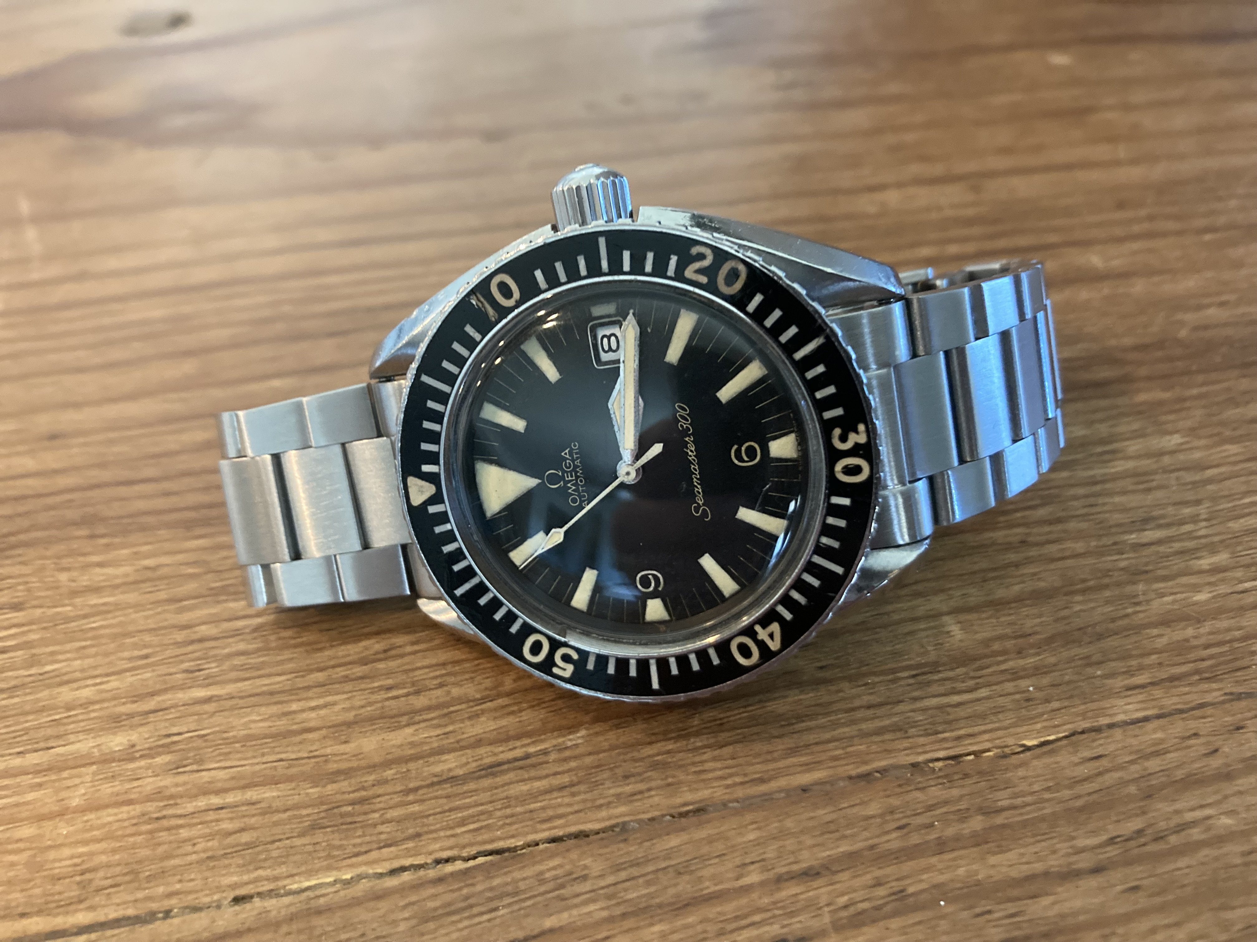

I have always worn my seamaster big triangle on a tropic but thought a bracelet would be nice change of pace. Bought the forstner pre 2018 flat link and as you can tell from the pics the end links are woefully short to the case. Fostner could not confirm that the end links should fit this particular year but there were other issues and ultimately Forstner was exceedingly helpful and made me whole. I really do like the flat link look and have considered the 1039? but it is rather expensive and hard to find.
Has anyone else used a Forstner bracelet for this model/case and did the endlinks fit?
Are there other bracelet options I might consider beyond Forstner, Uncle Seiko and the 1039? I do like the more modern bracelets since they feel a bit more robust and are generally better for adjustment. I really love the original elements of this watch but I am not as tied to keeping the bracelet period correct. Thanks all.
