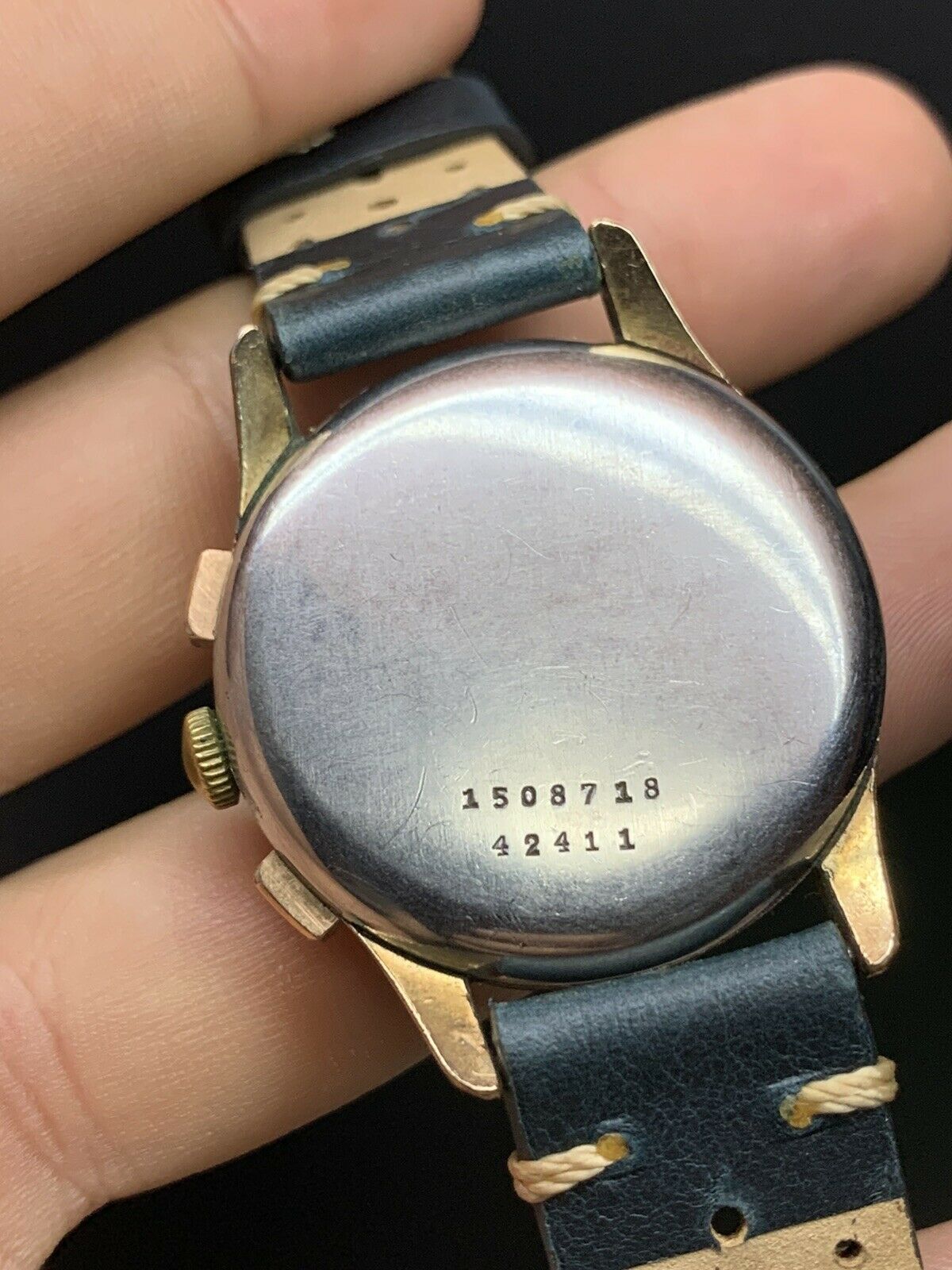

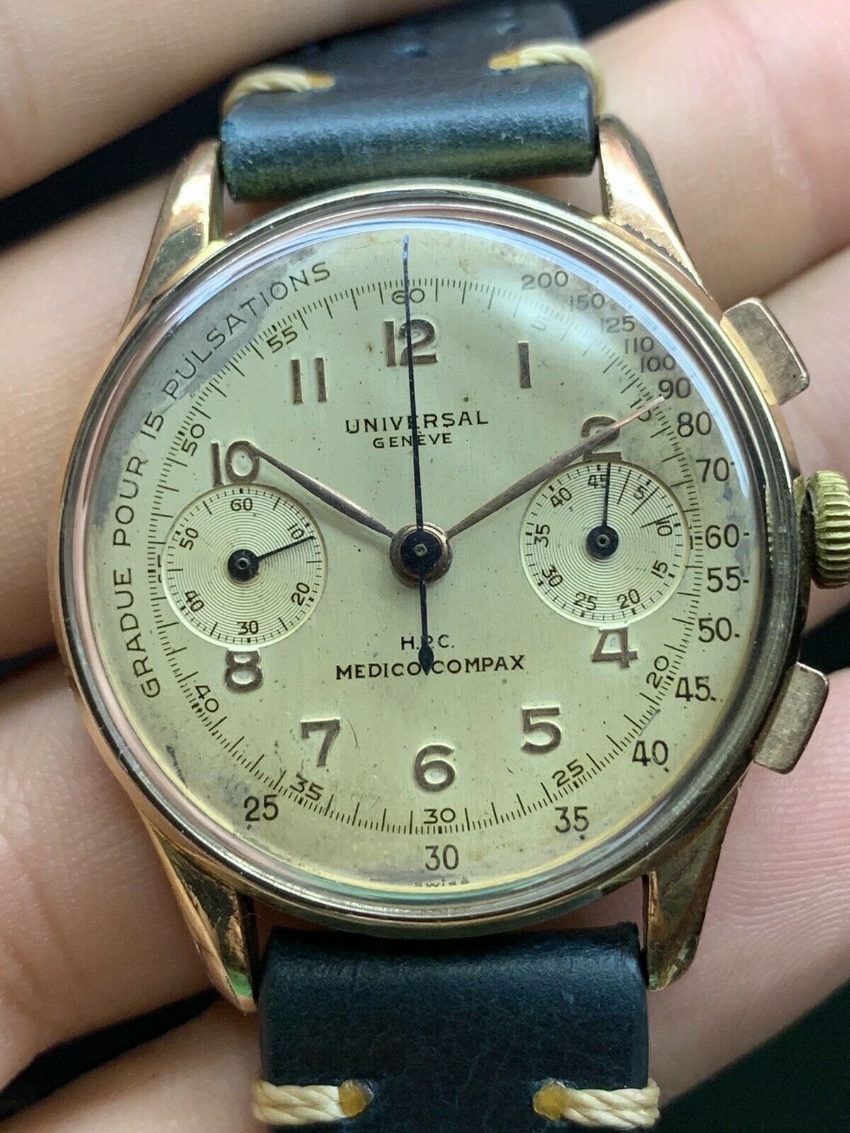

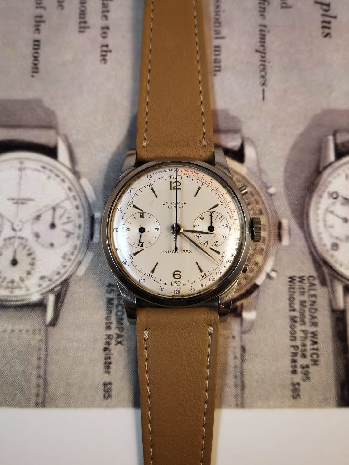

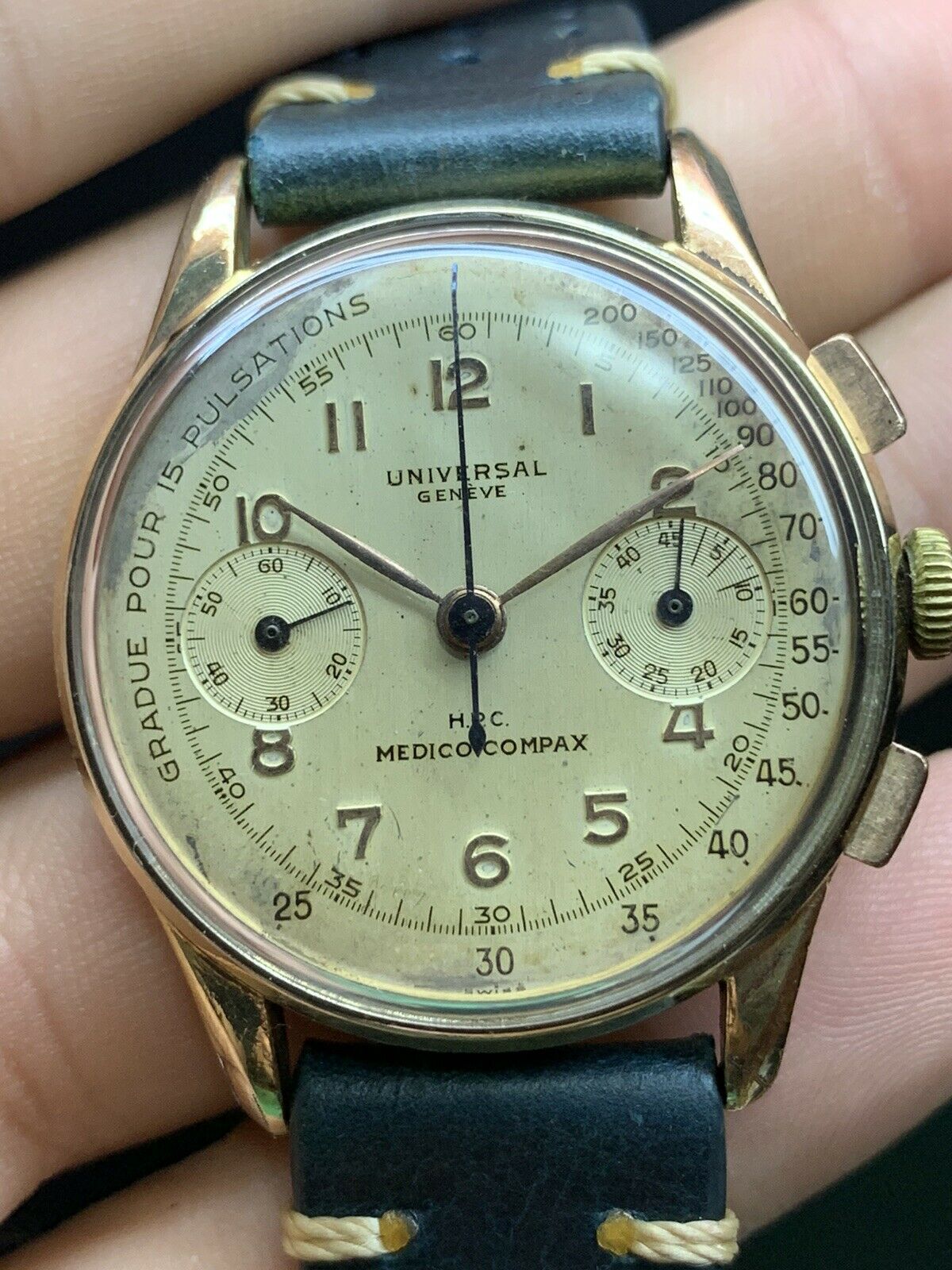

Should be a compur in this case I'm thinkin..
Not necessarily... Compur and Uni existed in parallel for a bit.
886
2,414
Yea definitely- but to me that case feels like a compur, compurs had those old timey cases moreso than uni's. Uni's were their modern spin at the time. But you could be right- hard to tell.
13,999
54,300
Plus the Tri Compax font rules don’t apply. So closed 6’s were a thing.
13,999
54,300
Imho that dial is from 50s.
Very possible.

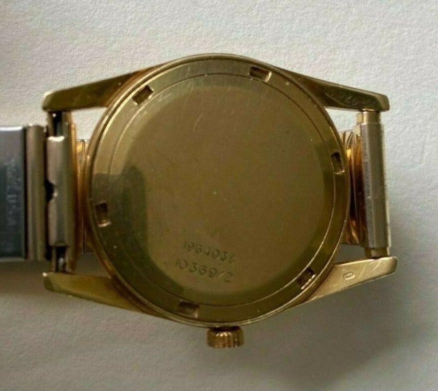

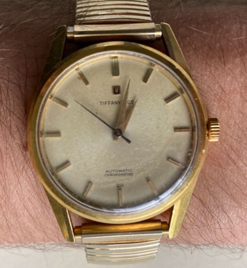

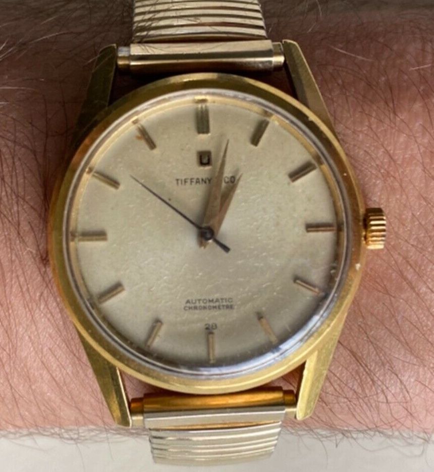

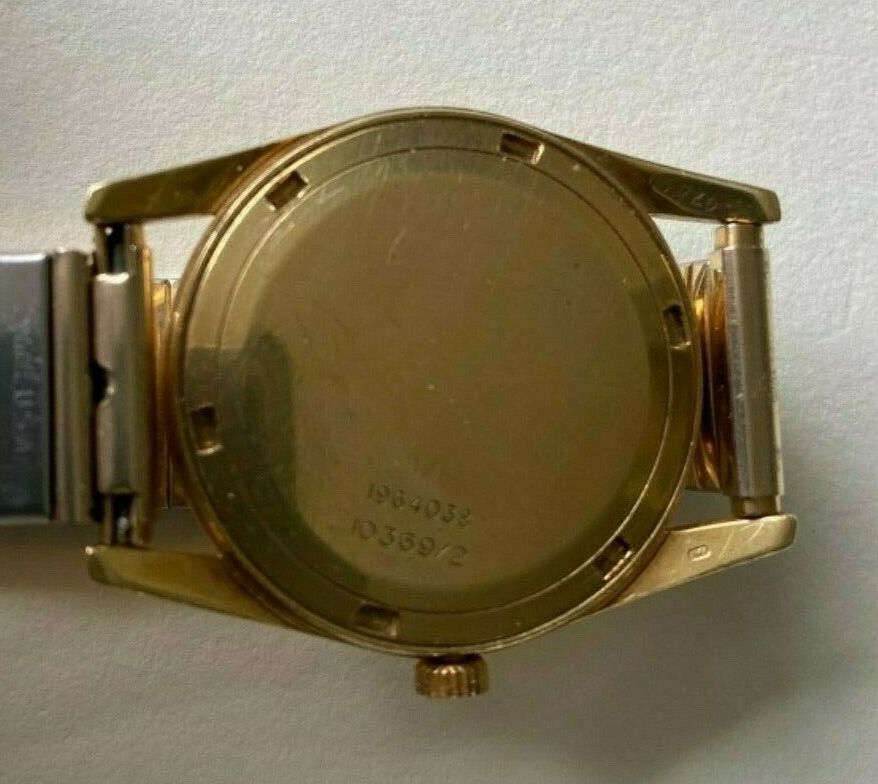

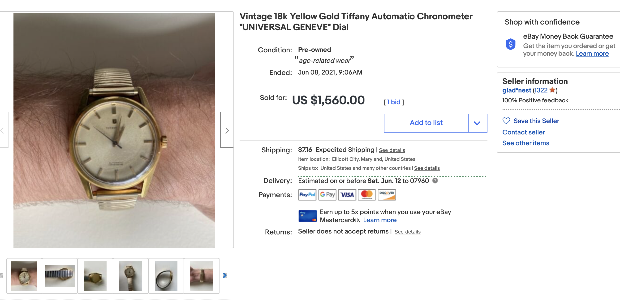

Yet another Tiffany Jet appears on eBay with a messed up dial - they seem to have made quite a few of these.
10369/2
1964038
1,211
3,071
10369/2
1964038
I wasn't sure if it was messed up or just a crystal with crazing and a bad photo.
I'll let you know.
6,901
10,764
What does the 28(?) mean?
1,211
3,071
Jewels I'm guessing.
Looking forward to opening it up and seeing if it has the chronometre serialised movement I'm hoping for.
It seems to have a number stamped on the back of one of the lugs, which is interesting.
13,676
19,044
Exactly what I would expect with Tiffany.
It should. That’s how they tracked the chronometer grade movements.
gatorcpa
1,211
3,071
I'll let you know.
The good news is that it does have a numbered chronometre 28 jewel Cal 215-9 movement with all the markings we would expect. It has an HON import code rather than TZY as we saw on a steel cased Tiffany Jet recently (that one had a reduced jewel Cal 215-97).
The bad news is that @CafeRacer was correct; it is the dial that is a bit tired rather than the crystal. I'm also now on the hunt for a gold Jet crown if you happen to have one.
I've not seen the watch in person yet but if it is good enough, I'll take some pictures and add it to the book.
