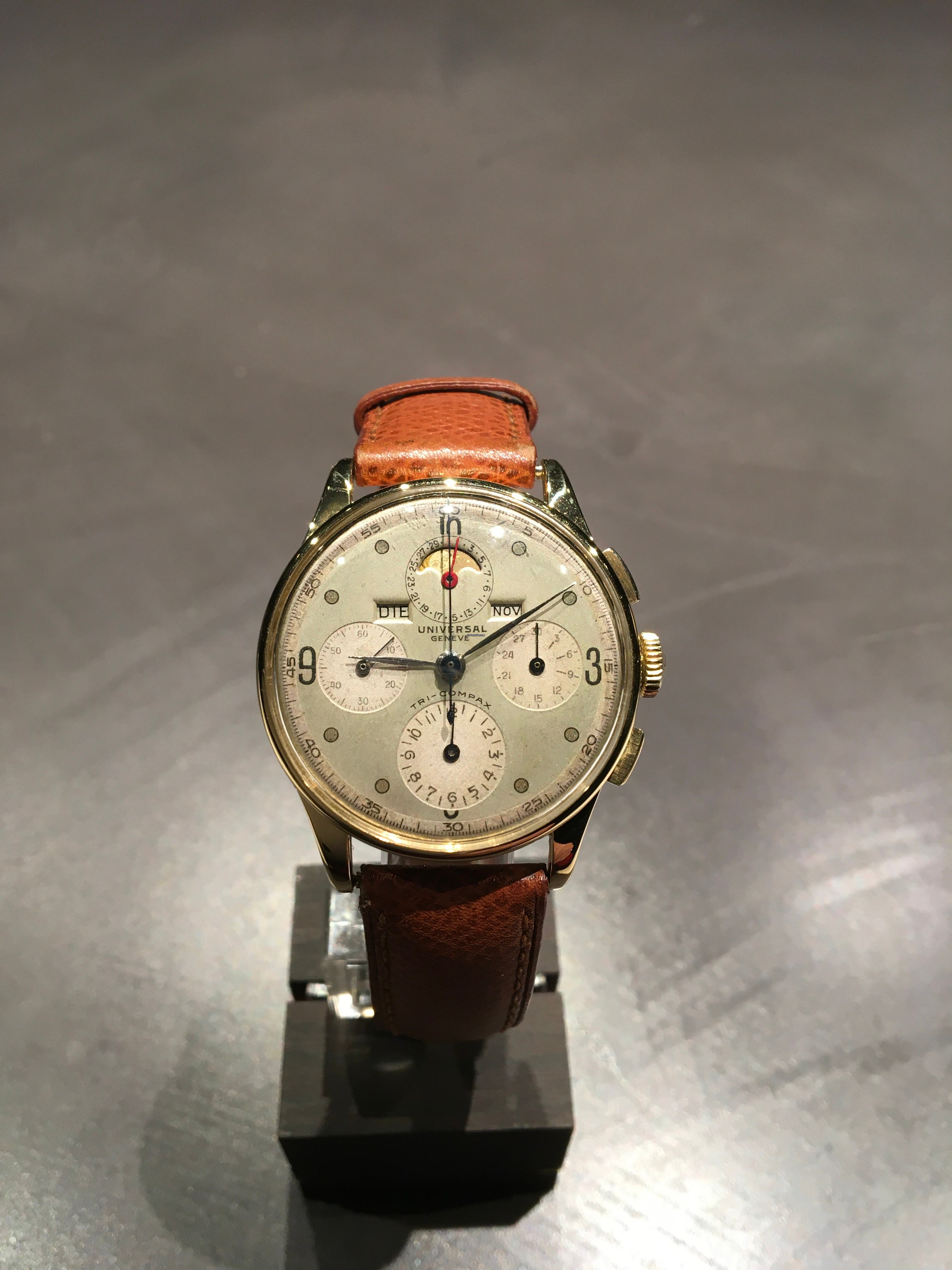

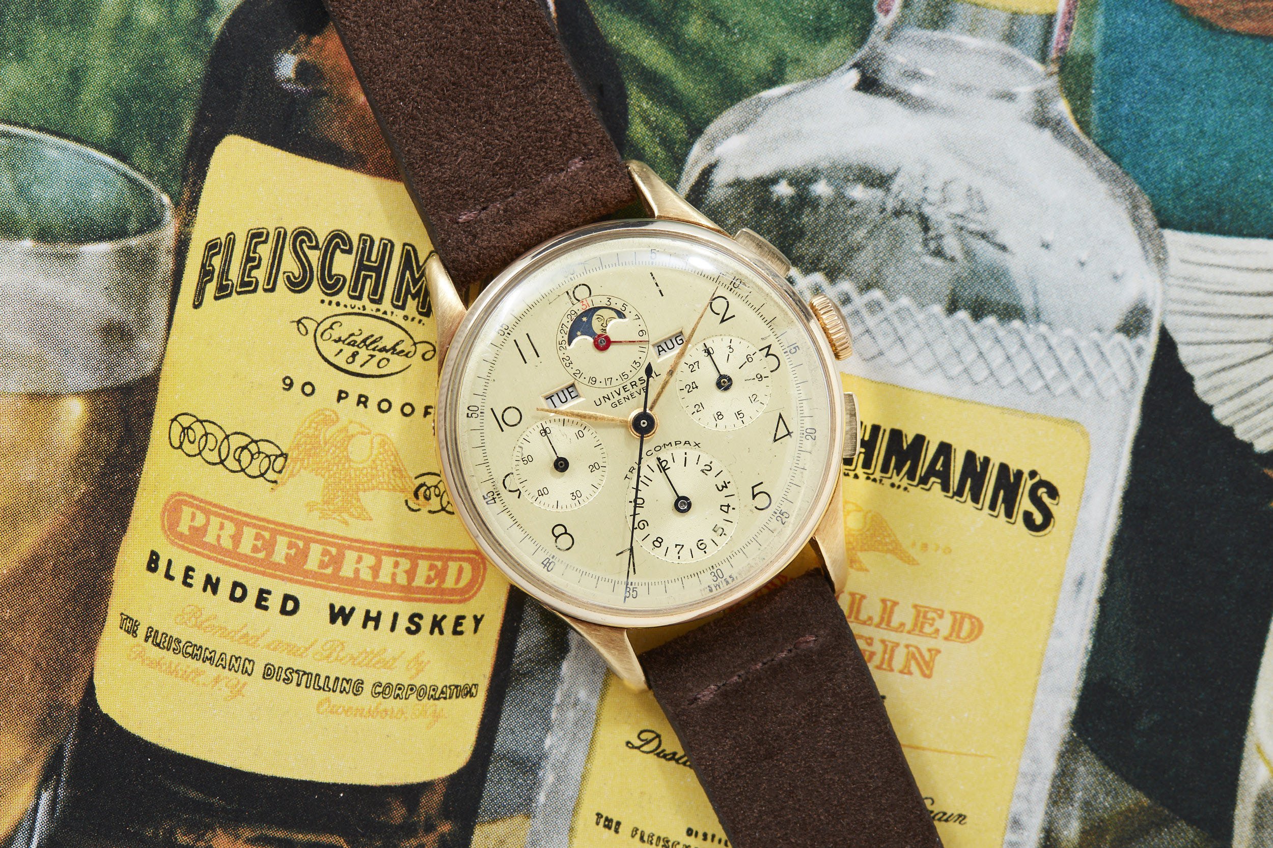

I do have some doubts though.
May I ask what doubts exactly?
I am asking because I don't understand what the serial should tell us?
Very close serial: 203 (vs 211 of the watch pictured)
1,127
3,952
serial number is not related to dial configurations, in UG watches from 40s.
1,180
4,233
That's why I am asking.

Well I'm not fully convinced about that. I think dials were very easily swapped at UG but in the end they will have come from the factory with the same dial if the have the same reference and were in the same batch...

I don’t doubt that this is a UG dial. I do wonder what “factory overhaul” means in the provenance.
