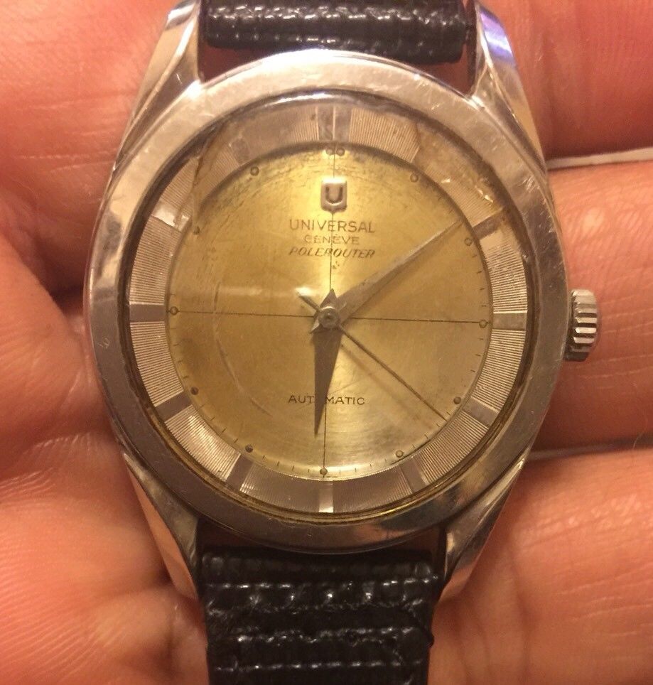

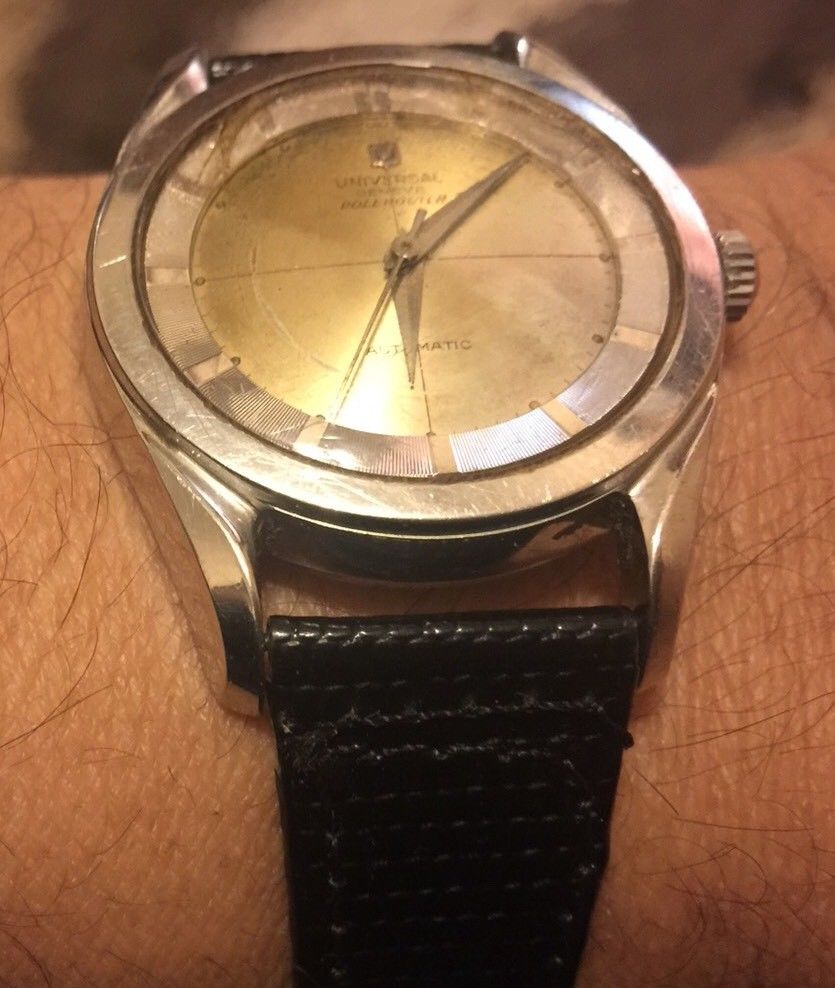

Polerouter Super dial in a Polerouter Sub case with hands from an older Polerouter as far as I can tell from a quick glance.
I see that it sold for 1600 Euros. There would have been some value in the parts I suppose but that seems like a lot.
Yes, it’s a lot of money for a parts watch.

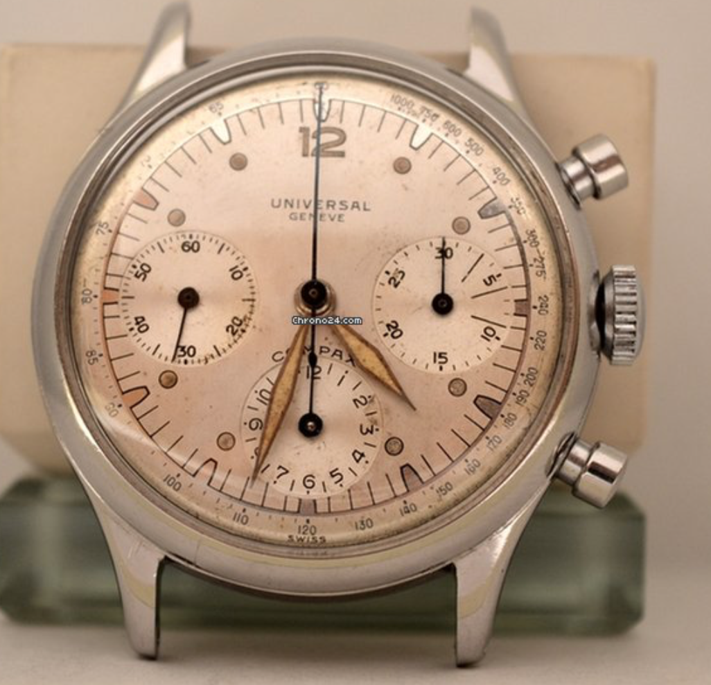

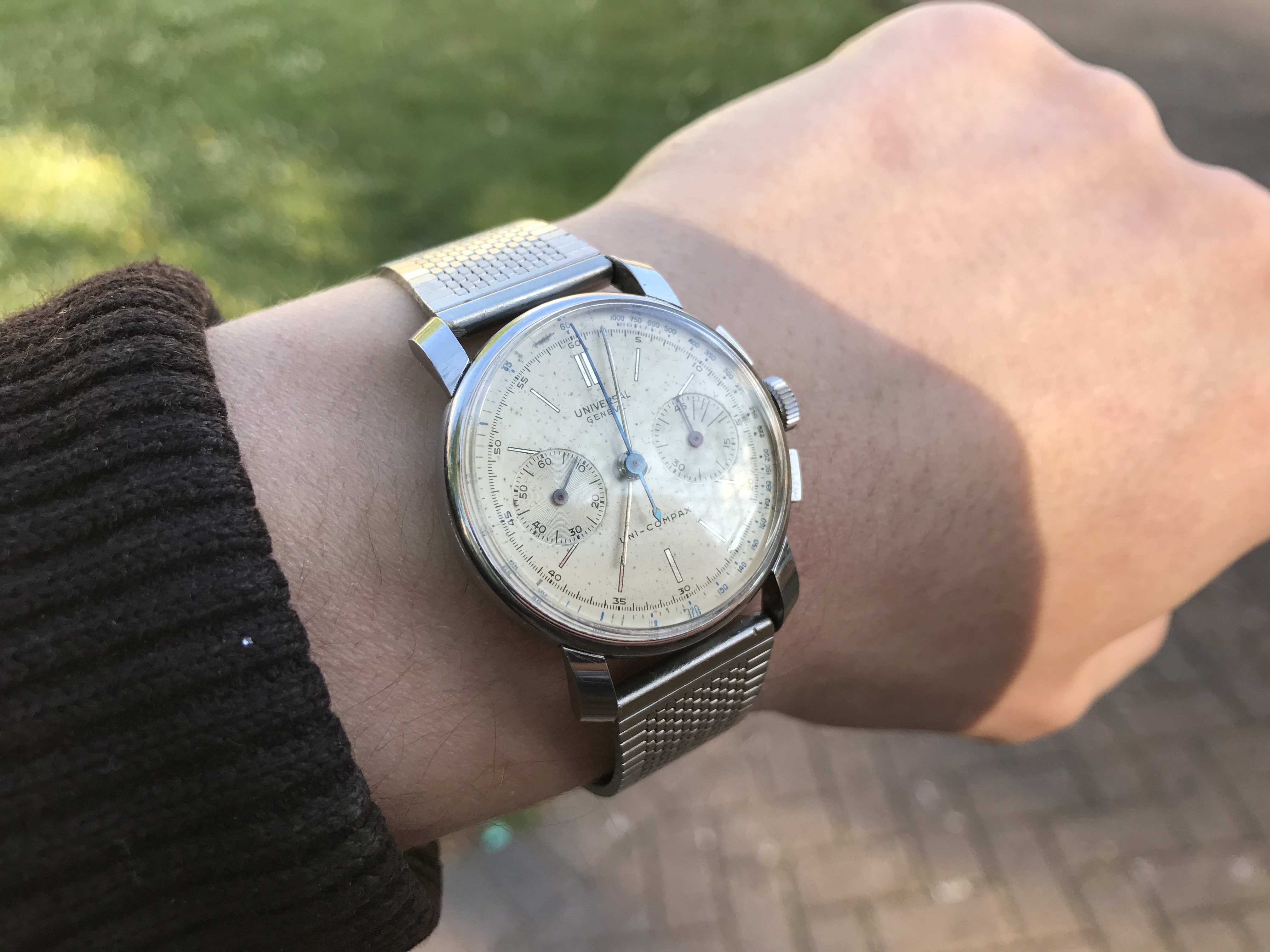

Tri-Compax on eBay:
Dead Link/rover/0/0/0?mpre=https://www.ebay.com/ulk/itm/263516822954
My concerns:
Is that dial correct for a 22502? (50s dial 40s case or no...?)
Crown may be replacement?
Thoughts?

Dial looks period correct, but the outer tachy has been rubbed off almost completely

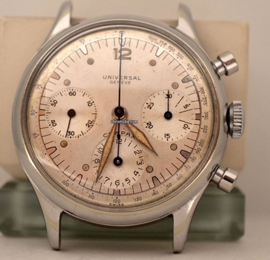

Tri-Compax on eBay:
My concerns:
Thoughts?
Lo
Agree, hands are correct, and crown is replacement

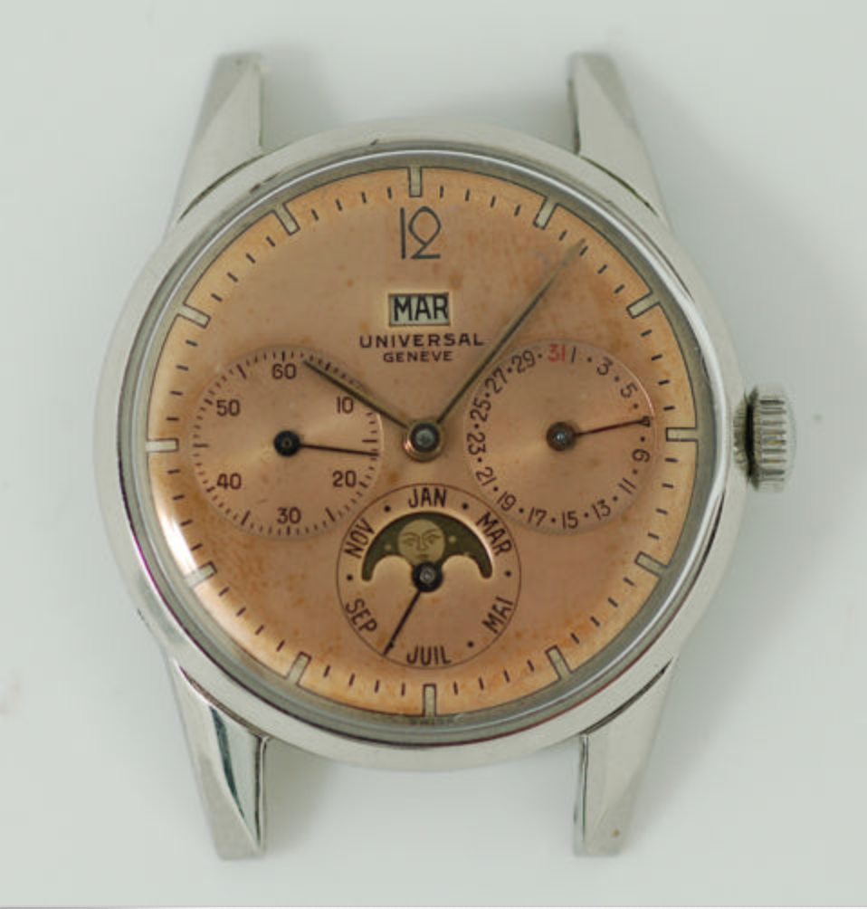

It was all original, nice and now sold 😉
I noticed it had sold and was just about to ask about its originality.
I'd not seen hour markers of this type on a calendar and there aren't any examples in Sala. Presumably you've seen others?
994
3,206
I never saw others with those hour markers, but the originals fonts, great patina and no red flags make me think that is a 100% original dial.
Furthermore this kind of "mirror effect" marker are usually seen on others watches
3,721
8,557
I have this dial in a time only, I’ve also seen it on other chronos, but not common. The other similar variation I was going to mention was already posted by Florent, also not common.
No issues IMO.
3,721
8,557
Wow those applied deco numbers are awesome. Too bad !
