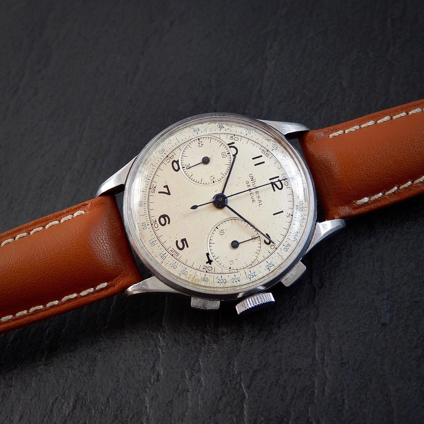

Interesting - could you share why you think this is a redial? To my (admittedly novice) eye, the dial does look aged somewhat although perhaps not having the patina one would expect of a 70 year old watch
14,012
54,360
Let’s begin with the fact that this is not a Compax.
2,671
24,911
Subdials not centered, lack of telephony counter in the minute subdial (only found in rail track subdial pattern but not this). Also the case looks pretty early (judging from UG logo) doesn’t fit the dial style.
Telephony dial just to demonstrate.

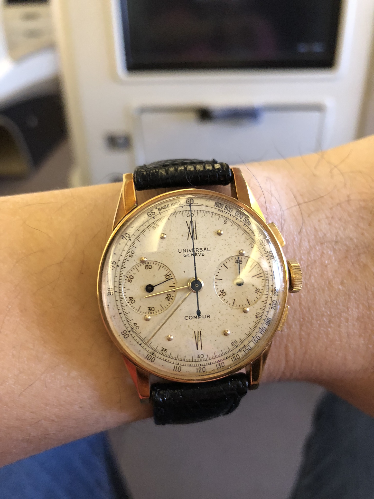

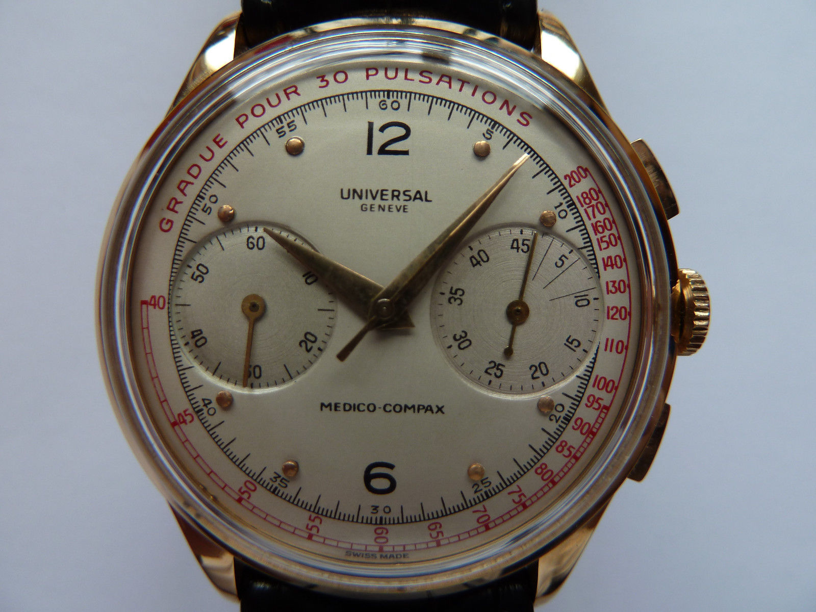

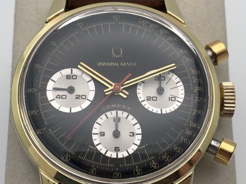

Hey guys,
I have the opportunity to look at this one in person. The dial seems almost too good to be true and after an extensive web search I couldn't find a single picture of a medico-compax with this dial. Also, I haven't purchased a UG before so any thoughts from the expert crowd would be highly appreciated!
p.s. I hope this wasn't posted before, otherwise apologies in advance!
994
3,206
Redial (fonts are different), wrong subdial hands, wrong chrono hand, probably wrong hour and minute hand, not even sure about the case (no serial or model number)📖
Avoid at all cost ::facepalm1::

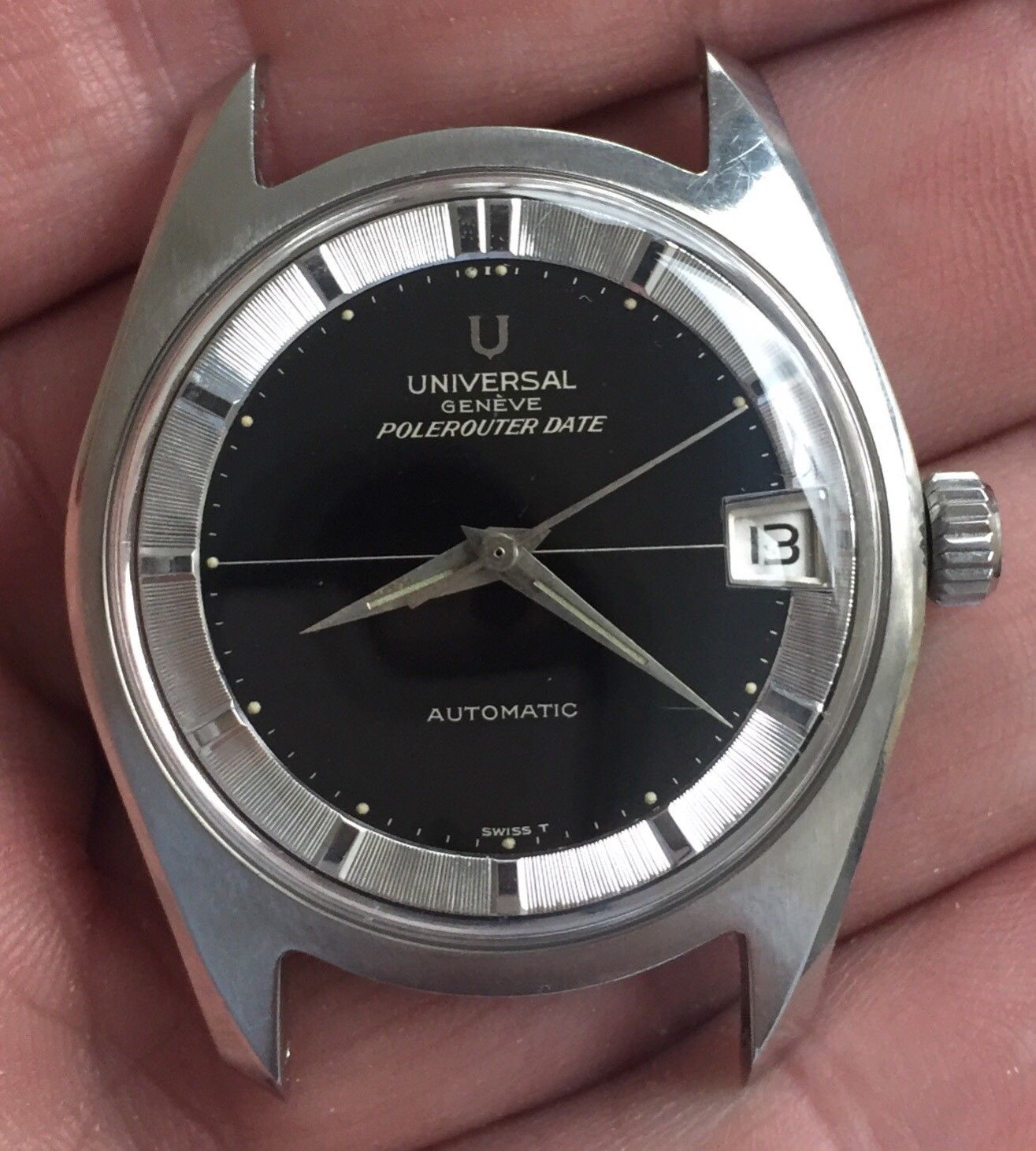

https://www.ebay.com/itm/202228130341
Ummm... Already at $1500 in about 12 hours. Is this were Polerouters are these days? Everything check out on this one?
The shape of the case and the movement put it in the mid 60's and not 50's. Looks all correct to me, maybe a little polished but a nice example overall. But for +1500 i would expect the caseback logo clearly visible...
Black stainless steel polerouter seems to gain value very fast those days ... when they are in honest condition.
This one looks pretty good indeed ...
1,727
5,962
Though the seller has listed as NOS, the only thing NOS is the Limited Edition Sticker on the caseback. Crystal is replaced, minor dings, and crown is not correct. Those lugs though...
That's an interesting observation. I've noticed that the caseback logo is often faint or missing for this reference (869113/01 with black dial, 869113/02 with white dial). I guess it was just slightly less prominent to start with.
