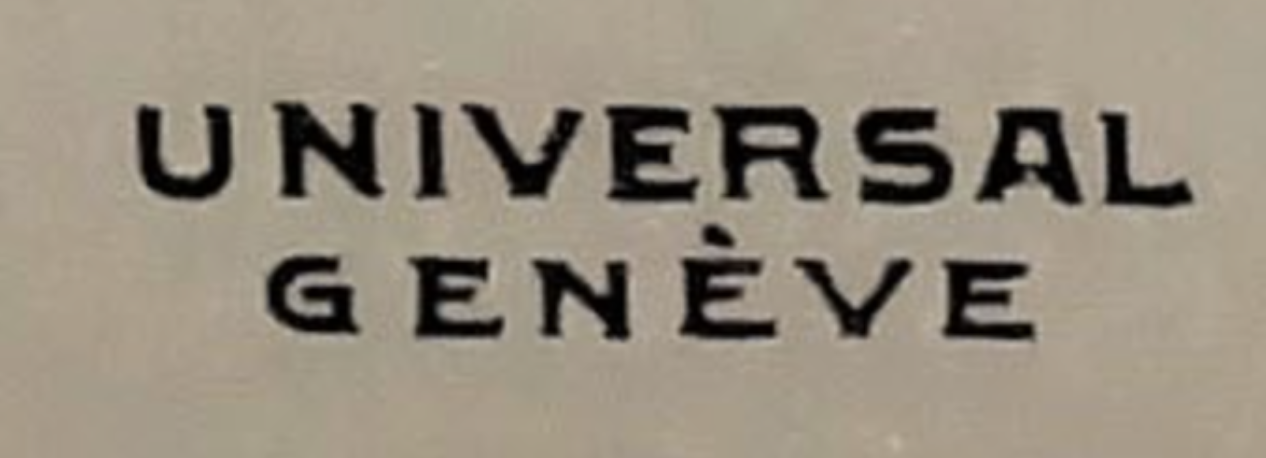

I don't agree that the texture of the dial is too new. When viewed closely there are bubbles under the surface and brown foxing to the surface where corrosion under the surface is breaking through.
I'm less concerned by the imprecision of the numerals. They have been drawn in an almost comical style and the fact that some numbers brush the line, some are proud of the line and the 12 was clearly intended to cross the line, does not look out of place to me.
I also wonder whether we should be judging all UG watches produced during the same period with the same exacting standards. This dial could have been produced in very small numbers or even be a one-off. It could have been produced by a different team or by an entirely different process to say a tri-compax dial from the same period.
Finally, when the conclusion edges towards a dial being being a very well done redial produced using the correct cliche then I am minded to think that in all probability that it is original.
First of all, let's not just assume original cliches where used because that simply cannot be said with certainty.
Secondly, my concern is with a multitude of small factors that, cumulatively, create the doubt.
Imprecision to a minor degree is tolerable. Some calendar dials are absurd and often multiple imperfections are seen but these imperfections are quite consistent and none of the sort I am concerned with in this watch.
Furthermore the Art Deco style of these UG numerals is just not Universal.
66
111
Look at the space between G and E (of 1st pic) and the overall quality of lettering is good but not great.
Ofc I understand if my doubt is hard to digest for many of you, but hey sometimes it's more of a gut feeling than a binary one.
Anyway, sorry buyer if we are tearing into to your piece, off all respect and props to you, but thats the purpose of this forum!

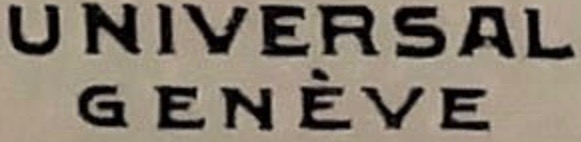

Surprised no one has mentioned the subdial inking and lack of emphasis of 12, 3, 6, 9 markers...

Were is Lou"s opinion ? Dre ?
Since I am being asked, I think Lucas' argument is persuasive. I tend towards redial.

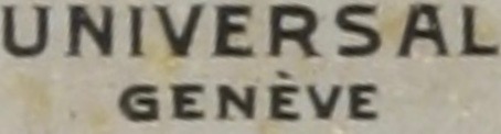

I do not like the Universal Geneve font 👎
Florent do you mean you don't like the UG font on the example posted by 10H10, or the font on the piece generally being discussed? The comparison you posted is the one under discussion, plus an example from Lucas, but you responded/quoted to the one from 10H10, so it get's confusing....

Concerning the polemical dial, everything said, I think that it is genuine because, after all, who would refinish with such a good quality a relatively low value watch (for the moment) ? Businesswise, it doesn't make sense, the concentric circles of the seconds subdial and the edge of it are perfect and it is almost impossible imho to refinish it like that...
But actually I don't know the price the watch was sold... I would have paid 600€ max...😕

My dial fonts ?
I assume @Florent is referring to this:
to which, I couldn't agree more. The UG print is too sloppy for me. I think that's one thing UG rarely messed up, regardless of era.

Back to the watch then, what is the general consensus?
1,204
3,062
I'm not sure there is a consensus. I think if we were to take a vote, then I suspect that those that believe it is probably a redial might just have it. However I don't think there is anyone on either side of the argument who is absolutely certain.
You made some interesting observations regarding minor printing anomalies however there are plenty of others who think that such minor imperfections are to be expected on a watch that is almost 80 years old and also question why anyone would have set out to create such a complicated redial on a watch that would not have been worth a significant amount until more recent times.
I'm not sure the debate can go much further without additional evidence.
