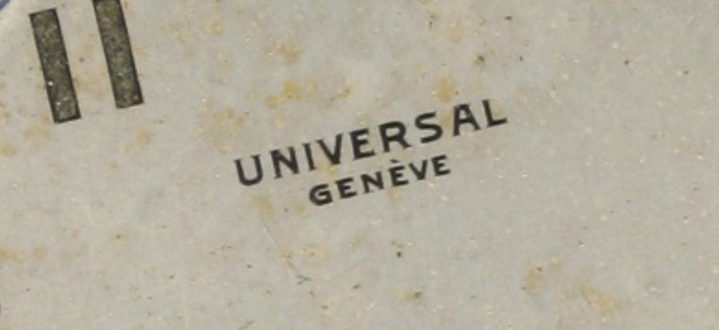

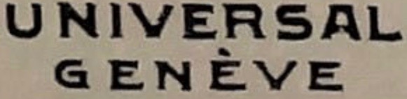

Though 650xx and not 84xx but check how much nicer this UG sig is:

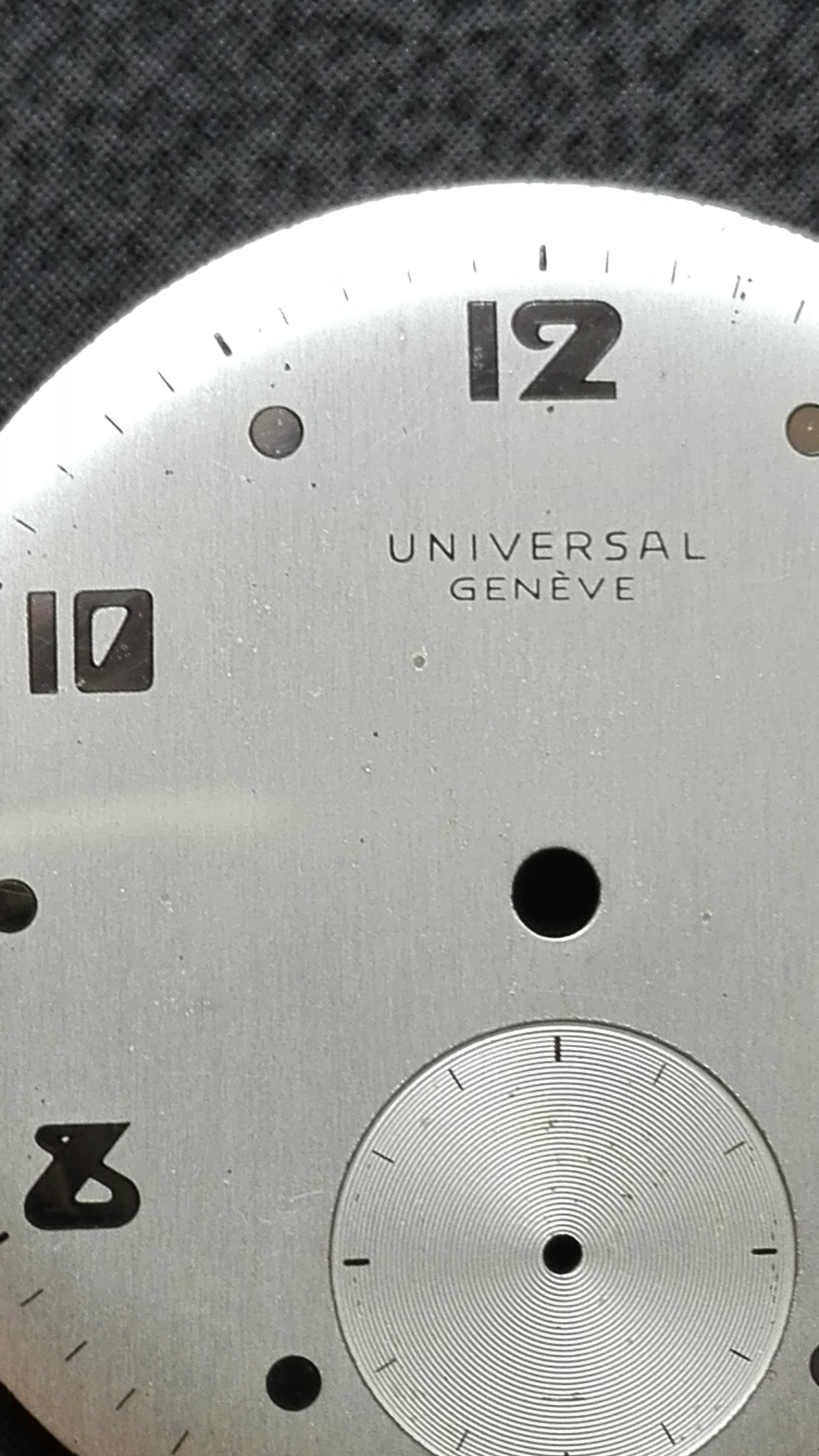

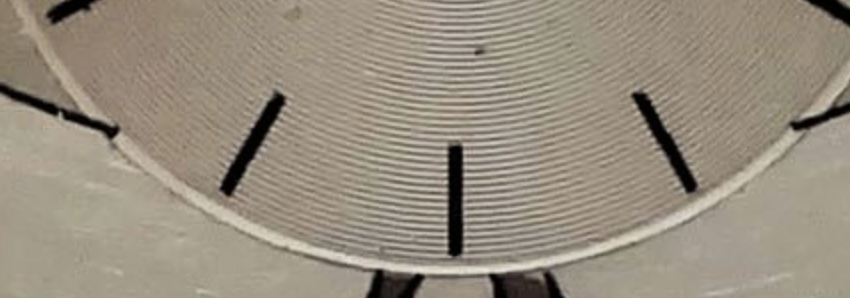

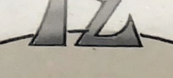

DETAILS IM REFERING TOO. look at the sub-dial, how the line crosses it a little bit. These print errors were not made in original dials!! this is my view.
The UG I posted in this thread also has a bit of the numeral not filled in (which for this dial process is certainly not unexpected). With regards to that and the slight overlapping of the inking - dial errors and inconsistencies were common all the up until the 50's and 60's for UG.

Alright, glad you understood now. let's not diverge topic. Two tone dials are very complicated to understand, form my experience. even some insanely beautiful look Patek dials are a clear 'redial' or restored to the expert eye, whereas most people are too stunned by its apparent beauty to see the issues.
Interested in seeing what you guys think. I have empirically laid out my concerns, so I urge you to do the same!

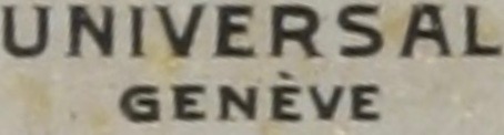

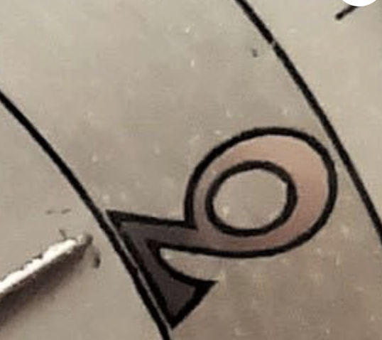

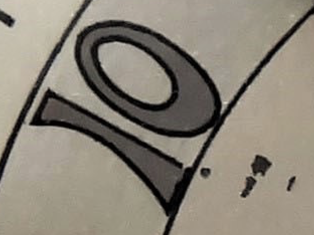

look at the number 10 how it touches the inner two tone circle, compare that to say the 4 which hovers better in the circle. there are a few spaces in the numerals that are not fully coloured in. I mean, IMHO redial. Should have stated that. Just seen a lot of these, almost to nice to be true. Plus not a really UG Art Deco, and the UG signature is too new. also the texture of the dial itself is too new. IMHO. always. Let me know what you guys think, am curious too!
I don't agree that the texture of the dial is too new. When viewed closely there are bubbles under the surface and brown foxing to the surface where corrosion under the surface is breaking through.
I'm less concerned by the imprecision of the numerals. They have been drawn in an almost comical style and the fact that some numbers brush the line, some are proud of the line and the 12 was clearly intended to cross the line, does not look out of place to me.
I also wonder whether we should be judging all UG watches produced during the same period with the same exacting standards. This dial could have been produced in very small numbers or even be a one-off. It could have been produced by a different team or by an entirely different process to say a tri-compax dial from the same period.
Finally, when the conclusion edges towards a dial being being a very well done redial produced using the correct cliche then I am minded to think that in all probability that it is original.

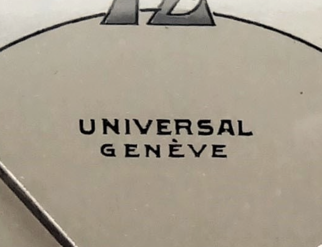

Here is an art deco dial mirror effects, made at the time, they were indeed very professionally done and precise...
