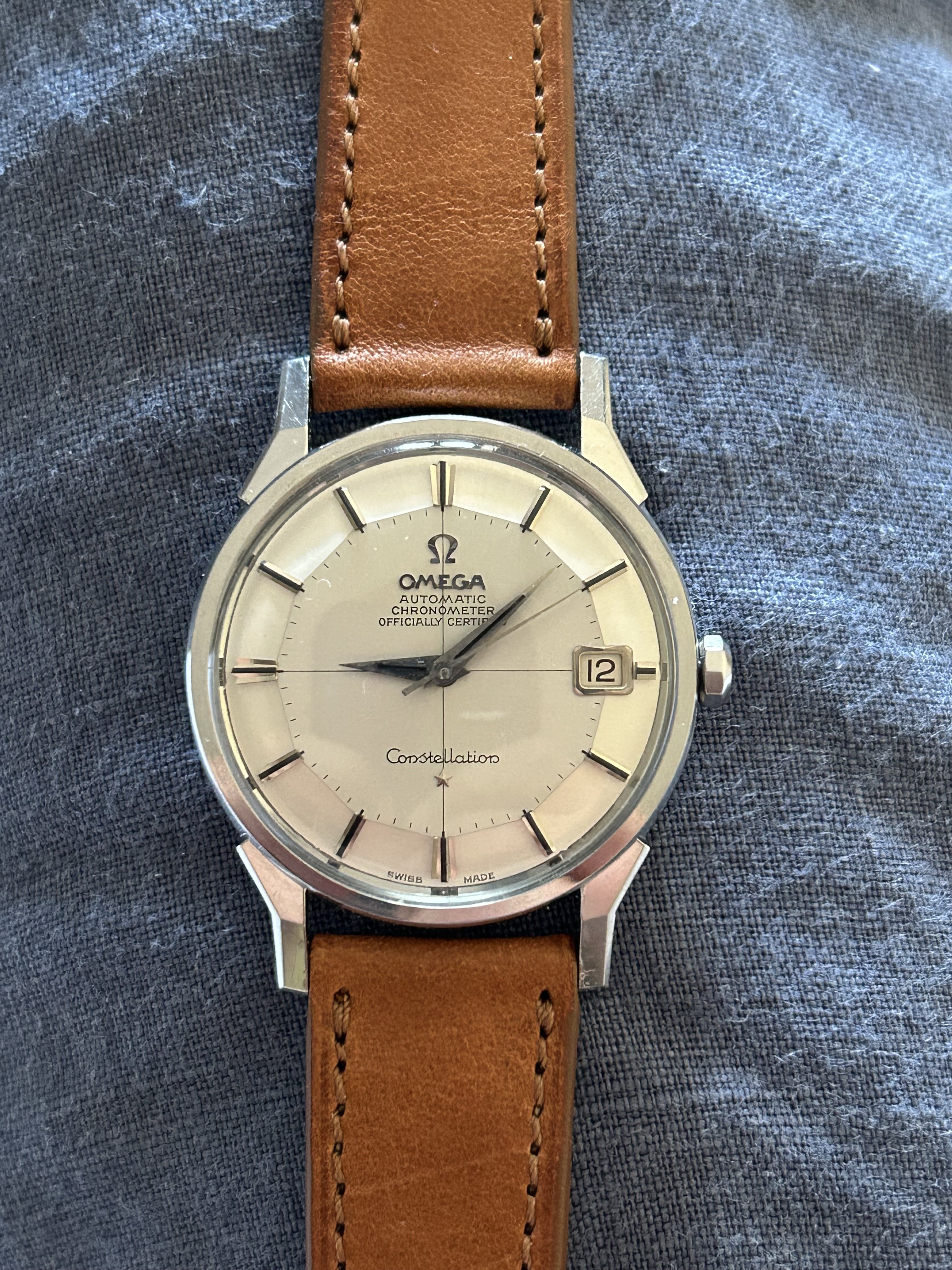

Hi there,

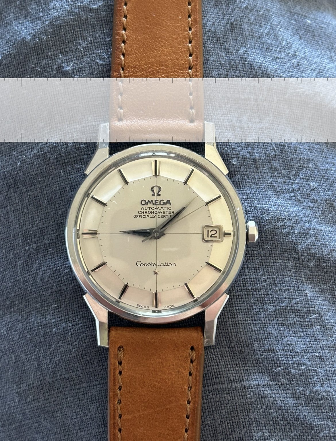

I’ve just become the proud owner of a 168.005 with a crosshair in wonderful condition, and which I’ve been looking for for a while. Naturally upon receiving it I’ve spent time wearing it, and couldn’t help but notice a small difference in the polishing on the top left and right lugs; the bevel on the left one seems to be closer to the body of the watch than the right. It’s not massive, but it’s an interesting difference, and it lends the question; how were these cases made originally? This is an SGR case. I had thought they were cast, but perhaps they had some hand finishing? Have you seen this before? Two photos, one with superimposed ruler and one without.
And before you say ‘I’ll happily take it off you’ - I’m very happy with it 😉 and part of the joy of these watches is the age and stories they tell.

Ha - it’s very slight. I only noticed it when I received it for the first time and was looking it over. The bevel on the left lug (on the top of the lug) seems to have been polished closer to the body of the watch than the one on the right. The pic with the ruler shows a small gap (it’s not symmetrical).
That’s why I was asking about how the cases were made - interesting to know if they were cast or were essentially handmade/hand finished.

My understanding is that they were cast, stamped, machined, and then hand-finished. These cases were originally black polished, and standards then were a bit more loose when it came to uniformity. Also, for what it's worth, this is a really complex case design, given all the facets.

They were hand finished originally and also often touched up various times over their lifespan.
I wouldn’t let it bother me.

Absolutely. At the end of the day the most important thing is that the facets are clearly defined; and that, they certainly are.
