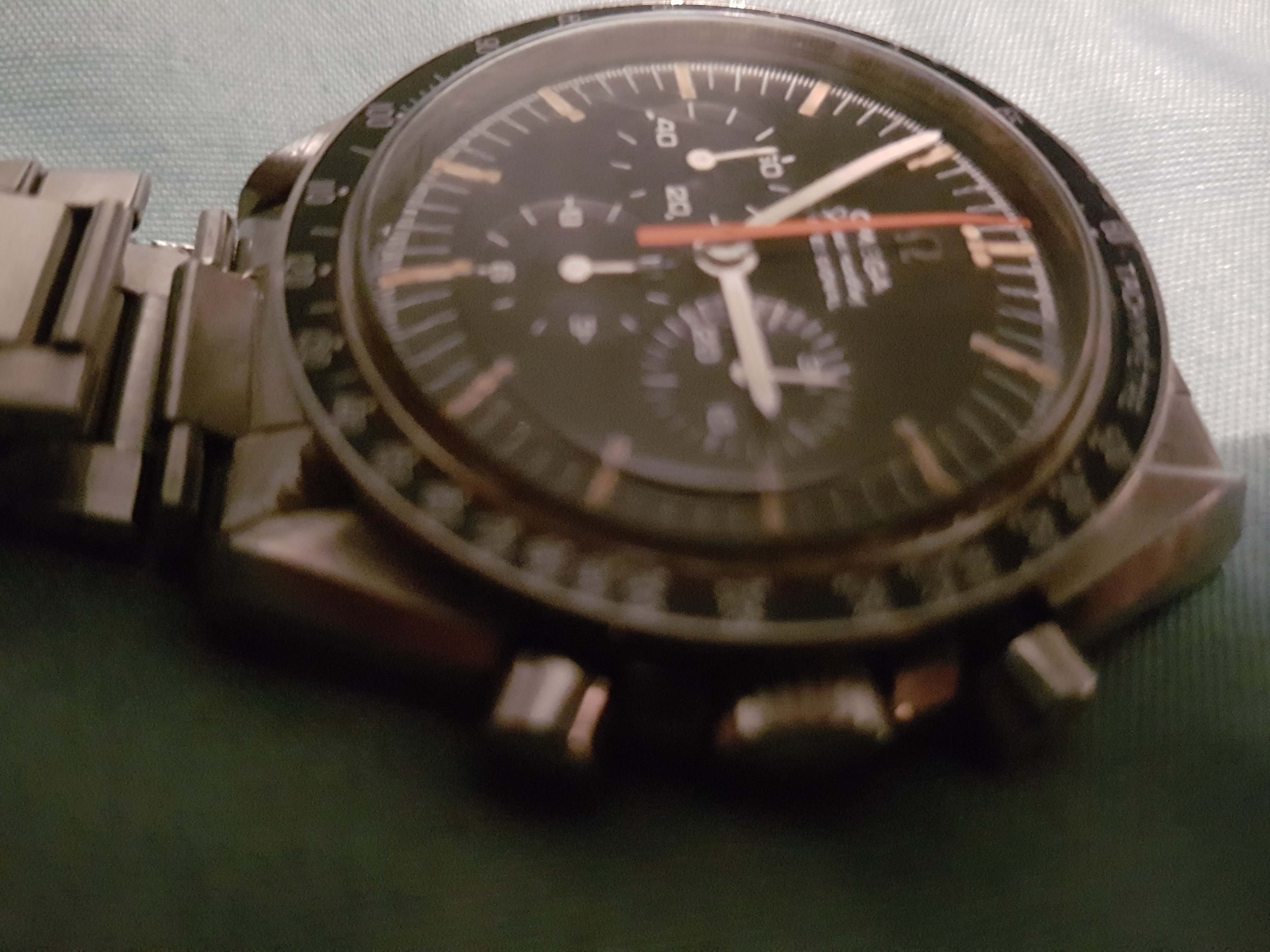

Well sadly, this is not a correct chronograph hand, too short.
How far should it reach? Disregard just saw your pic

This a better shot. I can't take picture straight on as I cast a shadow, is this any better.
,,,, and in the high res photos of Ultramen the base of the second hand is just about level with the base of the 1 and 2 digits in the 6 o'clock subdial, this one is well past. On the dimensions in the WBO article that makes it more like a Chronostop hand.
(Whado I know, my Omegas are two that get least love here. More informed eyes can ignore me.....)
The base (bottom part) of the hands also looks to be too wide.

As eugeneandresson has suggested, I think the best thing to do is get case and movement numbers and order an extract from the archives.
Was just about to write this. But it is possible that the tip broke off the hand while this watch was being worked on at some point.
Note that all hands have been restored (repainted white) and there is some "wetness" visible around the 12 Tritium markers.
Drag mark on running seconds subdial.
