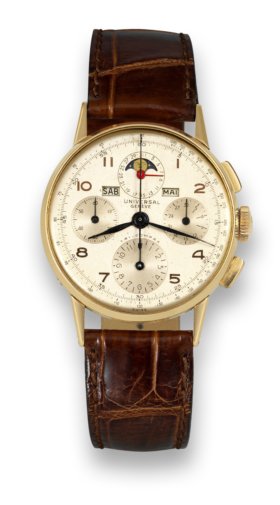

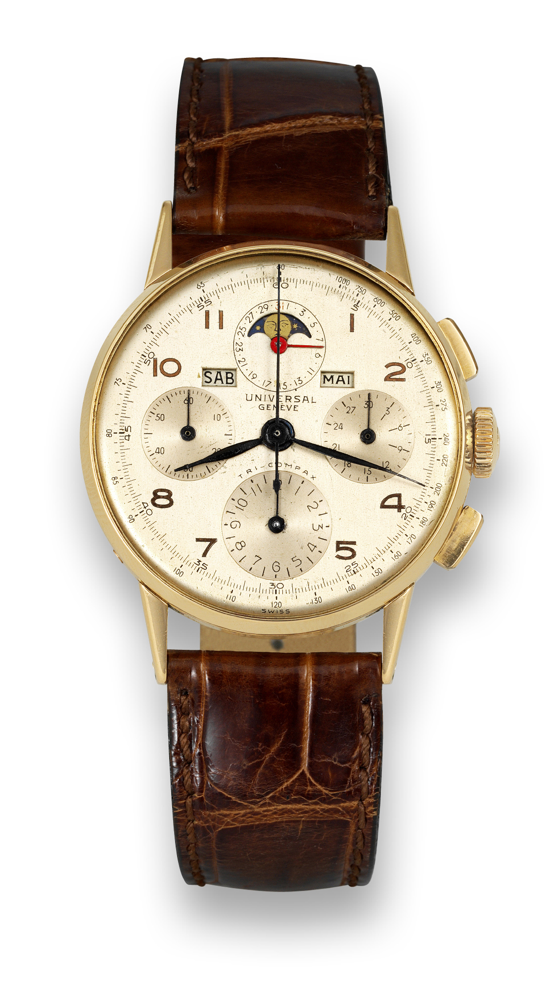

In italia, i 6 ad i 9 dritti o con la punta sono conosciuti da molto tempo su quadranti Tri-compax originali e non sono considerati tipici dei quadranti ristampati.
In Italy, 6 and 9 with the tip ("straight 6s and 9s") are known for a long time on the original Tri-compax dials and are not considered typical of reprinted dials.
Grazie A.

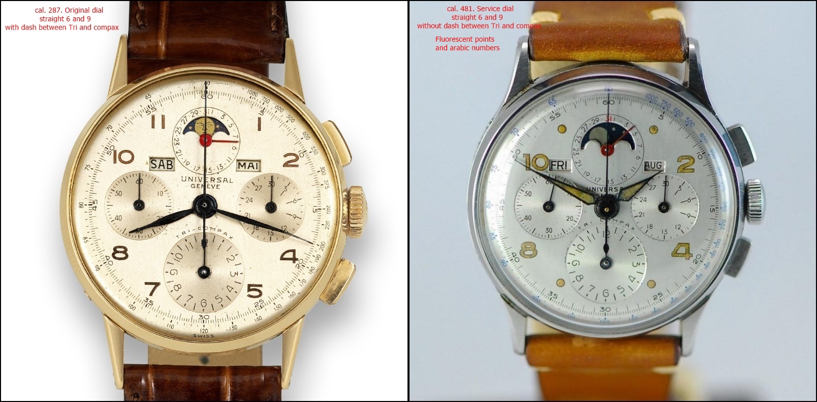

...the service dials didn't have the dash between "tri" and "compax" and straight 6s and 9s.
But straight 6s and 9s per se are not indication of a reprinted or service dial but indeed existed totally original dials from the 40s with straight 6s and 9s and the dash between Tri and Compax, right?).

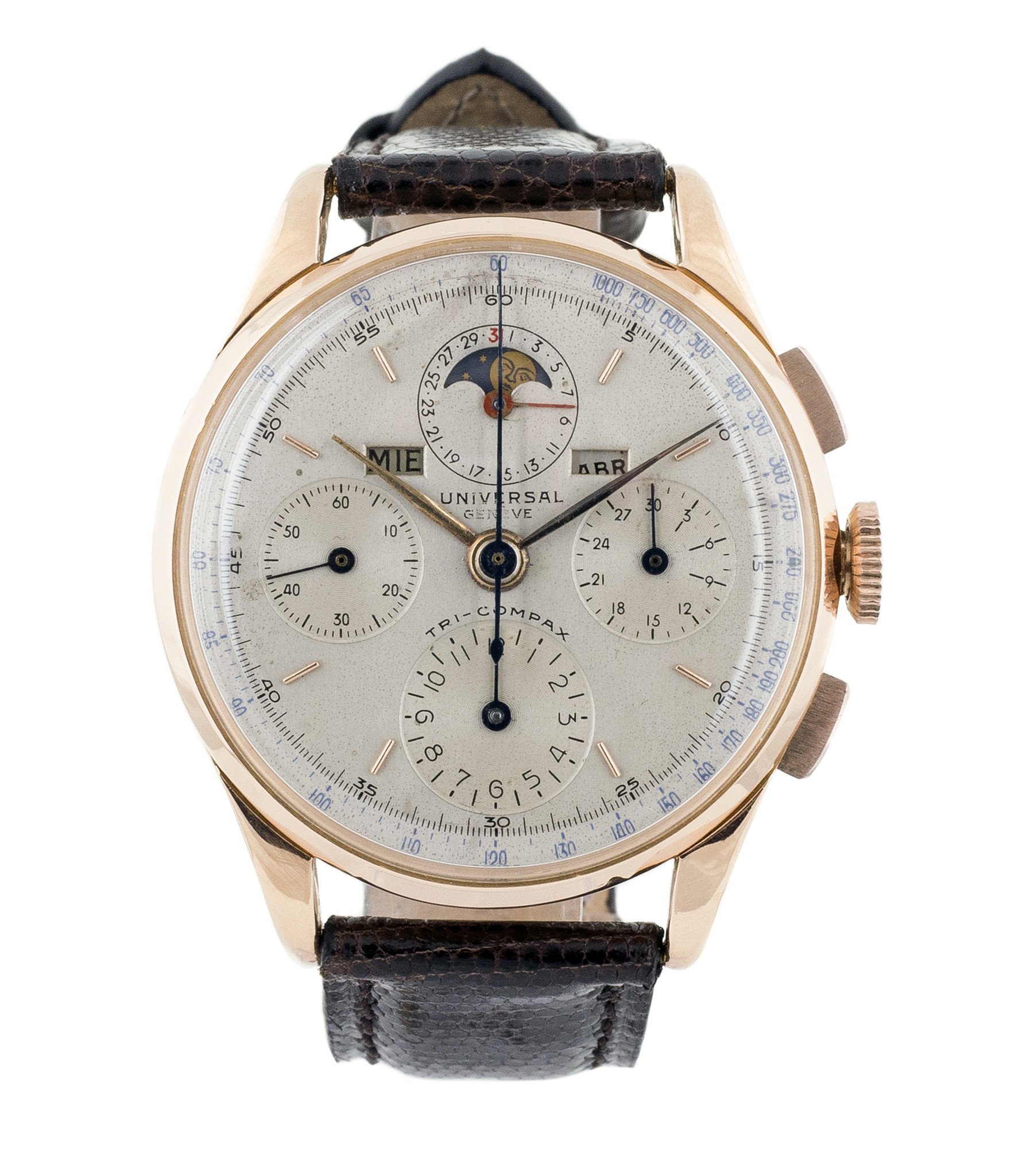

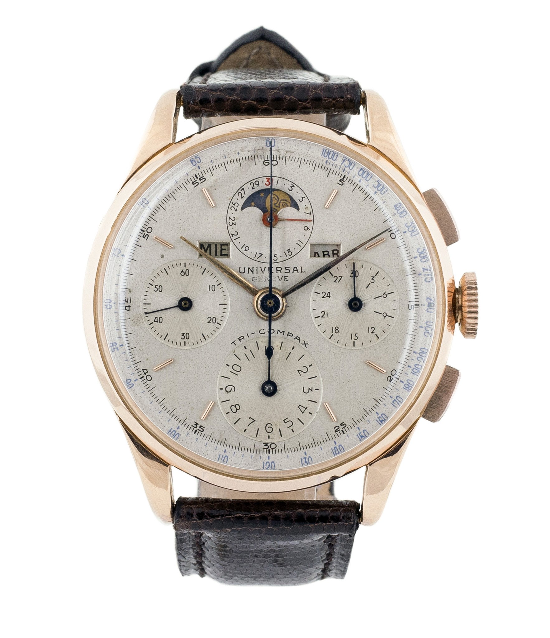

I have shown some examples of original dials with 6 and 9 pointed ( "straight 6s and 9s)

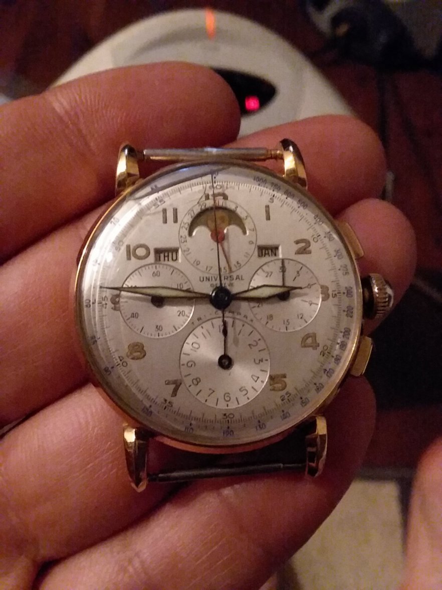

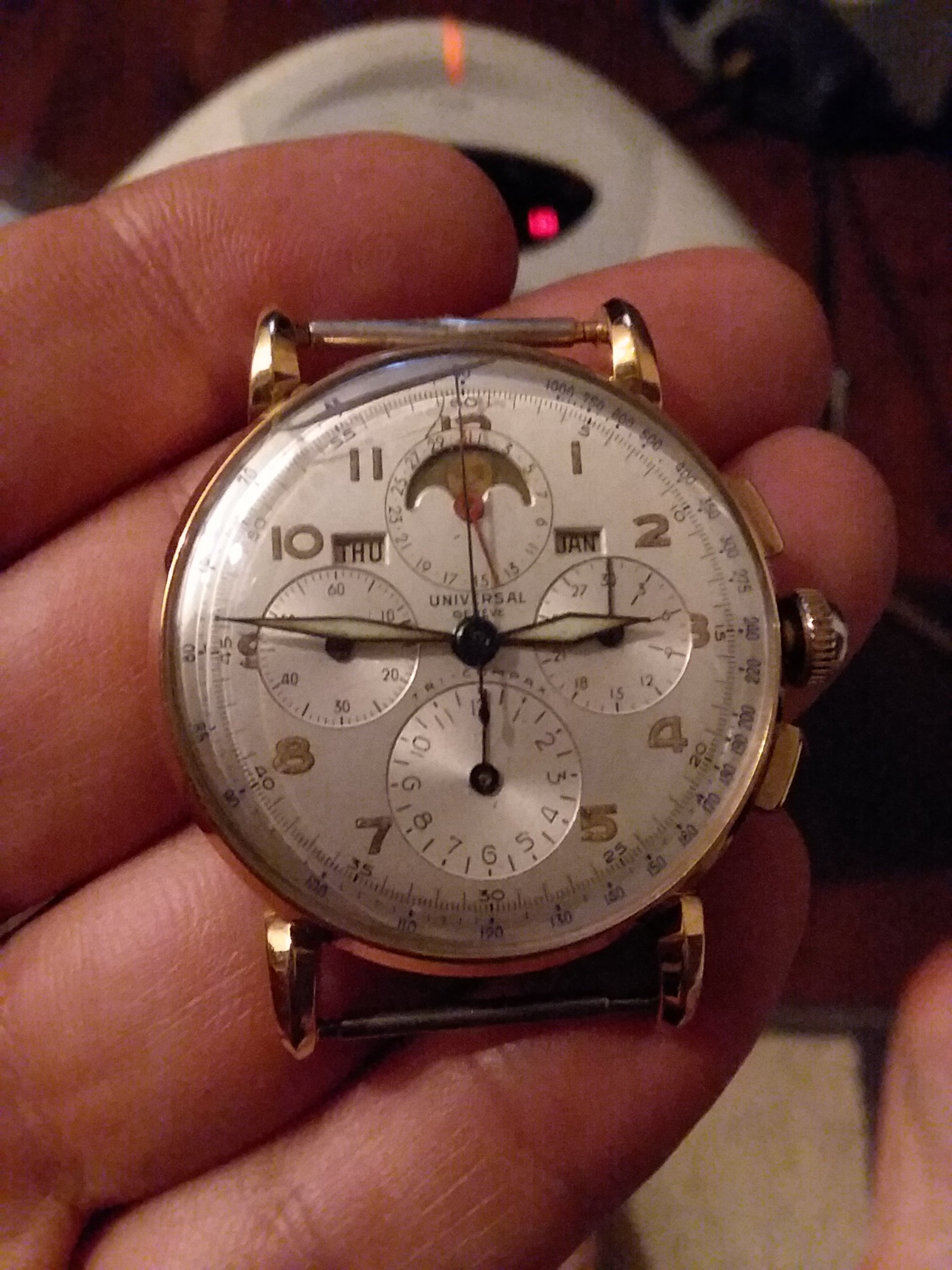

No, it is original dial .

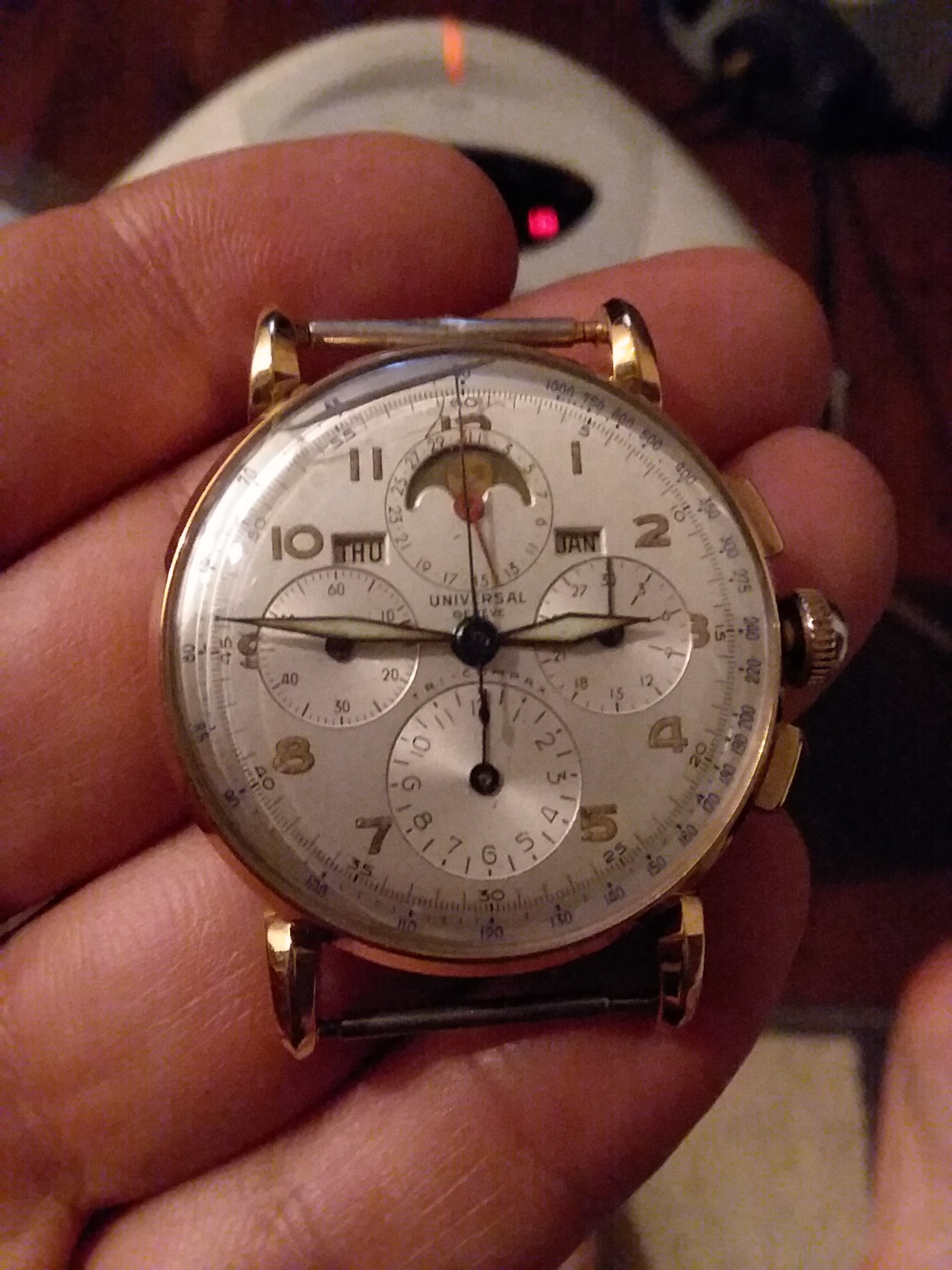

Here is mine , straight 6 and 9 with dash between Tri and compax . If this dial is original then it is my best condition Tri-compax I own !
994
3,206
Lovely watch and dial 😀 you should have the crown changed 😉
121
371
In my opinion, it is an original dial.😀
