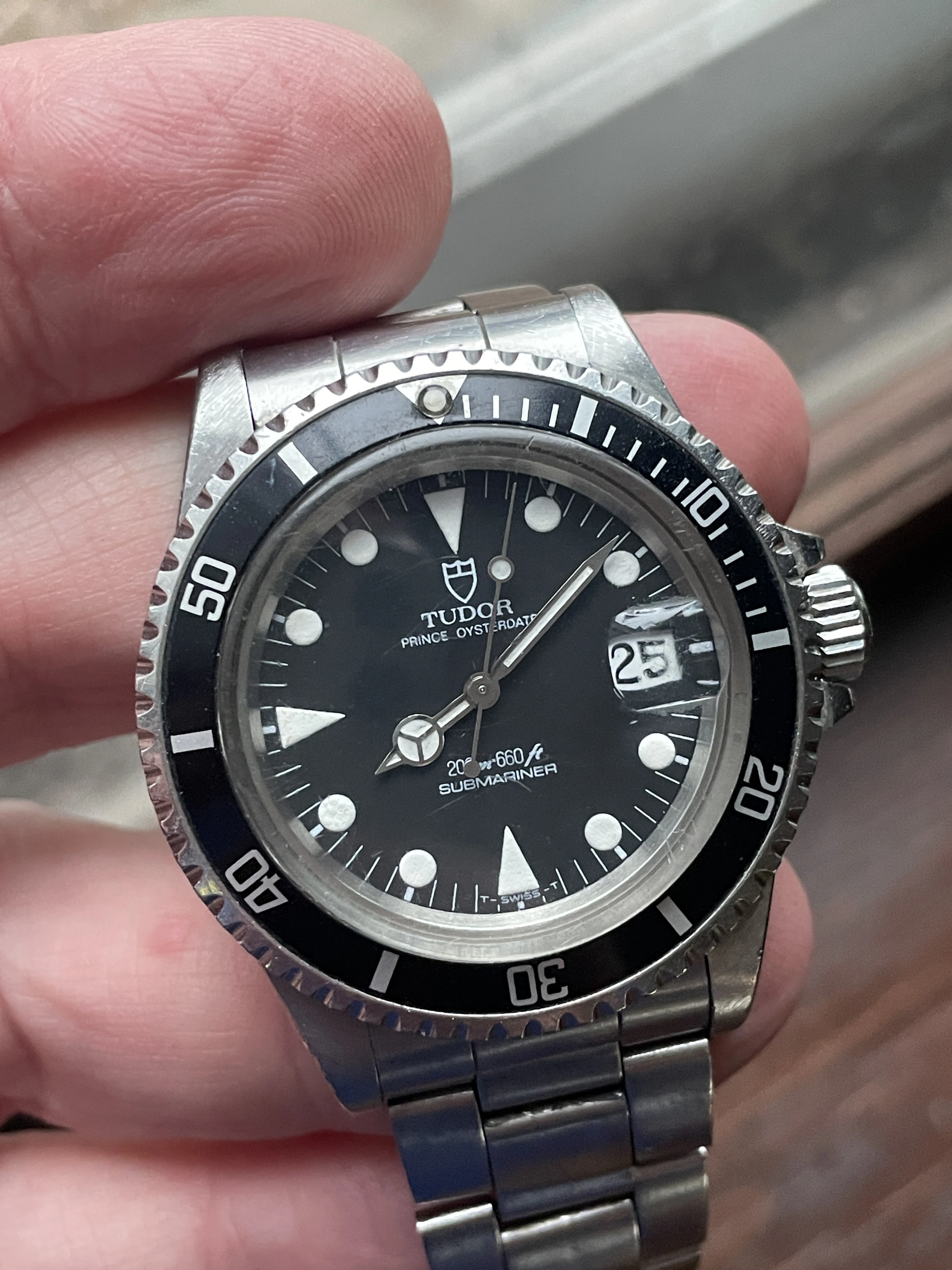

This is the kinda stuff that keeps a watch “fan” with limited knowledge away from vintage. And these Tudors catch my eye as well. There is just too much tomfoolery going on with these things. It’s tough out there, high water everywhere.
6,904
10,769
Inscriptions are also off IMHO
5
3

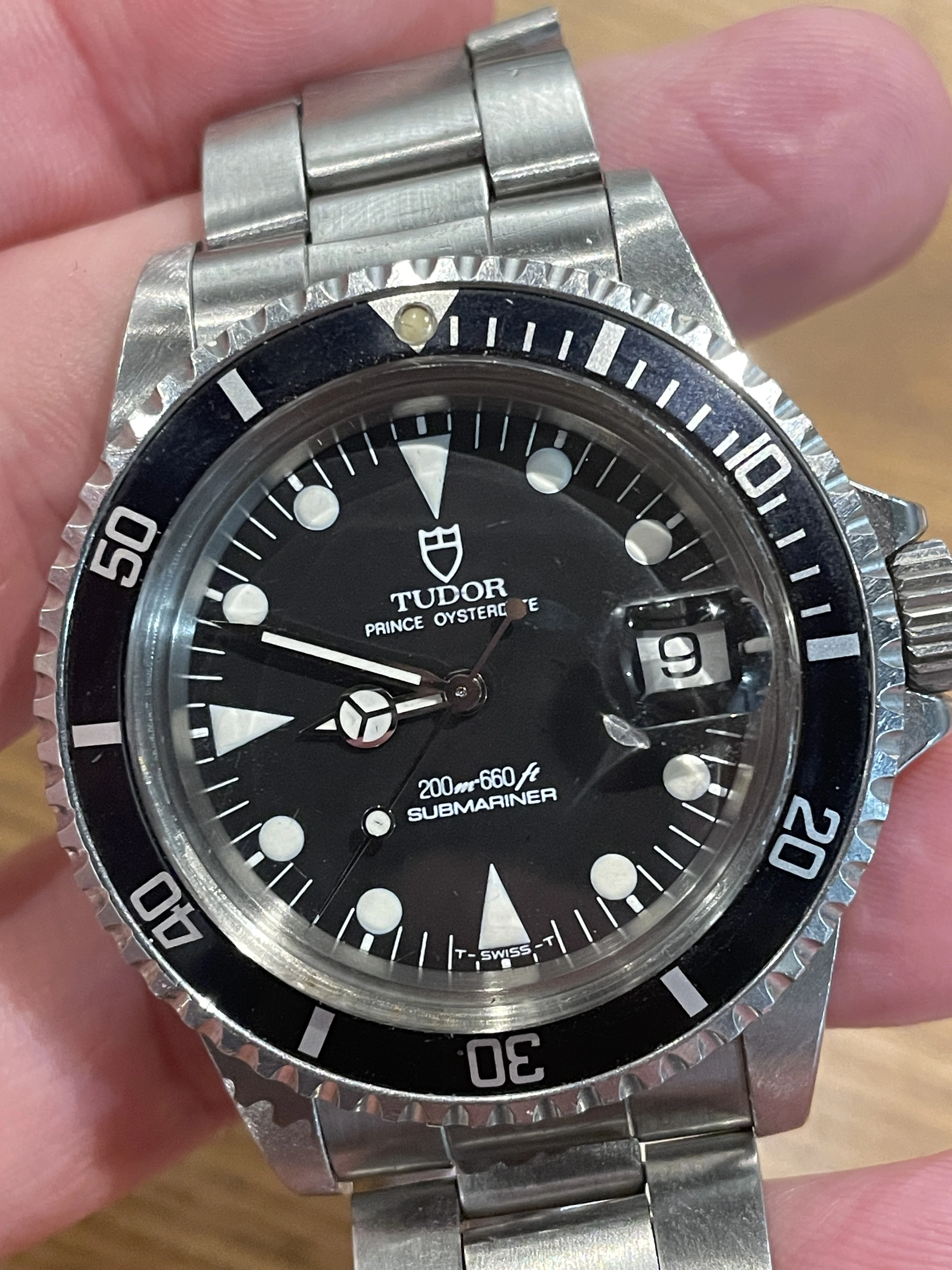

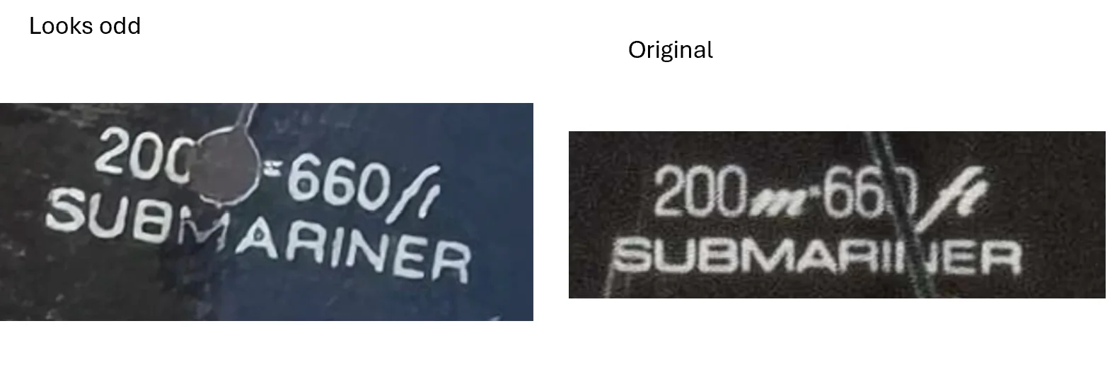

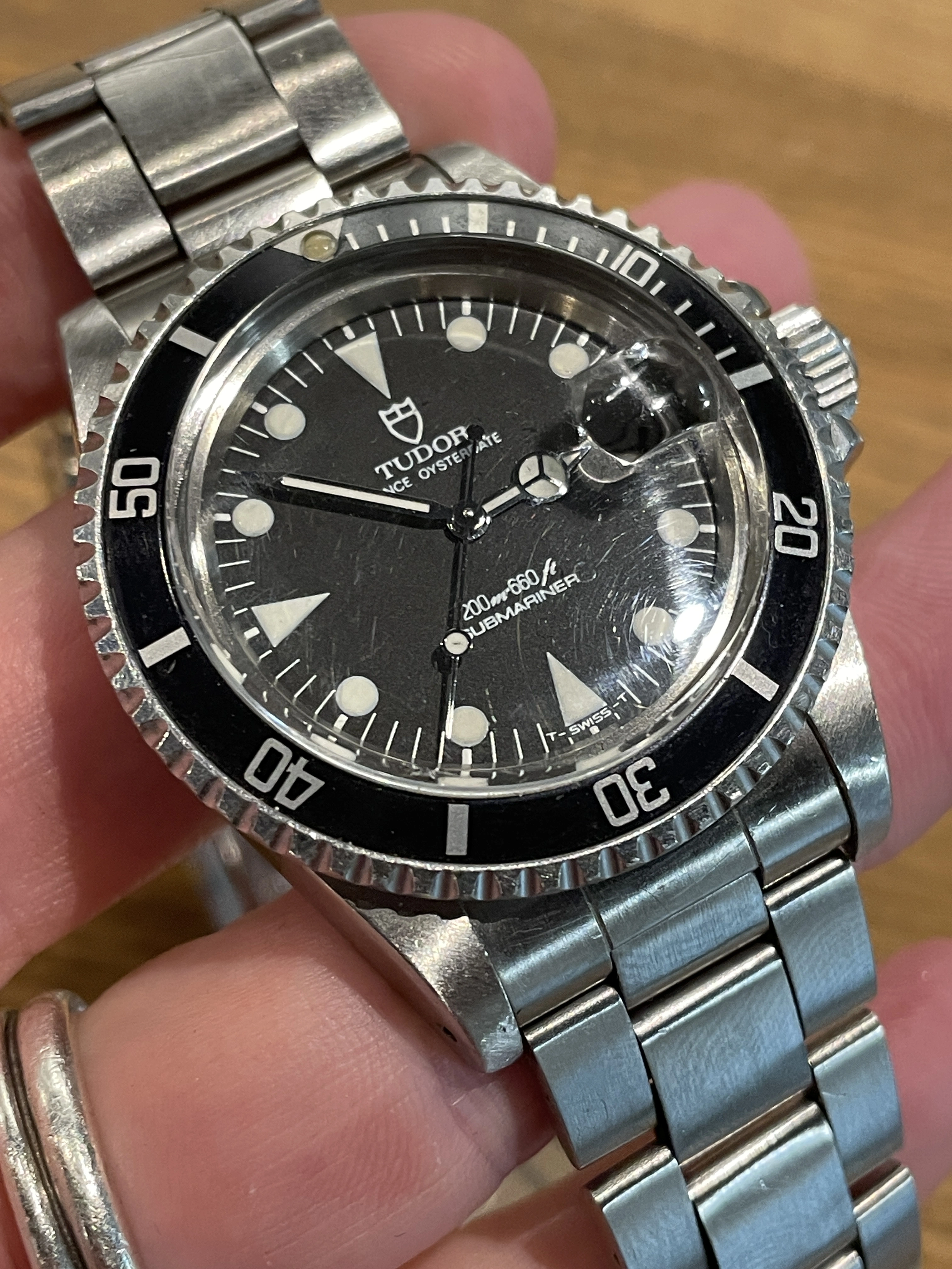

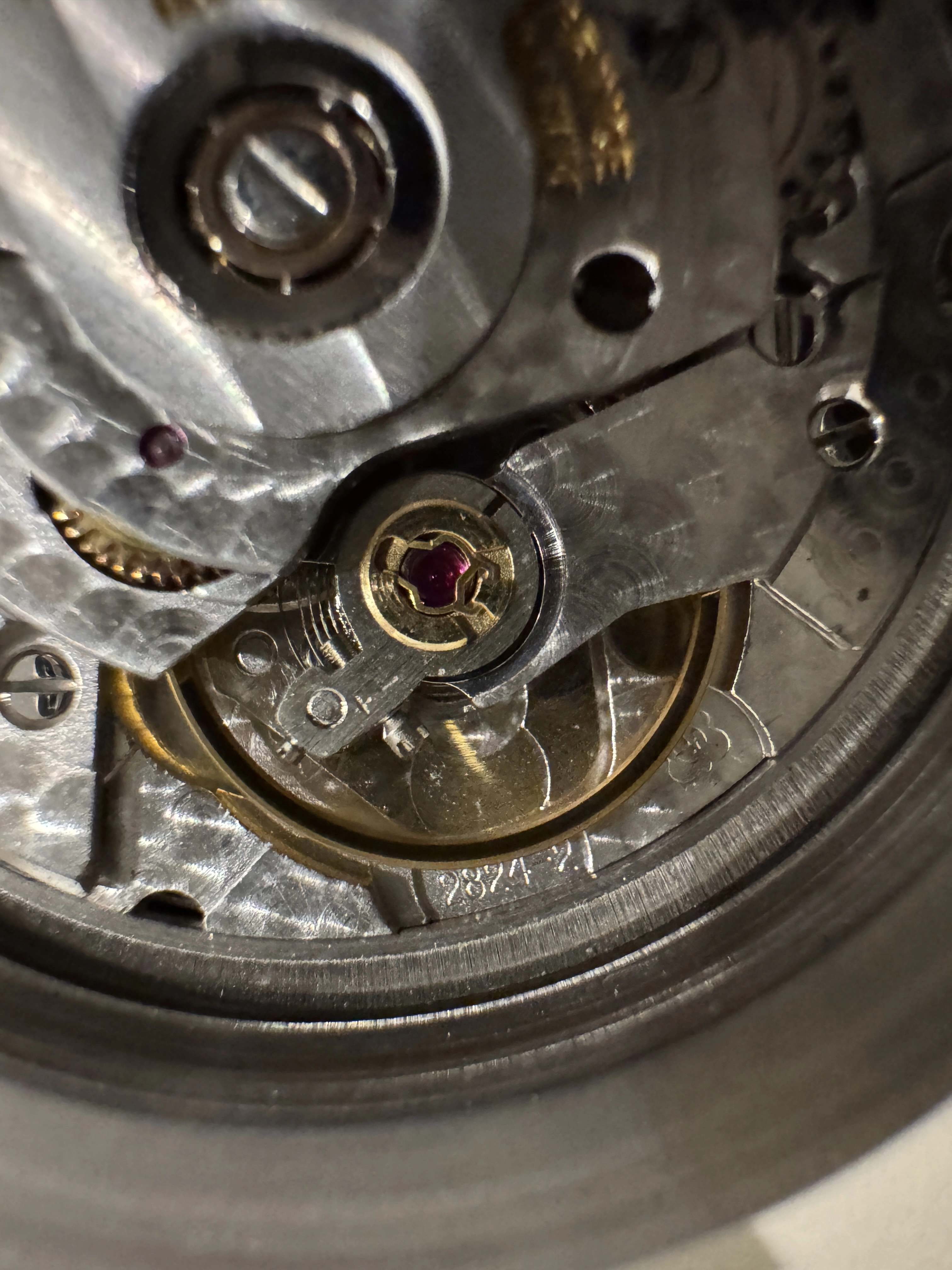

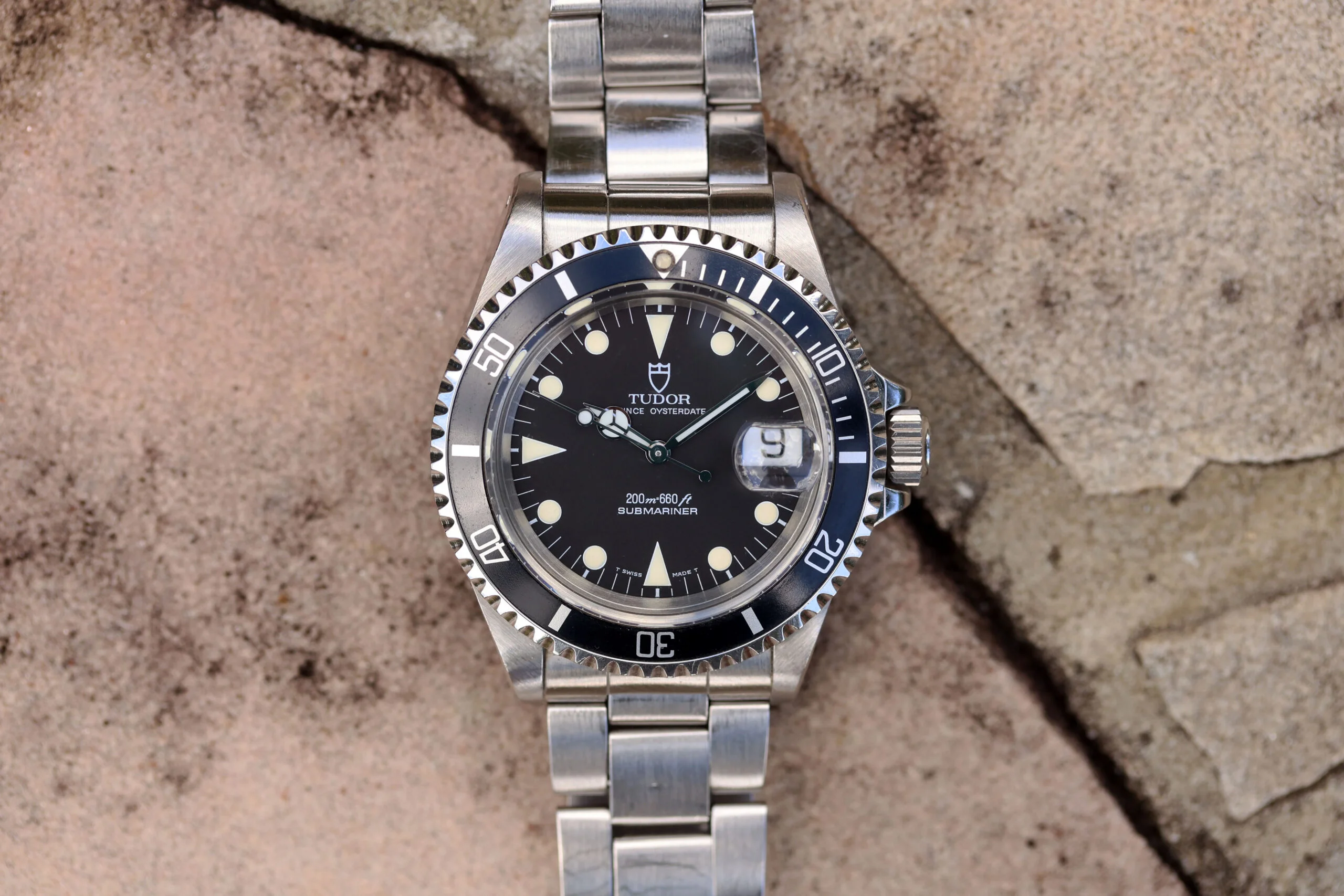

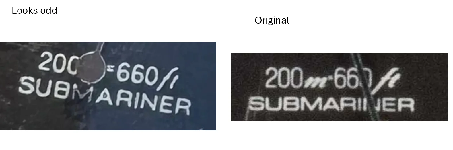

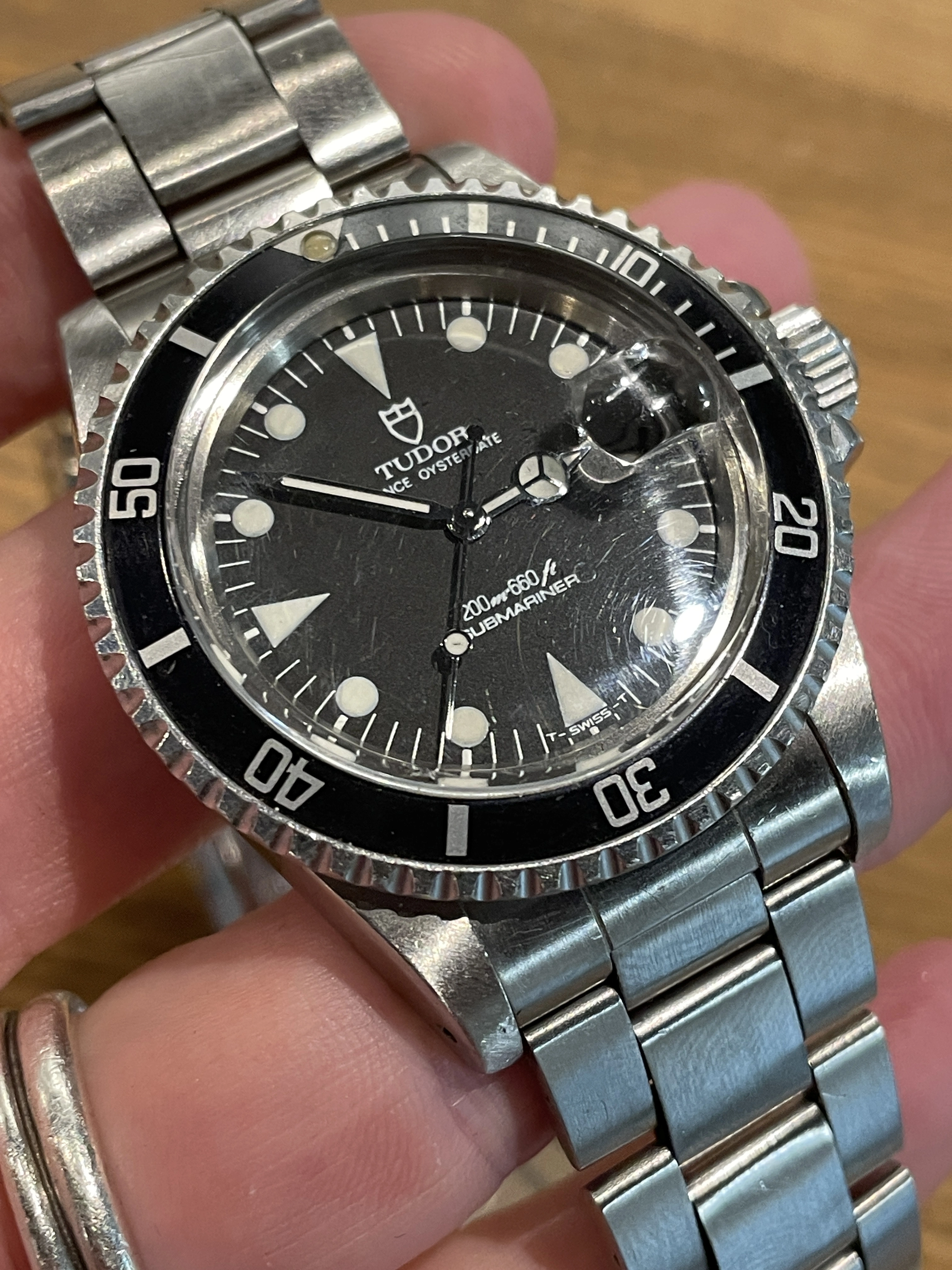

I used to own a Tudor 76100, but with the blue bezel. While I'm not an expert on Tudor, there are several things here that seem surprisingly odd to me. First, I notice from your picture that this Tudor is supposed to be a "Lollipop," but the "T Swiss Made T" marking strikes me as unusual. I would have expected it to say "T Swiss T." Additionally, the font for "Submariner" looks strange compared to others I've seen. When I search "Tudor 76100 movement" on Google, there are aspects in the pictures you shared that don’t align with the many examples readily available online. As I mentioned, I'm no Tudor expert, but anyone can do some due diligence using public resources, especially since the Tudor 76100 isn’t exactly a rare piece.
5
3

They are fairly modern but in certain examples, they can look quite vintage (if that is the look you are going for).
Couldn't agree more with this sentiment, and it's actually what keeps pulling me back to these 76100 / 79090 referenec
Agree there are a lot of foolery going on with these, but I'm thankful for communities like OF that help each other when we need a second, third, or fourth set of eyes to double check.

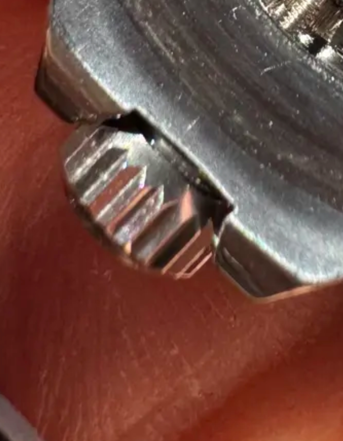

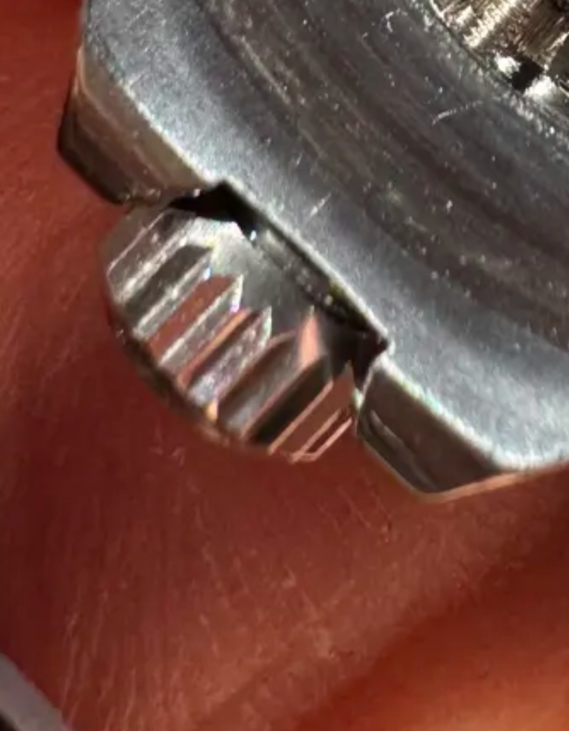

The crown is fake as well
It was looking strange to me as well but thanks for the confirmation
Appreciate your reply, but not sure if you had a chance to read my initial concerns written in the first post but many of the issues you note I point out in my original post.
The Lollipop hour hand was not much of a concern to me as Rolex has been know to replace the lollipop hand with a Mercedes style hand during a service as the the lollipop lume was known to fall apart.
The "T Swiss Made T" font caught my eye as well, noted in the OP, but not for the placement. I've seen quite a few 76100 references with service hands and dials that have this style of dial. I believe this dial design was introduced on late 79090 and used through 79190 examples, see picture below of an example with this dial. So my assumption was when looking at the watch originally was that it had a service early on and the dial and hands were replaced. Which since I was planning on this being a daily wearer I was open to a watch that had service parts if it was at the right price.
What caught my eye on the dial though was as you also noted the font style, again noted in my OP. Not only was the font style peculiar for "SUBMARINER" but also for all the rest of the font. Font on my watches is something that I tend to obsess over, so when looking at the dial of the watch offered to me I immediately noticed that none of the font had Serif style font that is so commonly seen on these Tudor Submariners (ref. 7016 thru 79190). Which is why noting that I'm not an expert I brought it to the OF group to see if someone knew something I was unaware of and could learn more about.

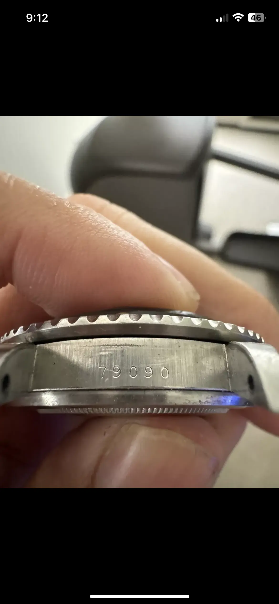

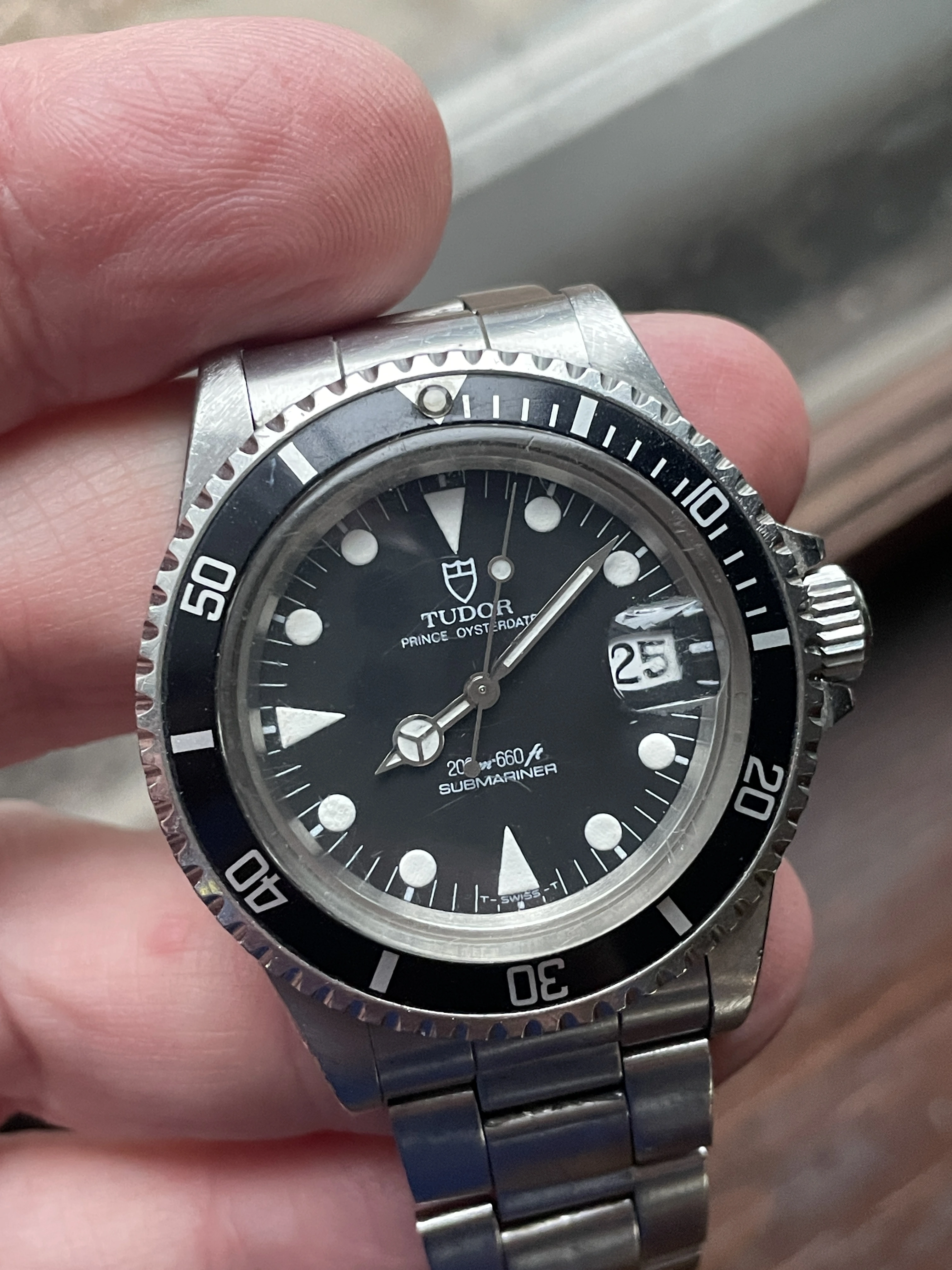

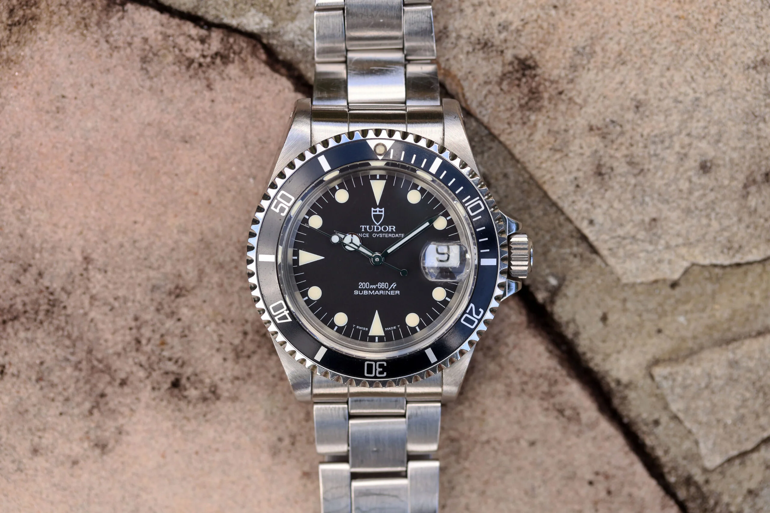

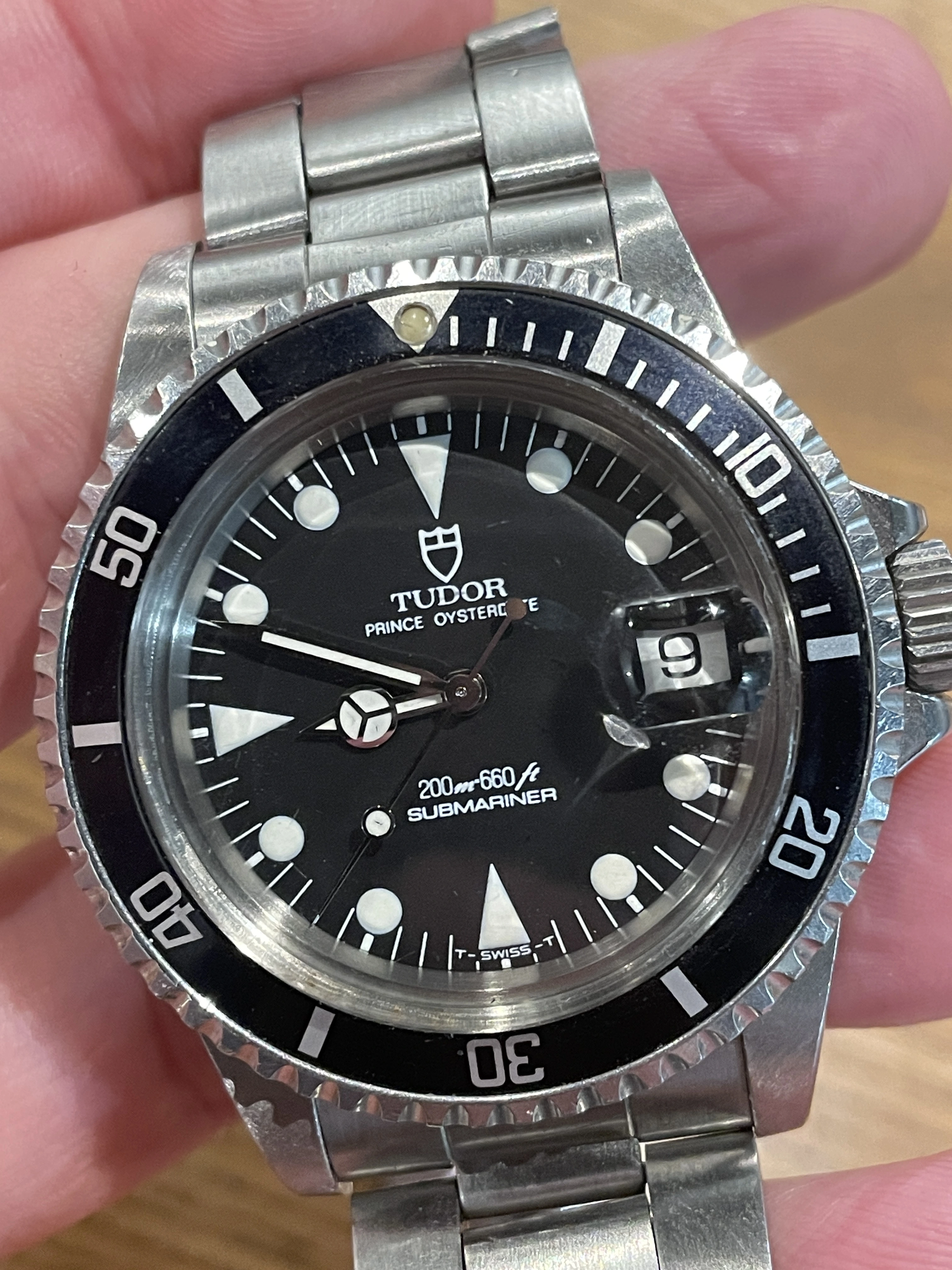

Okay OF, back for a little further help. Rather than start a new thread and since I’m still looking at Tudor Submariner but this time an early 79090. So I thought it best to adjust the thread title and just post the photos here. I was able to handle the watch in person today and from my eye it’s looking good to me but want to hear from you all.
@vibe & @Slevin kelevra I’d very much welcome your opinions on this example if you’ve got the time.
My observations:
  • Dial and typography appear correct truth the T-Swiss-T as well as the bold m and ft in the depth rating.
  • Lume looks like an attractive color although there appears to be some pitting on the hour hand
-Bezel looks good although the pip has patinated differently than the dial.

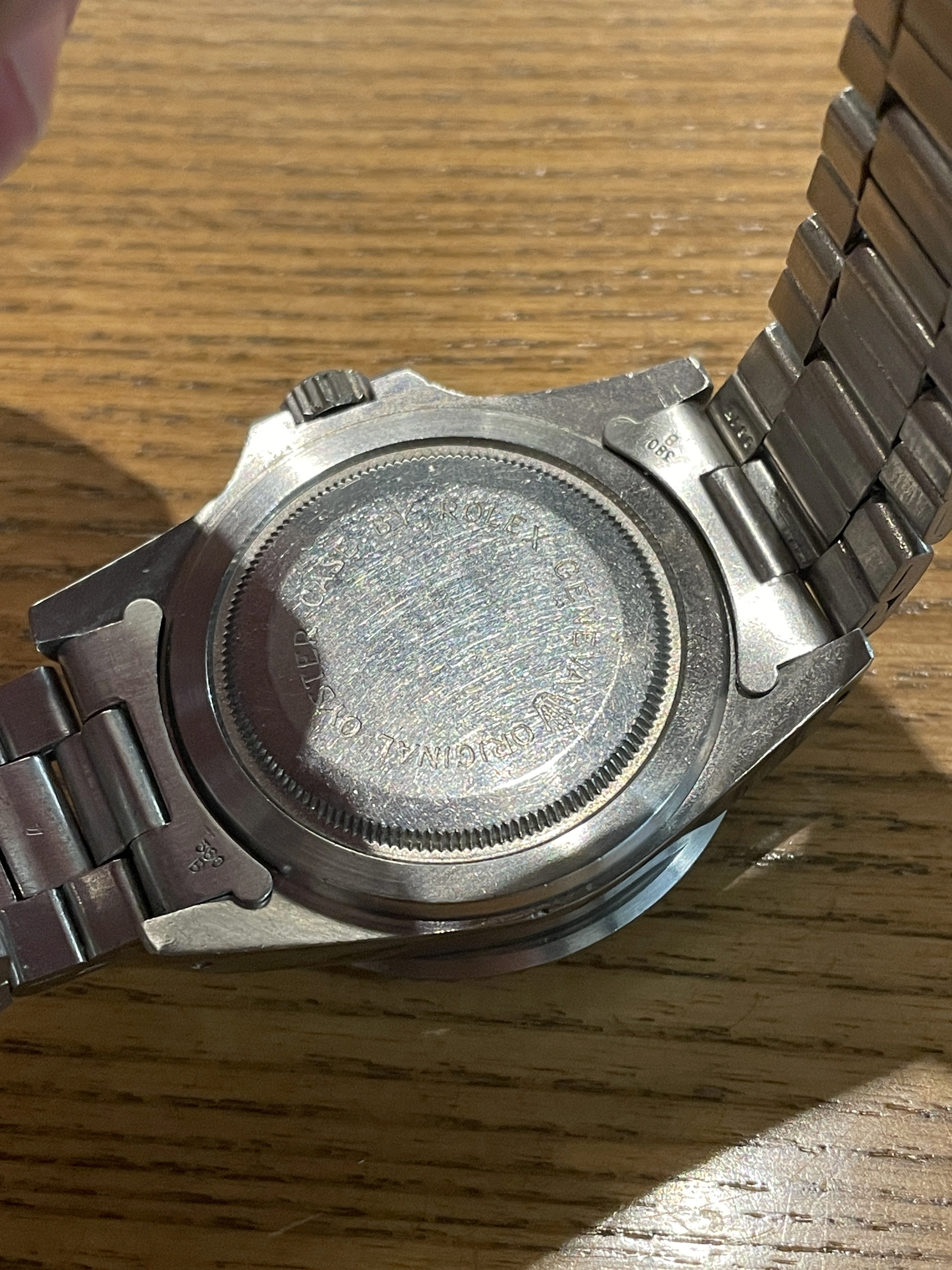

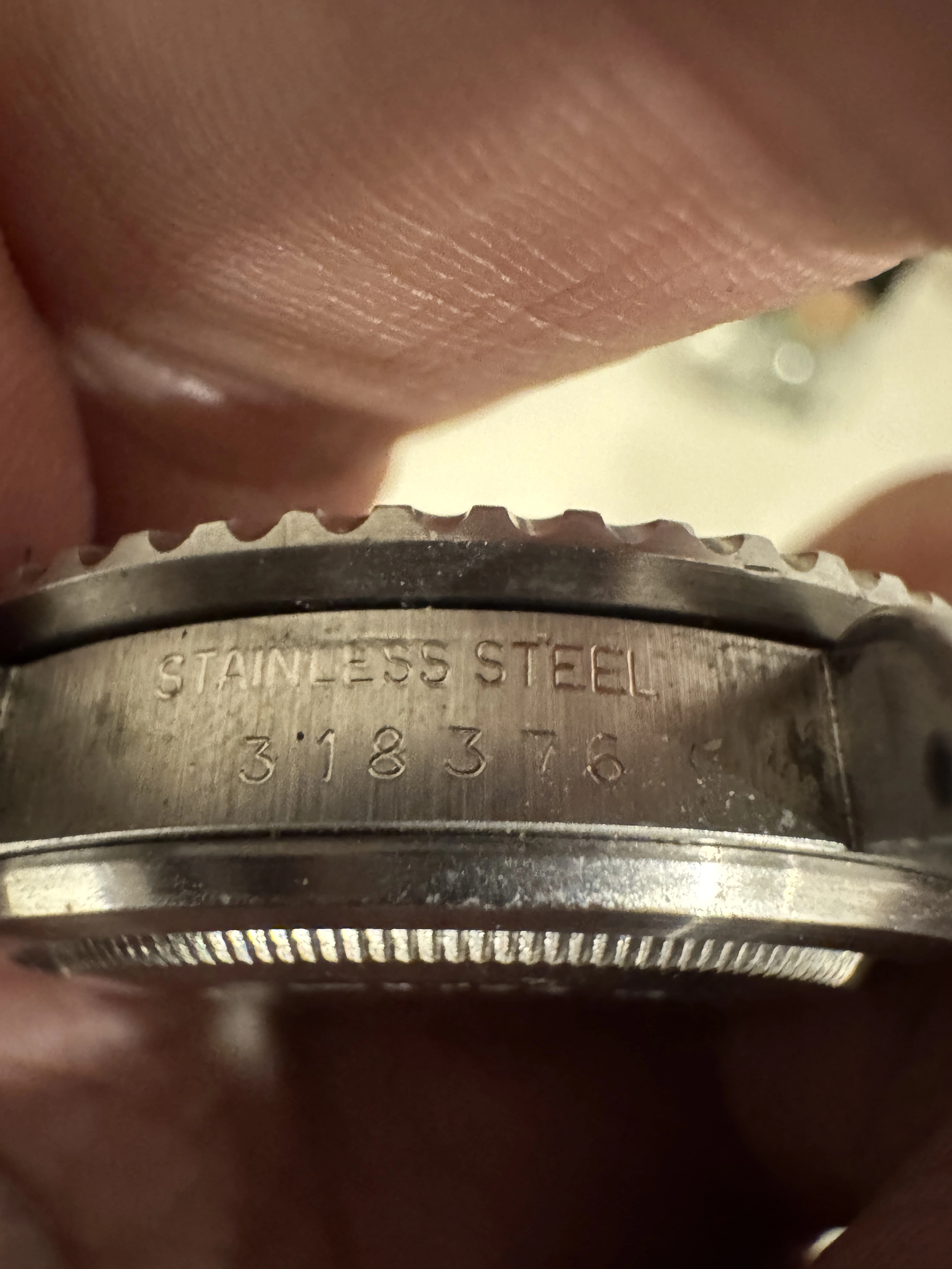

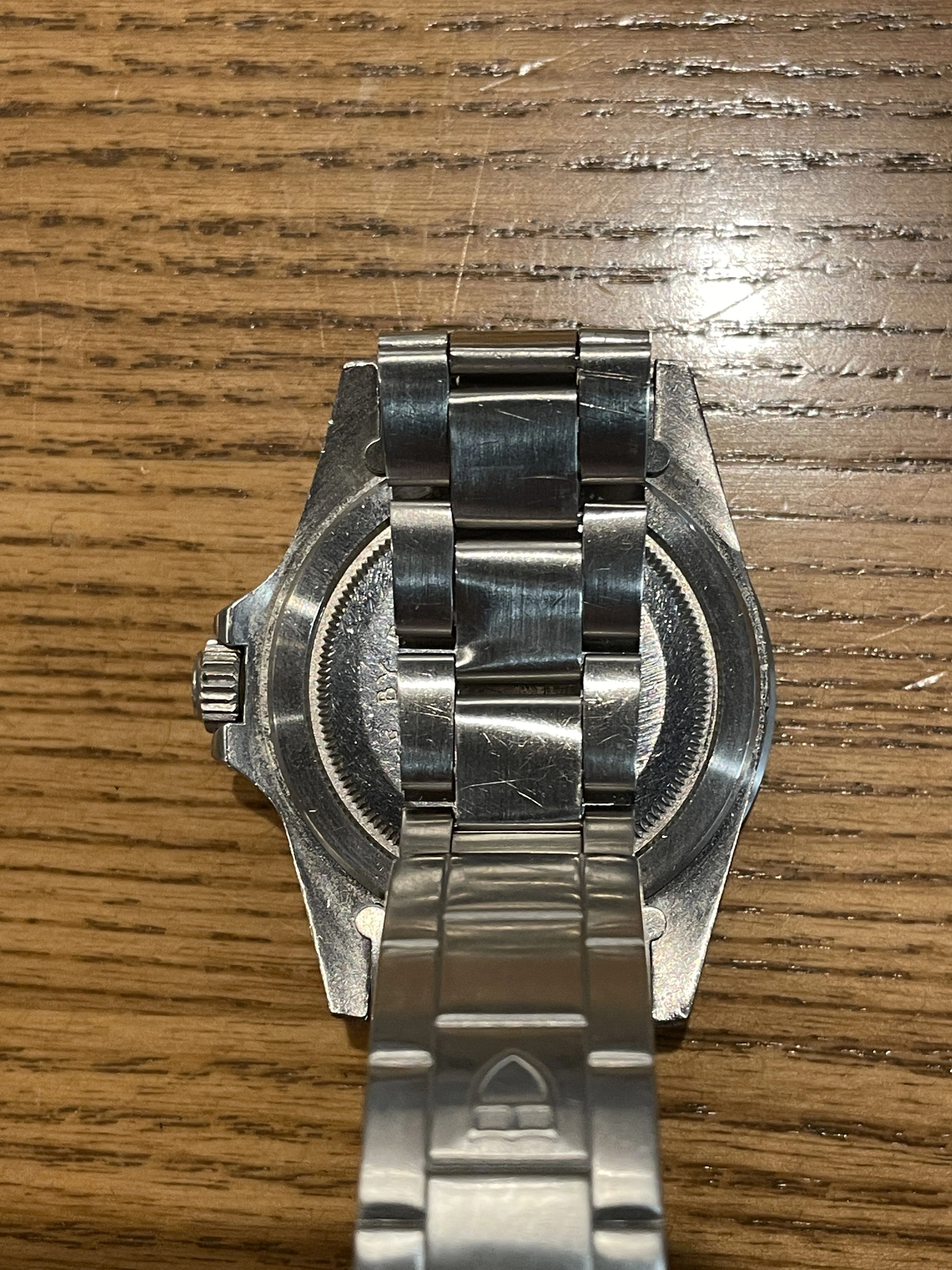

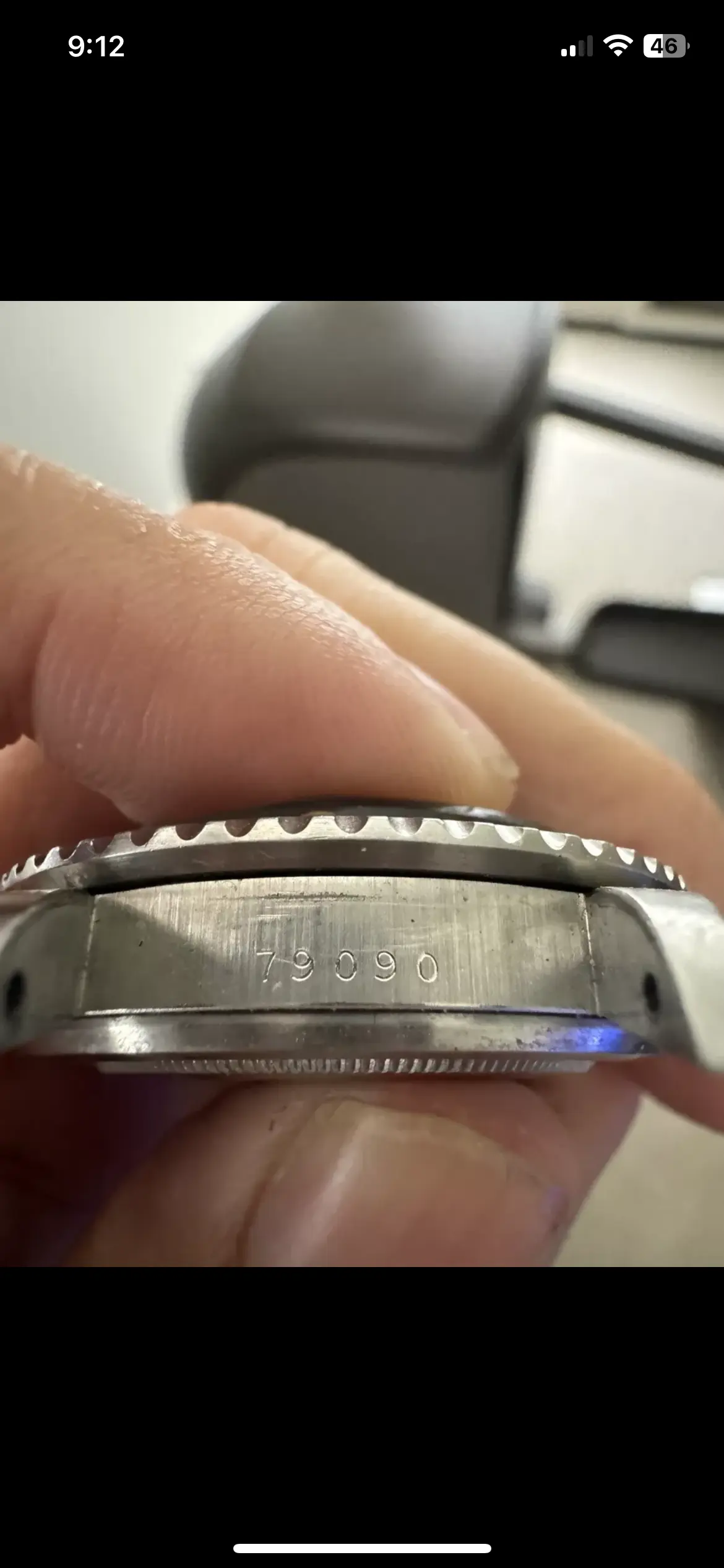

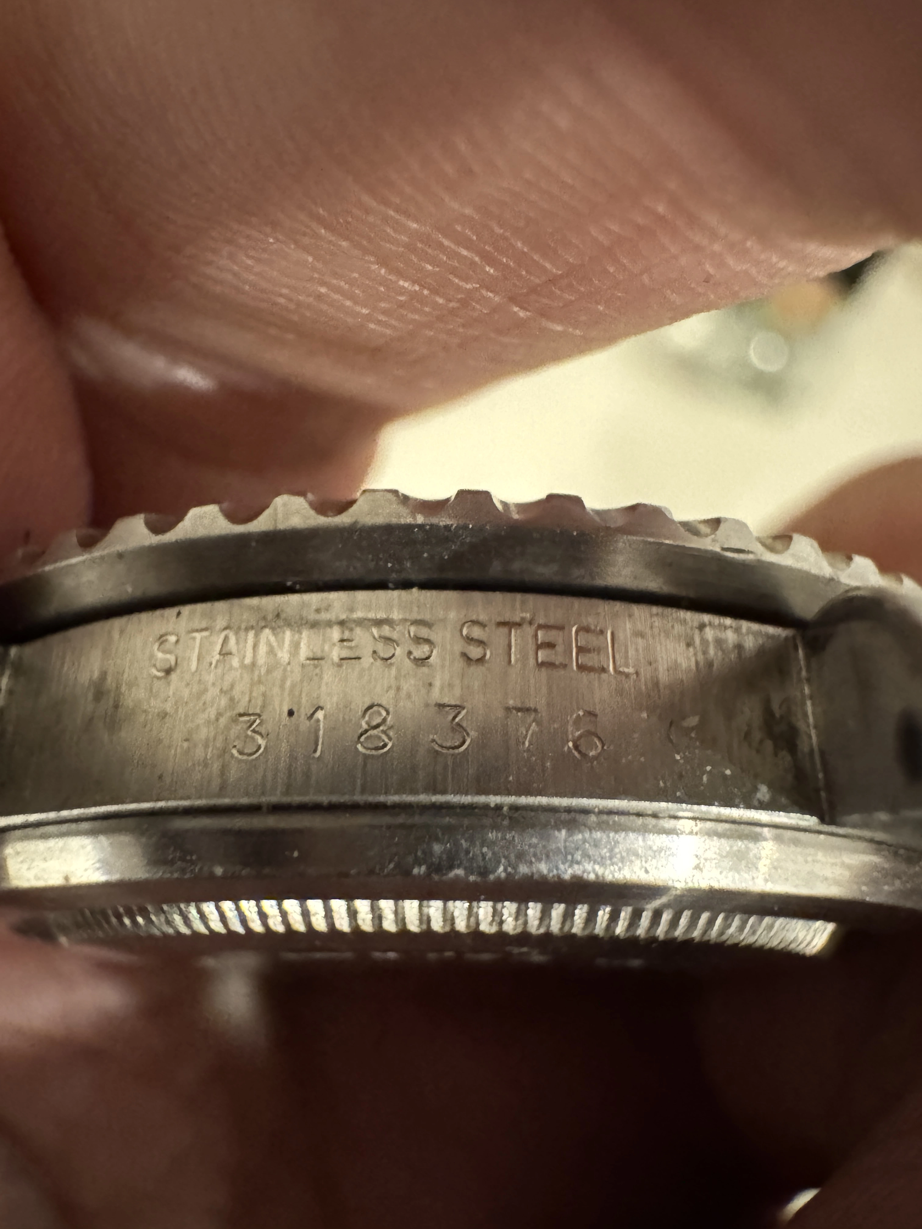

  • Case back engraving looks to be with the correct font style (apologies for the poor lighting)

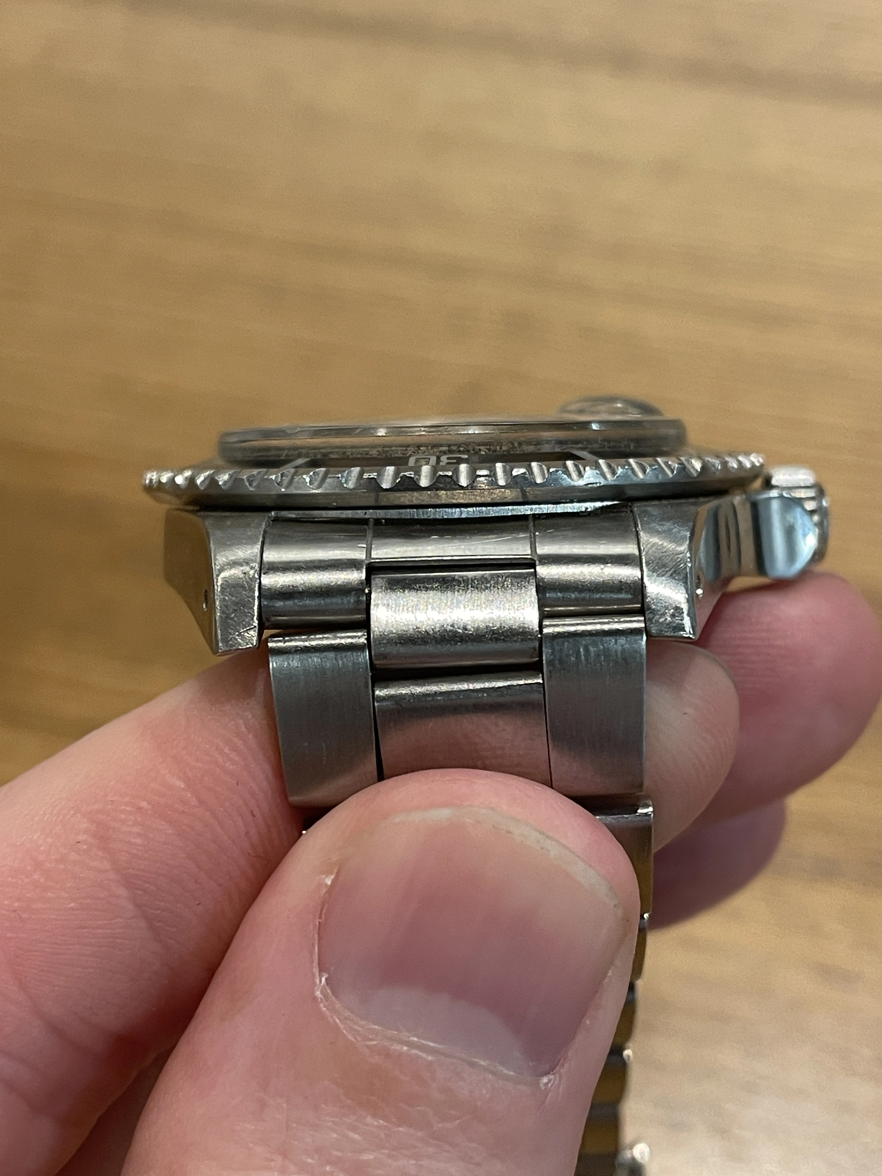

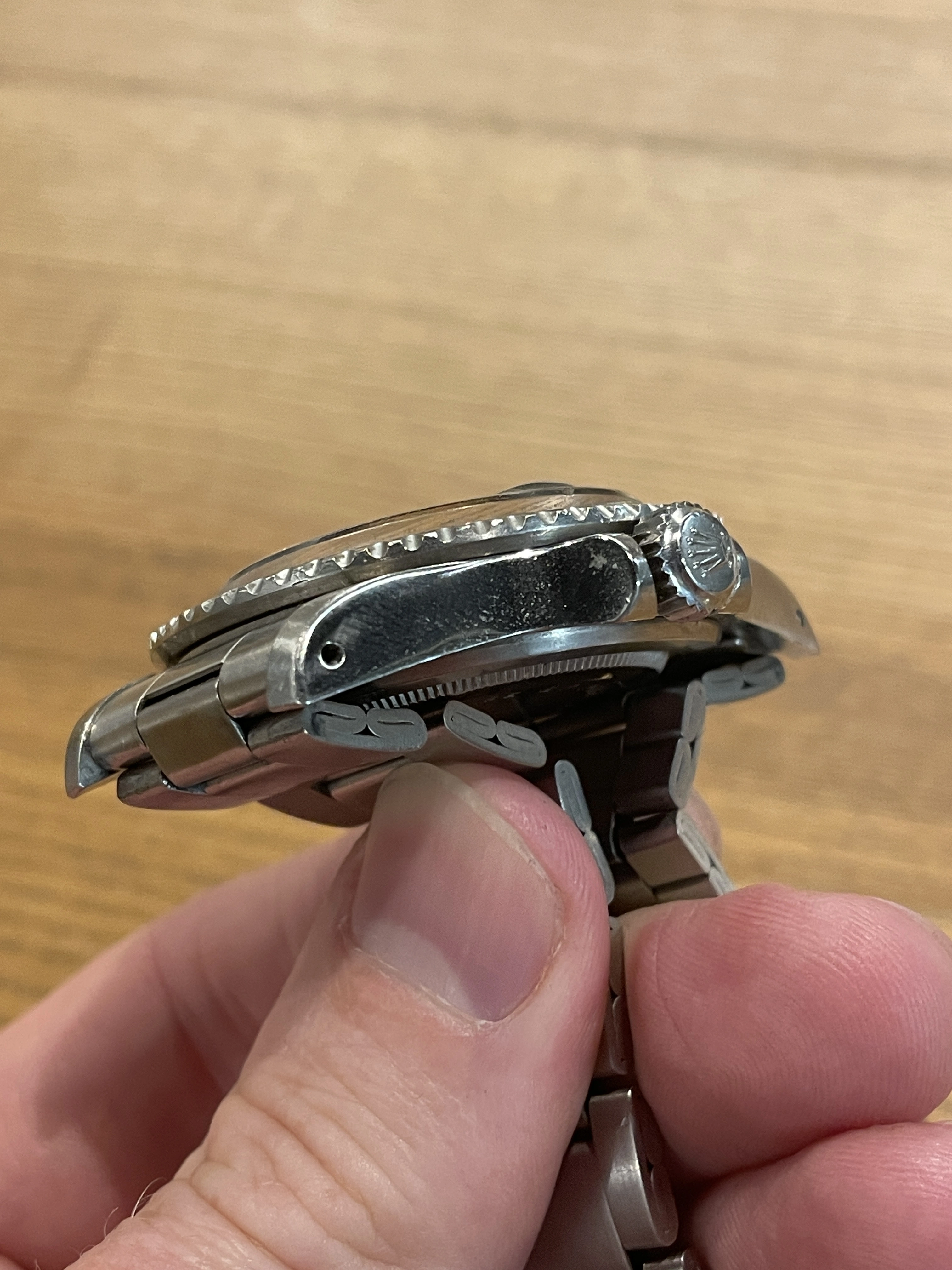

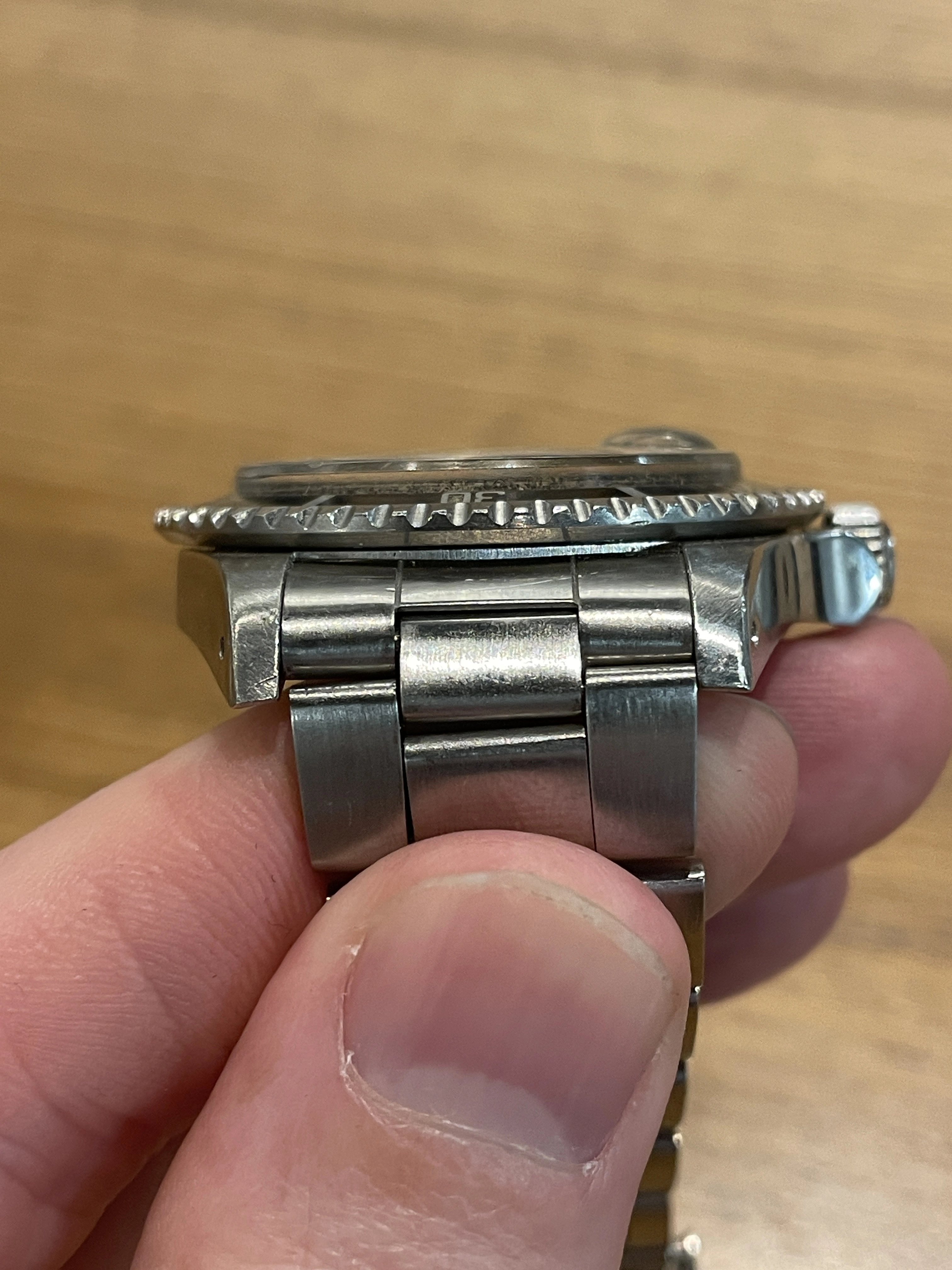

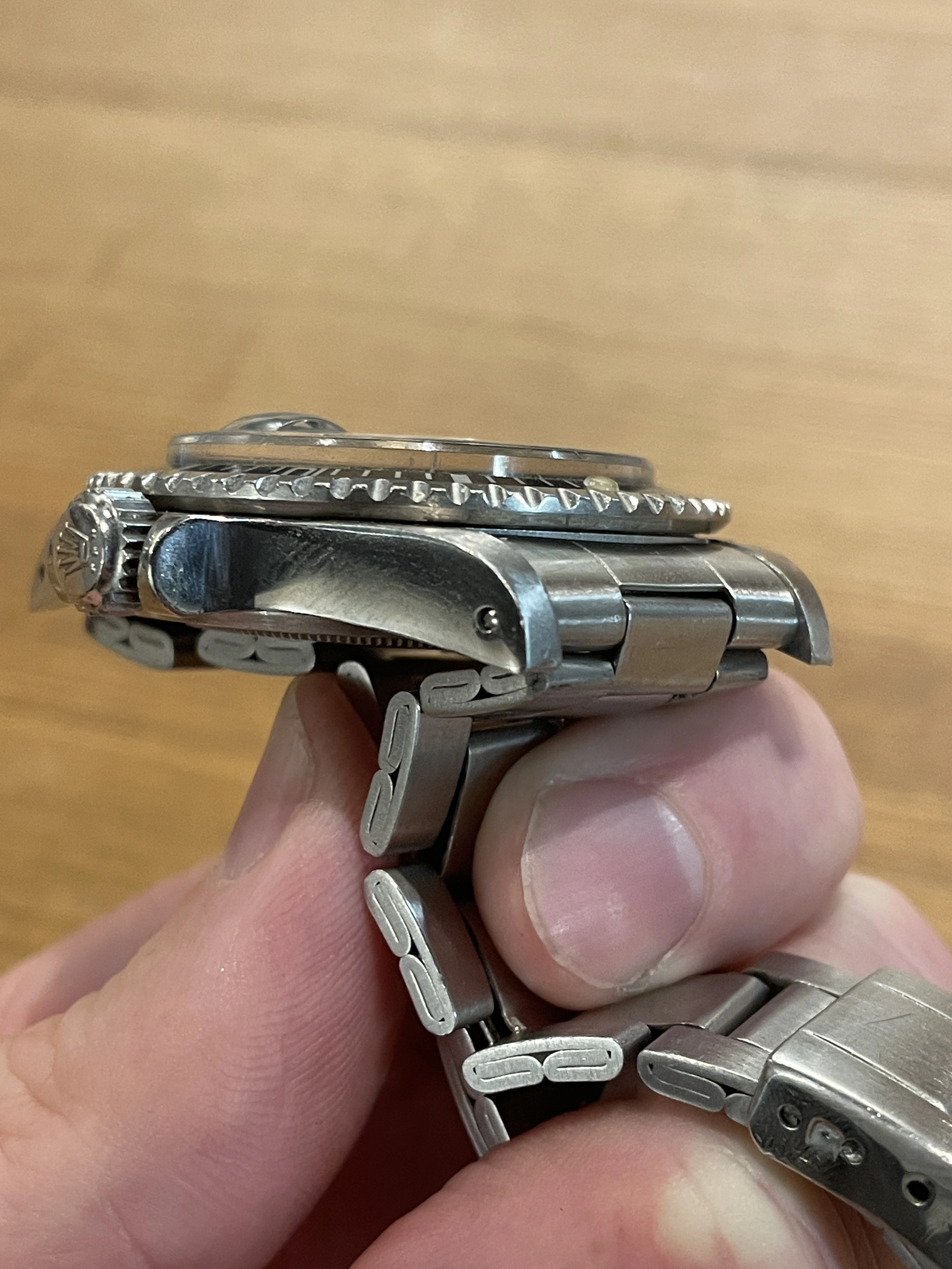

  • Case sides have been polished but for the most part the lugs are still thick and in all honesty I’m okay with a little polish history

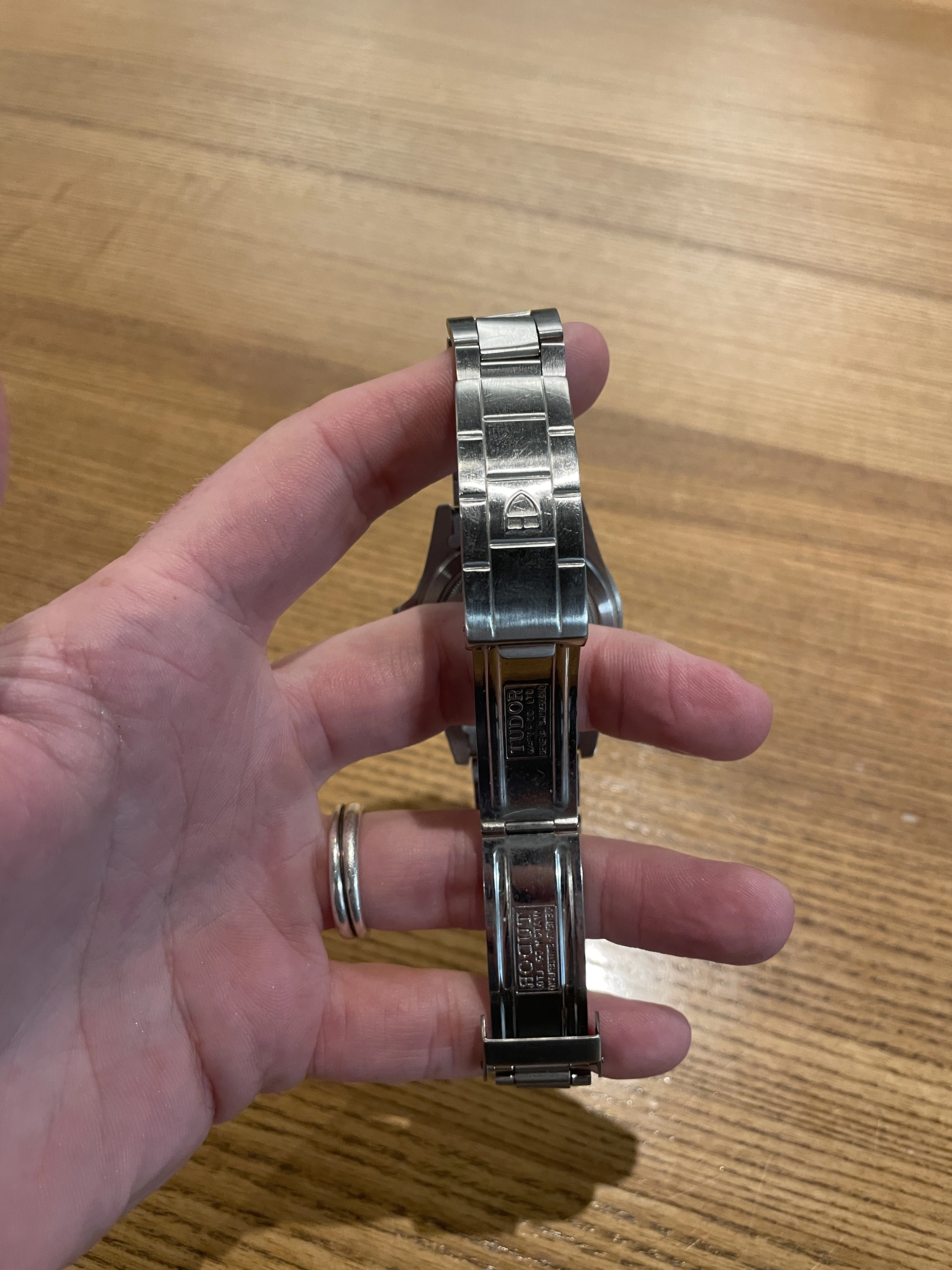

  • Bracelet has some stretch and scratch but overall it’s fine in my opinion for its age and I can always get it refurbished.

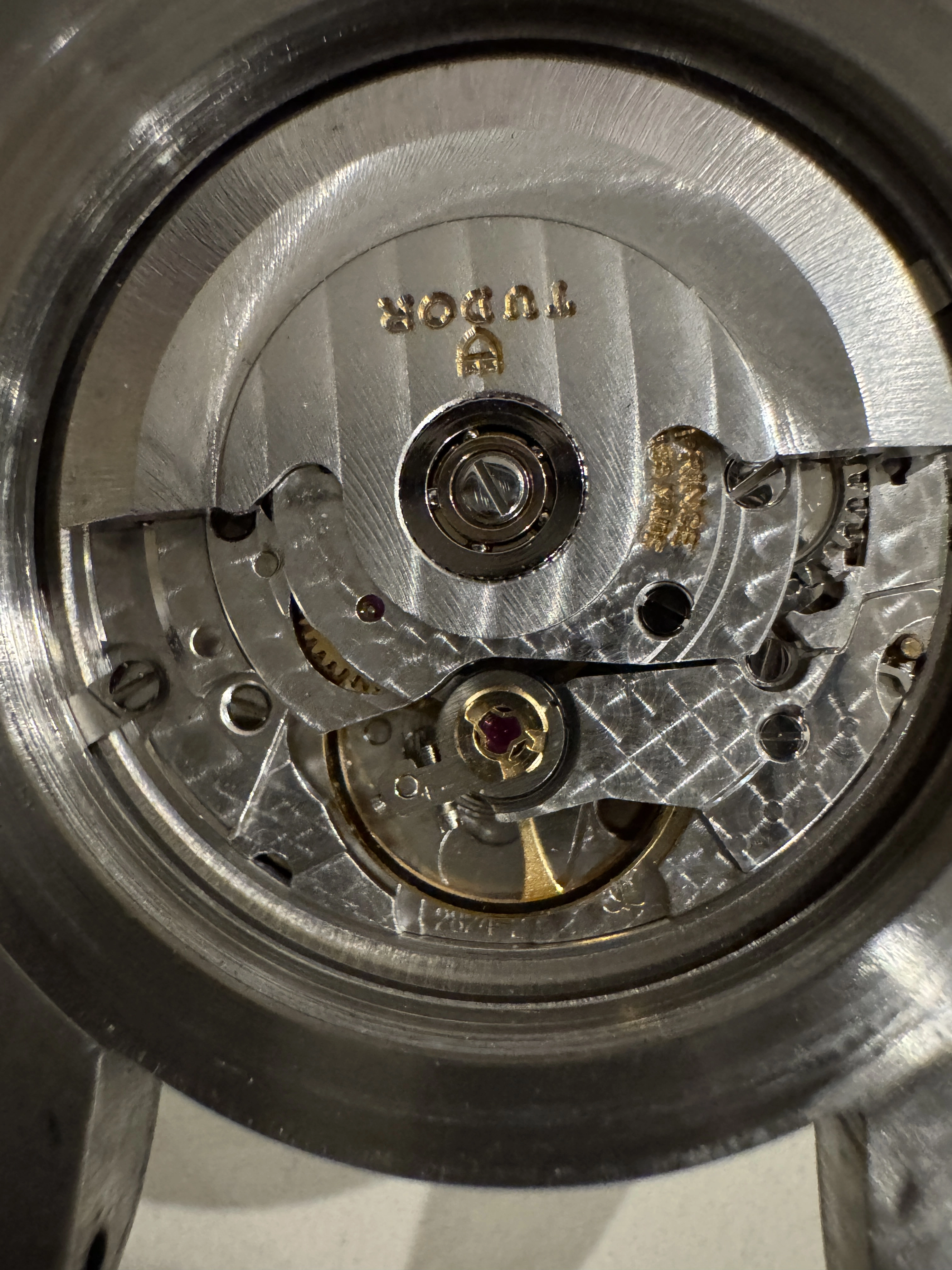

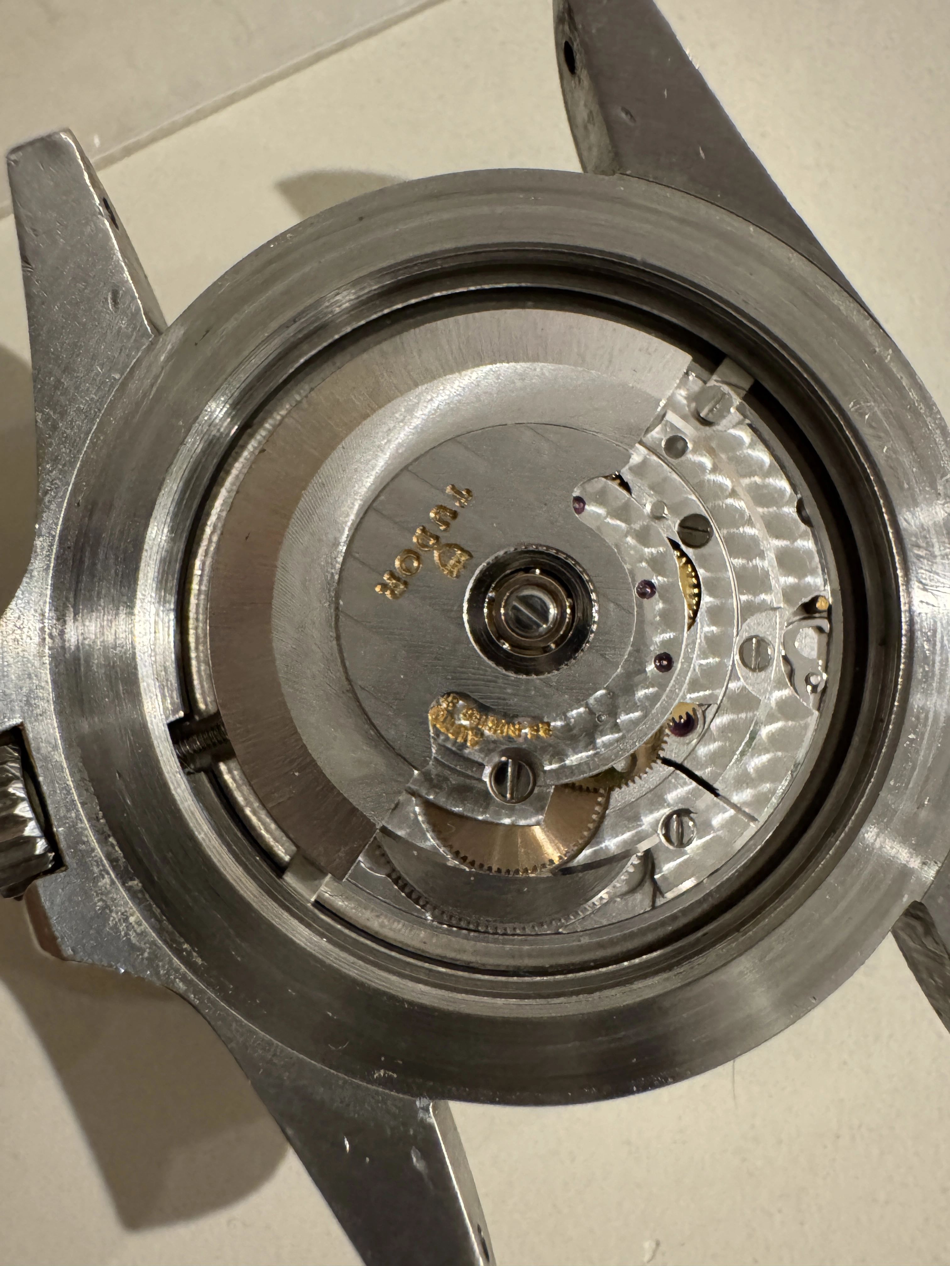

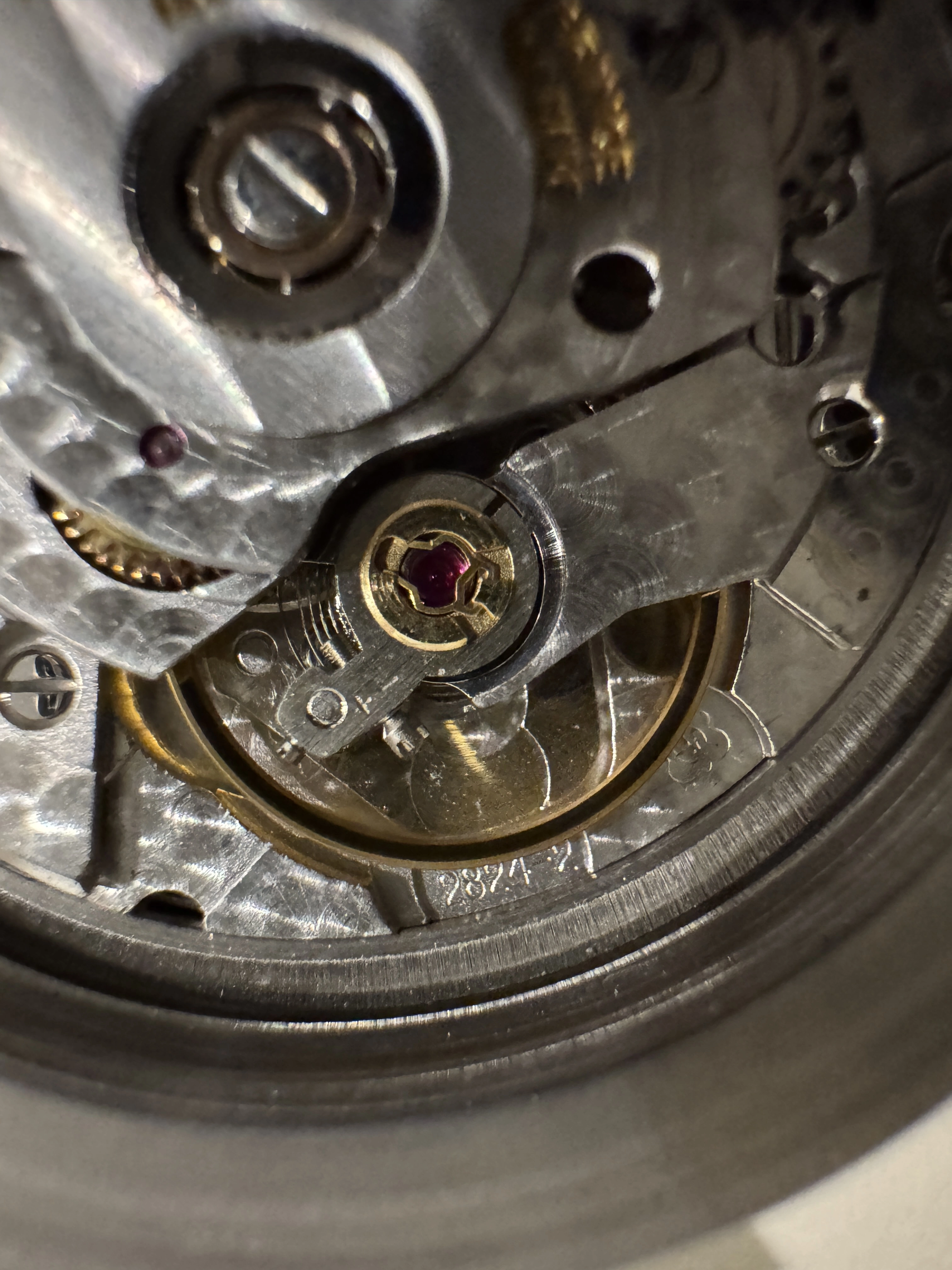

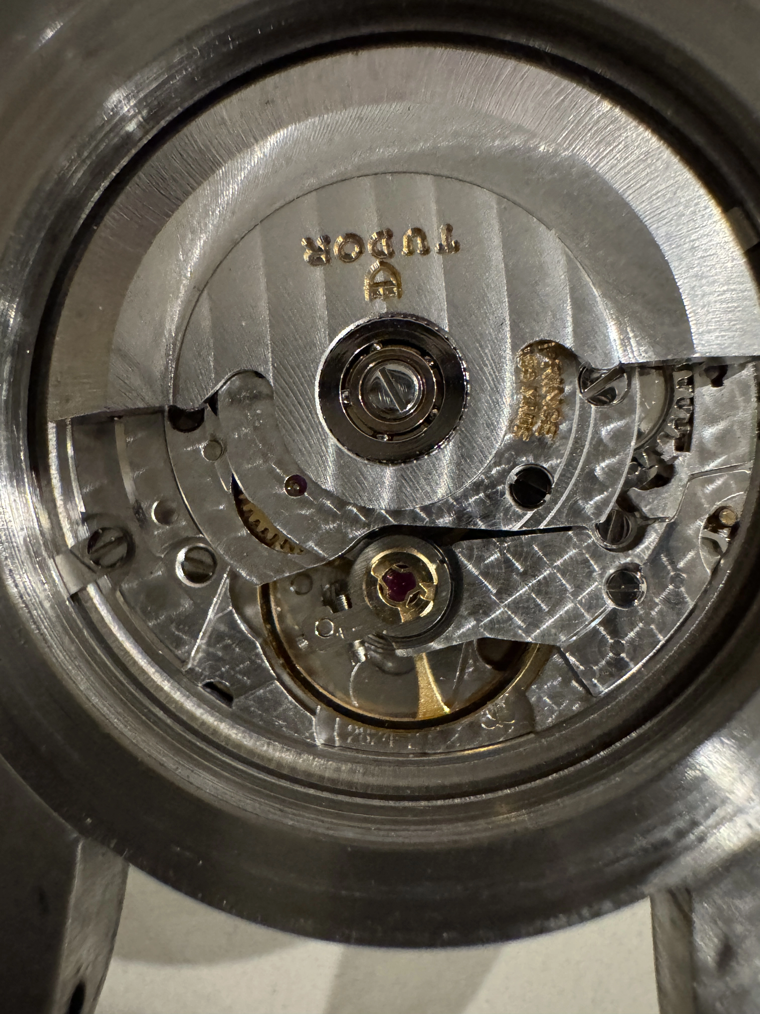

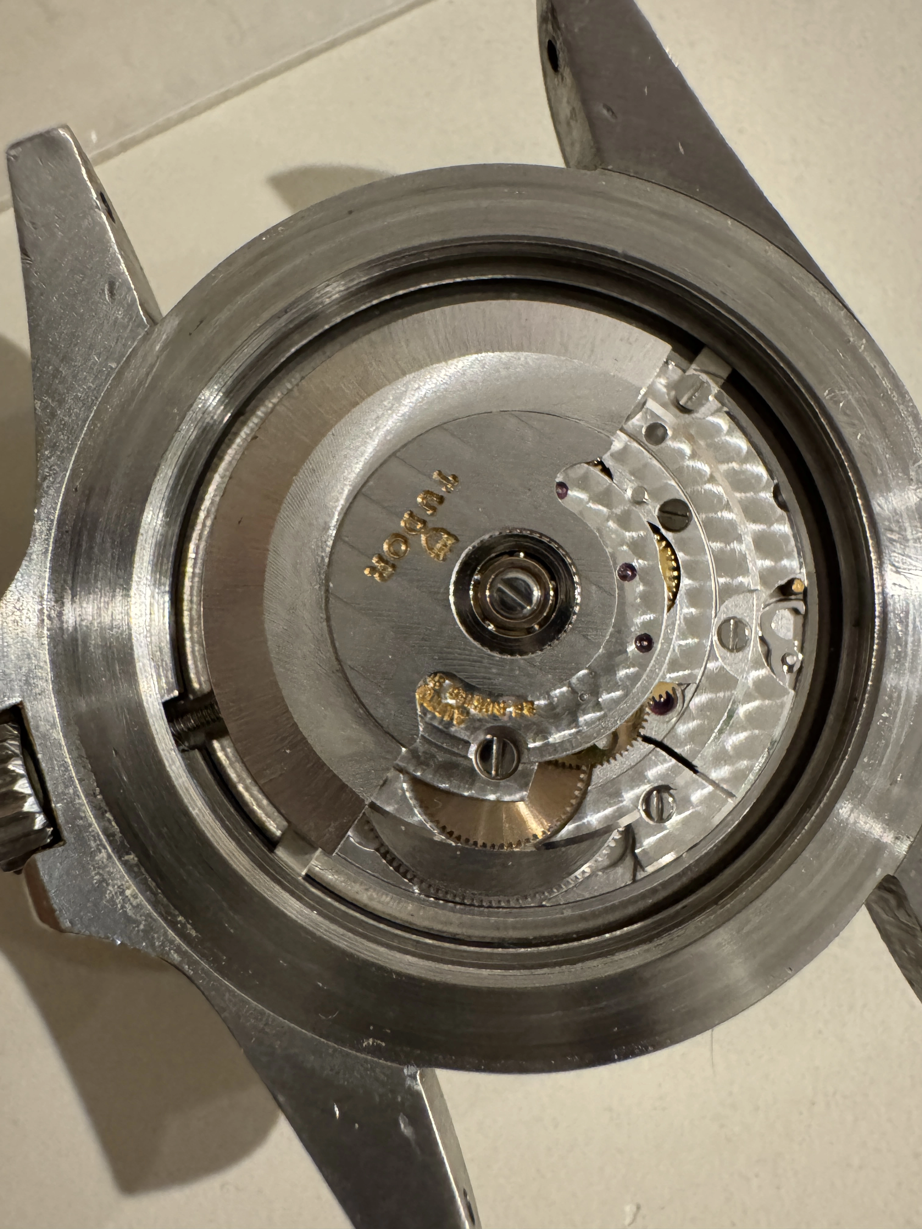

  • Movement appears to have the correct components @vibe previously noted it should have but let me know if I missed something.
Okay now the part we all want, the photos:
Seller provided photo of reference engraving

Bit of an update. Reached out to local well known dealer that a few friends have purchased similar references from. He gave the photos I posted a look and said it looked good to his eye. If any of you all have any thoughts on this second example I posted above, they would be greatly appreciated.

Anyone feel like lending a helping had / second opinion on the 79090?
496
1,211

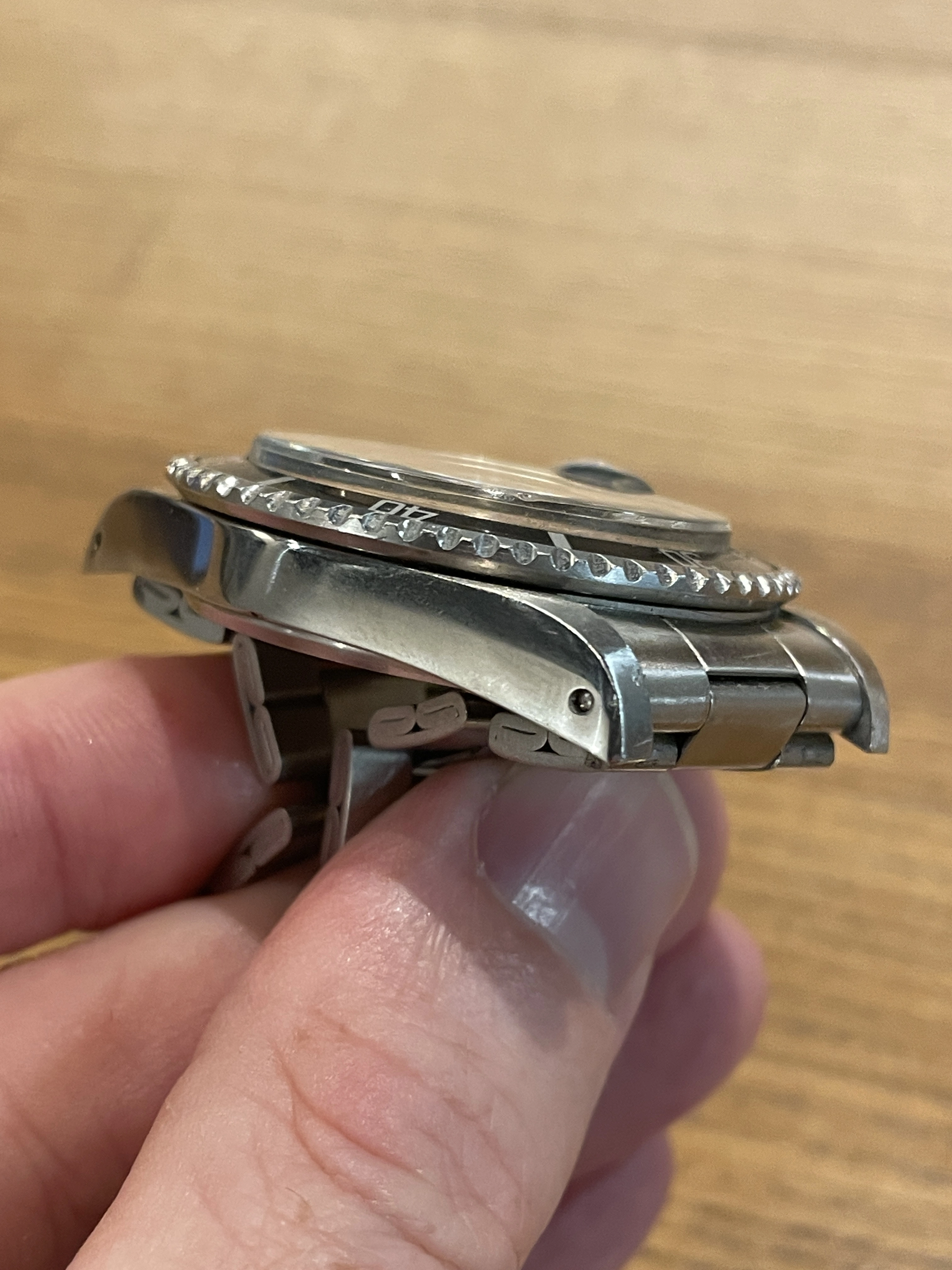

Seems generally fine to me, with some reservations: the polishing's made the springbar holes a bit bigger, and the lume on the hour and seconds hand looks (imo) not to be pitted, but cracked and maybe stabilized. That's all just a matter of taste; if it's the right price and works for you, go for it. Here's mine (can't remember if it's 89 or 90):

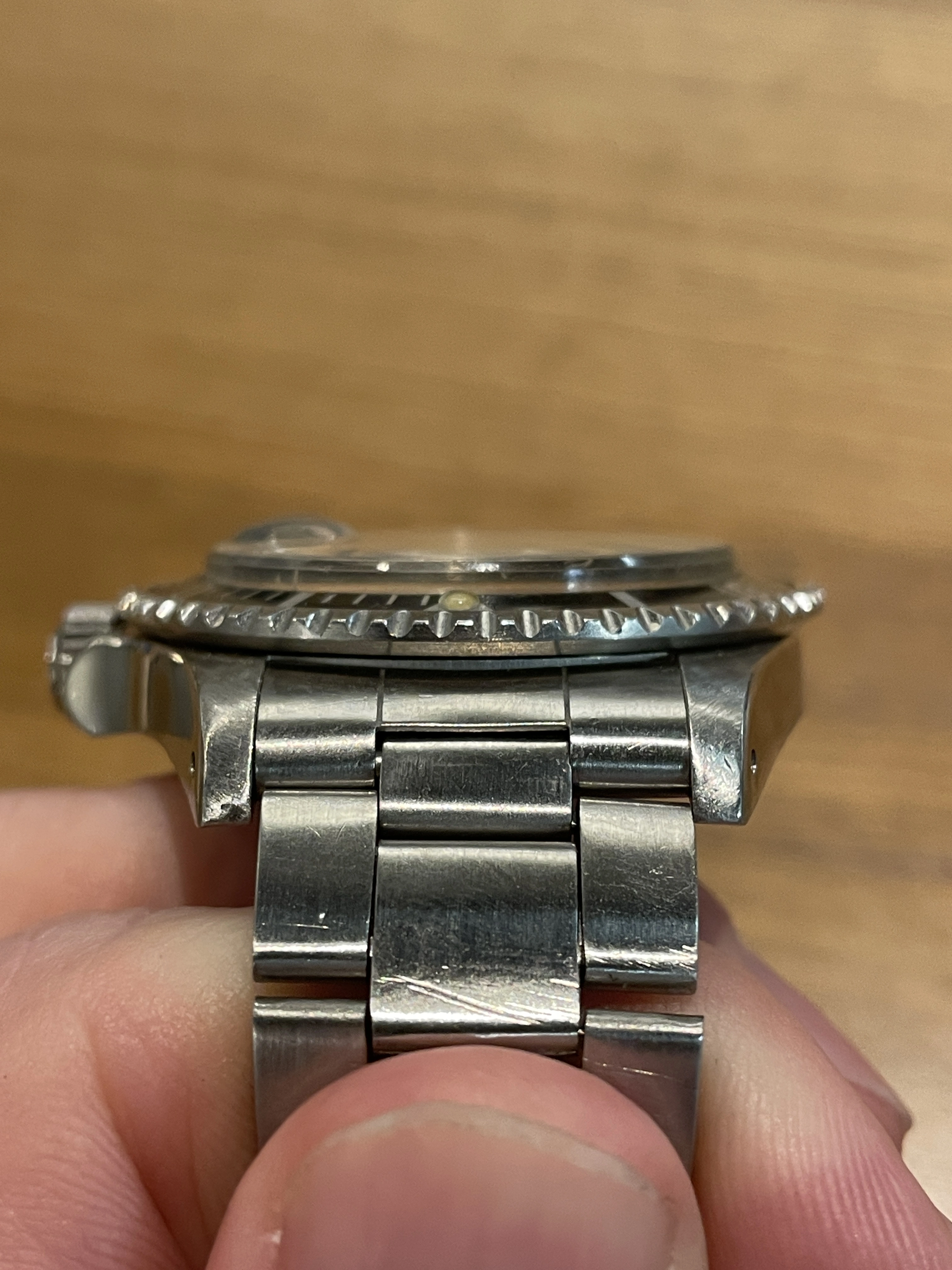

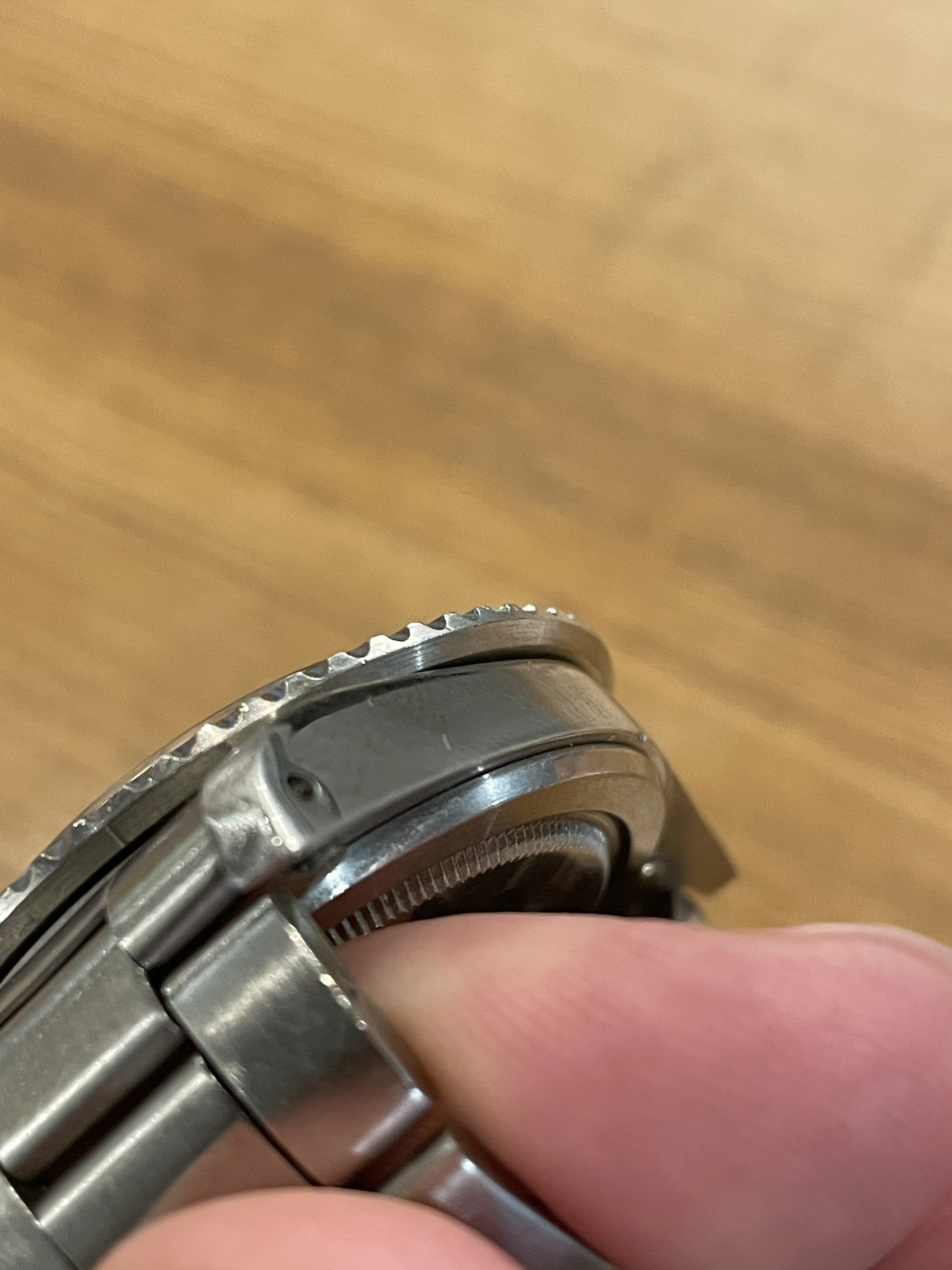

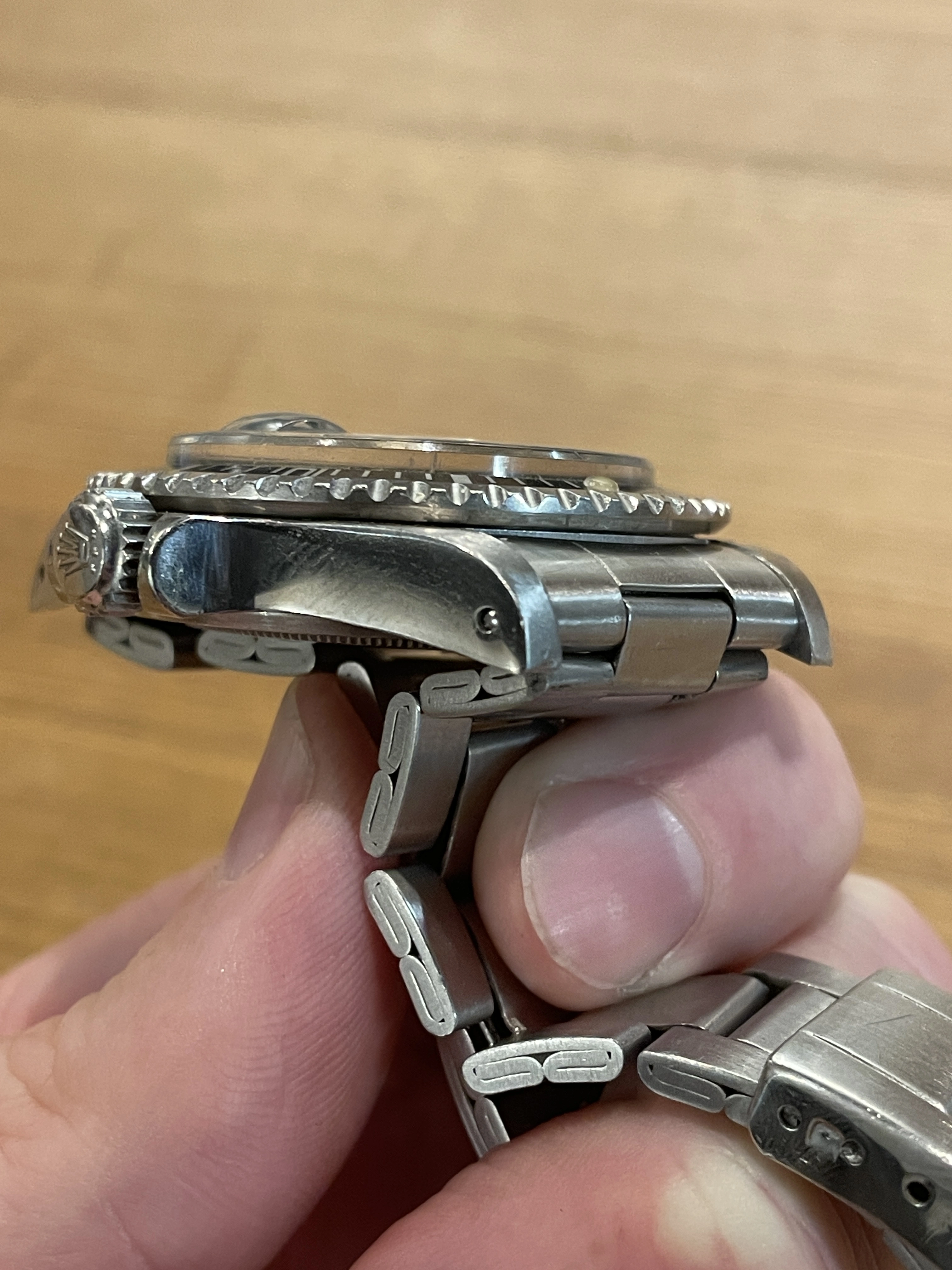

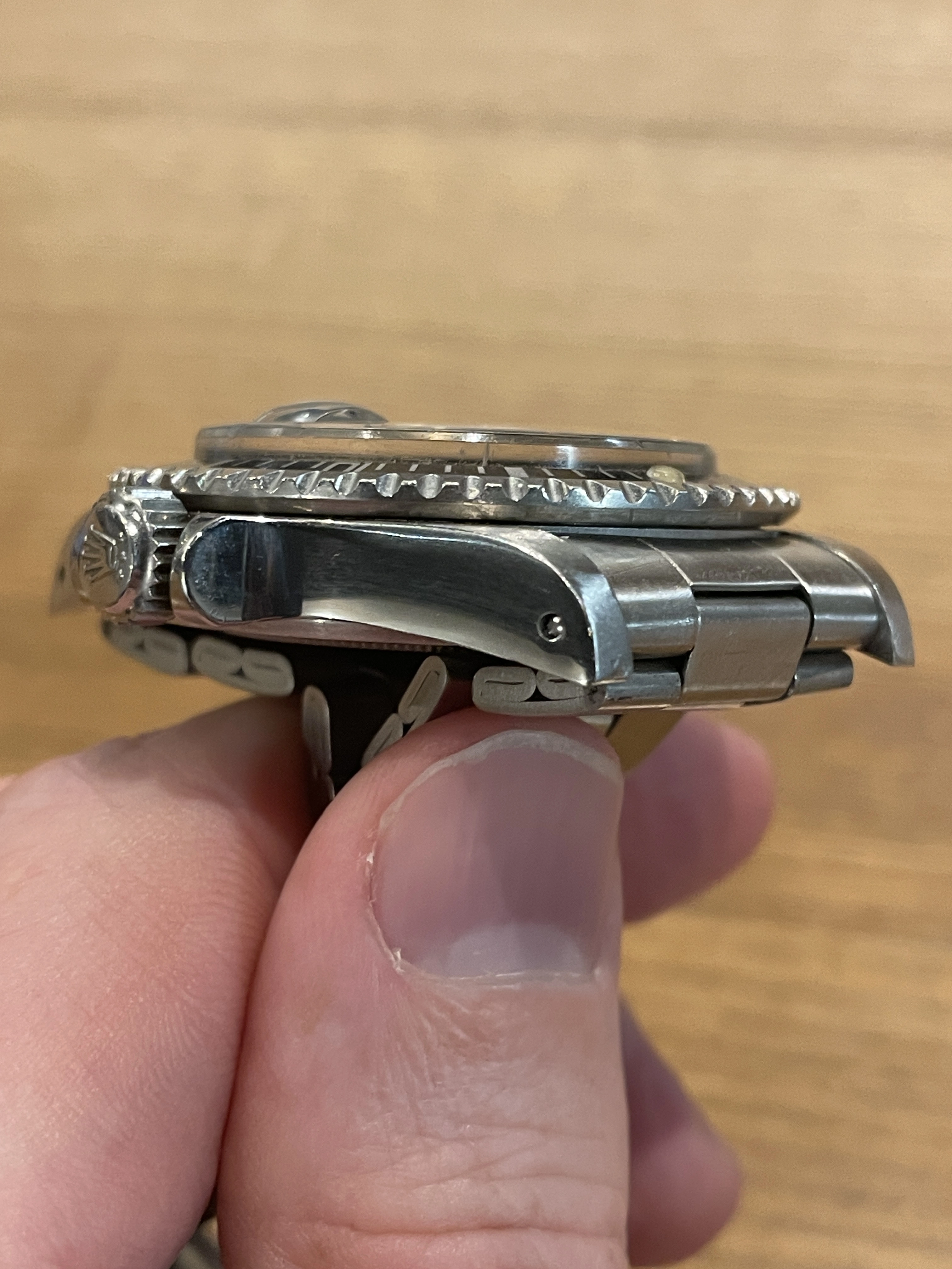

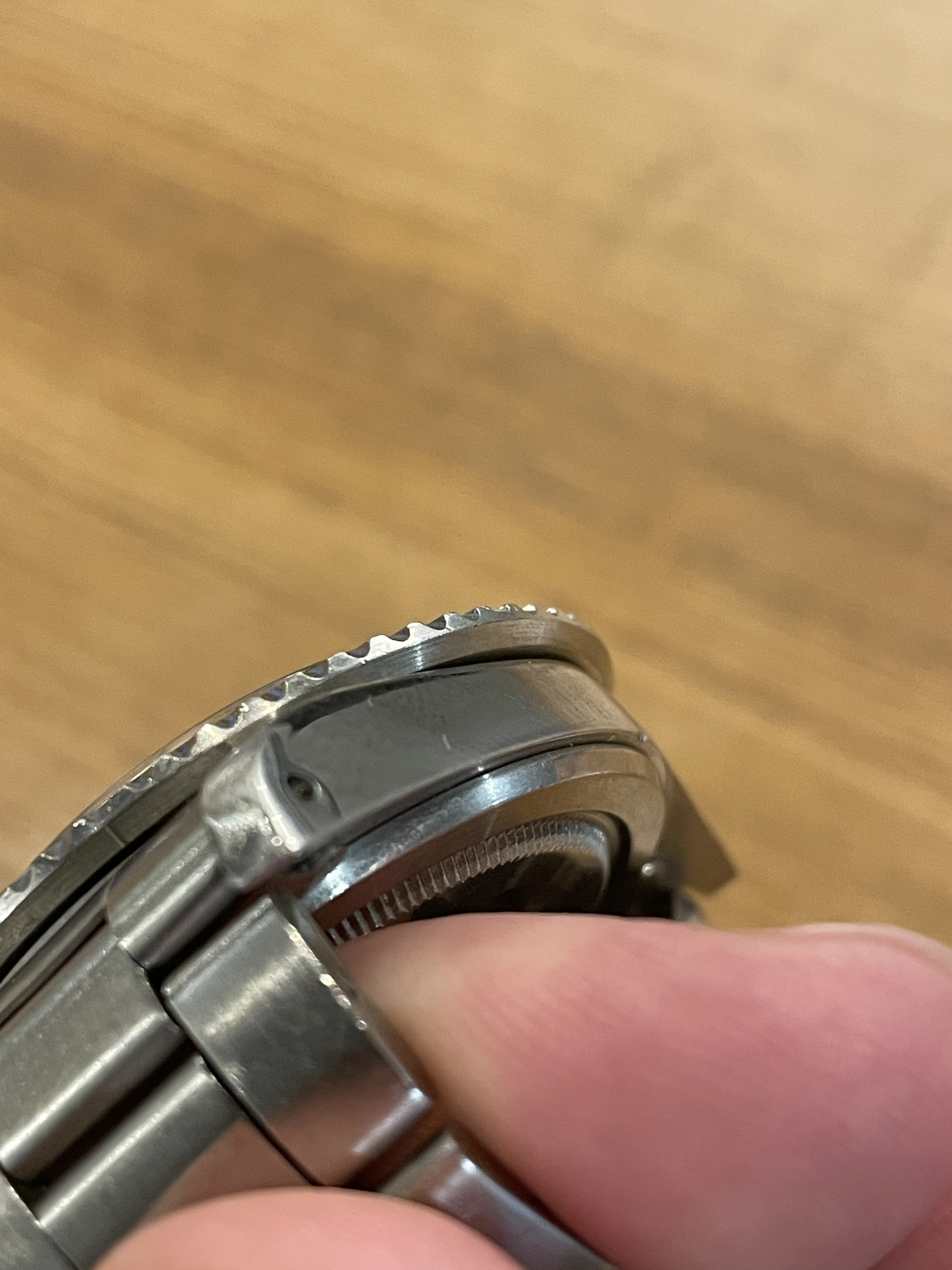

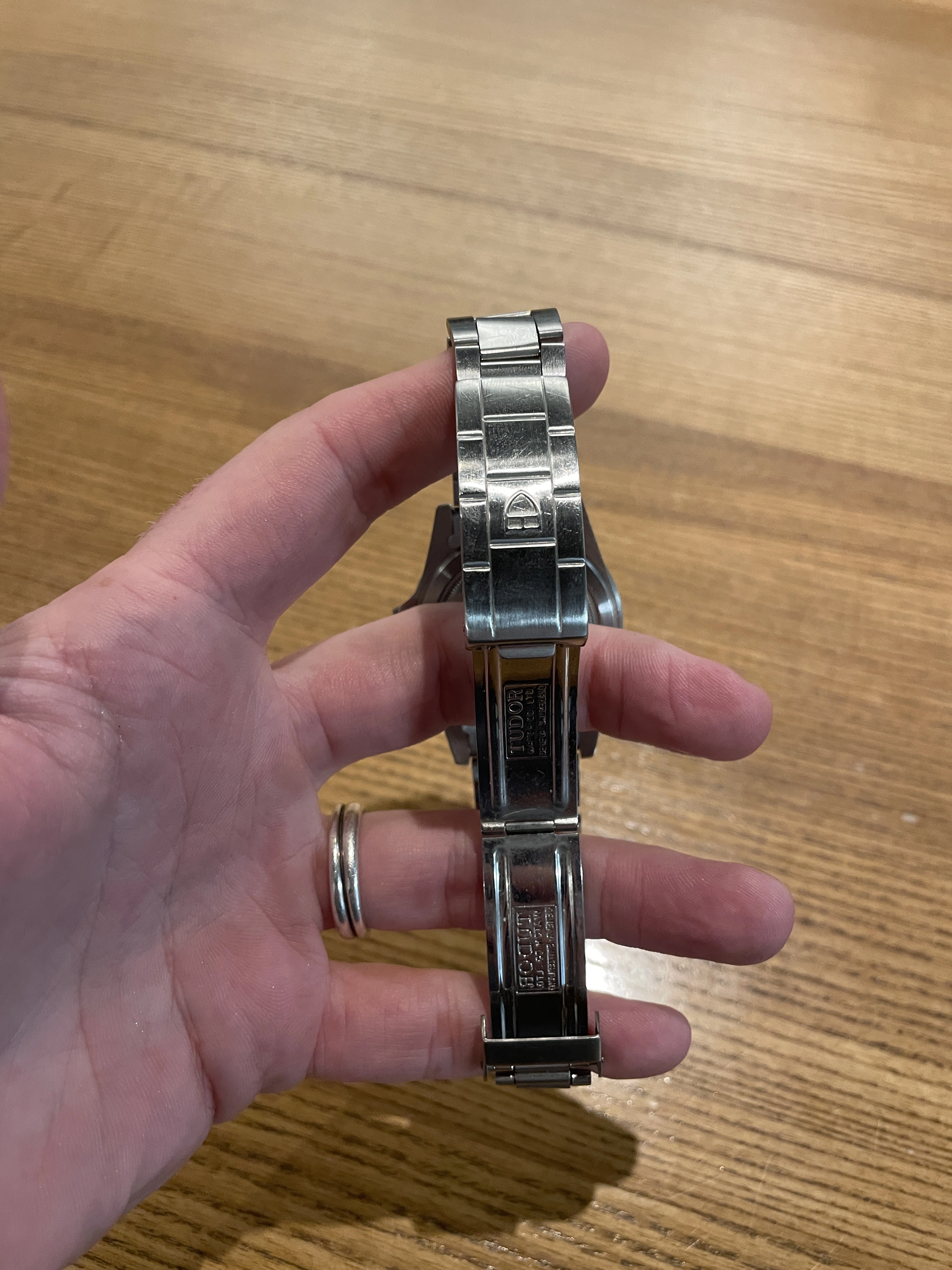

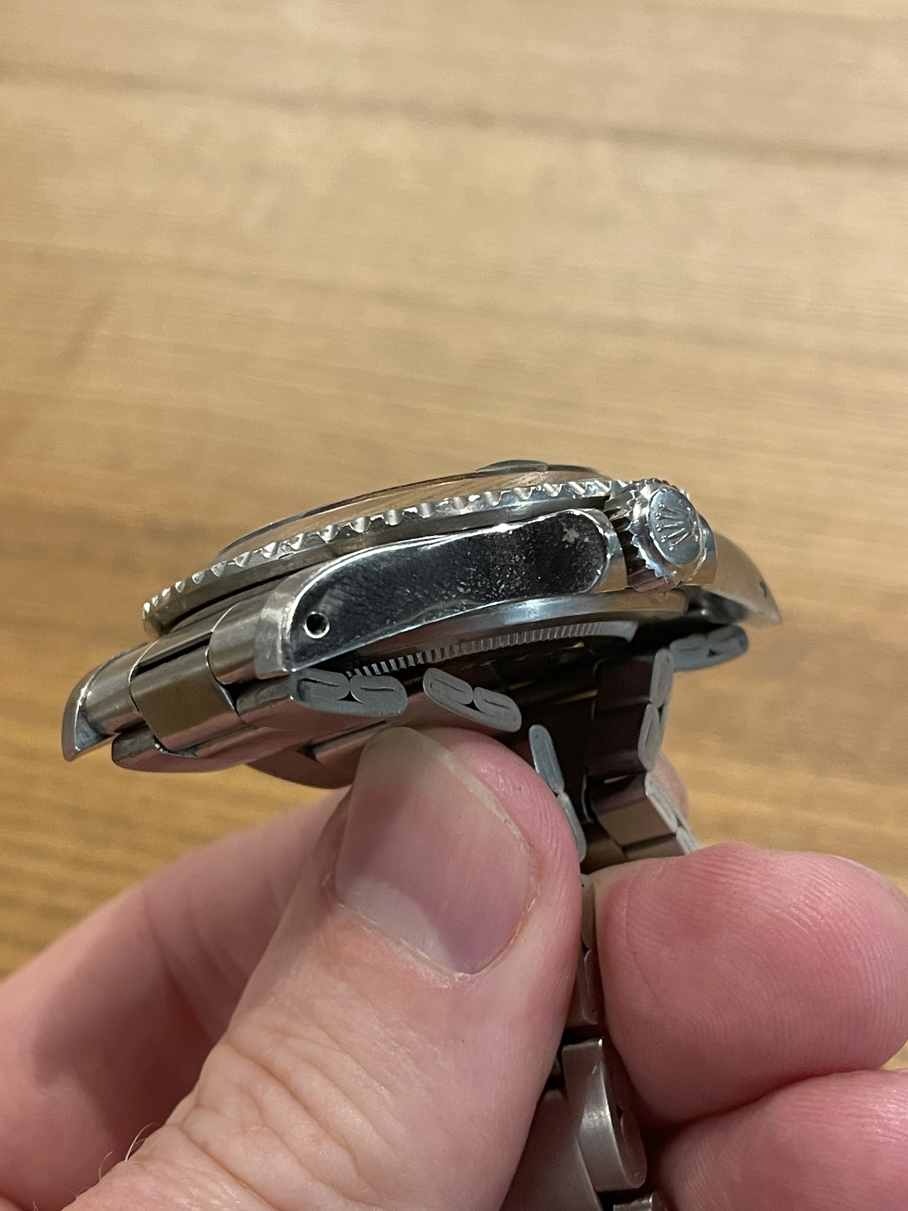

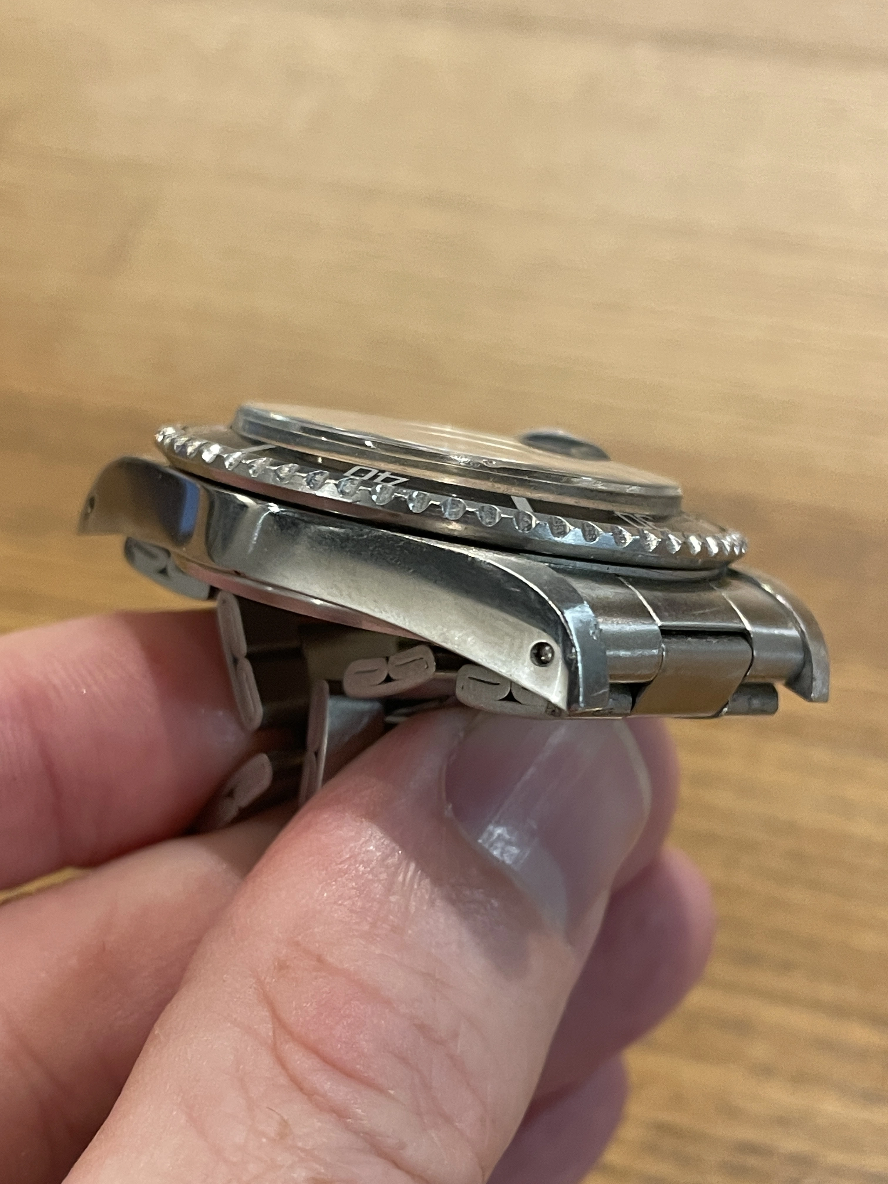

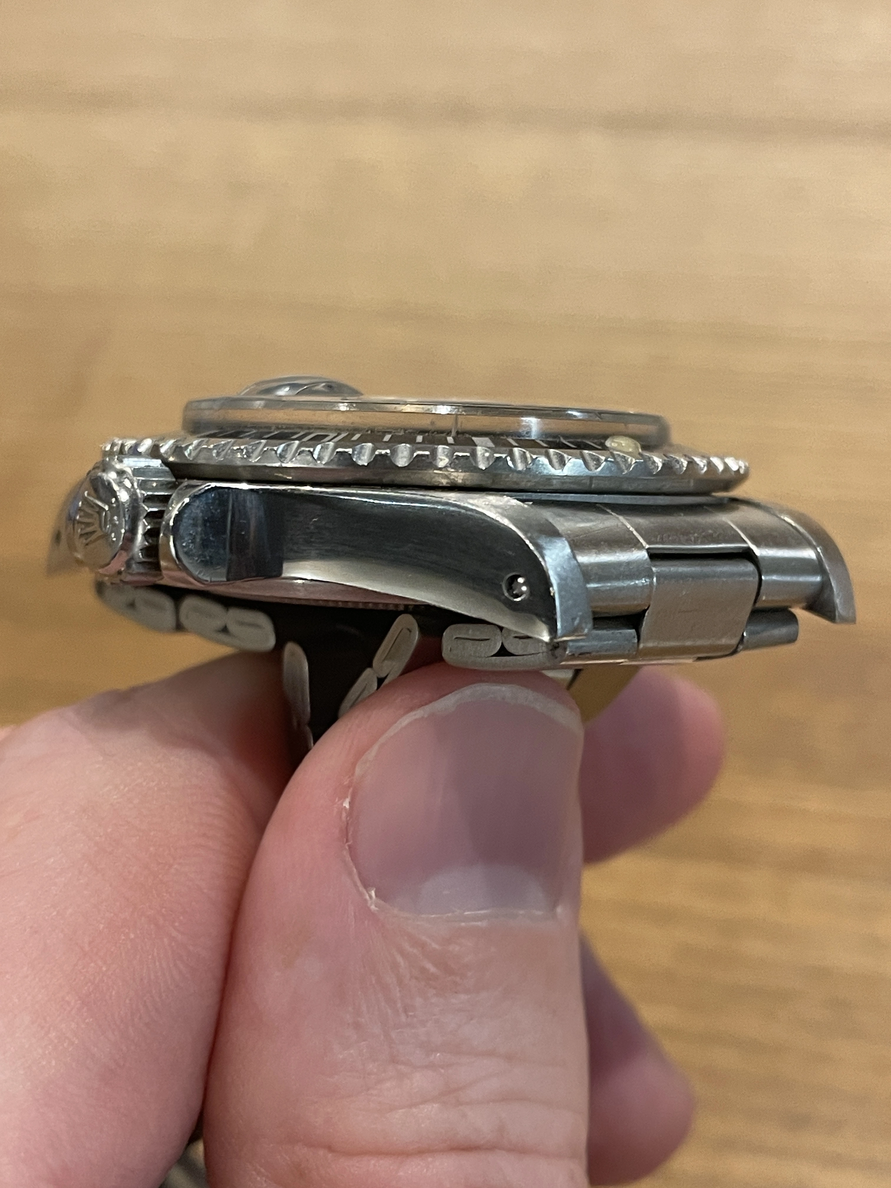

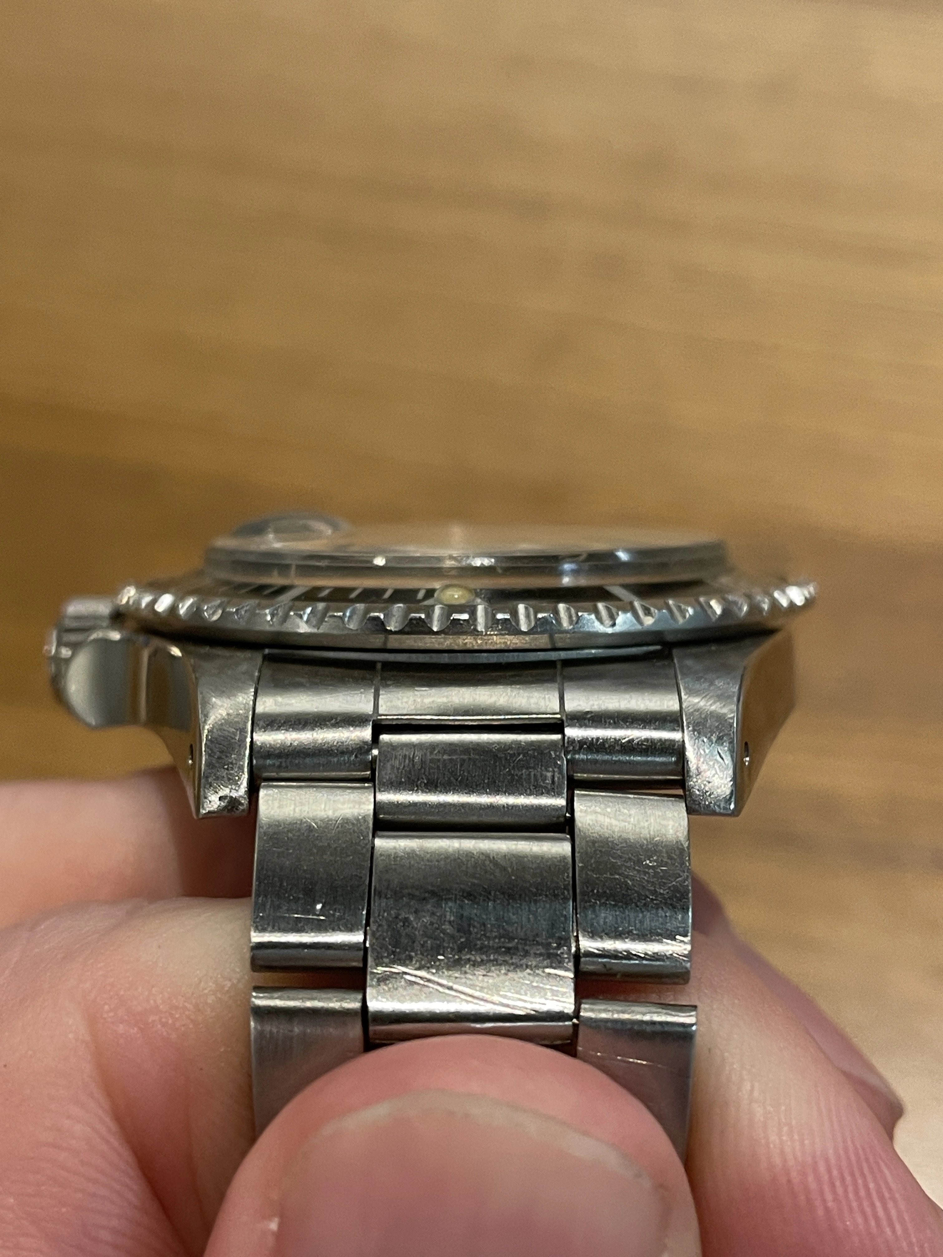

Regarding the first watch OP posted, I would say that the case has some funny business going on, the chamfers are cut way too thick. Like an early 5513 or 1675.
460
1,108

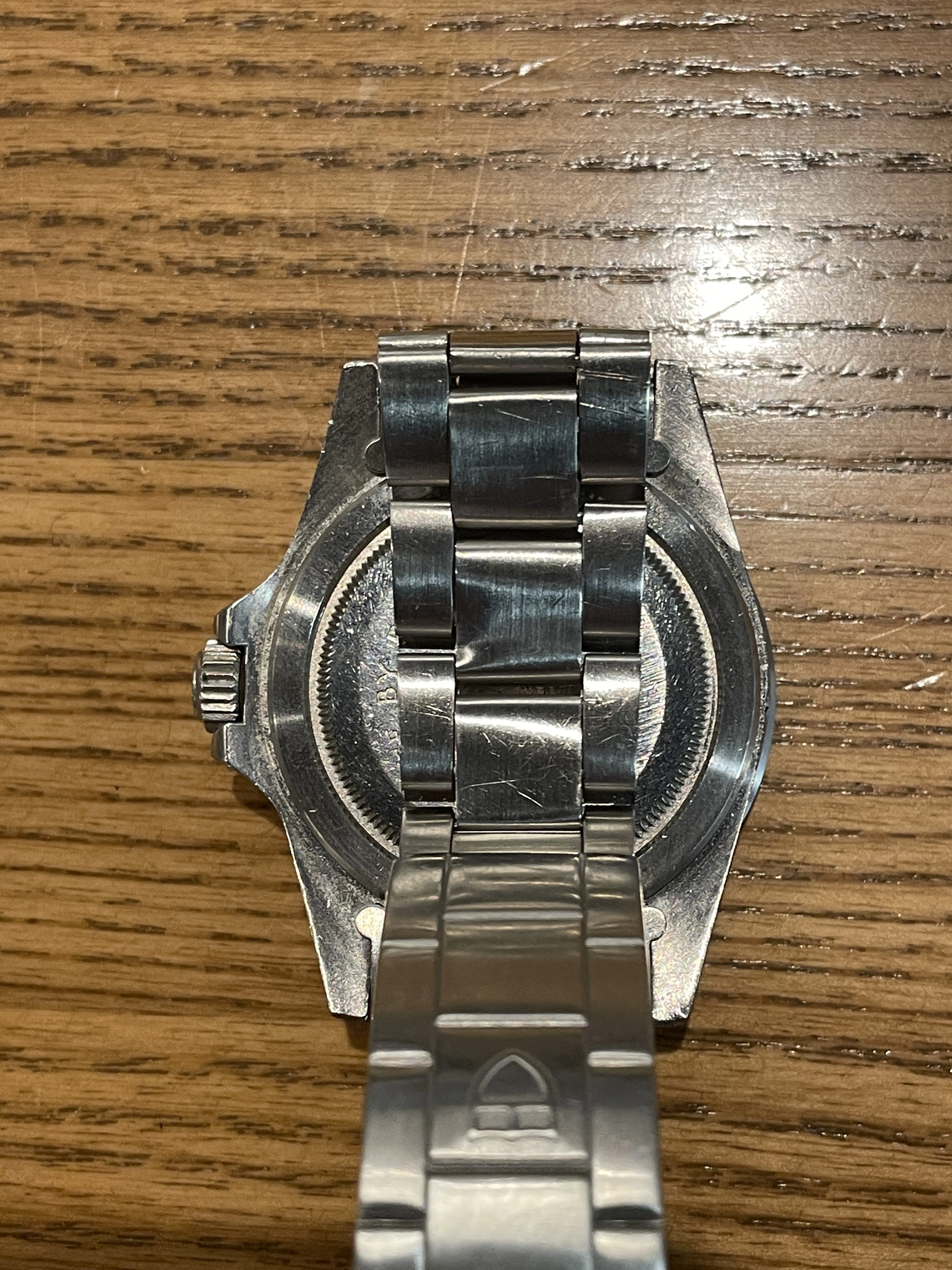

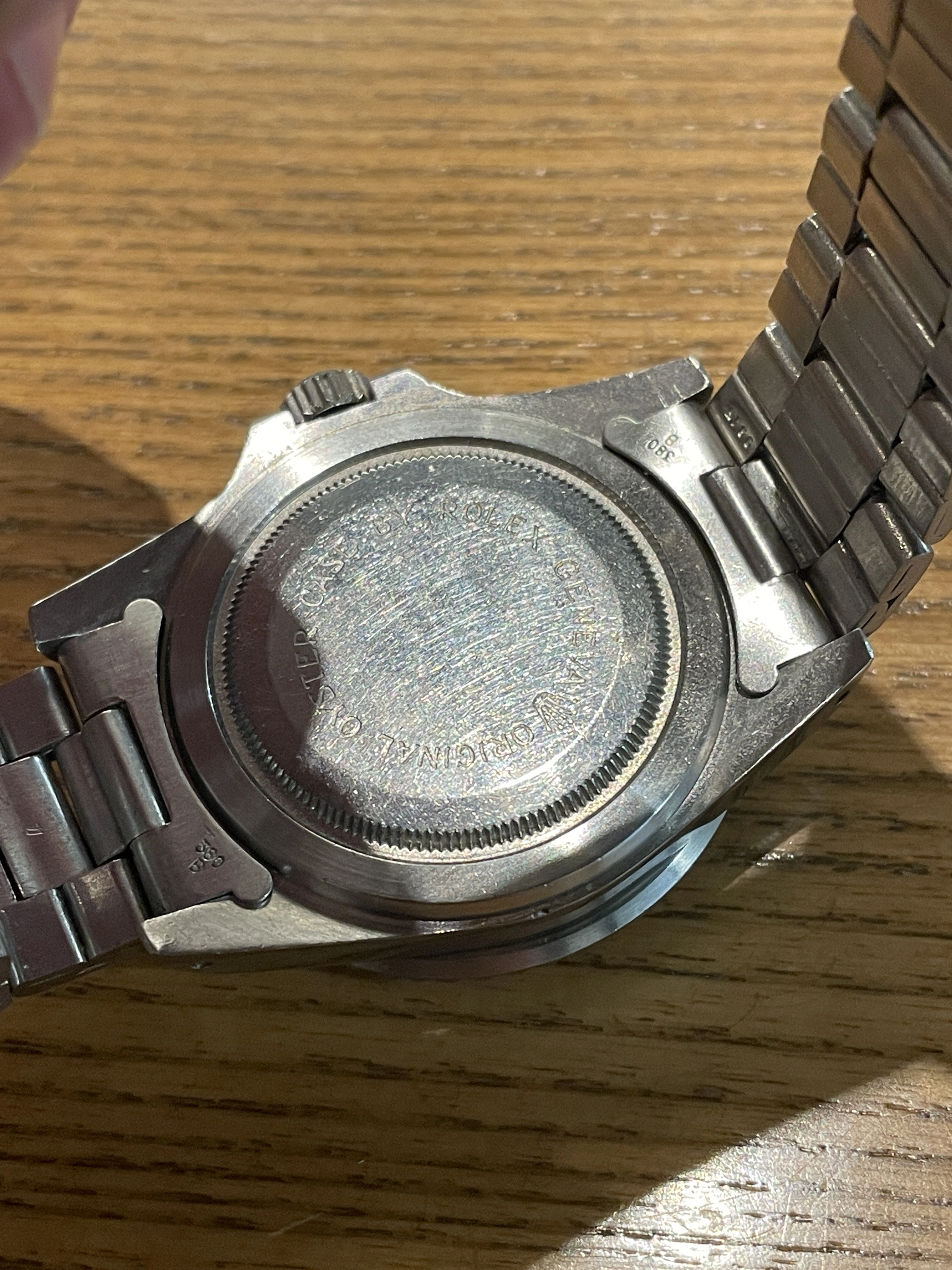

Not at all an expert, but this watch has too many red flags. I've never seen a 76100 with the T Swiss Made T placed where it is here, and the caseback, as noted, is incorrect.
Wes, they did this with the latter dials close to the end of the production run. I want to say it started in 1993 and went to 1997. So DEFINITELY wrong for a 76100, but would be accurate on say a 1993 79090.
