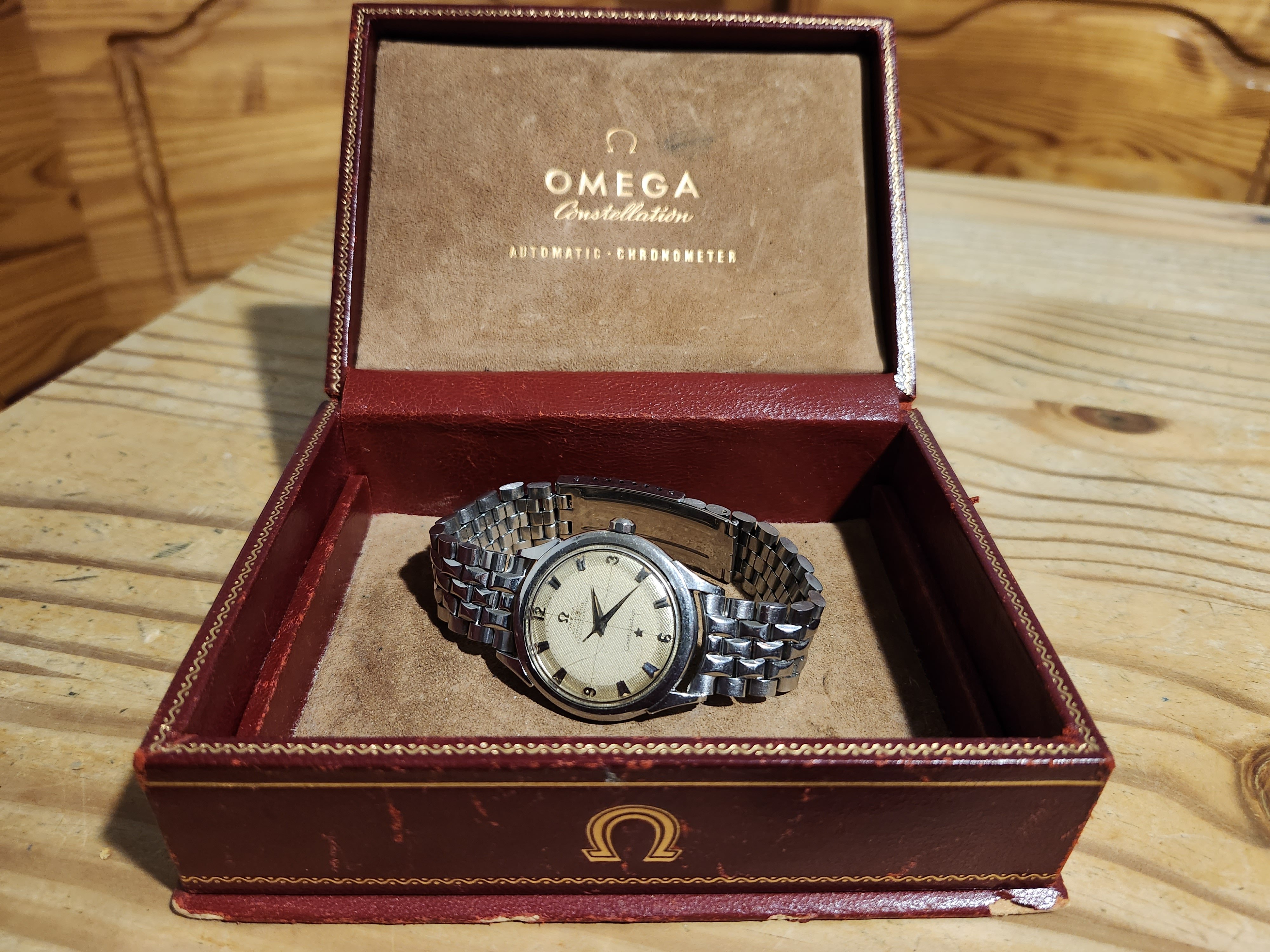

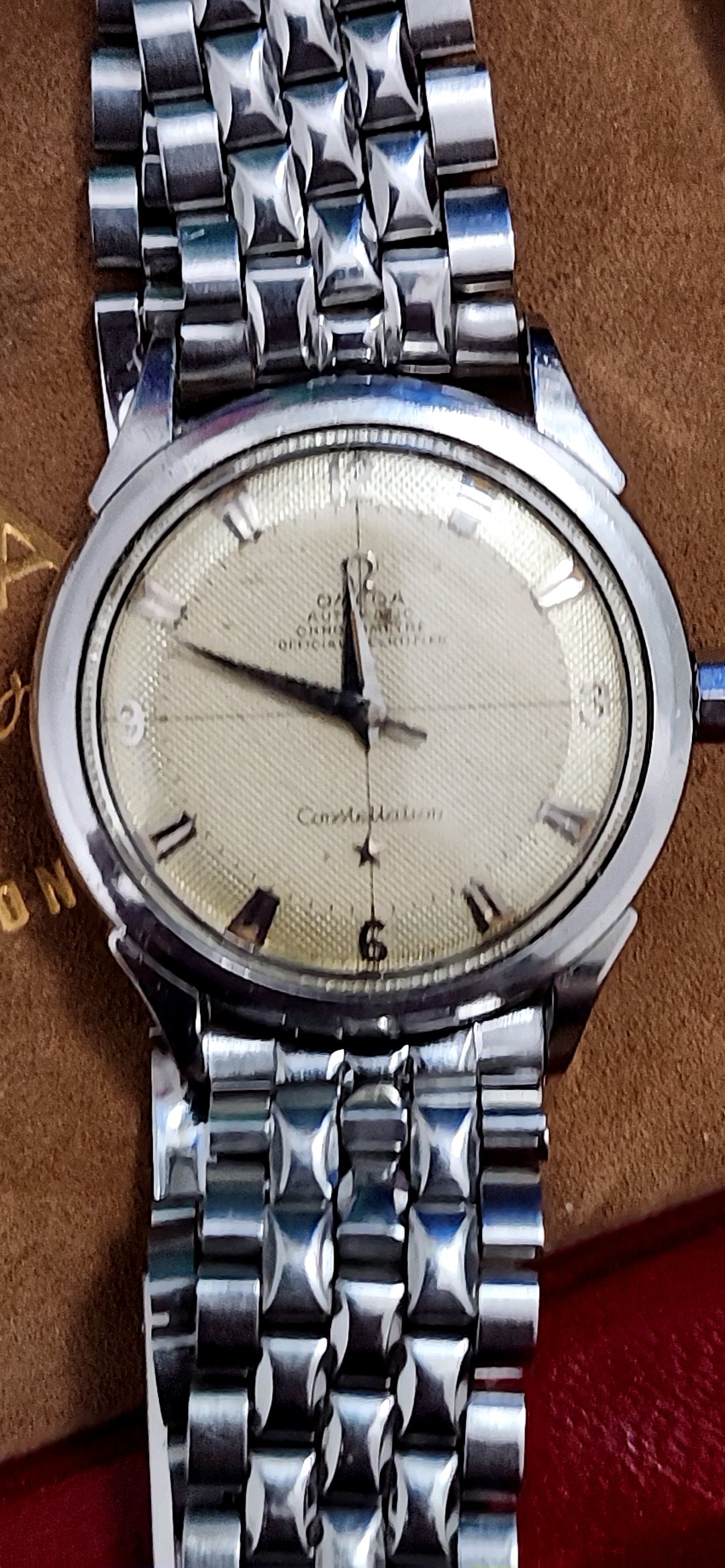

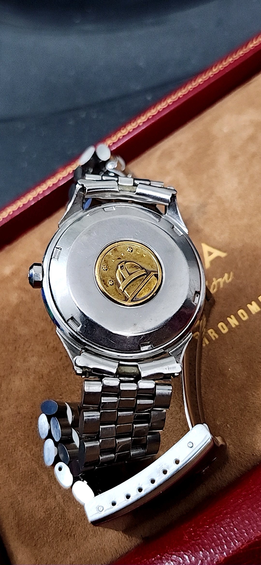

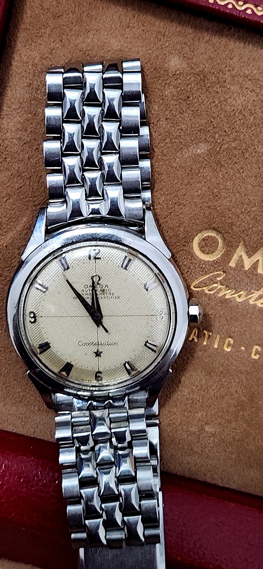

Hello all,
New to the forum here and looking for some help.

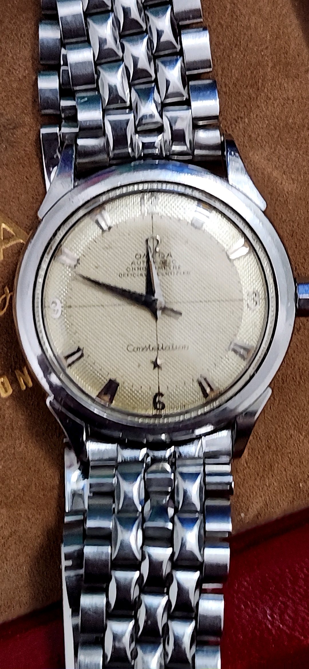

I have an vintage Constellation from my dad when he passed away many years ago and hoping someone can help identify it and let me know if its worth getting fixed.
I know nothing of this watch, or that it existed. As a small child I remember my dad showing me a Seamaster with the seahorse on the caseback which I wanted but never new about this watch. When he passed the seamaster was not found, perhaps he sold it, don't know for sure.
The watch runs but the seconds hand is stuck to the hour hand and both move as one. The bracelet doesn't seem original as the clasp has a "JB" logo.

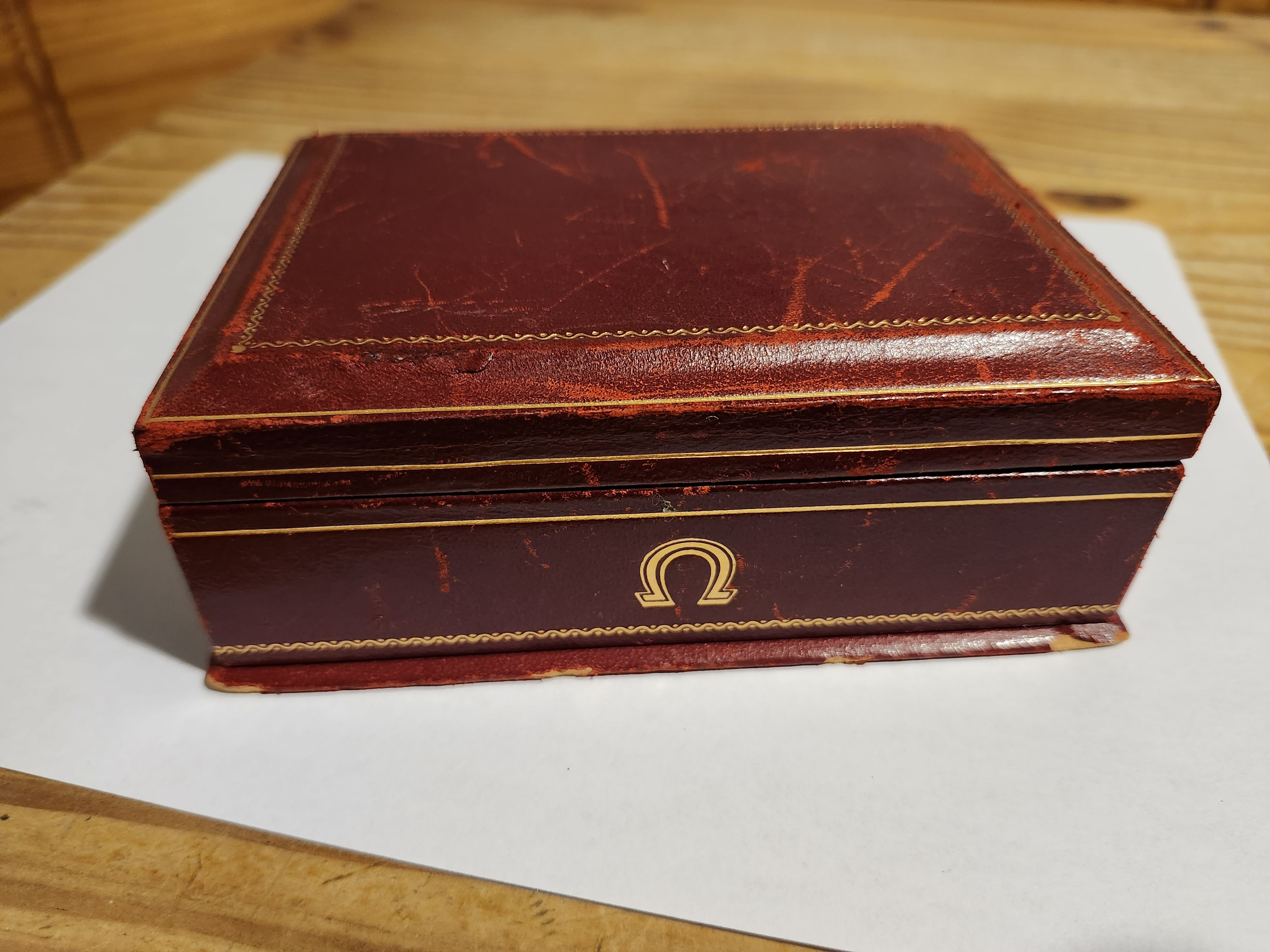

The watch was in a small red cigar style box with Omega name on the inside. Is it worth getting repaired is my question or leave it as a keepsake.
24,833
55,246

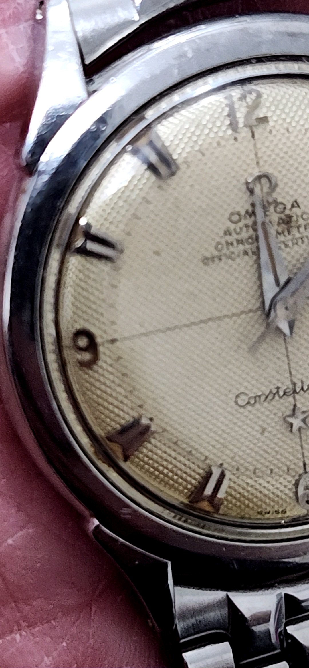

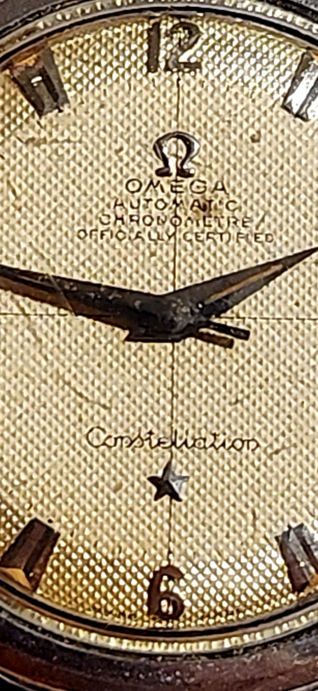

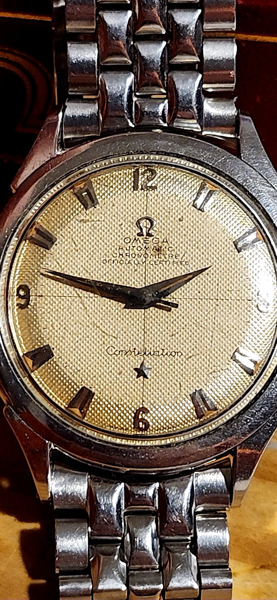

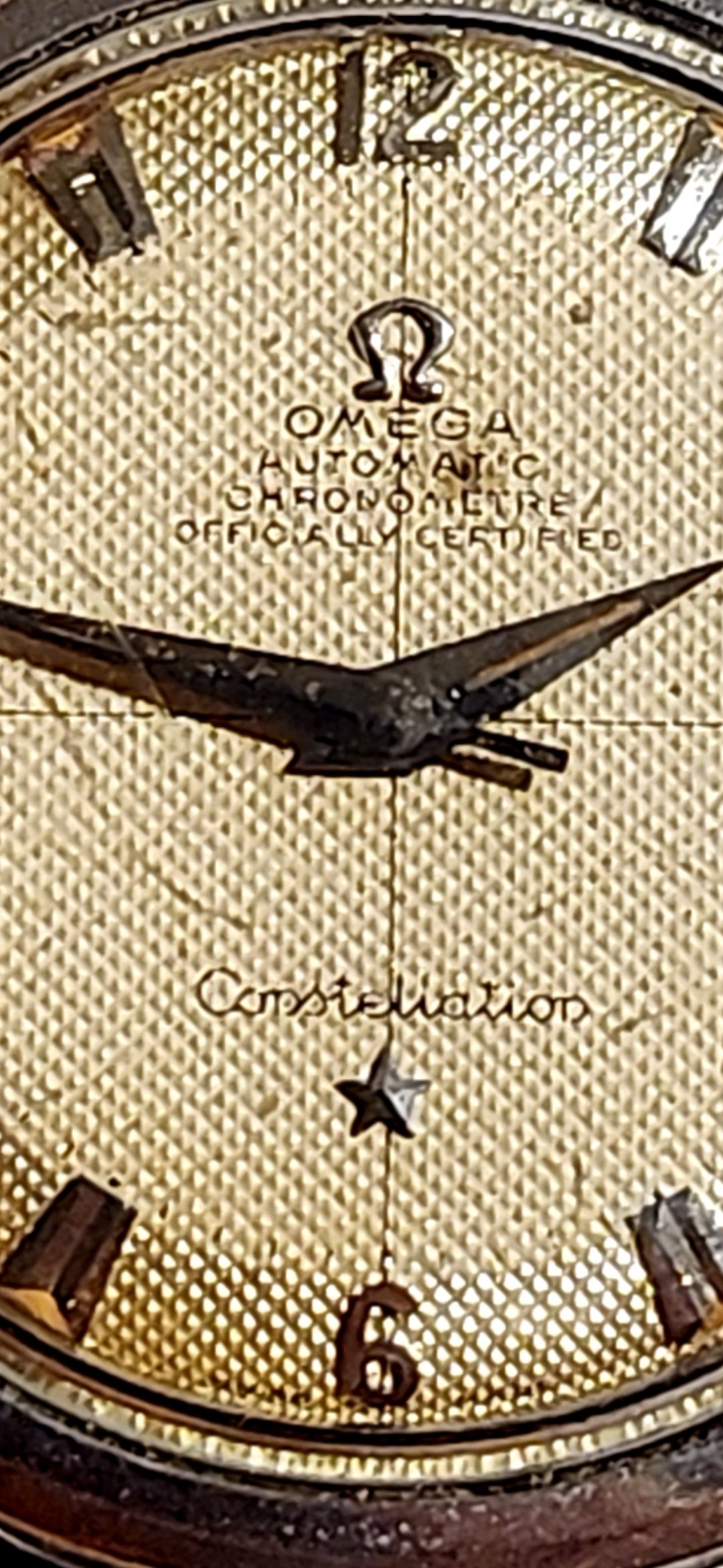

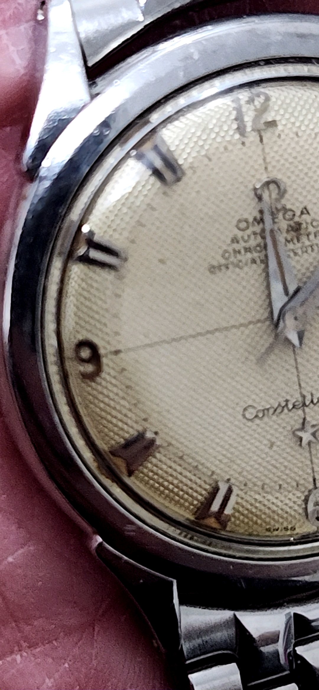

The photos are too blurry for us to be able to evaluate the originality of the dial. If you want us to do that, then take good clear photos of the dial when the hands are not blocking the printing.
However, original or not, it's really your choice. If you think you would use it, then it's certainly worth having repaired. If you don't plan to wear it, then just put it aside and hold onto it. The watch can always be repaired in the future.
BTW, the sweep seconds hand is stuck on the minute hand, not the hour hand, which would be very unexpected.
The nice brick-link JB Champion bracelet was added at some point, as you suggested.
461
412
Seems to me that this watch is certainly worth to be put back in shape ... in addition to be sentimentally important ..
5,026
18,607

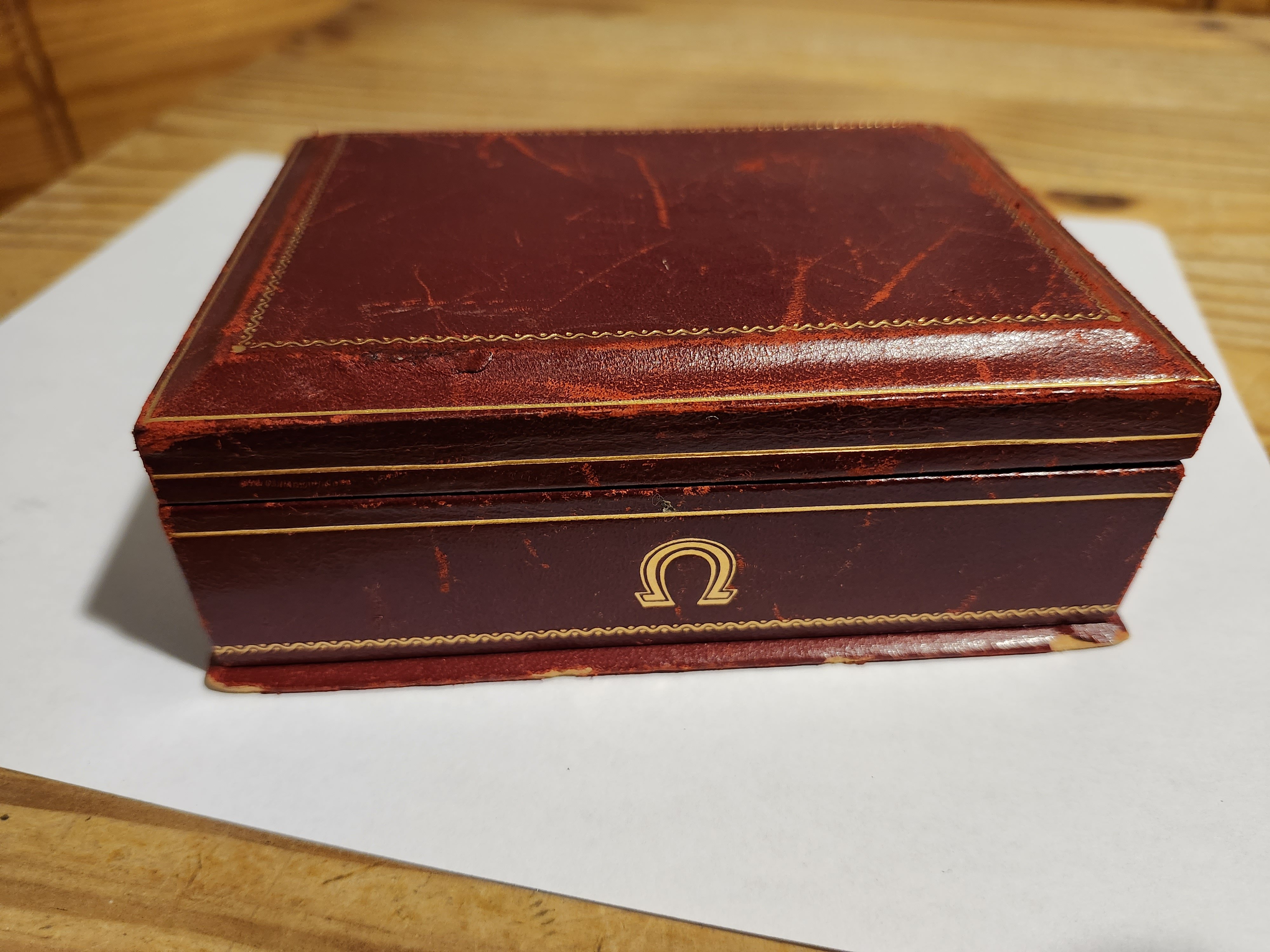

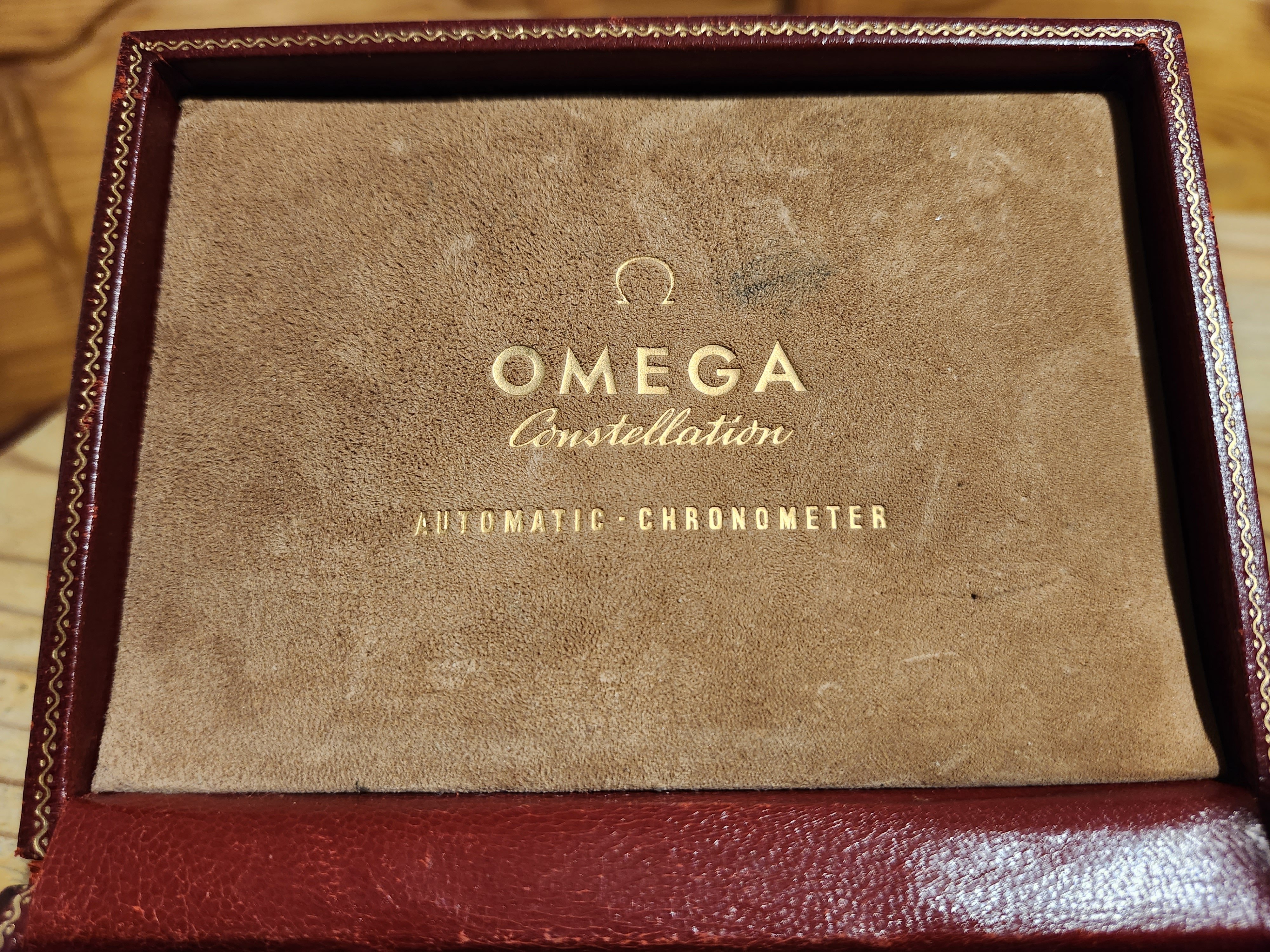

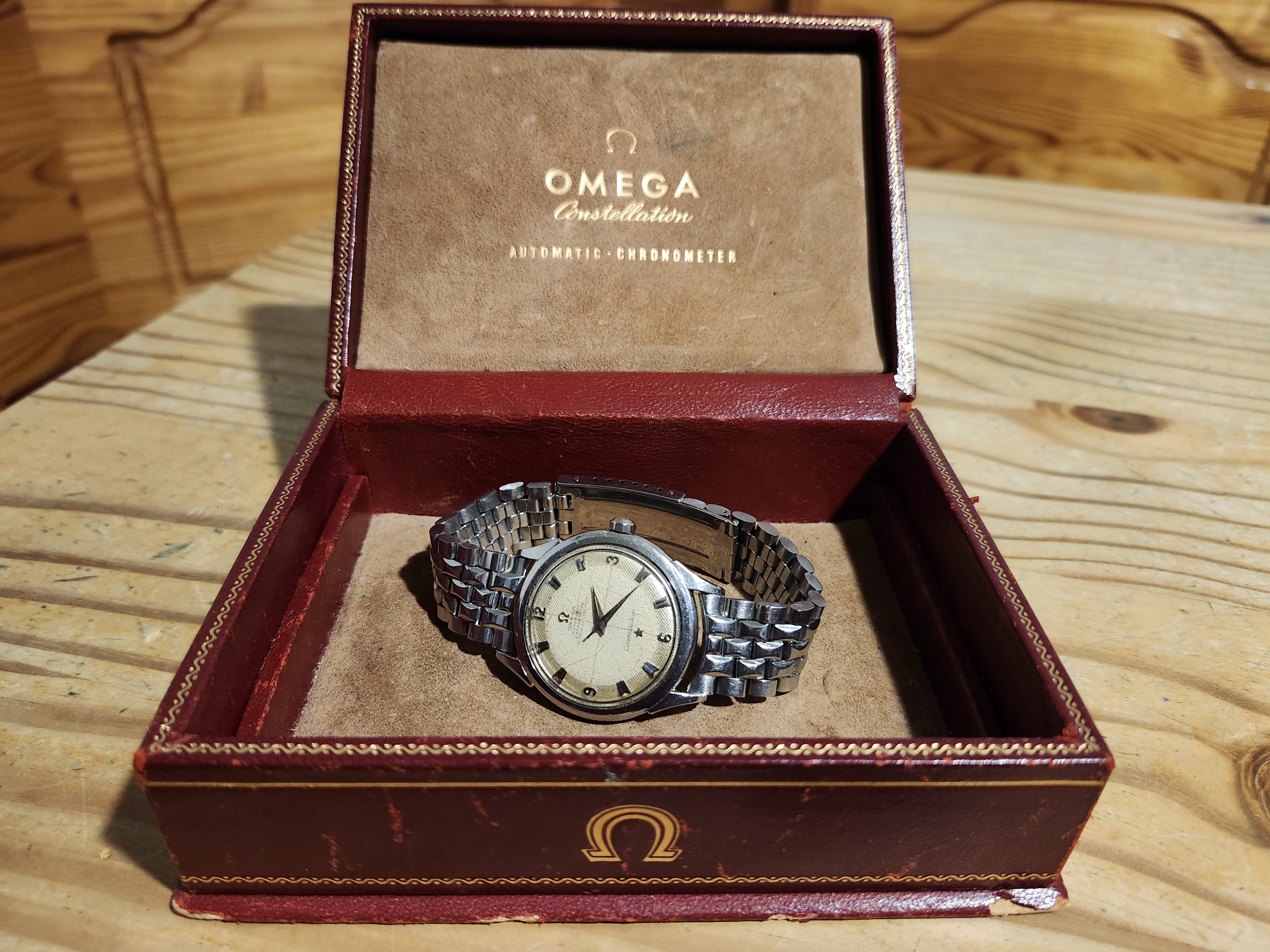

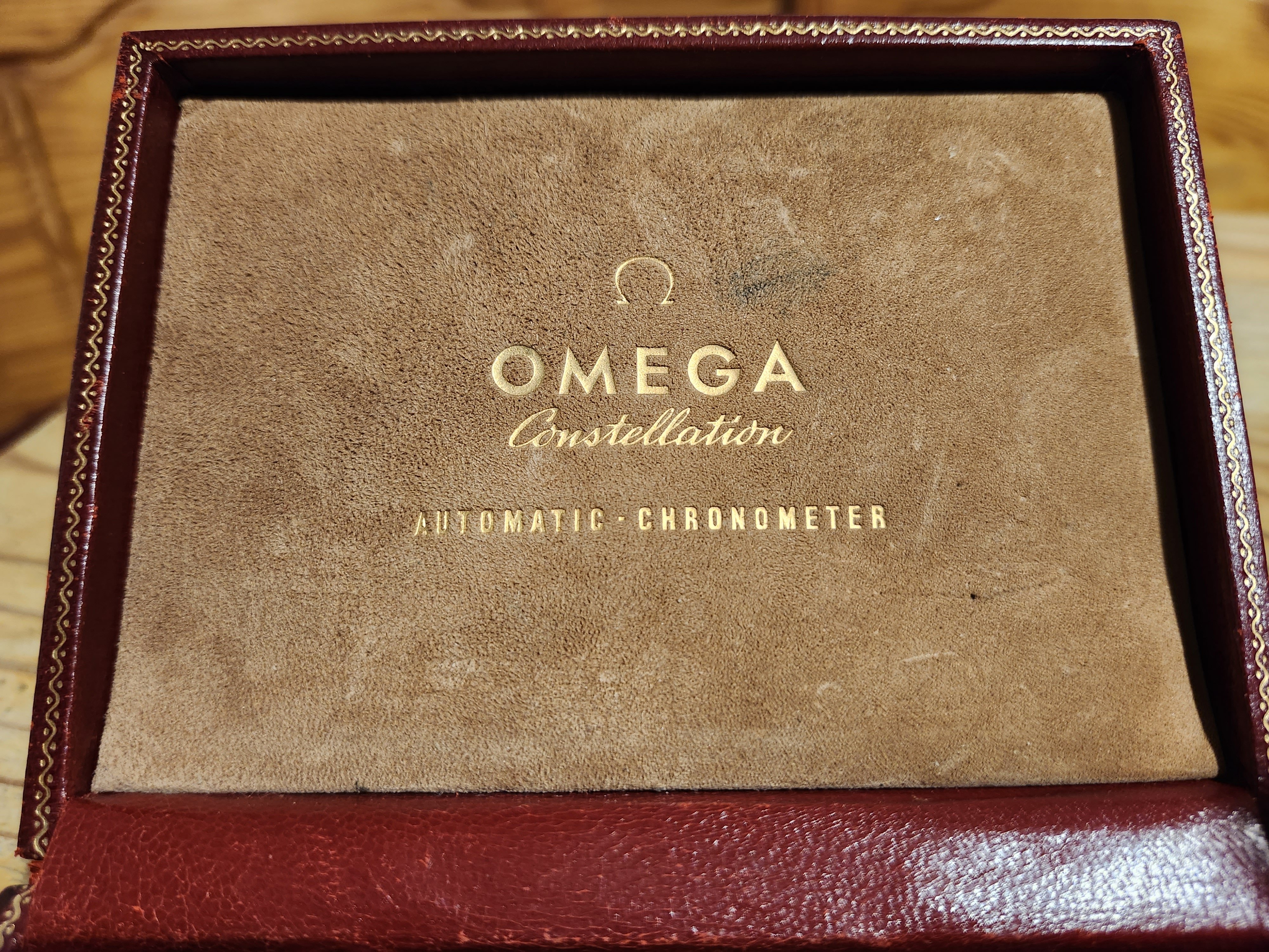

This could be a very attractive watch and it looks to be original. I can also see the original constellation box underneath the watch. Could you send pictures of this?

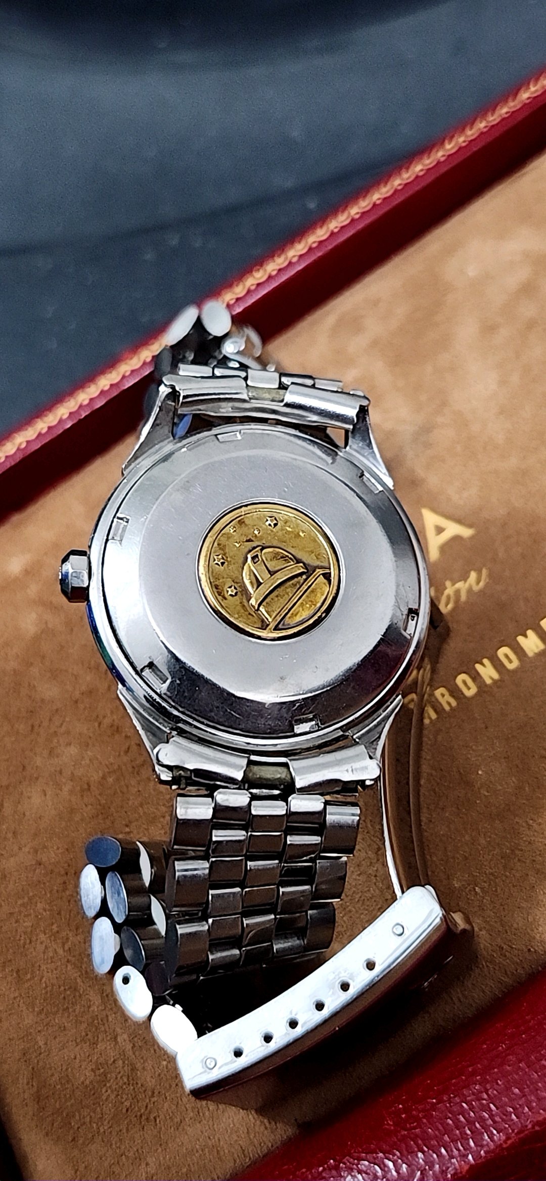

Just get it serviced. The watchmaker can open this watch and then you know which model it it. It could be a 2852 from the late 50's. But others will chime in to give opinions.

I’d say that watch is certainly worth having cleaned up and serviced. It’s a nice vintage Constellation with a good case and what appears to be an original textured dial (although better pics are required to confirm).
A service by a competent watchmaker, crystal polish and case clean (but don’t polish the case) will improve matters tremendously

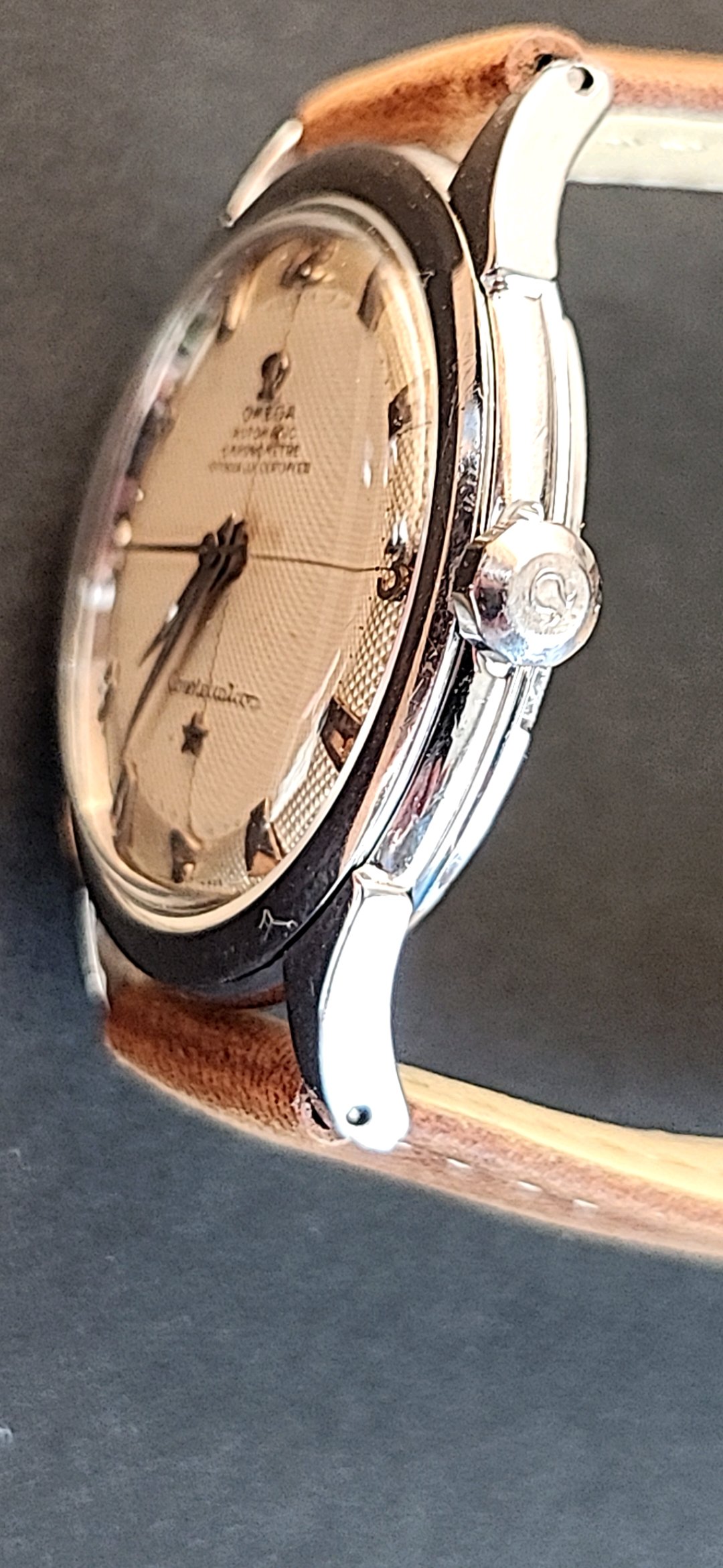

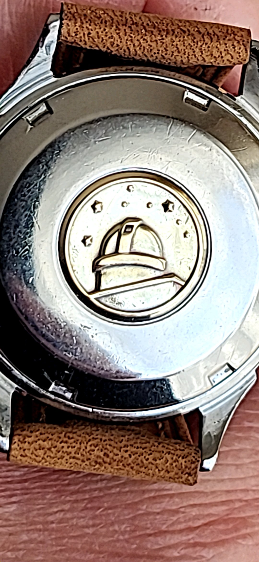

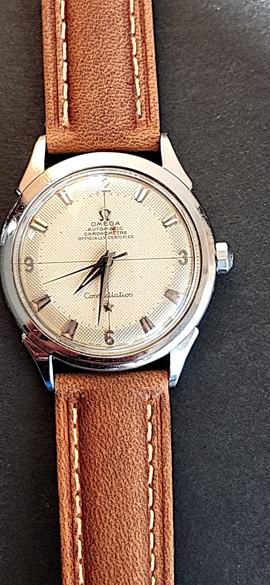

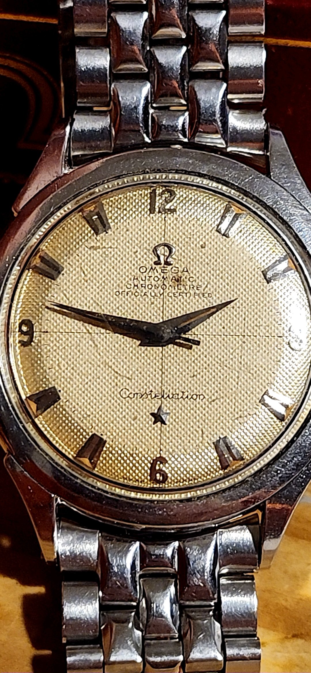

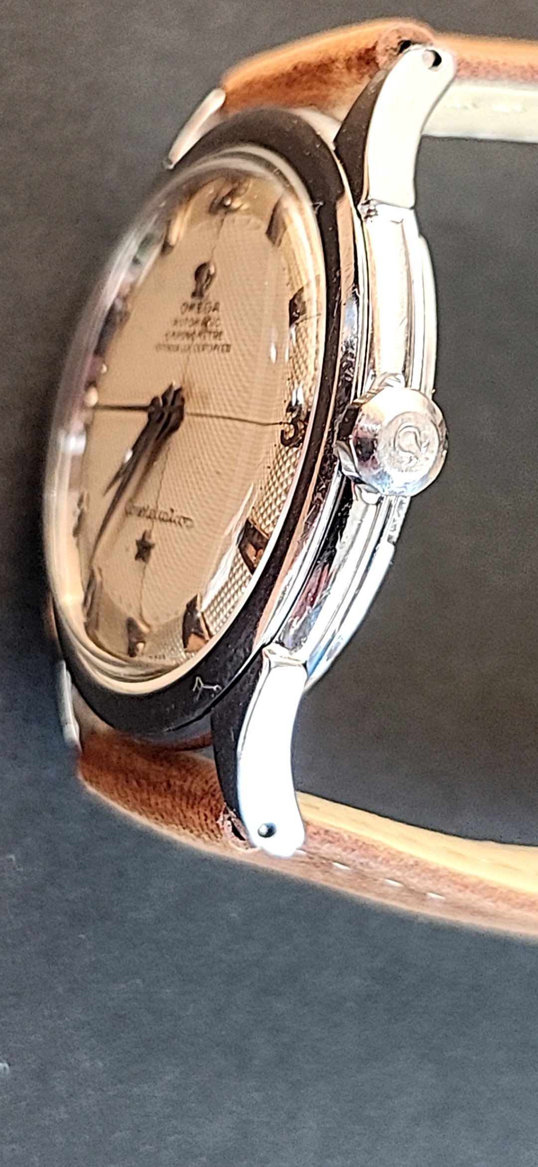

Thanks for the replies. I may just look into getting it repaired, and put a leather strap on it. I've attached some more detailed pics. Would it be advisable to send it in to a authorized repair facility or will any watchmaker do? There is a Swatch group facility near me but reviews aren't to positive. I did use them years ago for a watch that was still under warranty and they fixed the issue but did recommend replacing the bracelet which they claimed had too much play (watch was only 2 months old). Now that I will be paying for service I can imagine I will be at their mercy. Appreciate all the advice.

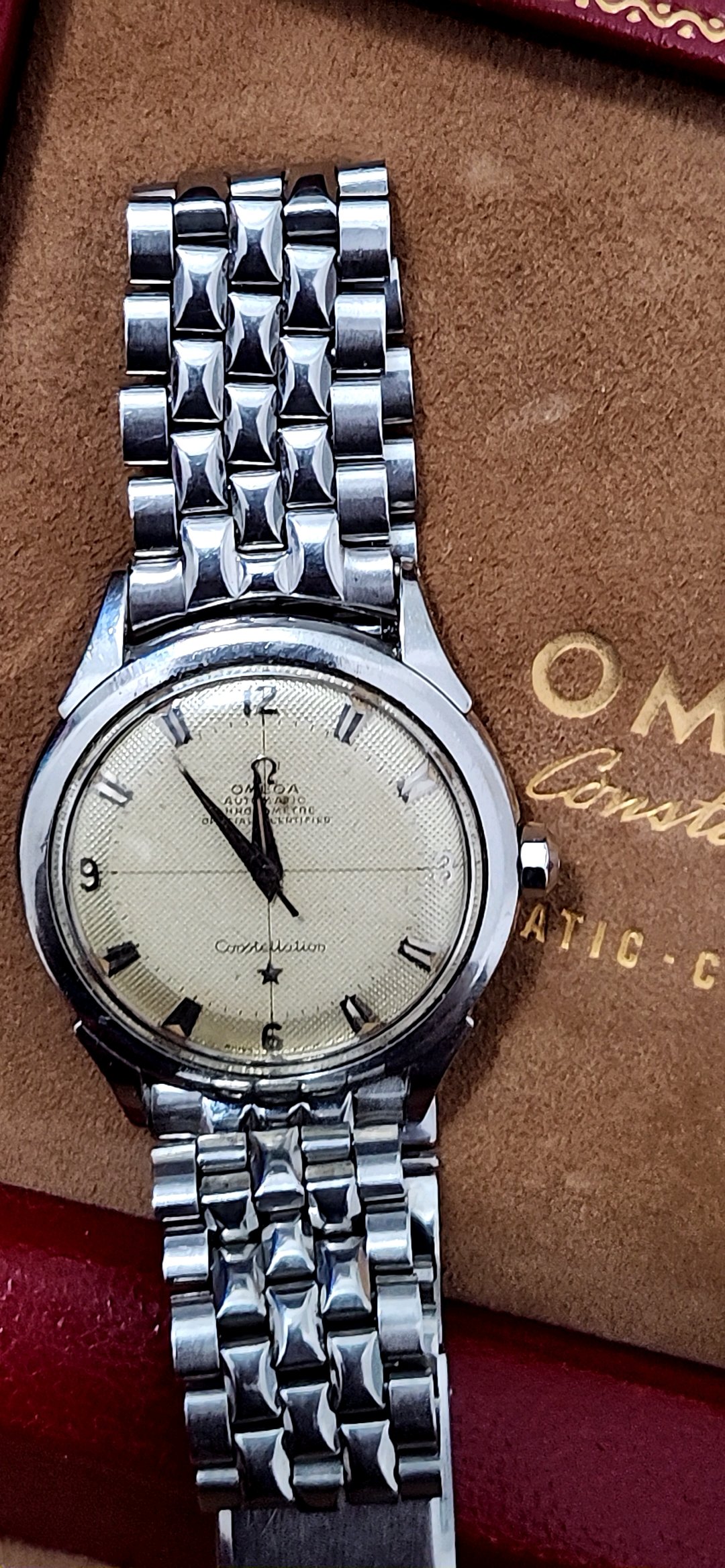

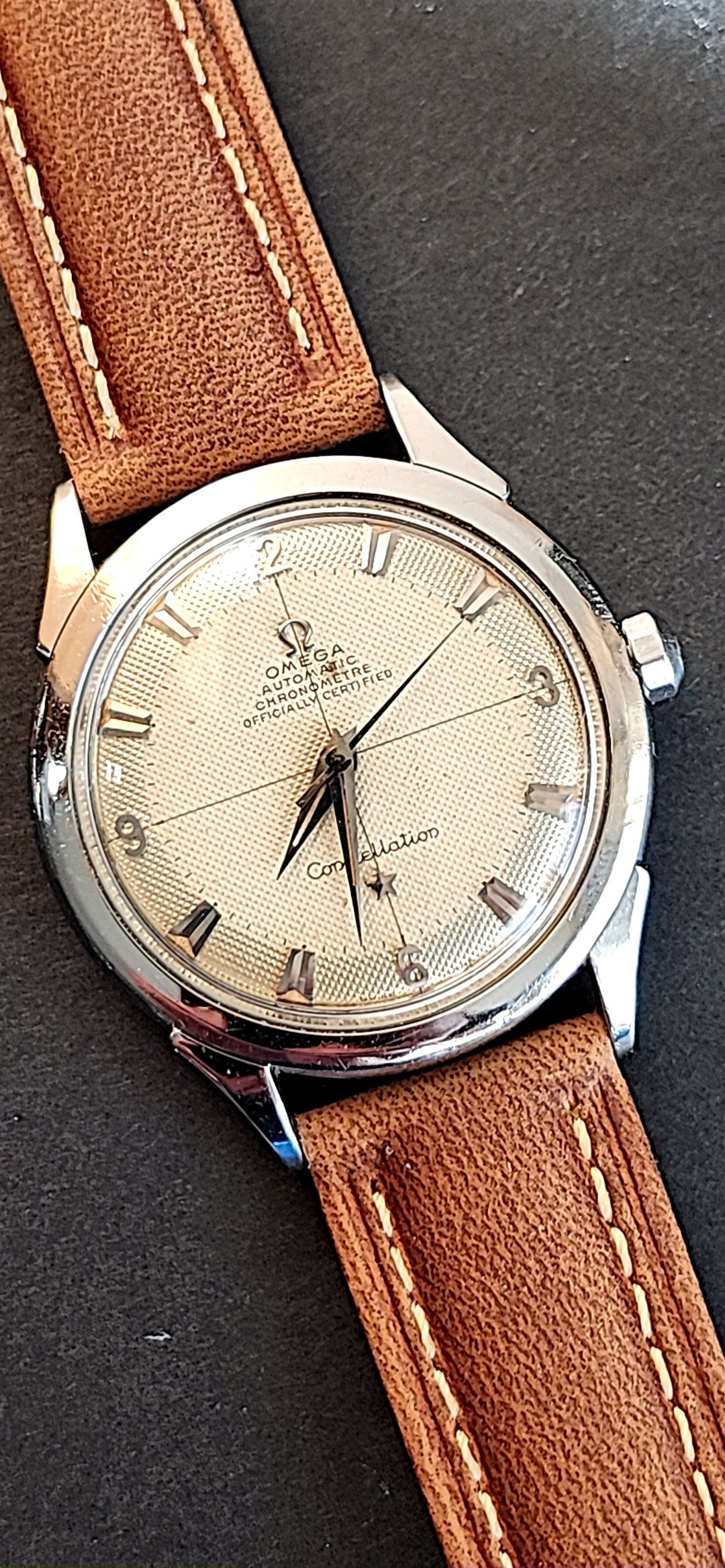

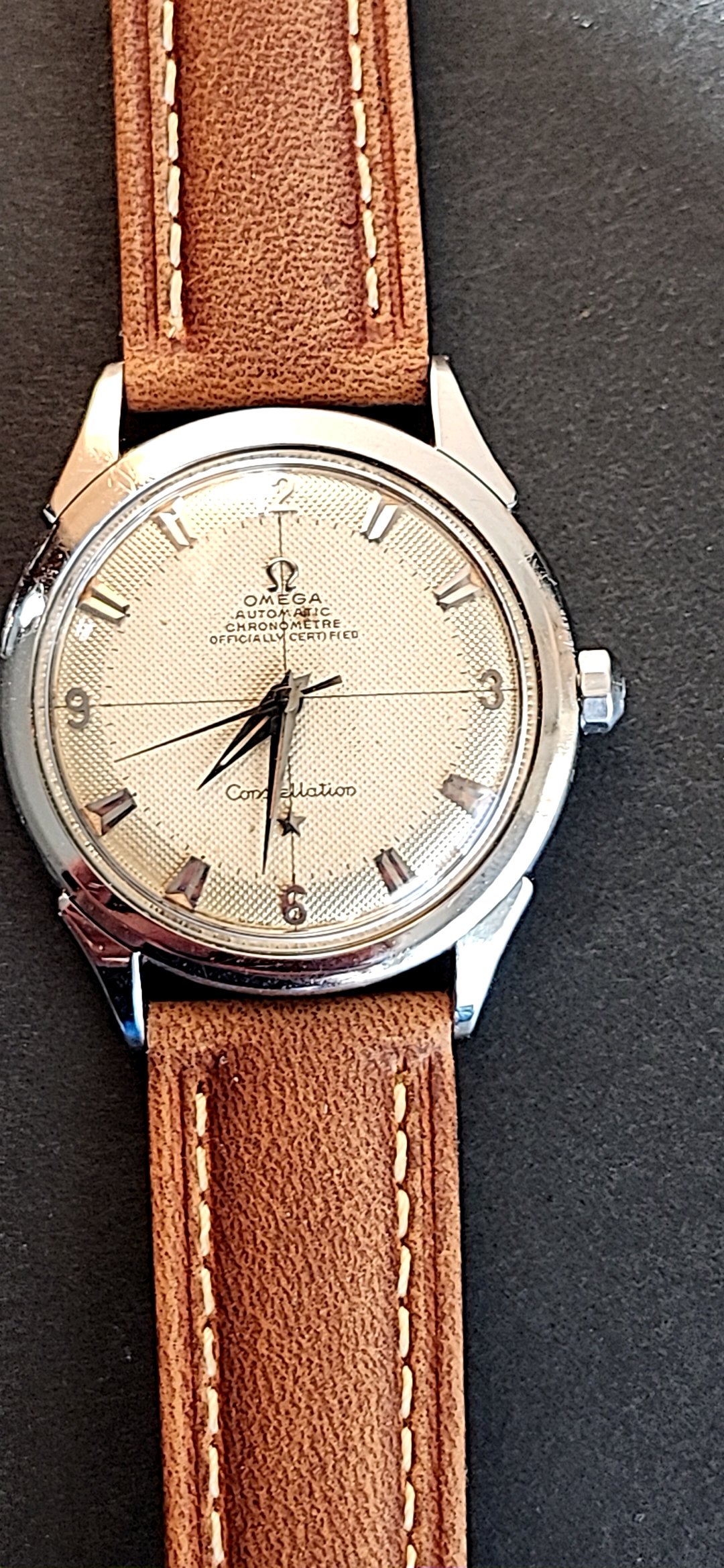

Update...

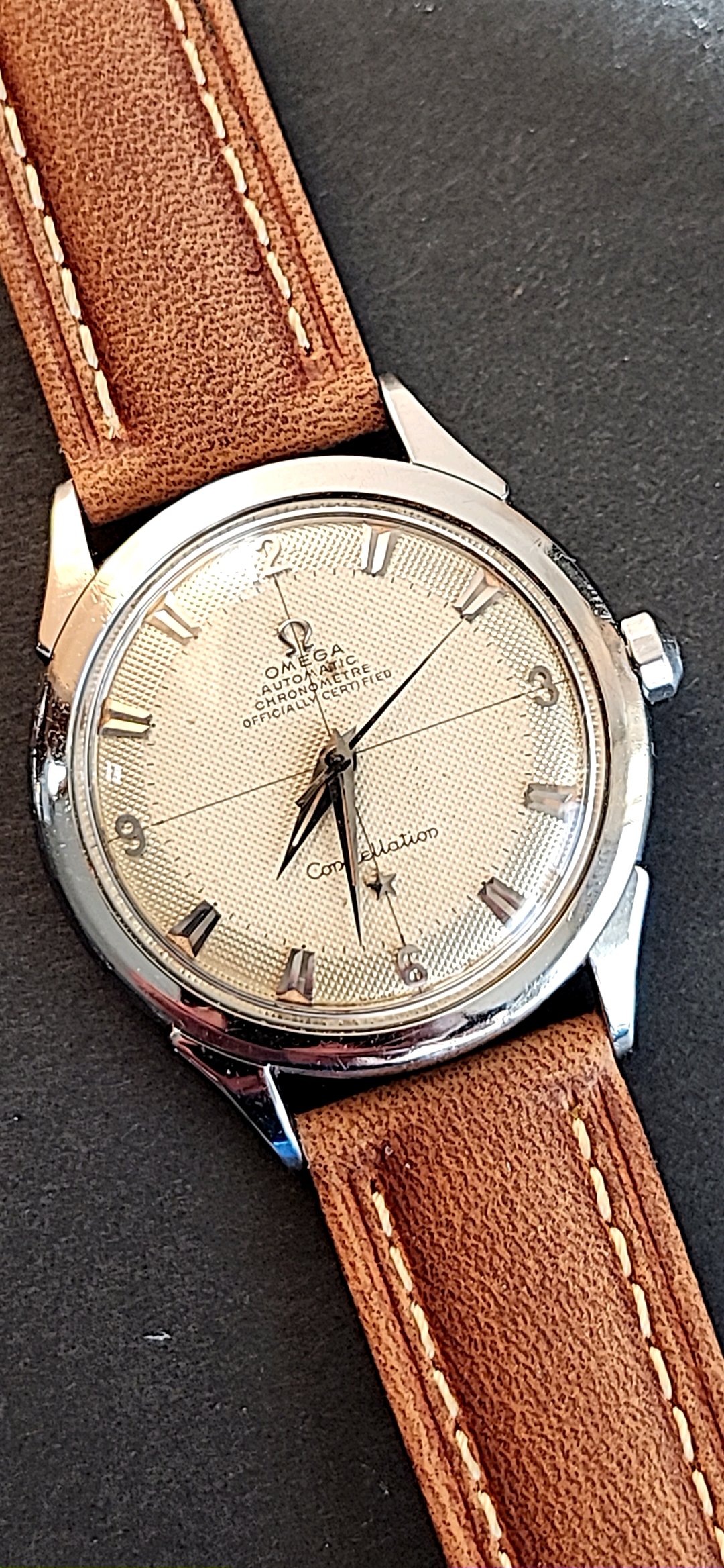

Just got my watch back from Charlie Squires and I am quite pleased with the results. It will definately be my go to dress watch. As noted by Bruce235 turn around time was very quick and the price was much better than I expected. The stain on the dial is still there as Charlie explained removing it might damage the dial. I guess it does help contribute to the patina look. Big difference from the before and after. Charlie dates this watch from the early 50's.
Thanks for every ones advice.
