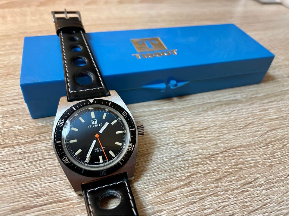

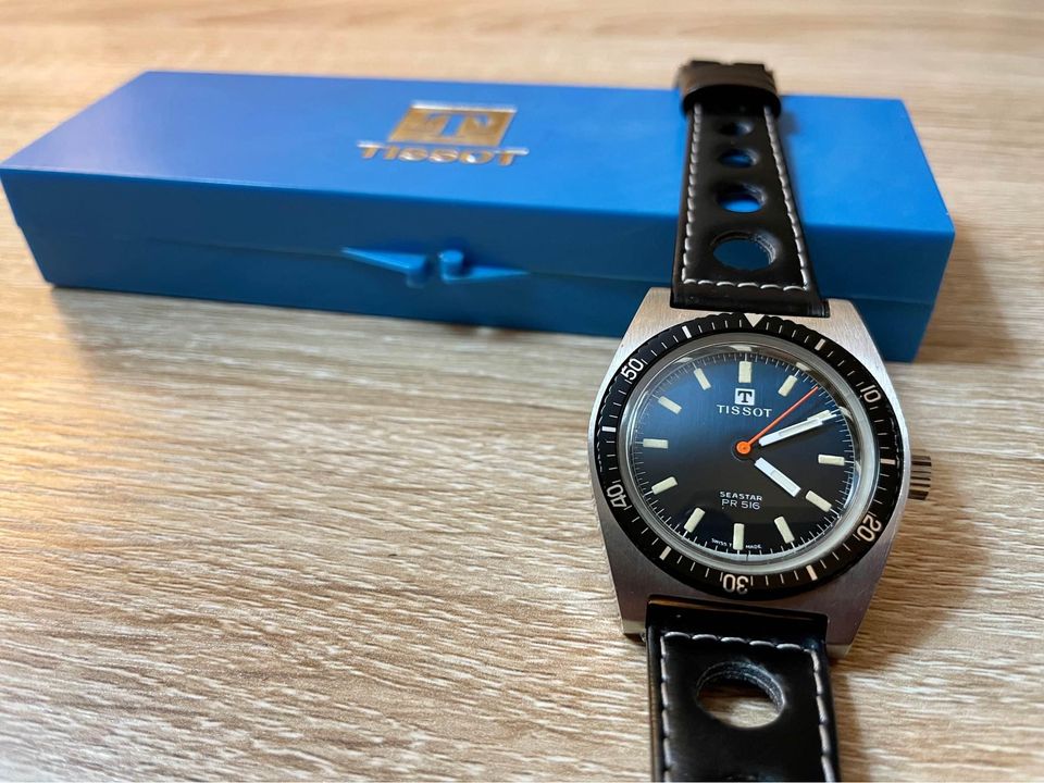

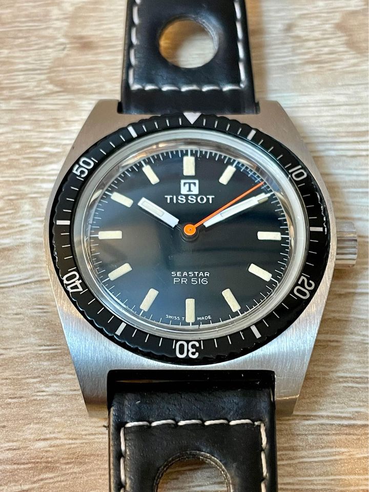

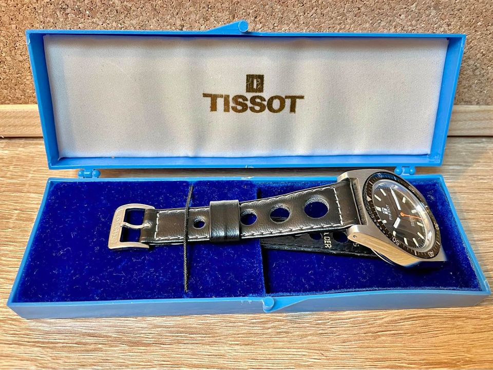

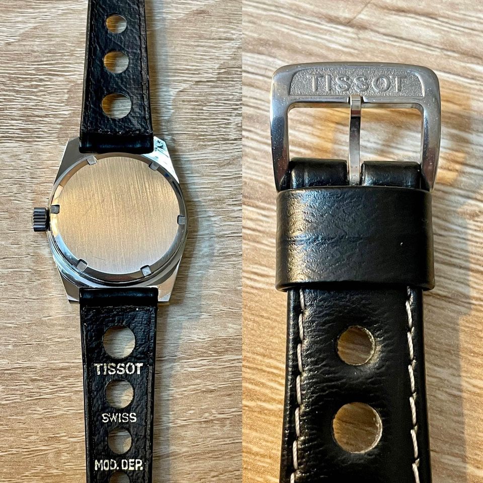

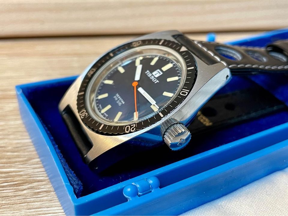

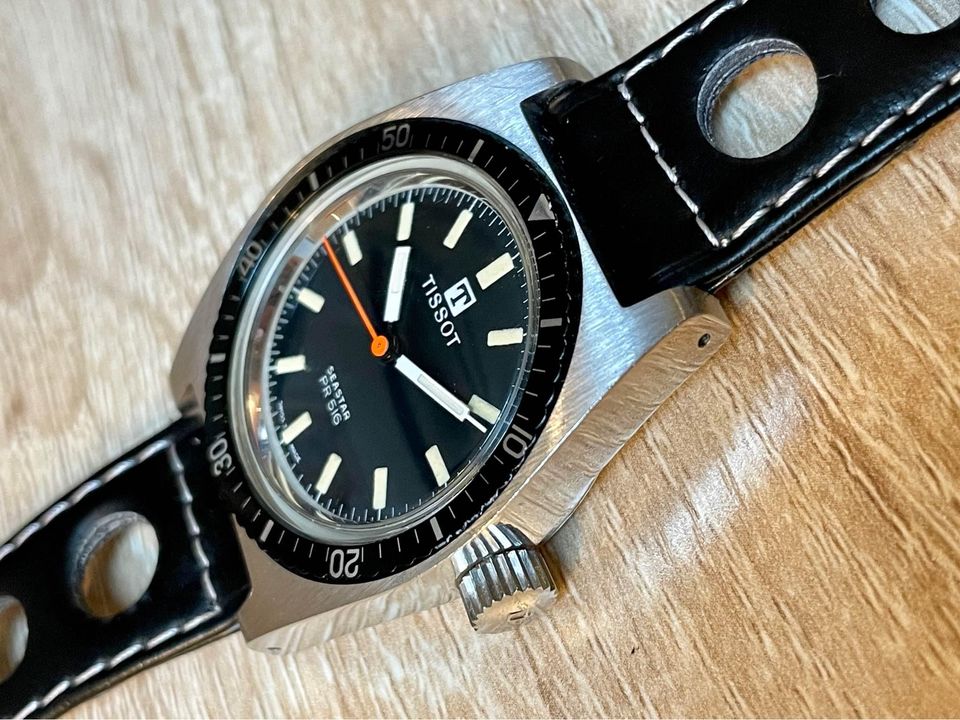

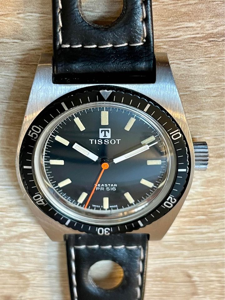

Do you guys think this variation of the PR516 is legit. I havent found anything that look like this. Dial missing Visodate writing, at the bottom the word automatic is missing, caseback looks odd for the model and so on. Also the seller advertise this as hand wound. Isnt it supposed to be automatic movement?Anyone with knowledge of this model that can share his thoughts that would be great because i really like this watch and it is at my price range even tho im not sure what the cost of a nos watch like this one actaually cost .

Not a specialist but as their is no date it is normal that there is no « visodate » written on the dial.
The article on fratello does not mention this version without date that’s true but they aren’t either very conclusive on whic one Moore really wore :
https://www.fratellowatches.com/tbt-the-underrated-bond-tissot-pr-516-watch/

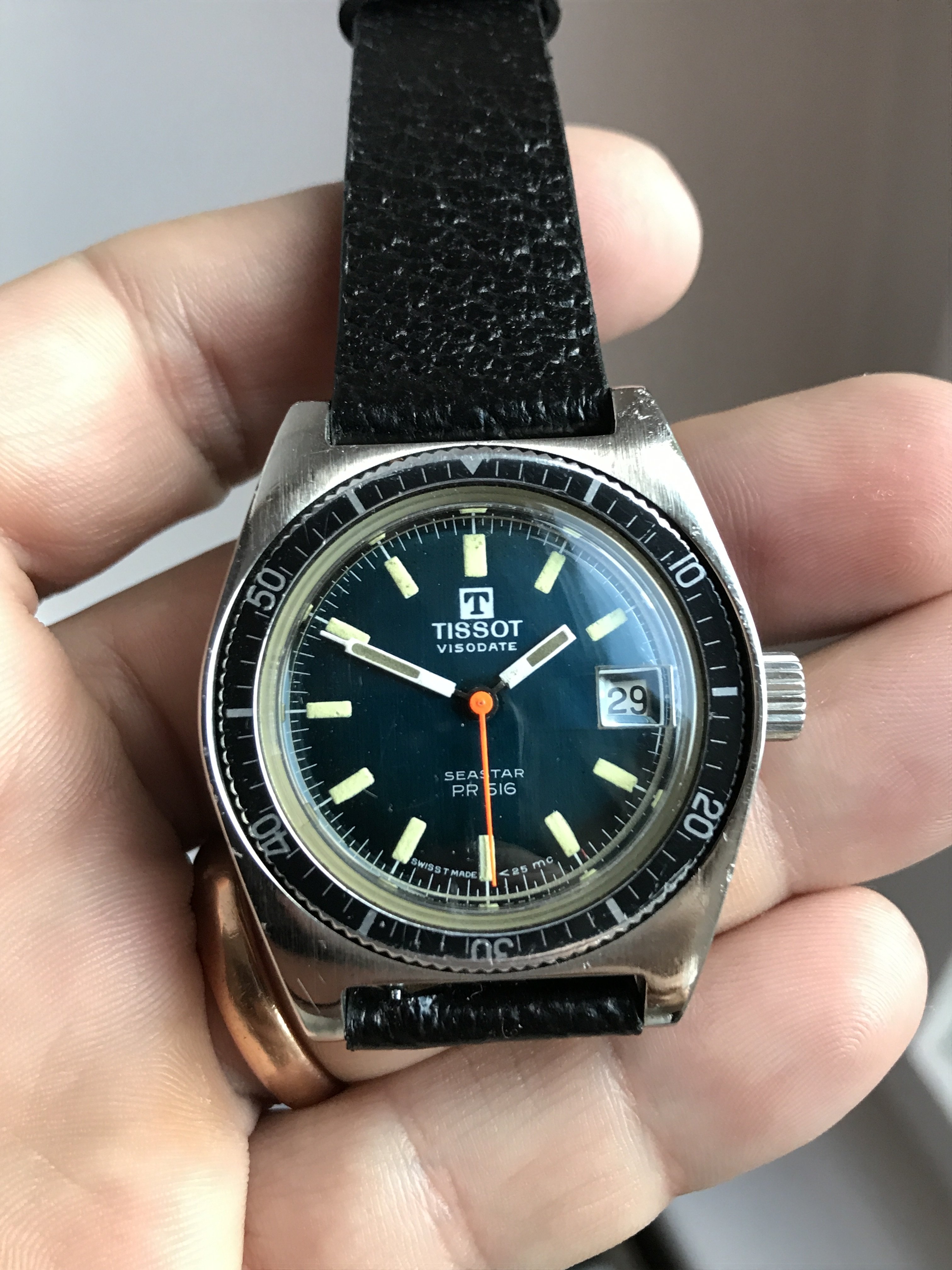

Here is mine for the record but it is a visodate. What I can say is your case, dial and crown looks legit to me :

Your watch looks legit.

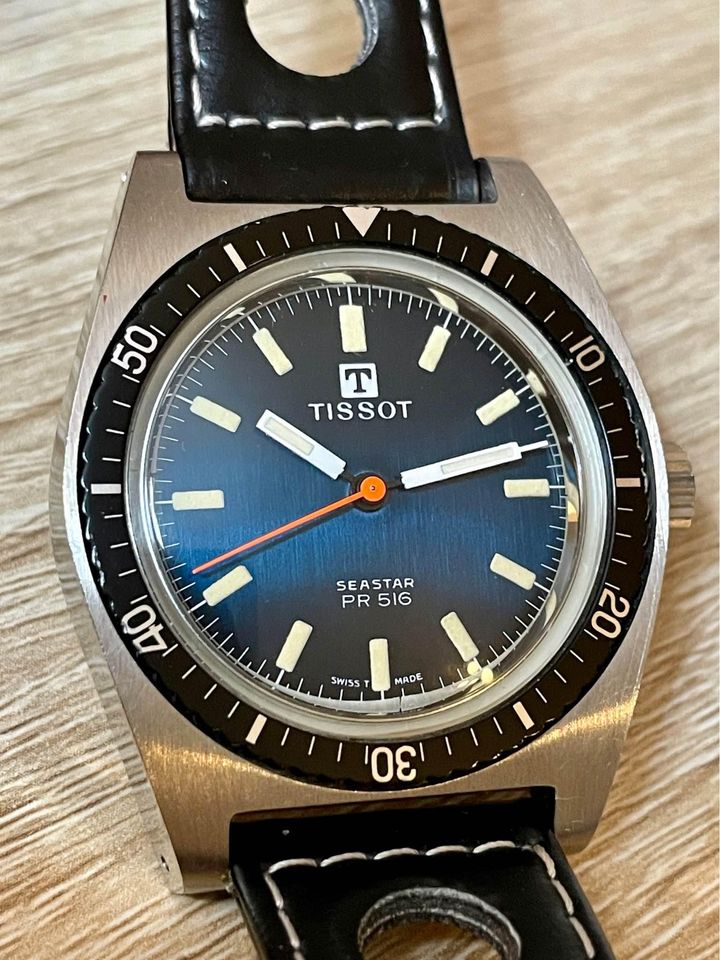

Here's my no-date PR 516. These are great watches!
