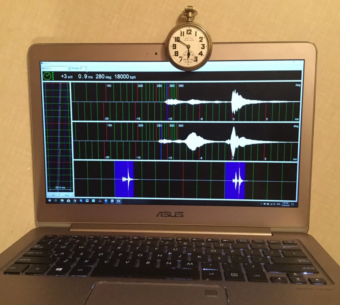

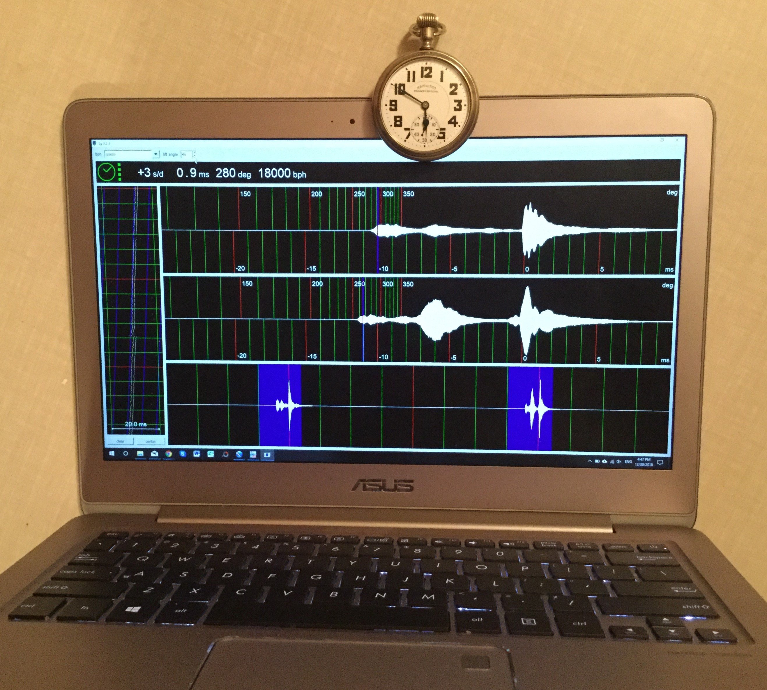

Is there a single inexpensive timegrapher that can be used for manual calibers 1861 & 861 and auto calibers 1045 and 565?
This one is free. Works well even with my laptop's' microphone.

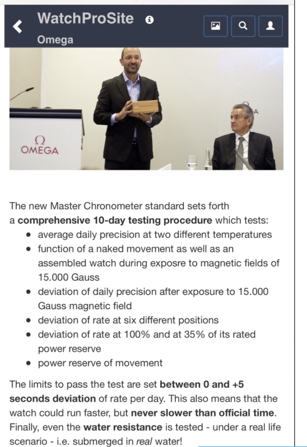

Thanks for putting this together. While it’s useful it still leaves a question to be asked - in regards to METAS movements, why does Omega explicitly state that this movement should never lose time and should always be in the 0-5 sec per day range? I have a new PO8900 that’s a week old that is about -1 sec after 24 hours. The first 15 hours on my wrist it’ll lose 1.5 seconds and then when I rest it crown up at night it’ll gain back 0.5-0.75 seconds but still be a hair slow by the end of that 24 hour period. So the fast position for this watch isn’t quite fast enough.
If Omega knows that daily wearer habits will be the most impactful in the accuracy why make a blanket statement that METAS watches should always be in the 0-5 second range? If it wasn’t for that comment by Omega I wouldn’t be bothered with -1 per day but the fact they say this makes me think something is wrong with the watch. Any insight?
I’m not aware that Omega ever explicitly states that the watch will never run slow. In fact the whole point of my post is to explain why that isn’t so.
This is what I was referring to
No idea what the source of this is, as it looks like a post made on a forum or something. But note the first bullet point above they refer to the average rate, and again as I’ve explained in detail in my first post in this thread, if the average can be 0 then the numbers that make up that average can be less than 0.
Read the first post again, as that explains it all.
Cheers, Al
Looks like this is the full article
https://www.watchprosite.com/page-w...ed-master-chronometer-part-1-the-live-report/
But yes, to your point it doesn’t look like it’s coming from Omega. Your first post explained it all. I think this particular watch is spending a lot of time in a slower position which is skewing the average. I wear it on my left hand and crown up happens to be a fast position so I’m going to switch to wearing it on my right hand to see how that switches things up, if any.
