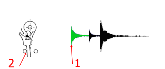

Lift angle depends on the location of the banking pins.
29,672
76,830
Because!
That’s some fine circular logic...

I guess you don't agree with my statement then.
Here's my understanding of the use of lift angle to determine amplitude. Looking at the image below, the start of the acoustic pulse (1), which is used by timing machines to determine amplitude of the balance wheel, depends on the location of the banking pin (2). If the banking pin is moved closer or further from the vertical centerline it will affect the amplitude measurement. I hypothesized a watch model with fixed banking pins would have less sample-to-sample variation of lift angle than a model with adjustable pins.
29,672
76,830
You have assumed that because the banking pins are adjustable, that they can't be adjusted consistently. There are always going to be variations (tolerances) even with the machining of fixed bankings, but in the context of the reason why lift angles weren't published, this explanation still seems quite a stretch to me.
