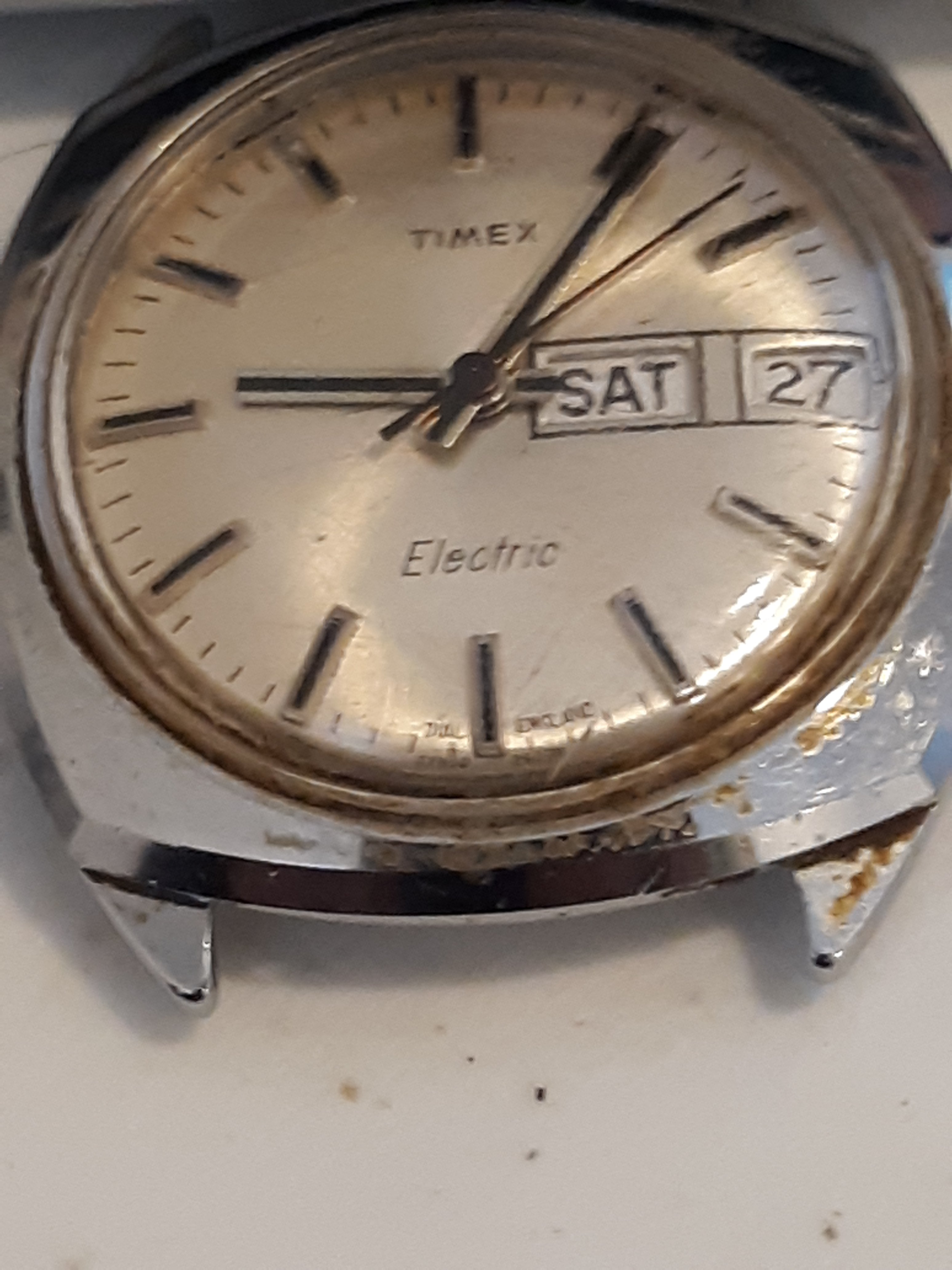

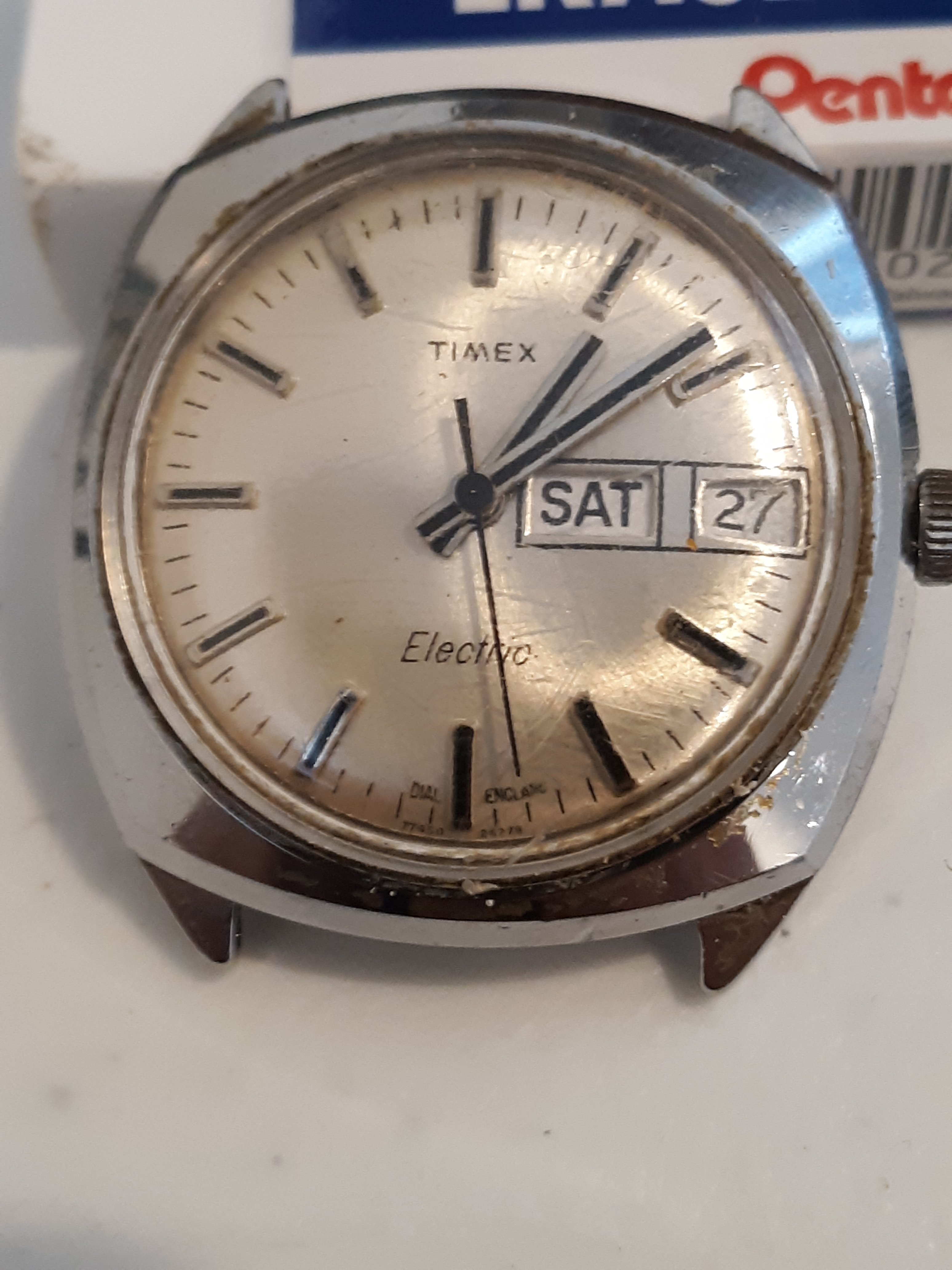

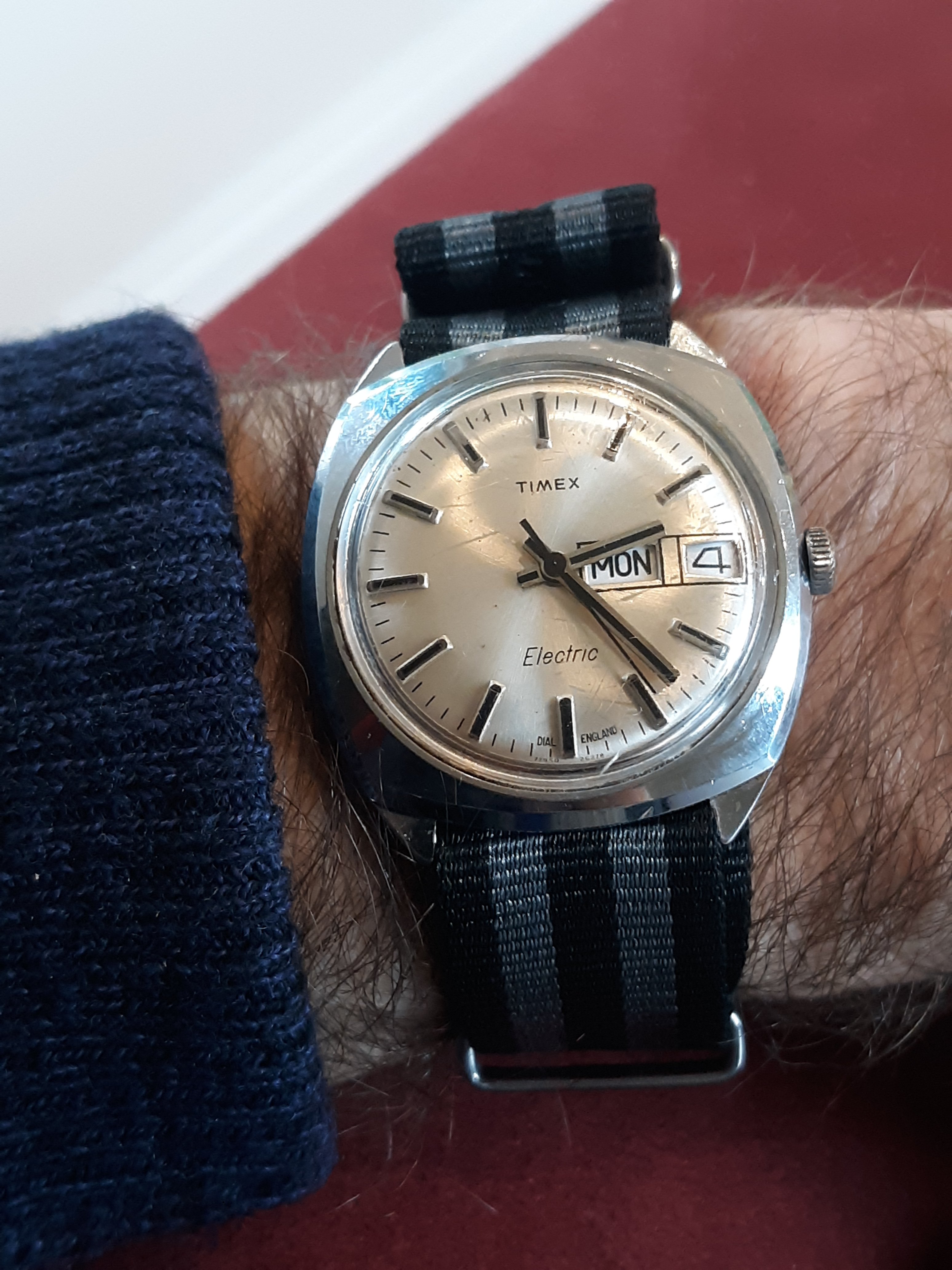

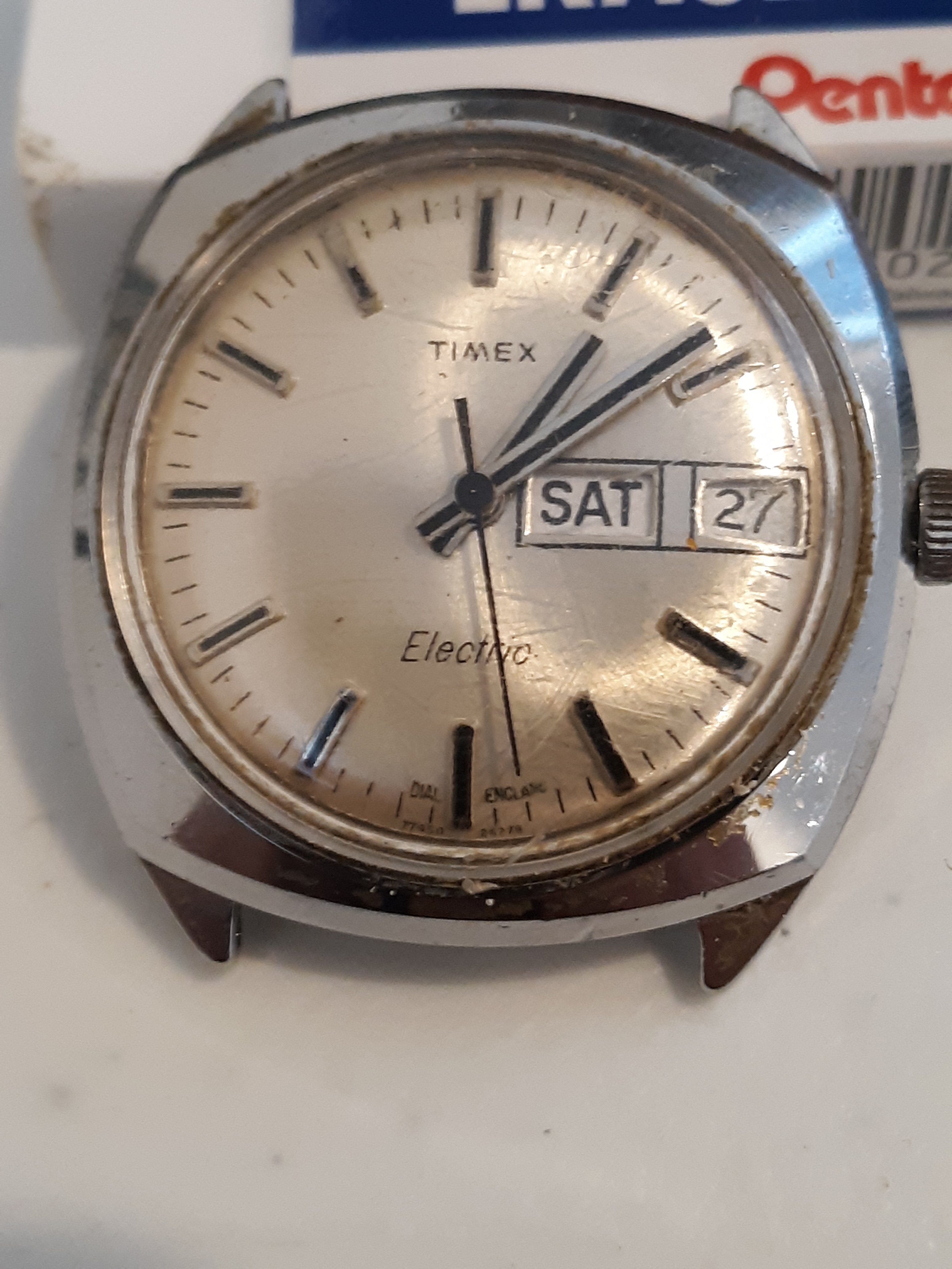

Hi all, I found this Timex in a junk store, and put a battery in it. Surprise, surprise it actually runs. I guess it can take a licken and keep on ticken. I can set the time, but can't figure out how to set the day and date. I would be curious to know if anyone has more details on these. From electric-watches.co.uk I guess that it is a model 42.

Underneath all the whatever I reckon that is quite smart 馃憤 sure you have already tried all the different combinations for setting the day date but just perhaps pulling the crown a millimetre as I have occasionally come across pieces and missed the first position ?

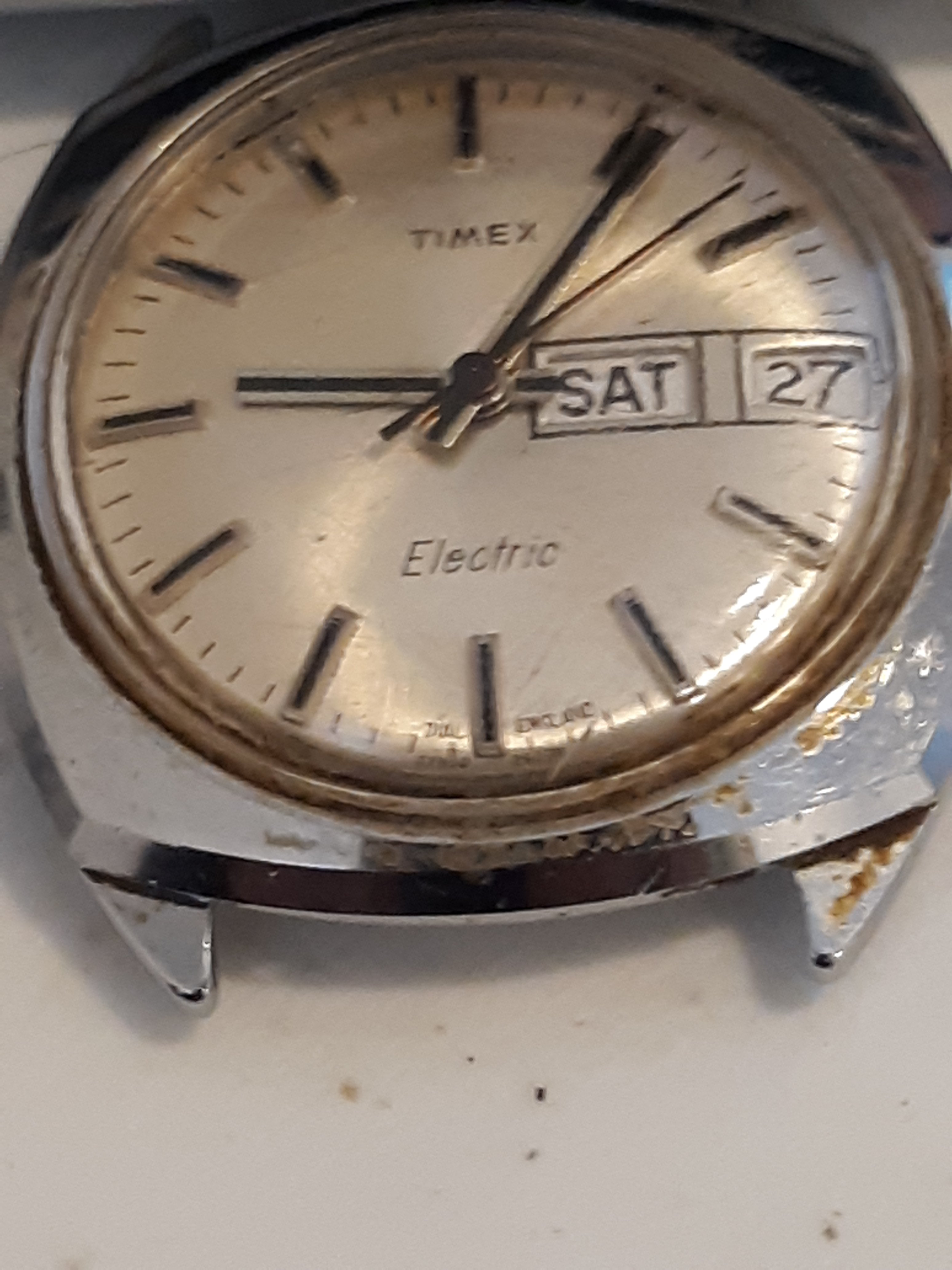

I don't have any day-date vintage watches. I figured it out though. Day is set by going round and round through 24 hours and date can be set going 10:00-2:00. Both go only up. So get the day then back and forth to get the date right.
4,857
12,285
Oh boy this is tiring. I'm on Mon the 16th.

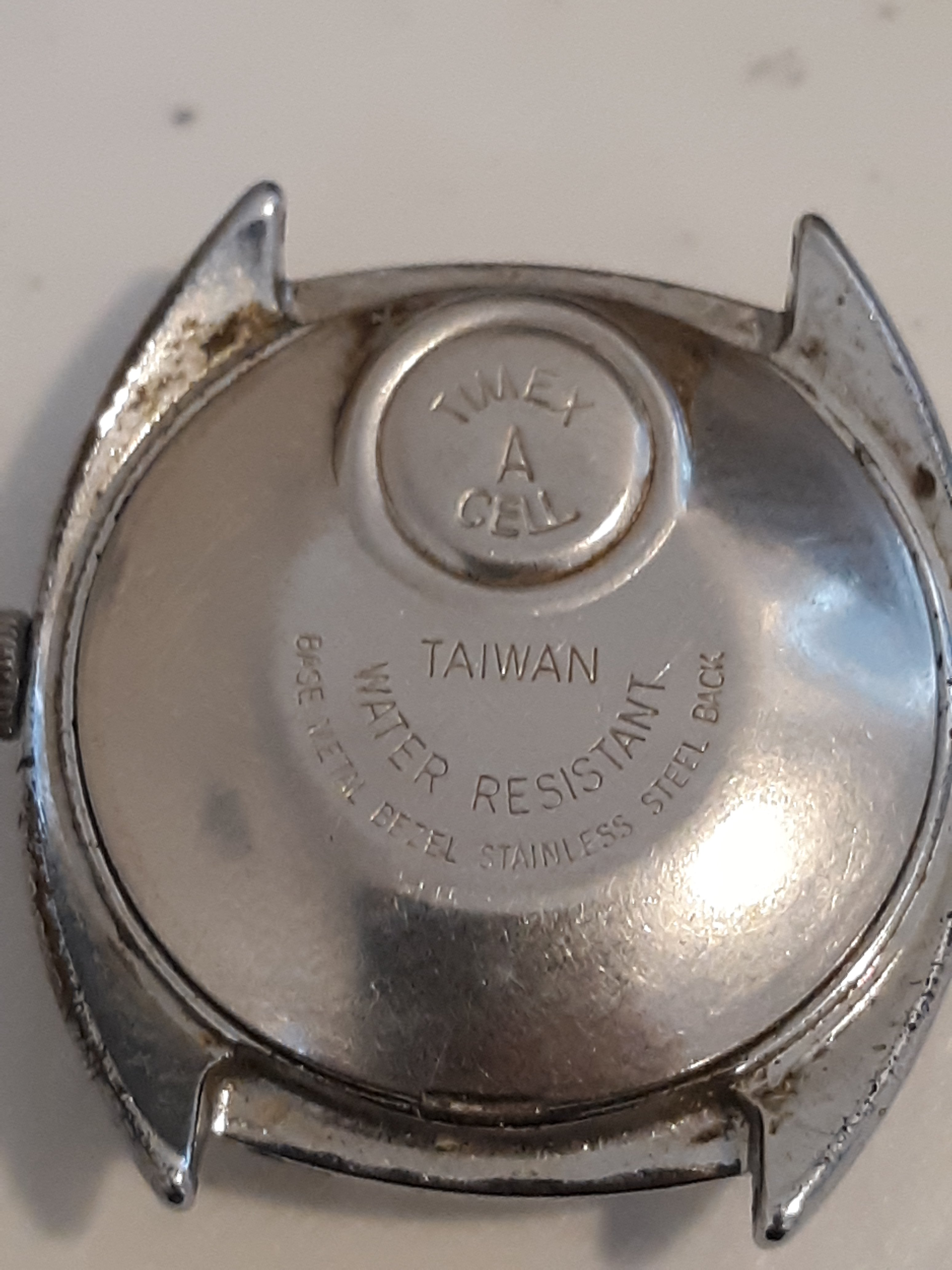

It uses a D303. Right now it has an A76 (alkaline), but I will get the proper silver oxide one. It will just cost 6 times what I paid for the watch

I wouldn't pay too much for a battery to keep that thing going, this is pretty basic (ie cheap and disposable) Timex watch. Probably sold for something like $10 or so, new.
4,857
12,285

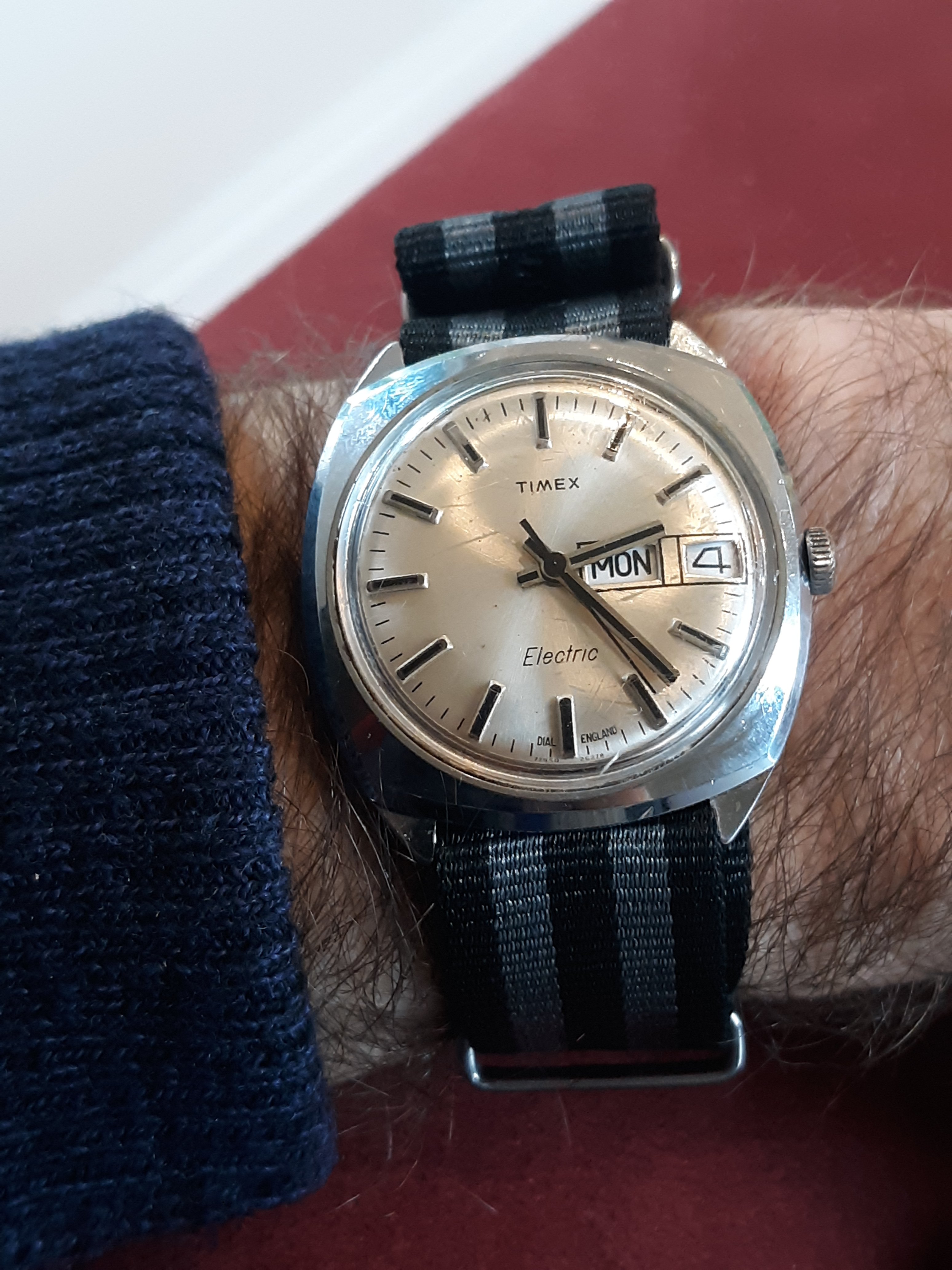

Cleaned up ok, crystal needs work. The watch was $1, a battery is $6 online. I doubt I will wear it much, but is worth having to fill in the gap between spring powered mechanical watches and an Accutron.

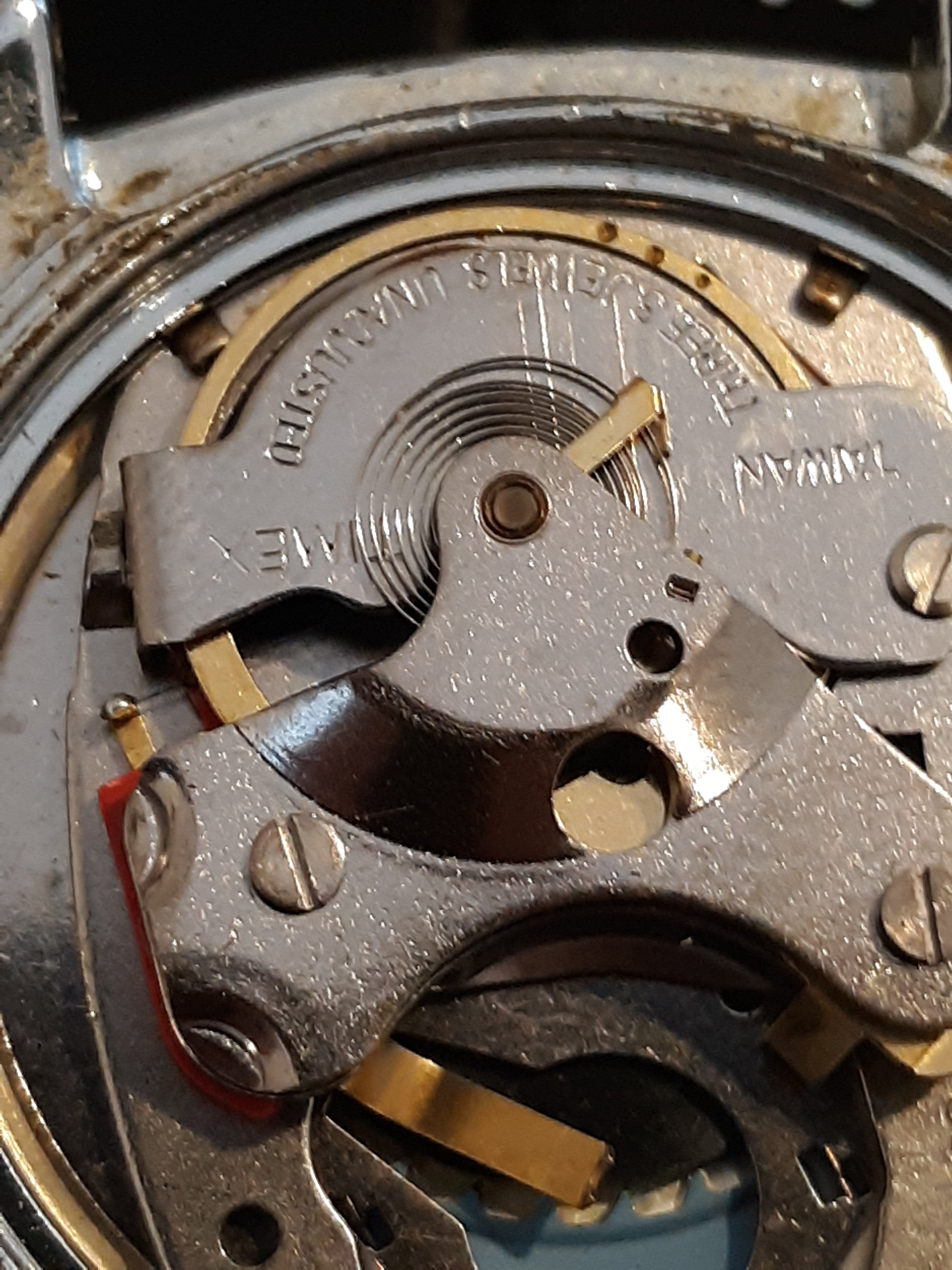

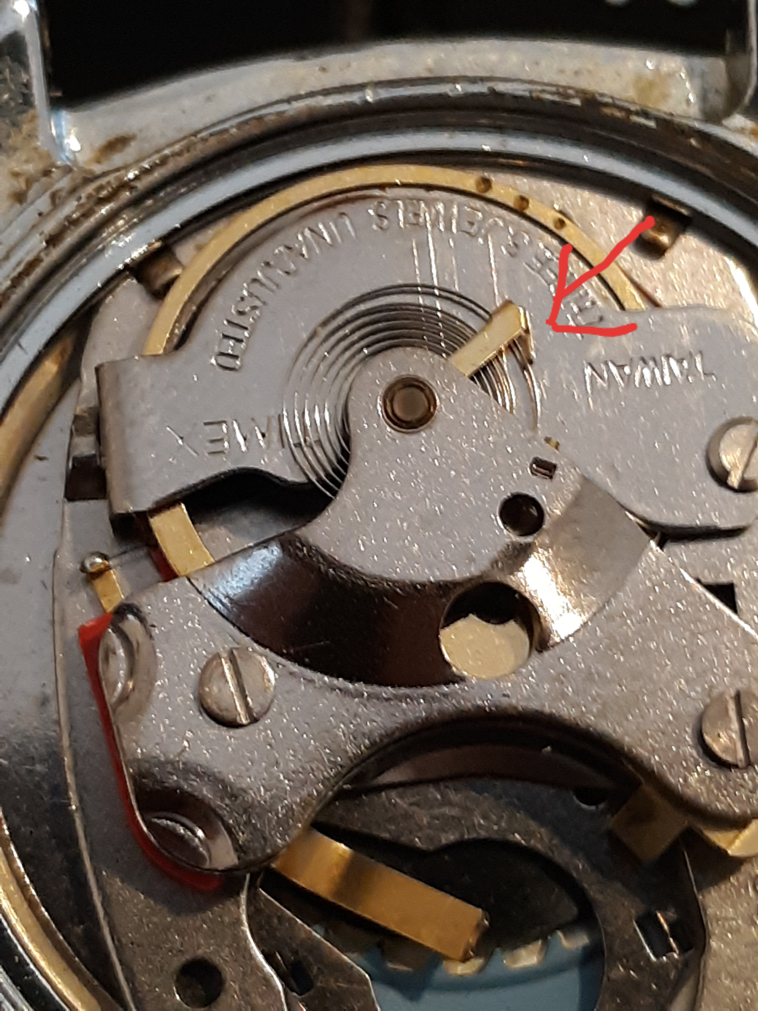

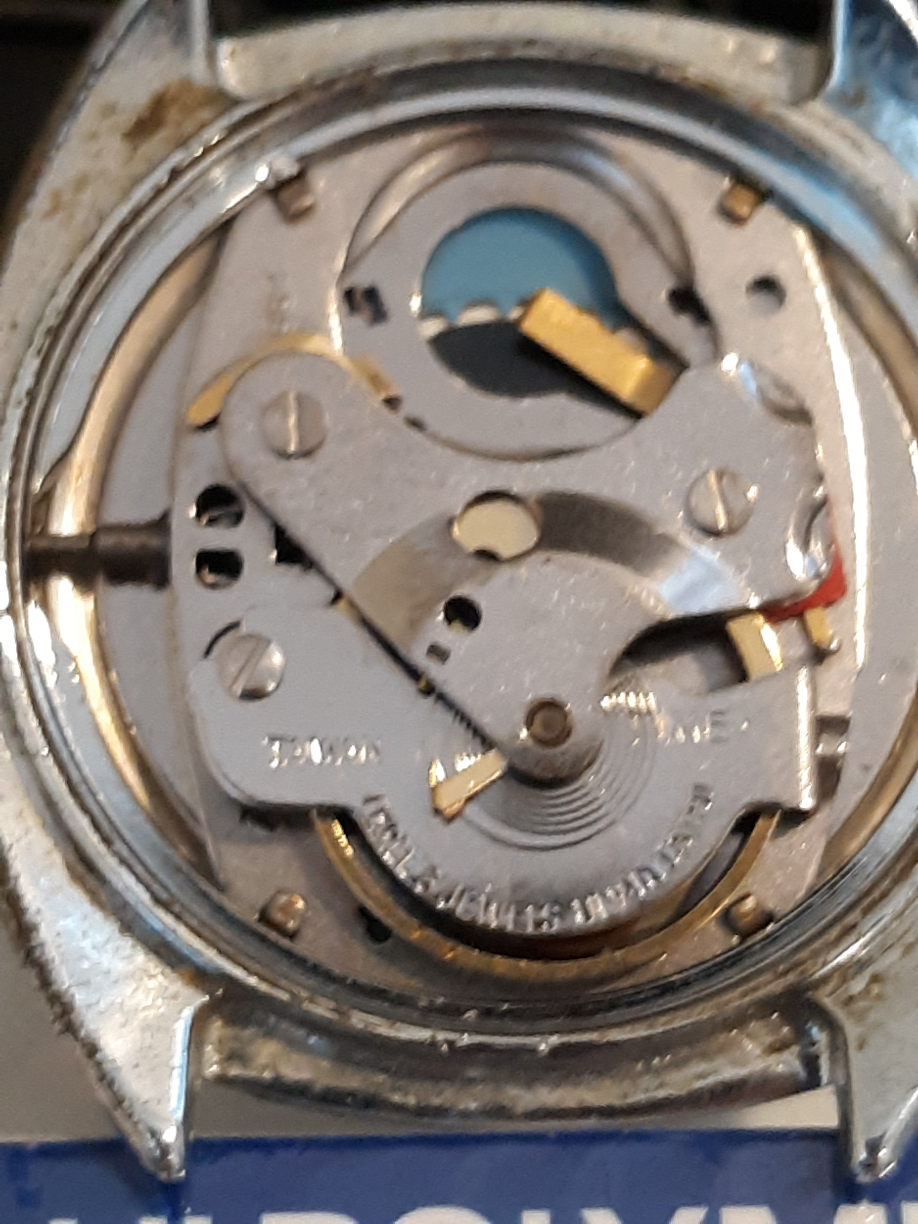

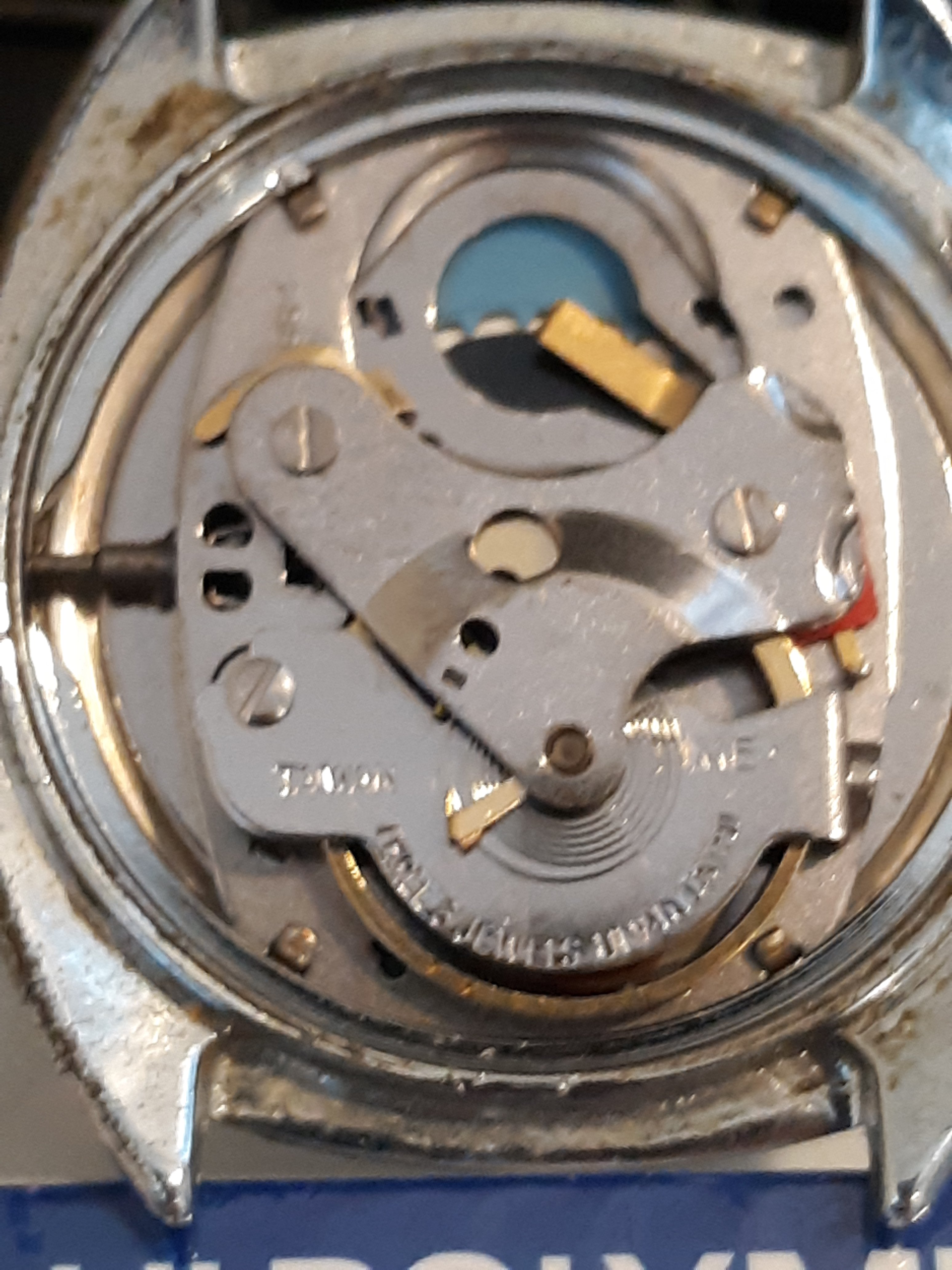

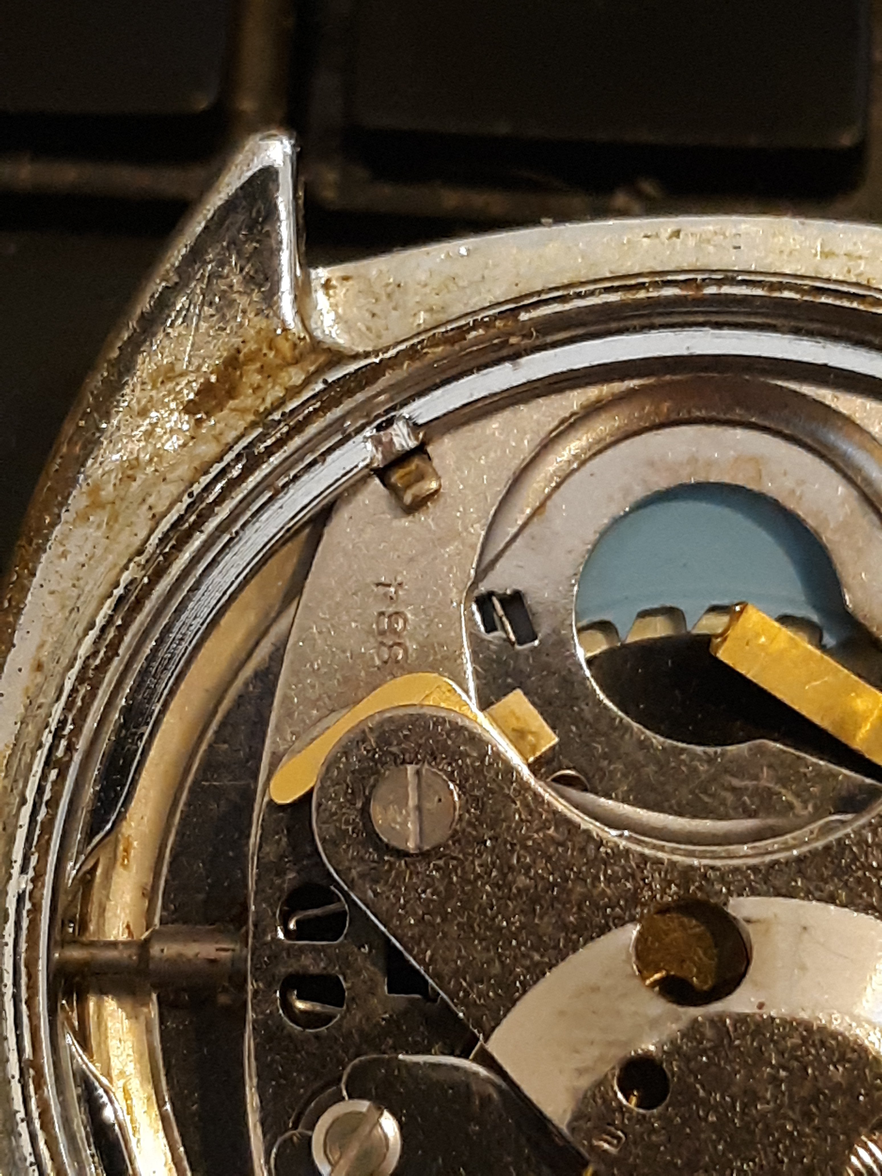

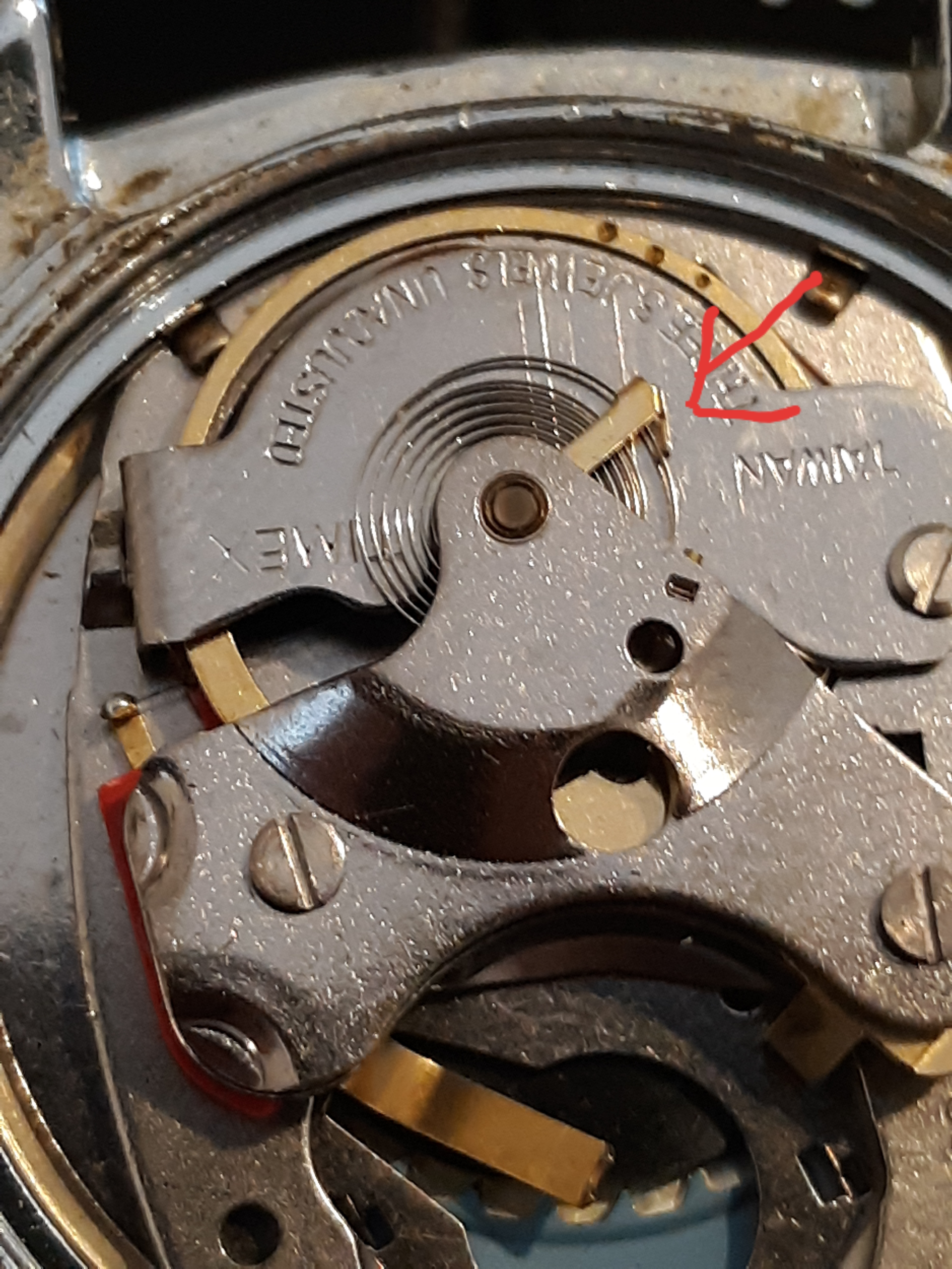

Just a quick update. The watch seems to run OK, but looses about 2 minutes. Any idea if it can be regulated perhaps by rotating the part in the picture?@MoclovFlop or @RI Omega Fan Also, my wife left for work with it on her wrist. I think she likes the gold sunburst dial.

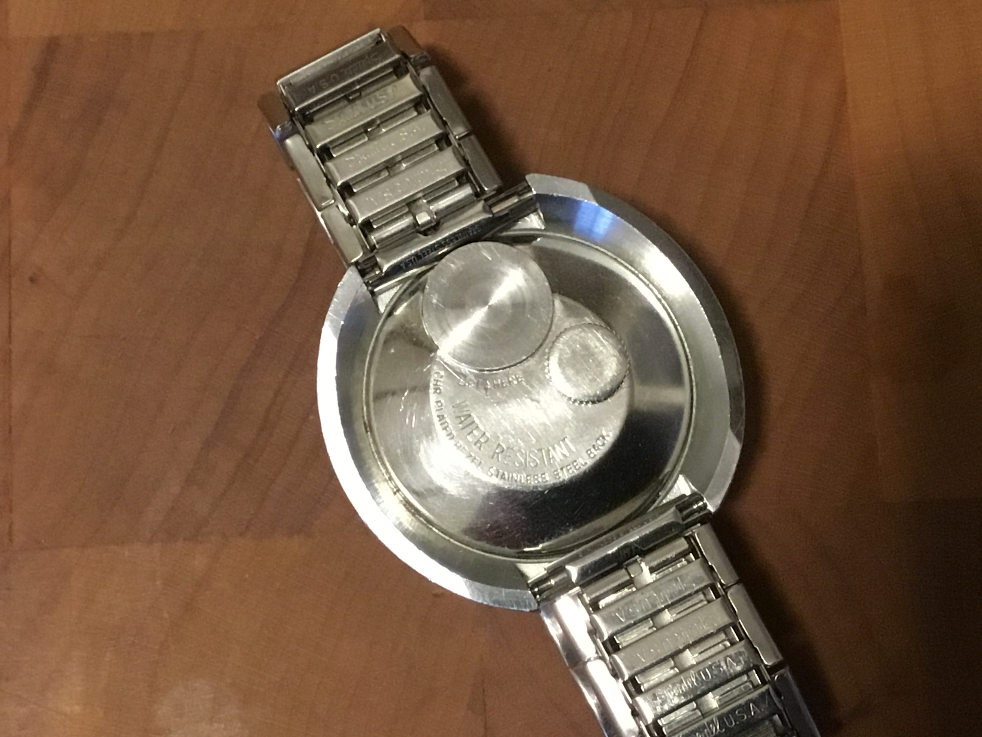

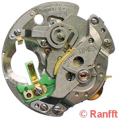

The very first Timex Electrics were put on the market around about 1960/61. This was before Timex was producing their own Electric movements. The Durowe company of Germany was producing battery movements, and Timex bought the company as they wanted the Durowe Electric caliber 870 for use in the Timex Electric. The Timex Electric in a Chrome case with a faux leather strap sold for $29.95 when introduced. I have one. This Durowe movement was much more successful than the very expensive Hamilton Electric of the era. The included picture shows a Durowe calibre 870 movement, clearly marked TIMEX.
Sorry Wags, I can鈥檛 help you. I really don鈥檛 know very much at all about watch innards. Proving this, I suggest you try moving that little lever over a little bit and see what happens.

The very first Timex Electrics were put on the market around about 1960/61. This was before Timex was producing their own Electric movements. The Durowe company of Germany was producing battery movements, and Seiko bought the company as they wanted the Durowe Electric caliber 870 for use in the Timex Electric. The Timex Electric in a Chrome case with a faux leather strap sold for $29.95 when introduced. I have one. This Durowe movement was much more successful than the very expensive Hamilton Electric of the era. The included picture shows a Durowe calibre 870 movement, clearly marked TIMEX.

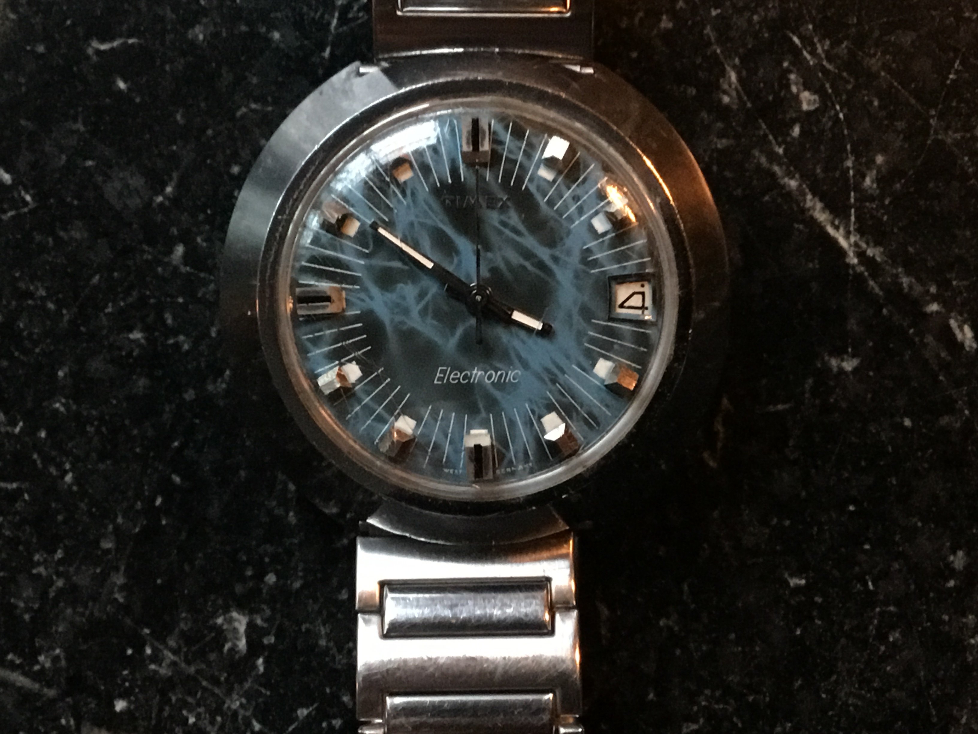

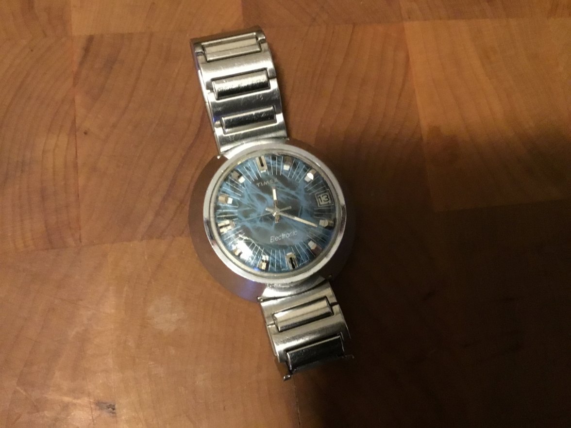

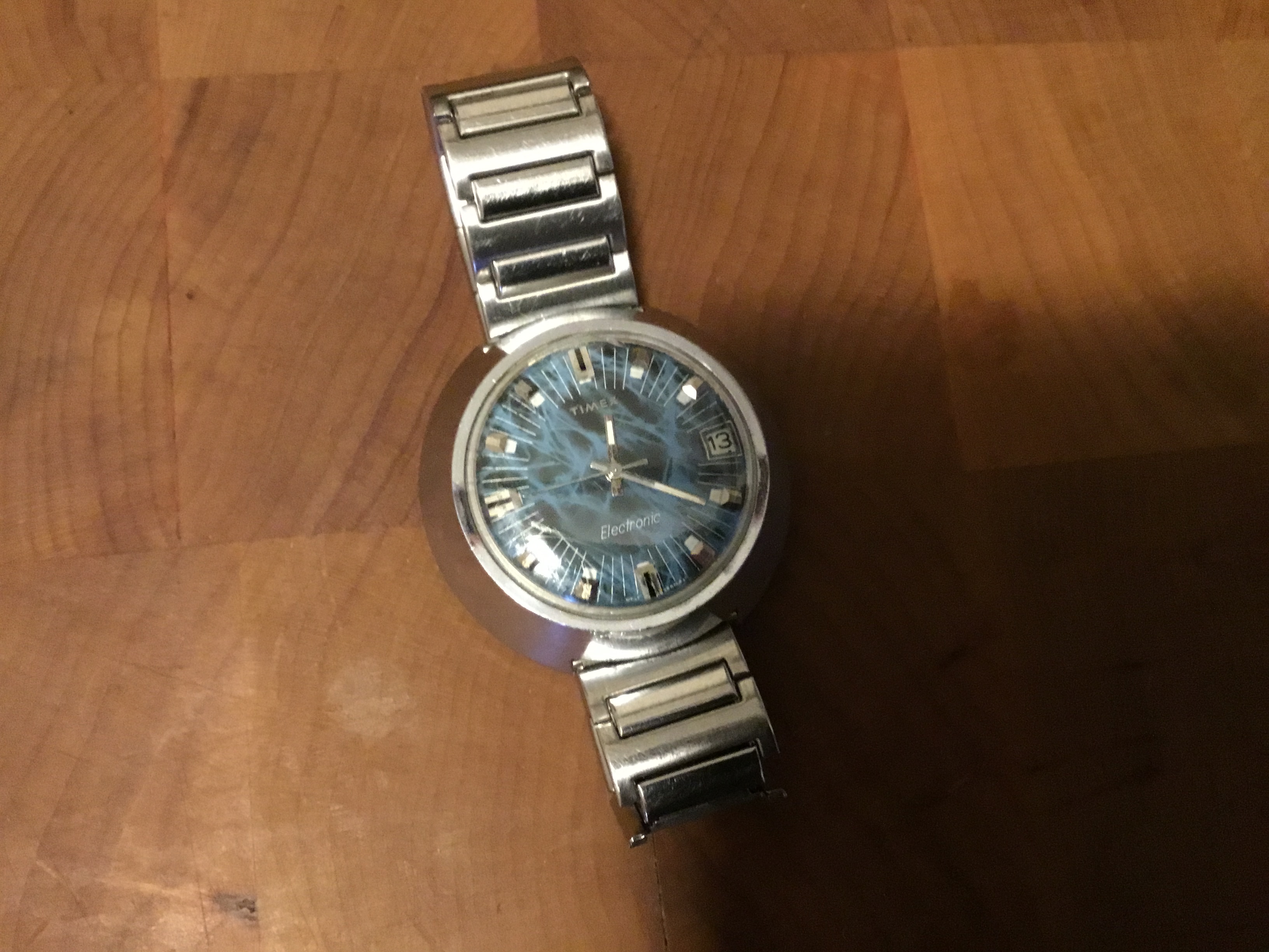

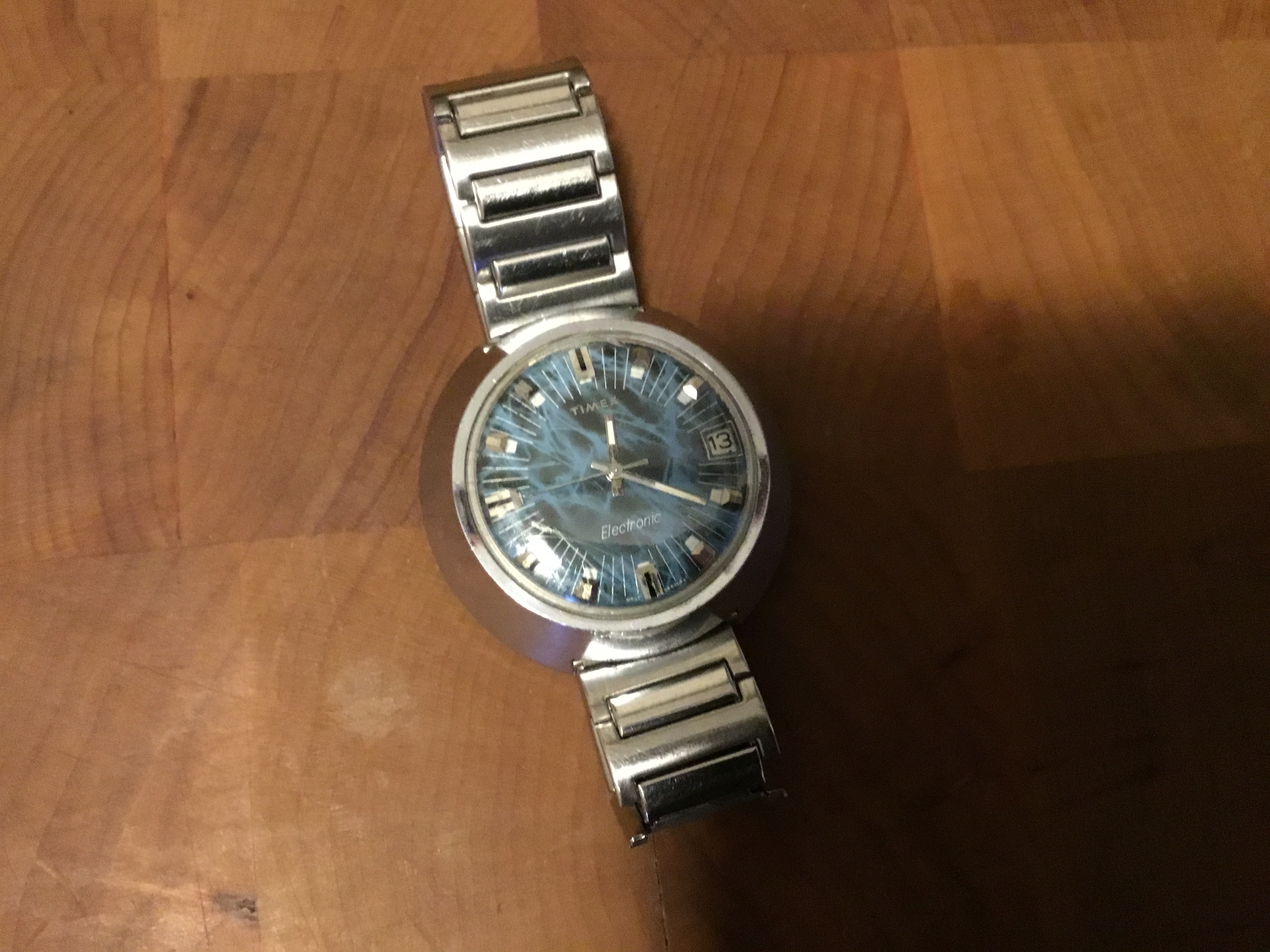

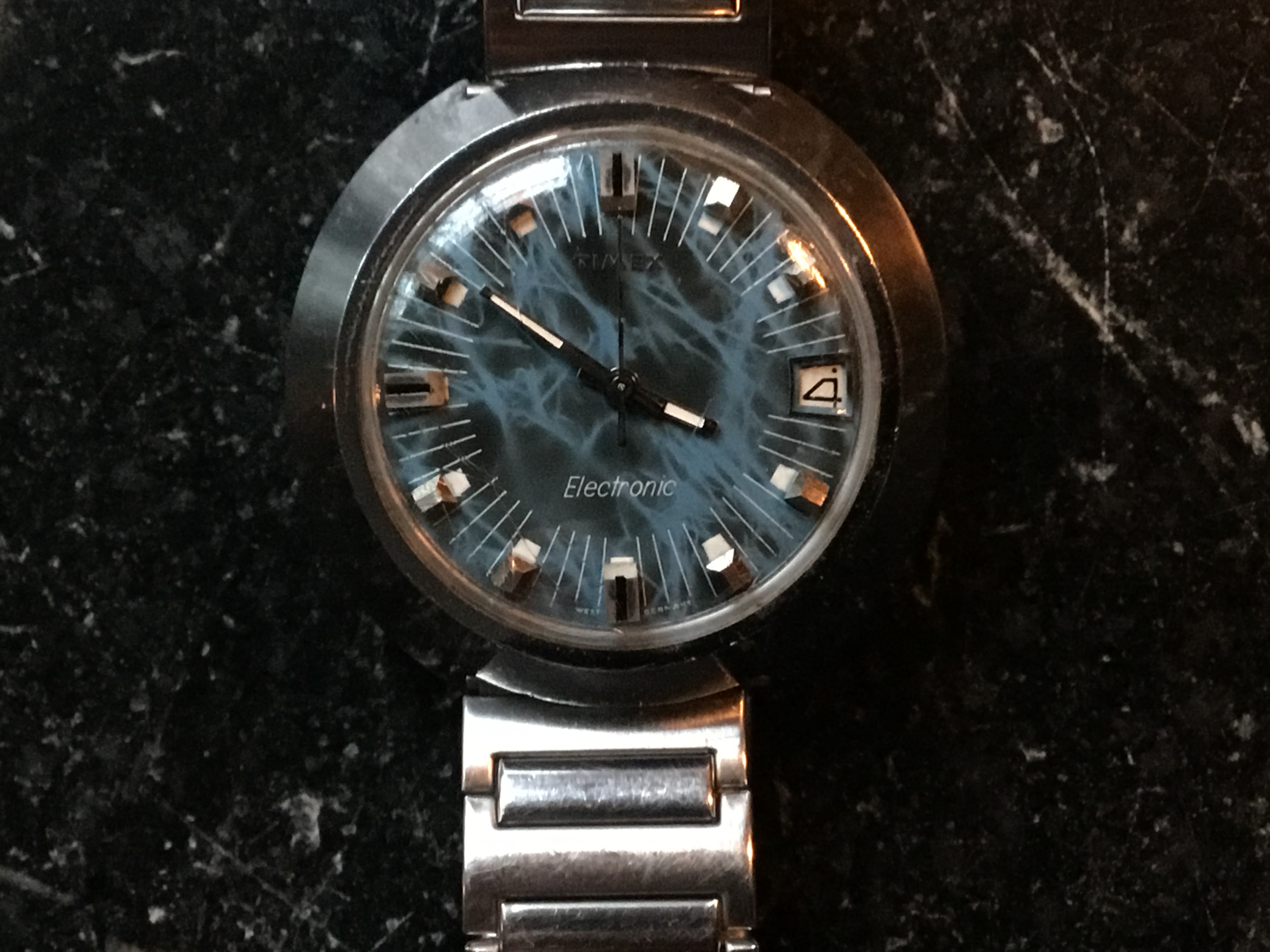

My now 95-year-old father-in-law found this watch on Revere Beach back in the 60s. It鈥檚 been in his drawer ever since. He gave it to me about a year ago. This thread inspired me to put in a new battery (a quick Internet search revealed a Duracell 357 is correct for most Timex Electrics). Nothing happened. I tapped it, shook it up a little bit, banged it on the top of my dresser, and the damned thing started ticking!
Reinforcing Canuck鈥檚 point, mine says West Germany on the spacey blue dial.
15,996
48,112
I鈥檓 almost certain yours will be the Durowe movement in my post. Once Timex got their feet wet with the Durowe Electric, they sent their r & d people to the shop, and they designed the gawdawful piece of carp that the Timex Electric became, until they went with quartz, like everybody else. Durowe did wonders with that movement. Glad yours runs. It is much more fashionable than mine, which incidentally was retrieved from a waste paper basket back when I was in retail.
Just a follow-up for future reference, the part indicated in the photo regulates the watch clockwise to speed it up, counter-clockwise to slow it down.
