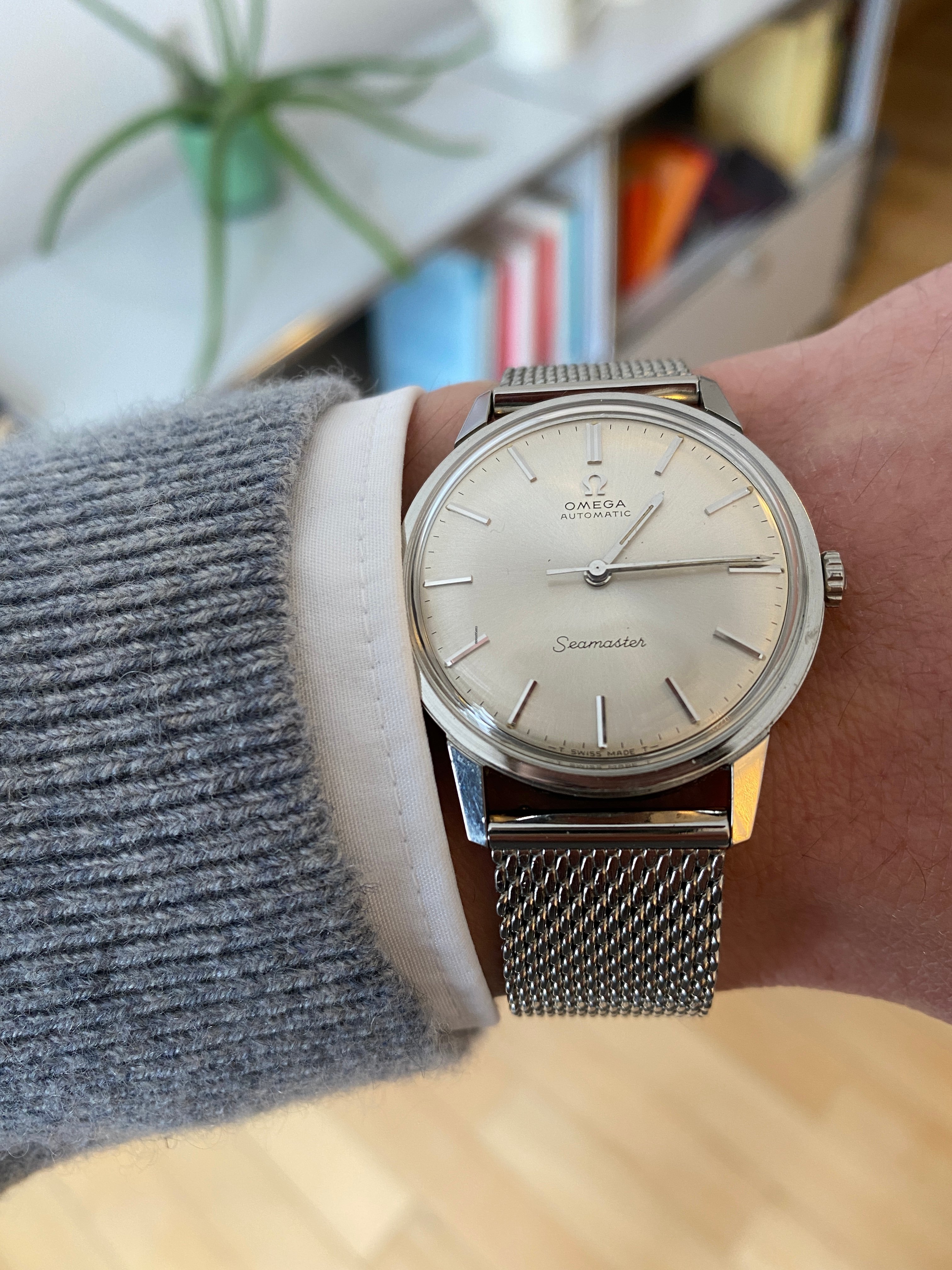

Looking to purchase my first vintage Seamaster and was hoping for some advice on authenticity and condition of this Seamaster 165.002.
It's priced at £1k which i'm guessing is overpriced? I might make an offer though if the watch checks out.
Year is listed as unknown, is there any way of finding this out? Also the watch comes with a mesh bracelet (which i really like) but do i need to consider the authenticity of the bracelet too?
Many thanks.

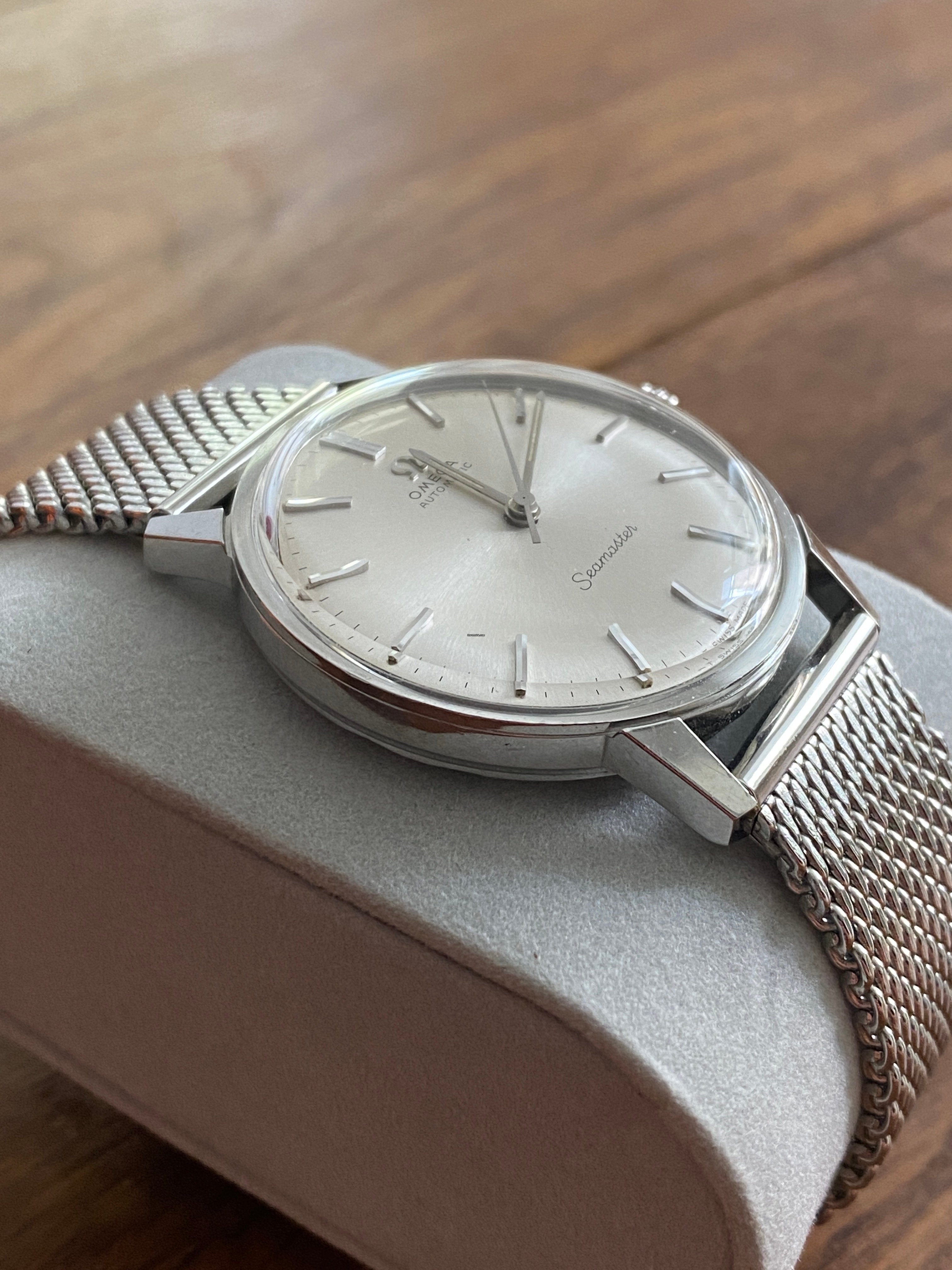

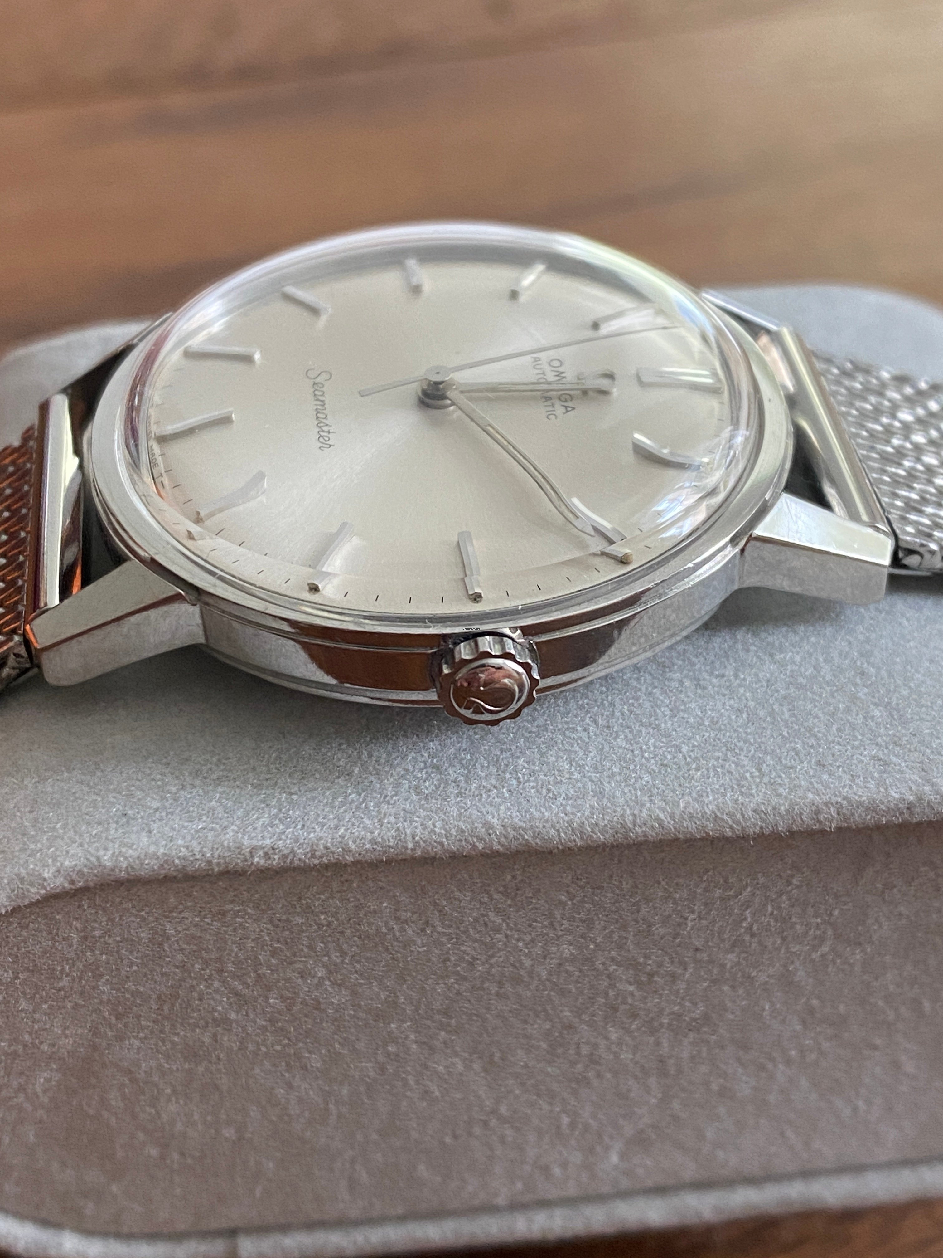

Hi, I'm not an expert, but the mesh bracelet could be a 20€ piece, unless there are pictures telling us a different thing. The watch is nice, is not over-polished. Do you have more info about it? Last service (if any)? Pictures of the movement? Size?
8,174
36,709
Although the condition appears OK I'd say that it is more of a €350-€450 watch than one that is £1000. If the bracelet is a 70's Omega mesh, then add €150-€175 to my estimate.

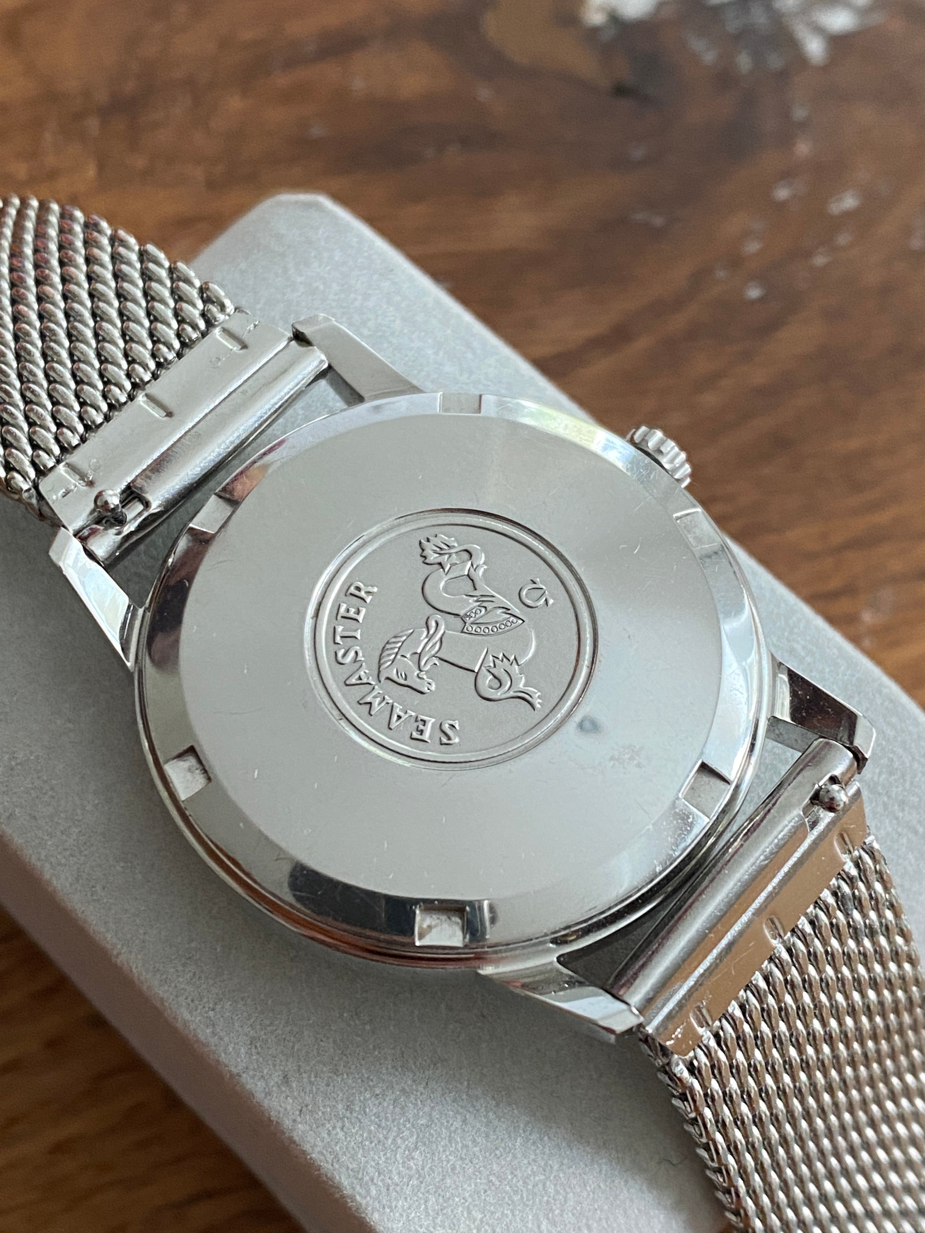

Pretty sure the bracelet is a modern one as it has been manufactured for QR springbars. This wasn't an option from Omega when this watch was made. It seems overpriced to me, but the UK market is different to here downunder.

Looks fine to me. The bracelet appears to be modern, no real value.
For valuation, make sure to focus on actual selling prices, just ignore asking prices. You can look at old forum listings or sold eBay items, preferably auctions. That will help you determine a fair market price. Of course, there is no guarantee that a seller will accept what you believe to be a fair price, and if you're in love with the watch and need it now, then you may have to pay a premium.

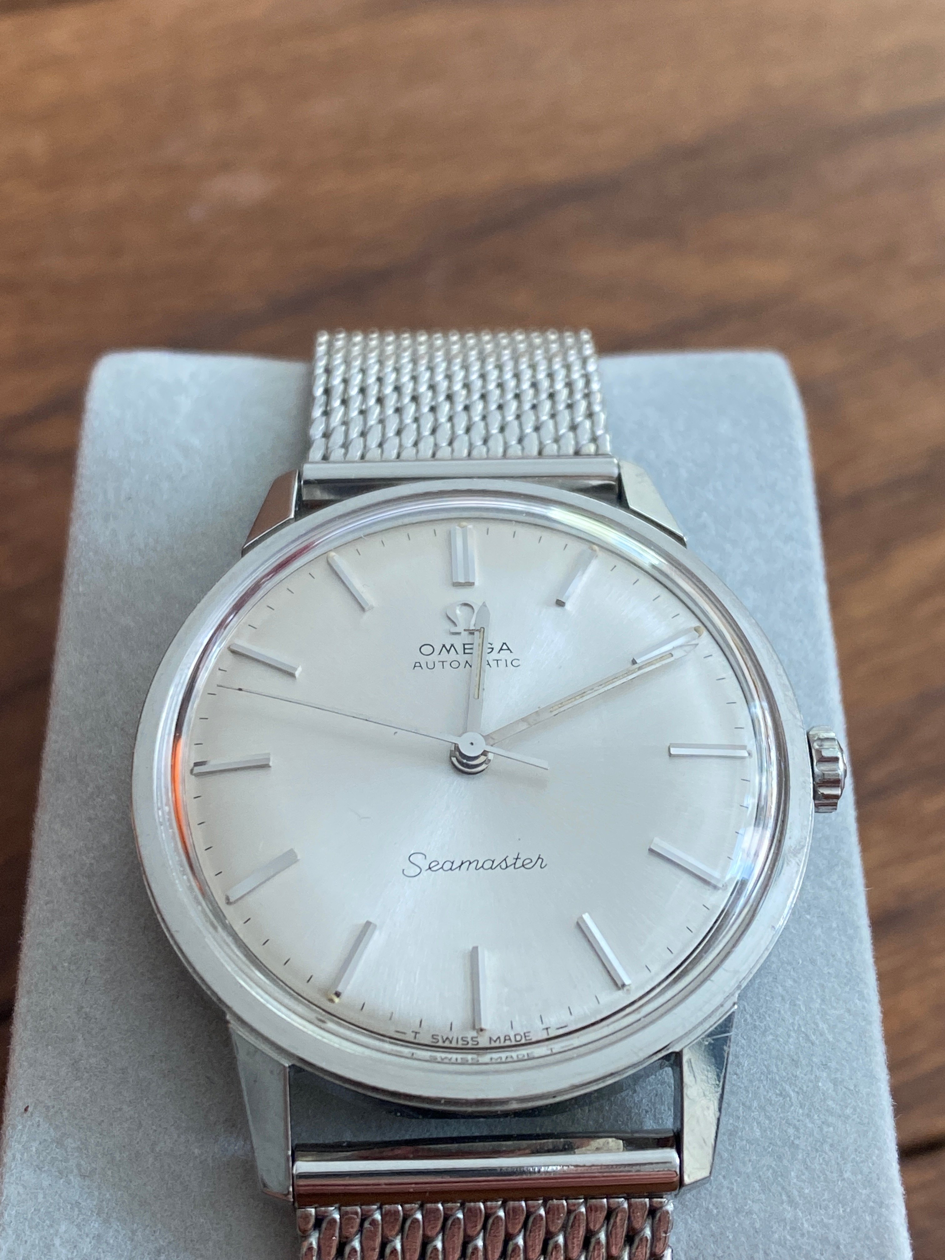

Can you shed any more light on the difference between this model (with the all silver markers) and other 165.002 models i've seen with black marker inlays? I particularly like the all silver markers and was wandering if there was a way to narrow my search for this particular style?

I am guessing at C24?
If I was the OP, I would search for any 60s Seamaster in good condition, more or less they look the same! I would only pay 1K for a rare technical dial in mint condition, I vastly prefer Omegas from the 50s.
