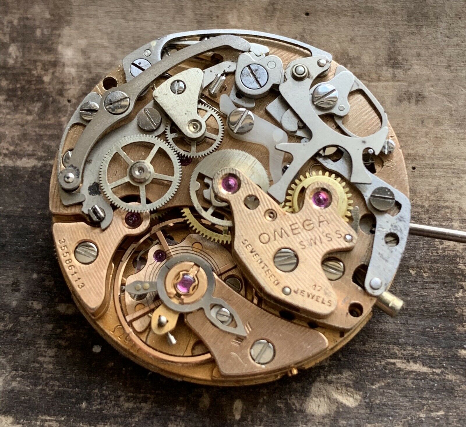

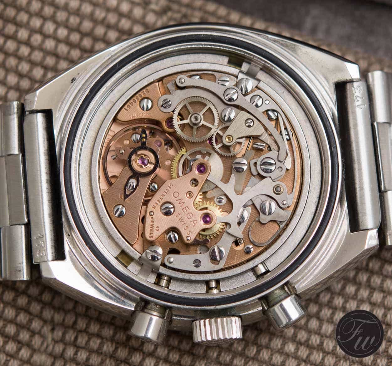

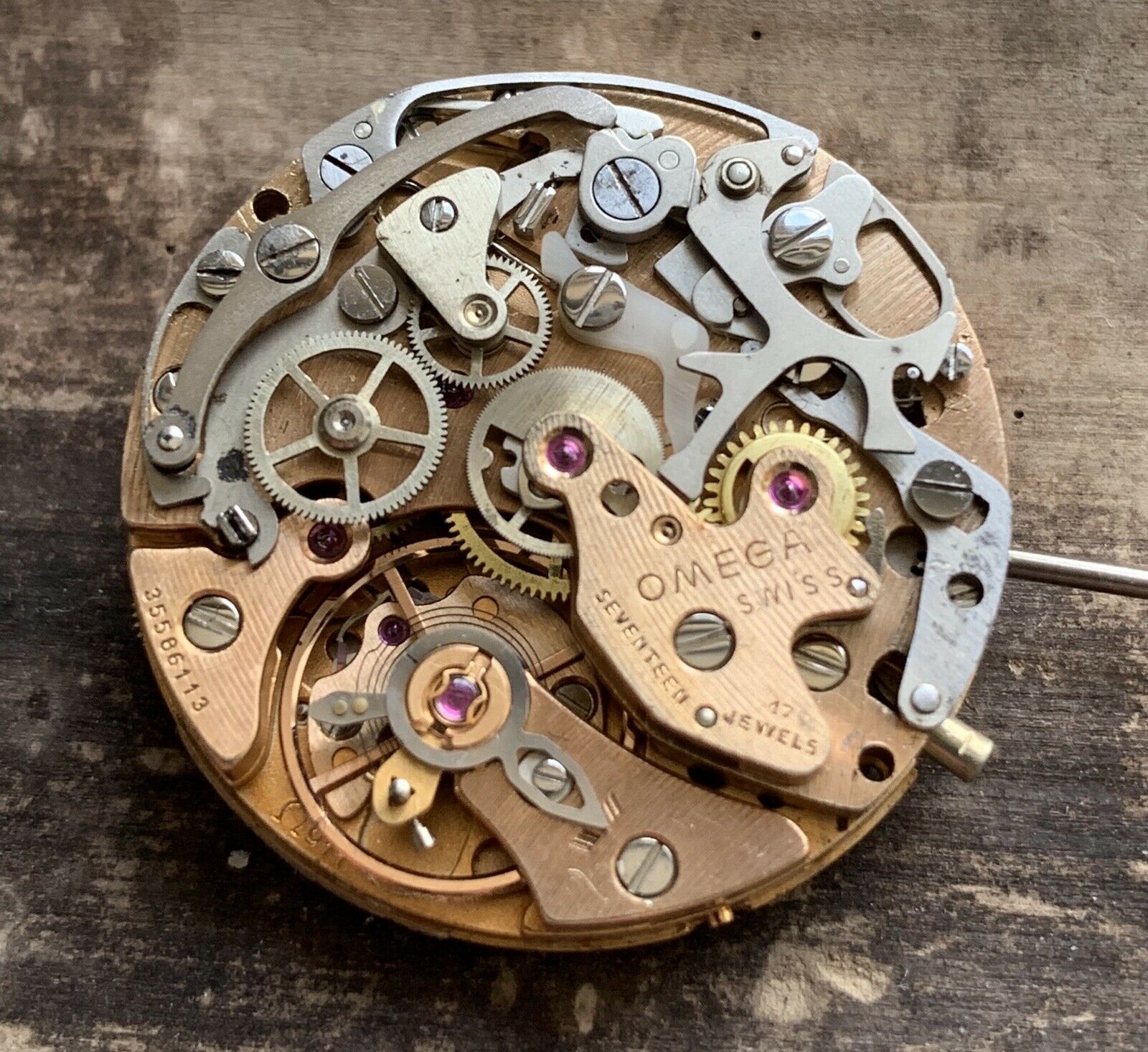

Here are a couple of internet pictures, this is a flightmaster 911 with a Delrin brake and then a 861 from a MKII. I just had a quick look in MWO who suggest that it was introduced in 1971

It's okay - you are pretty much there even though you are not familiar with the technicalities. First, the name "brake" is completely misleading, and the proper name for this part is "blocking lever" and that more accurately describes it's function. When people think of a brake, they think of how a brake on a car works, and that is not at all how this works. I just shot a coup0le of videos in slow motion using my phone, and have edited them down and uploaded to my YouTube channel that will illustrate how ridiculous the claim made by Omega's marketing team is.
In the video below I show the process of stopping an already running chronograph on a Cal. 861 (that is in my own 1971 Speedmaster). You will see that when I press the stop pusher, the operating lever moves the cam, and two main things happen. One is that the coupling yoke moves away from the central chronograph wheel, and the teeth on the coupling yoke wheel and the chronograph wheel are no longer engaged - this stops the wheel chronograph wheel moving.
The second thing that happens is that the blocking lever (in this case the two piece steel version) swings in to hold the chronograph wheel in place, so it doesn't move and you can read where the hand is that is attached to the other end of this wheel. These two things happen very close to each other in terms of timing, but the teeth of the coupling yoke wheel are only very slightly engaged with the teeth of the chronograph wheel - in fact Omega calls for the teeth of the coupling yoke wheel to only mesh to 1/3rd the depth of the very fine teeth on the chronograph wheel, so almost as soon as that coupling yoke just starts to move, the chronograph wheel is no longer being driven. Here is the video - first from a distance and second zoomed in on the phone so the quality goes down a bit:
The next question should be: "Hey Al, how many chronograph wheels have you replaced on vintage Speedmasters with the steel brake, due to excessive wear on the teeth?" My answer is "zero" so the idea that the steel versions cause excessive wear on the teeth of the chronograph wheel, is just simply not the case. I won't say there's no wear on these, because if the watch gets a jolt when the chronograph is stopped, it may cause the hand to move and there would possibly be wear at that point, but in the big picture it's insignificant.
