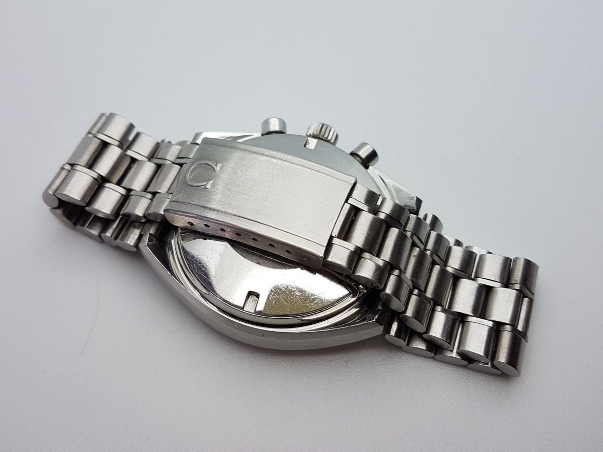

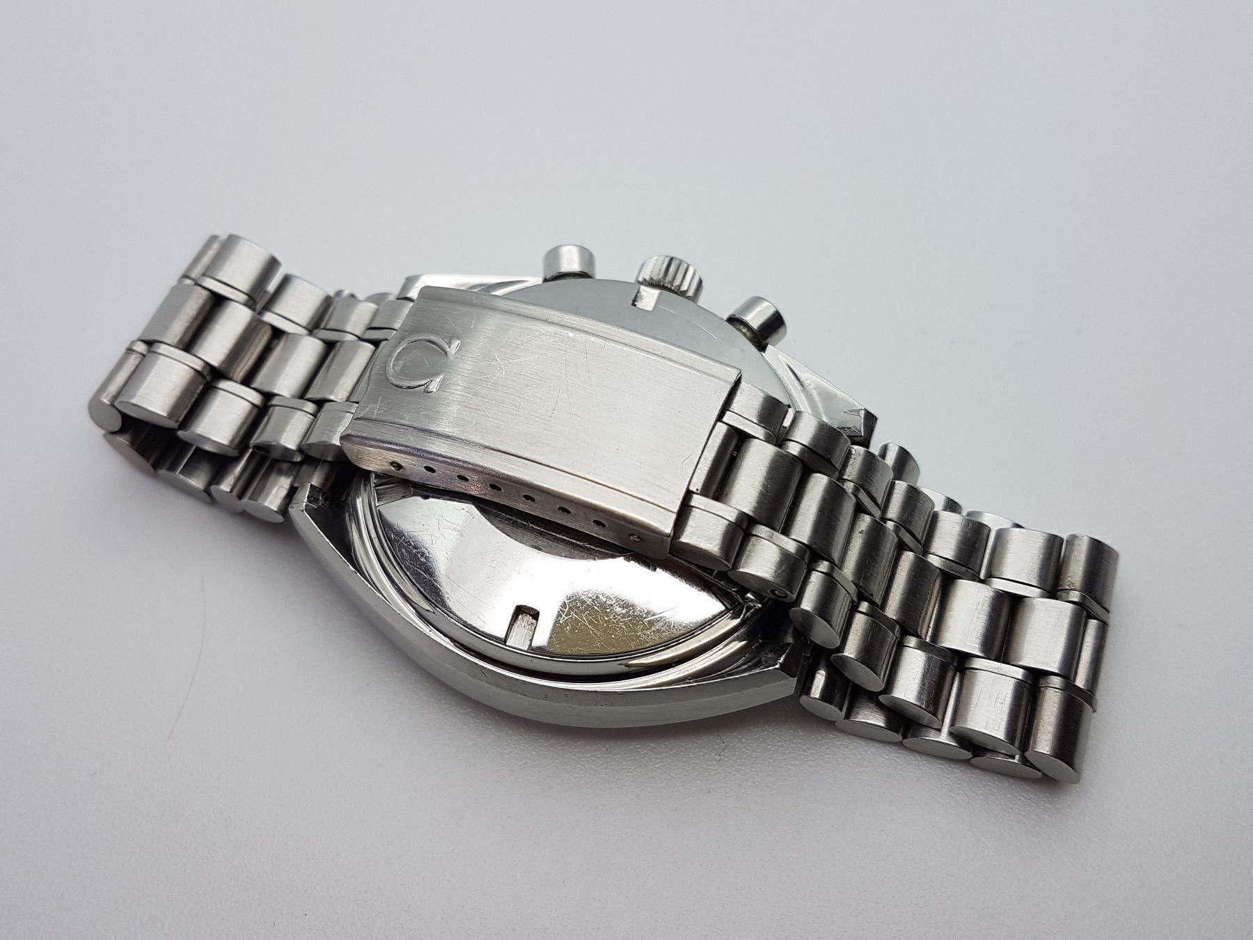

That is a nice example. It is the earlier model 145.014 which makes it better in my opinion. It is actually the earlier 1159 bracelet that was used before they introduced the 1162, but with the wrong clasp, or an 1117 that has had endlinks replaced maybe. It looks tight which is hard to find, these bracelets often come with a lot of stretch.
It looks untouched judging by the leaky seal on the crystal. No bad thing if your a collector.
Did a bit more investigating on the bracelet for the French model. Looks like it has the correct clasp cover for a "second generation" 1159/154 bracelet, so my best guess is only the inner part of the clasp was swapped in from an 1171 at some point:
The original inner clasp would have likely had a circled "30" and 1159 stamped in, as I understand it. Bit of a shame but given the relative rarity and good overall condition of this bracelet otherwise, I think I can live with that compromise.
For anyone keeping track, I'm now on amicable terms with the French seller and things are looking promising... 😎
I will actually revise my observation. I think this bracelet may be totally correct, and a slightly different model to the 1159. The 1117 may well have come with 154 end links on the 145.014
Bah! My weary, bloodshot eyeballs kept reading that as "1171". 🤦

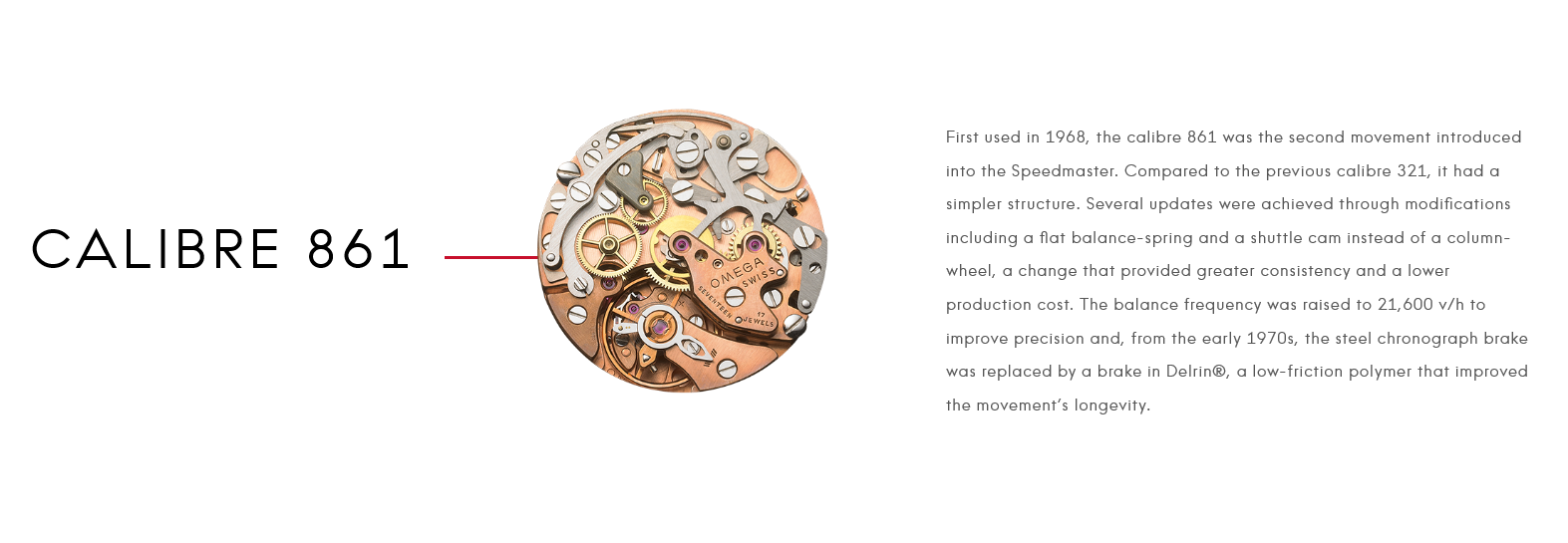

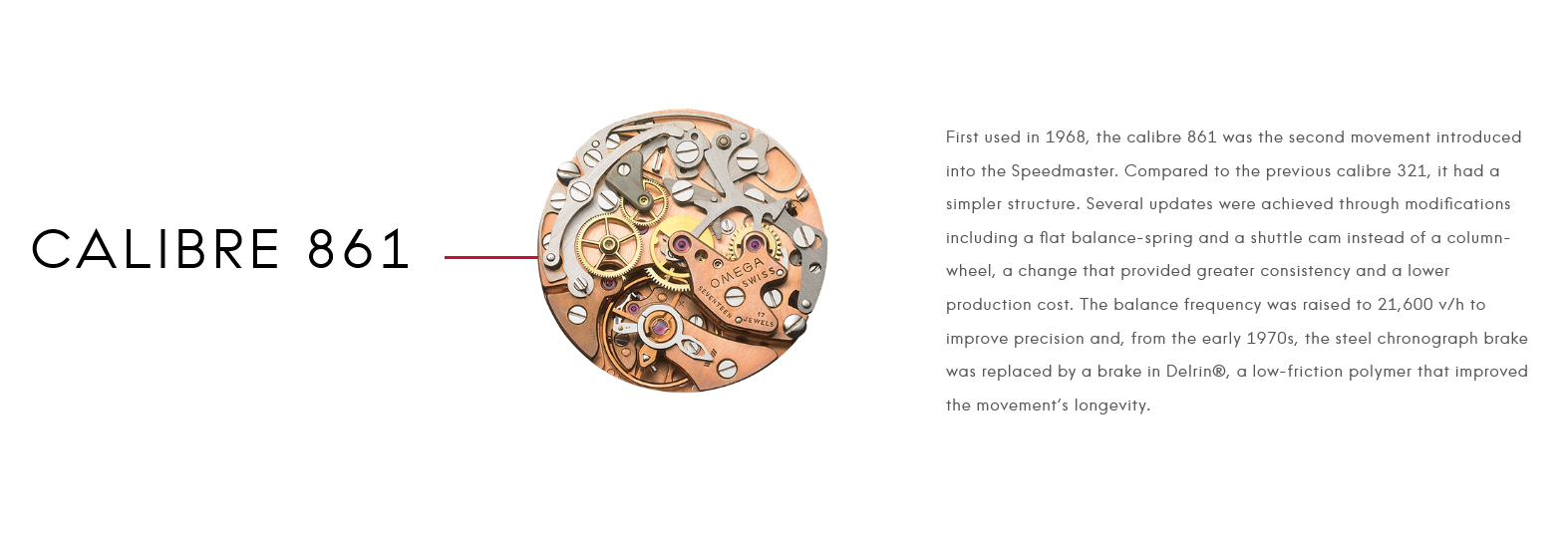

Hi, i bought a Mark II (maybe 145.034 SS) 5 days ago. Right now i can't open the watch and see what´s inside.
Did a little research at the OF before and after buying the watch.
I found this on the official Omega website, maybe it is useful for later discussions about the "Delrin Brake".
1,413
2,947
There’s a bit more on the changeover date from Metal to Delrin here, if that helps anyone
