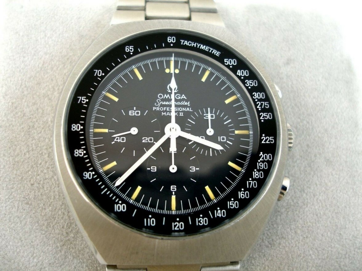

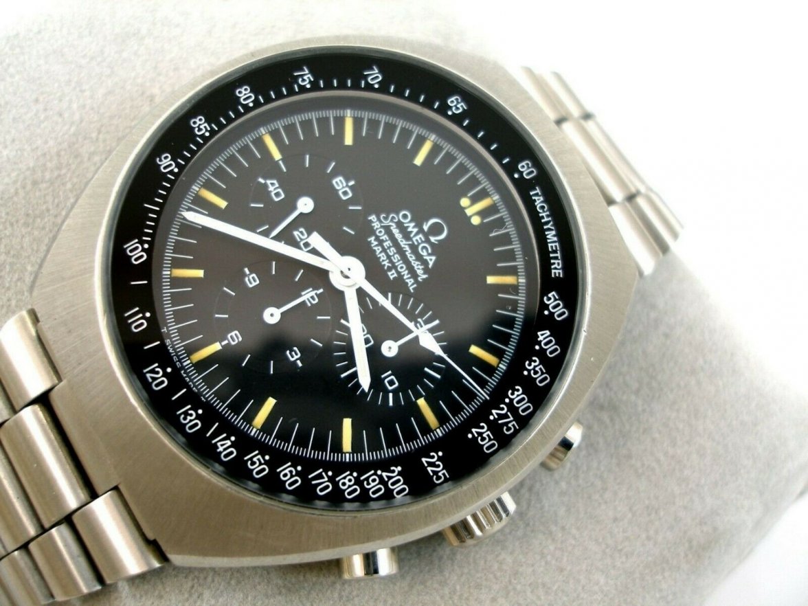

This auction has ended already (no bids), but I was wondering what the consensus collector opinion might be on a watch like this:
https://www.ebay.com/itm/REFERENZ-1...e=STRK:MEBIDX:IT&_trksid=p2060353.m1438.l2649
What I see:
- very nice original dial
- correct replacement hands
- serviced movement (with a few replacement bits)
- not-quite-Omega-grade (?) refinishing job on the case and bracelet
As my quest for a nice Mark II continues, I feel like I'm reaching a point where *any* refinishing is too much refinishing. I'd rather have all of the case's original metal there with scratches and dings than lose a gram to create the illusion of newness...
That said I can't deny this watch still looks pretty nice to me.
So: who would buy this and how much would you pay? 馃槈

The beautiful simplicity of the original Speedy dial pairs perfectly with this cushion case. It's the epitome functional Space Age class. (Also a bit cheaper/easier to service.)
I love Lemania 5100-powered watches (the other piece I'm considering is a Sinn 142), but the 4.5 dial just doesn't do it for me. Too cluttered, and IMO the busy 5100 dial layout really benefits from colour-coded hands for legibility. The Mark II dial really pops in black and white, whereas the Mark 4.5 feels drab in comparison.
I *do* like the Mark IV, though! I find just the elimination of the day window and 24-hr subdial makes for a better visual balance.

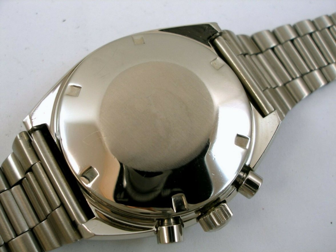

Well, the caseback is ... polished. 馃榿
Presumably if your face looks like a Hippocampus, you will see one faintly when looking at this caseback straight on!

The case back ruins that watch. It would need to go to bienne for a replacement. Sad.

I agree--the person who felt they were improving that caseback definitely has worse OCD than I do. 馃槈

No, No, that is the ultra rare, invisible hippo caseback 馃槣

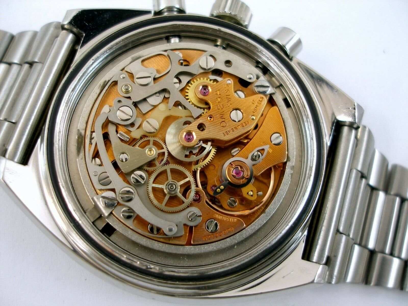

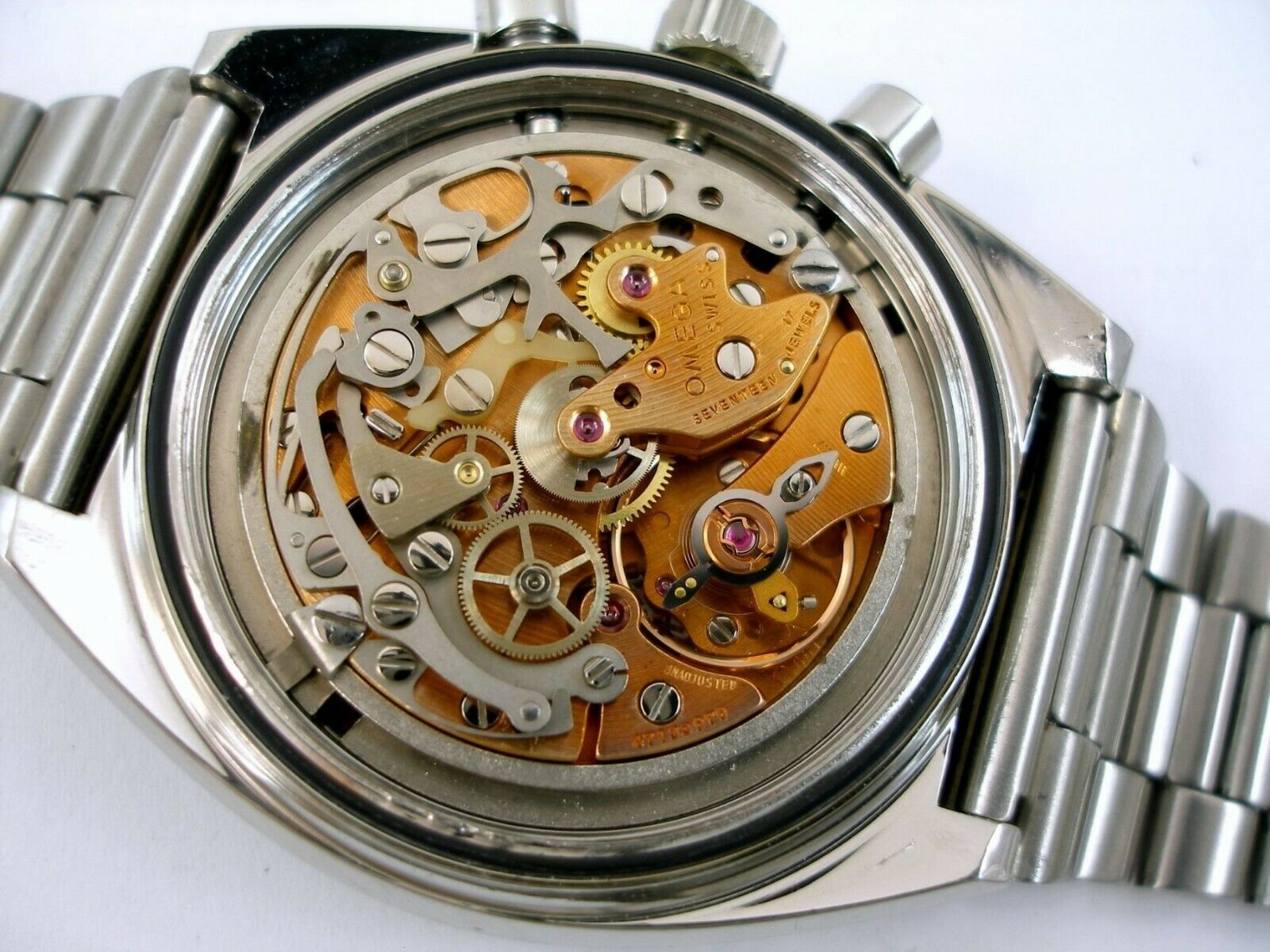

A delrin brake on a Speedmaster Mk2 movement? Surely that doesn鈥檛 match the real age of the Watch?
Seems like more than a possibility that the movement has been replaced. Likely from a mid 80s Speedmaster Pro.
So I think this Watch is likely a parts bin special, Frankenstein special. What鈥檚 it worth? To me, nothing, that Watch is more trouble than it鈥檚 worth.

Good catch on the plastic brake. My eyes are great at spotting missing "gold parts" and mangled screws in these movements, but still tend to gloss over stuff like that.

Very observant Nathan, but I know the later Flightmasters 911 had Delrin brakes, so I wouldn't rule it out on this alone. I am not sure when they stoped production on the Mk II? This 37 mil movement would put it around 1975 I think?
Also I don't know exactly when the Delrin brake came into use either, but I guess around 74/75?
I don't like that case though, so its a no from me.

Isn't the deleon brake a replaceable part? Could it not be a service replacement part?
Honest question, not sure if the delrin piece is backwards compatible or not.

Yes, could be, but I've never had to replace a steel 2-piece brake. These aren't exactly wear parts...they really never need replacing unless it's something like rust...
