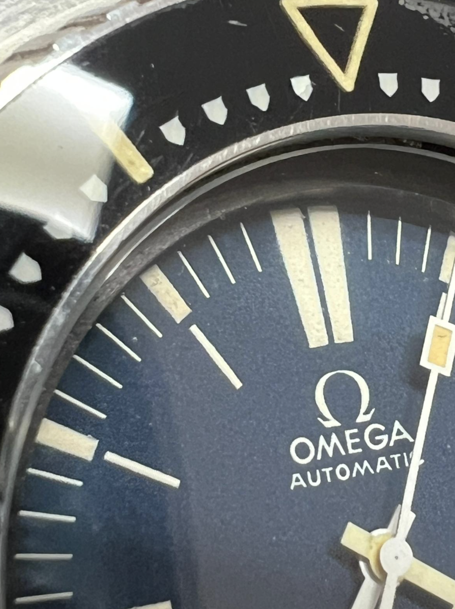

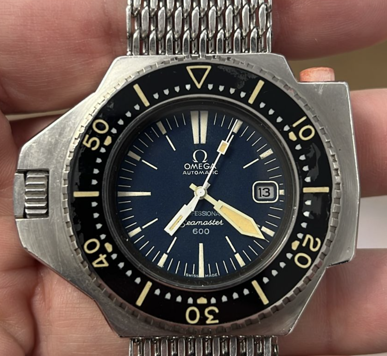

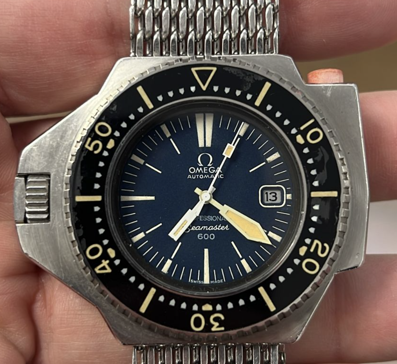

I am really keen on this Ploprof but have noticed a couple of things that need some discussion. Everything looks okay in terms of authenticity I think, but please speak up if you have a different view.
Only two owners and the last for thirty years.

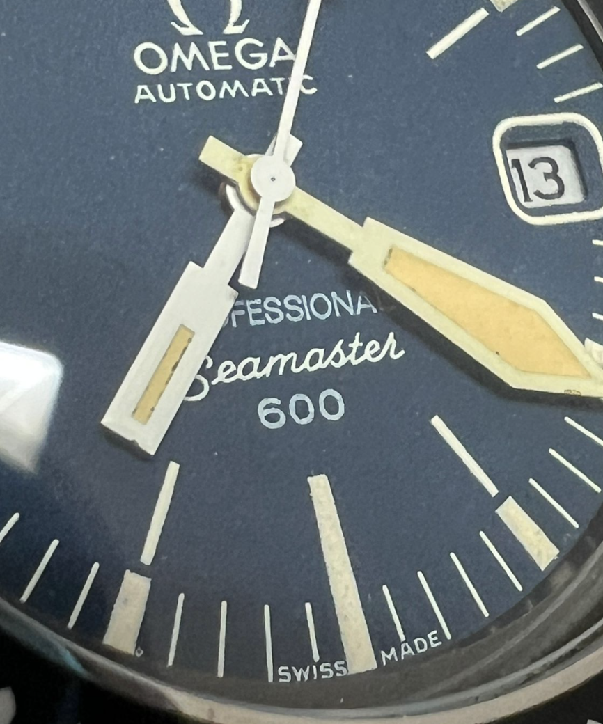

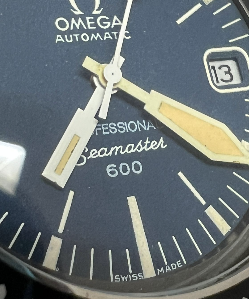

1. The hour hand pointer looks like it has snapped off or is this some hand I haven't seen previously ??

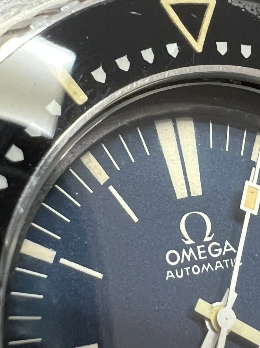

2. A bit of what looks like "fogging" on the bezel is I am reliably informed where the insert is pulling away from the bezel itself - looks like it will out-see me though.
Appreciate any comments and I reckon I could live with a missing hour tip if I had to 😁
And a happy and prosperous watch hunting new year to all here on ΩF.
1,916
3,975
Looks nice. The hour hand is original and quite a rare variation. Bezel will be fine. Original red button is a bonus. Can you get the serial number? If the price is right buy it!
