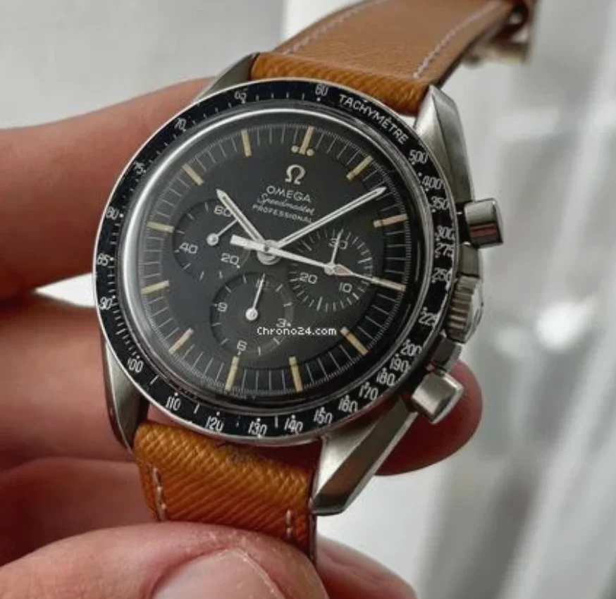

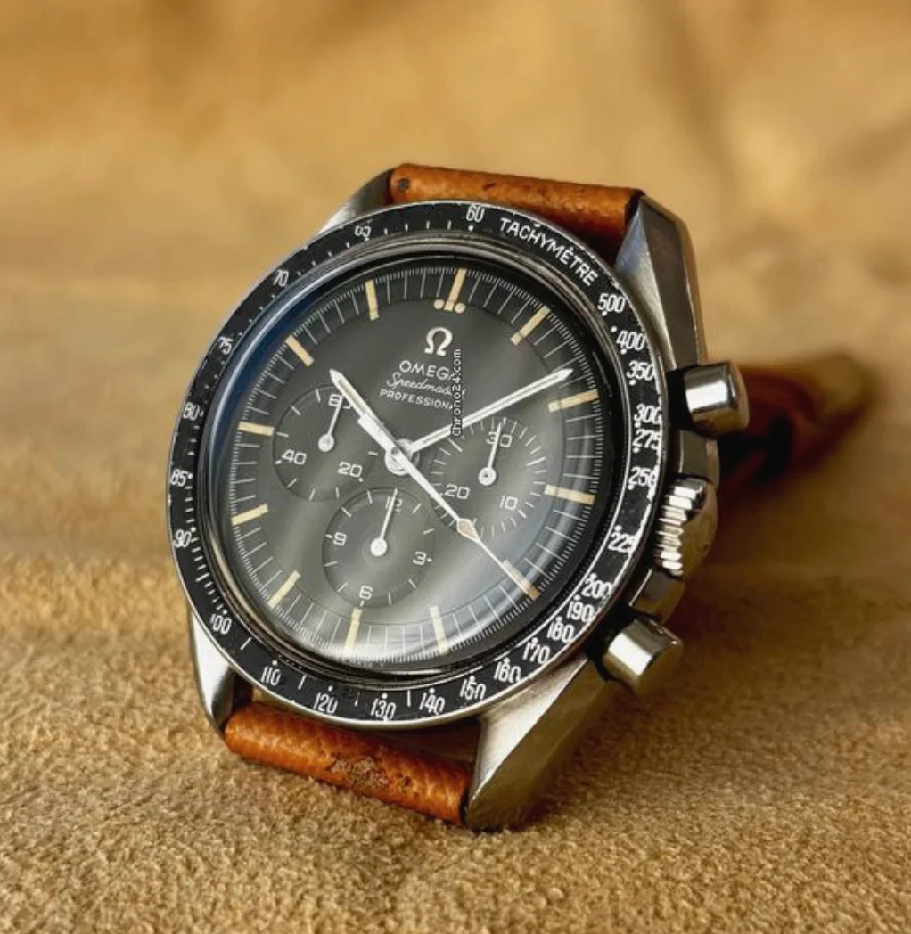

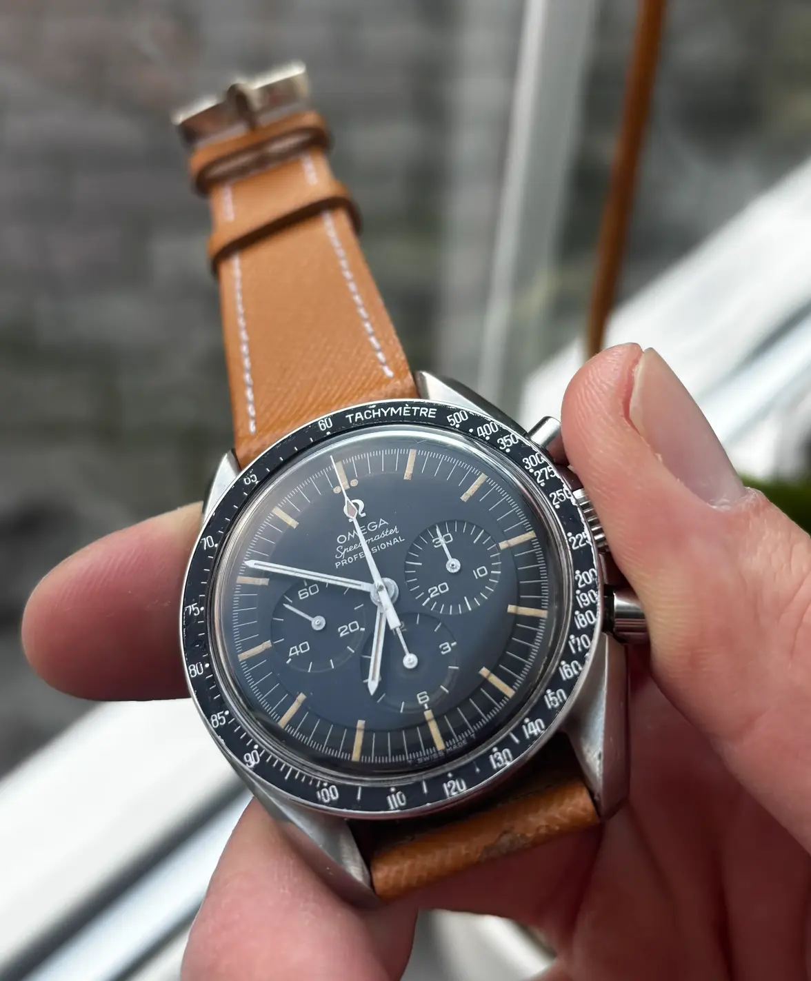

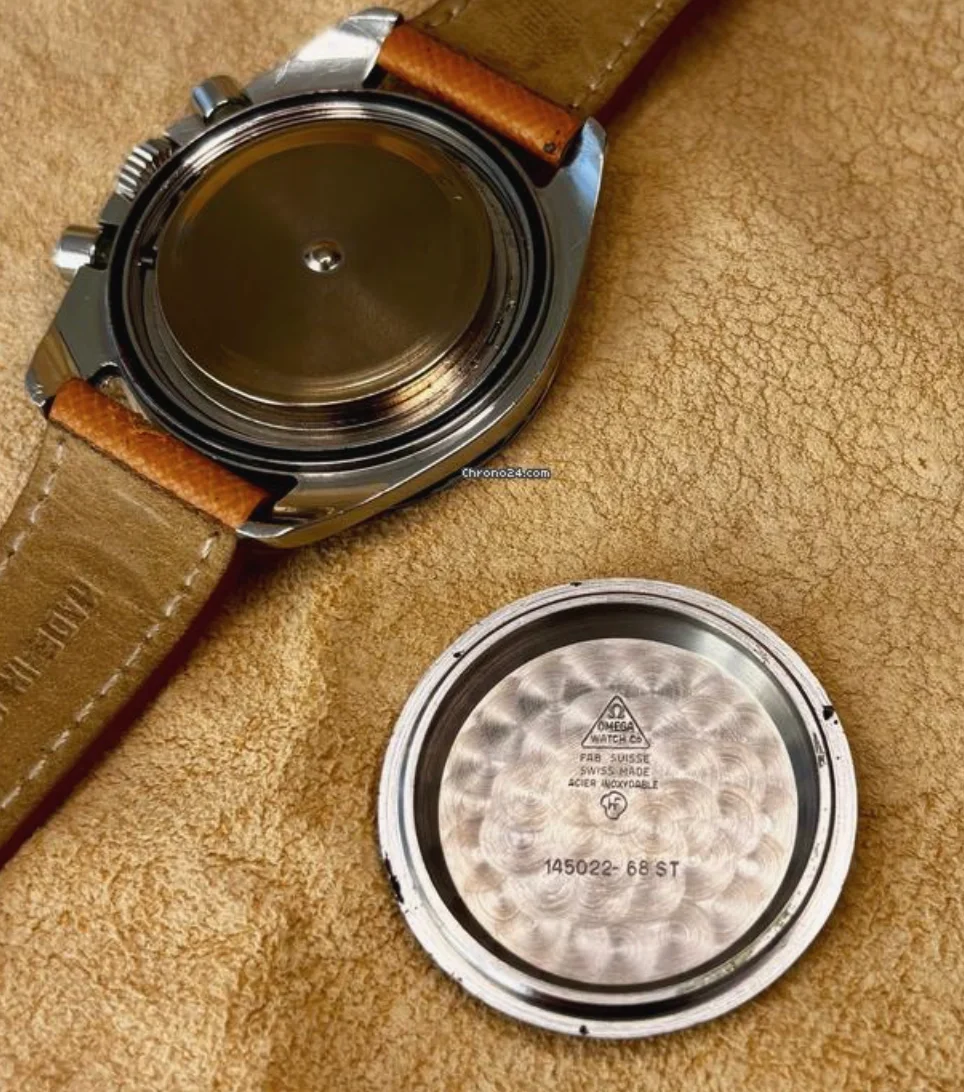

Thoughts on this 145.022-68st ?
71
39
Found this beauty on c24.
The seller tells me everything is original, besides the crystal which is not an original or omega (which I could perhaps live with)
Its a privat seller, so Im just taking all the precautions I can.
Are there anything that can tell me if anything looks out of the ordinary ?
The watch comes naked.
Any input is highly appreciated.
best regards:
The speedmaster novice.
1,477
6,483

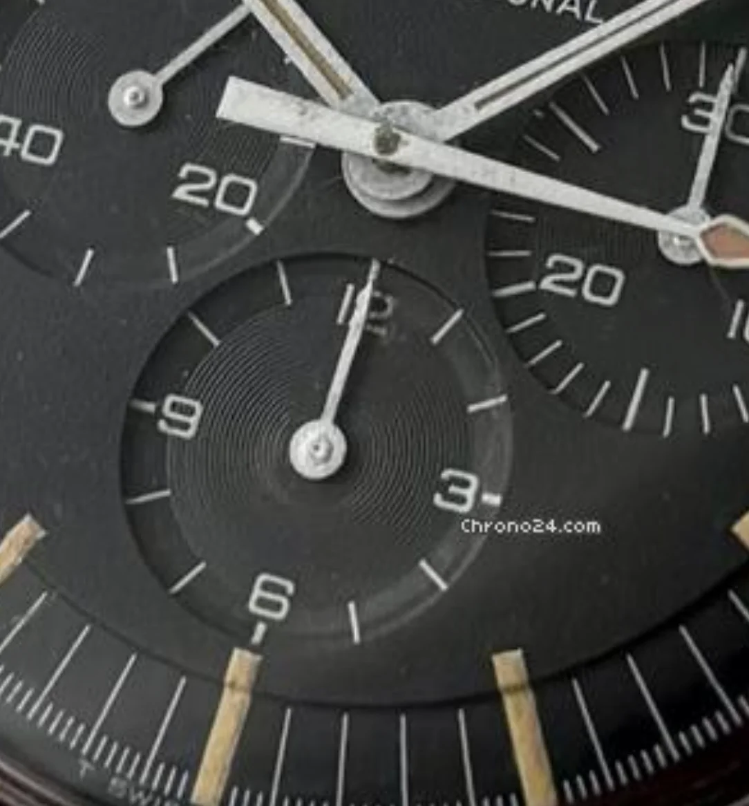

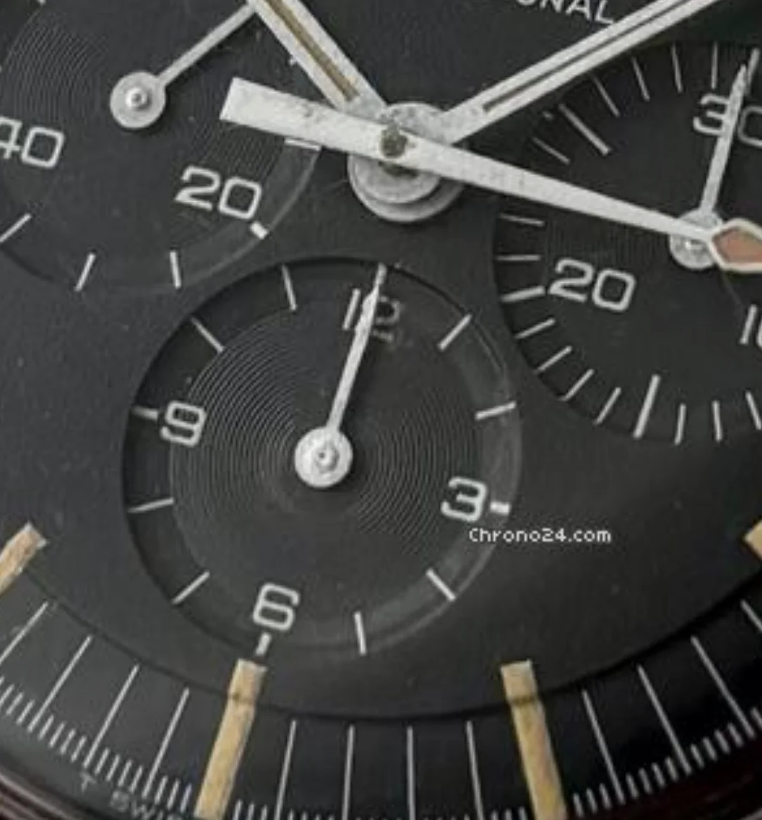

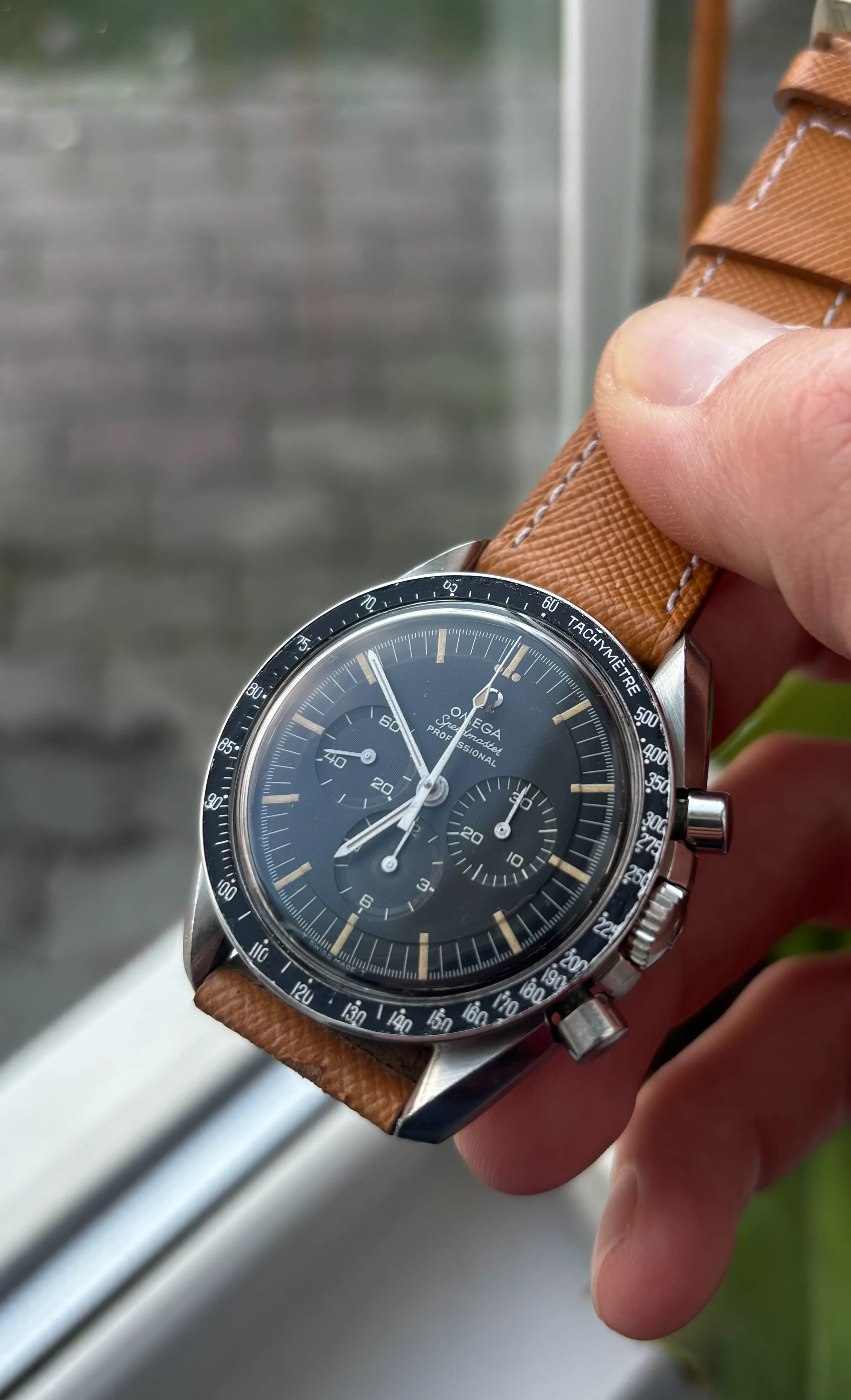

Looks like a pretty good specimen at first glance. It appears original indeed. Also, the lume colour of both dial and hands are not uncommon and pleasing to the eye.
To err on the side of caution, I would like to see a high resolution image of the bottom subdial though. It appears as if the centre is very shiny and that the corresponding subdial hand is repainted (the centre looks a bit blotchy). Both could indicate that there's been an issue with oil or water ingress there. Might not be an issue, but better pictures can rule this out.
2,206
3,020

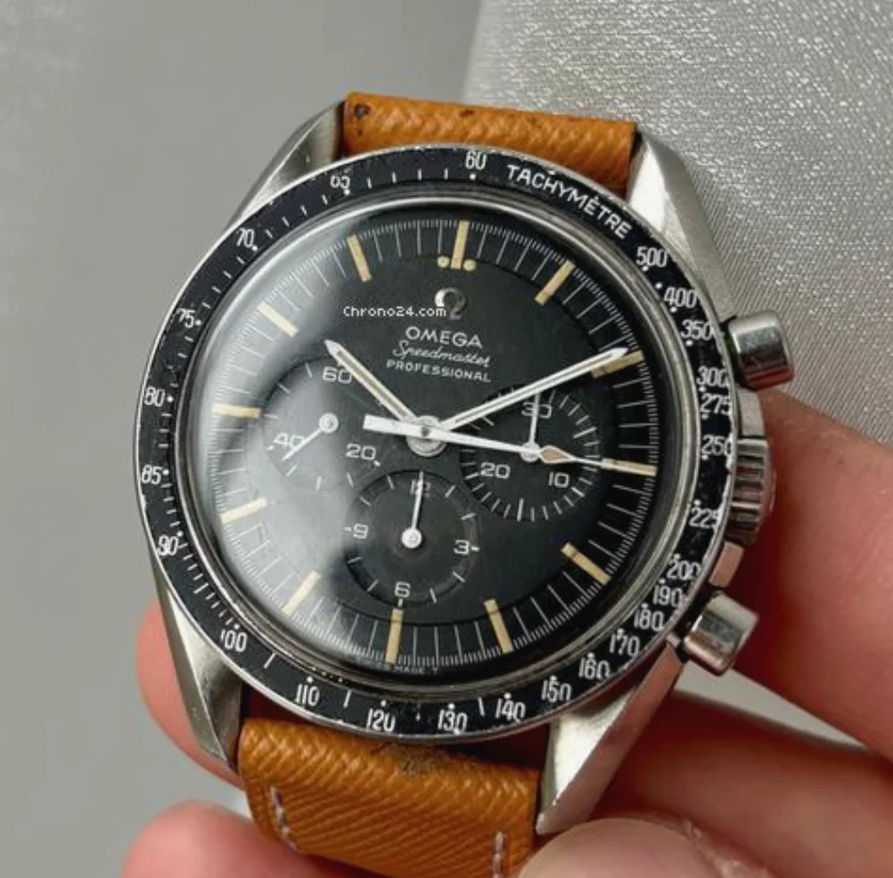

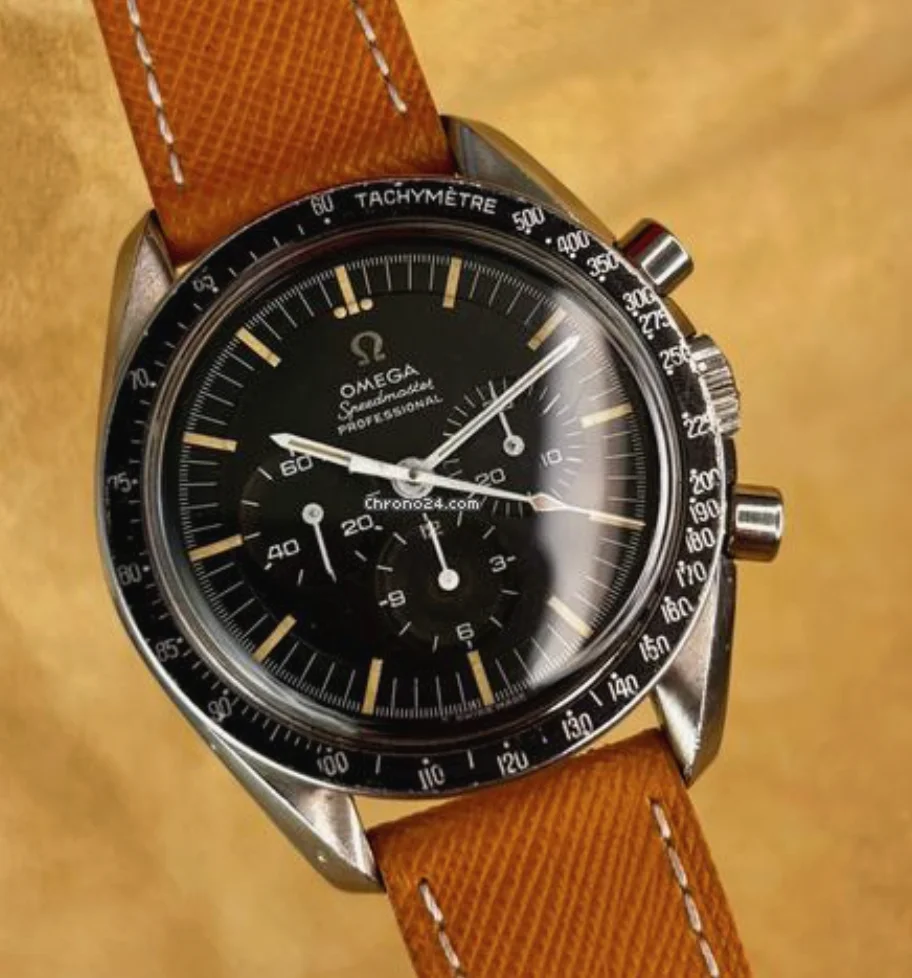

Speedmaster prices are not at the top right now, so you can afford to be picky

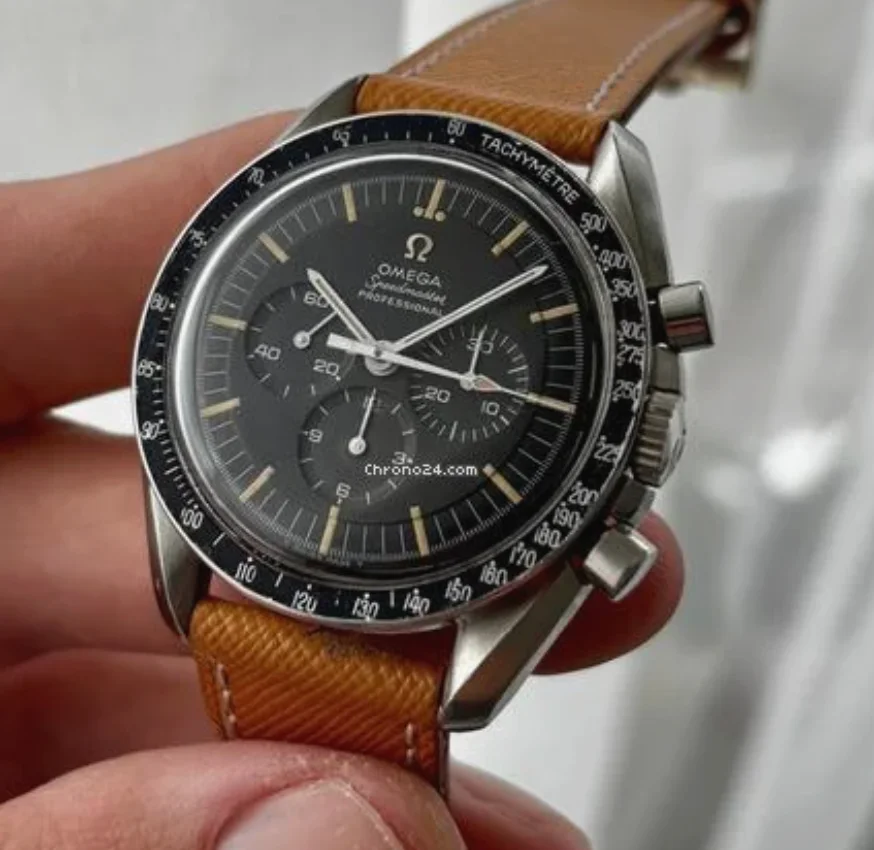

The DON bezel is not in good shape several areas look suspicious, maybe they were touched up with black paint. For example between 75 and 80 and at 120. Lots of tiny holes around 65
Are these corrosion holes?
Pictures are not the best, not corresponding to the asking price...
71
39

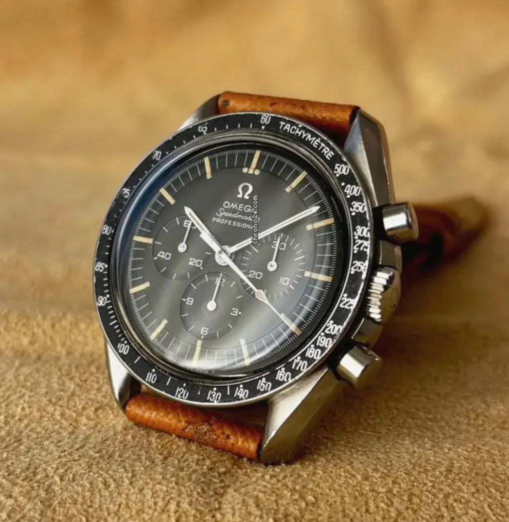

Appreciate the feedback !
I think its difficult finding a nice clean pre-moon with applied logo and nice even patina. Perhaps its just me.
71
39

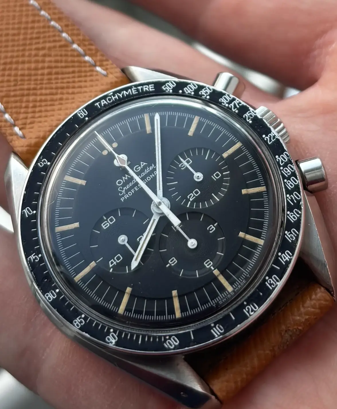

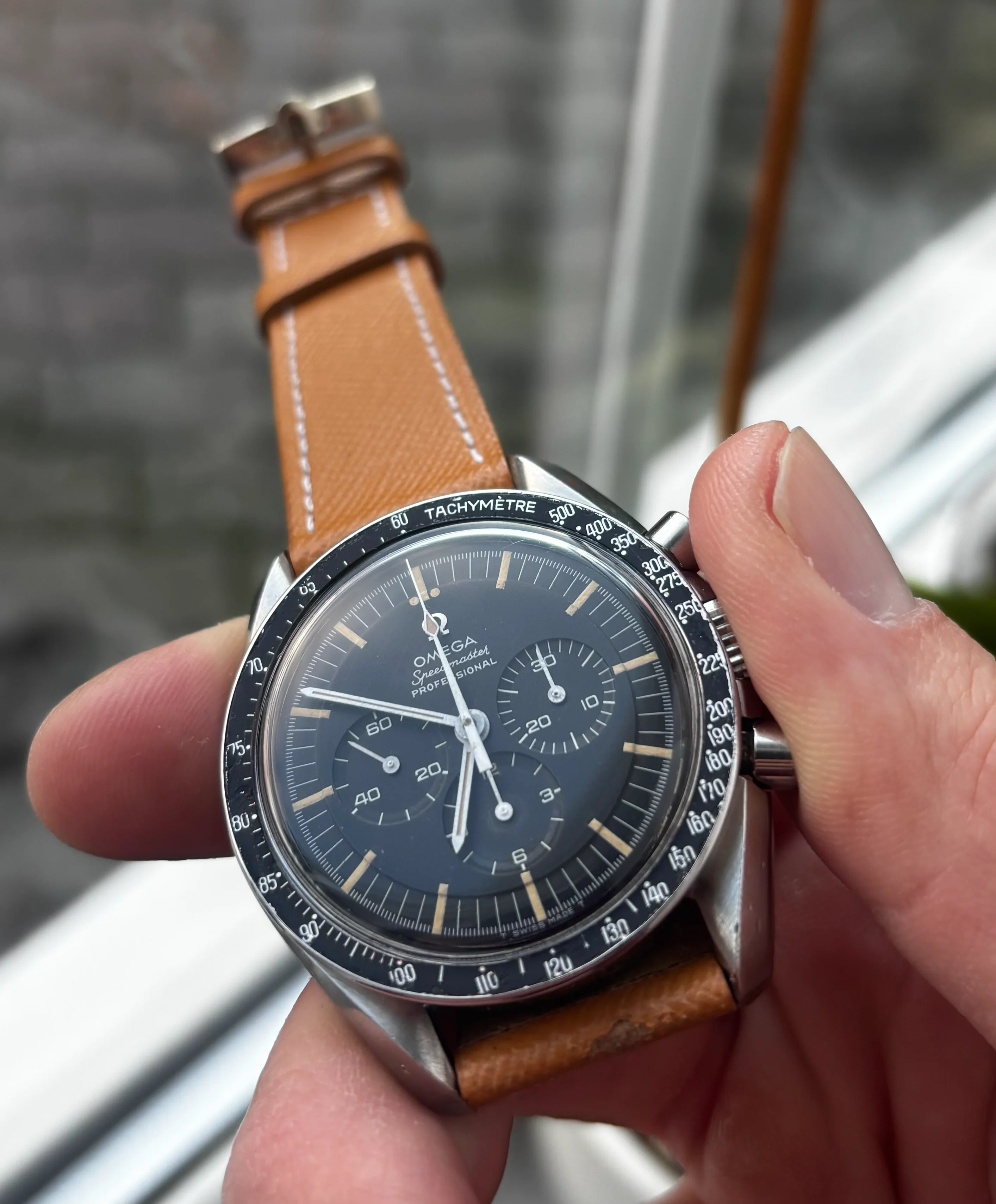

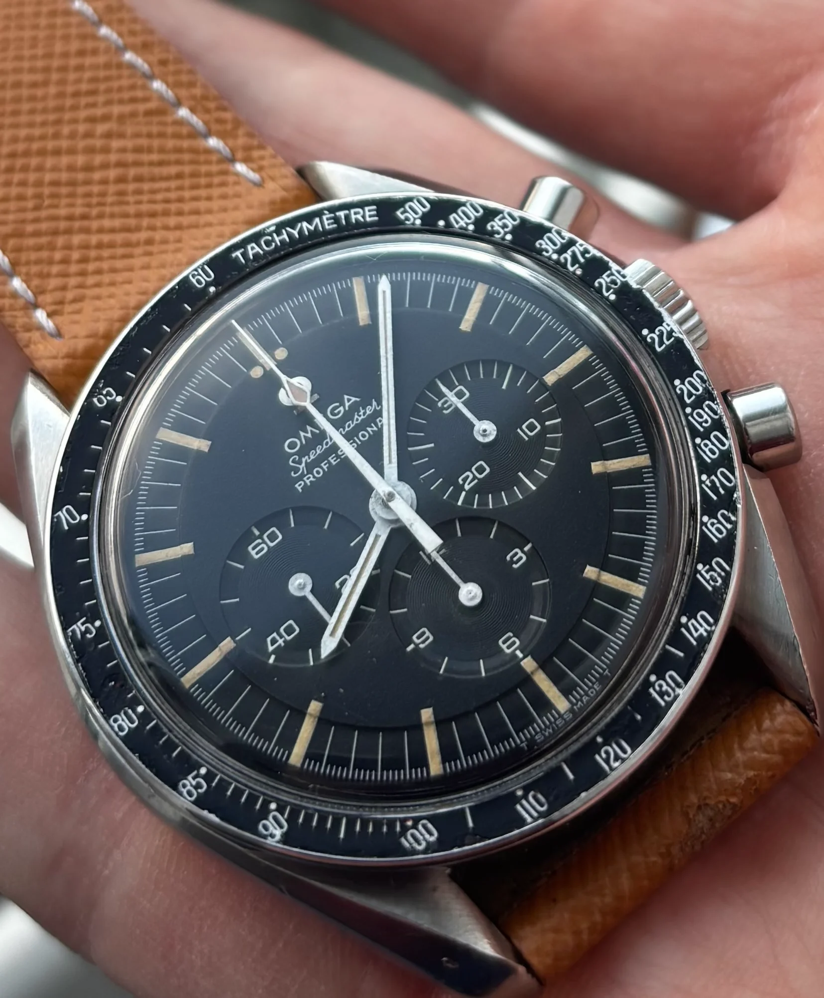

tried zooming in - does this help ?
38
16
Yeah looks like a white repaint. But depending on the asking price it’s not a big deal and can be found and replaced. .. again like said. All depends on the price and what you are looking for. To store or to wear the fun out of it.

How much is it?
I'd reserve judgment until the seller provides some photos in daylight from all angles of the watch. I would also caution you not to buy with the intention of changing parts - unless you know someone with a stash of parts or you are willing to wait (years?) to find them on eBay, it's very difficult to source vintage Speedmaster parts.
I wanna wear it, no safe queen!
He is asking around USD 7700 for the watch.
Both I and seller is located in EU, think speedmasters are just more expensive overhere than in the US
71
39
It'll be entirely dependant on price, the problem with these 145.022-68s is that on one hand they represent a value proposition and cheaper to maintain movement over Cal 321 Speedmasters, but then then correct bracelet for them is still fairly costly and they have a DON bezel, so a big chunk of the value in the watch is tied up in something you're going to whack into door-jams.
For this reason I would only really look for these if there is a good deal to be had, or if they were discounted due to a replacement bezel, and consider the 145.022-69 SW to be a much better value and frankly more interesting alternative, or a 145.022-71 for even less.
but both the 69 and 71 doesnt have the applied logo, right?
I really like that look. Also there's just something about a pre-moon speedmaster.
71
39
How much is it?
He is asking around USD 7000 (EU based) however said he was willing to cut a bit of the price. I am not looking to swap any parts. Just wanna wear and enjoy the watch

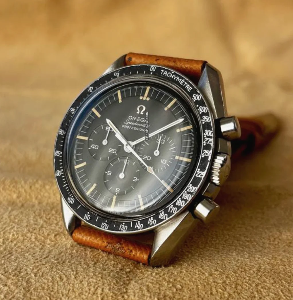

Greetings, and welcome to the exciting world of Speedys!
The one that you are looking at, as mentioned by others:
You need better and more close-ups, specially of the dial (and from different angles).
You also need pictures showing the sides of the case/caseback.
The bezel is not so nice, and looks weird..
The hands on the subdials have had paint job done, and this is always a warning that there could be other things done.
Maybe not a biggy, but check it out?
Has the watch been serviced, with proof?

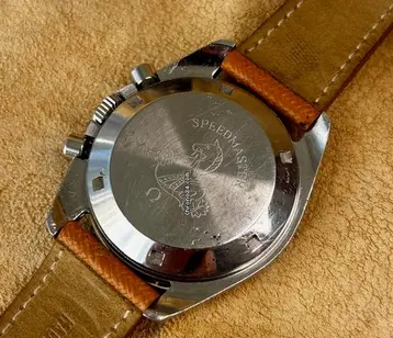

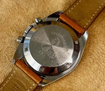

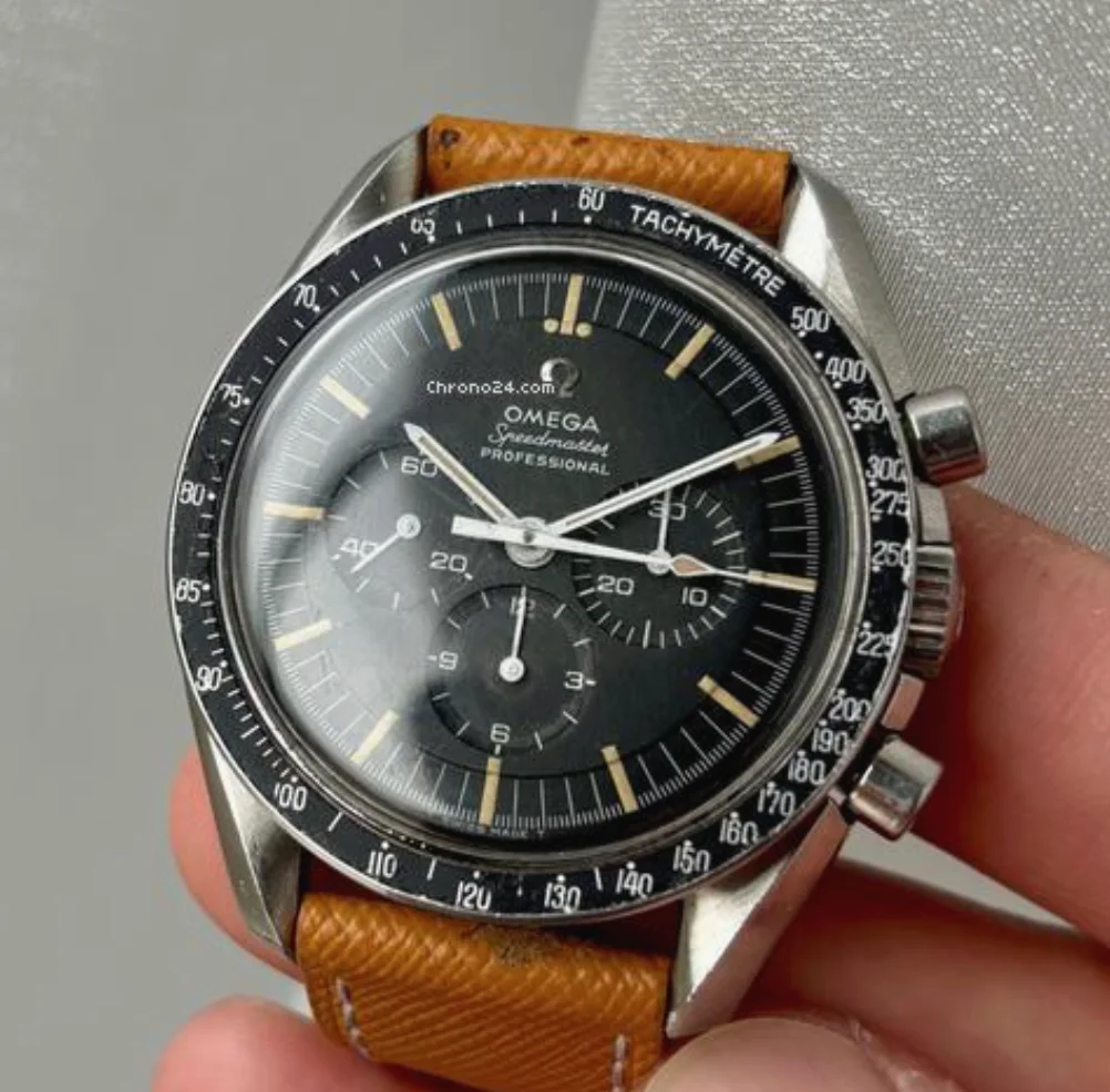

Can only support you with that, the OP one also has corrosion holes on the back as it seems...

Judging only by the photos posted, I wouldn’t pay +/-$7000 USD for that watch. It just doesn’t have a strong aesthetic appeal. If this is your approximate budget, I would set my sights on a 144.022-69. Look at this watch compared to the one your posted:
This watch has strong visual appeal and a case in such nice condition that you would look at it and smile everyday. Just take your time and make sure to look at many many many (many!) watches before you decide.

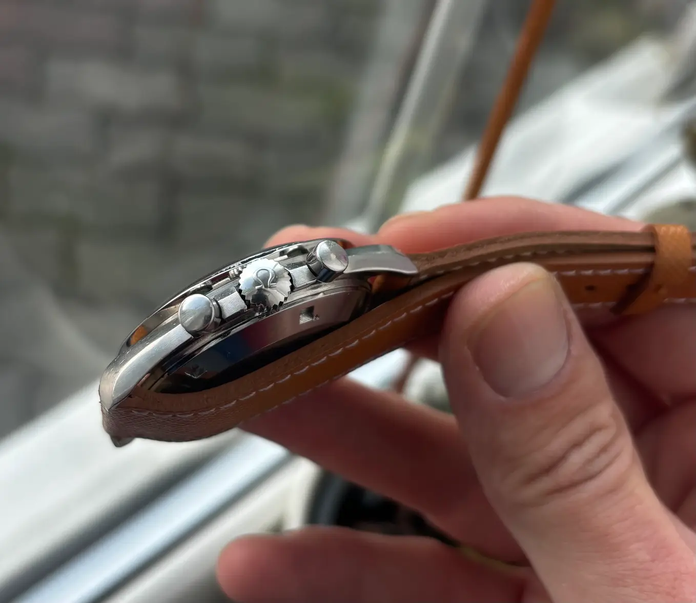

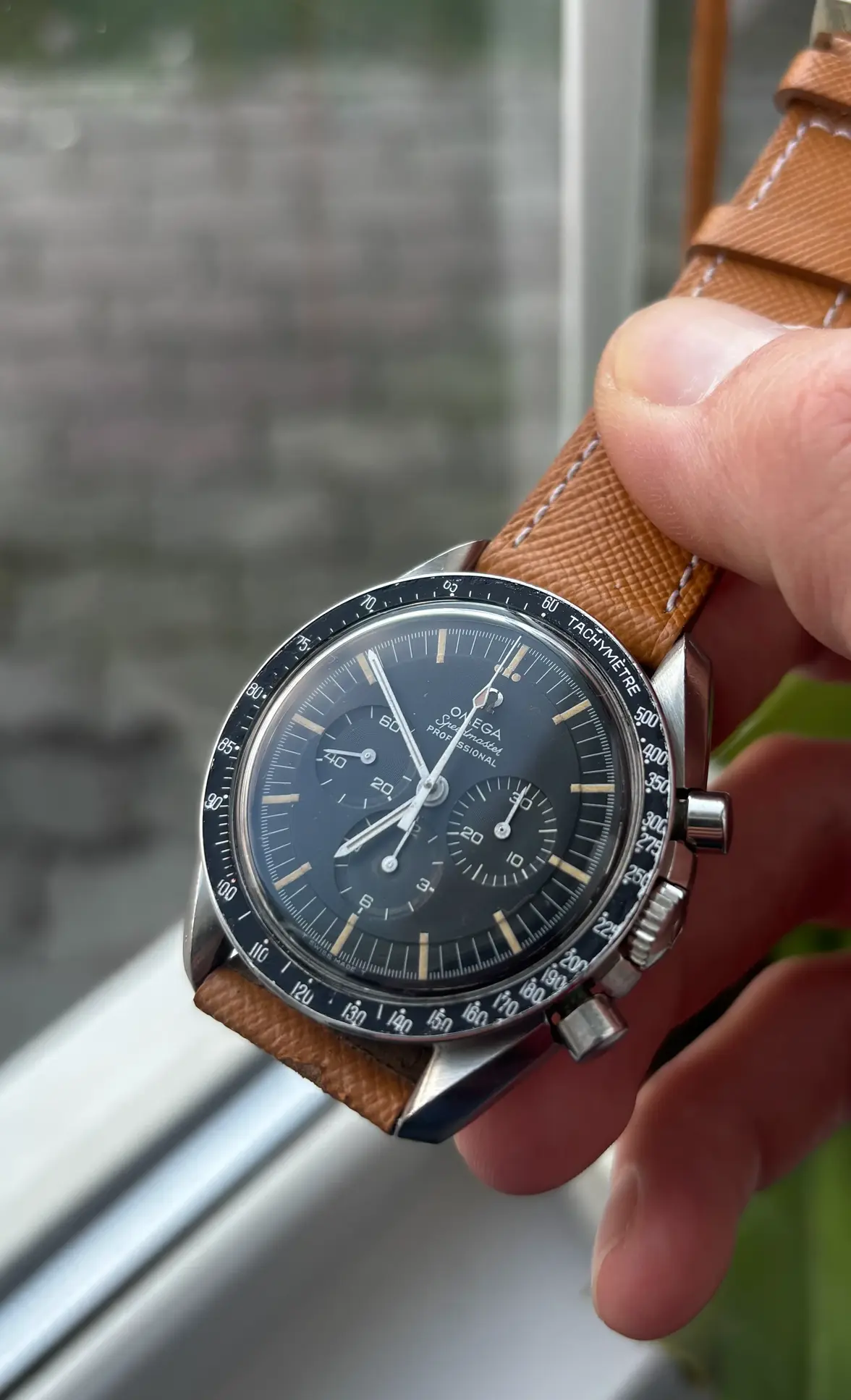

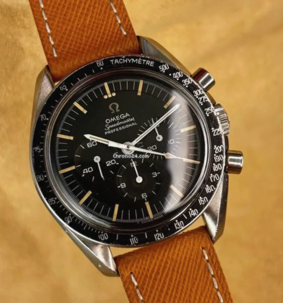

Just got a few more and better pictures - indeed the bezel looks a bit rough
