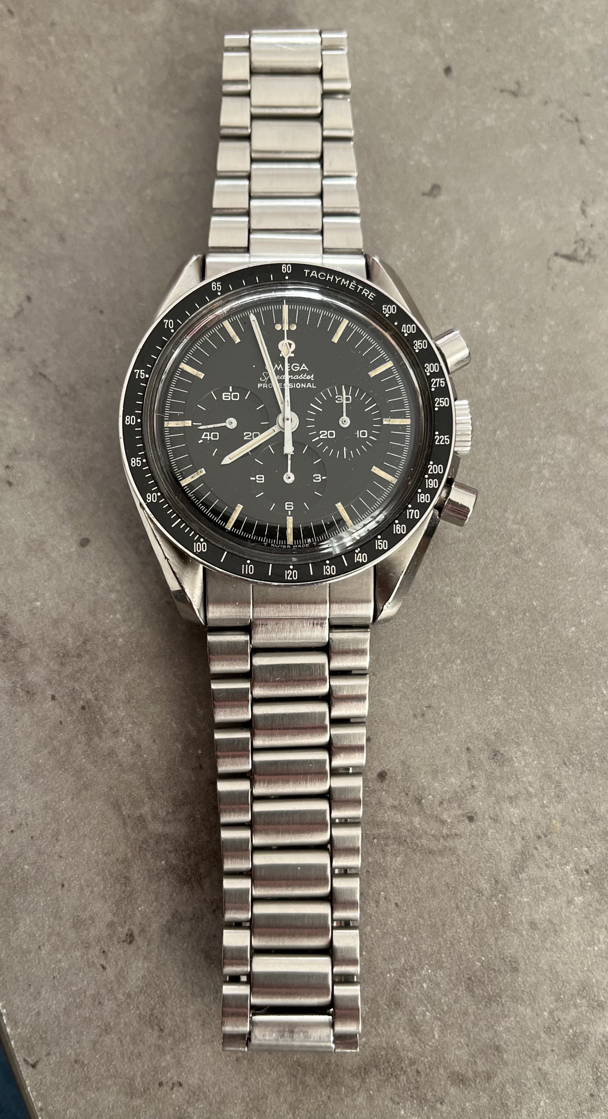

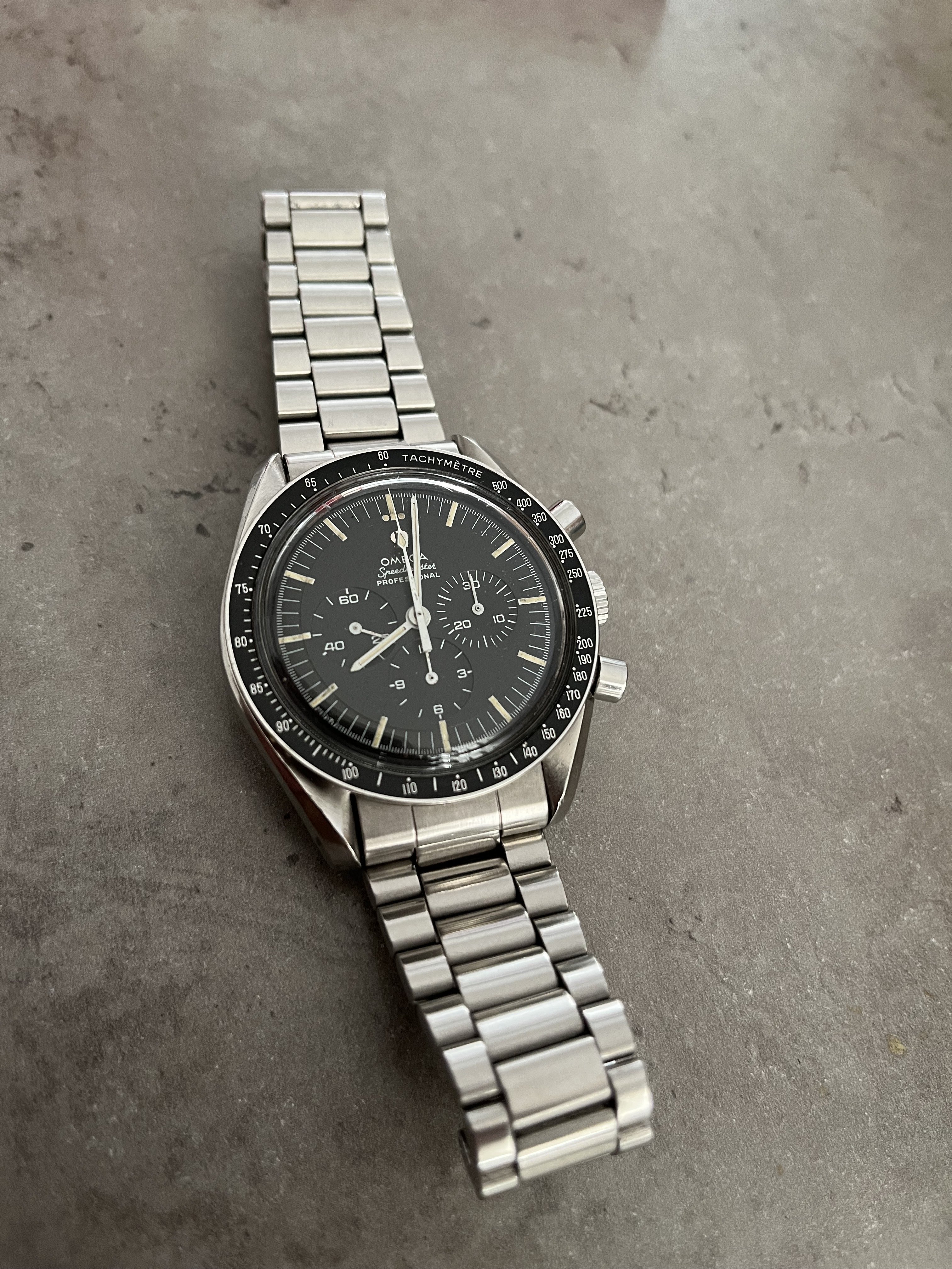

Recently got offered this 145.022 with serial 27323xxx. My first question is - Is it a -68 based in the serial? According to speedmaster101 -68 should have a low serial (between 26m to 27m). This example is just above 27m.
My second question is if this is a -68. How much would be fair for this example? Bezel doesn’t seem correct as it should have a DON bezel if I’m not mistaken. The dial has an applied metal logo which should be correct? The 1171 bracelet with 633 ends seems incorrect for the reference which I don’t mind. What else should I look out for? 😀
Here’s some pictures I got from the seller.

For valuation, start with the speedmaster101 price chart for the reference in GOOD condition. Then subtract the value of a period correct bezel (the OP bezel is a service piece without much value) and add the value of the bracelet. Both items are readily available on the open market, so their values are easy to research with a little effort.

The bezel is a replacement as you said, the crown is also a service one. For this reference the crown needs to have the narrow flat feet Omega sign. Case has seen some polishing and the dial has some markers which are not very attractive.. It has some issues but it also depends on the price and on how much you care about the things I mentioned. It could be a daily wearer but for future resale you need to take into account these issues..

As Dan says, start with a value in sp101 price chart and add/subtract depending on condition and parts.
If the case and dial are good then start there. If the dial has any damage or the movement isn’t good, then start with fair-good. It’s hard to determine whether there’s any damage to the dial from those pics.

Further to the advice already offered - an 1171 bracelet is not correct for a 68ST. The example fitted is a much later service replacement.

Look at the FS section on this forum, there have been a few posted there lately.....$6.5K is too much for this.
