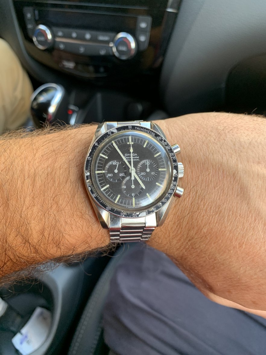

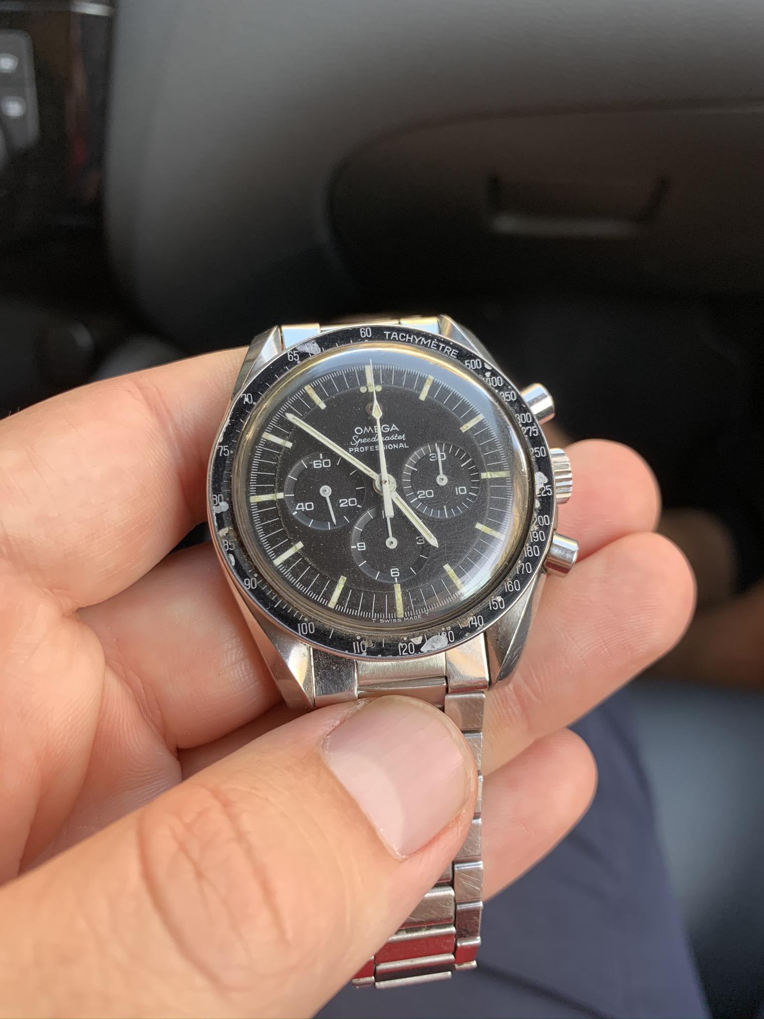

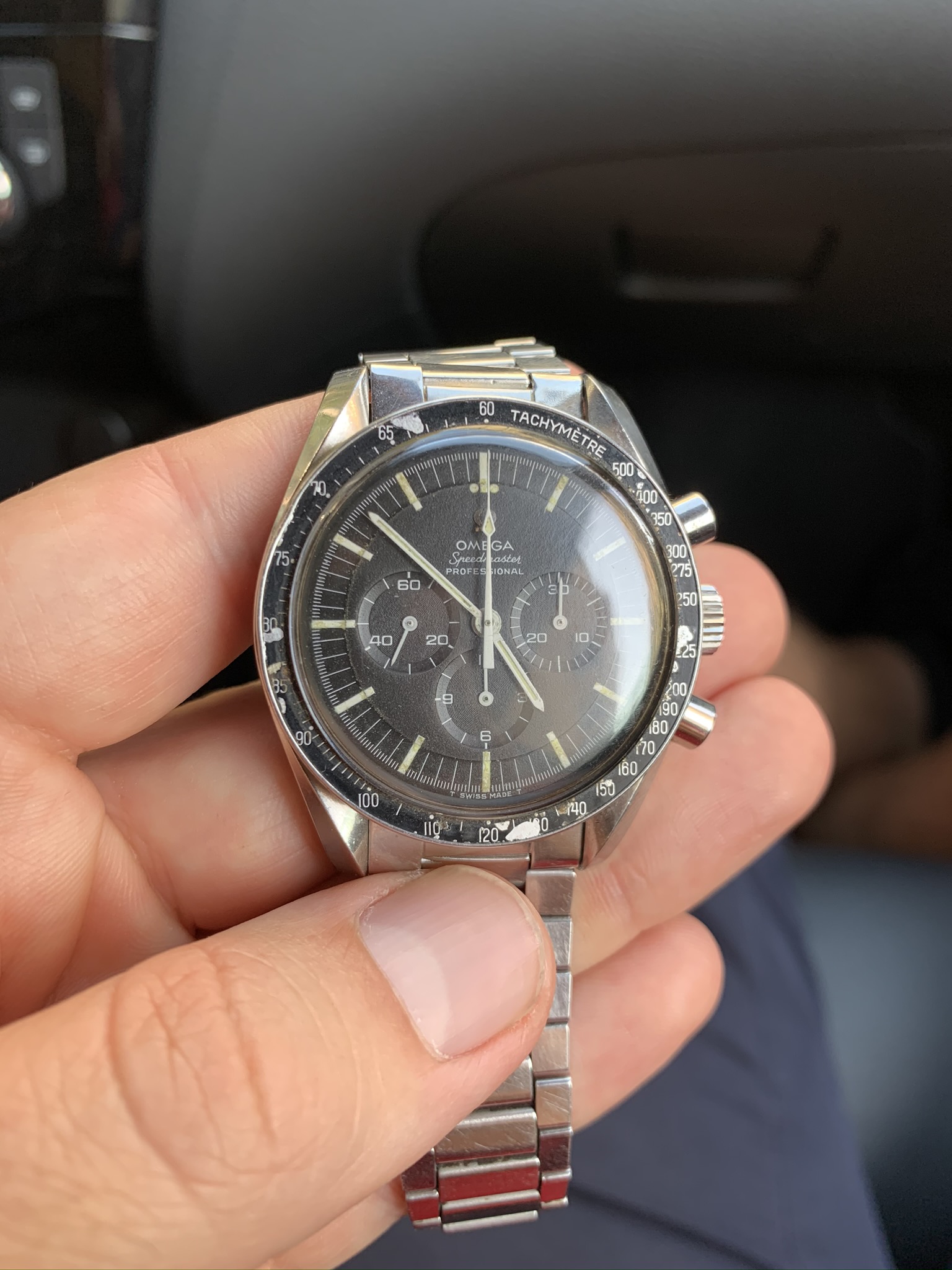

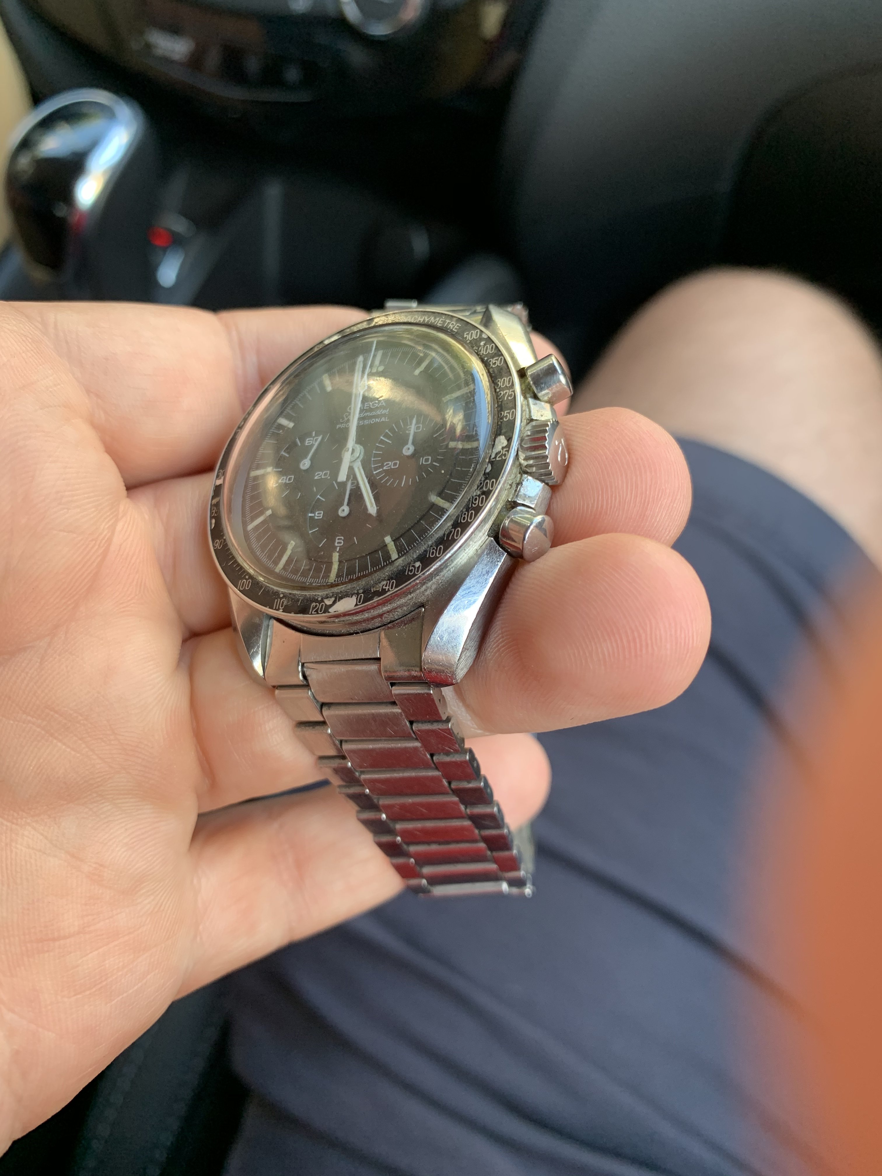

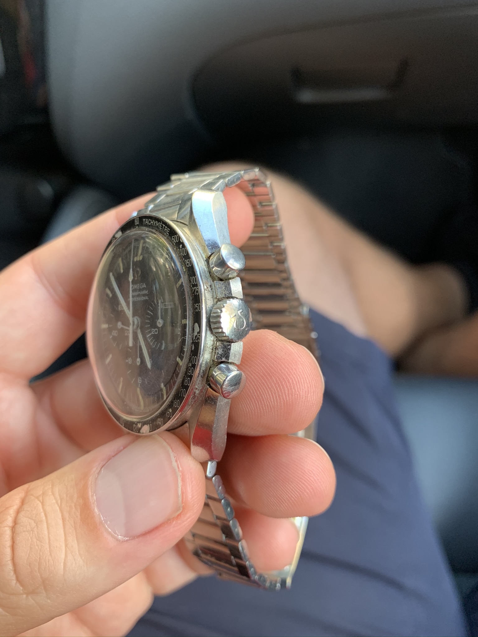

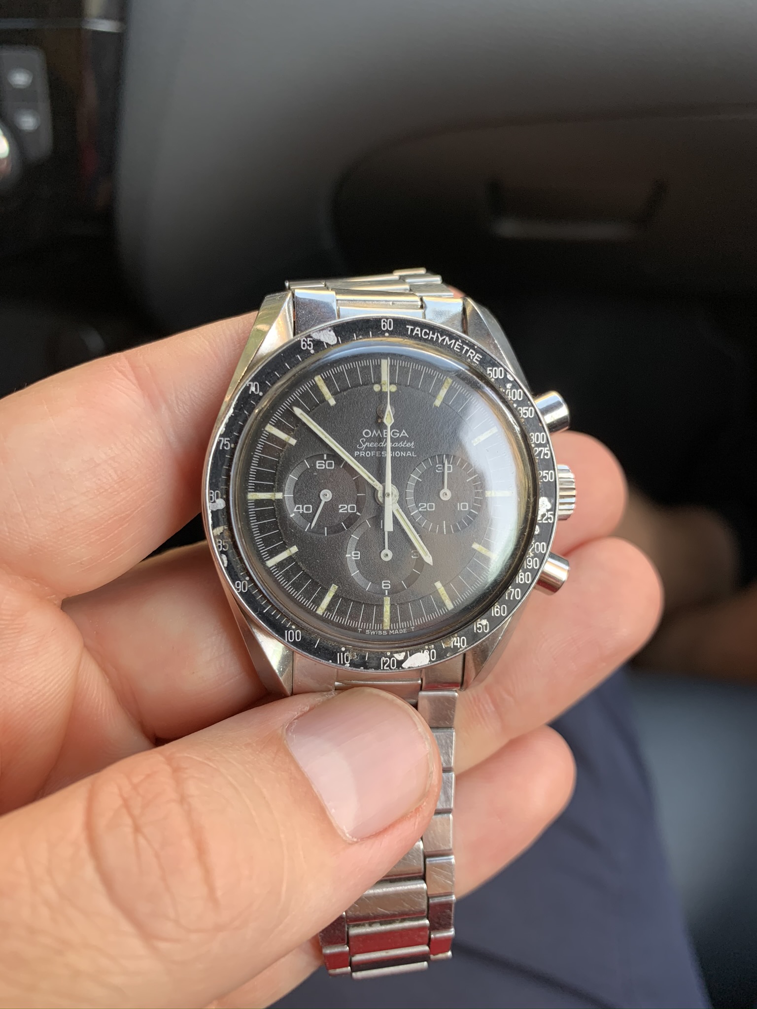

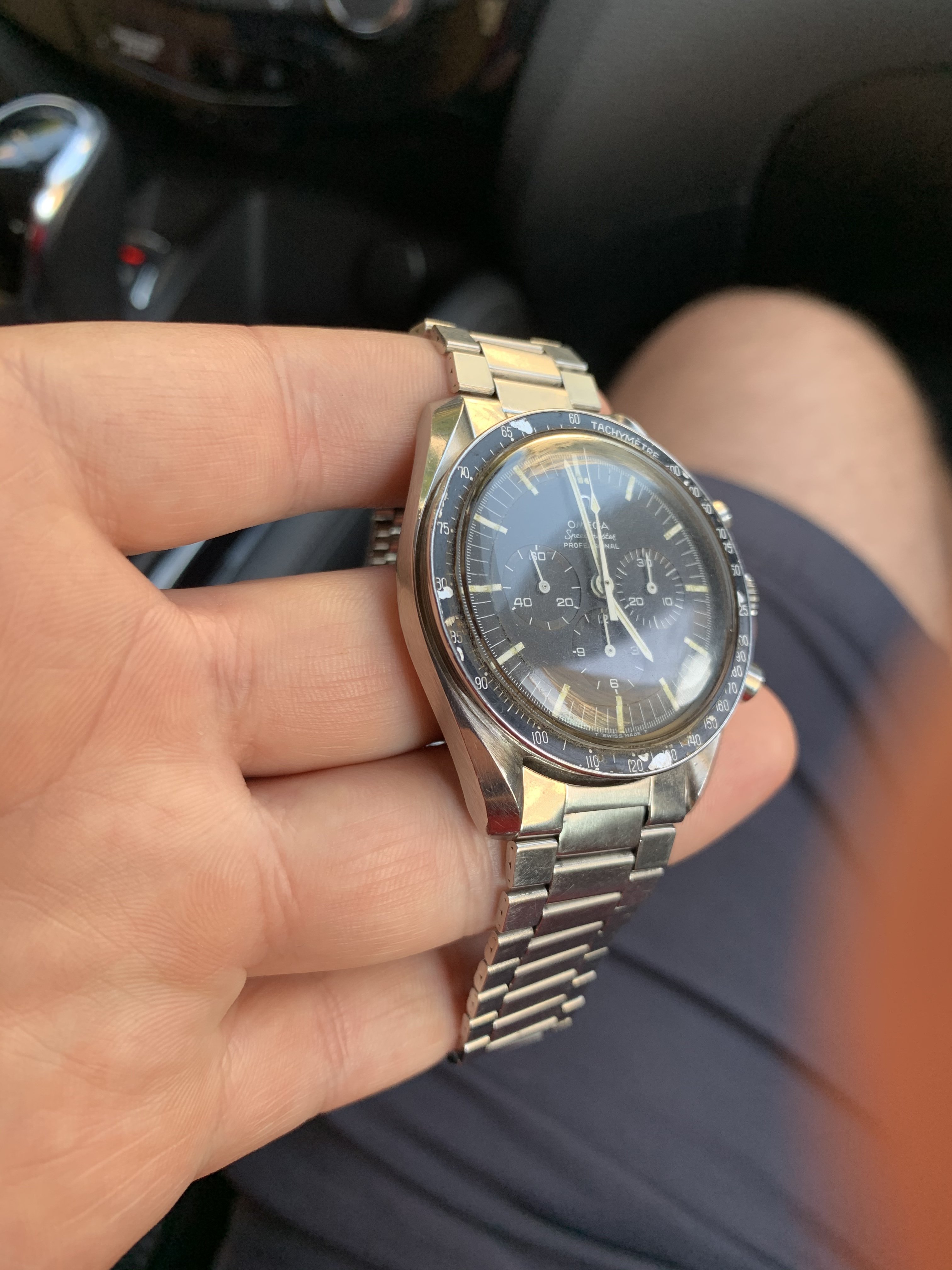

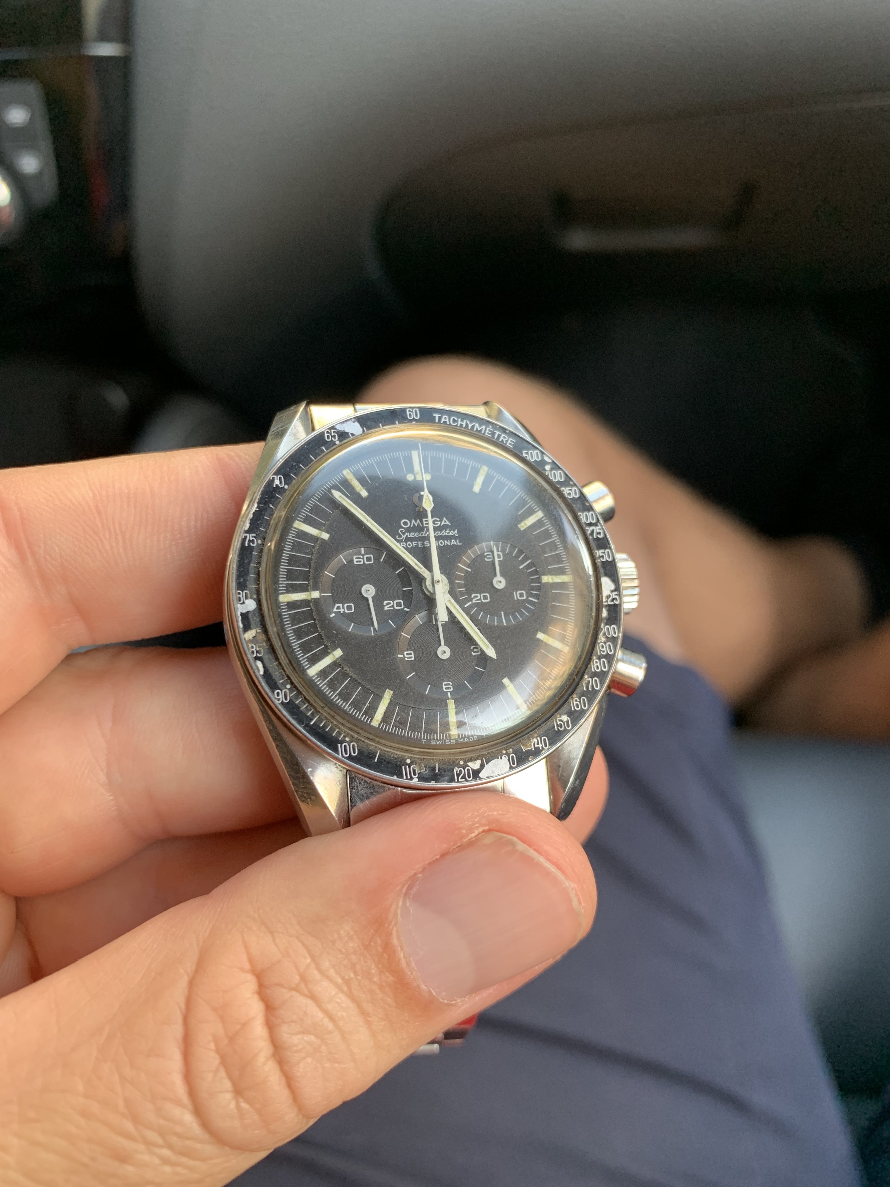

Thoughts on this 145.022-68
825
1,808

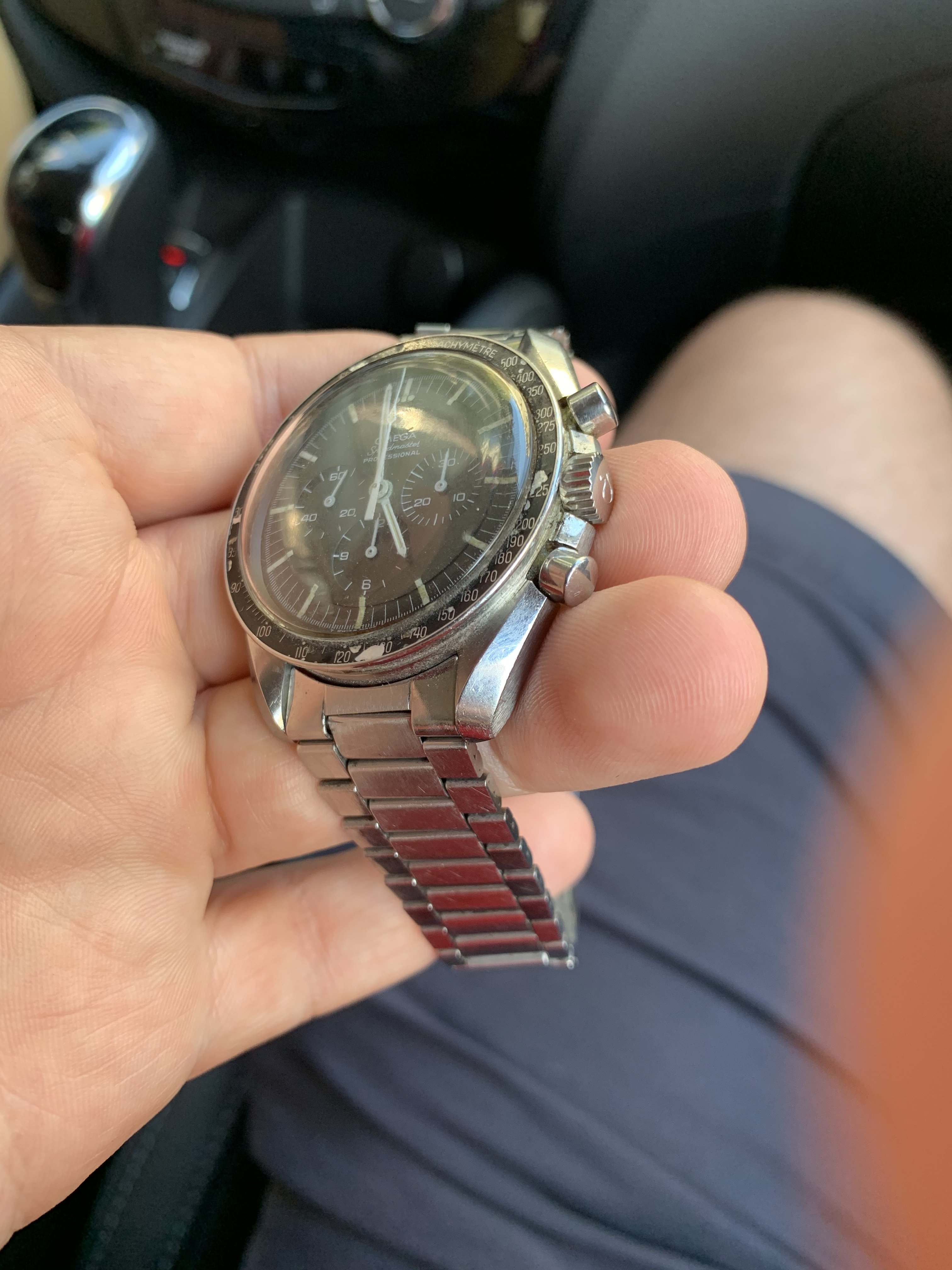

Well the Chrono hand seems to be wrong but I didn’t study it much. The bezel seems to have survived a nuclear blast.
383
412
anyone spot even one?

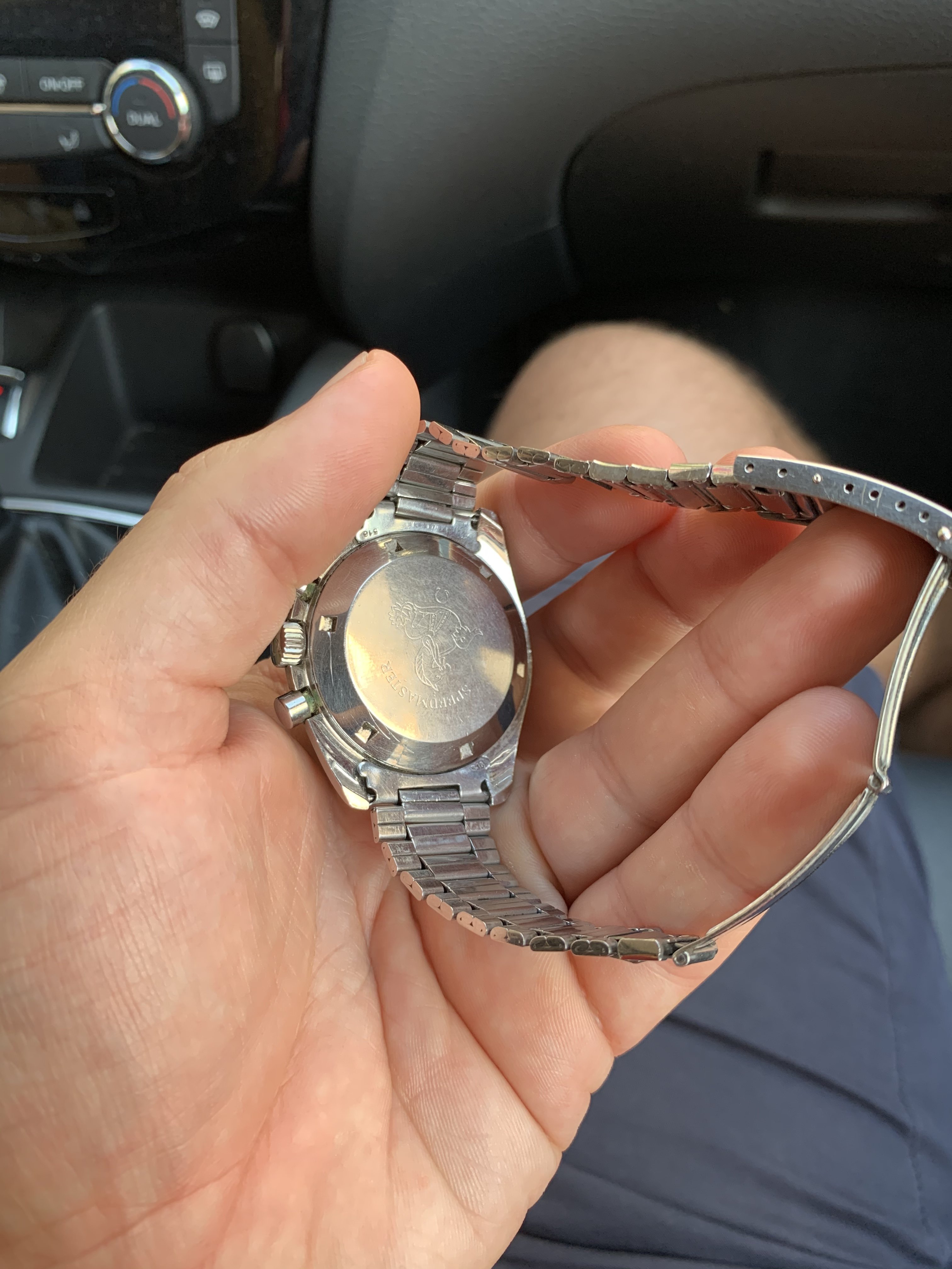

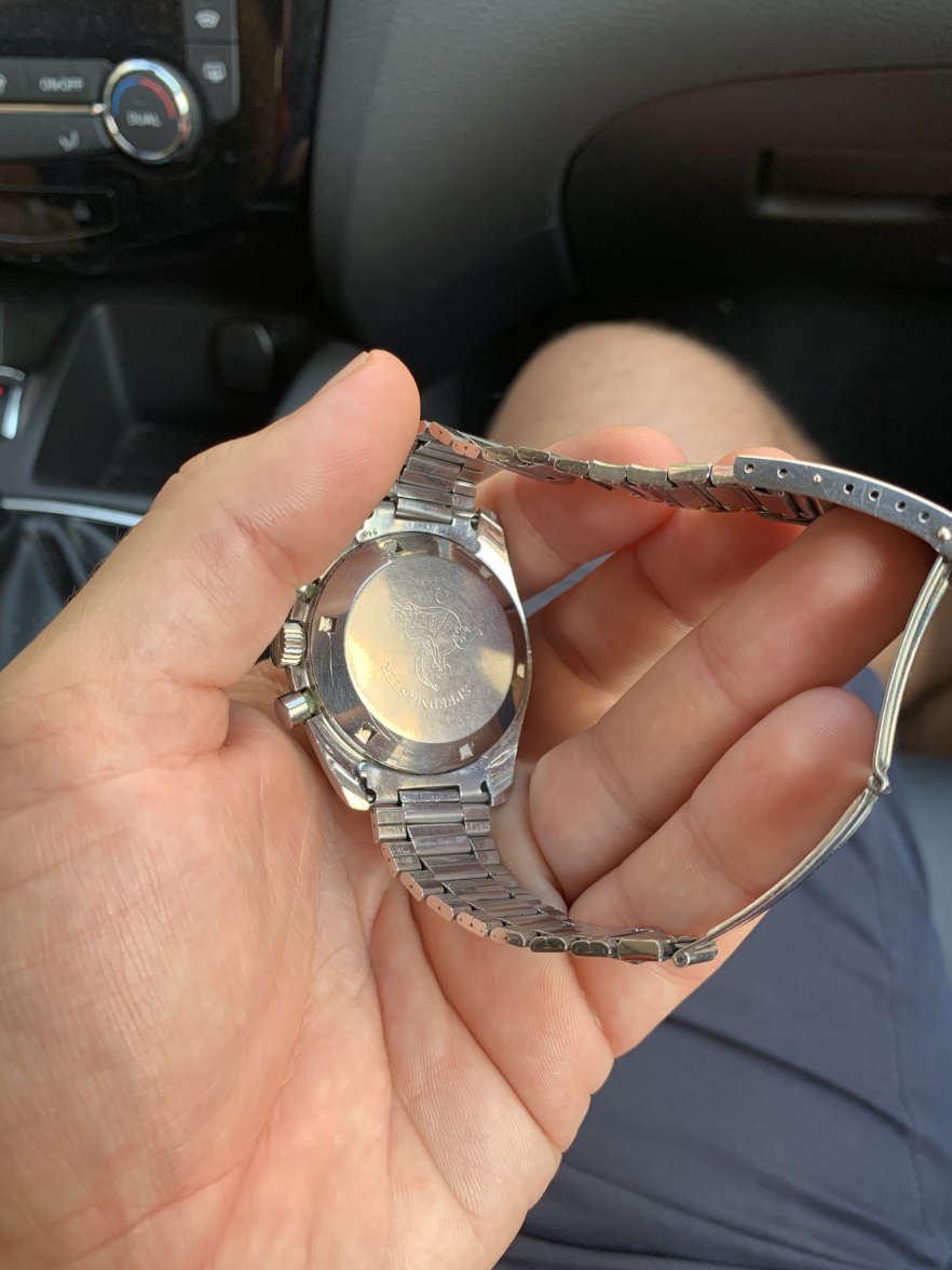

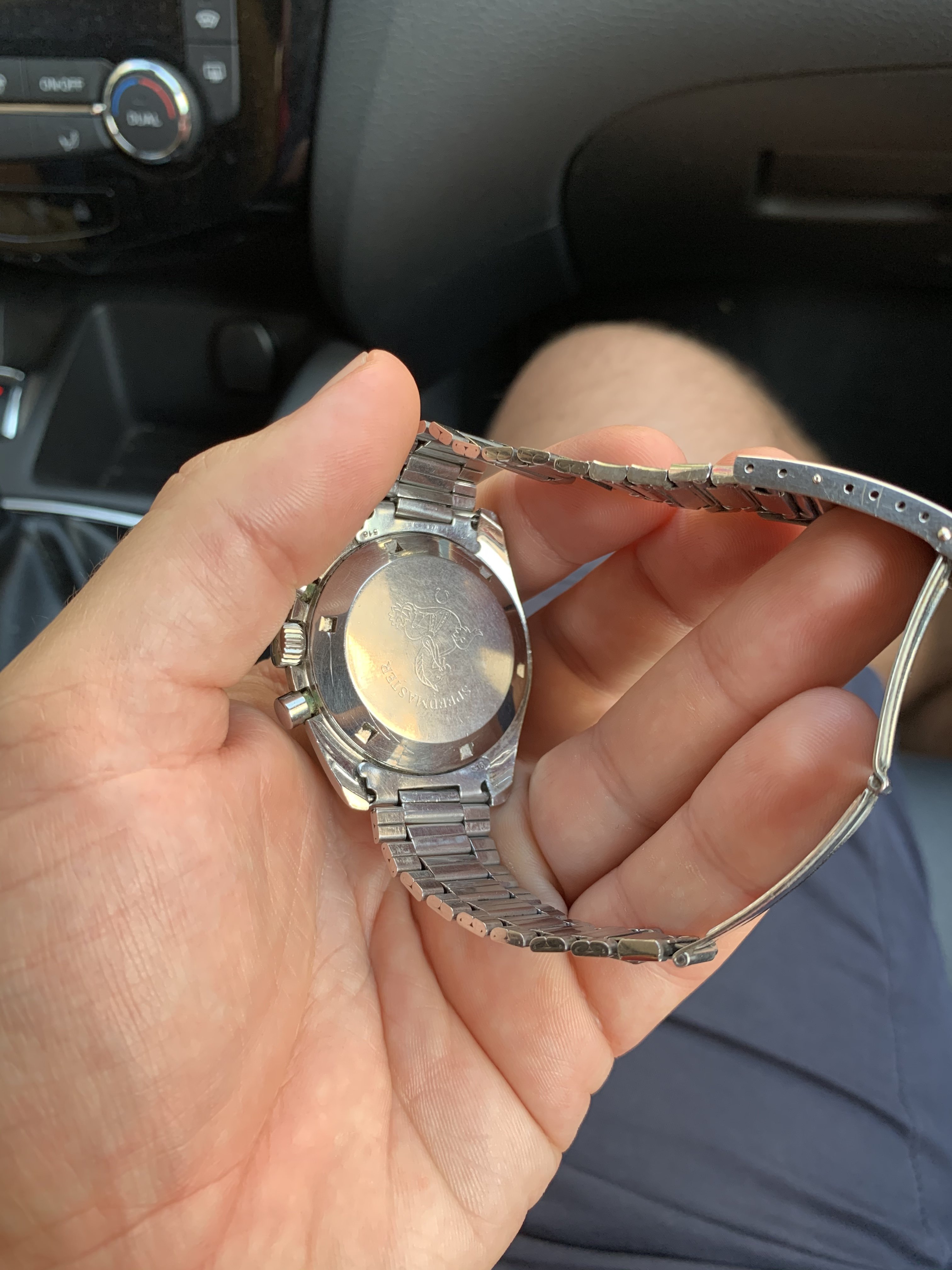

The fact that most likely it is a 105-012 with wrong crown, swapped escapement bridge and caseback does not detract from the fact that it still is a 321. And a tool watch. 😁
indeed.
but it does detract from the value and a naive bidder will over pay if he is up against another naive bidder.

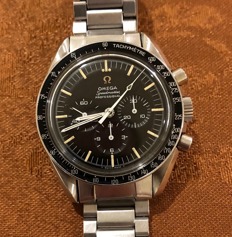

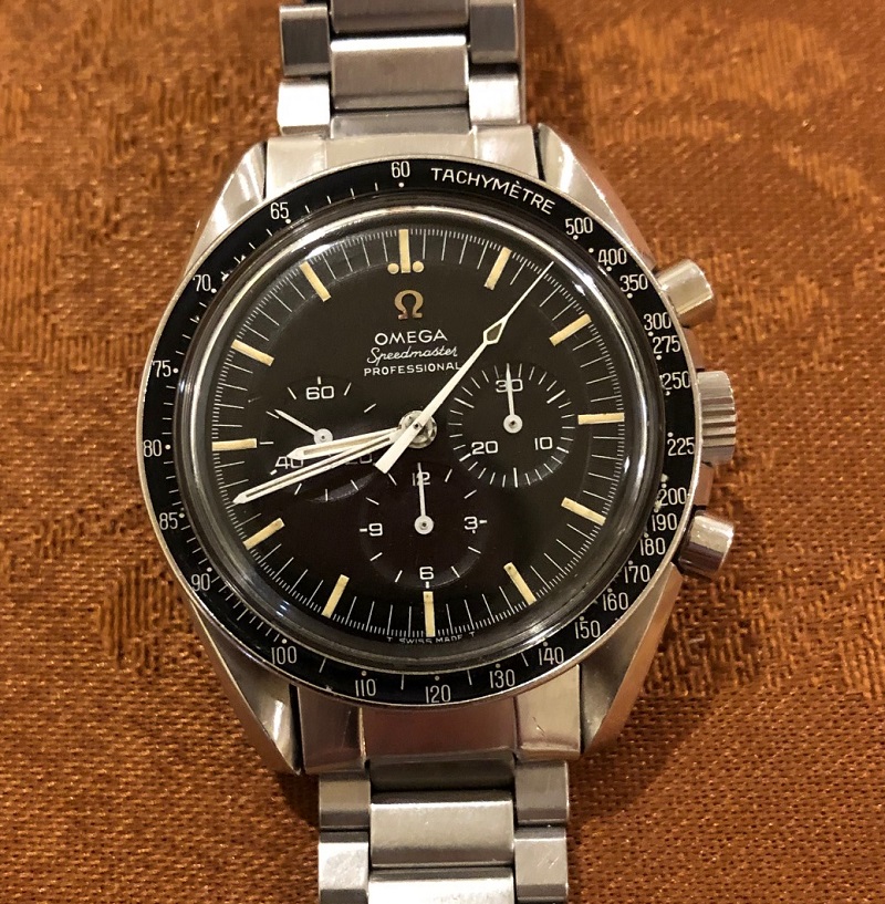

I like the OP's watch quite a bit, but probably because it is similar to mine.
Is there any shop that restores DON Bezels?
You'd think some one some where could carefully repair the chipped black surfaces and make it a new looking bezel.
Here is a pic my 68 Transitional watch.
I like it because it has one foot in the past (DON, applied logo, flat bracelet) and one foot in the next generation of Speedy watches (861 movement).

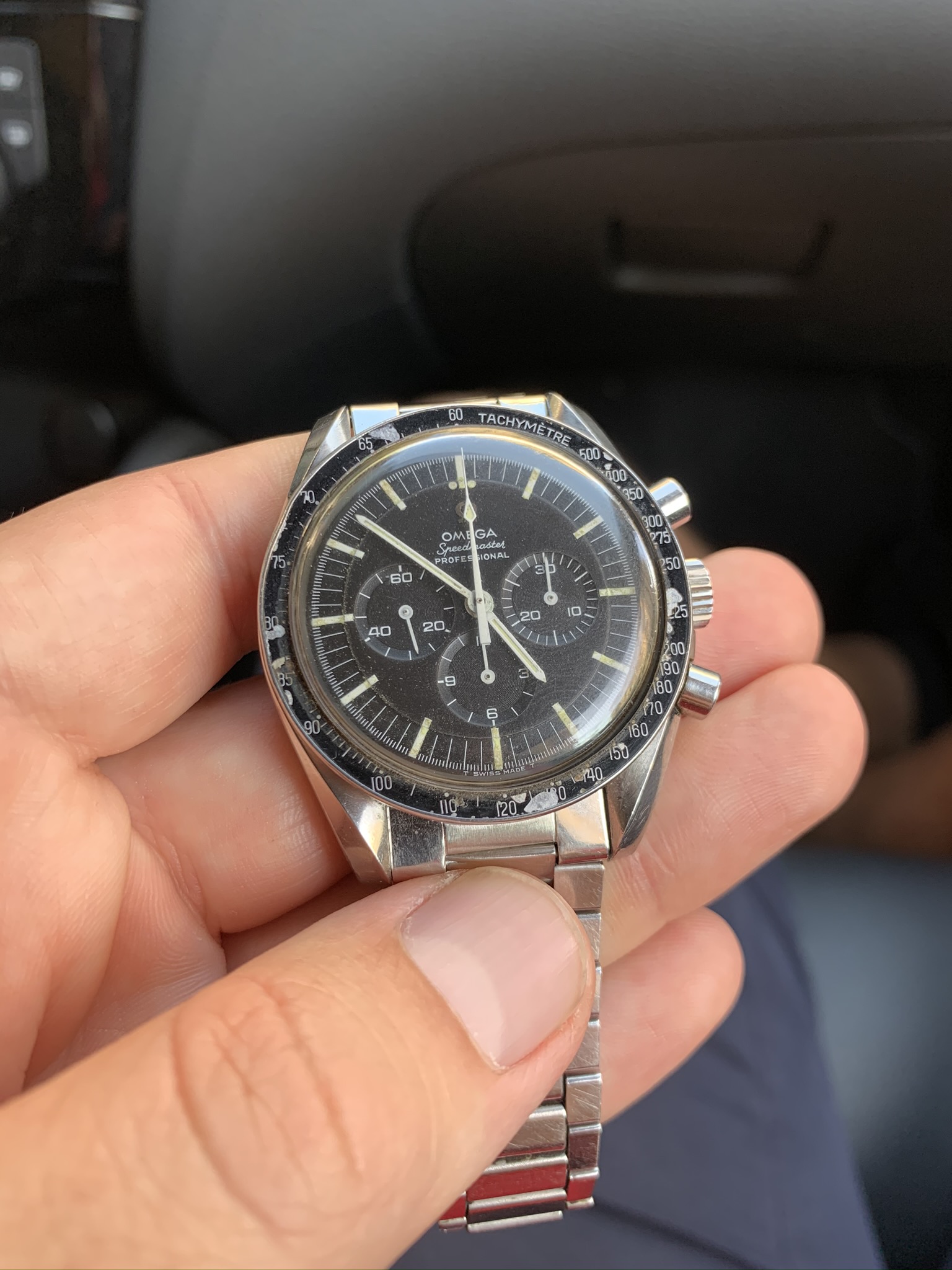

Hi all!

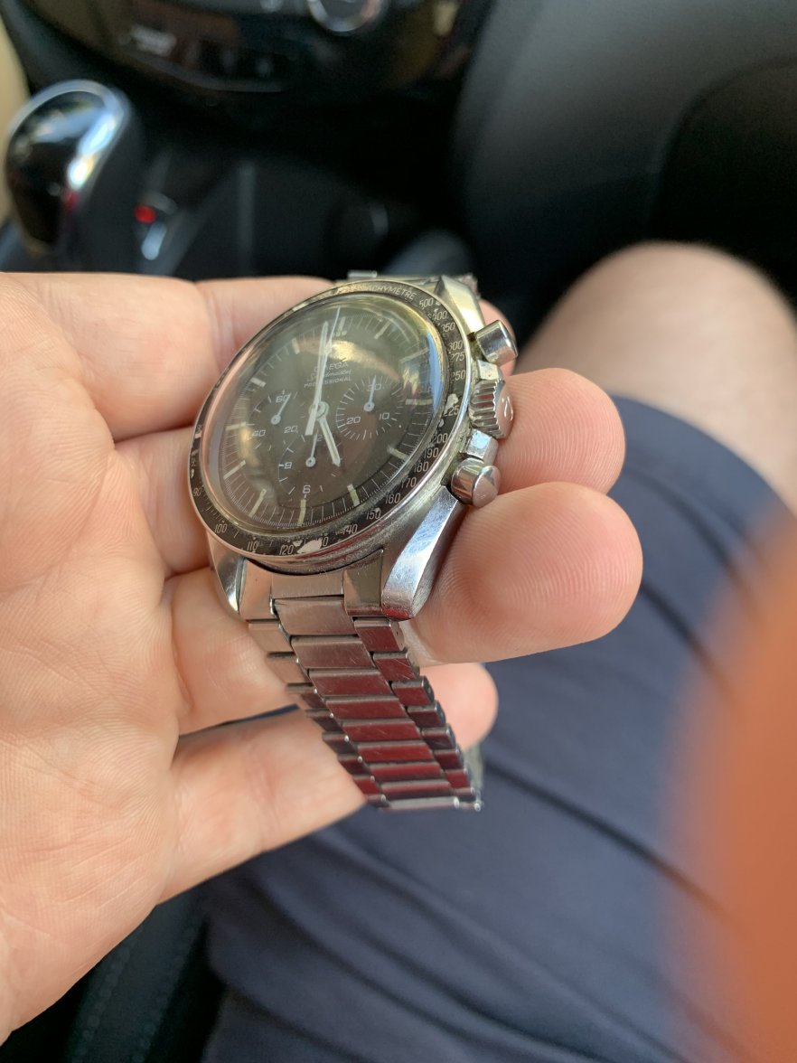

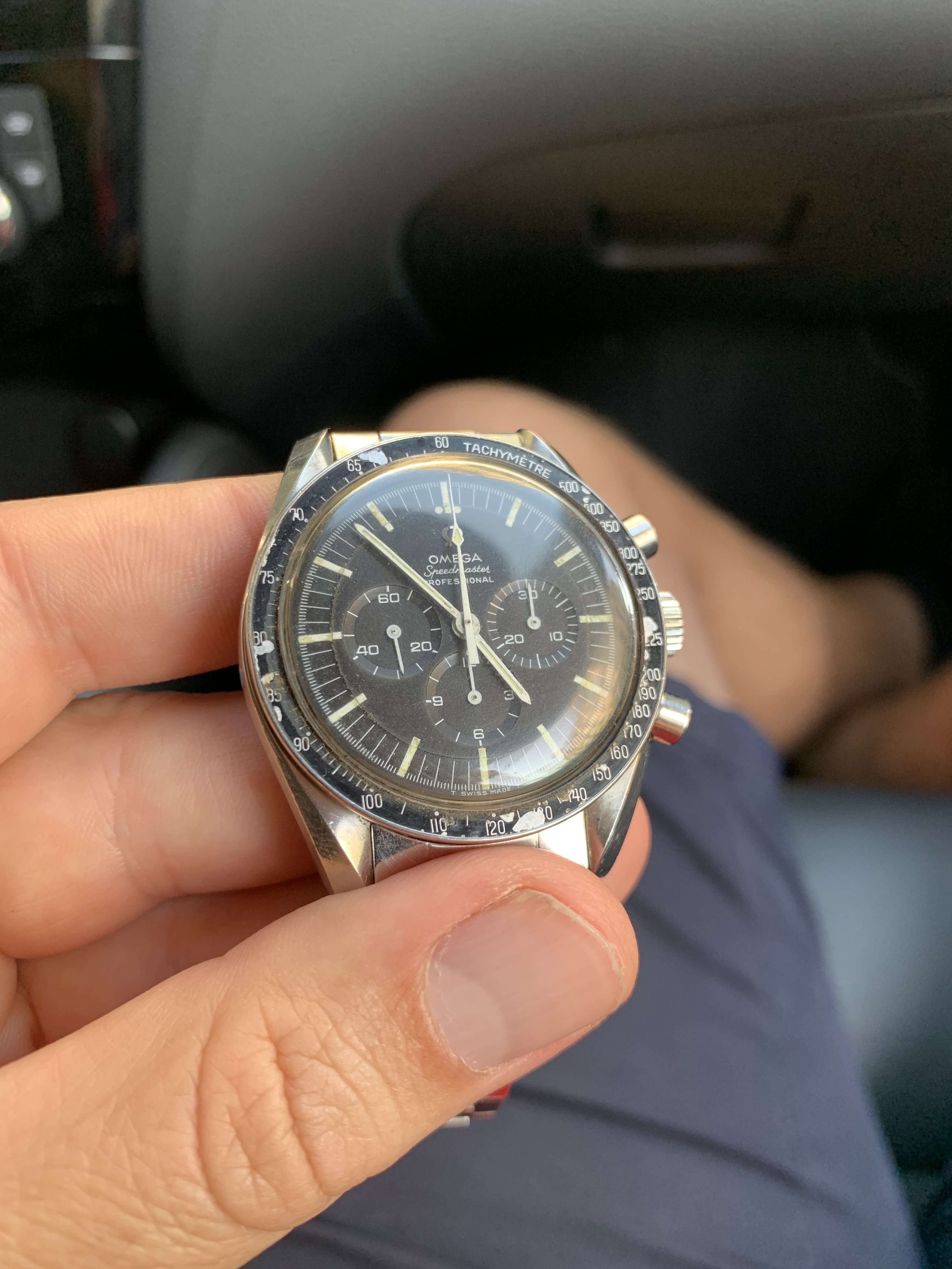

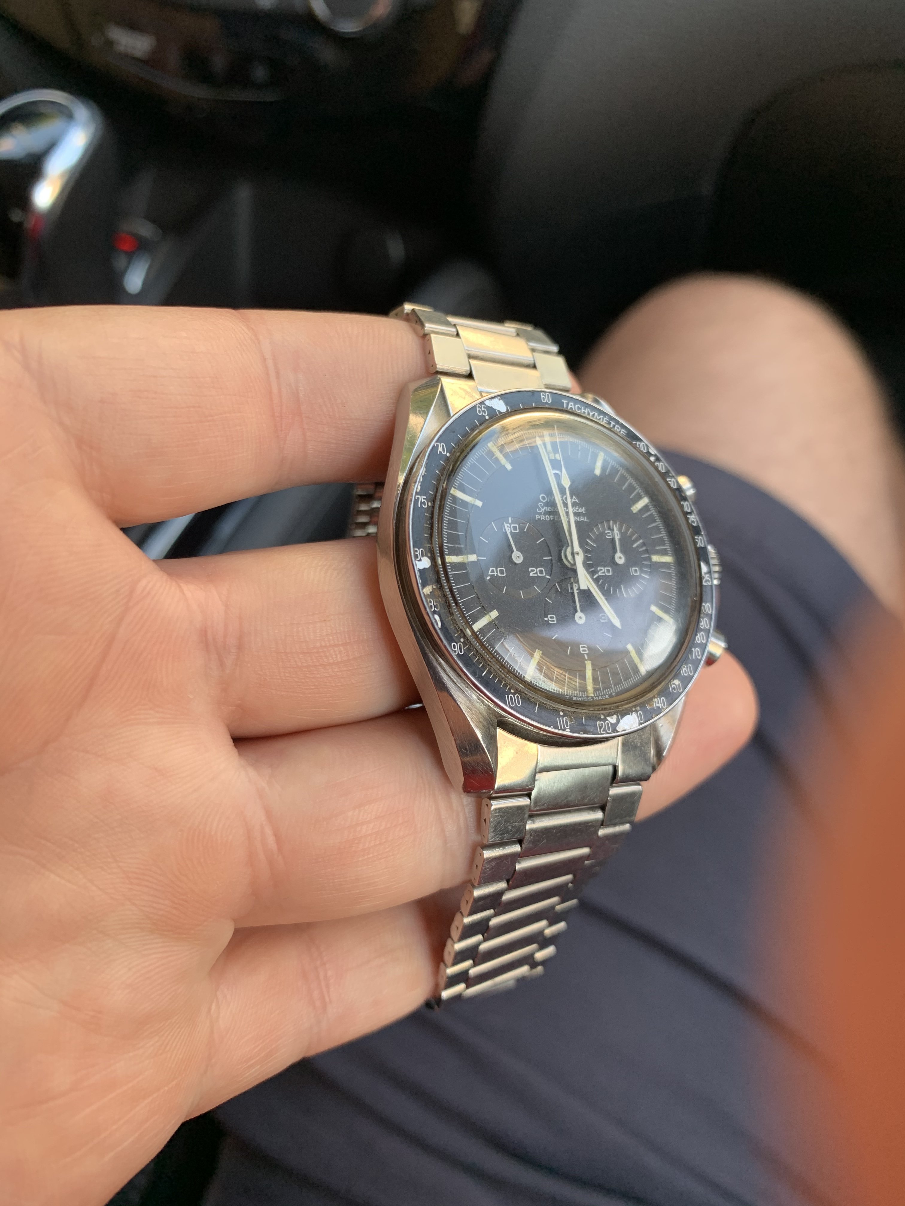

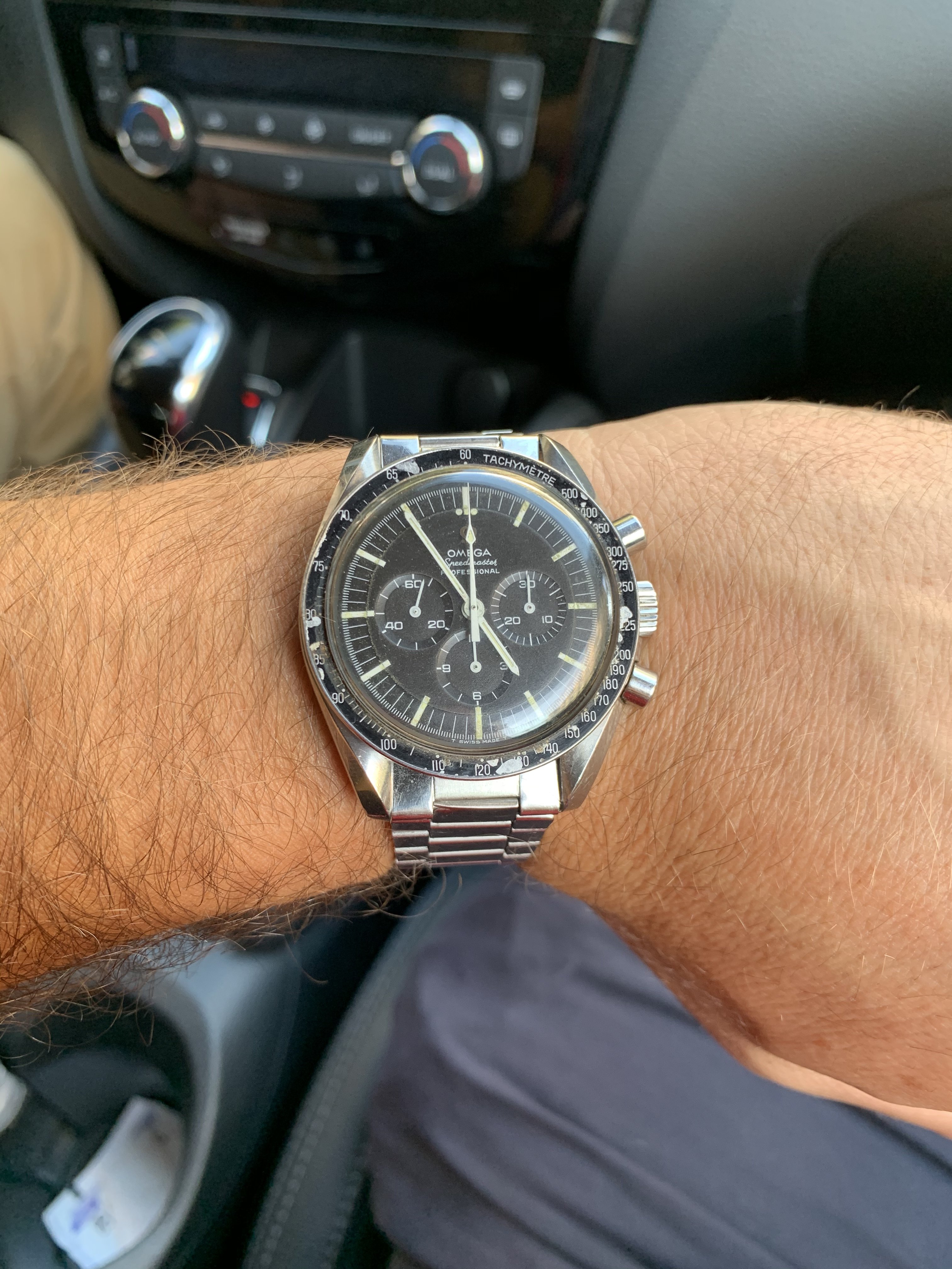

I ended up seeing the watch in person. The dial itself is nice, I think the « bubbles » we see on the left side is tritium dust because the indexes are quite damaged and it hasn’t been opened for a looong time (lots of dirt around the pushers and on the insert). I remember reading somewhere this floating tritium dust could be a problem with the movement...
The insert is quite damaged
The bracelet seems in good condition, with almost no stretch

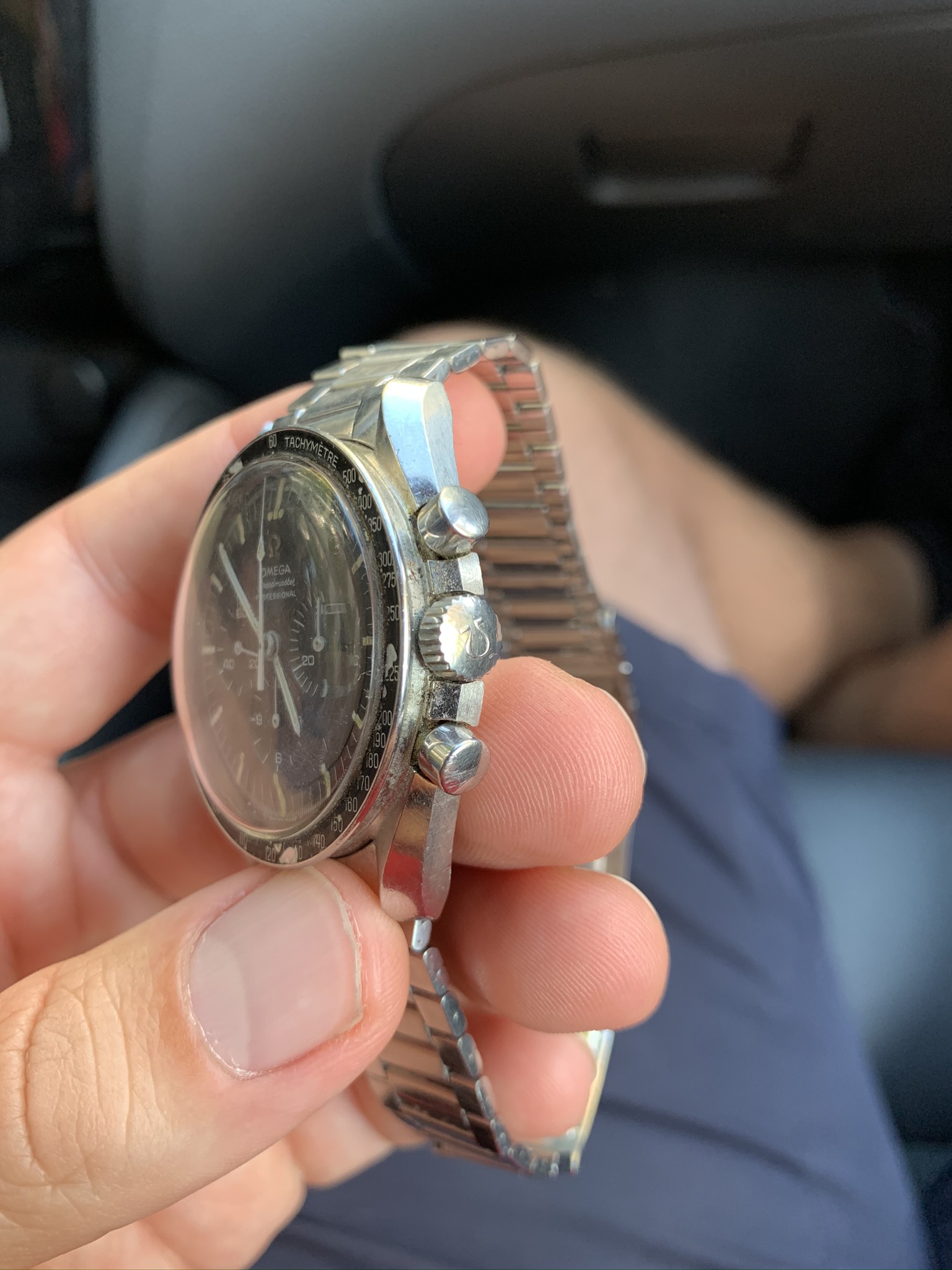

When a bezel is chipped like this one, does the surface continue to easily chip/peel away or does it remain relatively stable? I've never actually held a vintage Speedmaster in person so I'm curious how durable the bezels remain once they start to chip. Is it like peeling paint? Can accidentally scraping a bare spot with your fingernail or brushing up against denim or coarse fabric cause it to continue chipping away? Thank you!

Looks like it has 516 end pieces on the bracelet.
Is there a date code on the 1039 bracelet?
If you could, post pictures of the clasp.
Thanks.

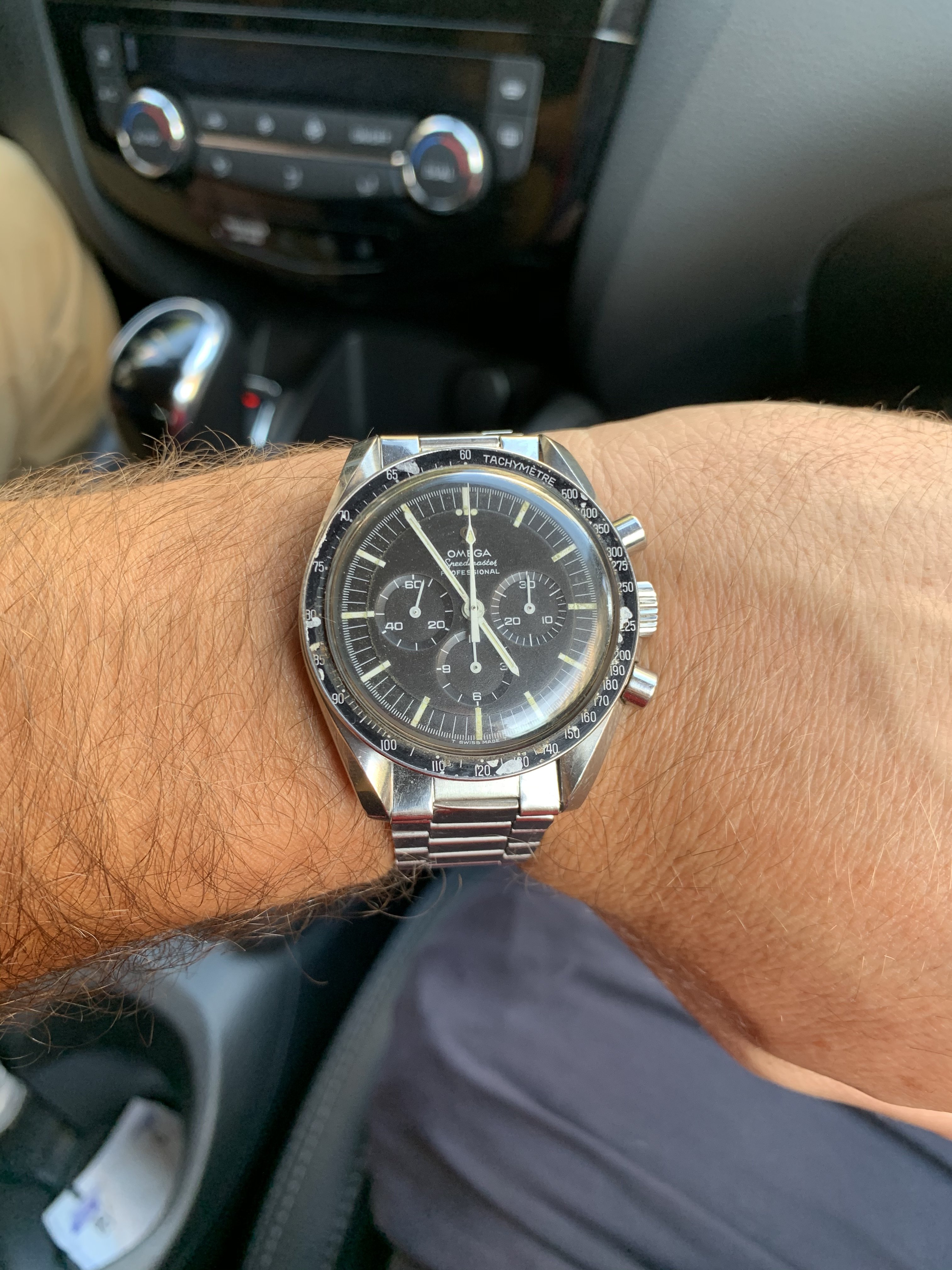

Yes, 516 end pieces, I didn’t check the date on the clasp but just asked for a picture!
So, does it seem a little more worth it than on the first pictures I’ll admit it felt nice on the wrist although it’s a shame the lume is partially gone...
