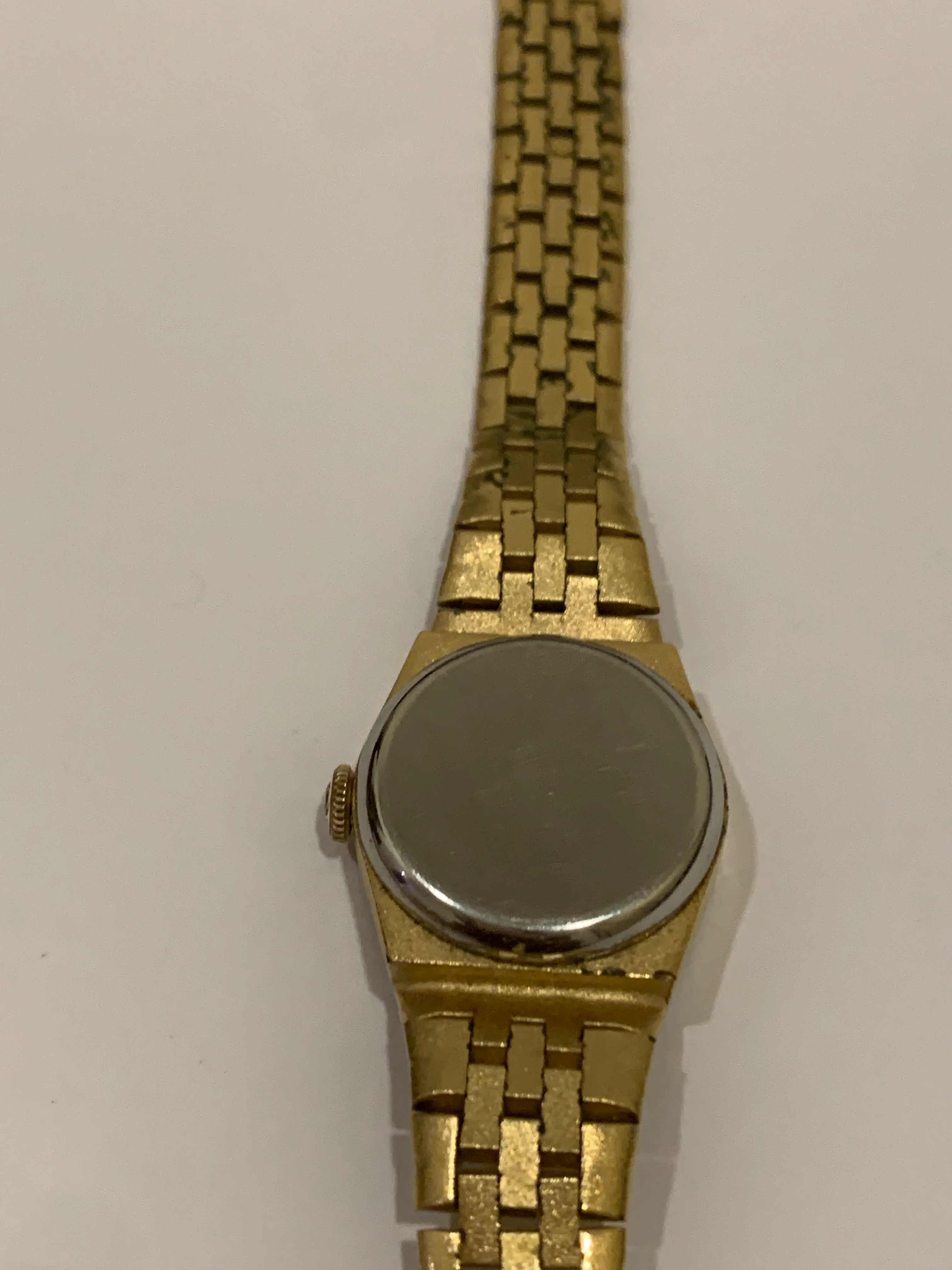

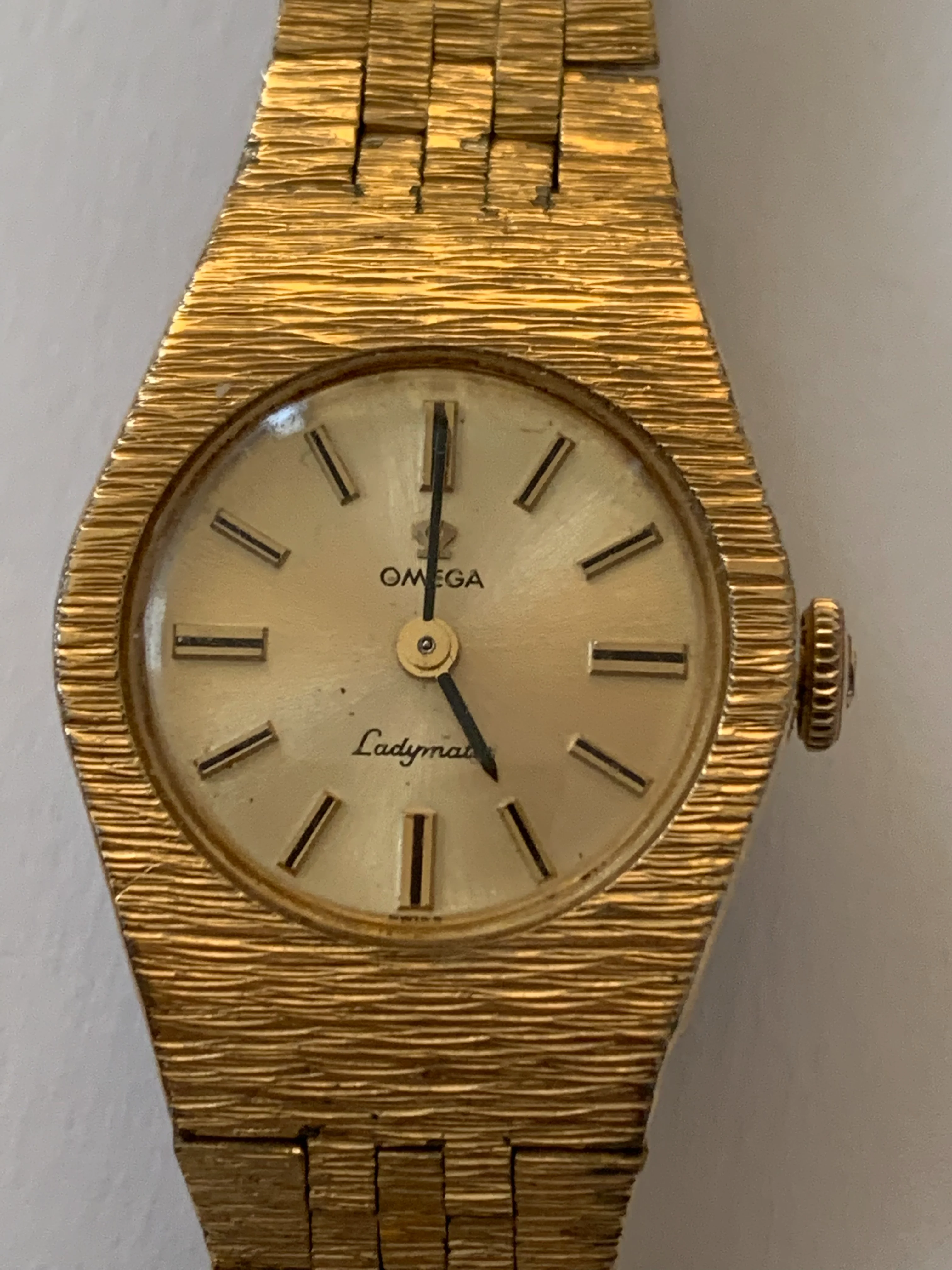

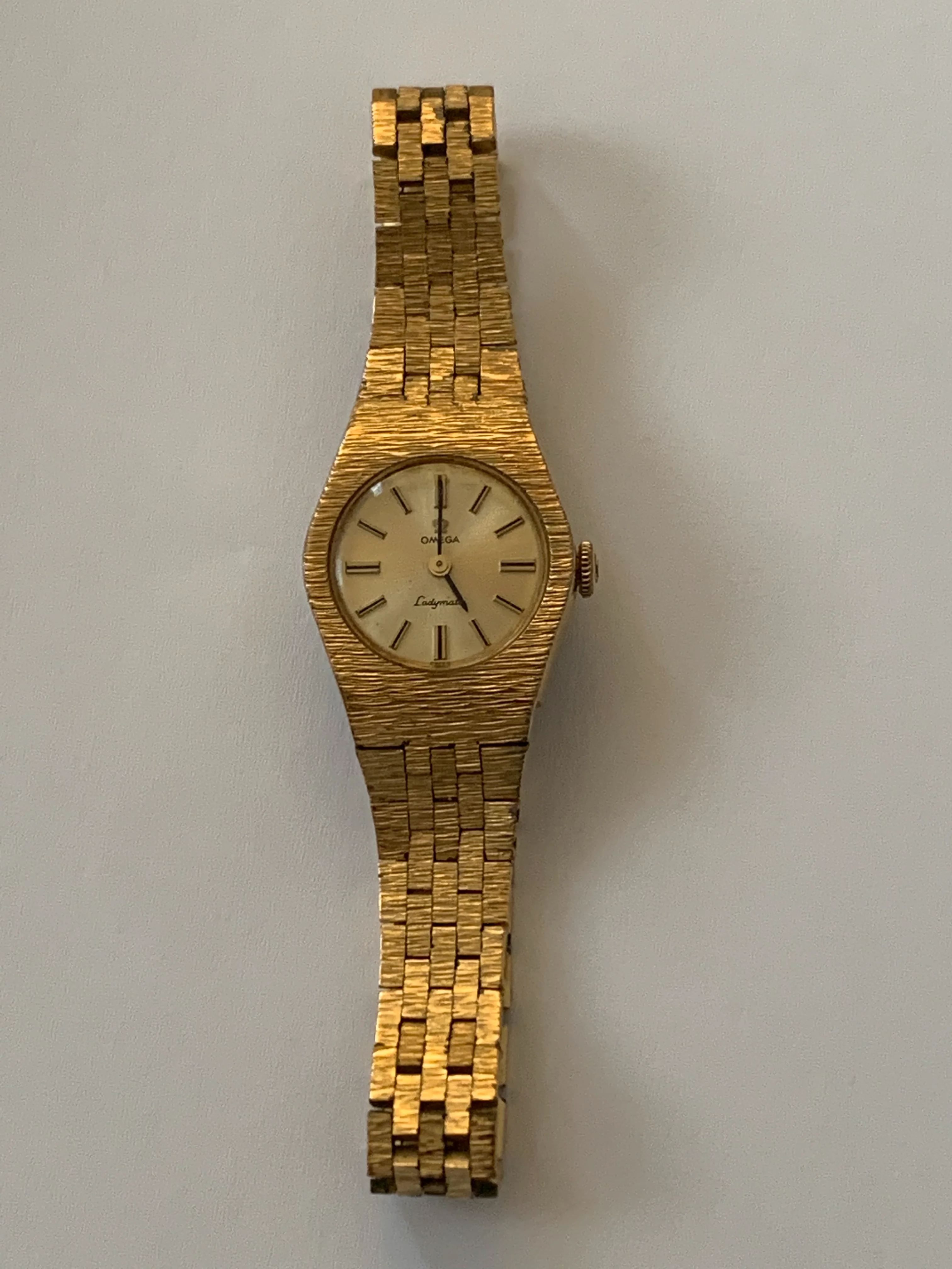

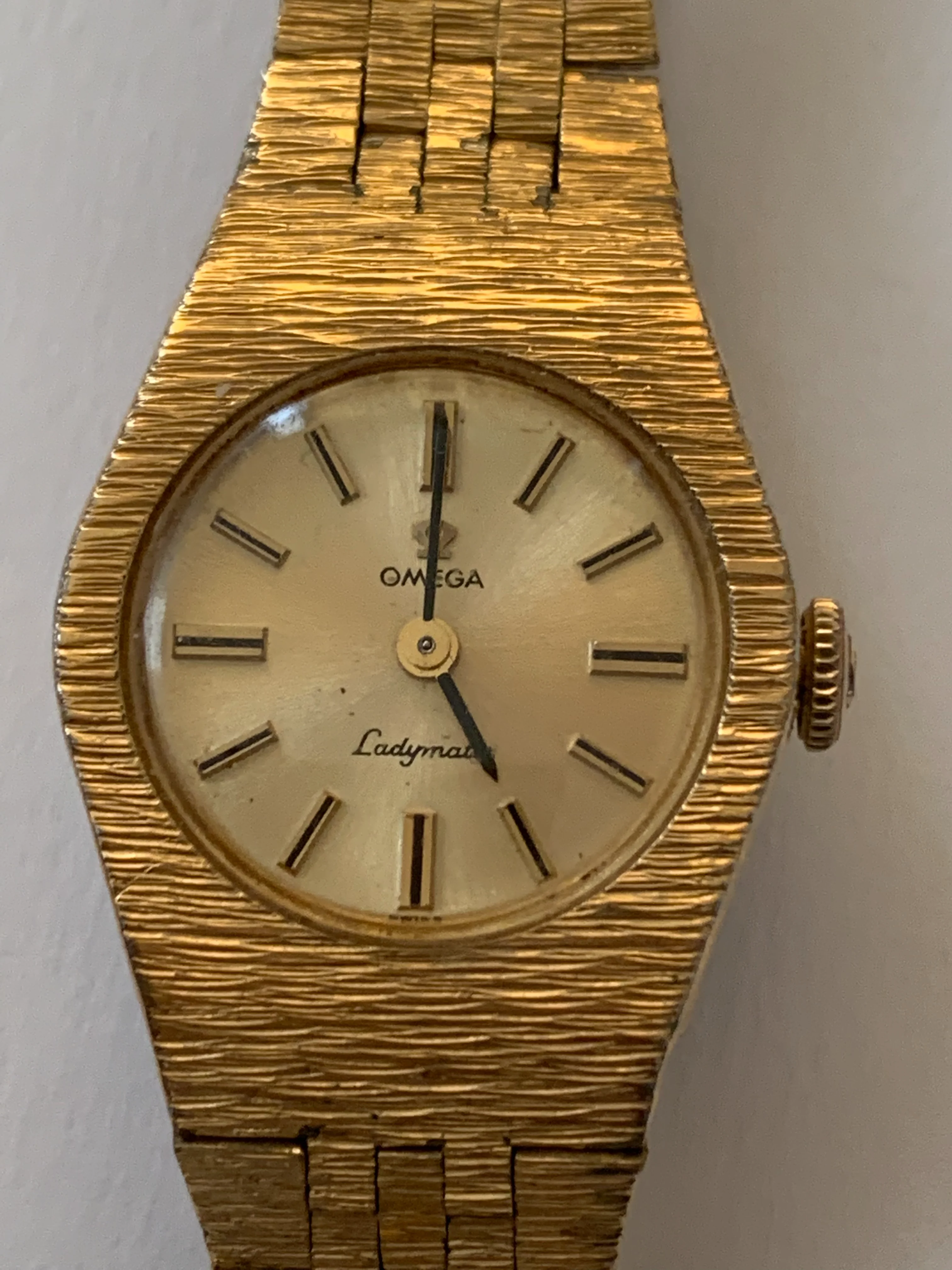

I bought this watch as I intend to gift it for my wife. I do not have much details about how this watch mechanism works or what movement inside, and the history of this watch may be one of a ton of models that were sold in the 70s. what do you think ?

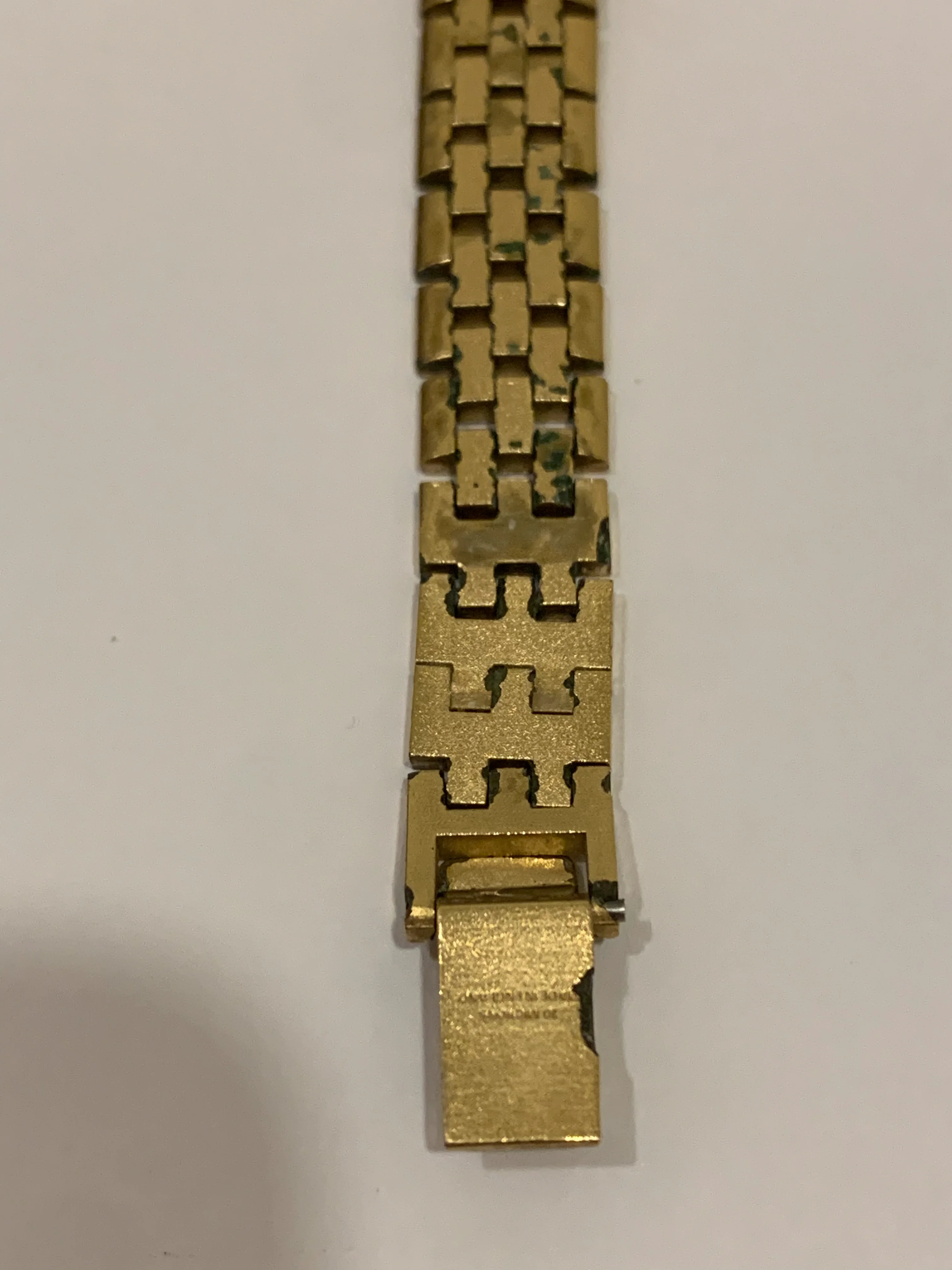

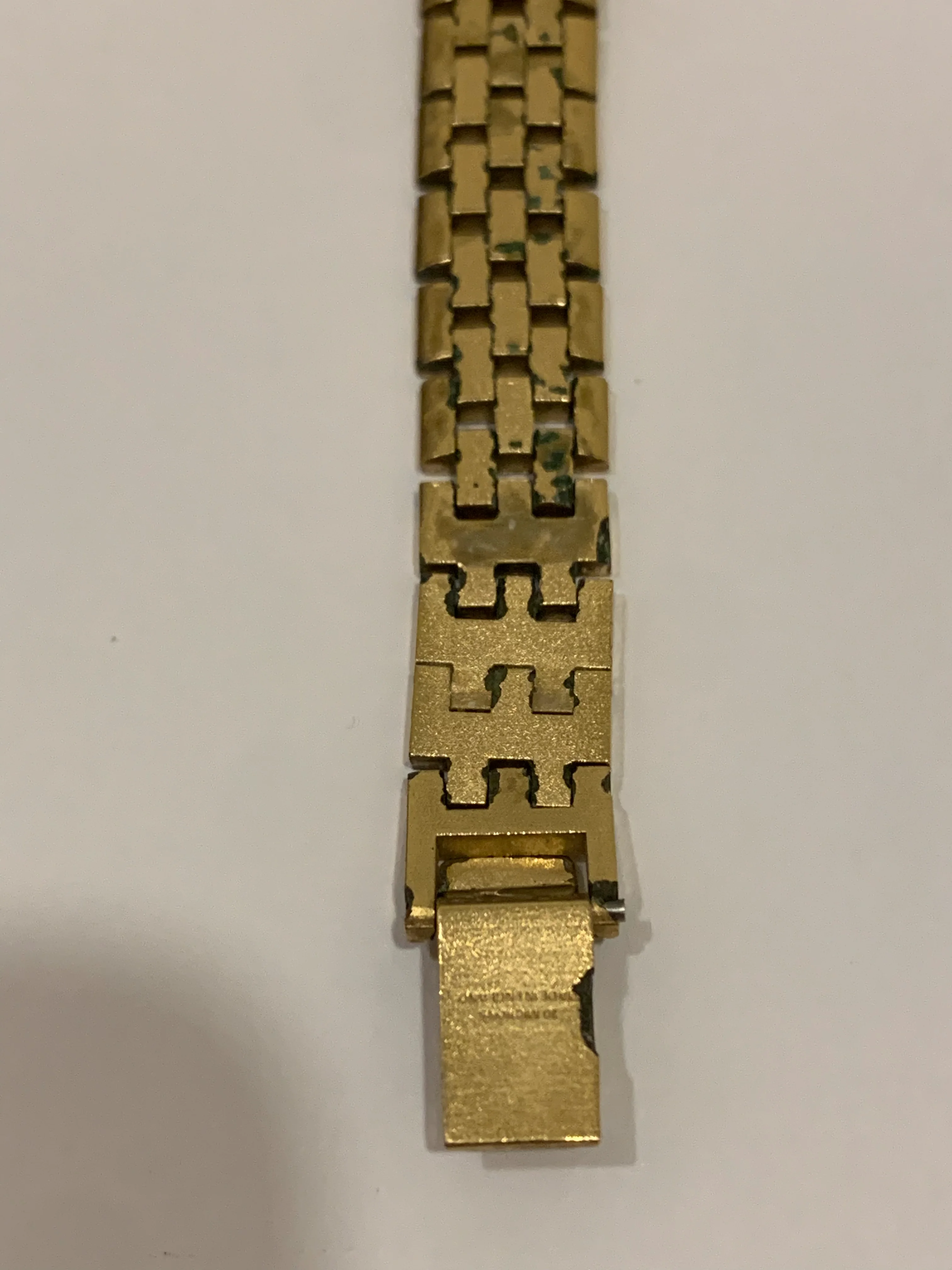

Check the under side of the bracelet. This watch is gold plated, and over time, the plating on the under side of the bracelet disappears in patches, exposing the brass substrate. When that happens, rough edges of the plating occur as the brass corrodes away. The wrist of the wearer turns green! As far as the operation of the watch is concerned, these self-winders are dependant on the wearing patterns of the wearer. Now that you own it, I wish you luck with your purchase. When the bracelet craters, no other bracelet will fit the watch.

Thanks for your kind reply and information, I believe there are small writing but I cannot see what is written, but not sure which gold number 9, 10, 14 is on this case

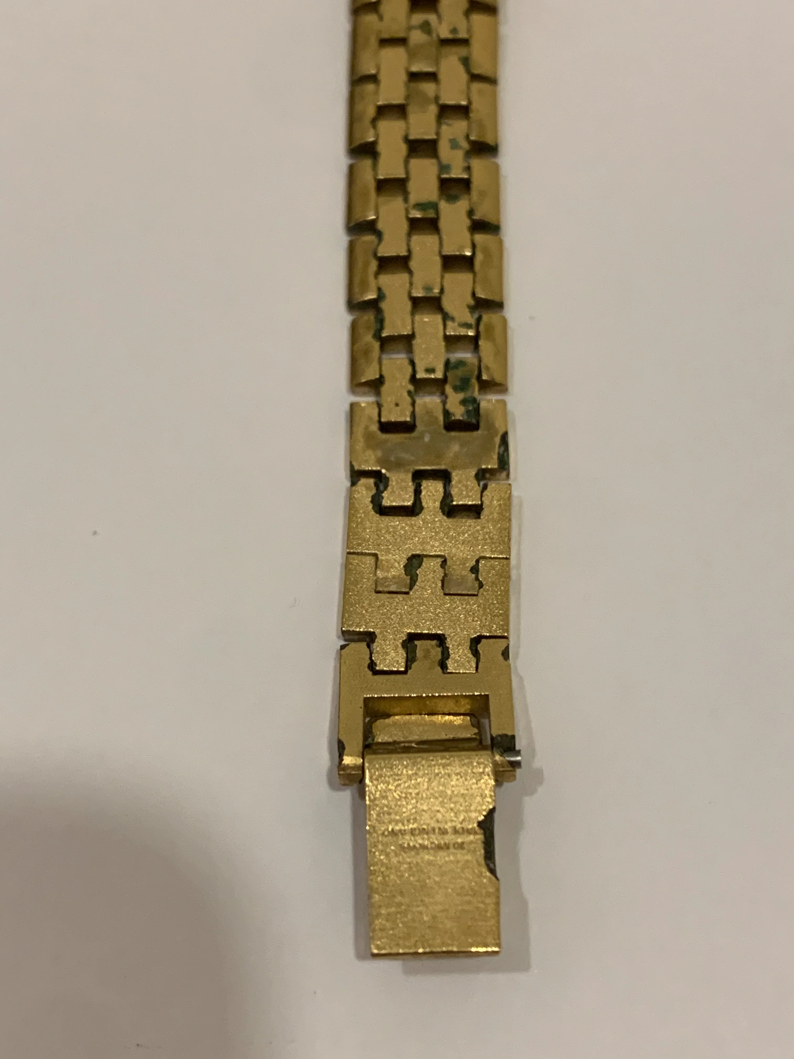

The printing on the buckle might say 9, 10, or 14 karat, but I think I can see the word MICRON. That means the watch is only gold plated, not karat gold. The finish on the under side of the bracelet is sadly very deteriorated, leaving patches of the original plated finish, but also voids in the plating where the brass has seriously corroded away. In addition, the hinges in the links are quite worn. I think you paid the “newbie” tax on this one. If the lady knows you bought it, it is too late. But if she doesn’t know you bought it, I suggest you stick in your sock drawer, and look for a better example. This watch would not be comfortable to wear, and it will turn the wrist green. Don’t consider having it plated as that will only be temporary. This watch has a lot of miles on it. I have given you a run down on what can be seen externally, and I’ll bet there is a plethora of ills with the mechanism, as well. Basically, you bought someone else’s problem.

That watch is only gold colour! Not gold. There might be one gram of gold on the watch and bracelet. With gold at over $3,200 US per ounce, you wouldn’t be able to buy a gold watch for $140! More likely $1,400! And at that price, you’d likely not get a gold bracelet. Check the FOR SALE sections of this message board for an idea of styles, and prices, to gain some perspective on what you’ll need to pay. You don’t have enough posts on this message board to permit you to buy, here (you need 200 posts), but you might consider sending a private message to the seller to see if you can work something out. If you had shown us pictures of the subject watch before you bought it, you’d likely have been advised to avoid it. You paid a “newbie tax”.
