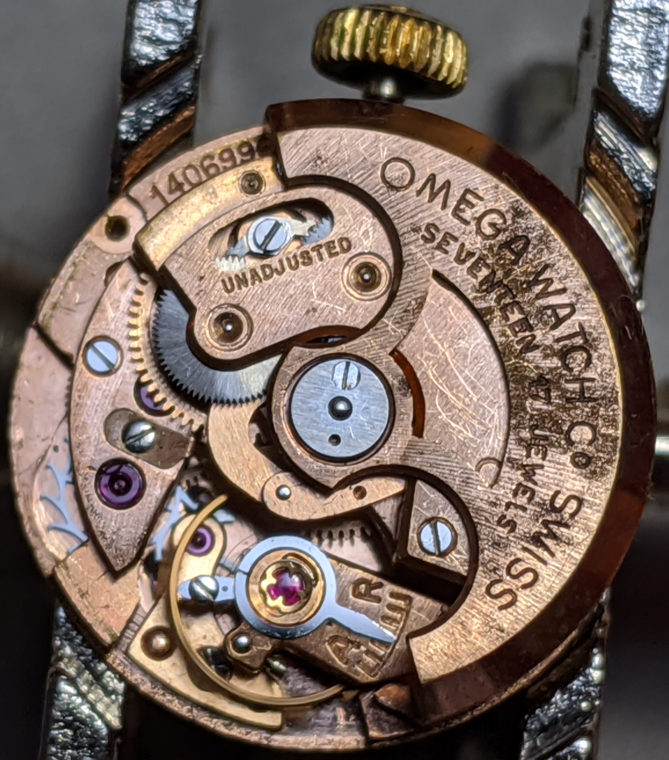

Before I started. The smudge on the rotor looks worse in person. I don't think the photos capture the difference between the reflectance of the copper vs the matte corrosion fully.

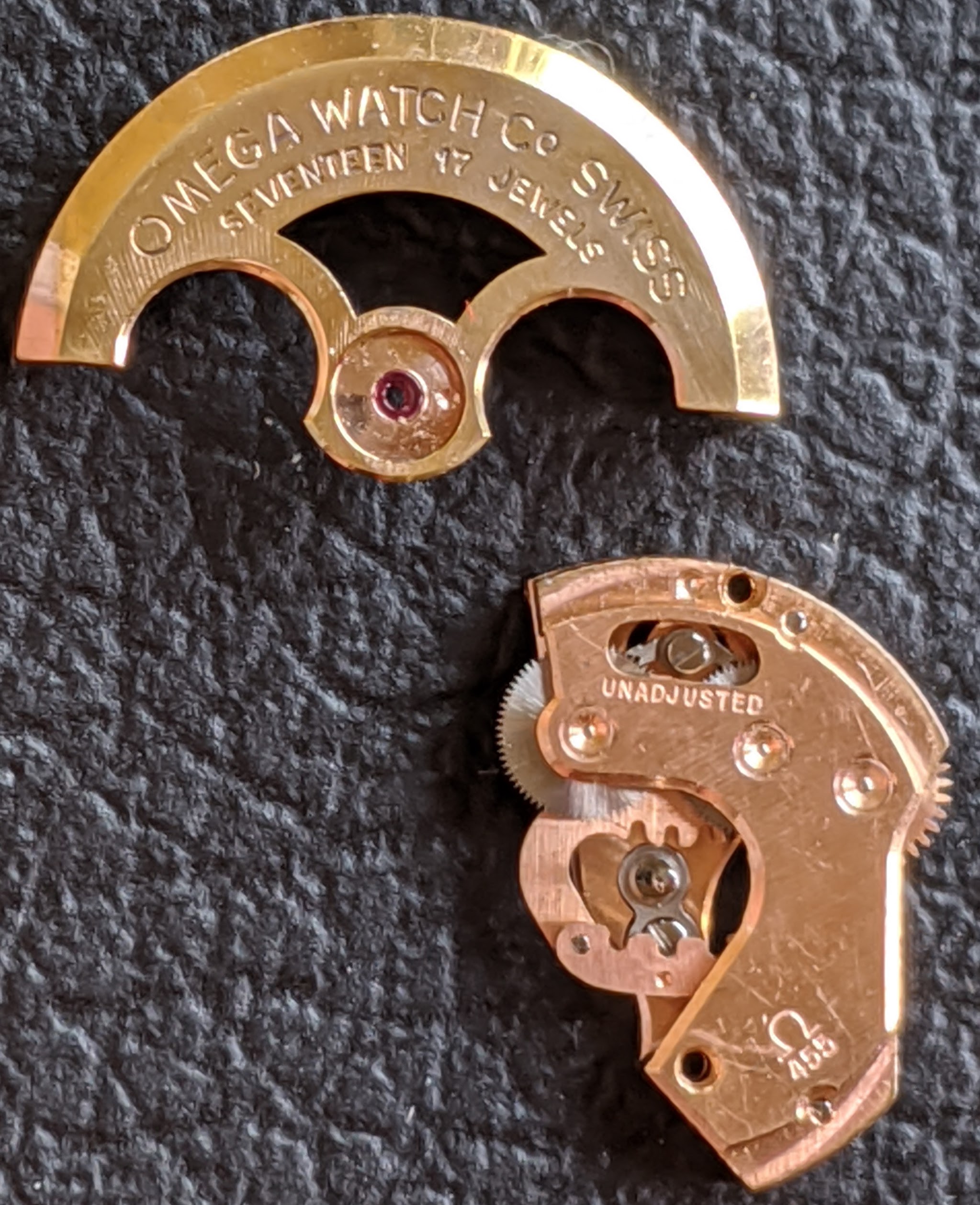

After polishing:

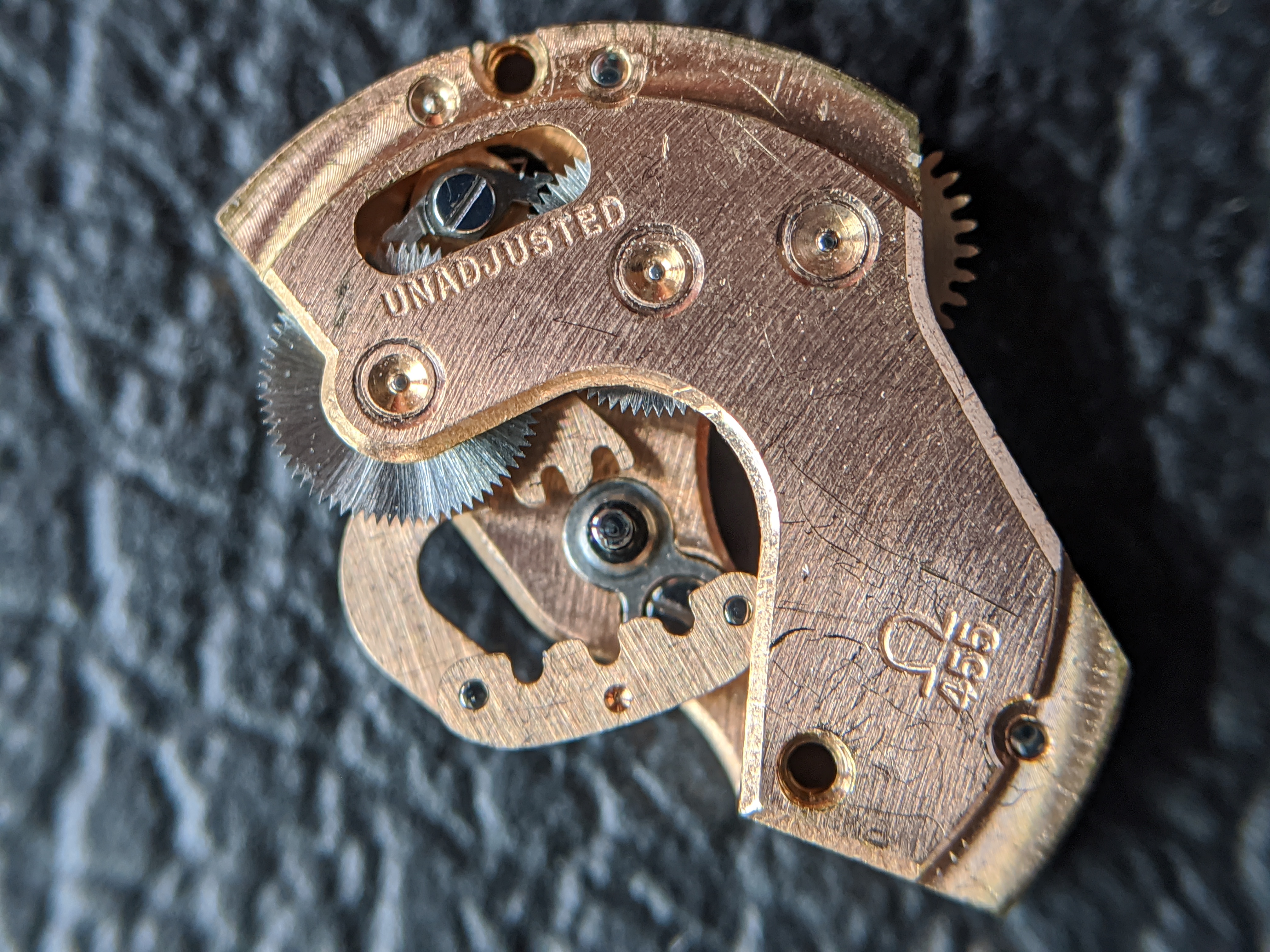

Better view of the mechanism after cleaning and reassembly:

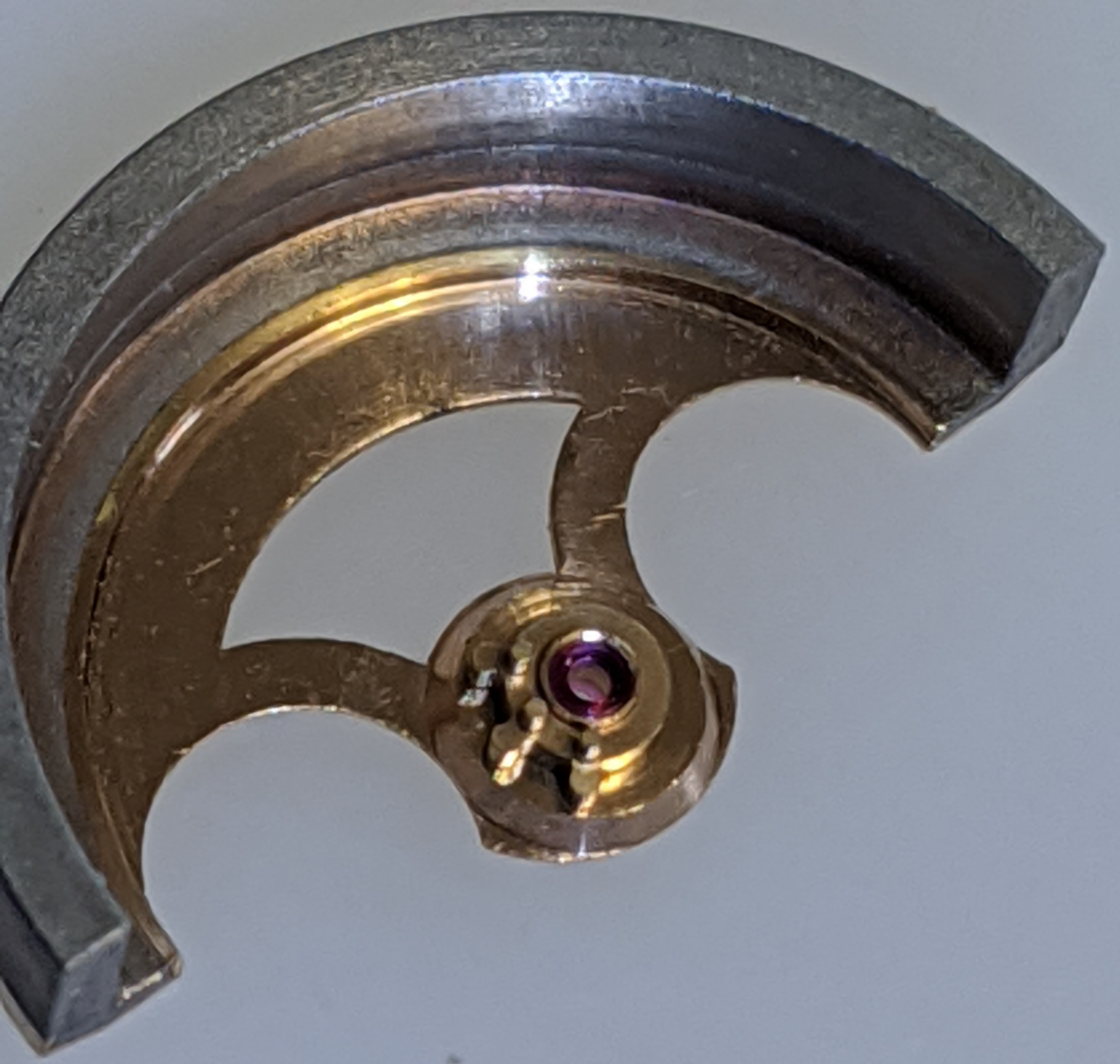

Back side of the rotor. What to put on these pins?
After polishing:
