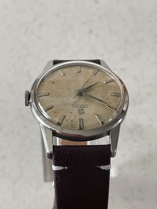

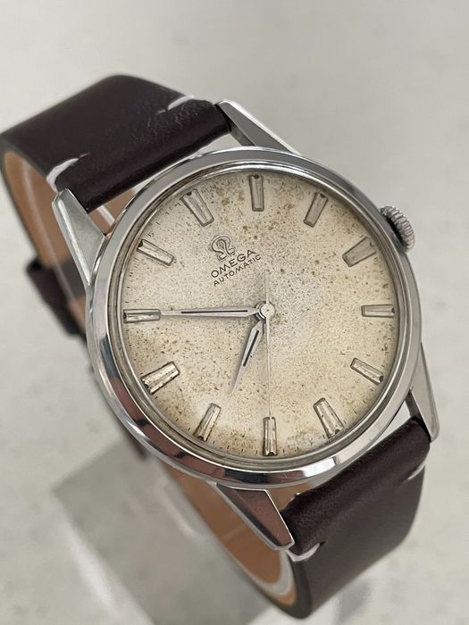

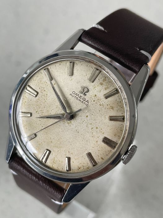

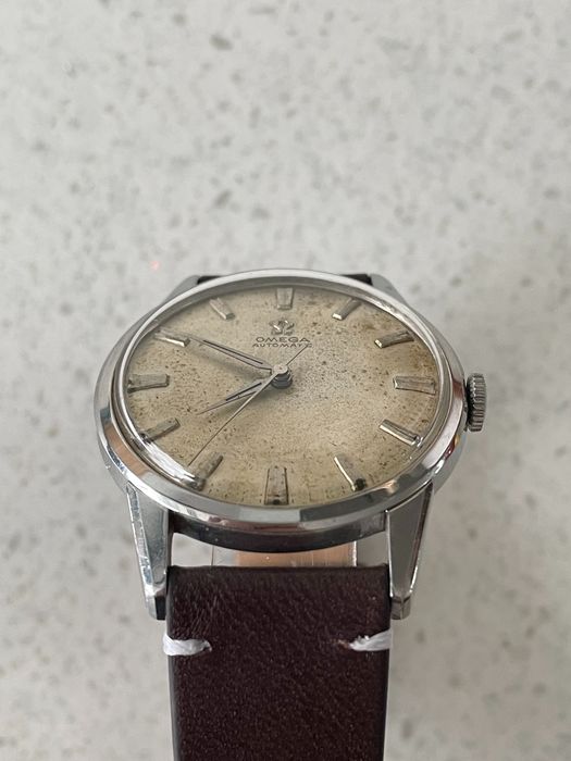

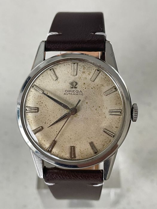

Thoughts on Omega Automatic 14776-61
7
10
Circa 1958.
34mm.
Cant find any info on it, would like your thoughts on its authenticity and value before deciding to get it.
It's going for 250usd.
TIA and cheers.
10,804
16,814

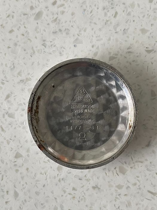

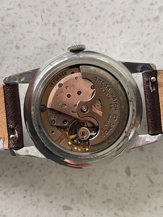

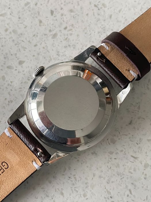

It’s tired and dirty. Bank on spending at least as much again to get it running right and even then the dial will still look grotty. The visible rust on the inner caseback is a big worry. The case iteration suggests it’s actually from more like 1961-62 but the movement number is earlier, ‘58-‘59 as you say. Normally this would be a red flag but I found another example of that model seemingly with a late 50s serial and -61 case mark so maybe they used up the spare 471s in the early 60”s. Just a theory, it’s rare the serial and case iteration are this far out. Here is the other I found, rather tidier than the one you show.
https://www.blackbough.co.uk/product/omega-ref-14776-61-steel-vintage-wristwatch-circa-1958-wwosa01/
13,556
23,503
It’s rank.
Pay a bit more for one with a better dial.
947
605
I really like the look of this watch. If you are looking for a new watch go to an authorised dealer and buy a new one. For me this watch tells a story. Not every watch has to be perfect. I myself like buying a watch that I can wear without servicing and see just how long it will work for. At that price I think its a bargain. Sometimes I am very surprised by the durability of these old omega watches. Just my tuppence worth.
