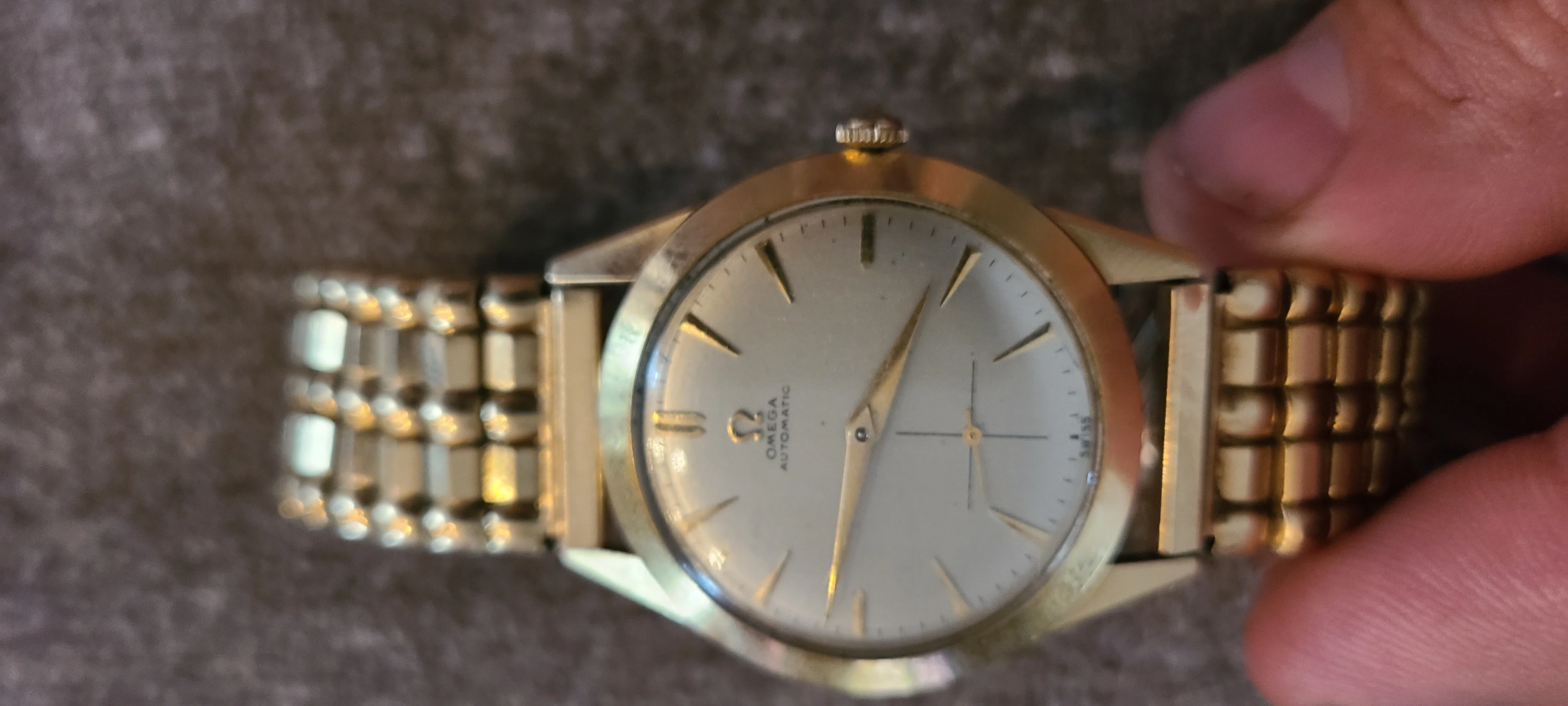

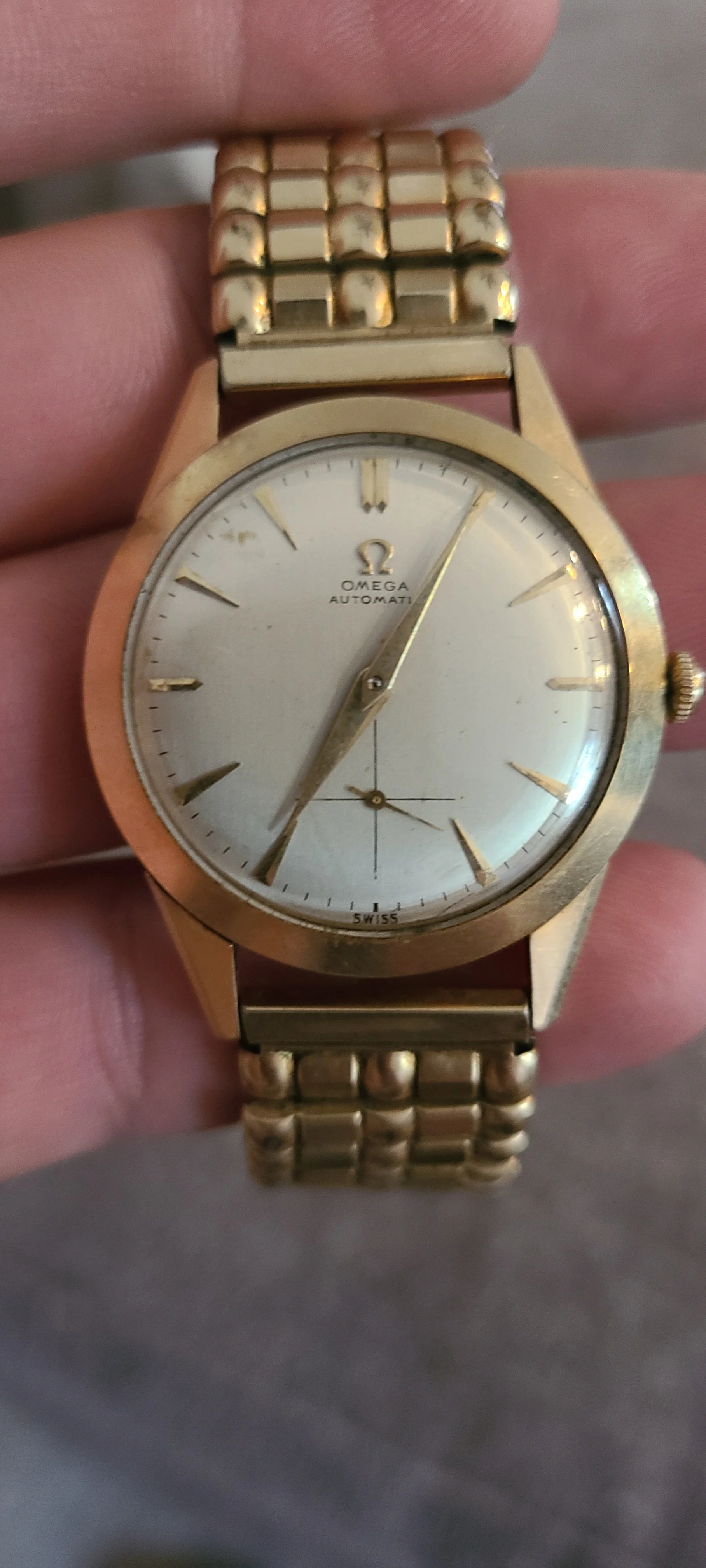

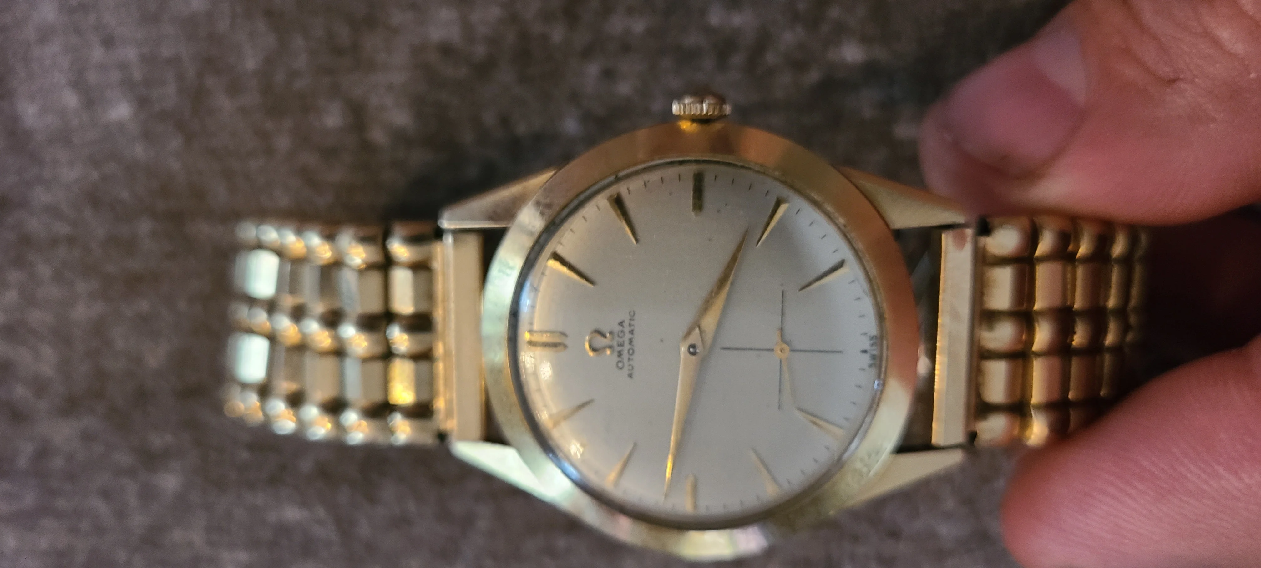

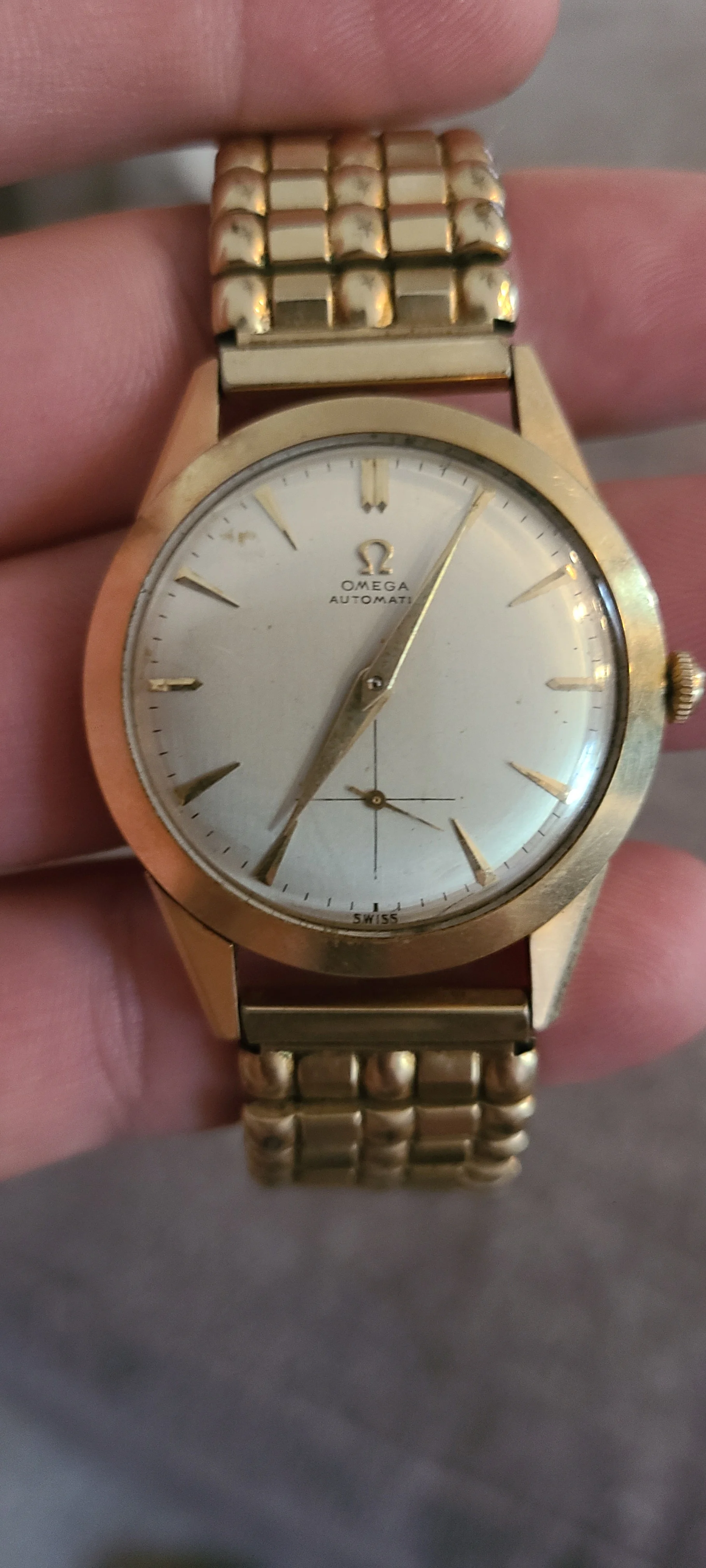

I inherited this non-working Omega Automatic from an elderly friend a few years back and it had belonged to his father before him. It is clearly older, but I cannot seem to find a match to this dial, with the lower cross-hair second hand in any image searches. I've seen similar looking Seamasters but this isn't labeled as one on the face. The original band has been replaced with a Lenox expansion band at some point.

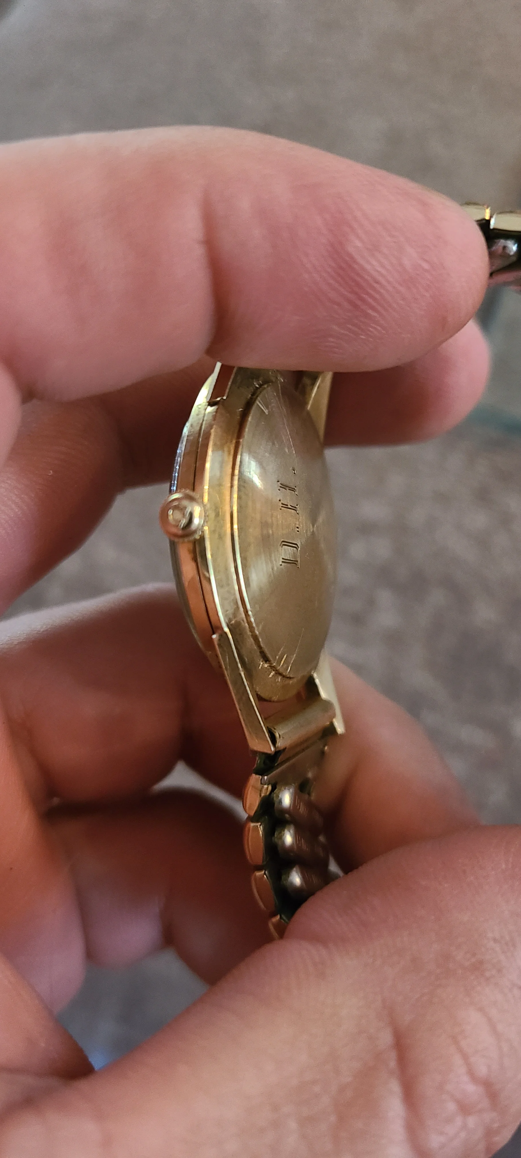

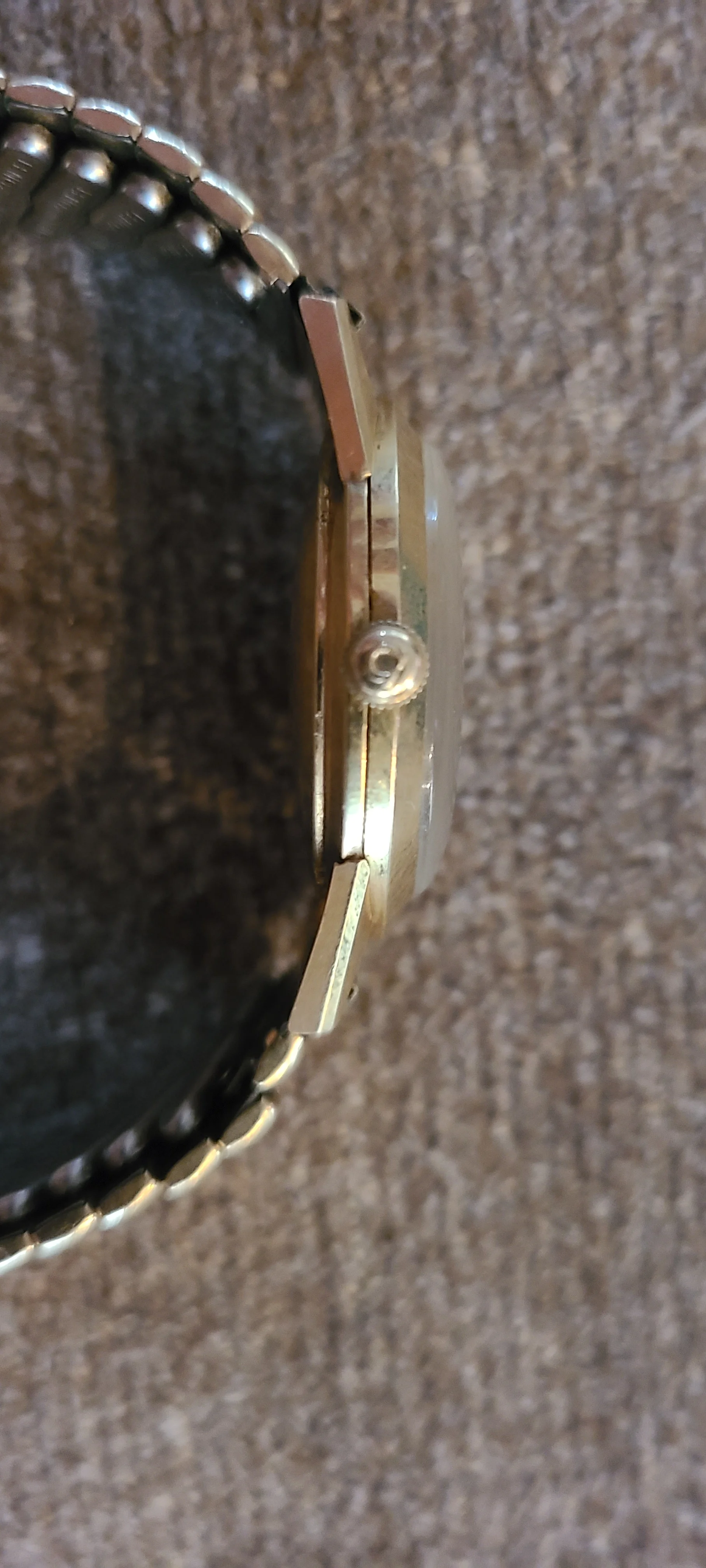

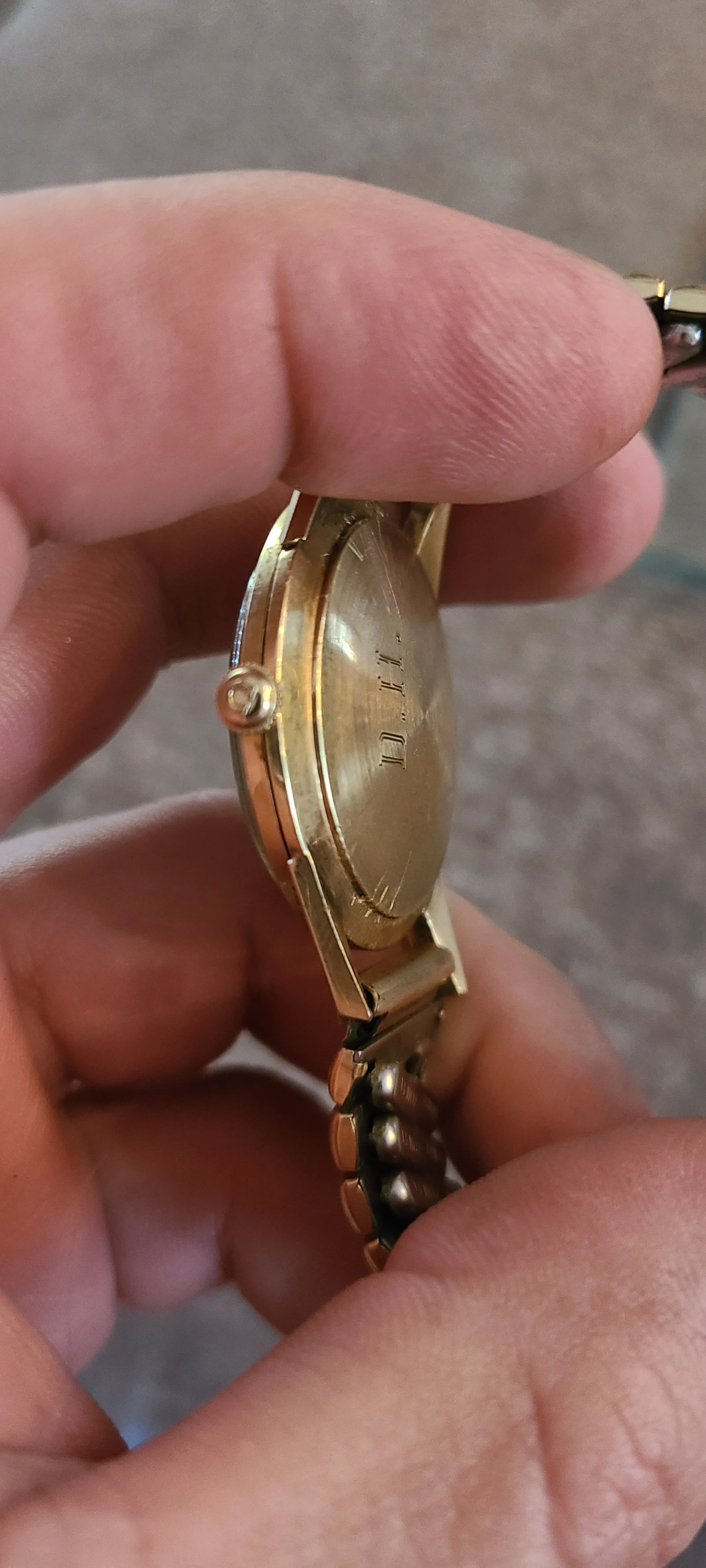

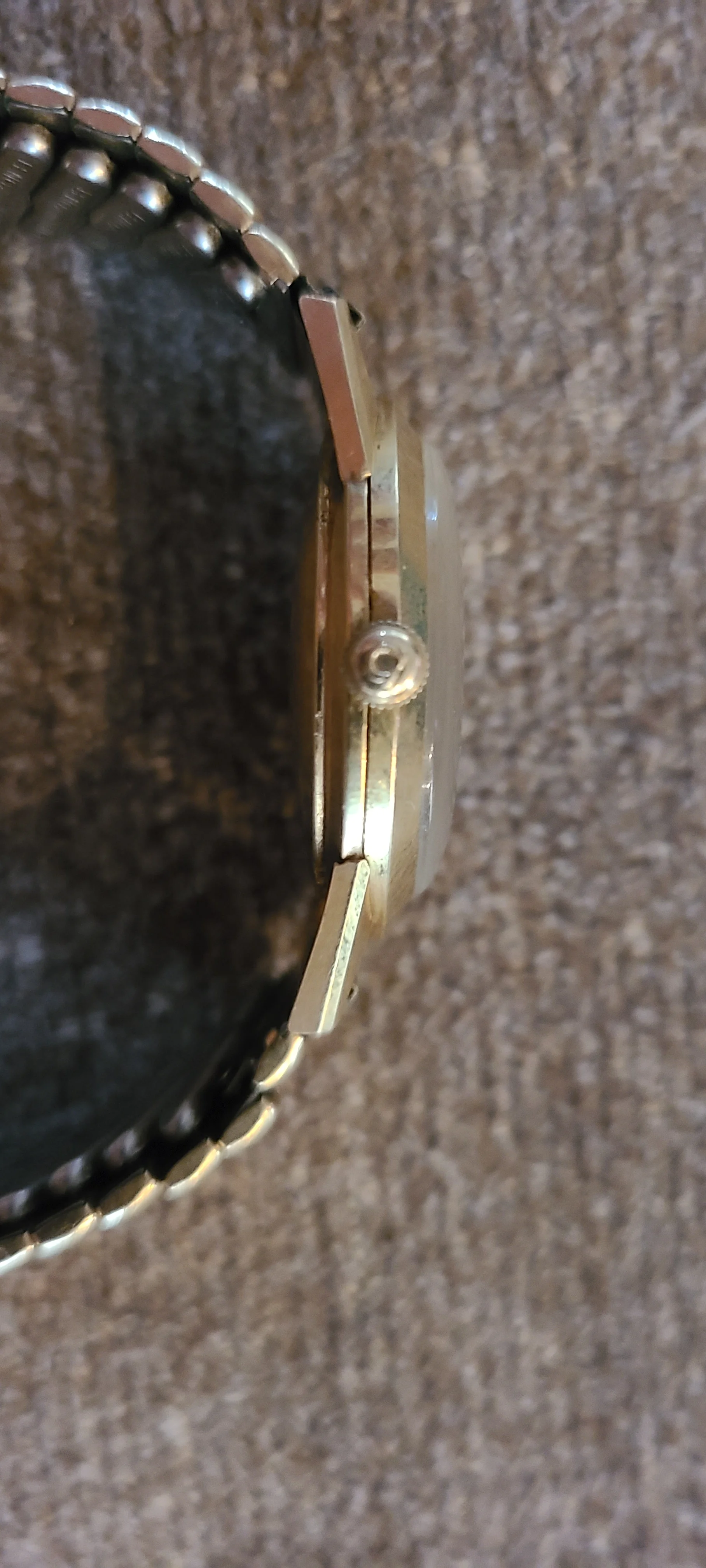

There are no visible markings near the lugs, and the only markings on the back look to be 14K with the Omega logo and the original owners initials. It appears someone has attempted to remove the back at some point and made some scratches. I have not attempted to remove the back because I can't see any sort of notch to aid in removal and I don't want to make things even worse.
I was curious as to what model this is, potential value, and if it's worth having it repaired.

Indeed the watch has no case-back, it is opened from the front. Most likely it is a US-cased watch and it has no particular model name. You would need to have the case opened to learn much more about it. I would estimate the realistic market value of the watch to be in the ballpark of $1200, more or less, primarily due to the high current price of gold. The watch is in decent shape, but seems to have some blemishes on the dial.

I don't have much info about the watch other than the original owner came to NYC from Russia in the 40s. The dial is blemish free, what came through in the pictures was a little schmutz on the crystal. Opening the case is above my pay grade, where would I have this done and what should the costs be?
The other question I have, is it worth having repaired if I intend to sell it? Because I'm used to a modern styling, I feel like the dial looks too small for my wrist.

You should not do any repairs if you intend to sell it. Have a watchmaker open it and take good photos of the movement and the inside of the case with the movement removed. If you come back with photos of the inside, I'm sure we would be happy to help you interpret them.
If the dial is clean, a buyer would probably pay a bit more than my previous estimate, but TBH, selling the watch is up to you.

It looks like a local gold variation on the 14700 Seamaster.
