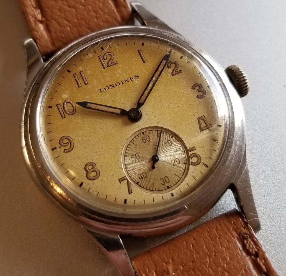

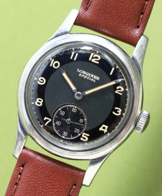

That's rather specious reasoning. How do you know that it is actually lume?
Specious? lol!
Do you imagine that the indexes were originally painted yellow? It's quite obviously lume, or meant to look as such by a re-dialer.
64
59
I would bet that the watch didn’t start out looking this way. Many warning signs for me.
422
884
If it isn't the lumed hands are of concern...
I'm going with original Longines dial installed in a later case w/ incorrect hands 😒
It positively reeks of being a put-together.

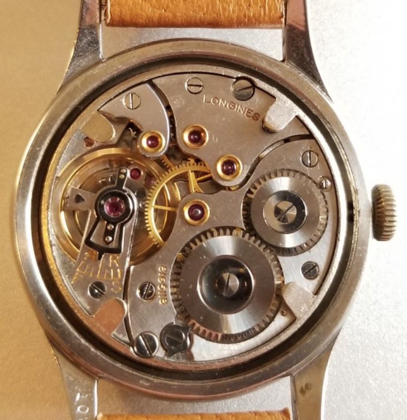

Its certainly probable given its an 8 million serial number on the movement.
Hmm, could one supply the serial to Longines and hear what they had to say..?

Specious? lol!
You clearly have better eyes than I.
I could post several Longines I own from the late 30s with similar colour numerals that are not lume.

8 million serial number is from the early 50s. I would be rather surprised if the dial is early 50s.
Please do.
Oh, I thought the serial was earlier. Then it probably wouldn't say much...
Re. the indices, they look golden to me, not yellow. Not lumed either.

I will post some in the future. I have a number of 17.26s that come to mind.
They do not look like gilt to my eye, though the rest of the dial does. Better photos would, as usual, help.

That minutehand is not even close to the outer «minute scale» looks to me
like a hybrid between sweep and sub second. The whole layout of the dial
is not period correct. But I would love to see more and better pictures.
1,145
5,651
Could it have been from a 12.68 chronograph ?
Are the dial feet in the same place ?
Yes, afaik the dials are interchangeable. Interesting suggestion.

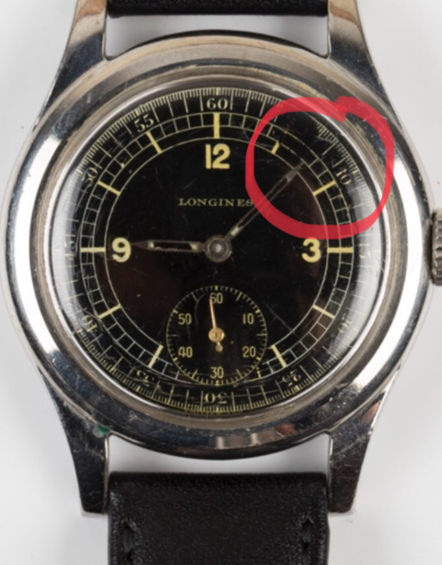

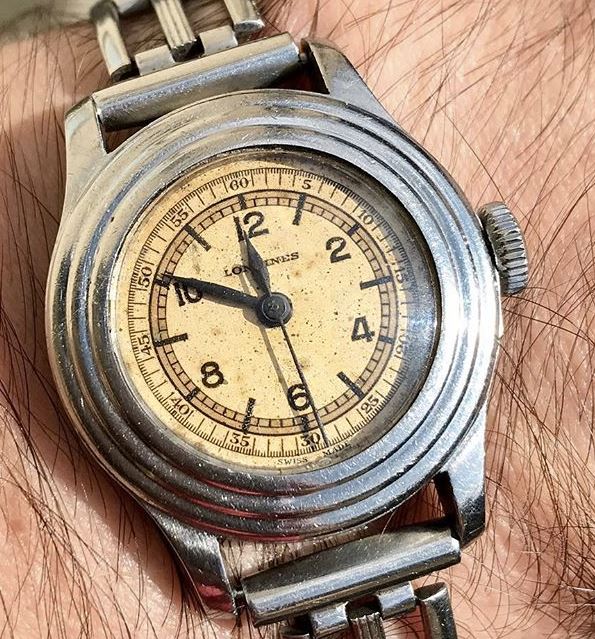

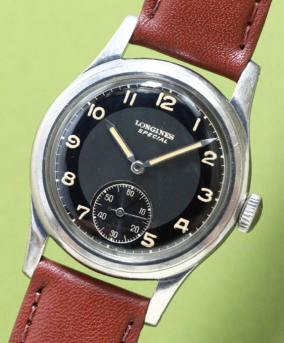

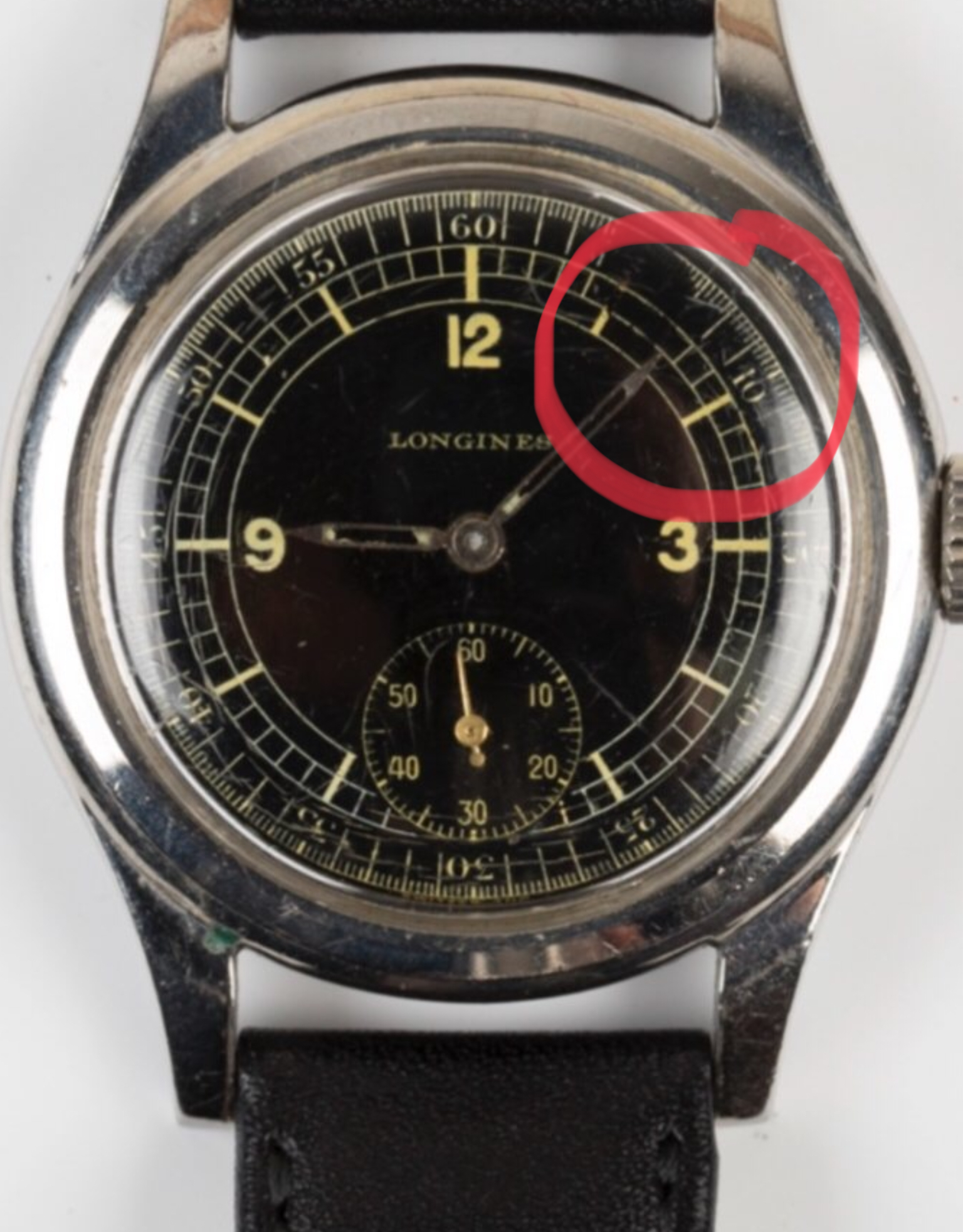

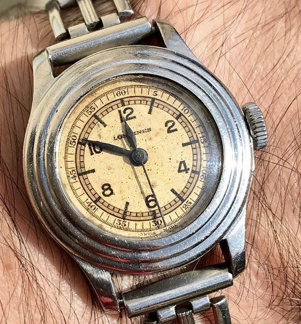

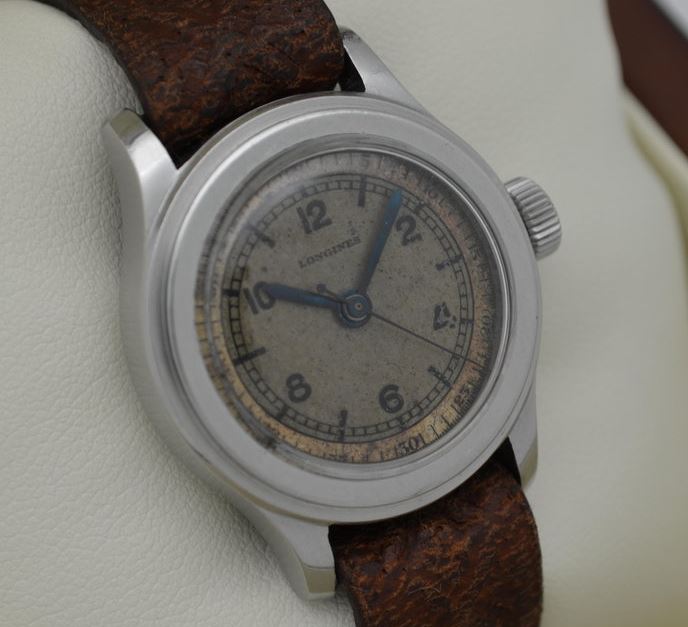

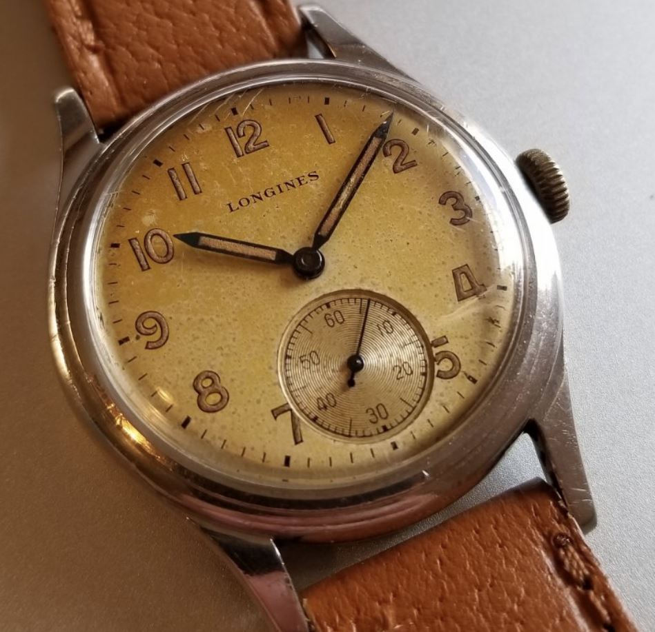

To my eyes, the fonts on this dial are incongruous. The sub-dial is reminiscent of late 1940s/early 1950s sei tacches whereas the outer track echoes the 1930s (see images below). This aesthetic dissonance, compounded with the mismatched handset, points in a dubious direction.
