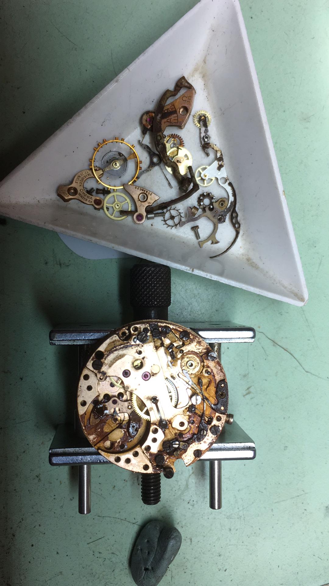

On it... apparently what it’s left there on the main plate it’s pretty stuck... but the serial number is out and seems to be in good shape... between finding a mouvement donor and fixing everything (mouvement first, dial we will see and hands won’t be touched) this is going to take months 😲

As noted earlier and in the linked threads, often much of the rust can be removed and parts loosened by soaking in the appropriate cleaning solutions and then superficial rust can removed with soft brushes. Many of those parts are not made of ferrous metal, so they are not actually corroded. I assume your watchmaker is aware of this, but may not want to invest the time and effort into it. Or he may think that you don't want to pay for his time and would prefer to buy a donor movement (which will not be cheap).
The watchmaker actually looked excited when I showed him this project 😉
He explained the “cleaning solution” exactly as you mentioned but he talked about a donor mouvement as well. As a matter of fact he asked me to wait as long as needed to tell which parts he would need. So maybe that explains it.
I was very clear about the “money and time” issue - it’s no issue. He can take as much time as he wants and I can fortunately easily pay the higher estimate he gave me the day we met. He's well aware of that.

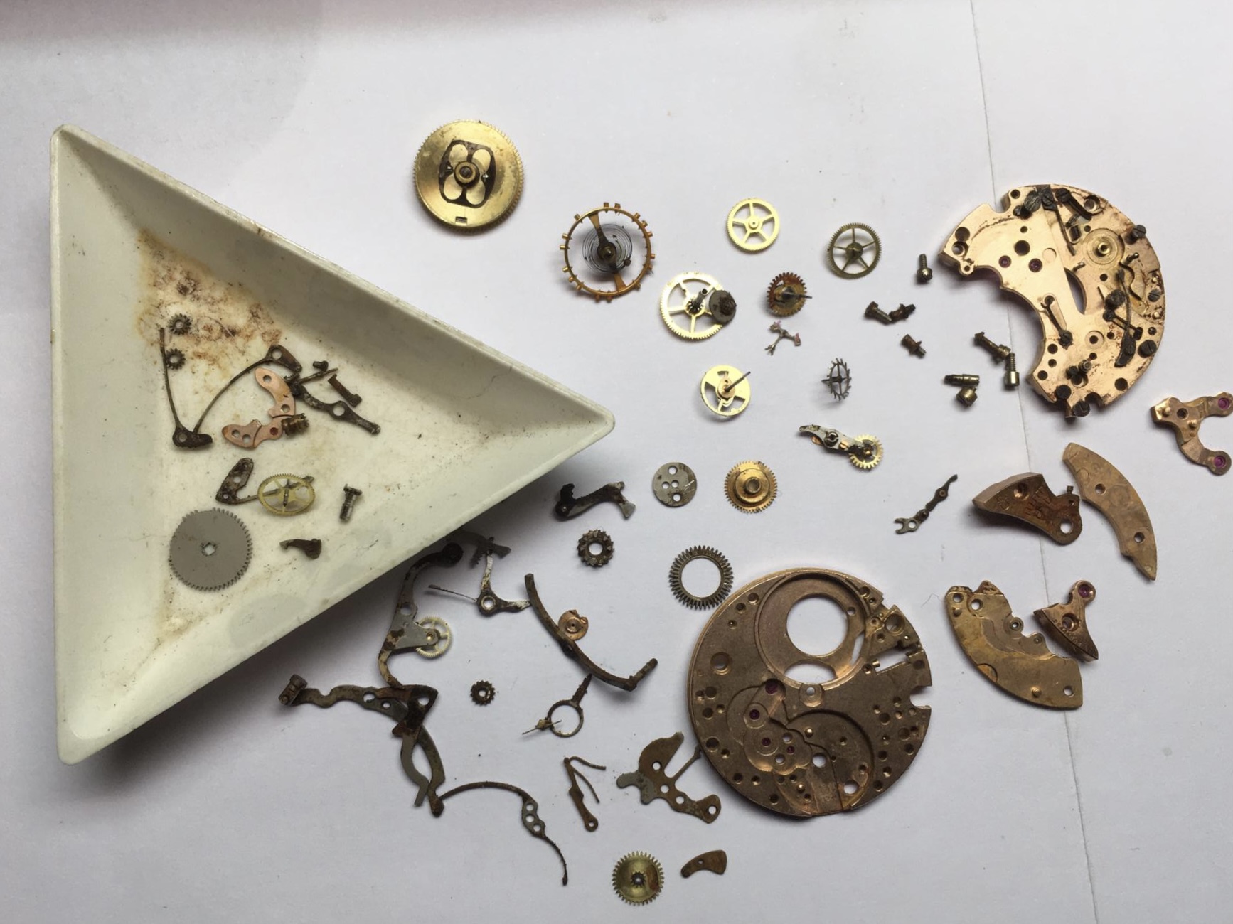

Disassembling completed and components ready for a thorough bath in a cleaning solution. We will see what can be retrievable after that well earned bath. Fingers crossed...
