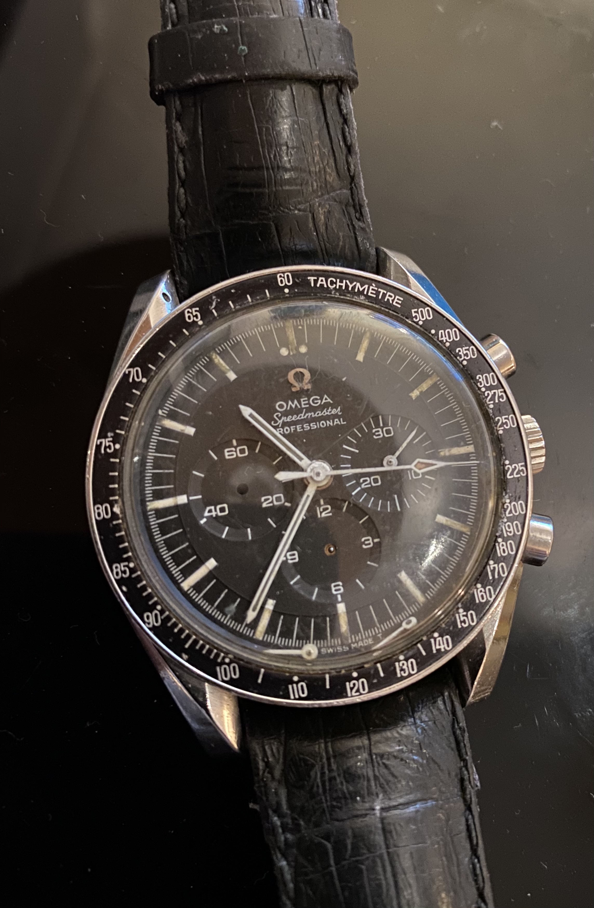

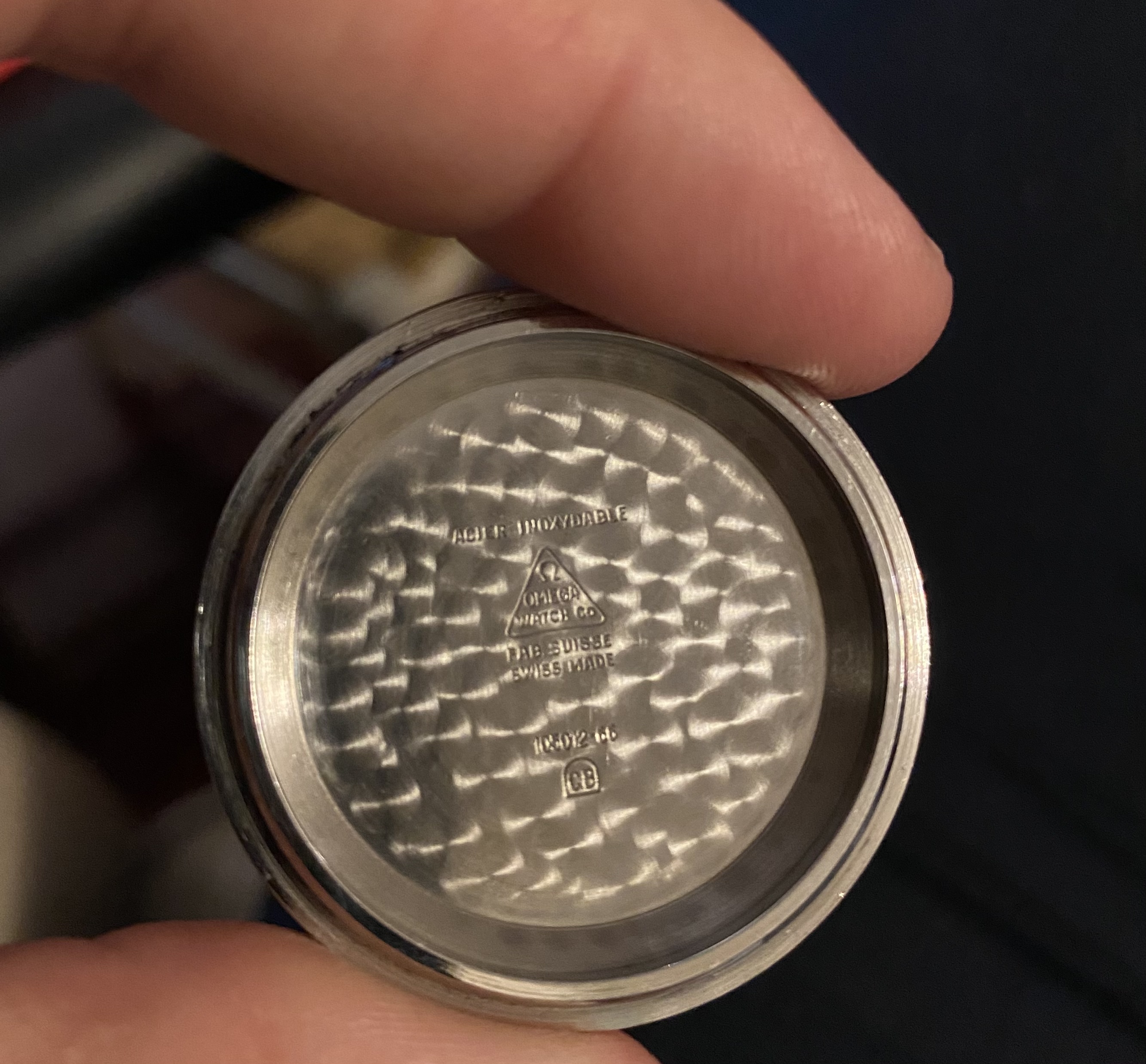

The story of this watch it’s well explained in the thread title...
I’m not the owner and despite finding it pretty cool I’ve surfed in my life...
I need some guidance regarding:
1: could we bring it back to life (if if a relume and mouvement transplant it’s need)?
2: if not, how would you value it for parts?
Thank you in advance for your help.
1,180
4,233

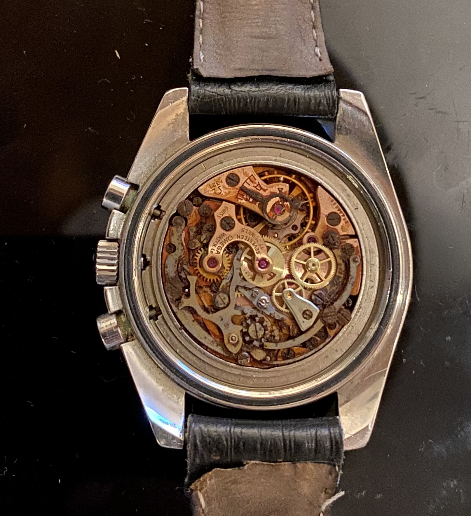

I can't read the last digits well but I think it's a 105.012 66 which is quite valuable.
So bringing it back to life is not a bad idea.
It's pretty obvious that some parts are a little bit rusted ... In the worst case, you need a complete donor movement to get the needed parts.
However, a skilled watchmaker can do the job.
Not Omega, but you get an impression: https://omegaforums.net/threads/video-completely-rusted-out-rolex-gmt-full-restoration.122103/

Thanks for your reply @Oku
i know it’s a -66 (case back says it all) and that in good shape it’s quite valuable. The problem is I’ve never seen one in such poor shape, however. That’s why I’m asking for help. If someone knows a very skilled watchmaker that could bring back this watch I would love to know his/her name.

Were are you from? That would help to recommend a watchmaker.

I guess you’re right. I’m from the country to where this watch was delivered to by omega. Before you ask, I’ve no EOA but I’m pretty sure what it’s going to be written there. 😉 (Little quiz???)

Forget the movement. Buy a 321 donor and service it. Clean the bridge with the number and switch to new mvmt. Explain, if you sell later. Rest of the speedy is easy to clean up. Good luck. Achim.

Thank you very much Achim. That’s what I was looking to know.

It's hard to know what will be needed until an experienced watchmaker disassembles the movement and starts cleaning it up. Much of the rust may be superficial, i.e. rust from the screws that sedimented on various plates and parts. At that point, you may decide that a donor movement is needed, or maybe not. As you mentioned, a re-lume would probably improve the aesthetics.

Portugal has plenty of omega experienced older watchmakers. And still plenty of parts. Omega was considered superior to Rolex in your country. Go to a local omega collectors site and ask for an older omega watchmaker. Should be no problem at all. And service prices will be cheap as well..... Good luck and keep us posted. Kind regards. Achim

The watch looks like it has plenty of potential despite the current condition. I would have the movement cleaned/serviced or replaced as many have suggested. The dial is a perfect candidate for a relume so I would send to James Hyman in the UK or Adam Lewis from Lewis Watch Co here in Australia. Lewis Watch Co recently saved a rusty 321 movement so he might be a good option if you do not mind sending to Australia.

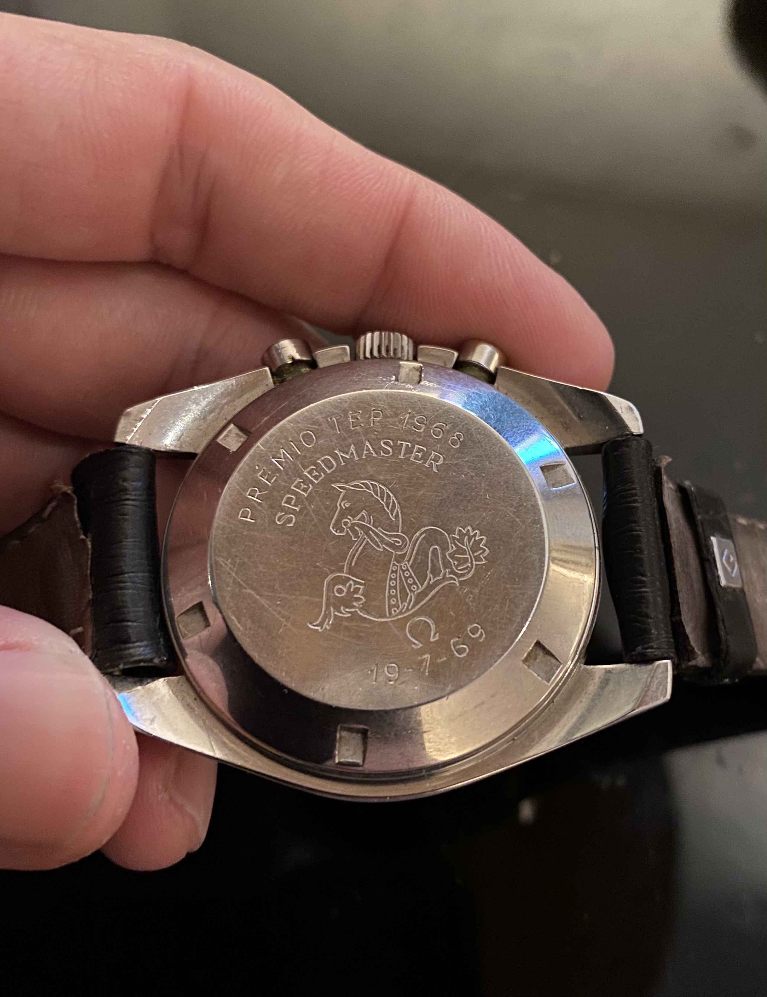

OP, do you happen to know what the case-back engraving refers to? It's intriguing.

i do know. This watch was a first prize in some kind of dance competition. The organisation/dance or meeting club it refers to doesn’t exist anymore, though. Can you imagine going home with a 66-CB after a bit of (very) amateur dancing??? 😁

Wow. Just to stress what some others have already hinted upon above; this actually is a rather well-preserved 105.012-66 CB case with clearly visible facet lines on the upper lugs. If you'd be able to get this going again with a donor movement and would have the dial relumed, it could certainly make for a very nice daily wearer.
That said, you will have to disclose the history of the watch in case you ever sell it. Great opportunity to get a very nice vintage daily wearer out of what at first sight might appear a basket case at best.
Given the Portuguese import mark, I would personally never choose to transplant the movement, unless you can keep the serial number as the serial should correspond to a watch delivered to Portugal. That said, for a true collector's watch, this example has seen a little too much action anyway...

After you switched the bridge with the number to the donor movement, get an Omega EoA and see, if Portugal delivery checks out. Or even get that EoA now.....

The advice here is good. I too would vouch for the approach of first seeing if the movement can be salvaged or not before deciding on a donor movement. Here is an example:
(before) https://www.instagram.com/p/CD1Z6CTHbBC/igshid=1ixm7x8b9iwbe
(after)
https://www.instagram.com/p/CEt-OLIHRYC/?igshid=riz6ogpxnehx

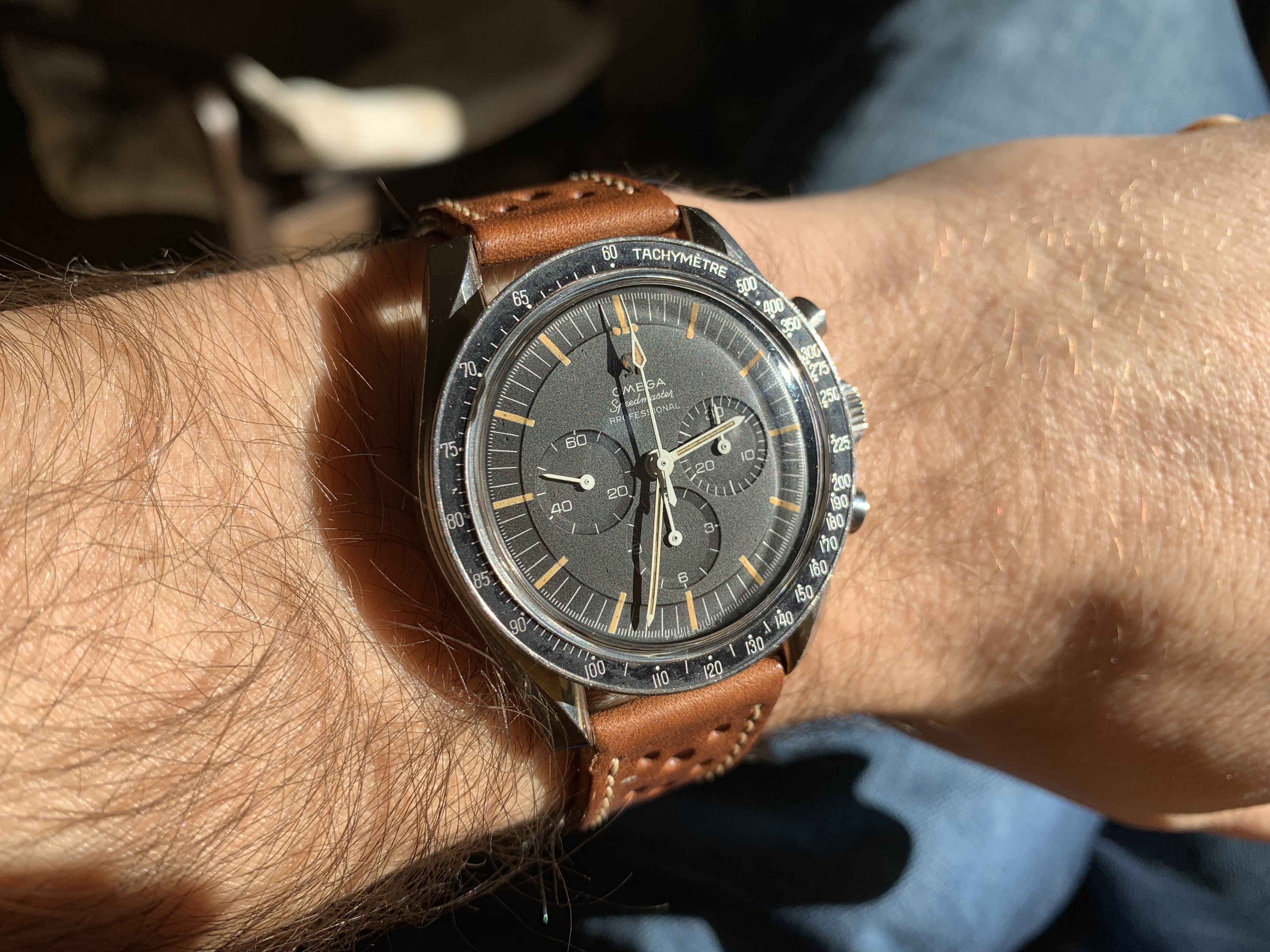

The case looks good, the dial would be greatly improved with a relume, and I would most likely leave the hands as is (maybe stabilize them) and get the dial lumed to match the character of the hands. But that’s my preference for maintaining character...another approach is to just lume everything all matchy-matchy, Good luck with the restoration and do keep us posted, always great to see.
ps : here is an example of how it could end up looking...
