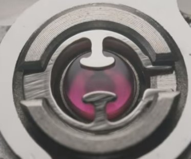

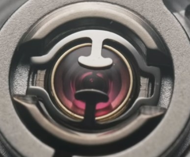

As usual, no pivots in the jewels of the fake. Obvious tell....

It’s tell that I have been talking about for quite a while now, and one worth learning, because this goes across brands...

I tried searching for a good quality fake movement pic to try demonstrate that here in this thread, but they are surprisingly hard to find from reliable sources. I've used a particularly obvious/egregious example from the video:
Fake:
Real:
Also, knowing this won't protect noobs like me from watches with the wrong movement, but only those where a basic movement has been disguised or 'dressed'. In other words the movement underneath the dressing will have visible pivots (presumably).
Anyway it will be important to have a loupe. I'll also continue to buy face to face from reliable sources for the foreseeable.
