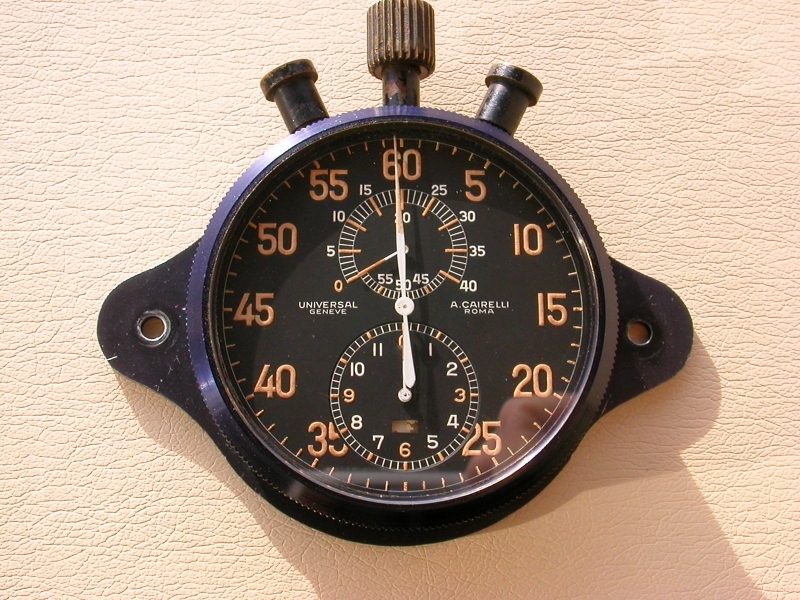

Unfortunately not a rattrapante, but a nonetheless spiffy dashboard chronograph from the 1940s, presumably Regia Aeronautica. I know precious little beyond that and am having trouble turning up more.
Bottom knob winds and sets, and the 4:30 knob starts, stops and resets the chronograph. Outer bezel turns the inner bezel
The mounting plate affixes to the watch with a leather washer
