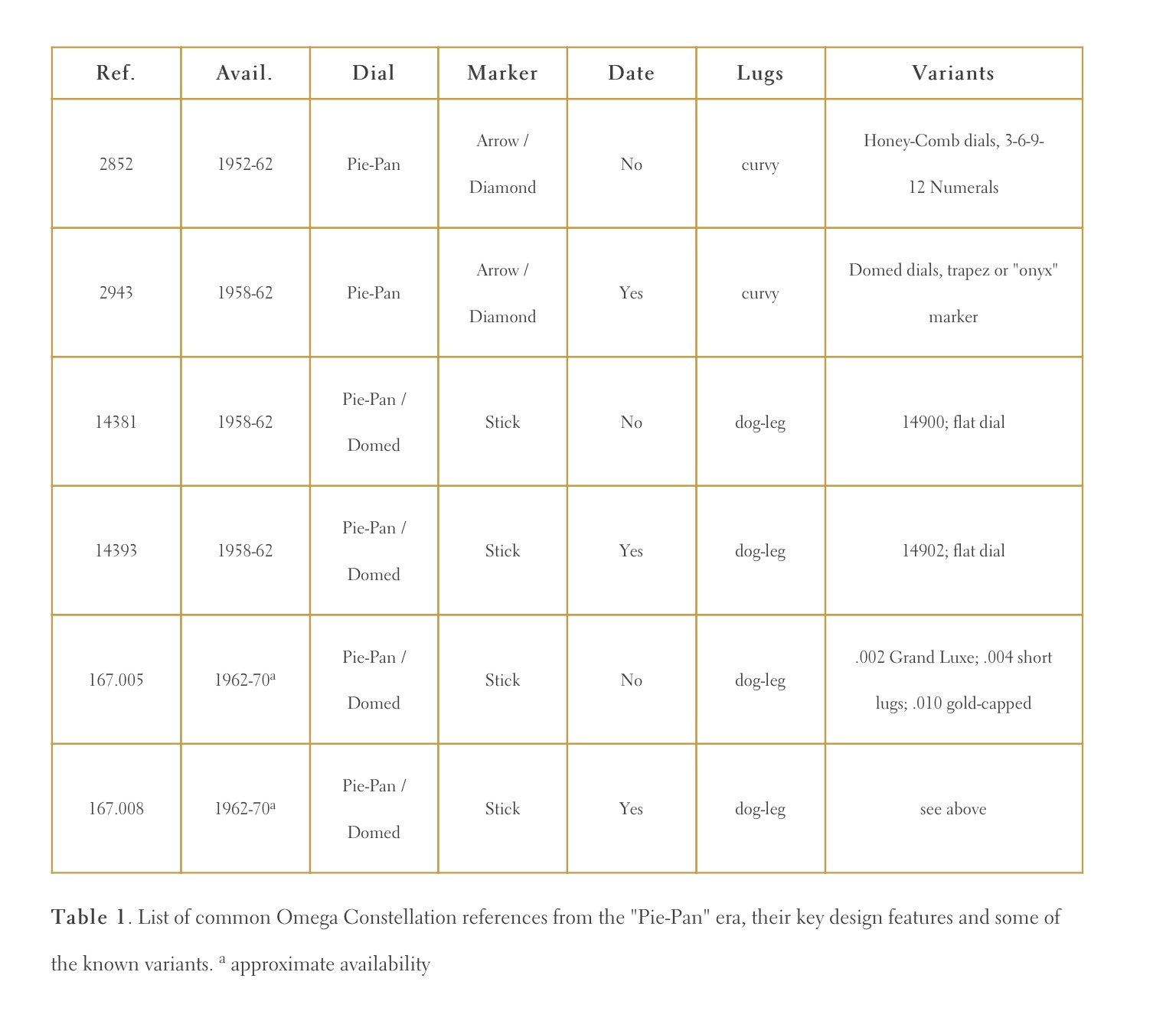

Interesting, I found a German catalogue listing both of these as the same case:

You might want to reference this table, put together years ago by @mondodec and shared on the Constellation Collector’s Blog.
It is sorted by caliber. If you can read into Excel, you can sort by case reference or year introduced.
I just don’t think it’s necessary to re-invent the wheel.
