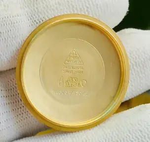

I own a solid gold Omega watch with the inner caseback stamped “168005/6 SC-62”. It also features a Helvetia head hallmark, as shown in the attached image. I would appreciate it if someone could clarify the meaning and significance of these markings. Thanks!
1,889
3,825
Hello - read the first post in this thread to get most of the information you want about the caseback inscriptions. Also, "SC" = Seconds Centrals i.e. sweep seconds hand; and the head of Helvetia signifies an 18kt item assayed in Switzerland.
More interestingly, you might want to look at this thread when looking at your dial: no question, it's a very special look - but it seems there's debate about how many real ones there might actually be. Most of the people who might actually know are on that thread and you might want to show them yours.
3
Thanks a lot, much appreciated.
