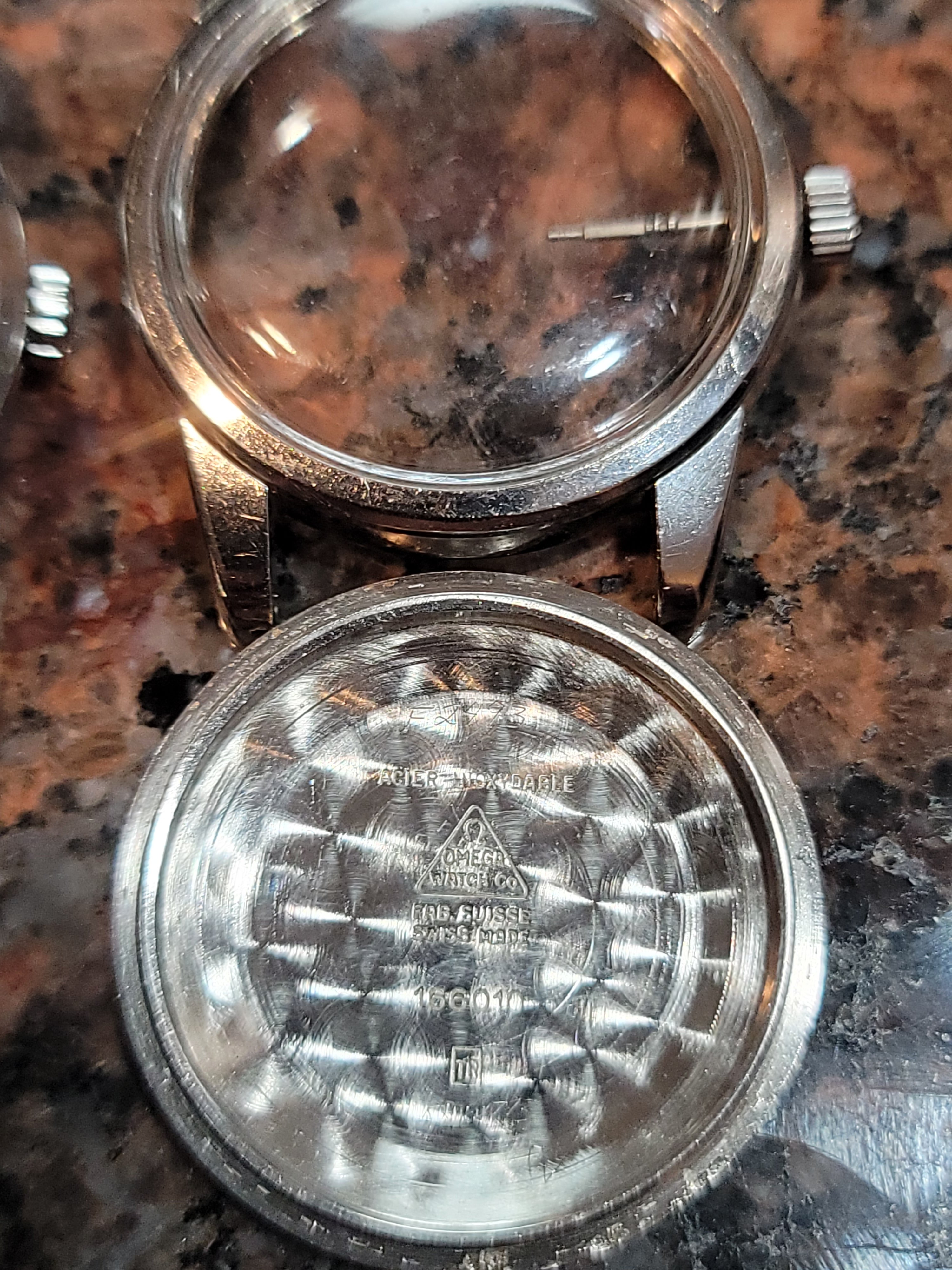

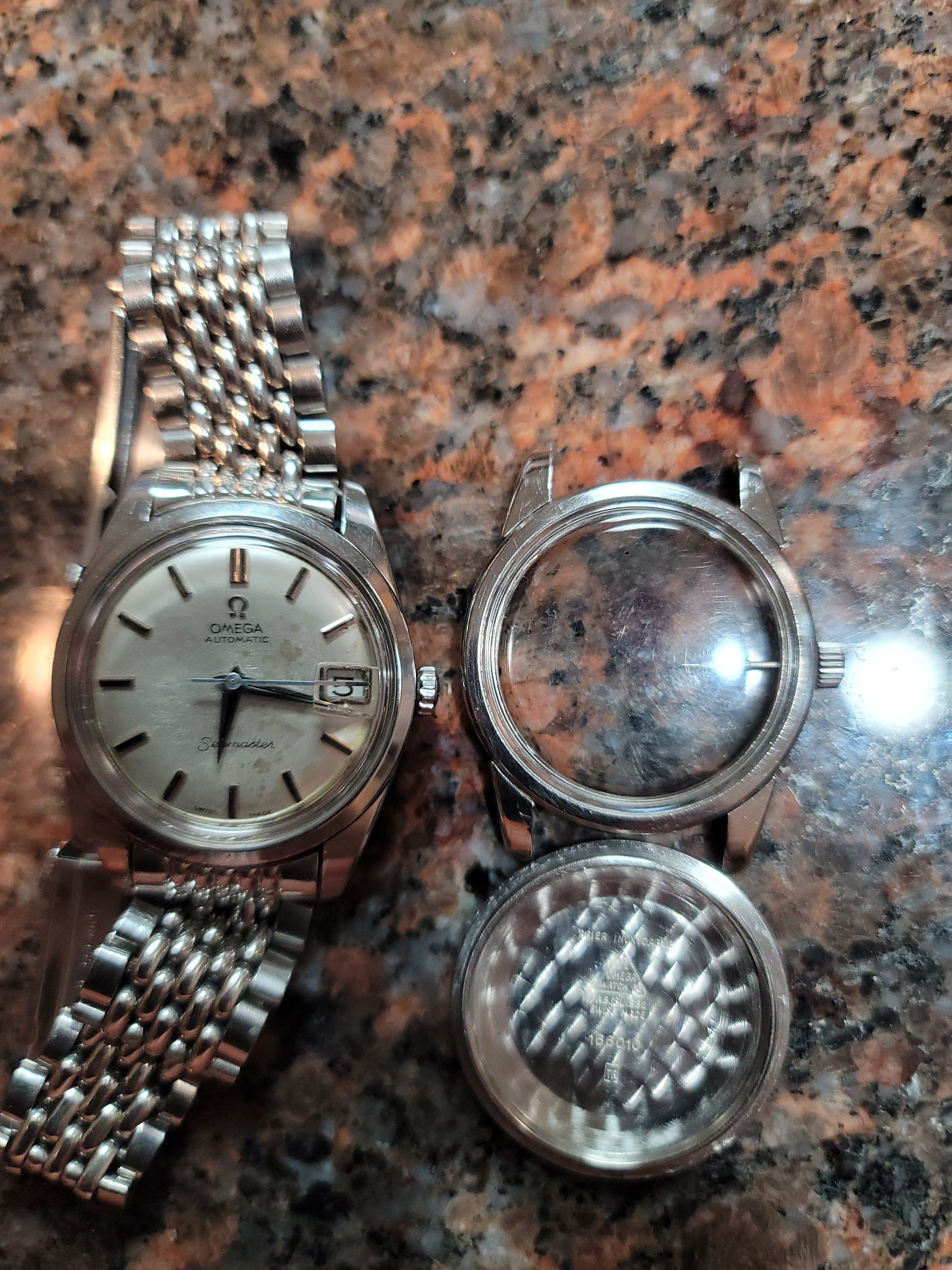

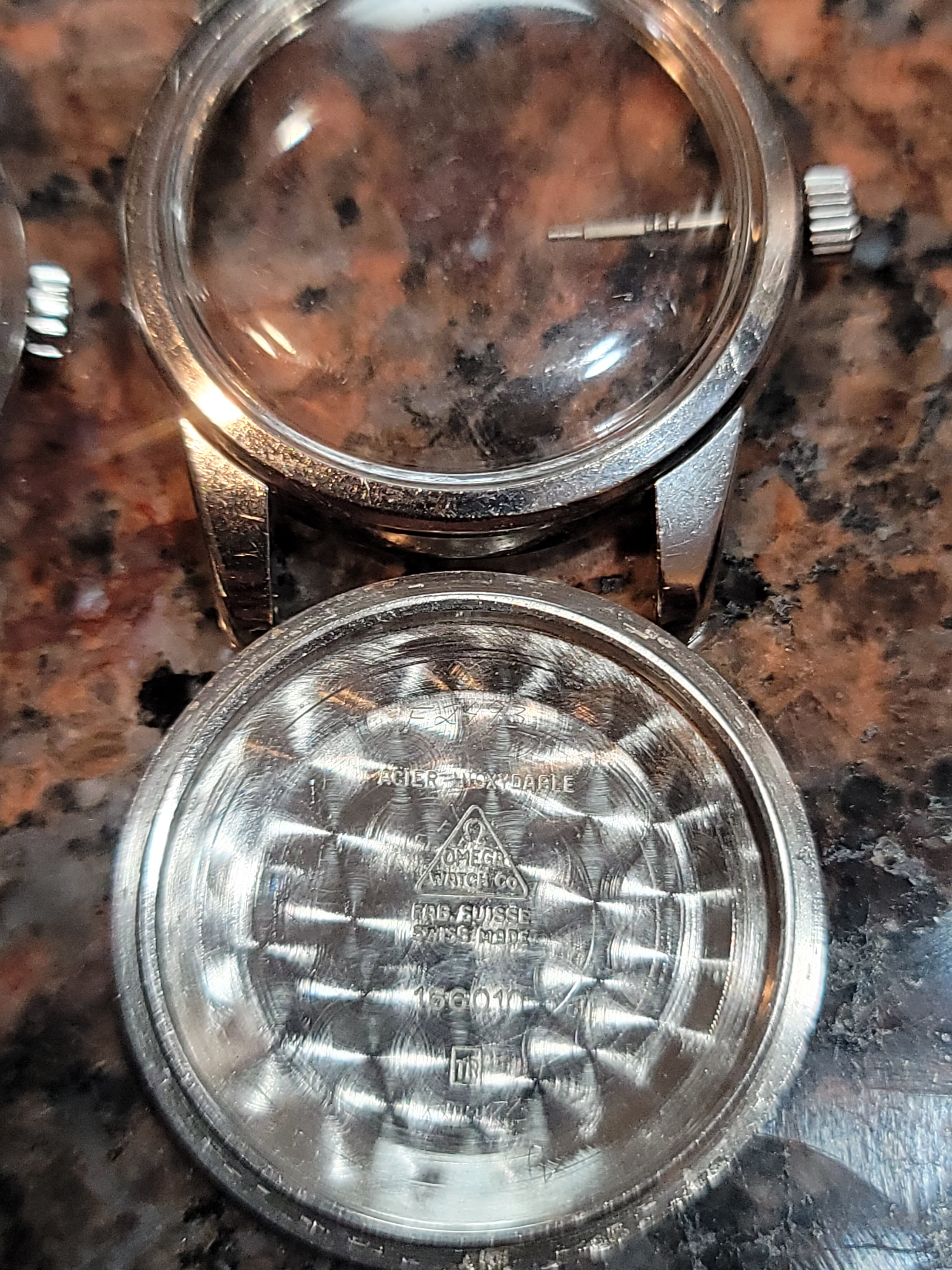

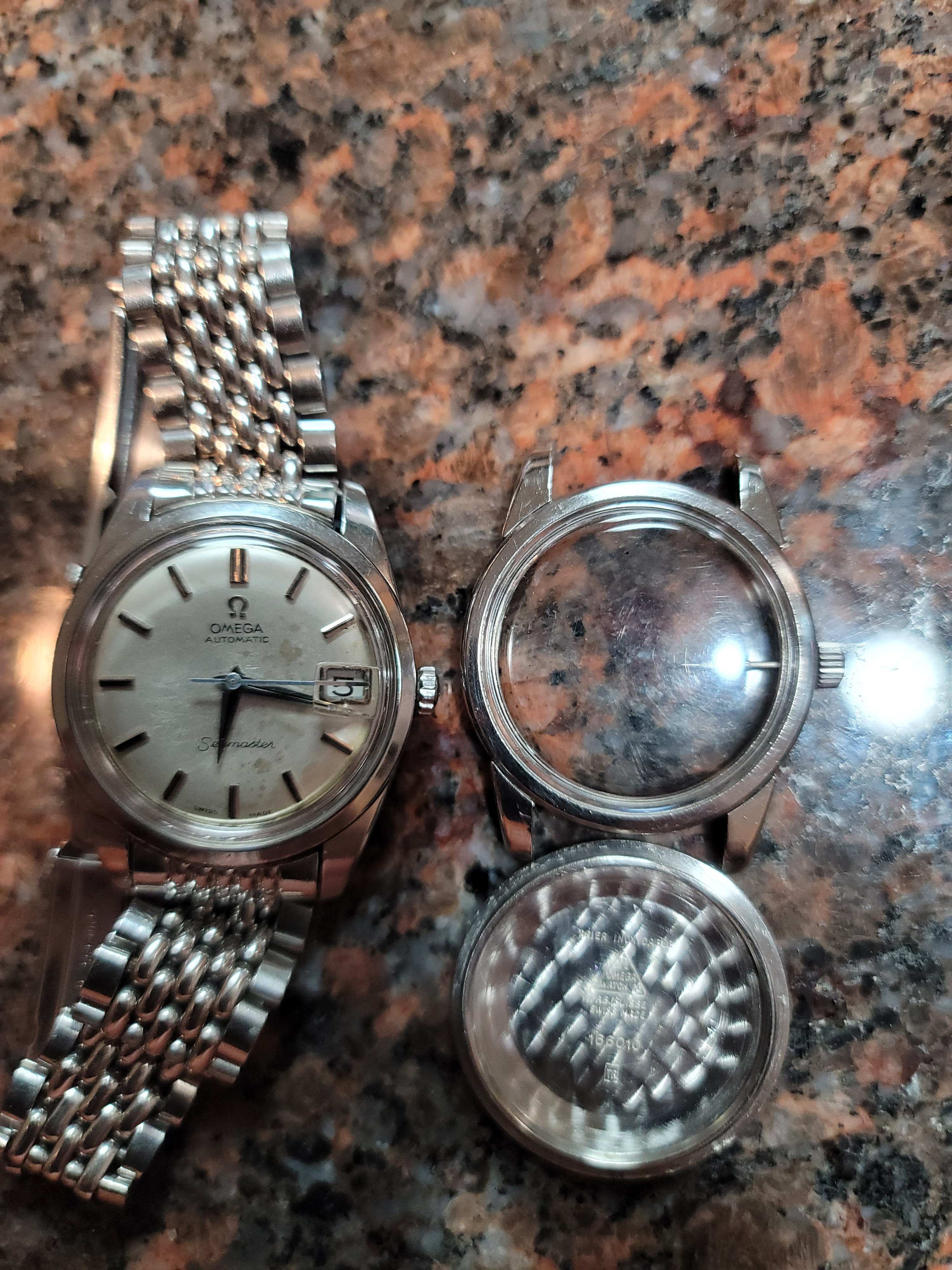

This is the "166.010" case and case back I got taken on, with my actual 166.010. When I ordered the etched Omega crystal, it was wayyyy too big. I was NOT happy.
166.010 bezel diam = 34.7
?(Geneve)? bezel diam = 33.5
