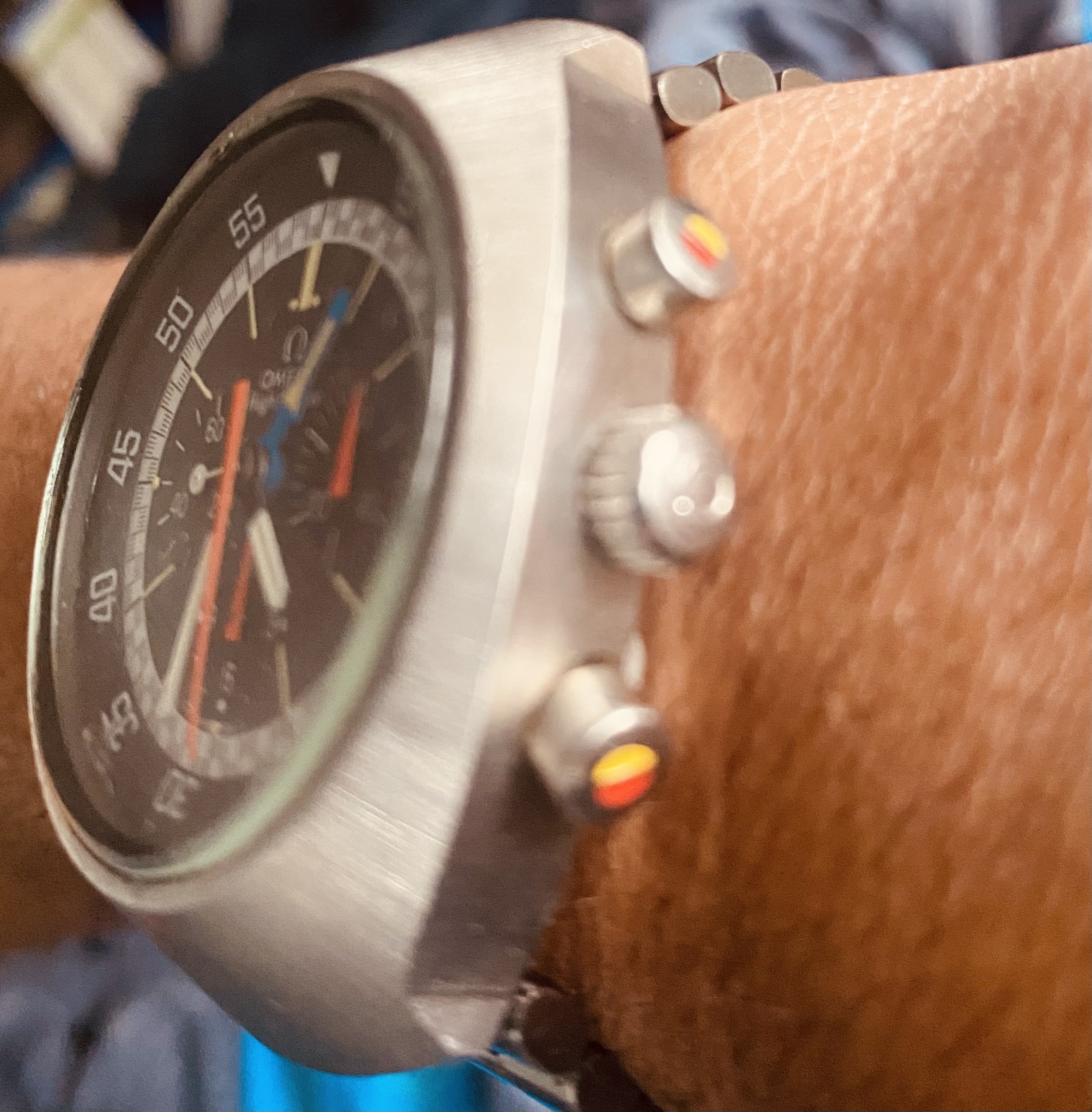

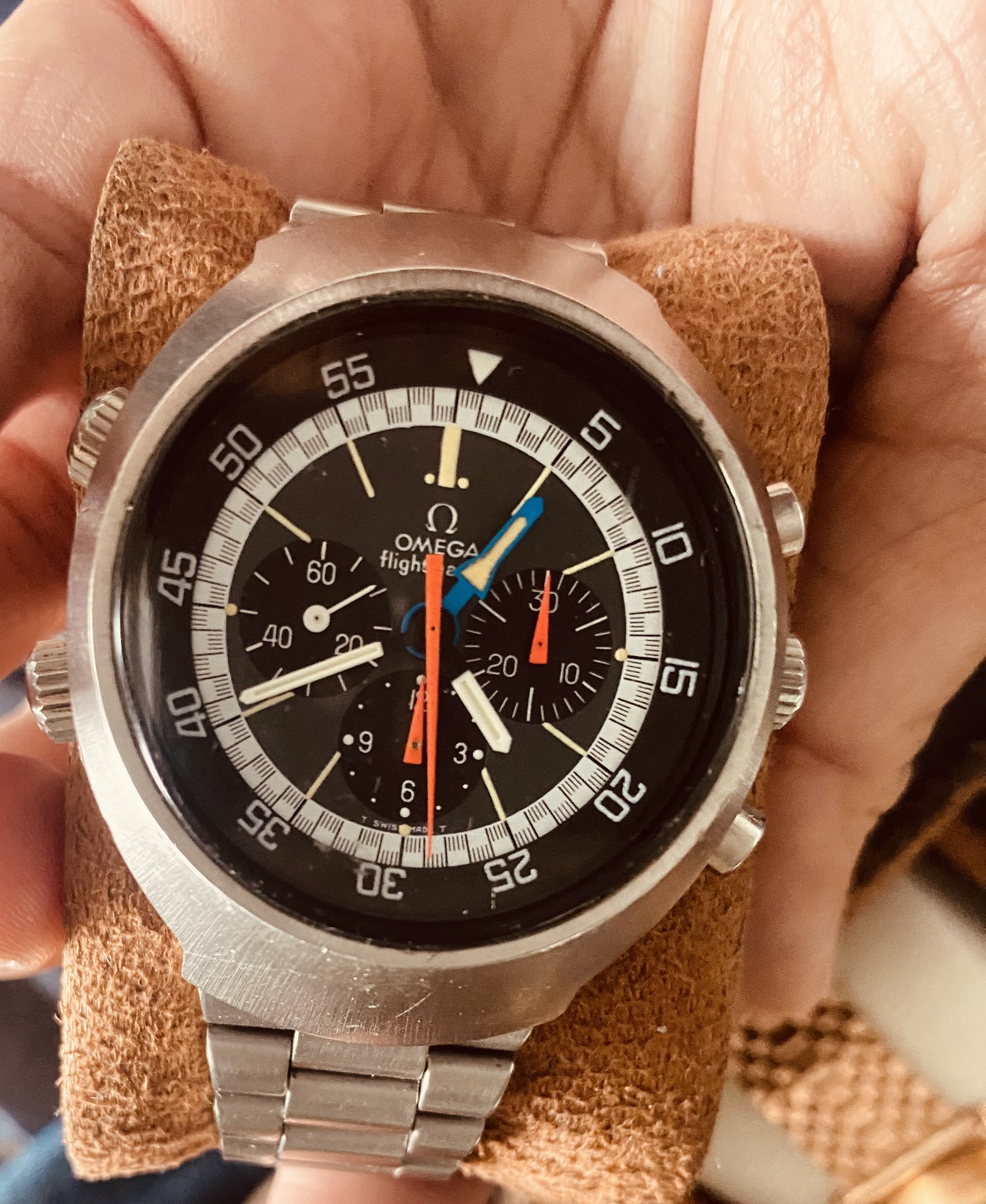

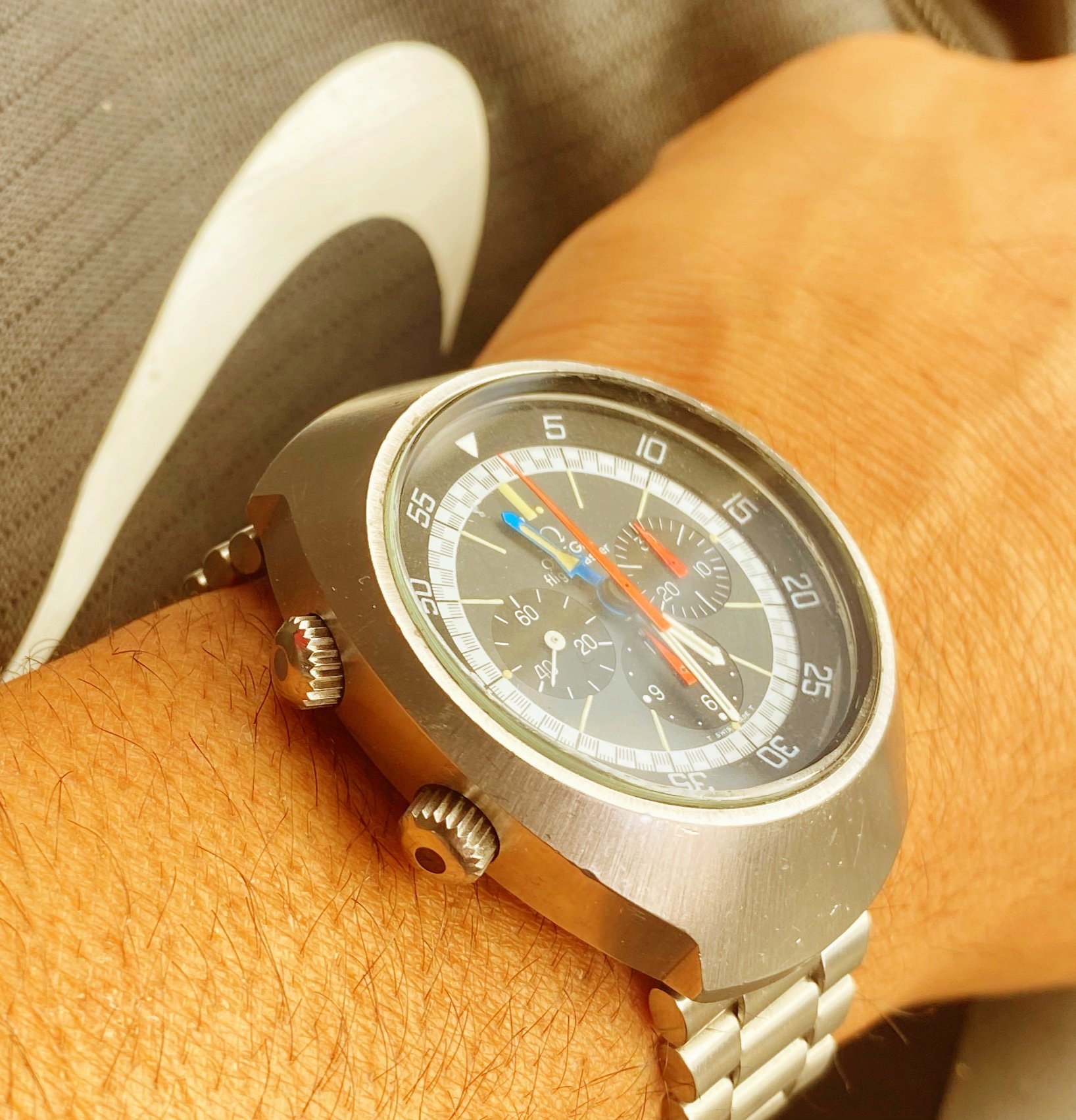

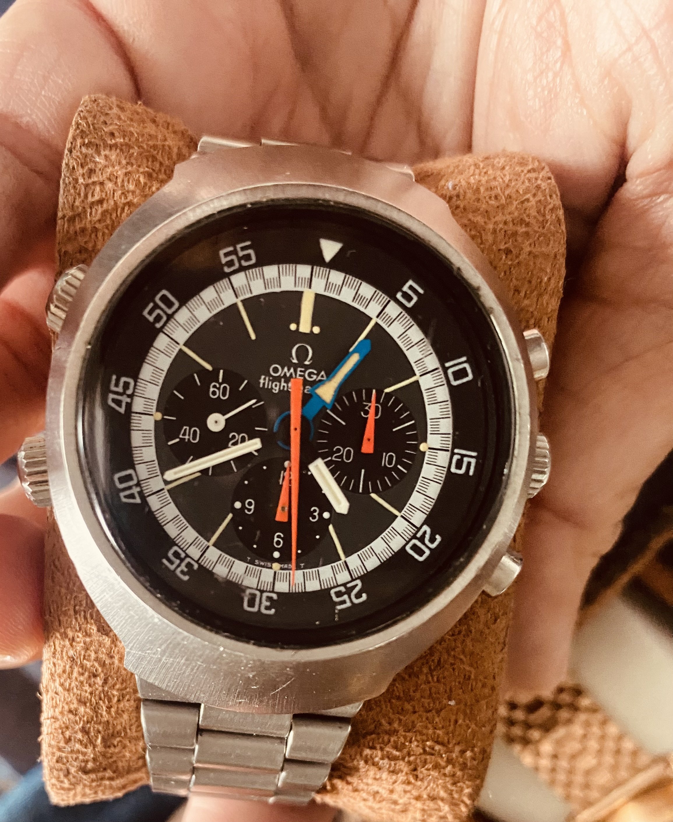

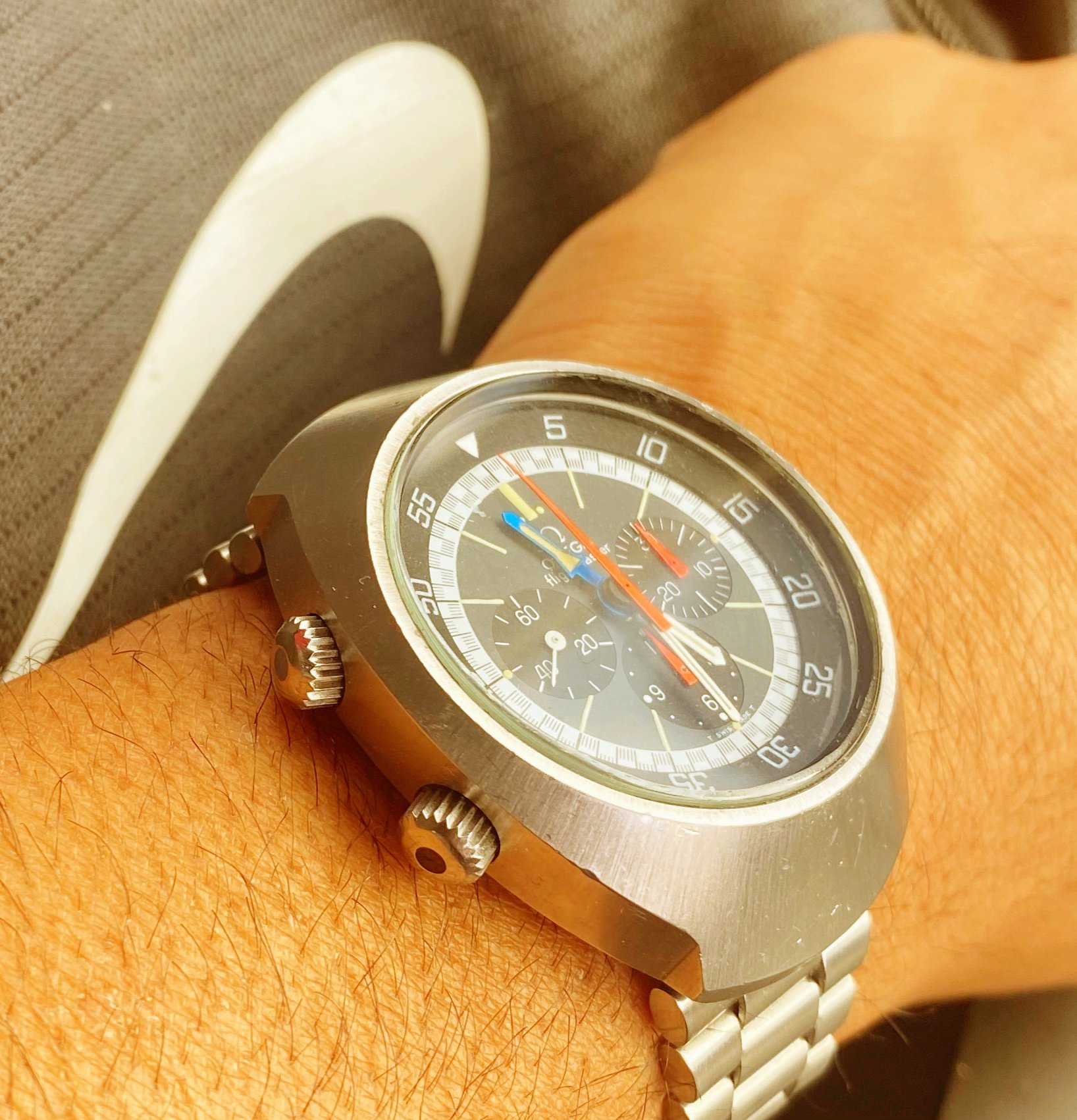

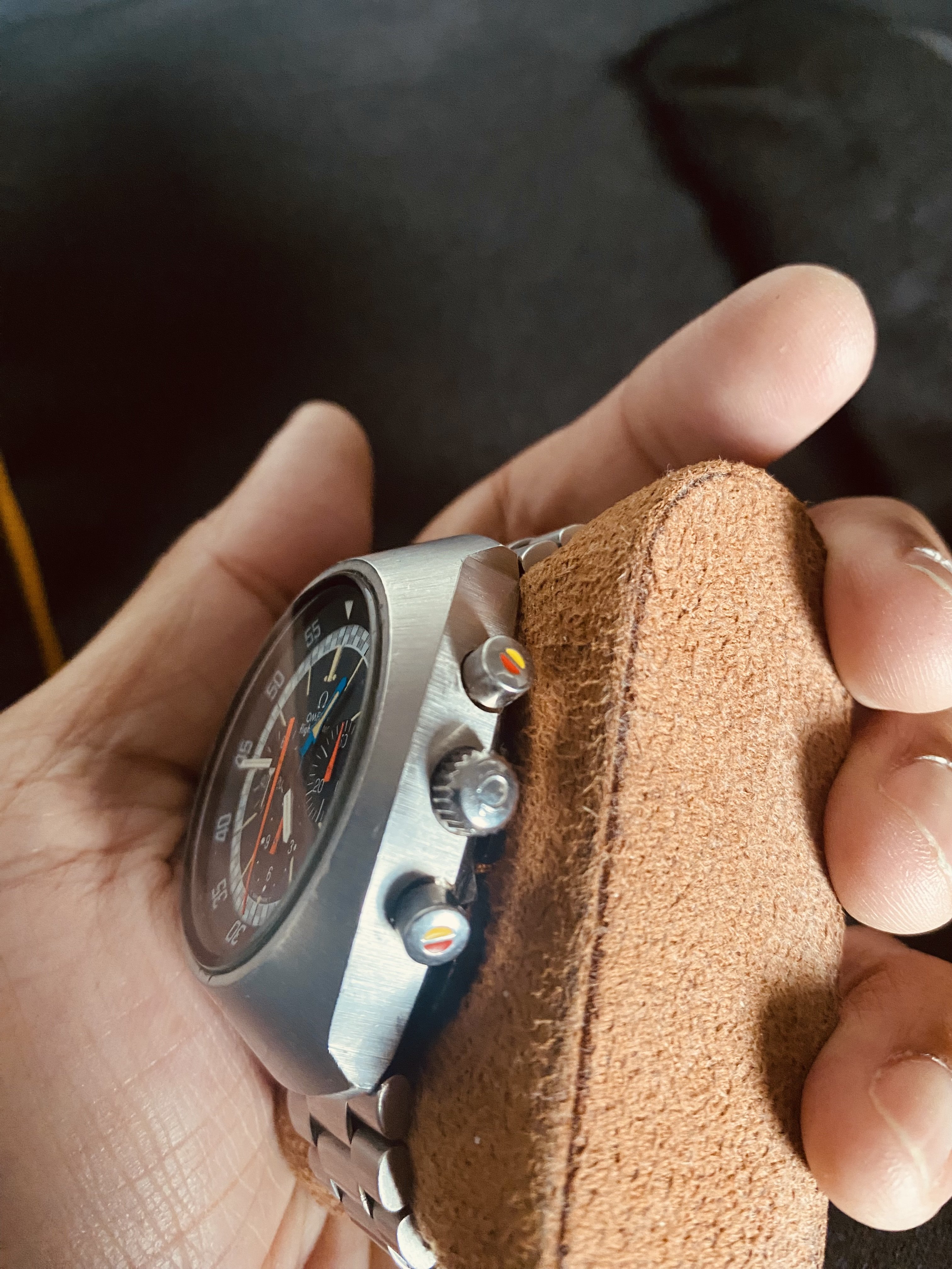

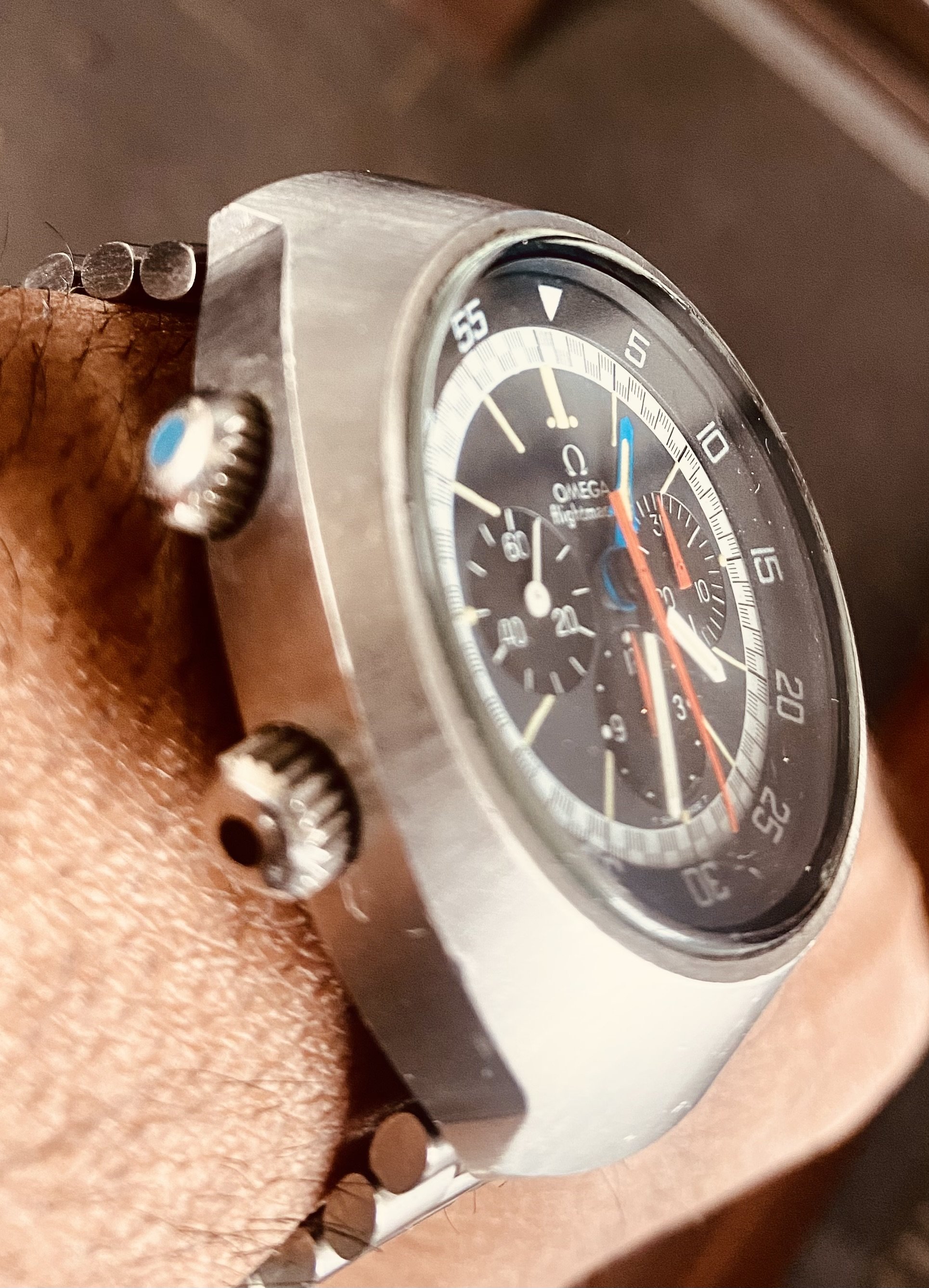

Hello! I just buy my flighmaster 910 (145.013) pre-loved. I do believe ths bracelet is not the right one as the large central seconds hand.
Movements is running in a stunning way and everything works, colored buttons, crystal to be changed. does anyone suggesting something more?

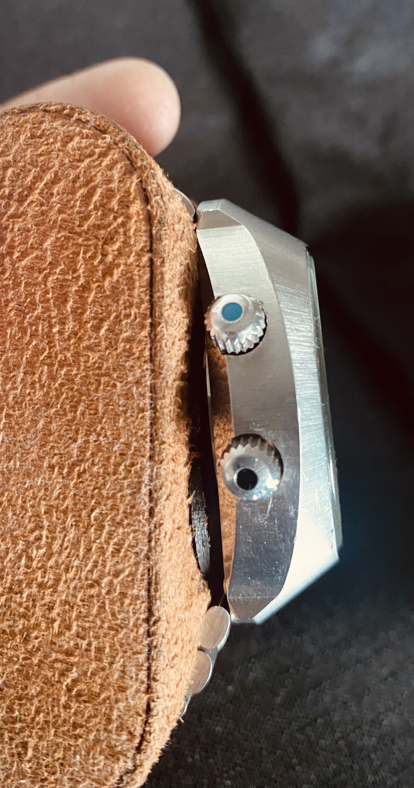

Also the crown does not look the correct one
307
230
agree, also the hour&minute hands look like later luminova service parts.

nice example, and the crown shall look just like that.

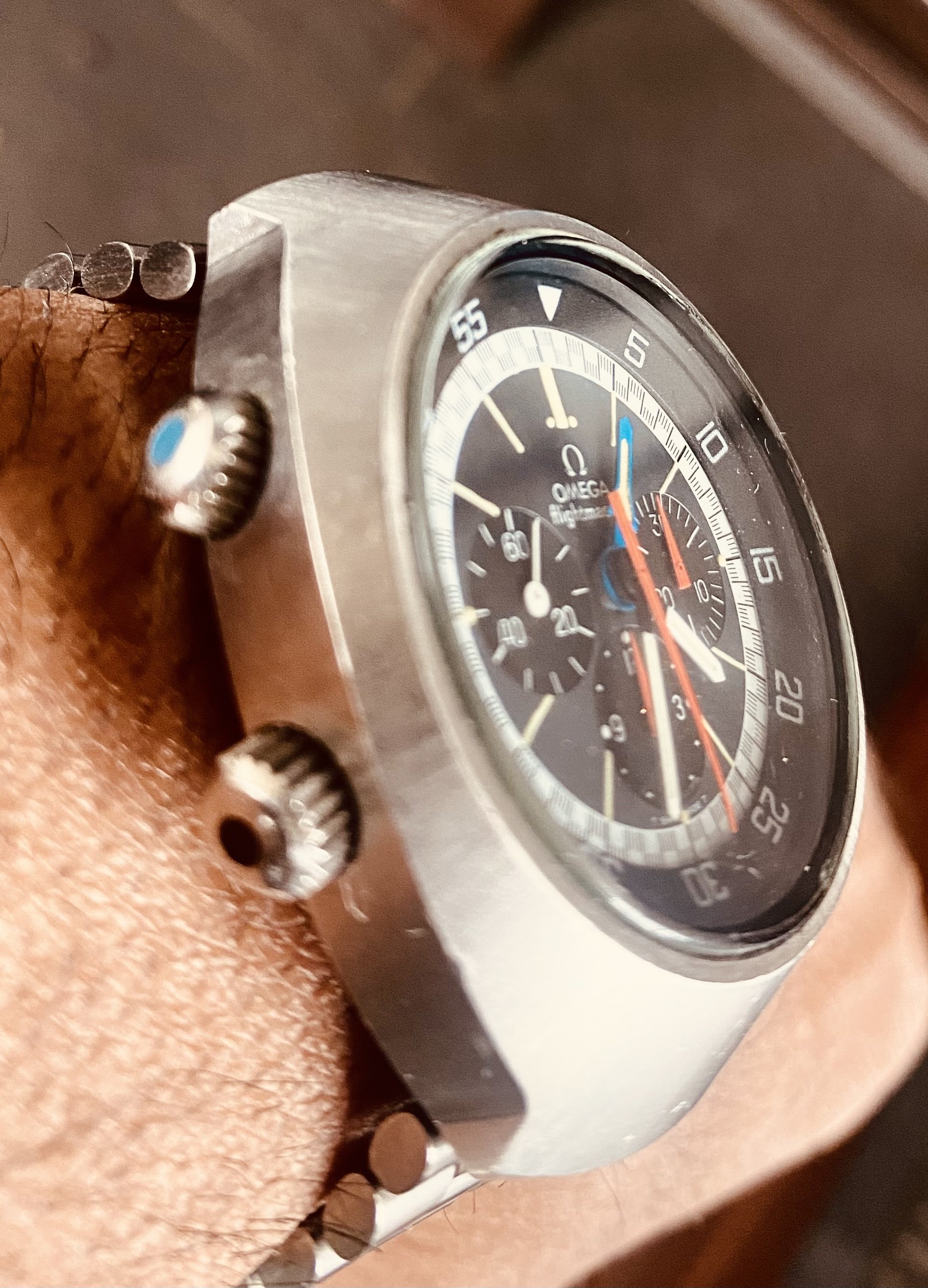

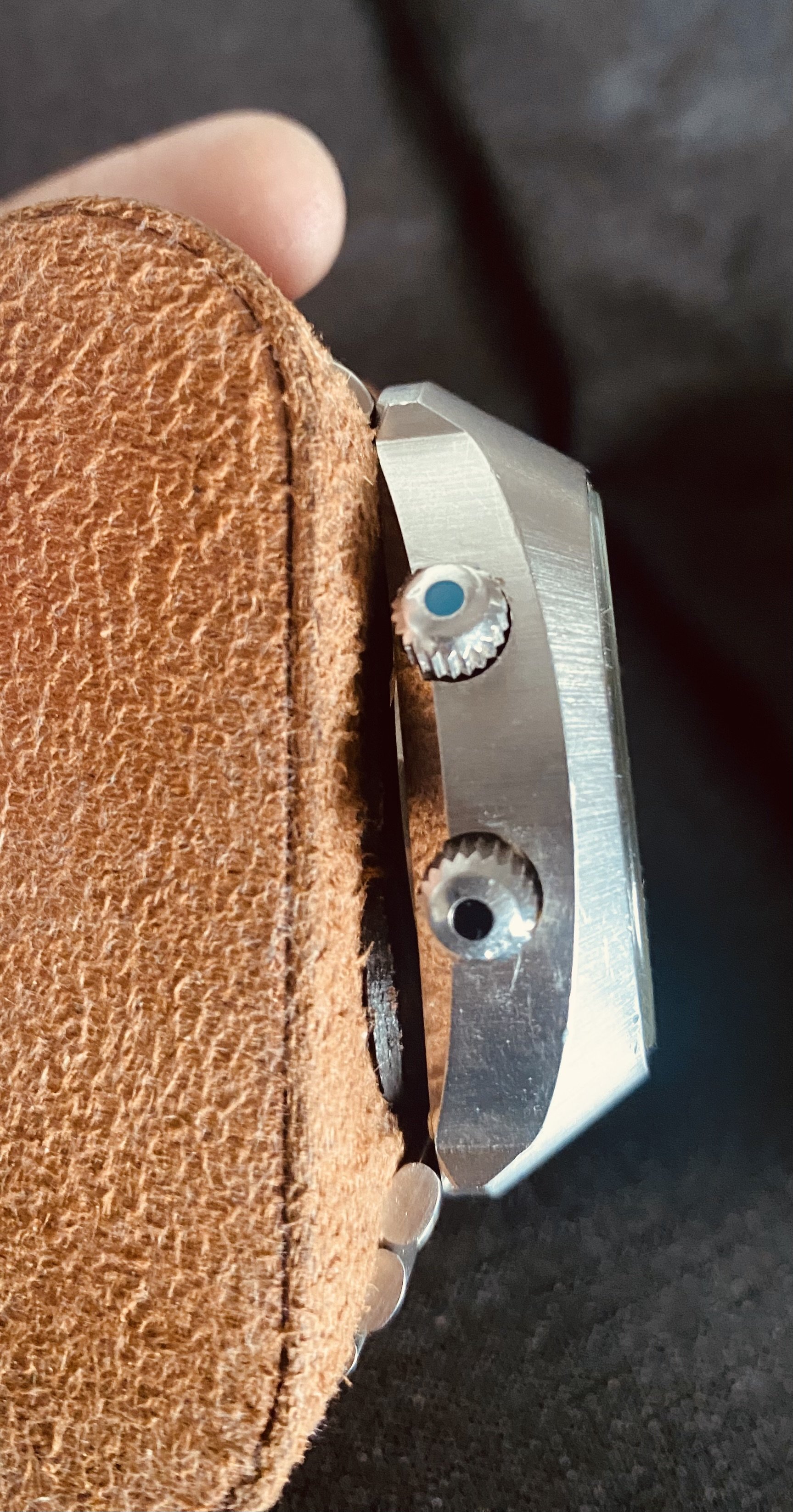

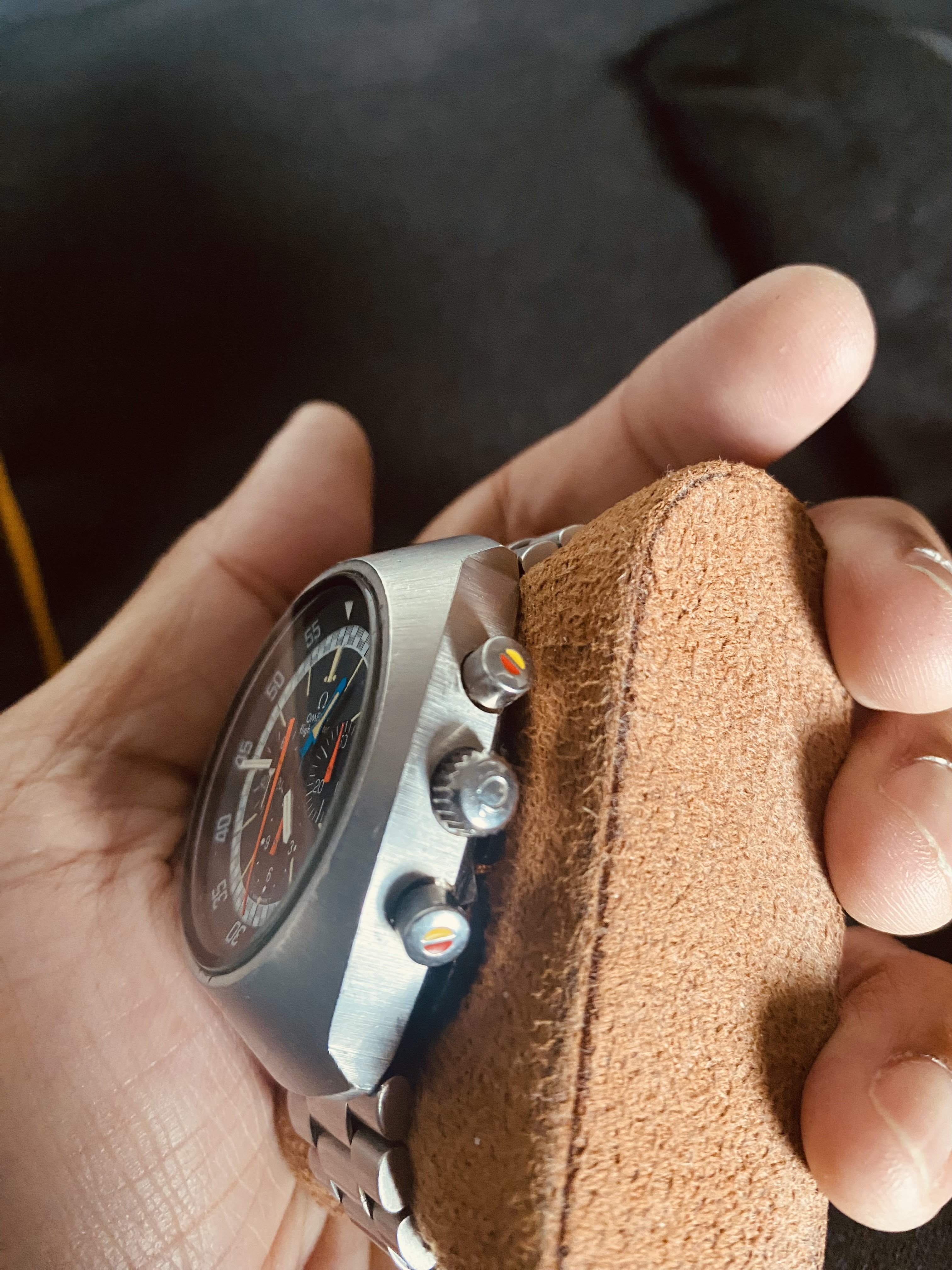

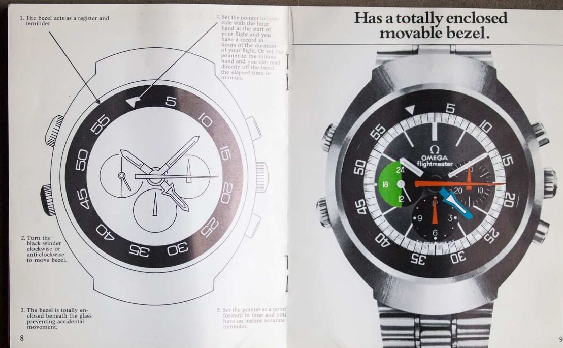

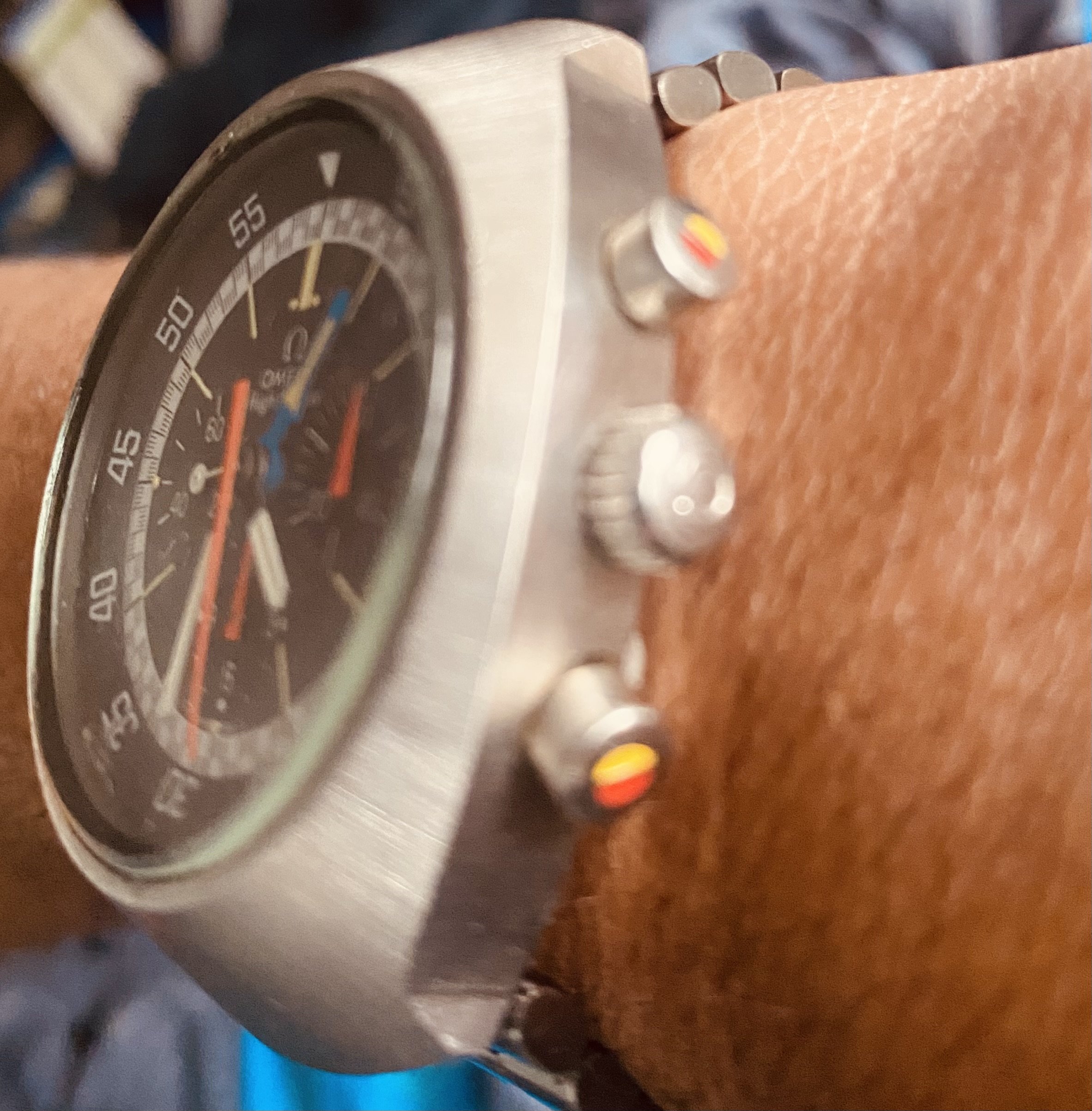

Hello to all the members of the forum and especially to the flightmaster lovers, I have an issue with the bezel of my FM, when turning the crown that moves the bezel it feels hard like a certain resistance, in addition to that when the bezel advances it feels like a small jump as if the teeth of the bezel protrude from its axis for this reason I would like to know if anyone has disassembled the bezel and has photos; I would also like to know if the bezel has any additional features that help it get on the dial, waiting for your advice and recommendations btw it is a 911, thank you!
307
230
The teeth jump is because there is a high resistance, that forces the tooth to jump.
And the inner bezel resisance is very probably due to glass seal melting.
The solution is obvious - have it serviced.

Can you post a picturw of your watch?
