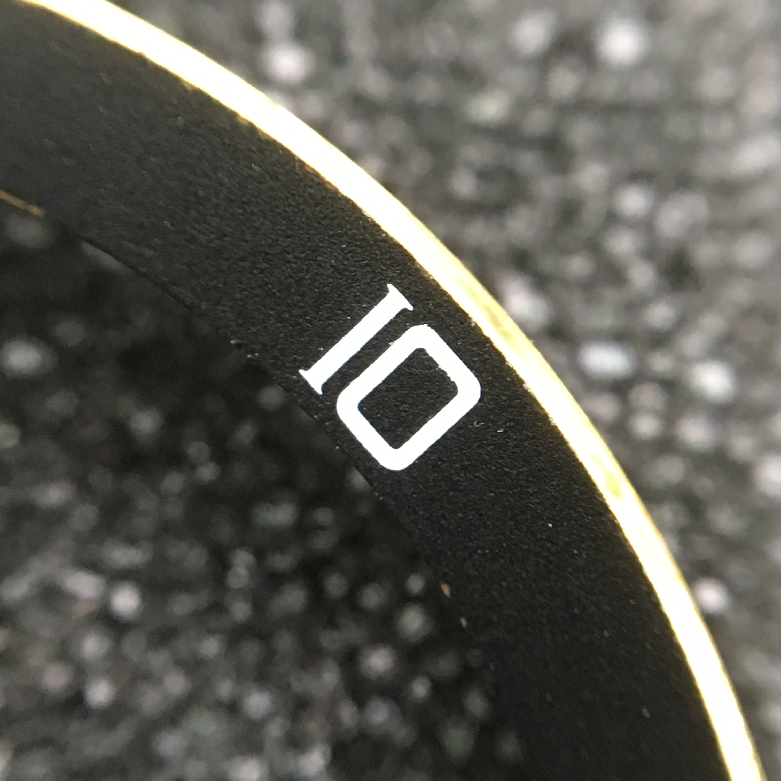

Also look at the zero in the 10 compared to 20, 30, 40, 50. They are not the same size in an original. Also look how pointy the hands are.
oh, yes, the pointy, a sharper angle, thank you

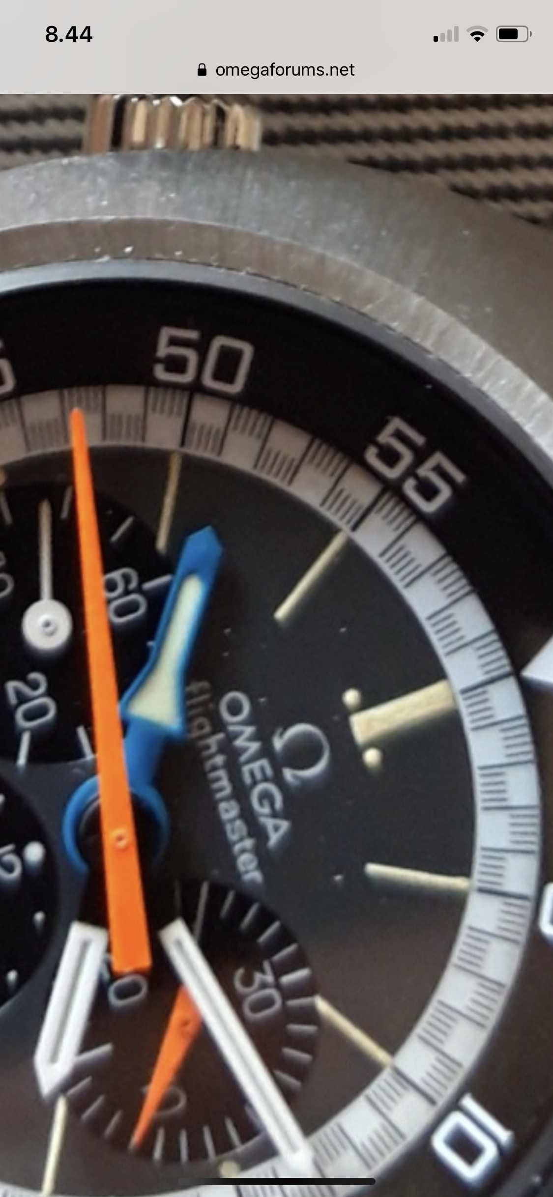

Original bezel and hands. You must look at the number 30 and look for the difference.
You also identify easier a service bezel from how the numbers are aligned, they are not straight to each other but tilted a bit. Just look at number 55 for example.

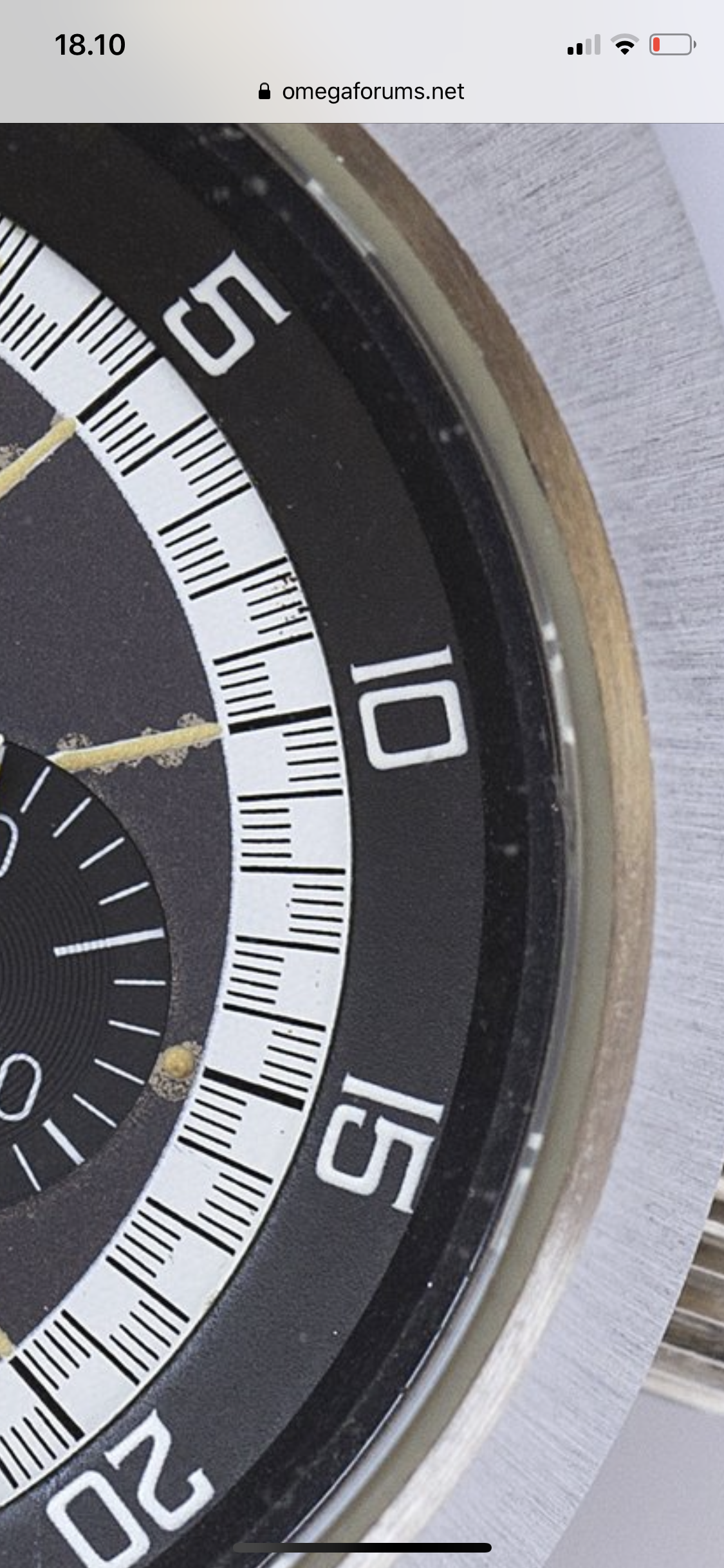

Usually I only look at the font, service bezel have serifs.
905
2,489

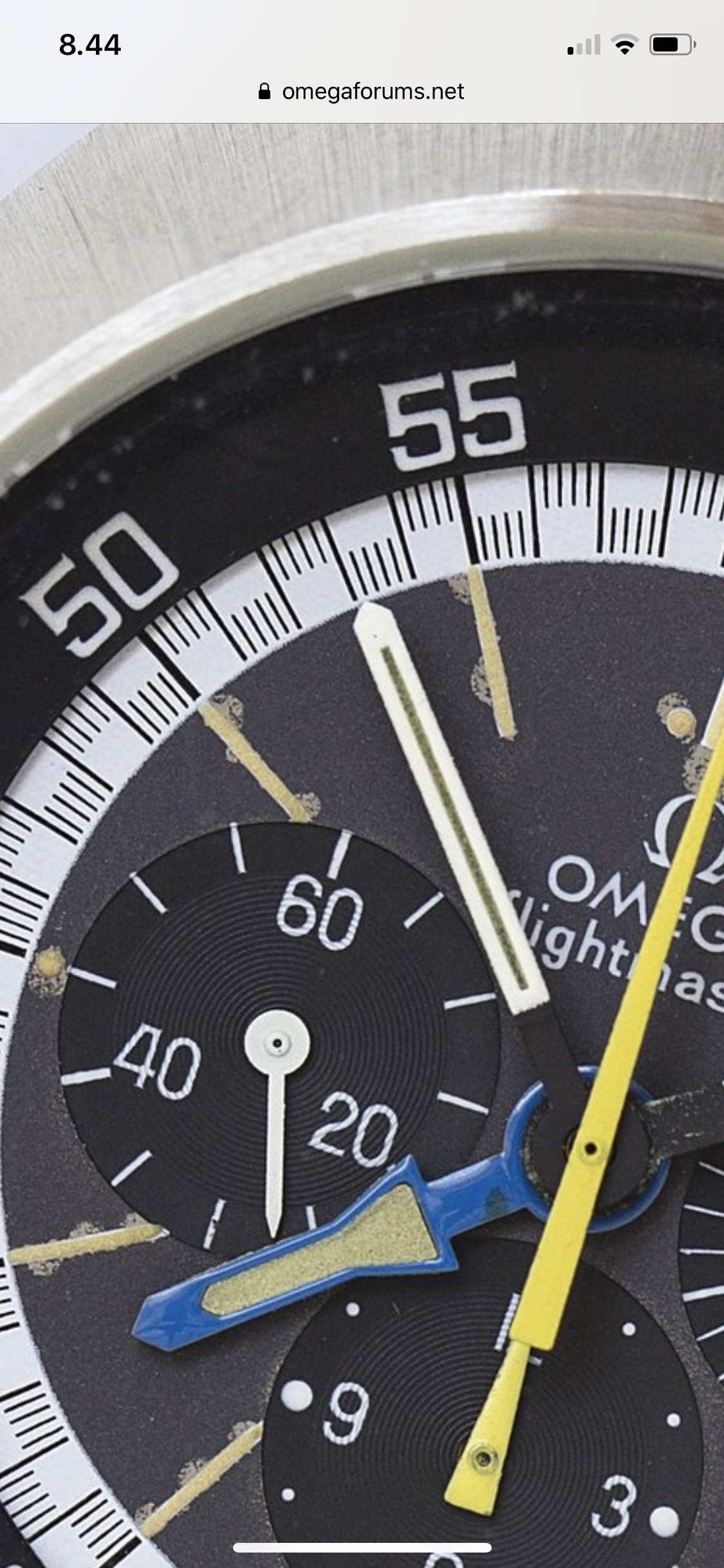

You mean the other way around, the original has serifs. (Top picture = original, bottom picture = service)
905
2,489
I meant, I always look at the ten.
This is service:
And this is a original one, so you can’t look at the ten, you need to focus on the 50 or 55’s.
319
558
You can also look at the 3. In an original the spacing between the top and bottom "loop" is not symmetrical. In the service bezel it is.
