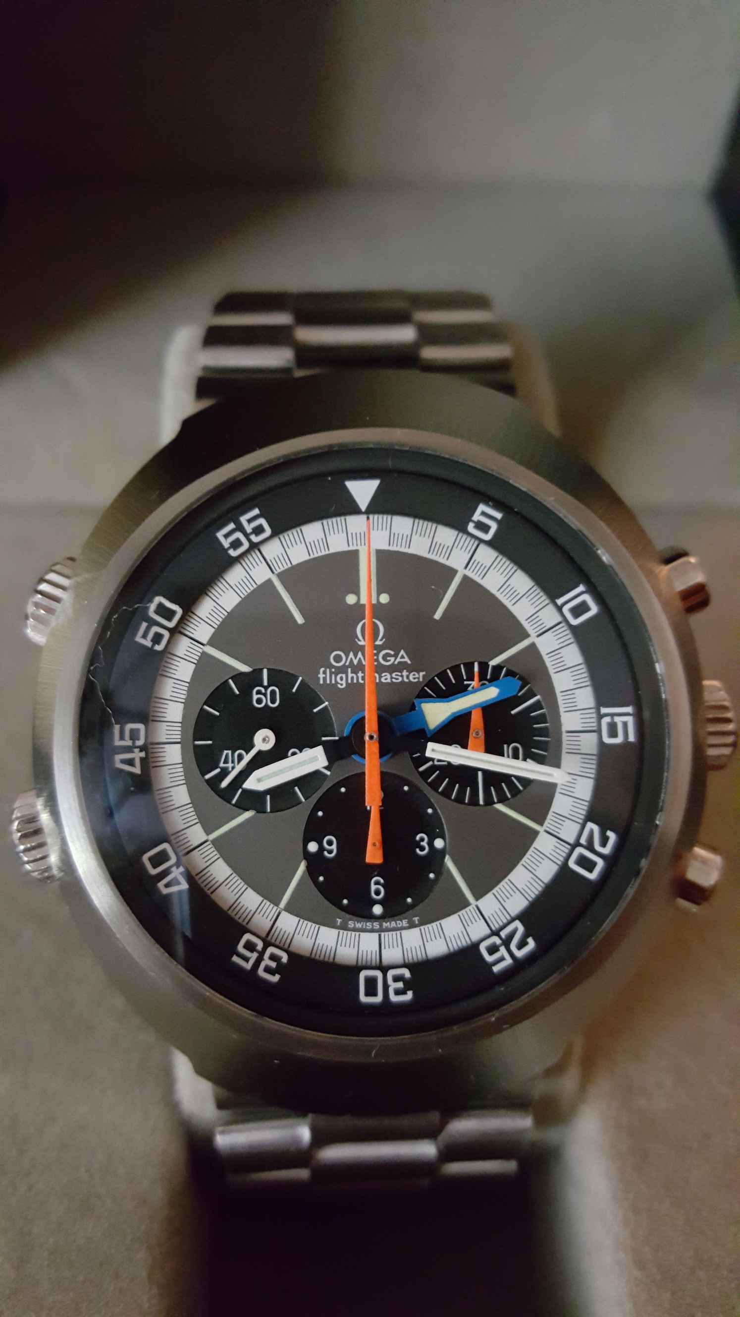

This photos 911 also havent got lume dots on 3,6,9 with yellow hands? Is it some version havent got lume dots? I am not flight expert...
Photos from web.. not my watch
It seems quite common to see dials without those lume dots and no evidence of them being applied.

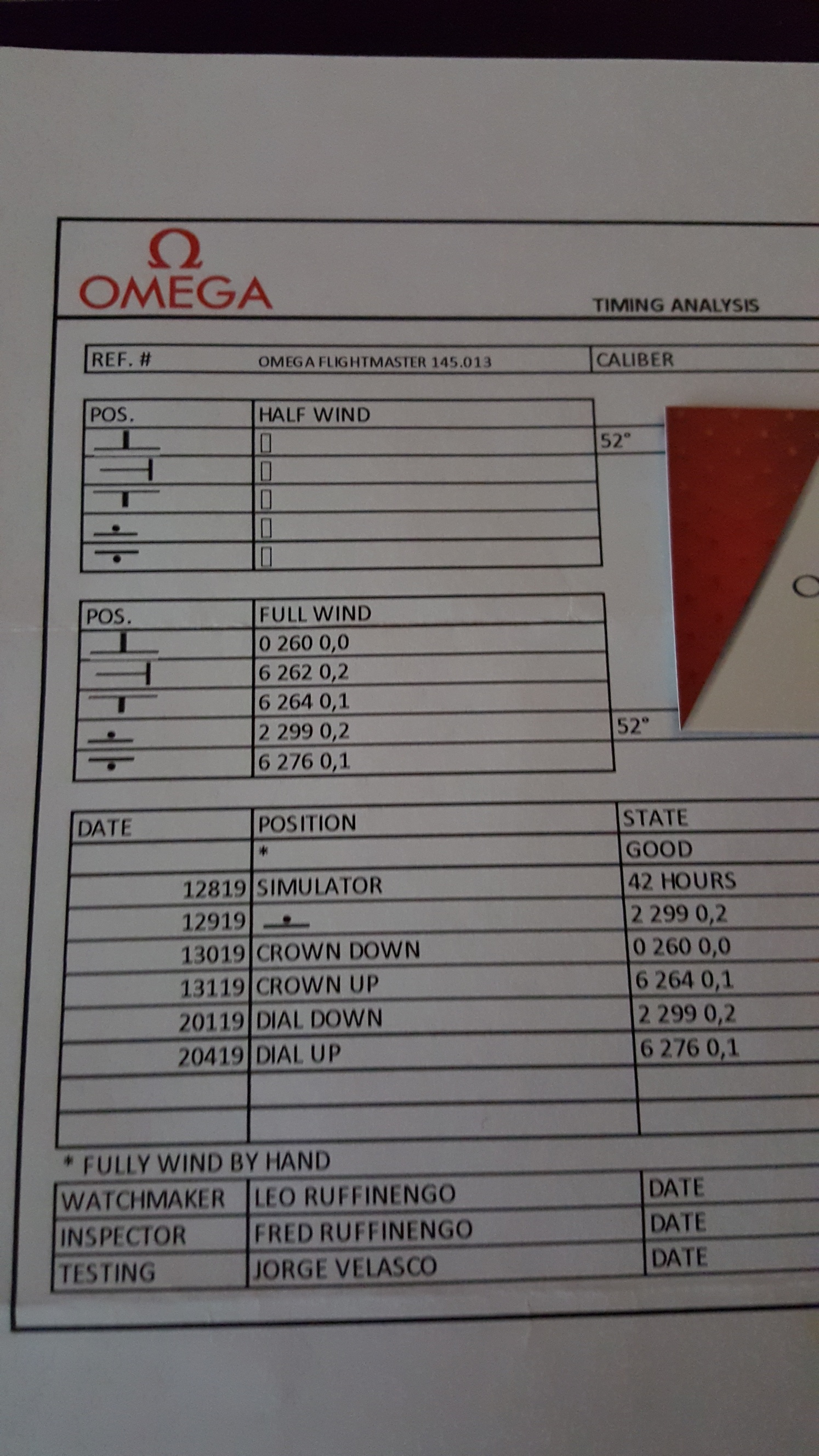

Expecting my "transitional" (911 in 145.013 case) back from Official Time Watch tomorrow after a complete overhaul and case refinishing. Will post some photos ASAP.

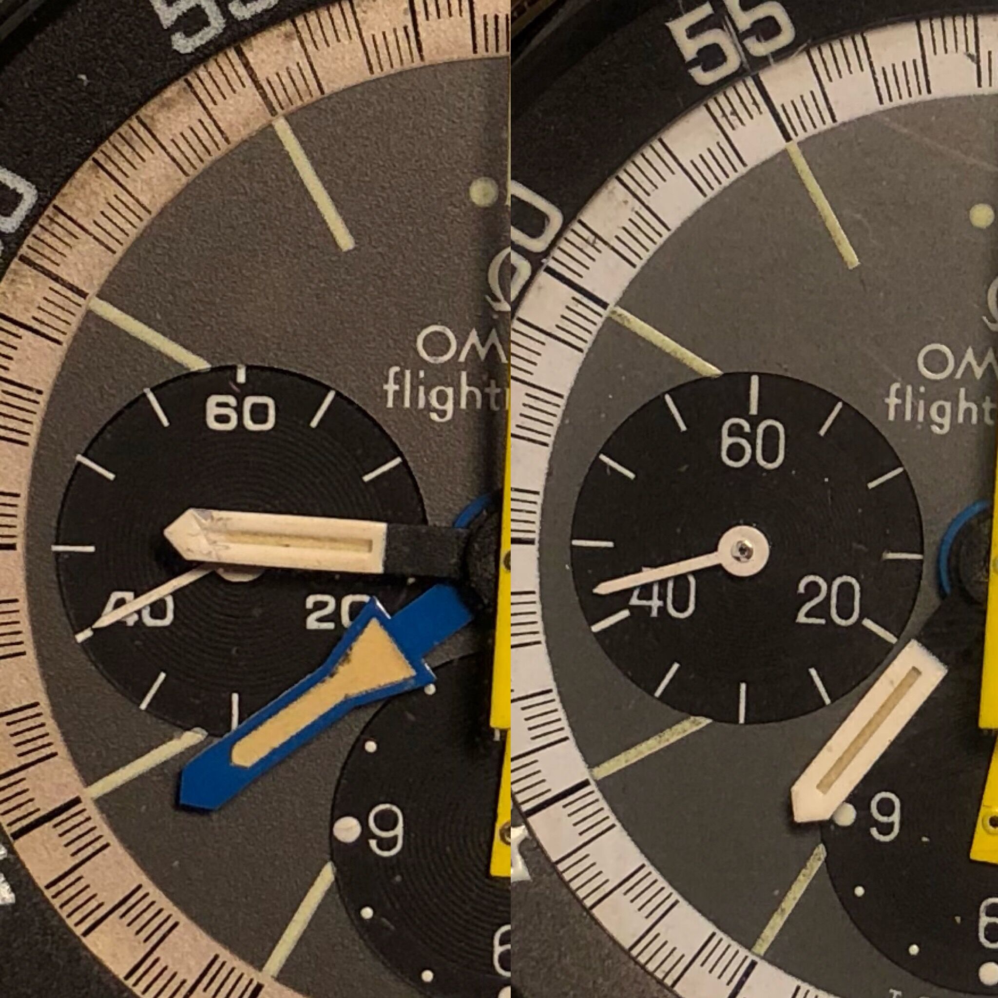

The Transitional is a cal 910 in a 145.026 case, in fact. The transitional dial has a different font on the subdial at 9 :
It was a 145.013 dial where they removed the green paint and printed the running seconds track instead (left). I have an example of extract of archives mentioning a cal 910 in a 145.026 case, with that transitional dial, to confirm that theory.

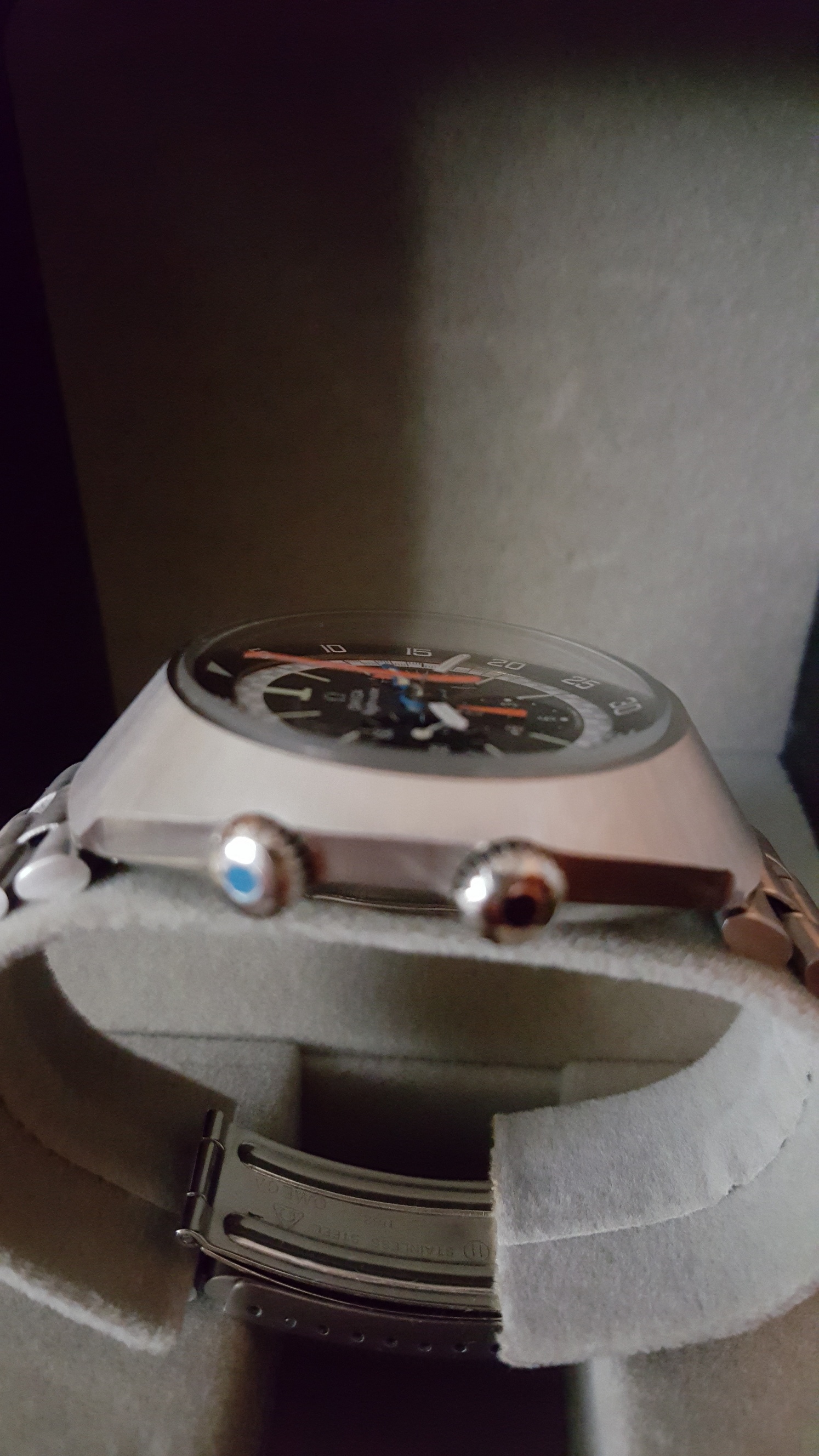

The other way around doesn鈥檛 make any sense to me. Why would a 145.026 movement/dial be fitted in an early case else than a custom build ? What do the Archives say?
No idea. I researched it when I first bought it (because of the single-color pushers) and found that some of the earliest 911s were supplied in 145.013 cases with single-dot pushers for about 6 months in 1971. I don't remember where I found that explanation (and I'm not militating for it if anybody doubts it); but here are a couple of other 911s originally supplied in 145.013 cases, according to their extracts:
https://omegaforums.net/threads/transitional-flightmaster.62988/
https://forums.watchuseek.com/f20/flightmaster-back-bienne-problem-photos-1167178.html

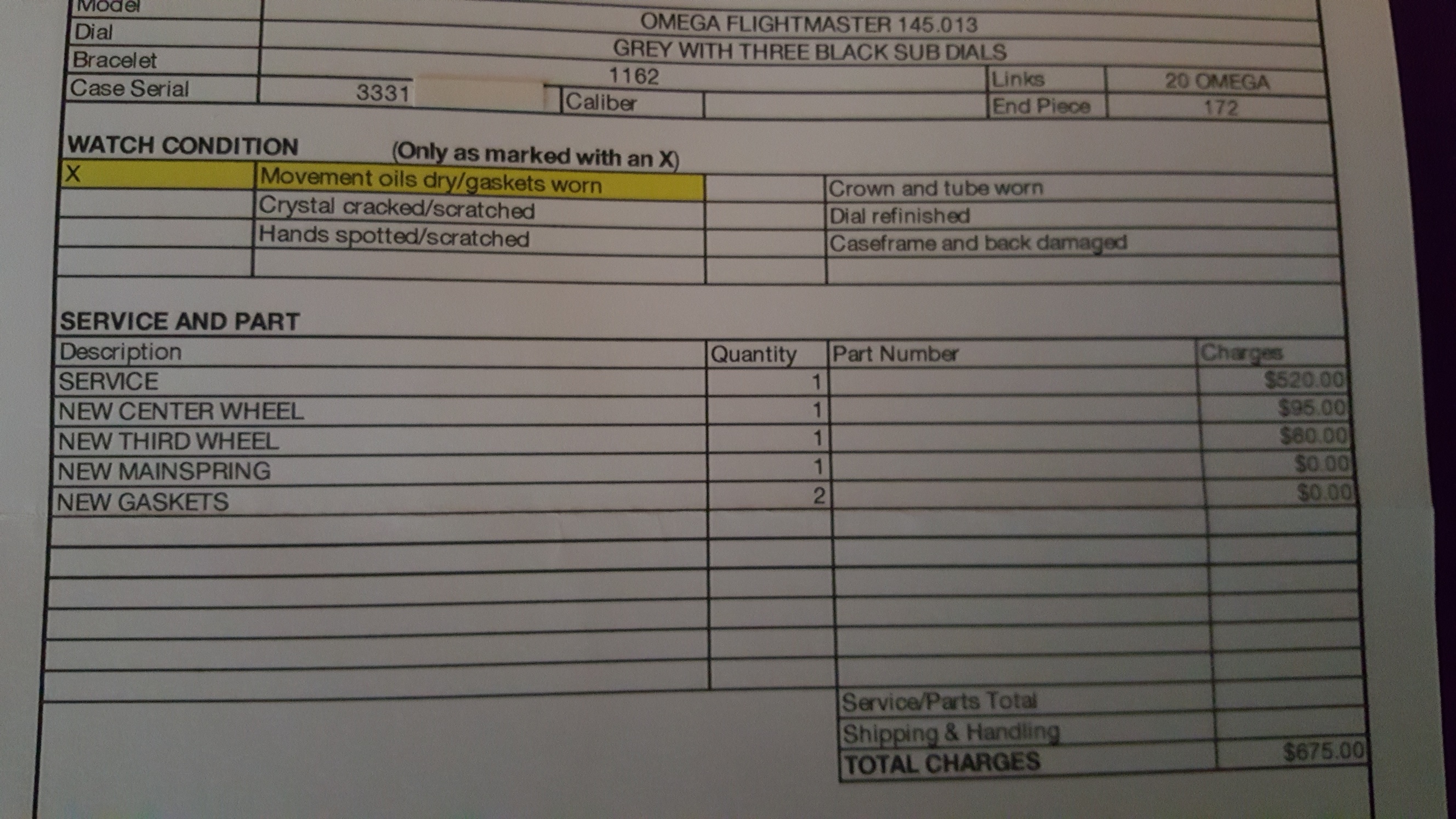

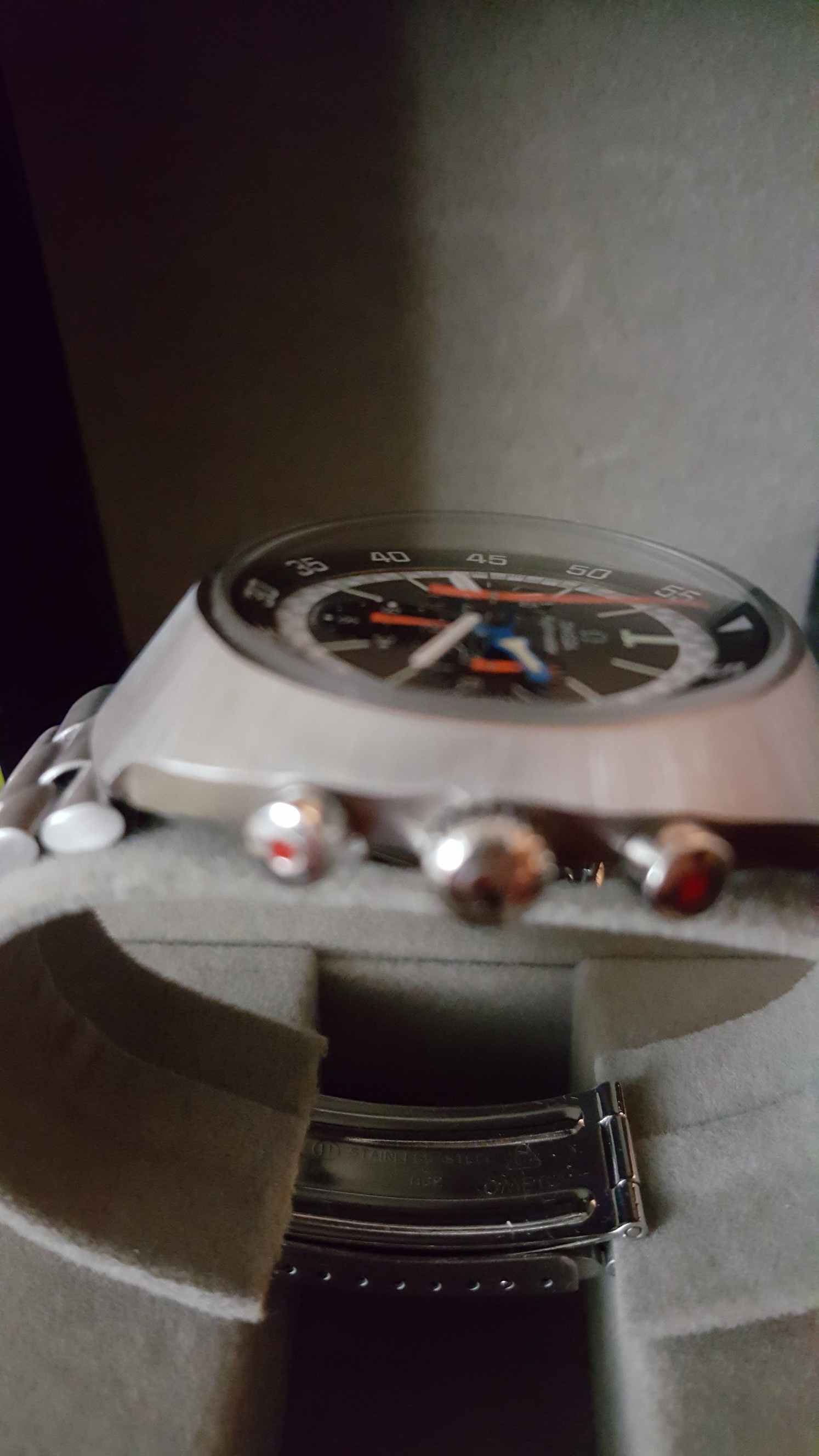

Anyway, apologies in advance for relatively shitty photos. Very happy with the service and the price. The base price for the overhaul was $520, plus $155 for the center wheel and 3rd wheel that Leo determined required replacing. Eight weeks later, he called to say that the overhauled watch was being tested and that it was working well but that he wasn't happy with the amplitude at half-wind power and that the 4th wheel would also have to be replaced, necessitating a complete disassembly again. I received it back a week later with no charge for the 4th wheel and extra work.
