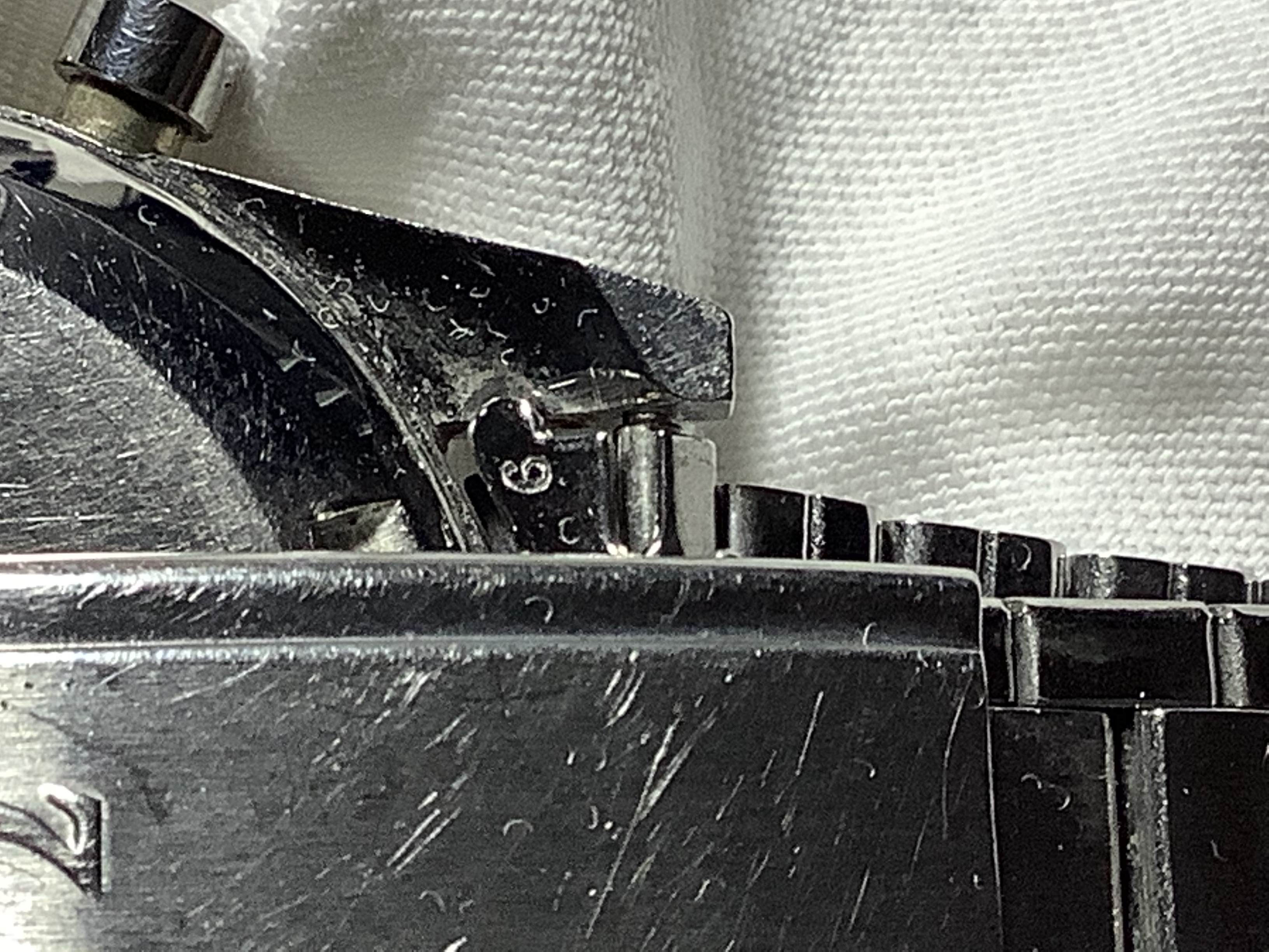

The dreaded combo: single-shoulder spring bars, and no. 6 end-links...

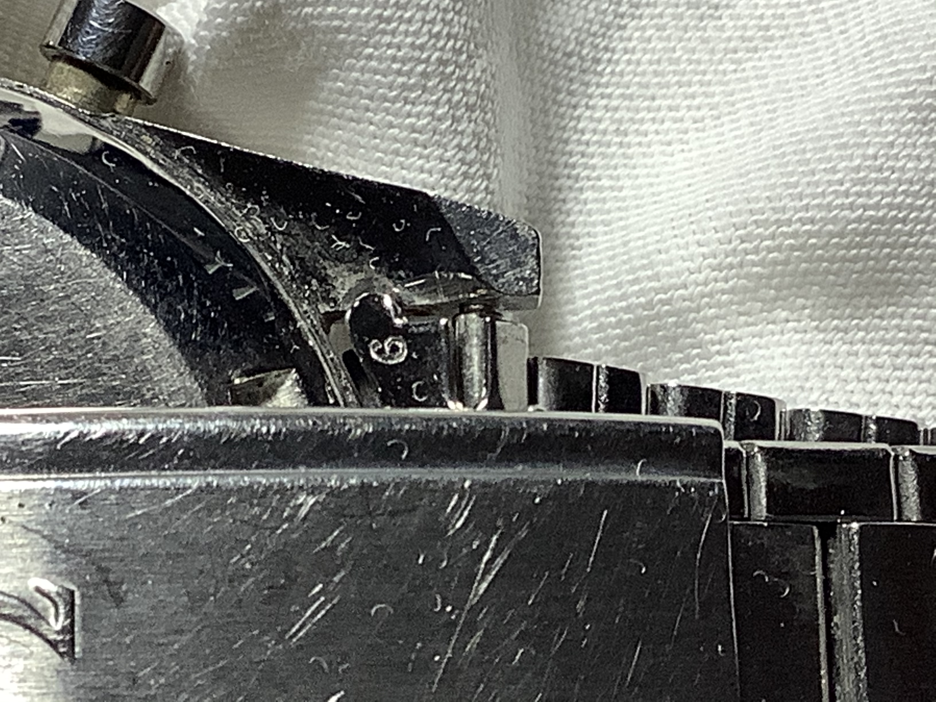

Just for grins, can you post a pic of the scene of the crime?
Yup, can do it later. Thanks.

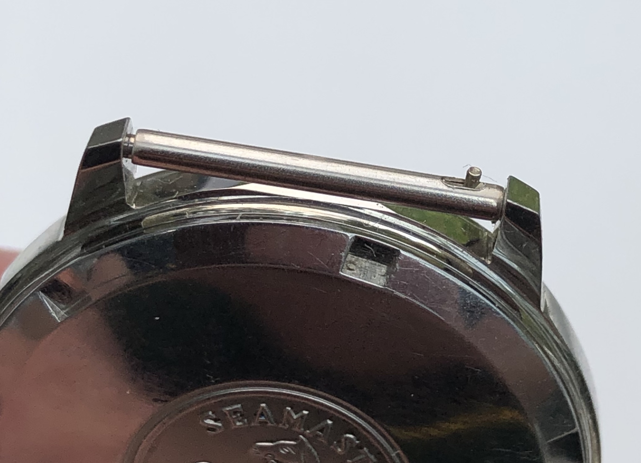

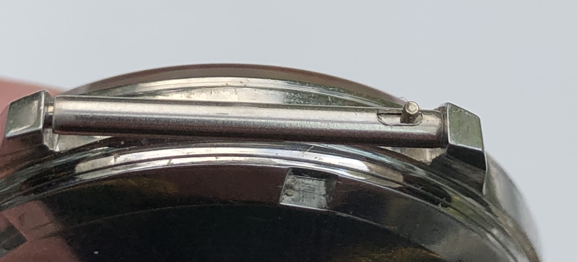

yeah, can see just the tip.
that’s what she said 😝
if you can just see the lever, try looping some dental floss (if you have teeth to floss and not dentures, thus dental floss around) and hook it around.

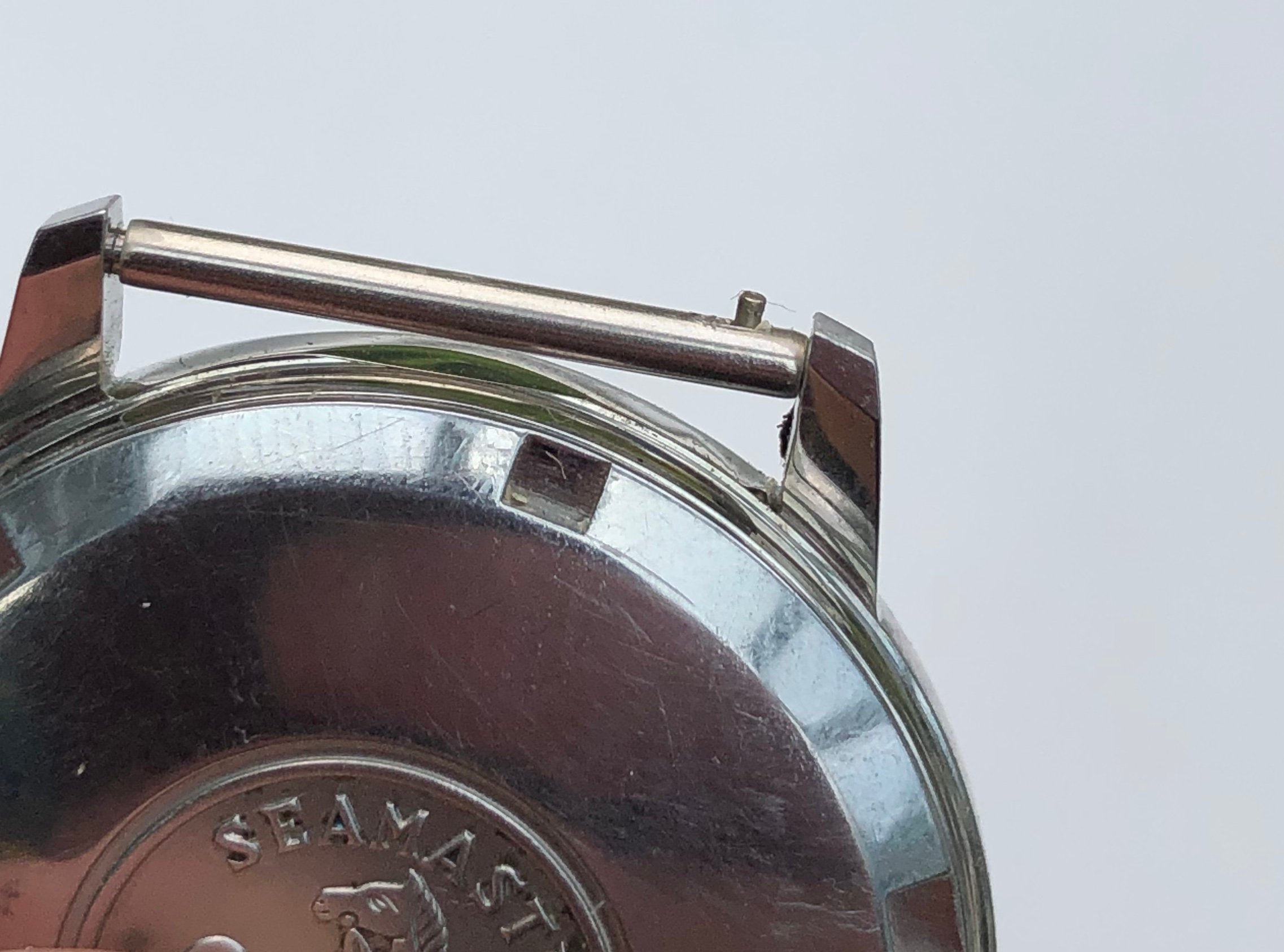

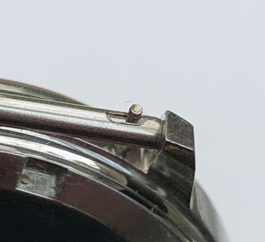

Has Achim said....
Some old spring bars have a tab which is hard to see unless you turn the spring bar, also hidden by years of dirt.

Has Achim said....
Thanks, I’m hoping this is this case. Will be a much easier solution if so.

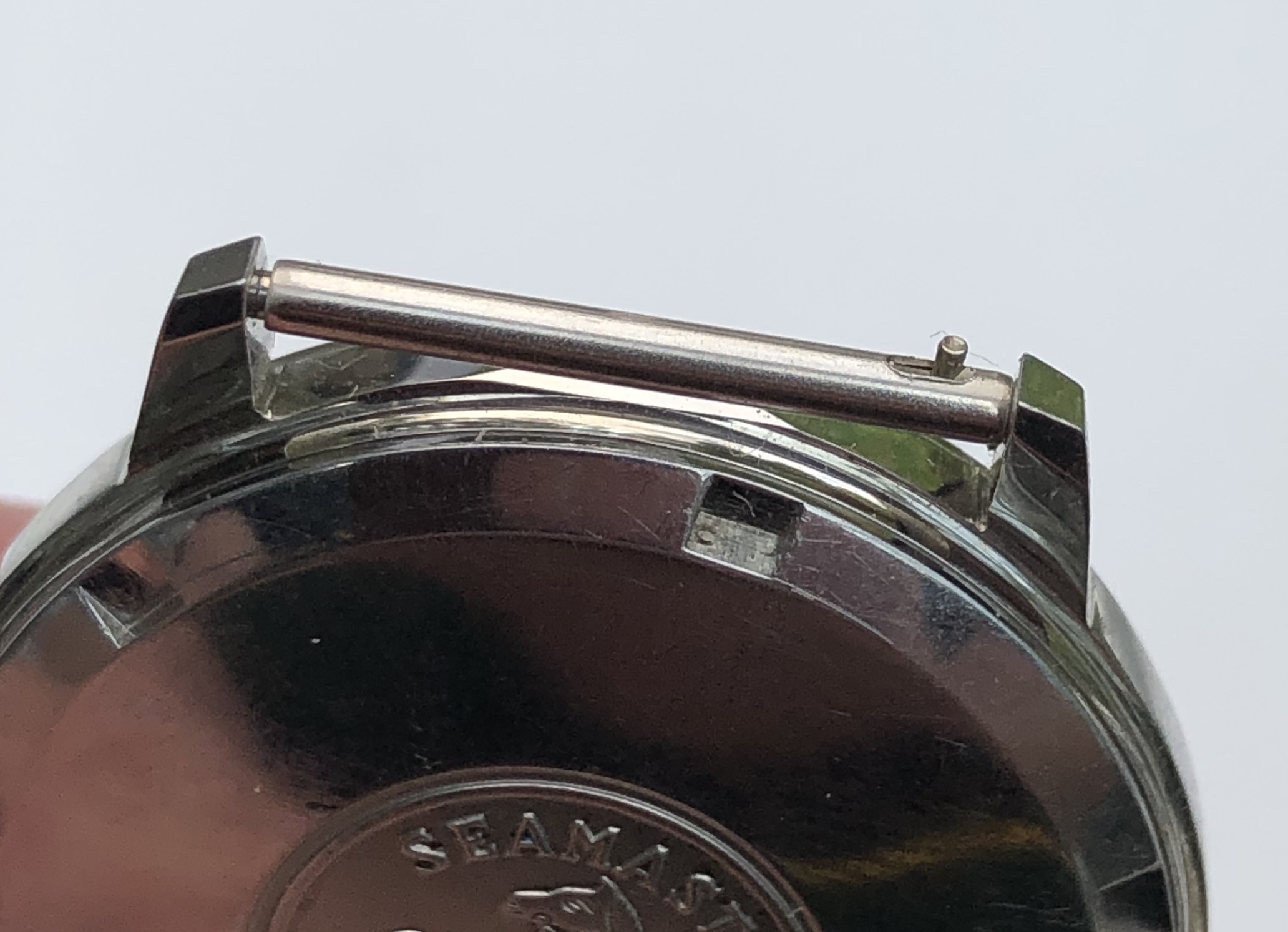

Not sure if Omega used these, but they are common enough on vintage Omegas to make me think they did use them. I agree they are stupid, and make getting the bracelet off more difficult. They never look like the photos posted above - they are almost always so caked with crap you can't see the little handle. Sometimes the body cheese is so hardened that I have to split the bracelet, open the case, remove the movement, and chuck the case and bracelet in the ultrasonic to clean it out, just to be able to remove the bracelet...
1,522
4,786
Omega did definitely use them from new, the case I show is NOS but has been in my drawers for years, I have also seen them 100s of times before too on other Omega watches especially with the flat link bracelets.. I like to see them on an old Omega but I don't leave them on.

Back in the 70's and 80's Patek Philippe used 18kt spring bars with the little 'handle', I doubt if they use them nowadays. On a watch like a PP that wouldn't get a lot of heavy wear they were easy to extract.
