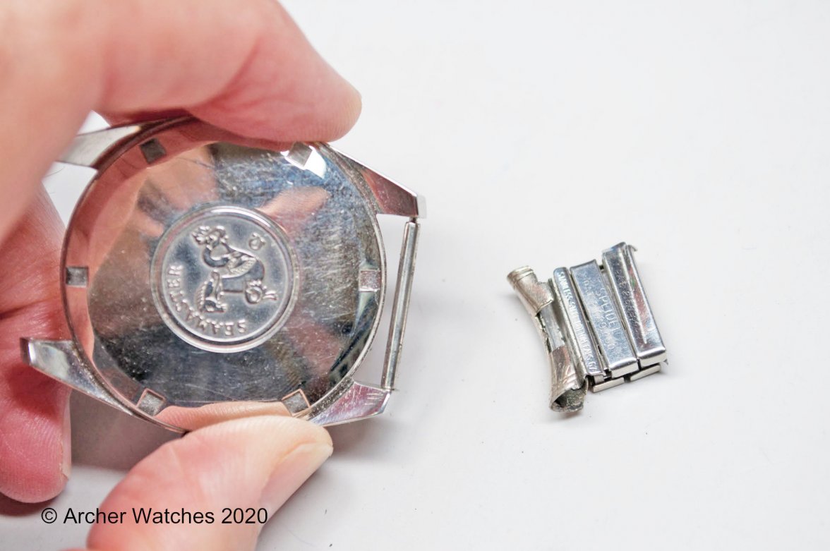

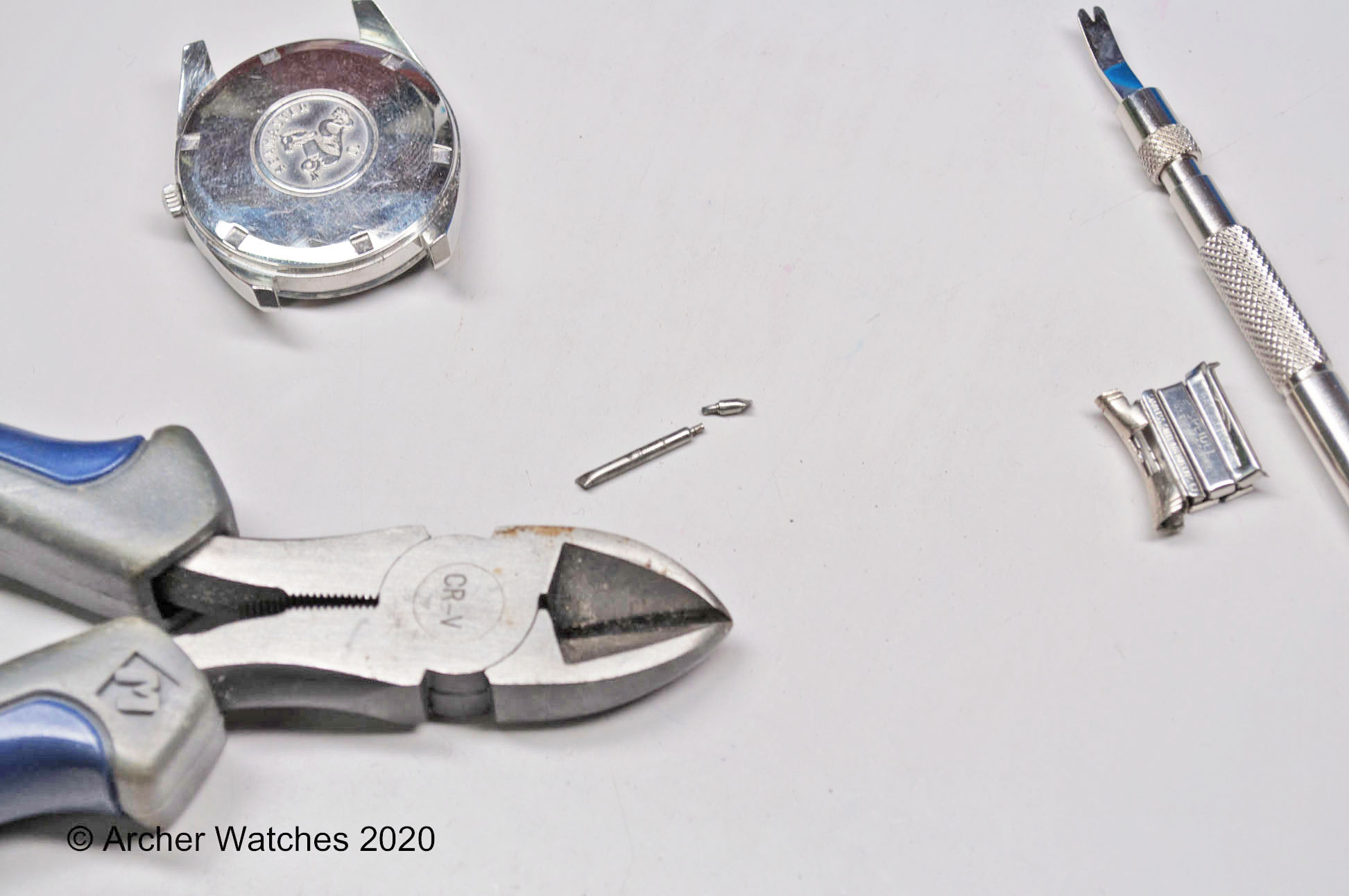

End links can be opened up easily without "destroying" them...
Optimally, hoping to do this without bending them, despite the fact they are flexible.
30,270
78,121
Sure - most of the options given have risk, so it's your choice. I just showed how I would do it. When people talk about using drills, or Dremels...well bending the link just enough to slide the bar out seems pretty tame to me, but YMMV.
