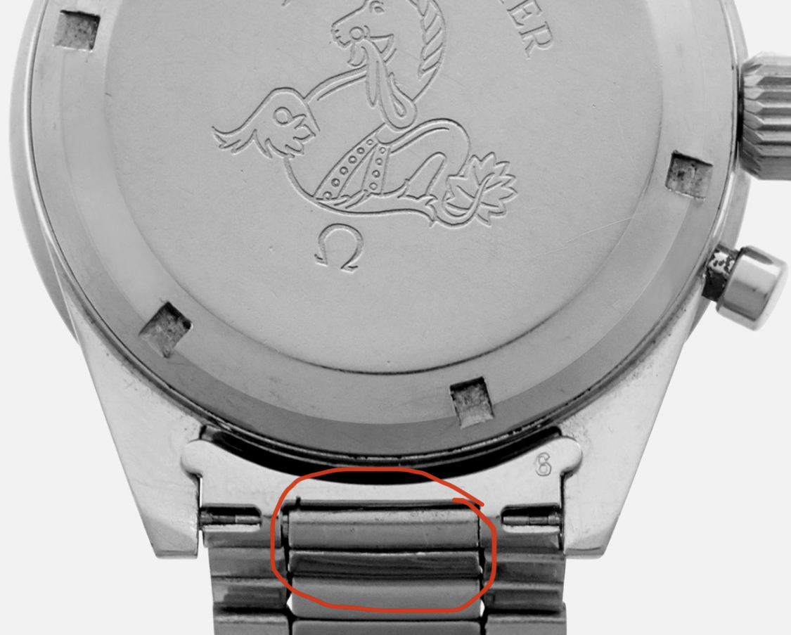

The dreaded combo: single-shoulder spring bars, and no. 6 end-links...

That outer bar is all fixed all the way?
Al's advice is looking better and better.
Will have to check that.
Not doubting Al could do this easily, but his picture shows an inexpensive Speidel band end. This is a number 6, way more at stake here if someone screws it up.

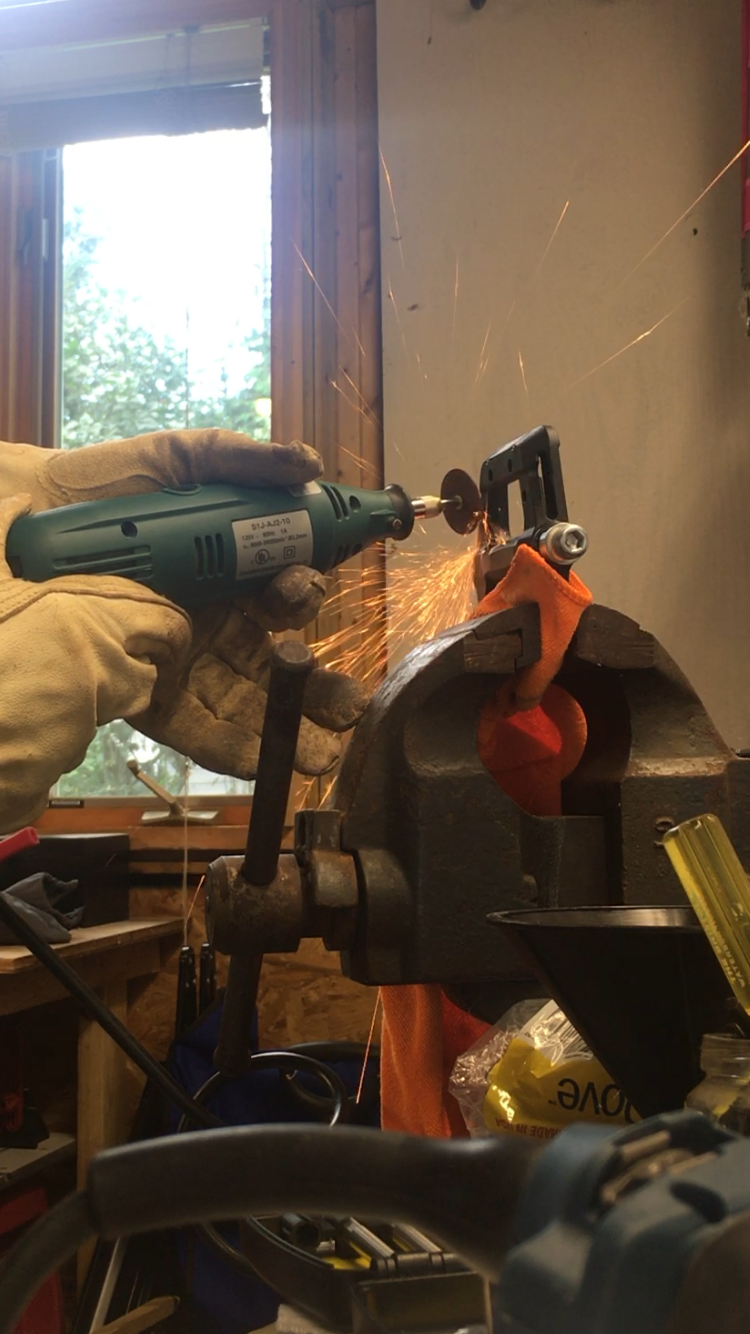

Are you skilled with a Dremel and cutting bit? I don’t have a steady enough hand to even attempt it on something like this without fear of taking out the lug, but I know some people who can. Just depends on your confidence.
Power tools in that small space way exceeds my confidence level. Would be willing to try the jewelers saw or flat head screw file, if I could figure out out to minimize the abrasion damage to both the inner lugs and outer end-link.

Yes, and clearly I wasn't concerned about the link in that photo when I took it off, but these links can be bent open - again just enough to free the bar - without doing any damage.

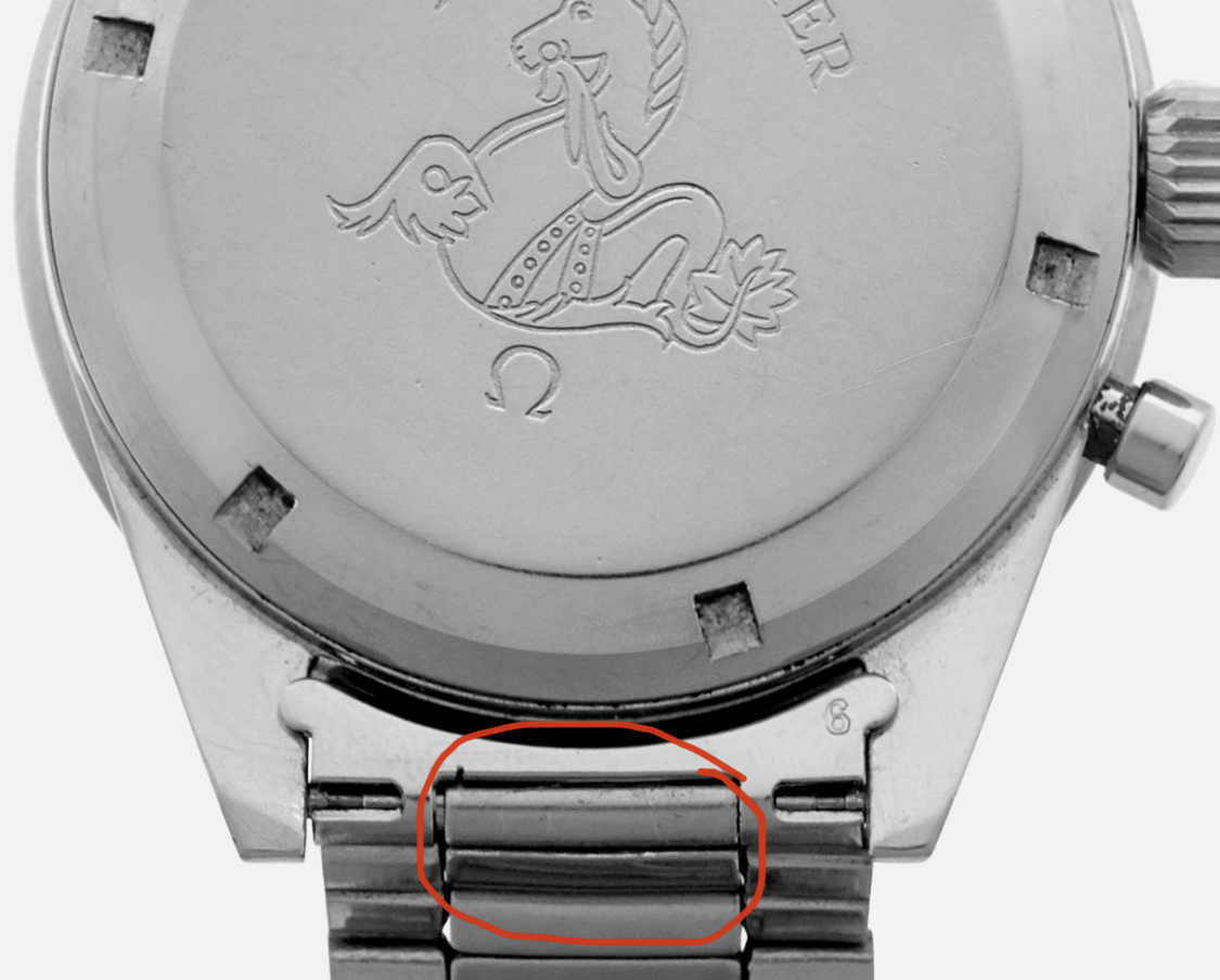

This all makes sense, thanks. My last hope is that there lurks the little lever under there somewhere. Any tips for getting enough purchase on the spring bar to rotate in either direction to check?

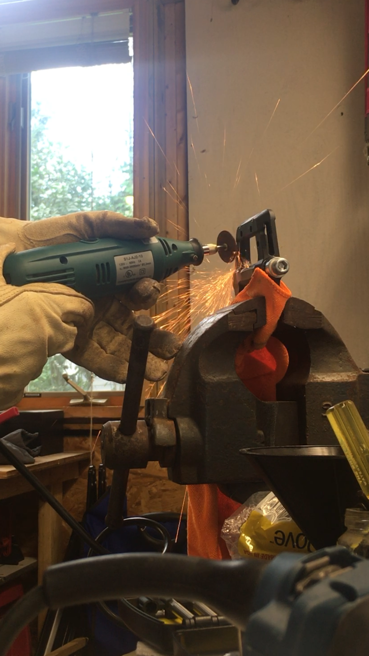

I had the same problem the other day.
I slightly bent open the last link of the bracelet, the one that holds the bracelet to the spring bar, so I could remove the bracelet.
Once the bracelet was removed I had easy access the the spring bar and used nippers to cut it.
Great idea. I’ve seen this, but sometimes it’s hard to put back that link to its original-looking configuration. Yours looks good, though.
It turns out, after careful inspection, that I do have that little level spring bar noted above. So despite what I originally wanted, something is going to get bent...
