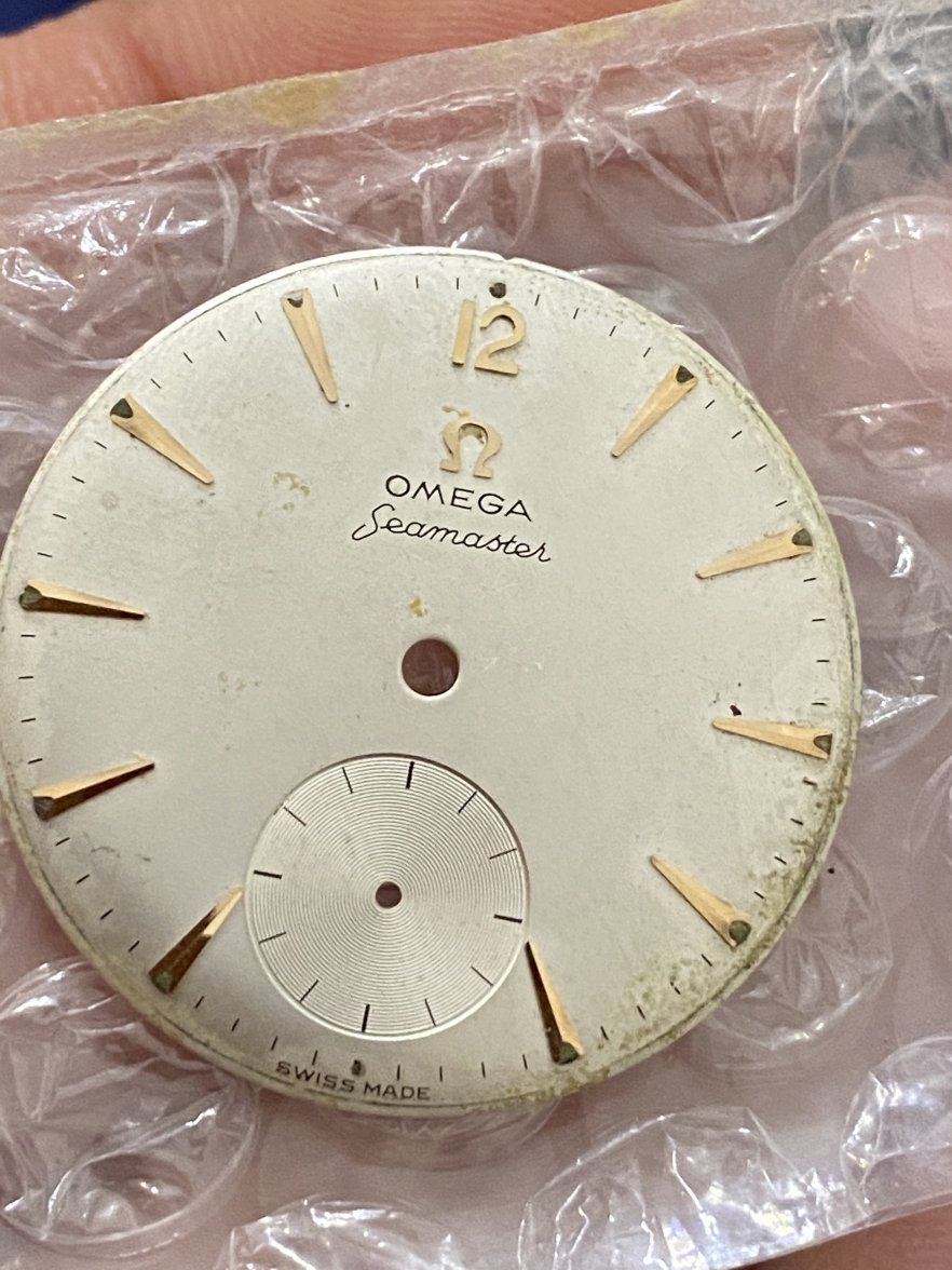

Test for everyone. Is this an omega redial ?

The quickest "tells" are always the sub dial print and the Seamaster / Omega font.
Your sub dial indices are too long and off center. Once I see this (and am looking for an original dial), I simply move on.

I am still new at this but in the subdial I see a gap between the markers and the indent at the top of the dial and no gap at the bottom. Is this tiny variation ok, or an effect of the angle at which the photo was taken?

Just wrong
script too close to the symbol.

Well some points to consider:
Seamaster dial:
1. The S is from another era, and the “r” faints.
2. Between 5 and 7 the minute markers also faint too much.
3. The seconds markets in the sundial are misplaced and not aligned.
The plain omega dial:
1. Omega is too close to Ω.
2. The seconds markers are not aligned good.
I can’t find other problems. So I would say this is a far better work

It should be as obvious to you as identifying which one of the images below is the photo of Emma Stone and which is the drawing of that photo
This is a really good comparison, I understand what you mean. Every now and then, I’m also looking at dials and figuring out echter it is a redial or not. Topics like this, with examples help me a lot. But in de the end it’s hard to describe and explains why the drawn picture of Emma is drawn and not a photo.
No still a crap job 😗
It’s when you can’t tell from first glance you doing better. And both are worlds away from that.

I think this is a digitally manipulated image. the black text looks 'off'. I think someone has comped this image together & pasted the text from another image. When I zoom in, I see slight differences between the background of the text & the dial. This makes me suspect that the black text is a layer that has been placed on top of the dial image. The feathering in the top layer looks off.
Very suspect mate.

@Kargol The thread mentions| "Test for everyone" That implies that you may have expected a one eyed blind man to say it is not a redial. It also begs critique, and mine would be......... "the redial is a flunk-out" To me it looks like icing on a Ritz cracker.
Very suspect mate.
No my friend you are wrong. That’s a photo I took holding the dial when I got it from the post office .
