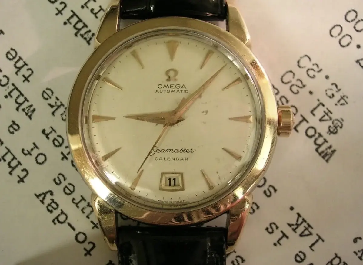

You should enter ‘Seamaster Calendar', ‘Omega 351', 'Omega 354’, ‘Omega 2577', 'Omega 2767’, and other OF members will make other suggestions.
What is paramount is that whatever takes your fancy, start a new thread here and someone will let you know if the watch is a good deal or not.

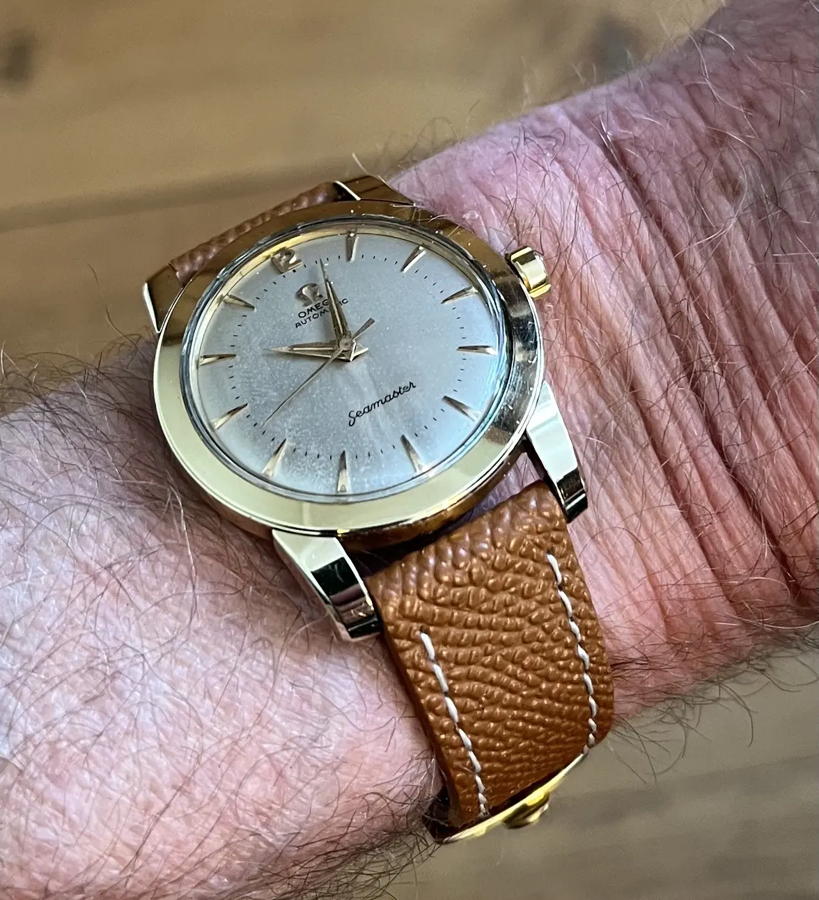

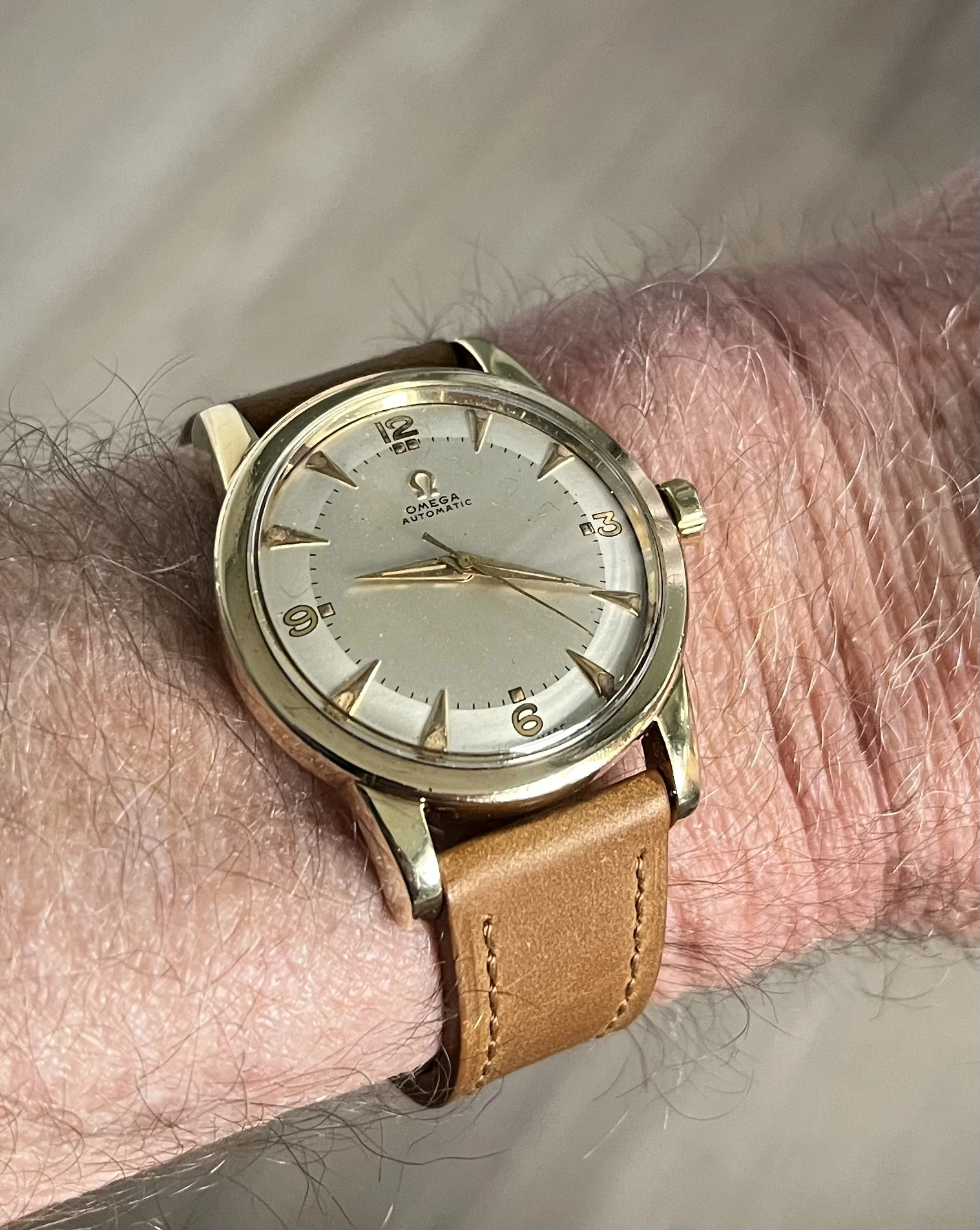

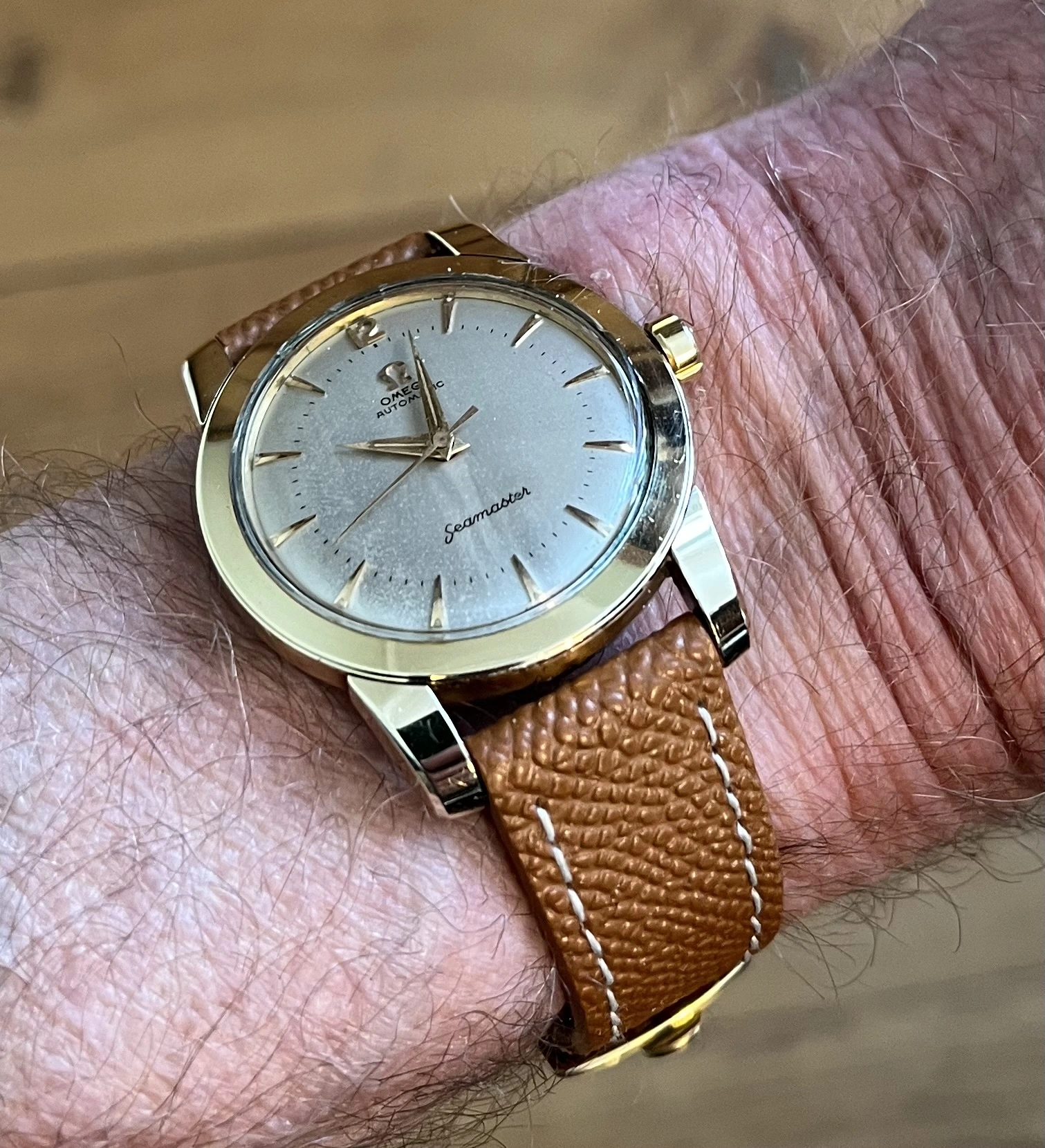

Here are a couple of examples from my collection
The first is a 2767 with a 354 movement and the second is a a 2577 with a 351 movement

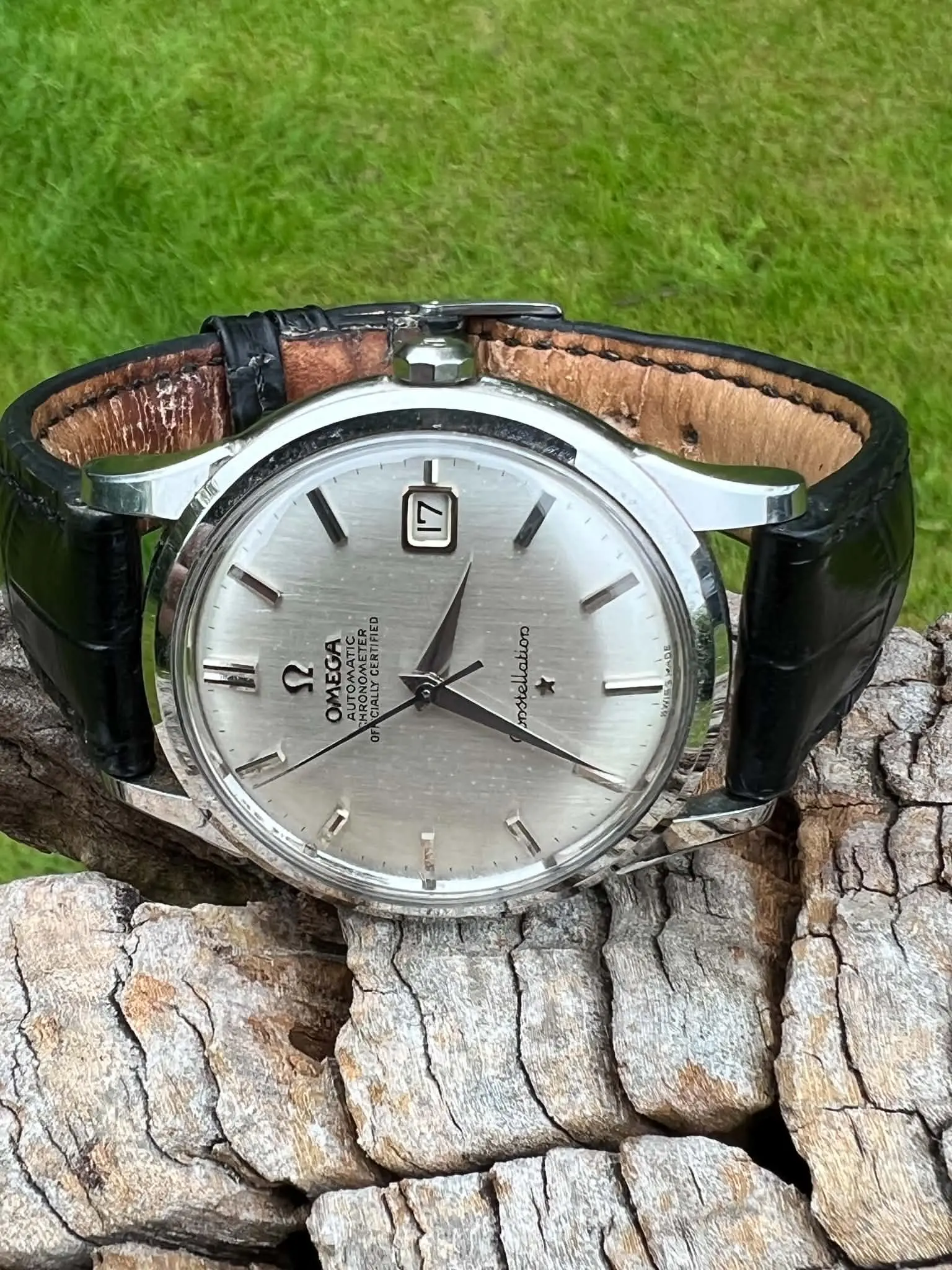

I think you have a very healthy budget - so please don’t settle for none original or poor condition examples.
If you like the simple DeVille styles then you could also consider the late 60s Constellations, as they wear a little larger on the wrist.
Constellations were Omegas top of the range watches at the time.
Try looking at references 168.010 or 168.018.
Both references have a date function and the latter is especially good value.
(There is the 168.016 which has day and date but these are too busy for my tastes)

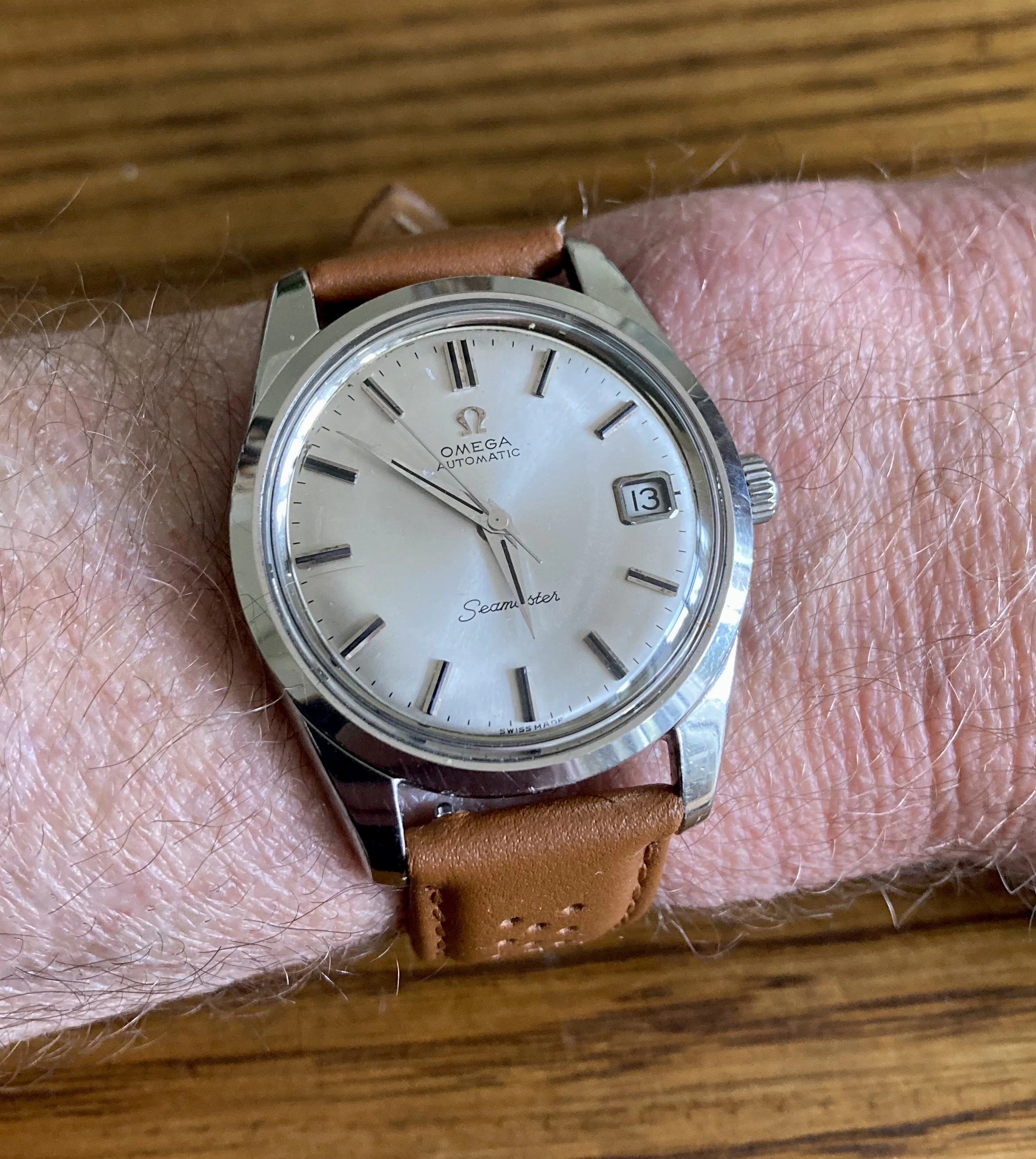

As @Peemacgee suggests, 166.010 are very nice watches with the very reliable 565 movement. The 168.010 is similar in appearance but with a chronometer movement.
Again, a photo

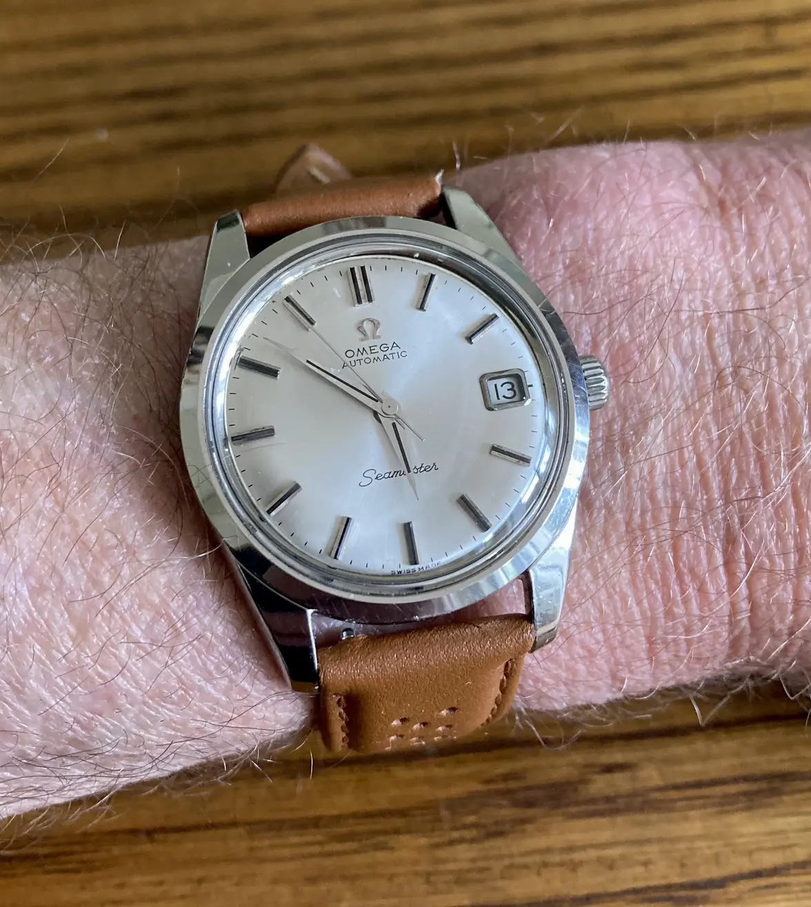

Here are two watches that have been recently listed for sale from other Omega Forums members. Neither one are gold, but otherwise they are very attractive watches:

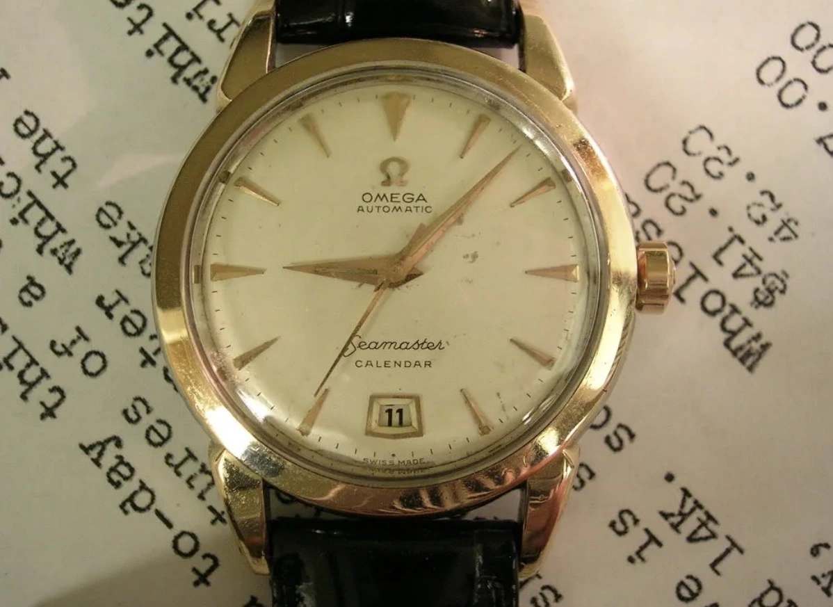

The classic Omega Seamaster did come with a date function if you wanted it:
Google “Omega Seamaster Ref. 2627” for similar watches. This version did not have a quick set date. If you were setting it, you have to move the hands forward to get to the desired date.
